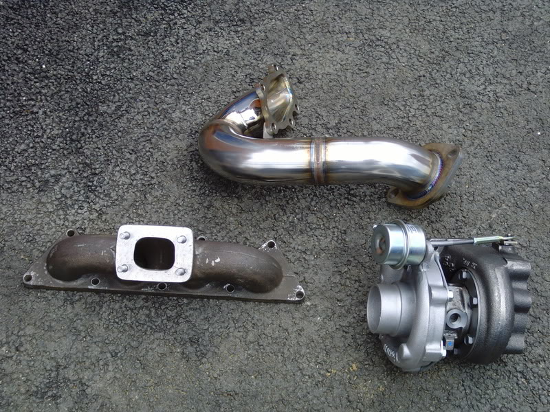

i priced up the parts for a turbo kit, £1300 without ecu, you have the ecu so your at an advantage, that was with some new bits aswell!! bolt it on your engine, run low boost till it blows up then rebuild it ;) with mapping you could boost yours for less than £1500 if you searched around for good 2nd hand parts
2nd hand t28 = £150
new oil feed and return = £100
Manifold = £150
downpipe = £100 (my mate could make you one)
intercooler (cheapo ebay jobby) = £50
spark plugs from megane = £30
Boost pipes including hoses = £150
nimbus heat sheild = you have
megane injectors = £70
obviously things like oil and coolant etc will be needed but thats the majority ... £800

Mike on his first "demo" car used an ED exhaust manfiold, a focus RS turbo, and a custom made turbo downpipe, the ED kits are decent though if you want to just buy it all in one go.
197 head and inlet is about 300 quid ish, it only lowers the CR a tiny bit though, the rest came from the use of a megane head gasket as well which is thicker.
CR at the finish was just over 10 IIRC and it drove very well like that, I see no point in going lower CR for a low boost conversion, it was still taking upwards of 20 degrees of ignition advance in fact which shows how much these engines like big CR when on boost.
