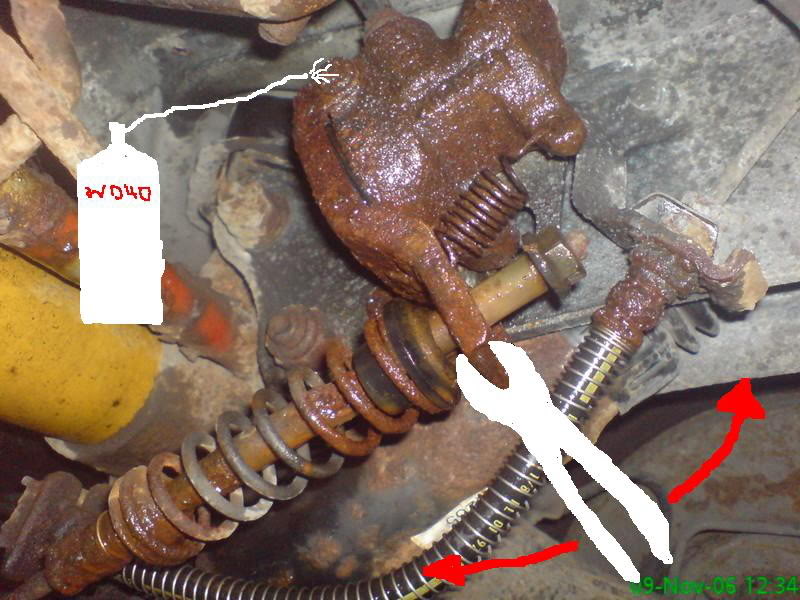

the load sensing valve isn't attached on the cup, do a search there is a vosa newsletter for MOT testers, to explain why there is no braking force on the rear.
that's what I wanted to hear, thankyou. I will give it a search, if no luck I'll post in here again haha.
Thanks for your help, probably the most informative reply I've ever recieved on CS
this is what your dads looking for, Incase people are wondering what one looks like, This is a 306 but its all the same
