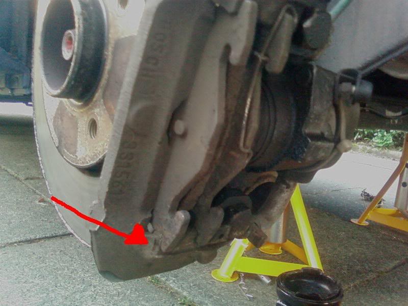

Hi All, Anyone know how the rear pads are changed. done the front ones with the guide from here but can't see how that works with the rear. Or are they released with just the metal holders?!? Thanks

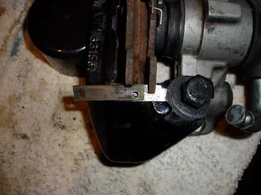

I read how easy to change the pads it is so just put my car on axel stands...took wheel off...now i'm stuck My search for rear pads doesn't help much as i seem to keep getting disc guides.

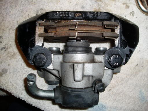

I don't know what guide you guys are using , but you don't need to remove any part of the caliper to change the rear pads .

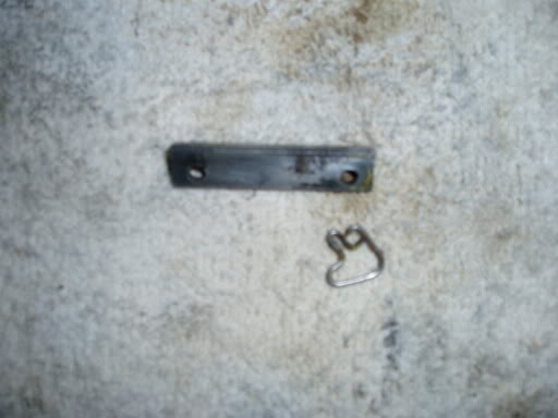

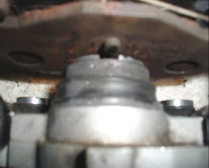

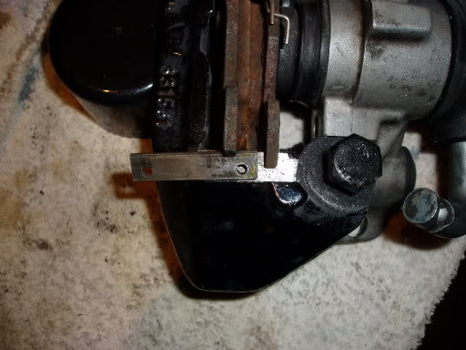

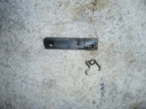

All you need to do is remove the spring clip , tap out the pad retaining plate outwards ( small angled piece of metal ) then pull the old pads out using some pliers . Don't loose the anti rattle springs as you use them again . Then wind the piston clockwise back into the caliper back so the groove is horizontal and the lug on the back of the new pads lines up with it .Make sure the brake fluid reservoir is unscrewed and put sone cloths round the hole just in case the fluid overflows , it shouldn't do but better safe than sorry .
That helps thanks! Sorry though, the bar won't move, i mean how can i knock it out away from the car when it seems something is holding it in? I know rust is prolly making it stiff, but hmm it's hard to explain...even if i did it that bar, the is something on the left stopping me from slidding it out?
It'll be a combination of brake dust, dirt , maybe a little bit of rust . Get a flat bladed screwdriver or a punch and tap it out with a hammer . There's nothing else to stop it sliding outwards away from the car . Once its out clean the retaining bar with some sandpaper also clean the surface on the pad mounting bracket or else you'll find it hard to tap back in .

Do you have that on both sides of the car ? Mine doesn't on the 182 and didn't on the 172 . Can you tap the retaining clip inwards then to give you enough clearance to remove the pads ?
Hm mk... on the other side of the bar is the bolt. So i think i'll just take it to my mechanice friend an he can do it The talk of oil going places has scared me anyways.

No problem mate . Sorry i couldn't help anymore , but i can see the problem , they don't usually have that on the pad mounting bracket stopping the retaining clip from sliding out .
