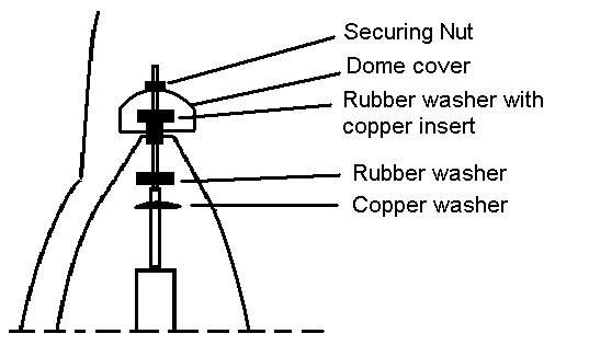

it did this to me when i fitted my fk's. on the rod you should have something like a rubber ring, copperplate that stops the damper from moving up into the car, another copper bullet with rubber protector which goes inside the boot that connects to the copper ring below then a cup and bolt on top. hope this helps
I did a little sketch for you, it goes something like this:
Please use this as a helping hand as i cant remember 100% if this is correct

cheers adam, i dont have a copper insert, but i have everything else, i dont think the konis come with the copper insert, it just uses the circlip to stop it cming up through the boot, as Iceberg 172 says. gonna give it another go today, see if i can get it to fit without the circlip slipping off, if not im fooked.
