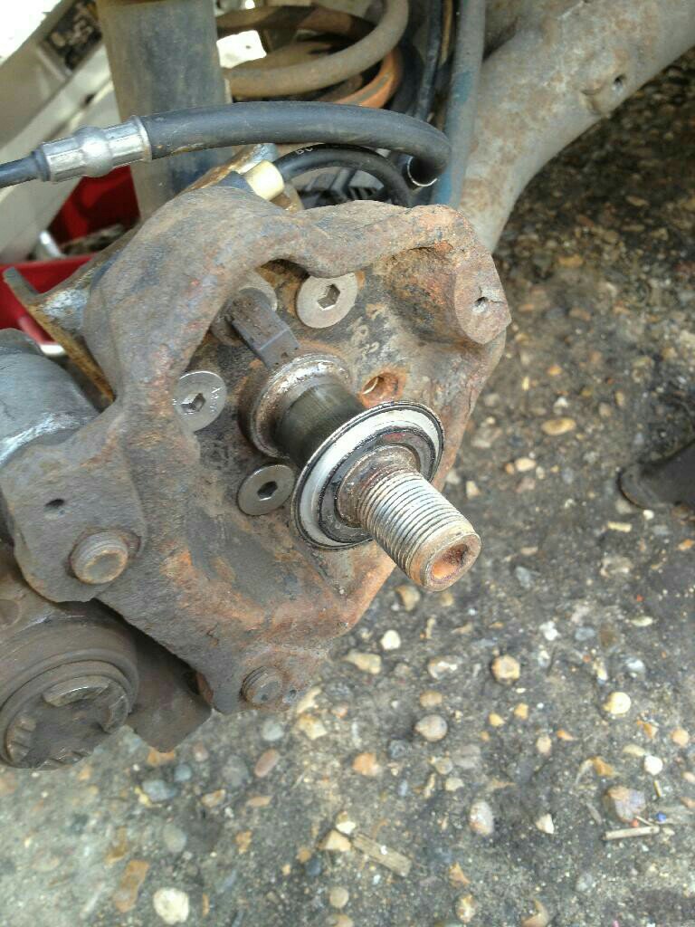

I have a question regarding the spacers which fit behind the bearing on the rear discs its an 04 clio. So I took the old discs off since the bearings where shot and bought a pack of discs with bearings included. Both sides had the spacers but the spacers flatside was facing towards the stub axle. Now last may I had a secondhand rear axle put on by guys who deal only in renaults so I wud assume then that this is correct? I also noticed in the haynes manual the flat side faces the stub axle...
But is this correct or is it actually supposed to be the other way around? Reason why I ask is because there on the car right now like that and if its wrong I would rather sort it before new bearings go bad lol
Flat side should be facing you to mate with the bearing and the curved side to follow the contour of the stub axle.
The spacer the other way round would make no sense.
  16v 1.6 Clio MK3 GT
Hmmm any pics at all bud? I dont understand how even a renault only garage could get this wrong?? I just replaced them as I saw them the same way around. I know they were the last ones to take them discs off due to the bent axle last may.
So you want the flat side facing outwards, otherwise you're putting a curved thing against a flat side of the spacer so when you torque it up the spacer could get damaged etc.
  16v 1.6 Clio MK3 GT
Ahh think im getting confused. One side of the spacer sticks out and thats the flatside?
  16v 1.6 Clio MK3 GT
Ahh yer so i did get it right. Lmao. Was confused to hell. Yep torque'd to 175 as well. Tah lads
