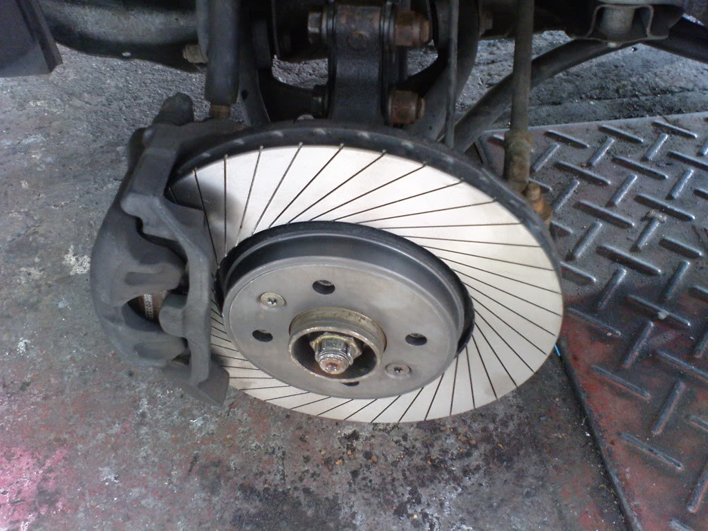

...... Finally I have new discs (82quid a set from Dave), new pads, 30mm socket... so I recon I'm ready to goto work this evening...... one last question..... (well two) I always clean the discs with petrol.... not brake or carb cleaner (any comments welcome) and I've never messed about with checking the disc alignment.... most online guides don't even mention this but some do and then say it's critical... which approach is right ????
Personally I just attack the bare hub with a wire brush on a drill until it's shinny clean and then bolt on the new disc... is that so risky ???

I've got the brake pads & calipre off without any real issues.... and the 30mm hub/bearing/disc nut is off too..... the disc wobbles making me think that the bearing is knackered but the disc aint coming off..... I've tried leaving with a 2ft tyre lever and a 4lb builders hammer but it's not moving..... any help/advice would be very much appreciated ??:eek:

PANIC over ..... at least on the drivers side;) ..... the time it took me to make the posting allowed the WD40 to do it's work and a subsequent clout with the hammer got it moving..... so old off and new one on ..... I'll do the other side tomorrow... but have already got the WD40 working:cool:.
I noticed that there is a 'key' on the back of the brake pads that NEEDS to be slotted into the brake piston head... never seen that before!
A trick for pushing the piston back in..... when the disc is off (assumes you replacing them!) you can get a tyre lever behind the disc calipre plate to apply leverage to the piston... at the same time, a thin screwdriver can be placed right across the piston head (in the key) and use the screwdriver to turn the piston at the same time as pushing on the tyre lever ..... it worked nicely for me anyway.....:rolleyes:
Answering my own question concerning disc alignment....... in this case, since the discs include the wheel bearings there is nothing you can do to adjust the alignment anyway...... except remove them and reassemble and hope you get a better fit..... So I conclude that it is not something to loose sleep over....:sleepy:
