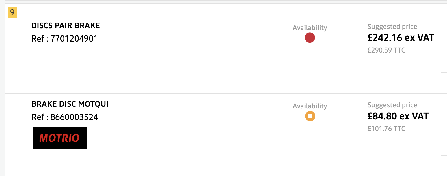

Or you could buy the Motrio rear discs and pads which are still genuine Renault.
Used and suppled for cars that are 10+ years old.

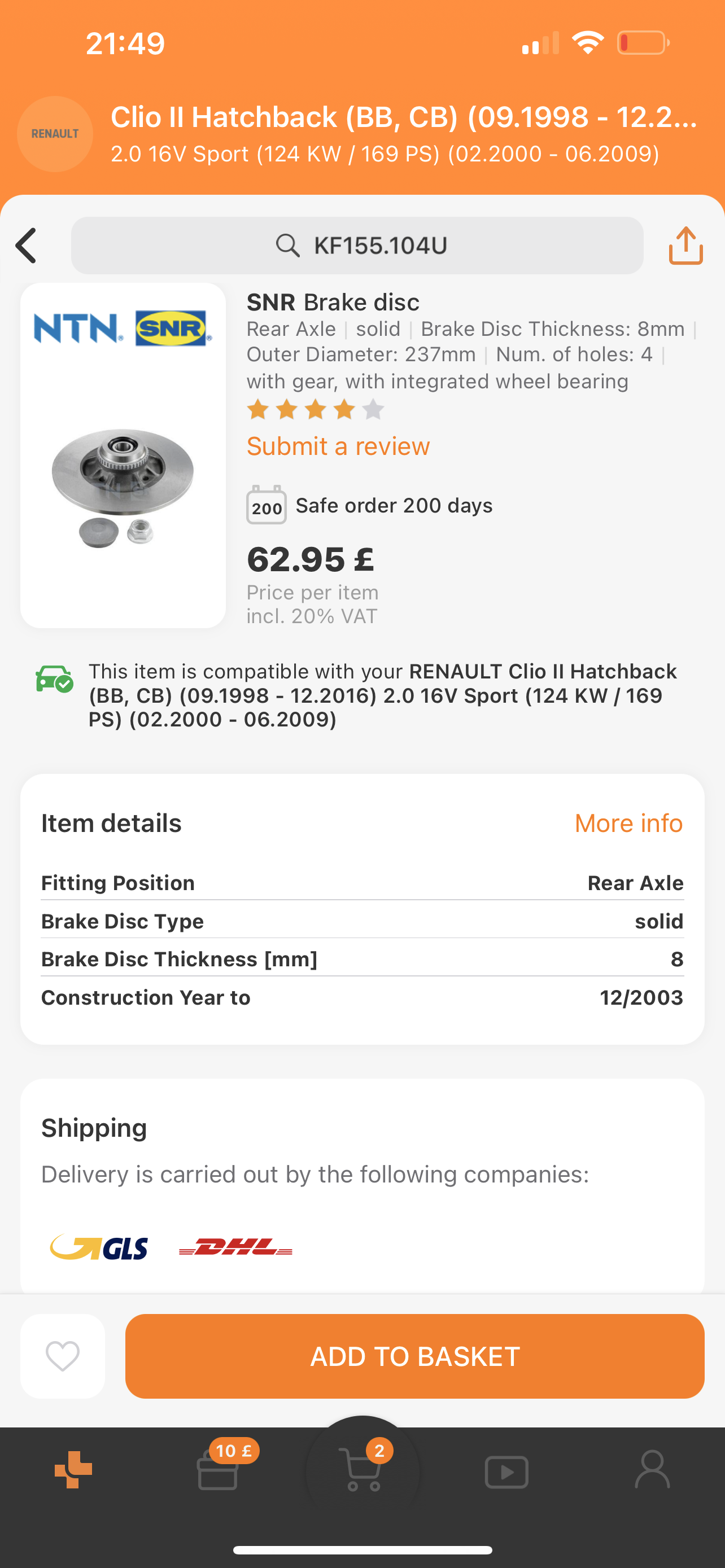

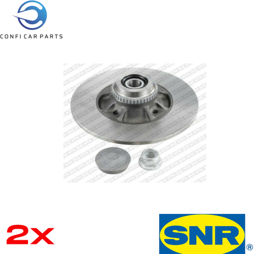

Just buy SNR ones

As long as it has the SNR bearing you are will be fine, Renault have used SNR bearings for years on there cars and come standard from factory stamped with SNR
