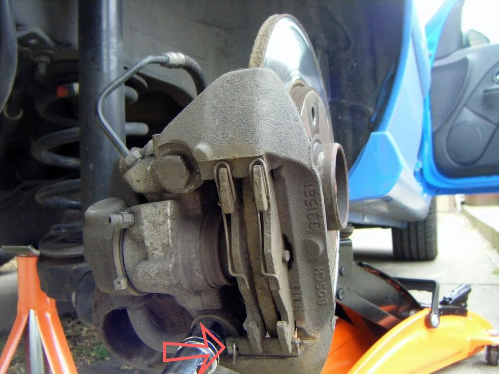

Yep another brake question... Also changed the rear discs and pads. Managed to loose one of the four springs on the back of the rear pads... Are they actually necessary? If so, does anyone have a picture of how the sit in place as Im still scratching my head trying to get the three remaining ones back in place...

the springs stop the pads moving around in the carrier, i would fit them.
if you still need to know how the springs sit, i can take a picture tomorrow morning
springs are a must!! heres a pic courtesy of jonny 1*2
