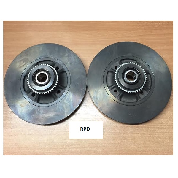

The problem is that the cheaper discs quite often have s**t bearings in them that don't last very long at all so you end up doing the job twice.
Genuine discs come with SNR or SKF bearings in them so if you're trying to go down the cheaper route, try to find discs that use those brands of bearings
