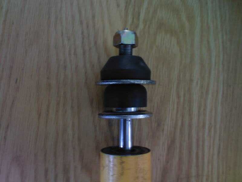

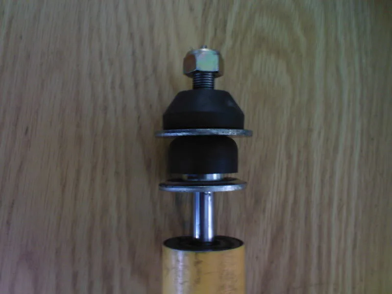

The hole is larger on the Koni ones and also they are like rubber bungs. When you screw on the nut, the rubber compresses and fills the gap in the top mount so that its a very secure fit.
Well the top one is very similar to the renault one but looking on dialogys you can't buy them seperately. So i'd try one off your original rear dampers.
