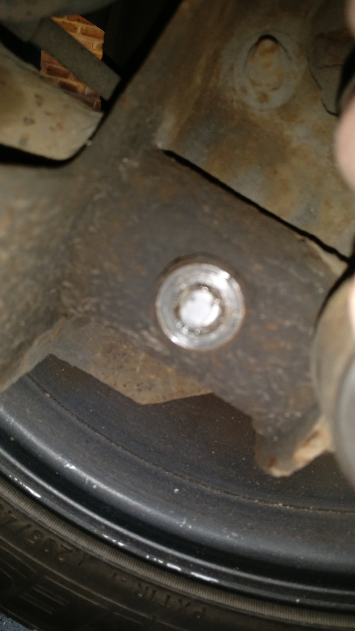

Changed my exhaust quite the fiddle. Everything went well. Removed the shock bolts to lower the axel so I could get the old exhaust out. All back together.
Just to put the shock bolts back.
Greaaaaat. I've not managed to move it. Seems pretty stuck in there. I've soaked it with Wd40 give it a bash tomorrow.
But where do I get a new bolt from is my question?
I'm guessing I'm not the first to snap these damn soft breadstick bolts. Where can I get a new one? Cheers

It wasn't that tight. It just went. Was doing it up with a hand torq wrench. And not even fully in lifted it up and snapped. Was shocked to say the least. Cheers. That be appreciated.

Drill it out, you should find when you get close to the bolt diameter the drill bit will pick up on it and spin it out for you.
If anyone tells you to usr an easy out tell them where to stick it ?
I had the same situation at the same point roughly putting the bolt back in when I changed my rear springs on my old 172. Renault didn’t stock it but I managed to get a bolt from a local little nut and bolt shop which apparently was stronger. Had to get someone to drill it out for me because I failed though.
Can you not get mole grips on it from the inside?
Gonna give it ago today. I've soaked it in wd40 over night and I've got some long nose mole grips in gonna try move it. Normally snapped bolts move with a hammer and screwdriver, like my snapped wheel bolts from jerks-r-us who do them up way to tight. Will give it a go if not might get someone to give me a hand. If they have any drill out stuff.

I've got a drill. Can't move it at all atm. I've got some new bolts though at least. Hoping to get a mate to help me get them out. Sucks I can't move the bolt atm :/

I'll give it a go today. I always use a jack to align the beam with shock. It went in smoothly by hand. I just don't get my it snapped, just the last few turns with a torq and it went. Proper anoying.
Hoping a mechanic mate can pop round he's got colbolt bits. Or I heat it up and wind it out with a drill extractor. I'm not wanting a new rear beam.
That should drill out a doddle with good drill bits. Cutting fluid and patience required, dont bother with the easi out shite, when they snap your in a whole world of pain.

Slow speed more pressure rather than high speed and light pressure or else you'll burn the bit out. Always works for me.
Cheers lads forgot to say its out. I got drill bits but my old drill gave up the ghost before I got anywhere. So got a good mech mate to pop round drill, then smacked a hex bit with a socket attachment in and wound it out.
I picked up a set of 25 bolts from screwfix (couldn't just buy one ?) but only £15 so not to bad. High tensile M12 x 1.5 think it was 180mm long with a solid section at the head of the bolt before the thread and shuved a washer on it fits better than the standards. Tempted to change the other one over.

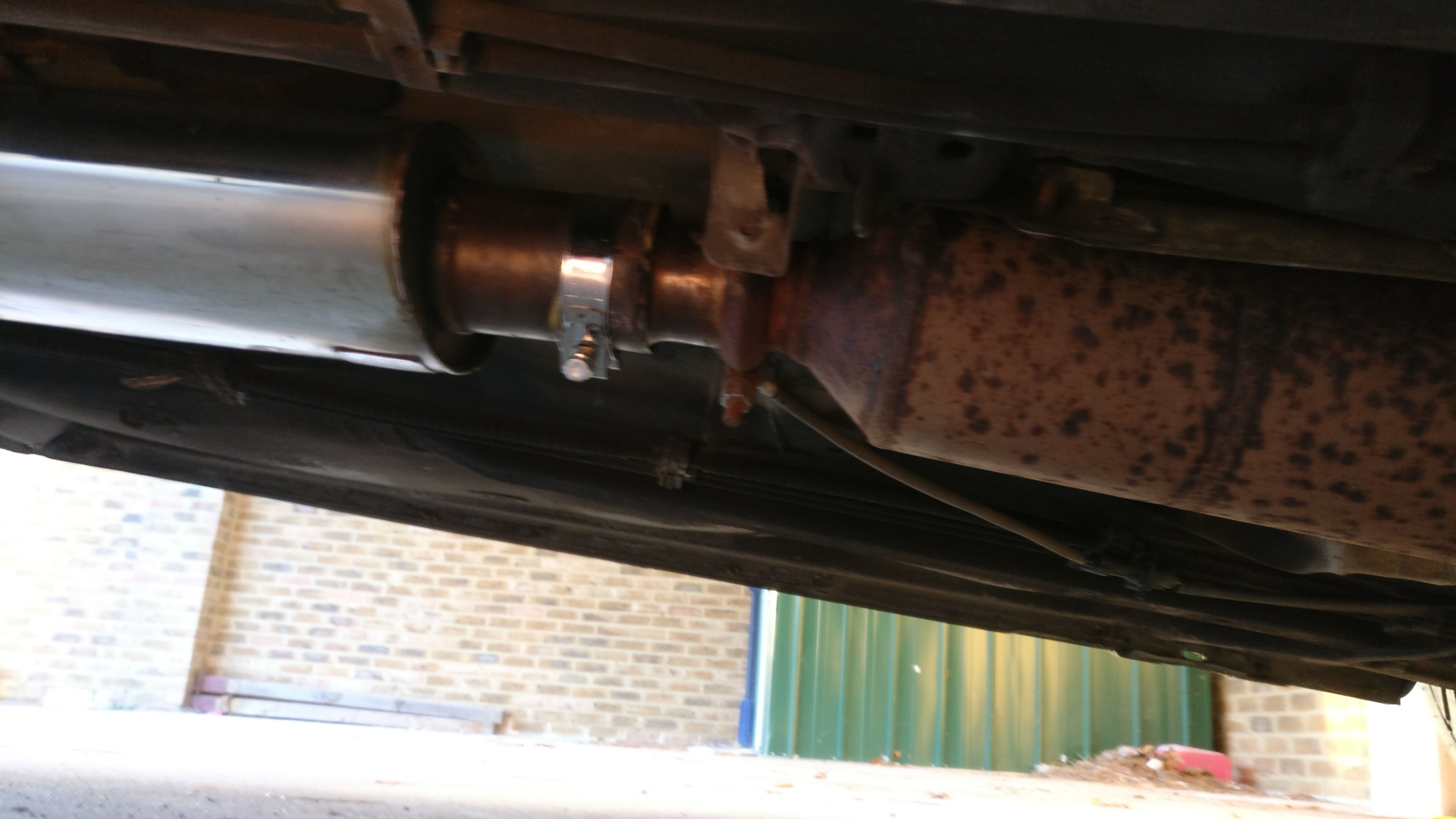

Cars back in one peace. But one of the exhaust clamps doesn't hold tight. So I've got a ricer fart atm.
