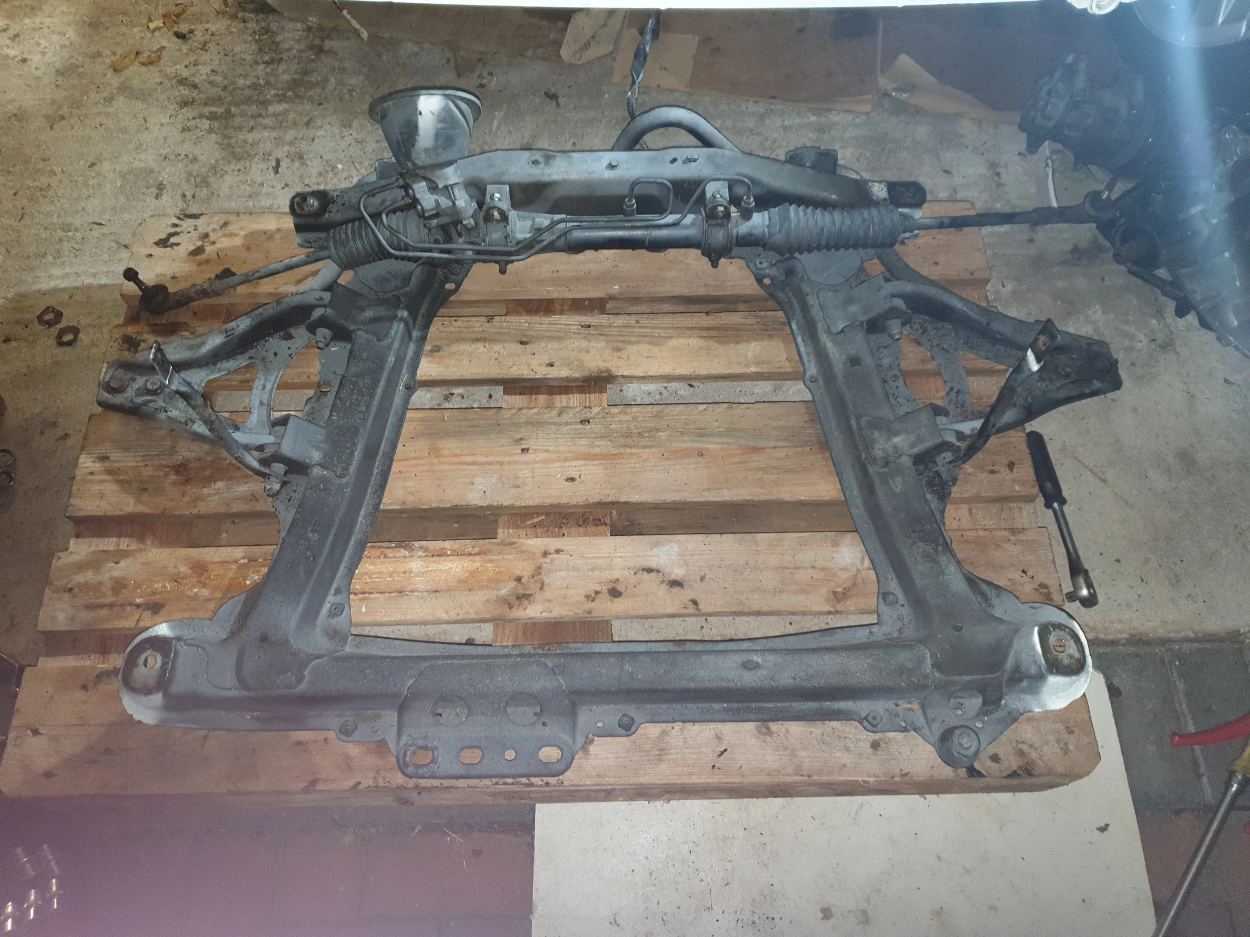

Rear subframe bolt captive nuts
Car  clio 172
Are the rears the same as the front in respect that there is a cage which will require removing in order to get a spanner located on top ?
The fronts were a pain and i will be planning to fit locknuts when i refit
I couldnt remember from my 172 , i think i got lucky on the rears coming loose as i must have soaked them week before ! Stupid those cages , takes more time getting them off !
Yeh the rears are a pain In the arse, once you've got the cage off, it's a bit of a pain in the arse but you can just about get an open ended spanner In there at a funny angle
I got a stubby spanner on the rear and used extension bar to lock spanner in place. A it of plus gas and they came off a treat
