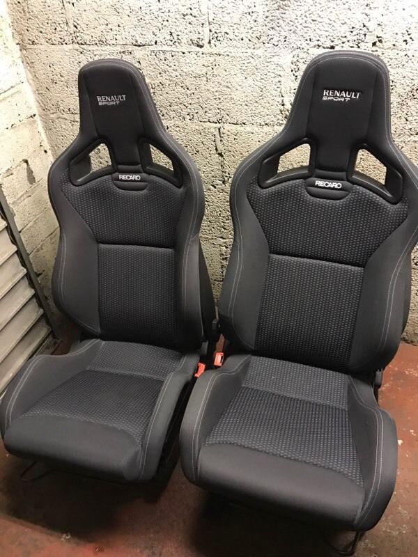

Over the past few years I've been asked quite a few times about fitting the Recaro CS seats found in the 197/200 into Clio MK2.
Up until recently I'd never seen a set removed from a car to really understand in detail what kind of job it is.
I've now got a set of 197 runners and subframe assemblies that are used with the CS seats.
I've had a quick look and I'm pretty confident that I can produce a kit which would enable fitment straight onto your existing Clio MK2 runners.
This will be a total replacement assembly.
I won't be chopping up existing ones as they are a complex unit.
I will be reducing the height from the 197 as people's opinions have always been that they are far too tall in the car.
To be able to offer the Lowered seating position,I think the "one touch"slide function,that comes when you pull the tilt lever to the rear of the seat would need to be deleted.More time on design will determine this.
Im interested in hearing any comments or ideas from members on this idea.
Once Ive got prototypes in hand I'd be looking for a MK2 who has a set of CS to test fit etc.
Jon

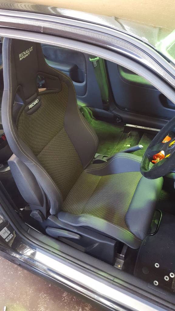

Meg 3 seats into a 172. Don't underestimate how much height needs to come out. These were done with aftermarket sliders and bespoke mounts.

Thanks.I understand they sit pretty high.
Mine are going to utilise standard Clio runners.
Did you go for the lowest you could go ?

Took the height adjustment out and made mounting points. If you removed the plastic skirt they could possibly go a little lower. Look forward to seeing how it goes.
