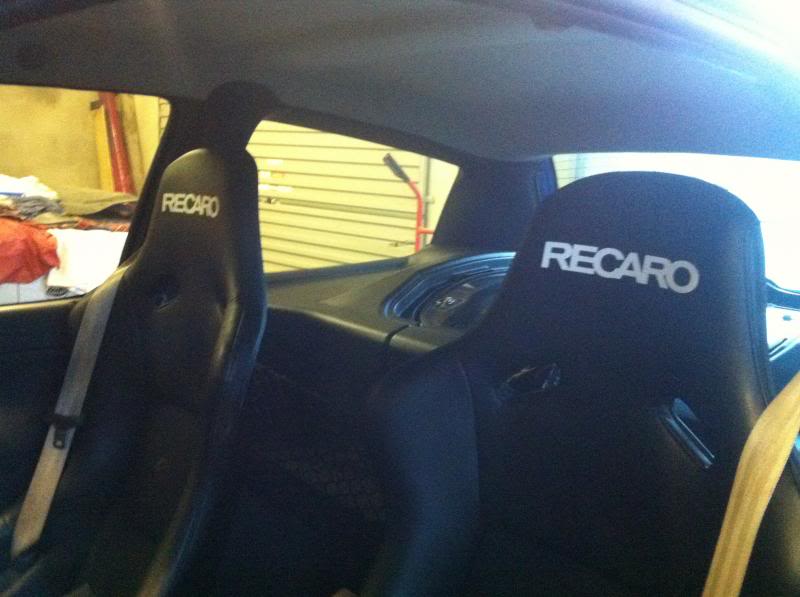

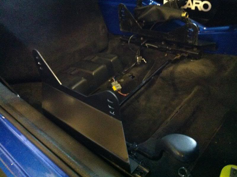

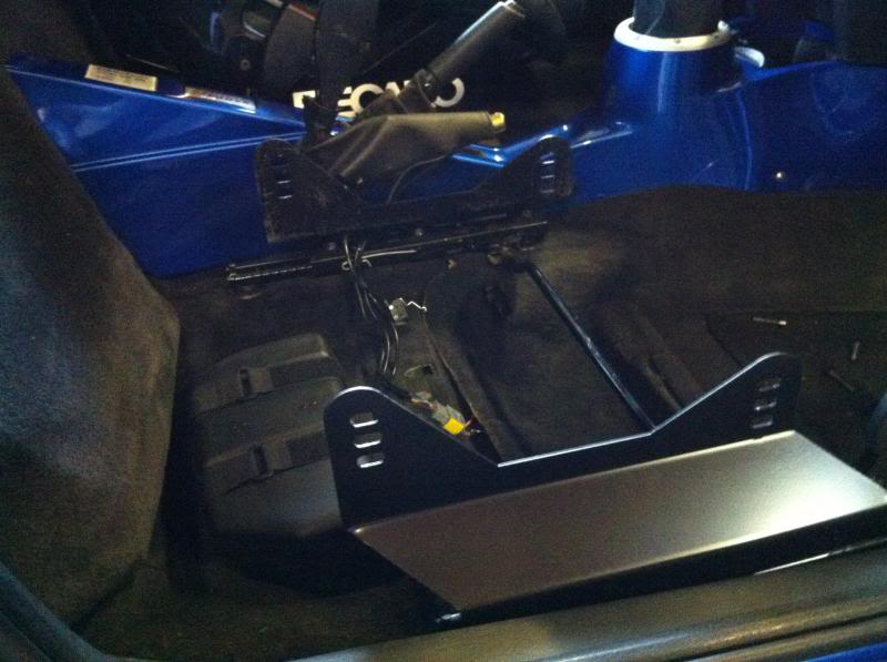

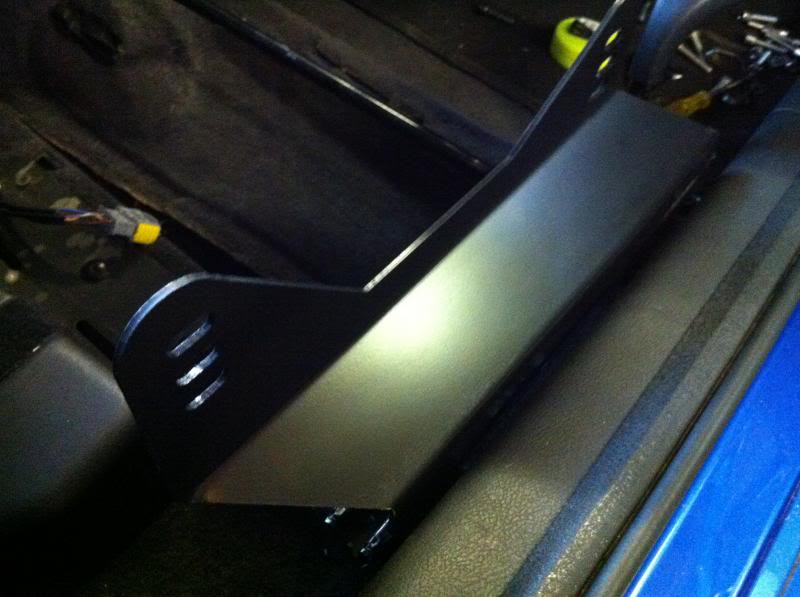

Here are a few pictures of the brackets before the seat was fitted.

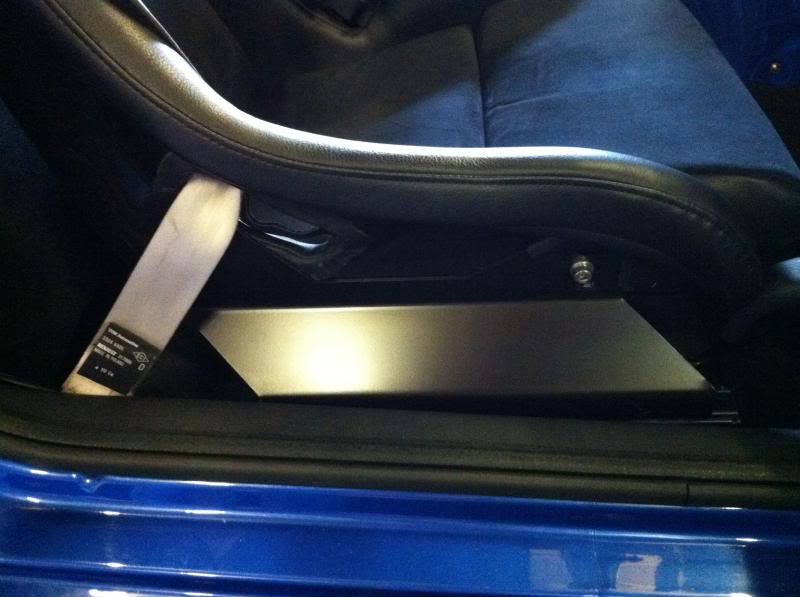

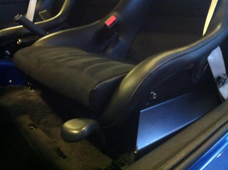

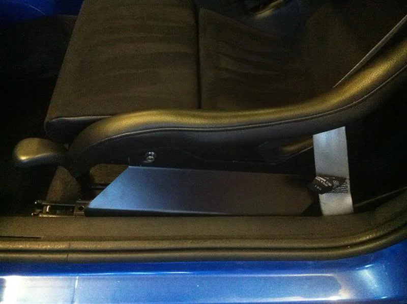

I also tried to take a shot of the difference in height between the original recaro side mount brackets and the custom made brackets with the seat fitted.

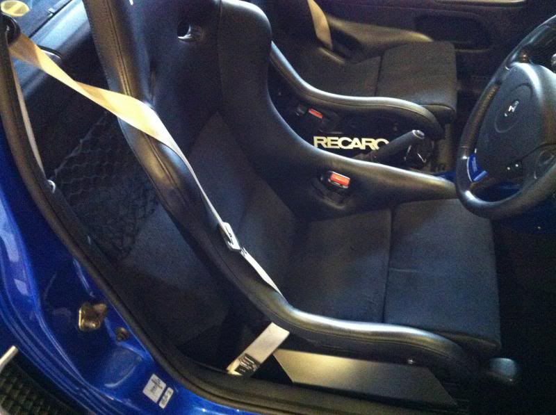

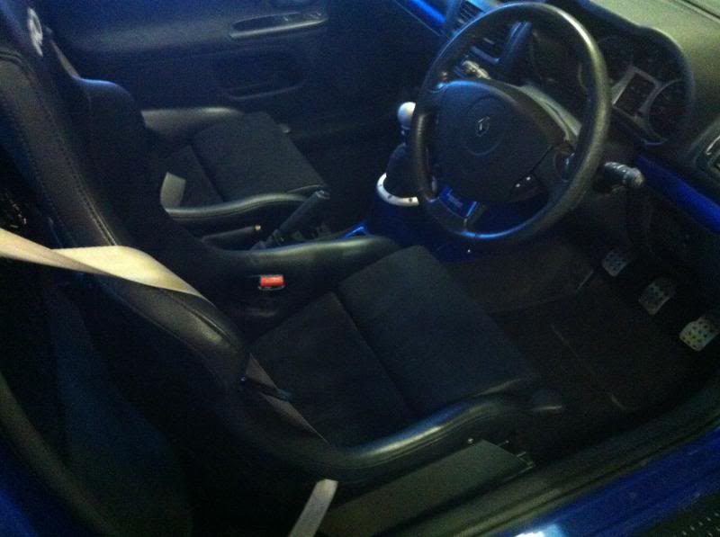

This is what they look like with the seat fitted.

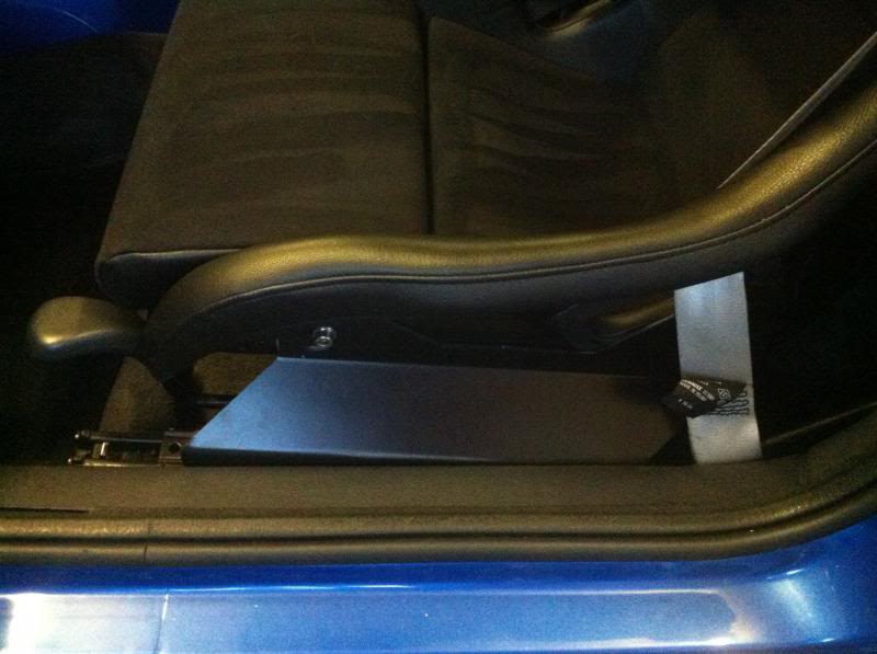

Passenger brackets also fitted.
They now sit a lot lower than the standard brackets, much more head room.
Overall this is one of the best modifications which i have done to the vee. The Pole Position seats really are fantastic but i have not got the best out of them until i lowered them.
Any of you who have the Pole Positions on standard brackets will know how high you sit on the standard brackets.
Using these custom made brackets i have lowered the seat around 5'' i could go another 1'' lower although i would have to adapt the handle which you slide the seats with.
