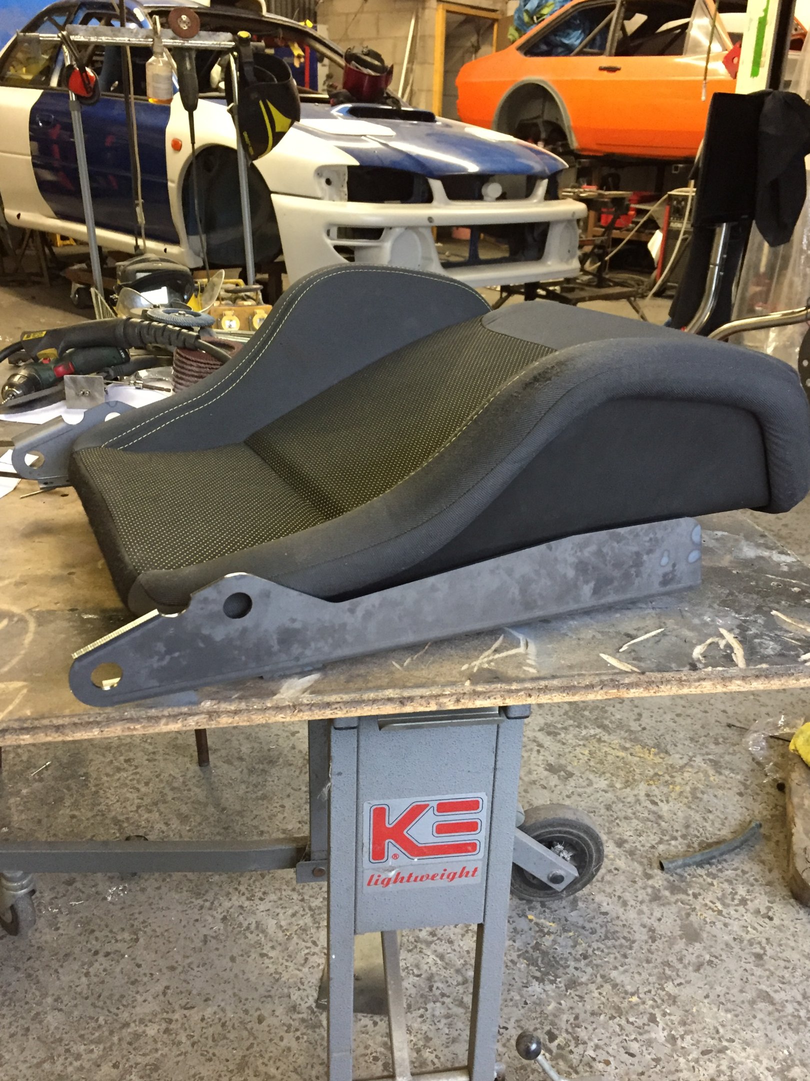

I sure am Gus.
I've just had my first prototype back yesterday.
I'm welding it up on the jig tomorrow and will be checking it over.
I'm thinking that the Meg CS seats have the same fixings on the base once the existing subframe assembly is removed.
If you want to send me your email address I can show you how my set up will work.
Jon
Mine came direct from Recaro so have completely different way of mounting. Mine use another subframe bolted direct to the underside of the seat.
@JON FOZ was developing some
I sure am Gus.
Jon

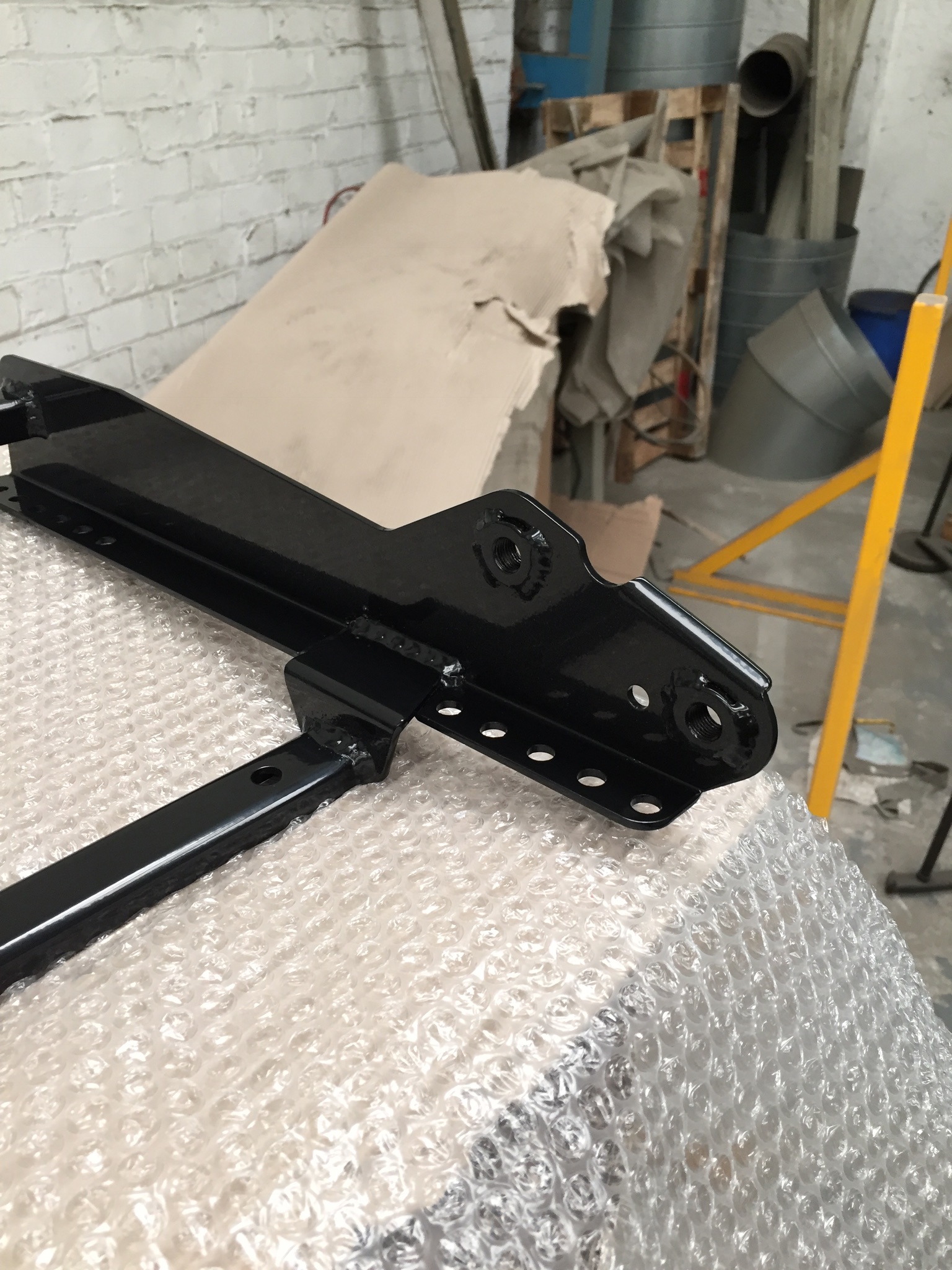

Thanks so much for pointing us in the right direction guys!

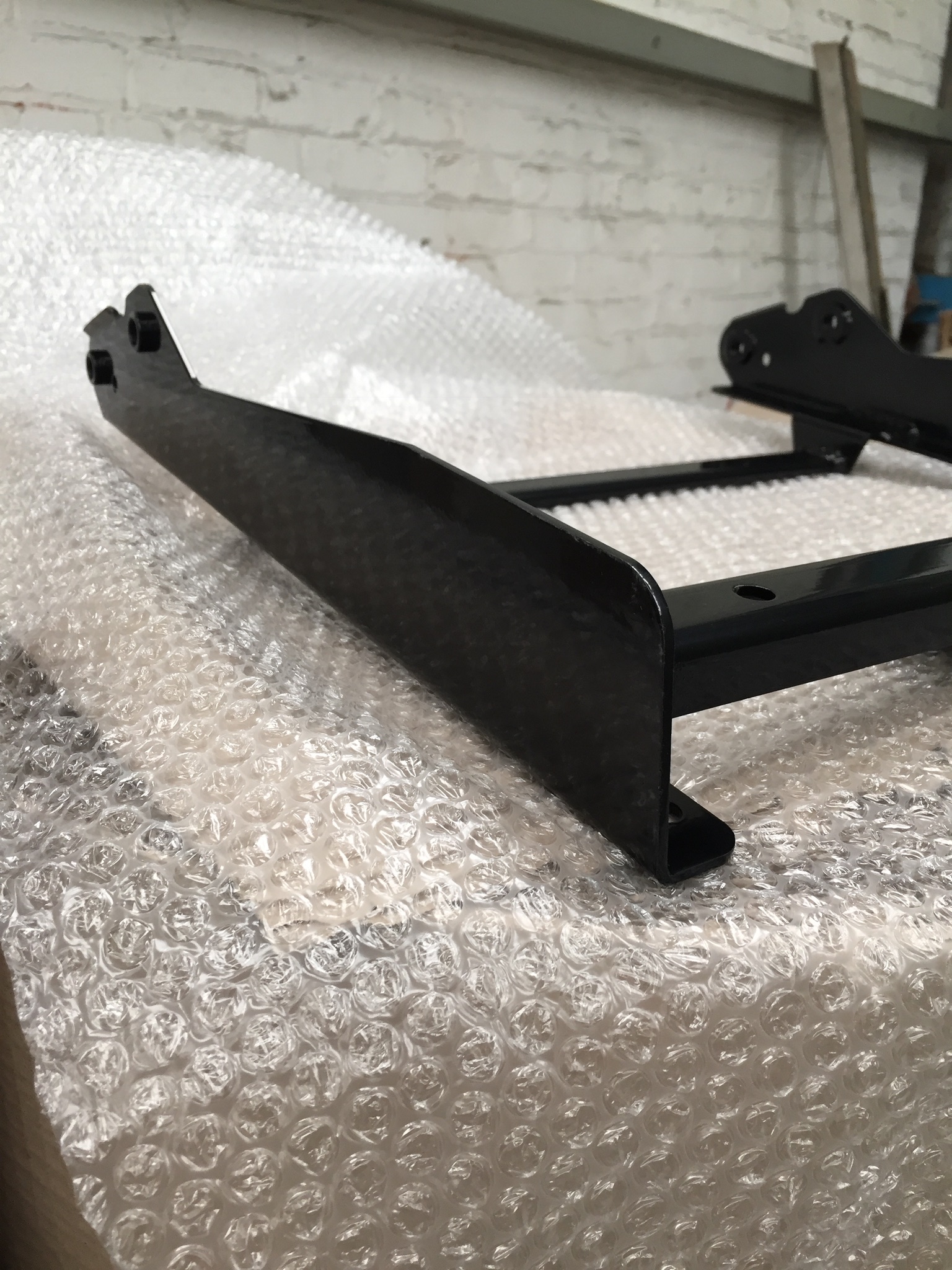

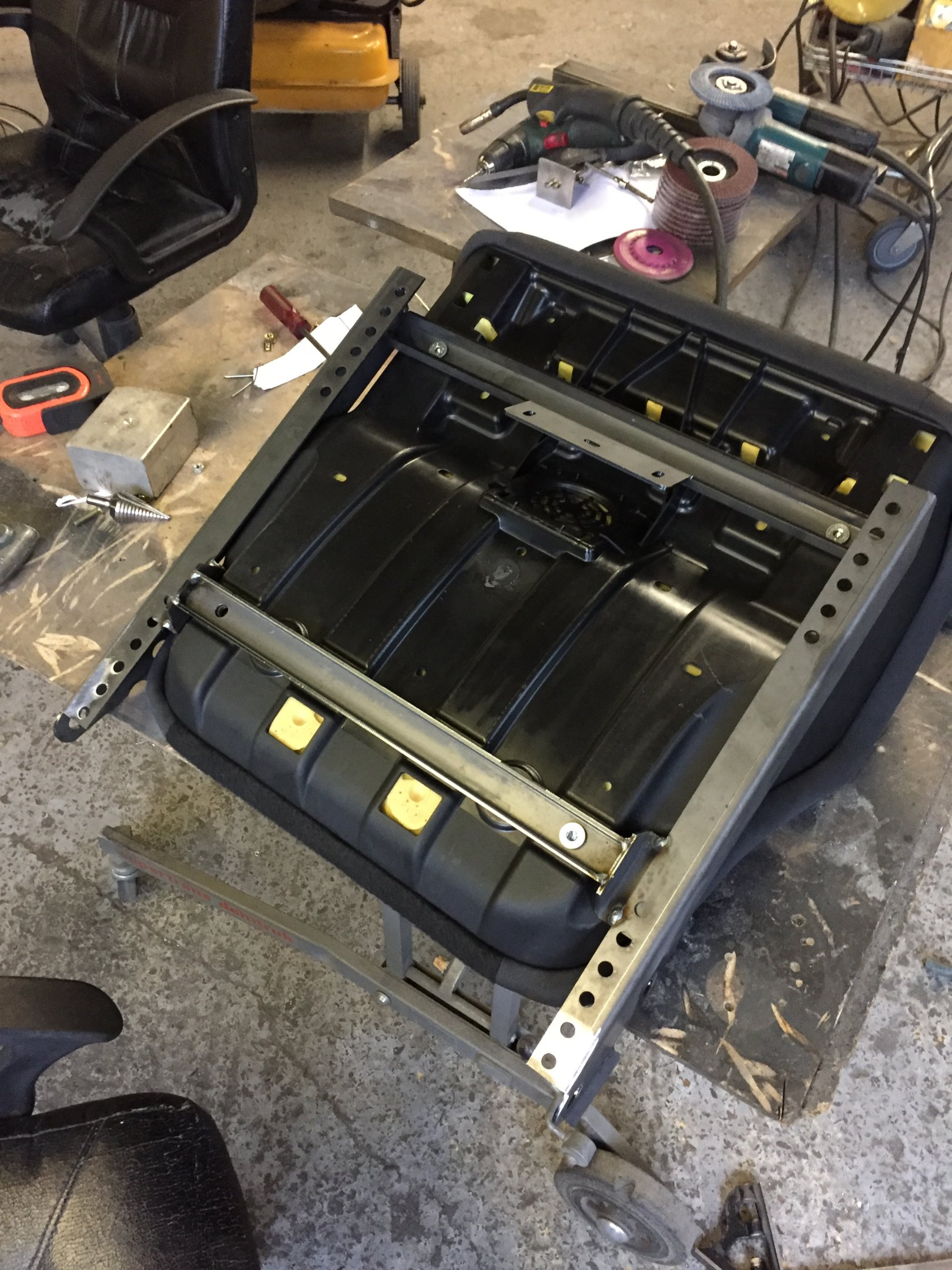

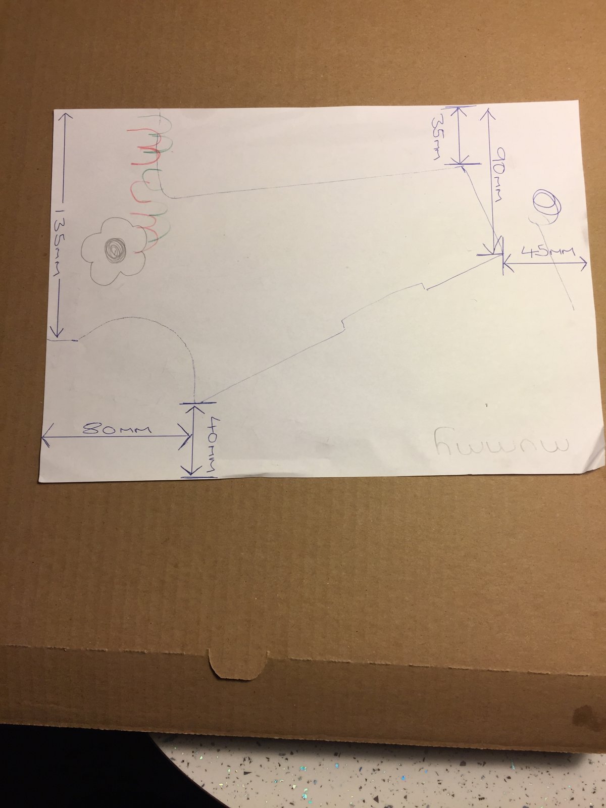

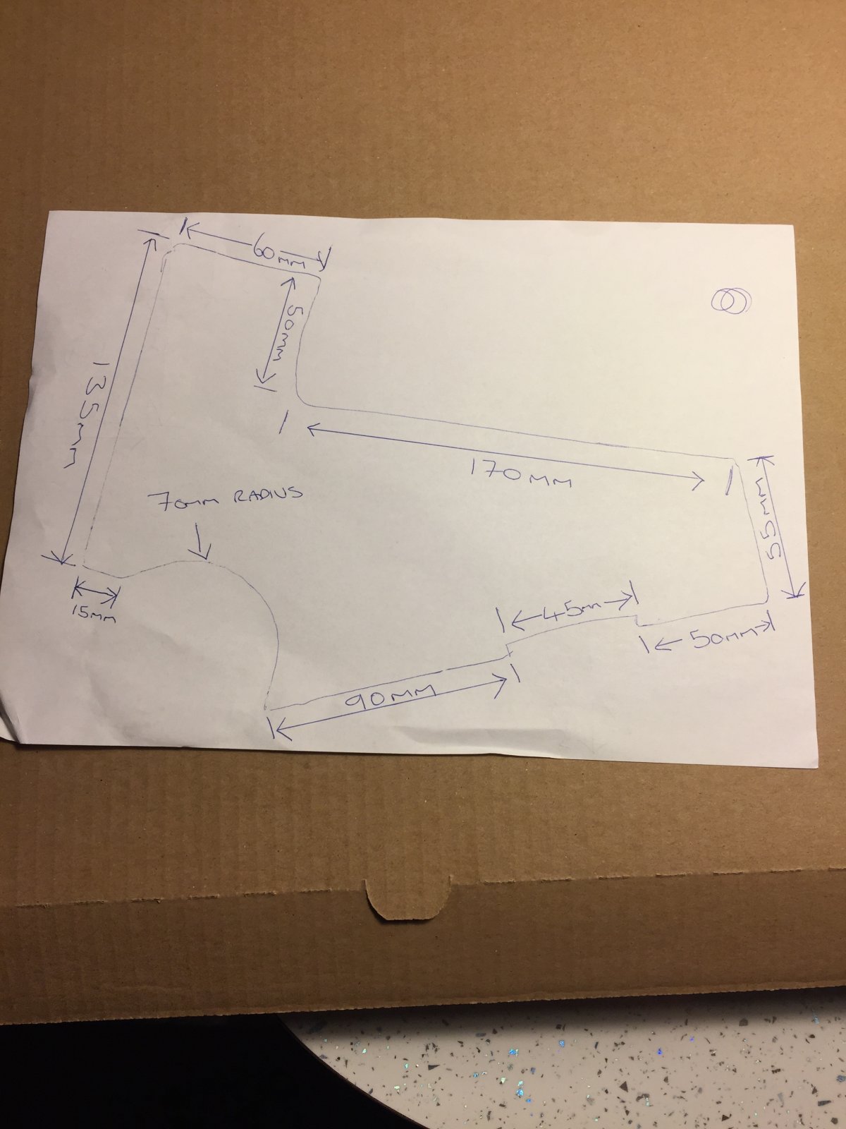

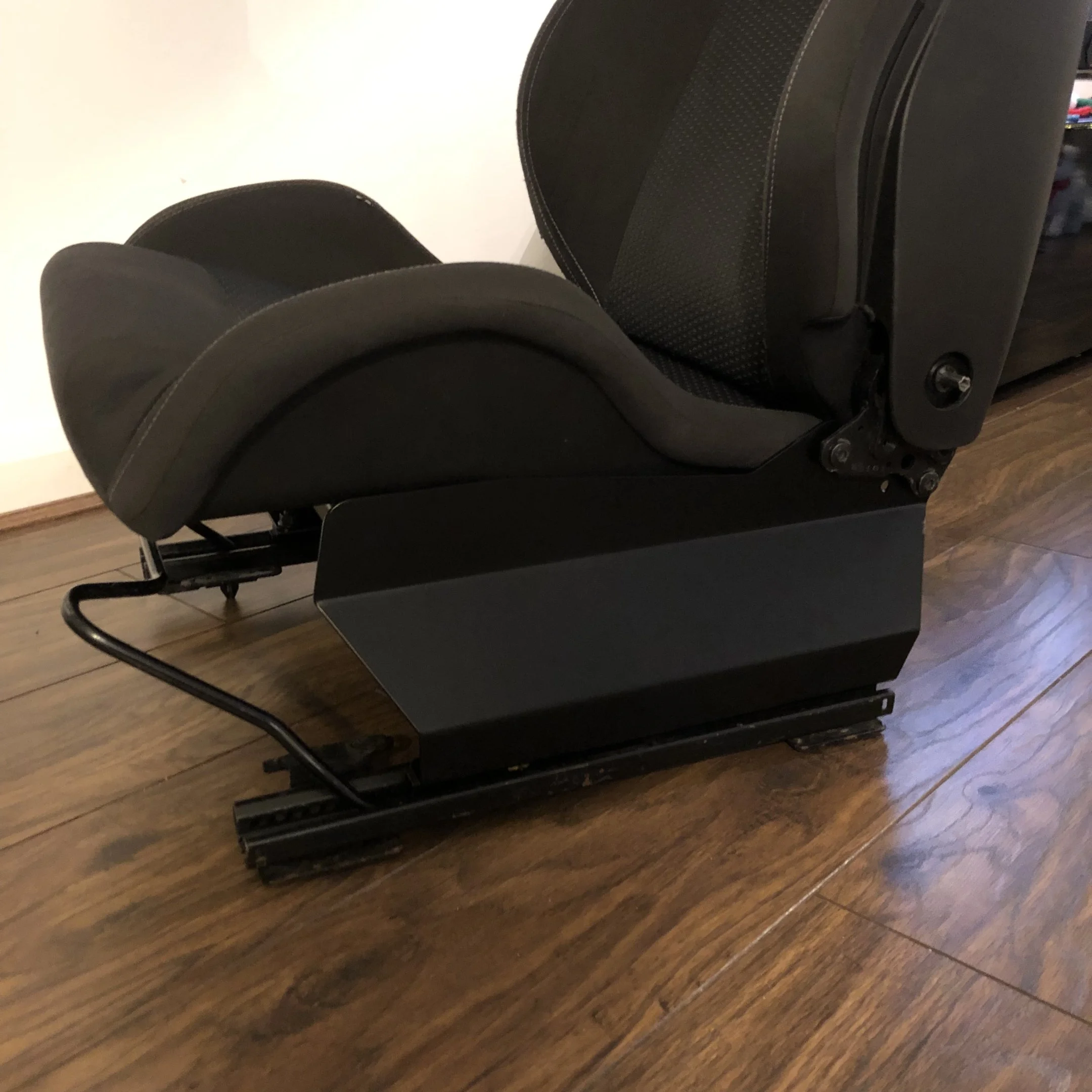

I've tacked up my first prototype Recaro CS seat base frame today.
This is required when fitting the CS seats from a 197 etc.
The complete subframe assembly has to be removed from the 197 seats and replaced with this frame.
My VBD Clio Recaro adaptors will then bolt to this frame and onto your existing Clio runners.
I'm machining 4 steel bosses tomorrow which will be welded in.
These bolt the back rest part of the seat to the base.

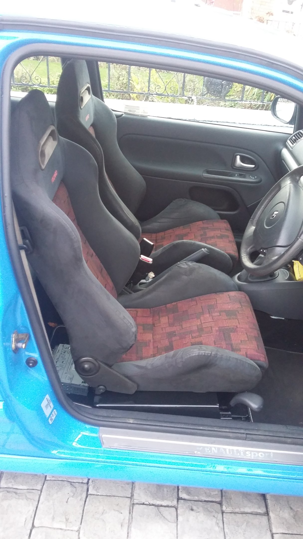

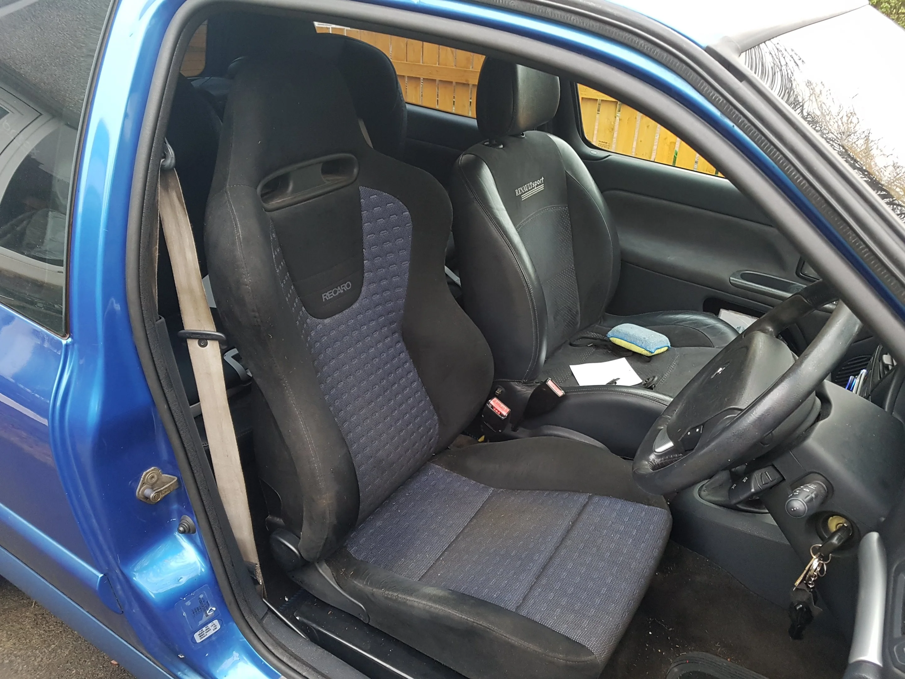

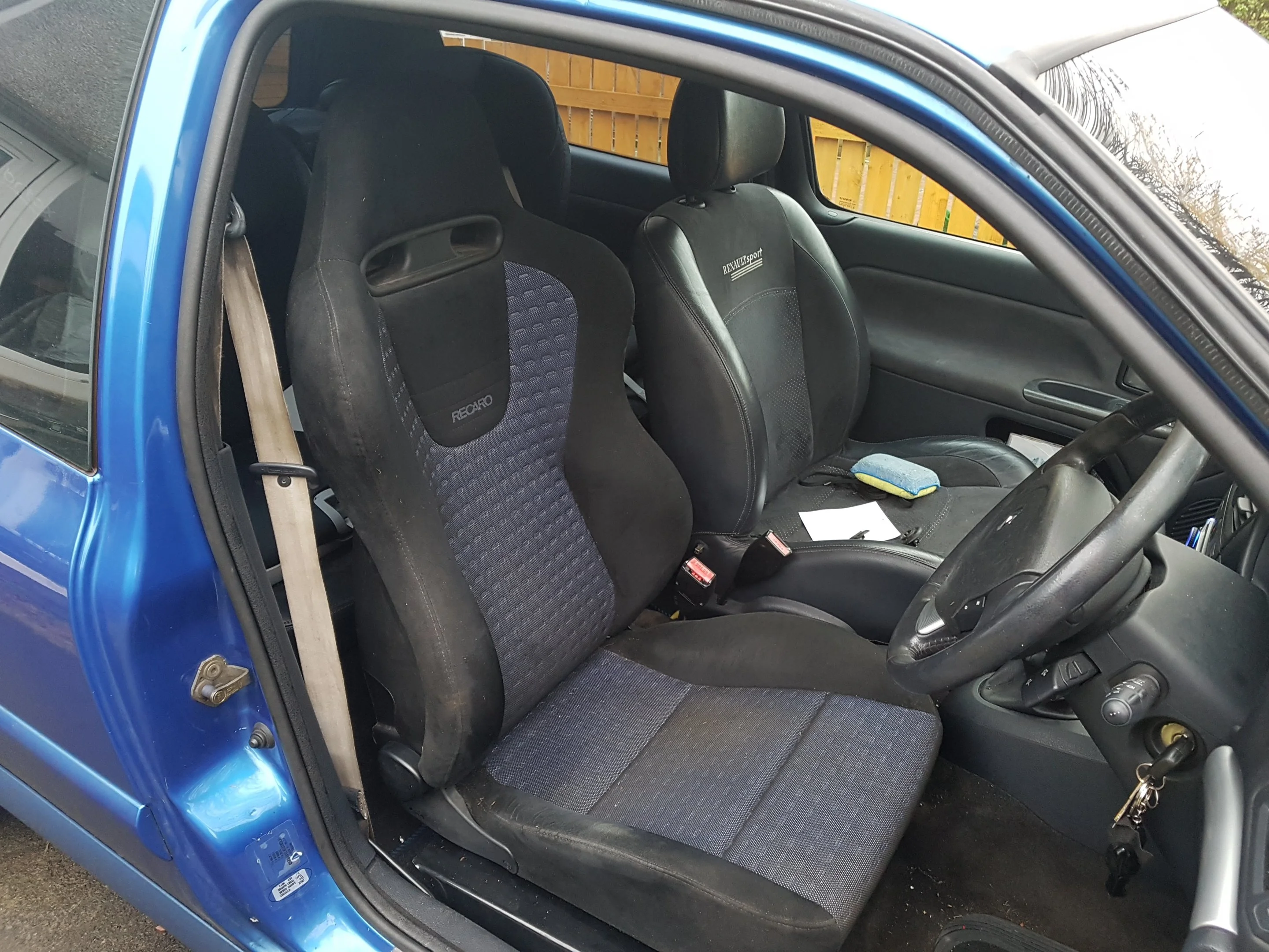

First one in today. Evo 8 seats. Turned into a bit of a bugger with the 8mm Allen bolts rounding off. Also a bit lopsided so the grinder might need to come out to get it sitting a bit lower without so many levelling washers! Still, it's lower and a lot comfier!

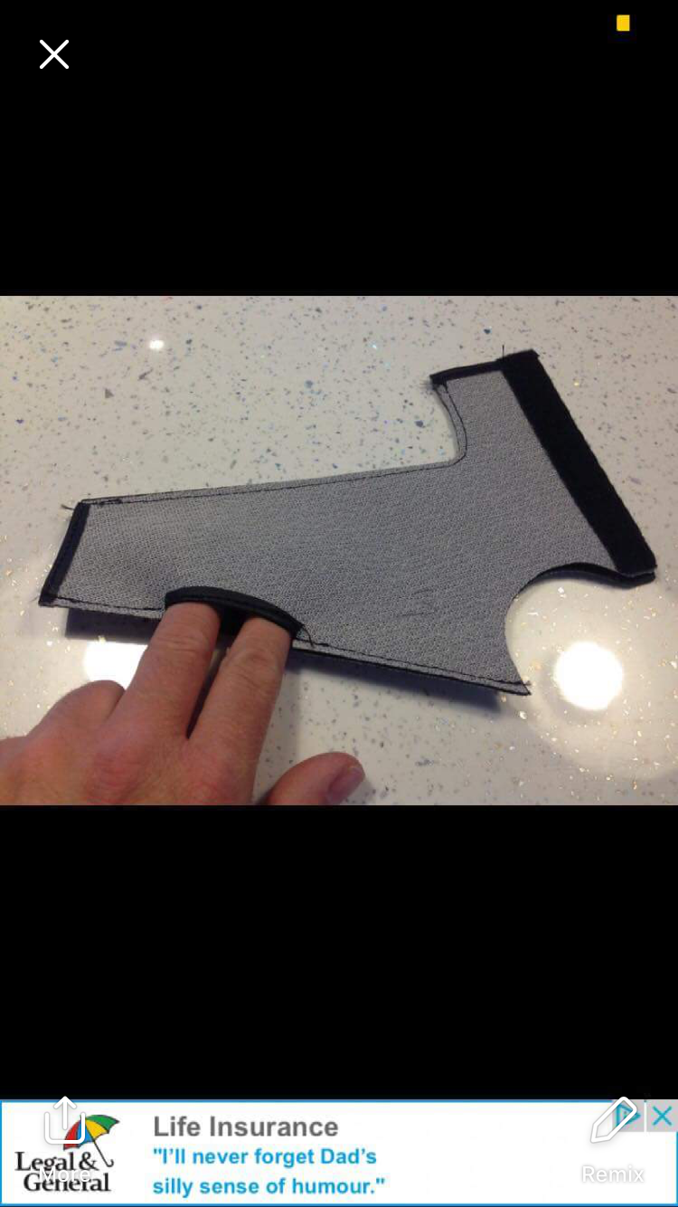

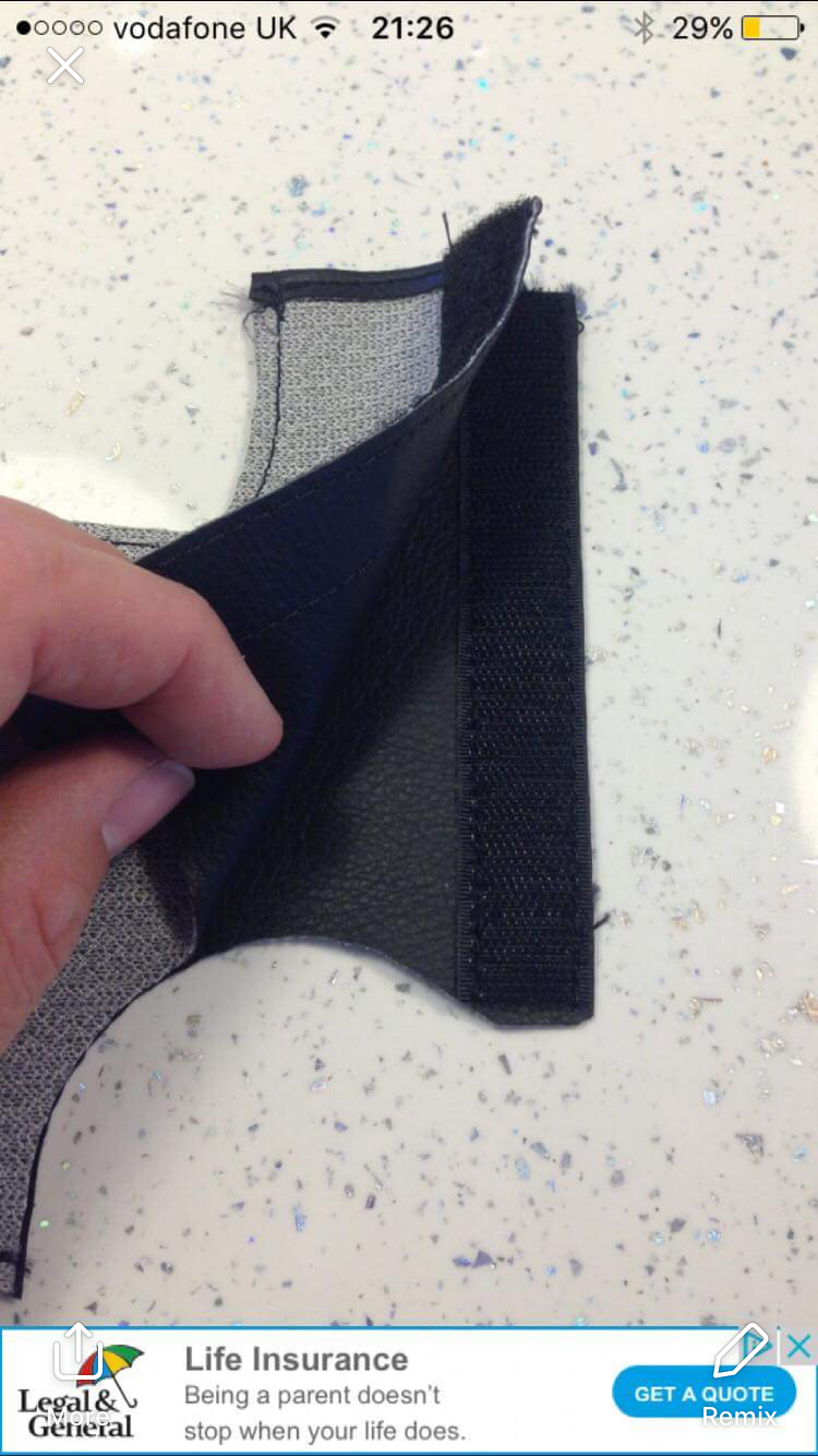

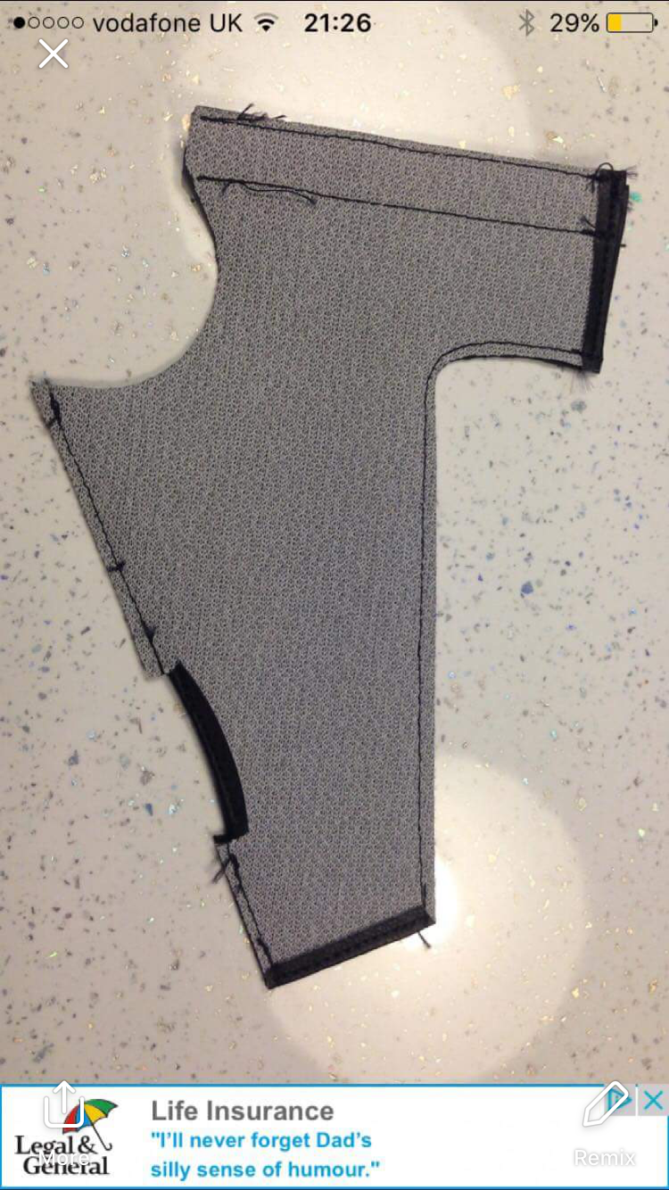

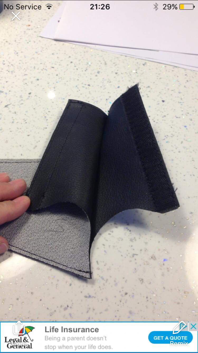

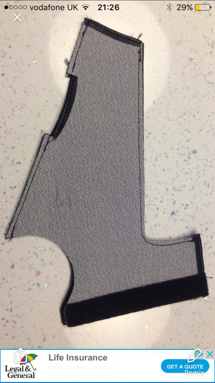

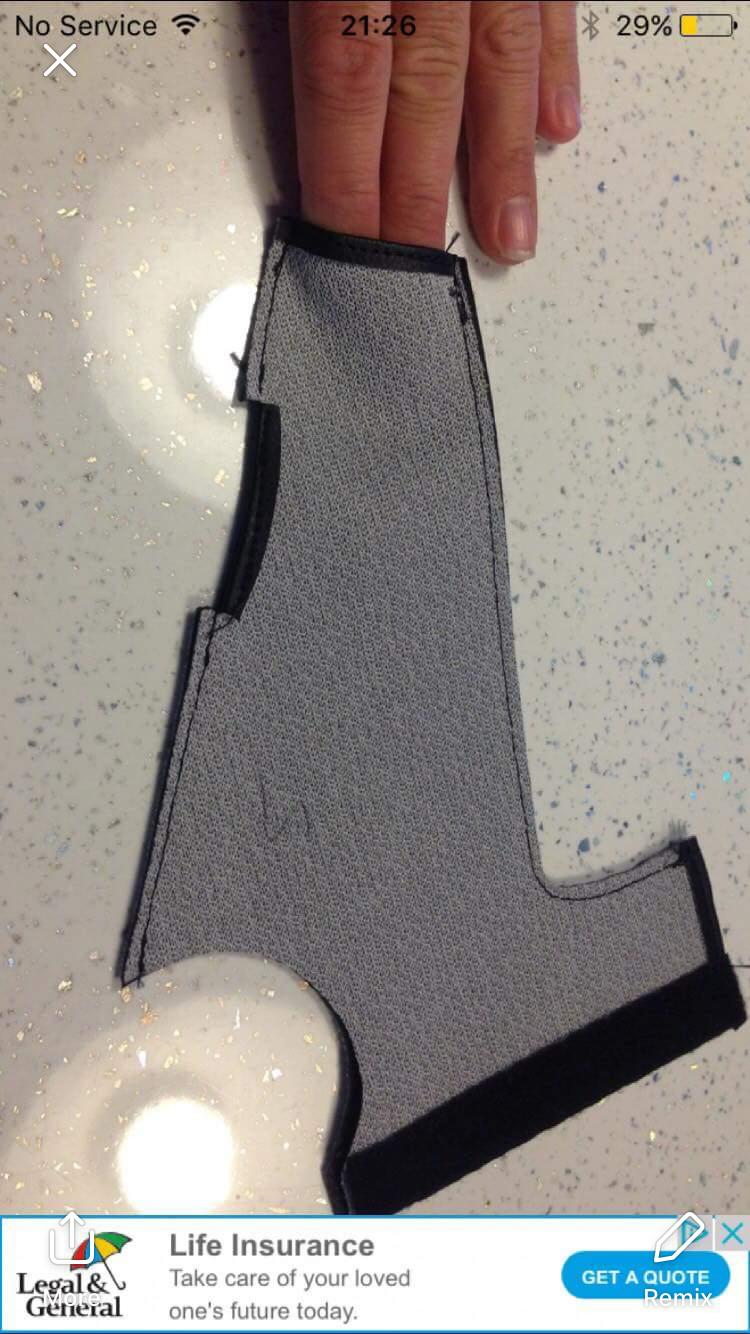

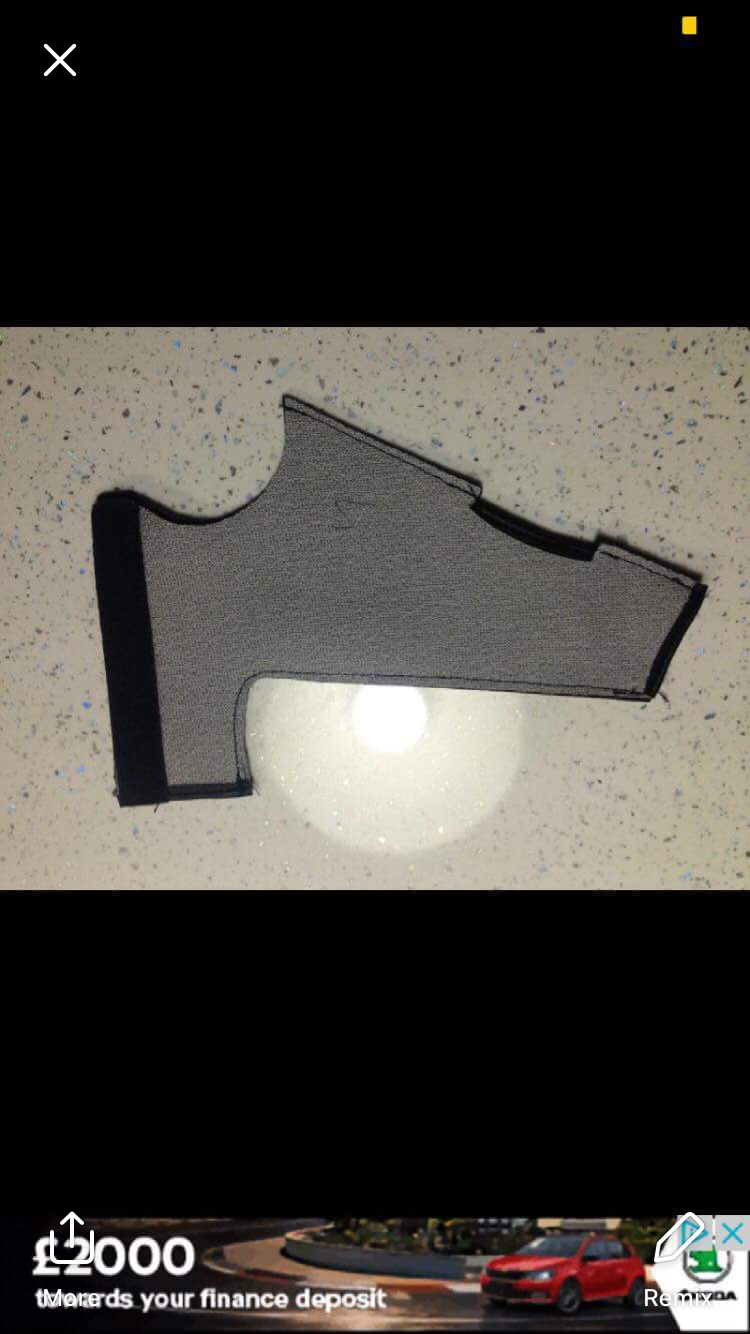

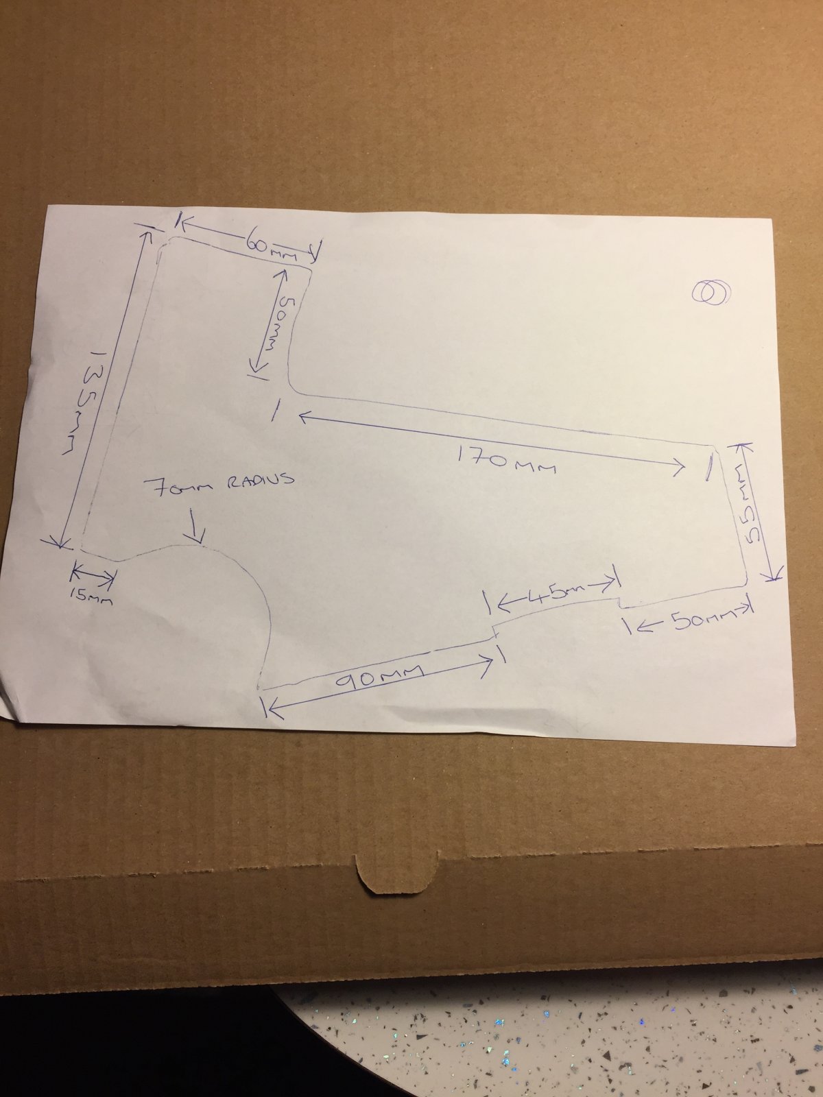

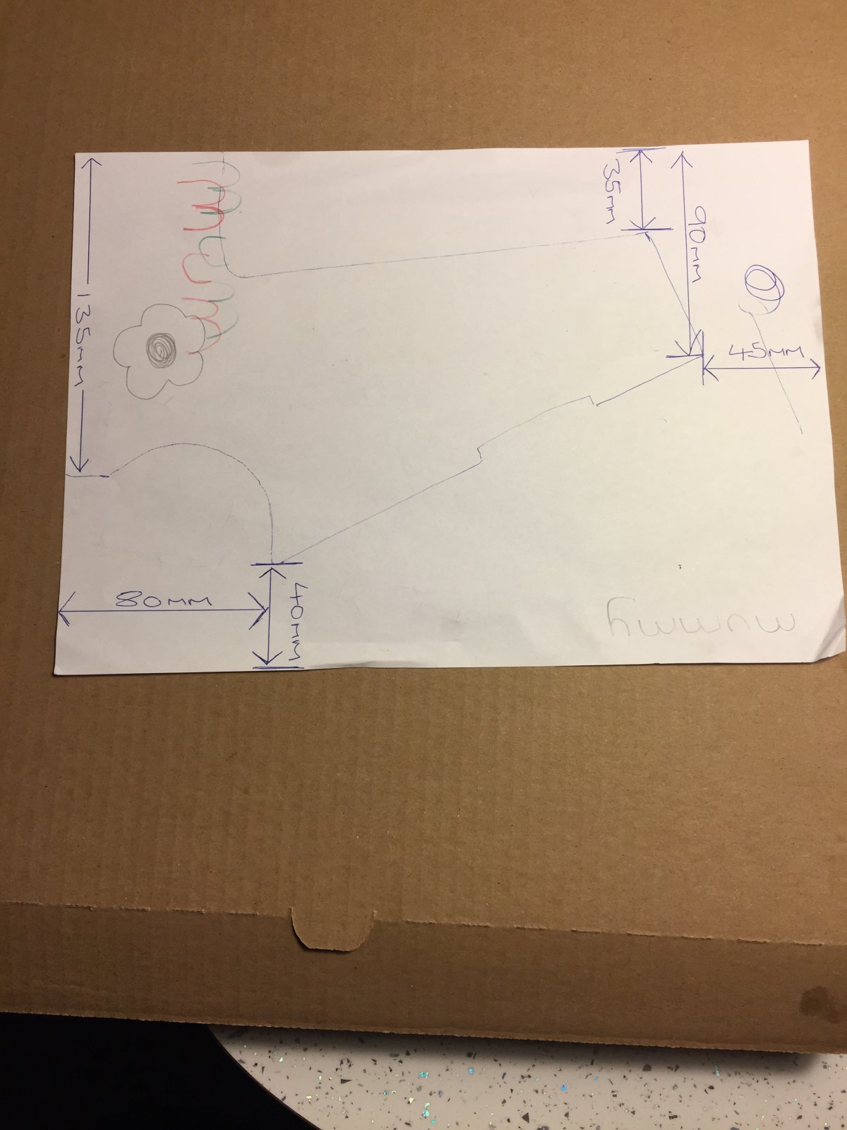

Jon- what material would the cover be made of- metal?
Do you have any pics of a finished one at all?
Ta.
Not sure what happened there..
Ta.
The pre tensioner covers can be made of any material you choose.
Alcantara looks really good,black vinyl is a safe option too.
Will see if still got pics if a standard one to share.
Cheers

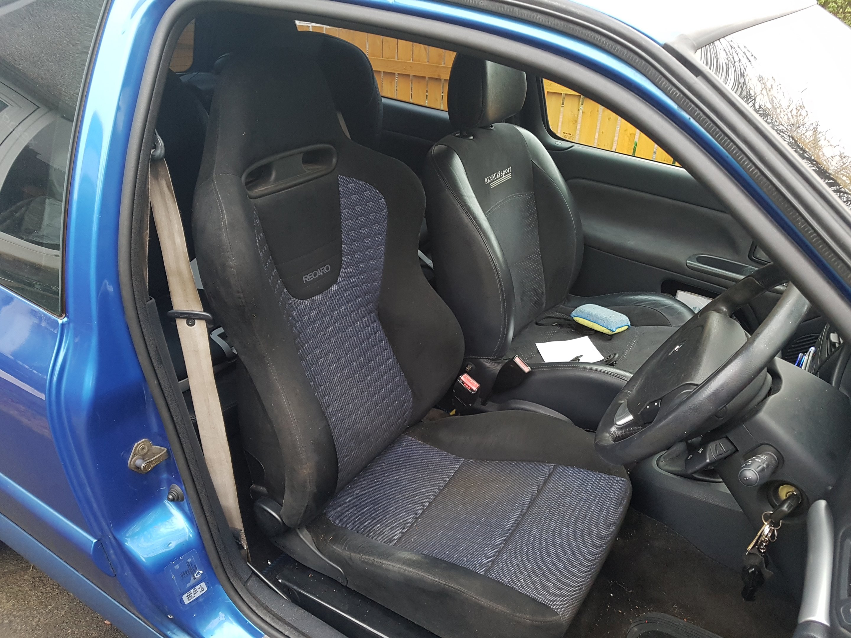

Hi all, just got myself a 172 cup and a friend's upgrading his evo 5 seats so offering me them for a ok price, no subframes though, what all will I need, I know you can get recaro subframes, is there any other subframe options, I've seen some people running ones made by someone on the forum, are these still being made? I'm guessing it's too different to modify the standard ones to fit the recaro base? Thanks
Sent from my SM-G950F using Tapatalk
Contact @JON FOZ

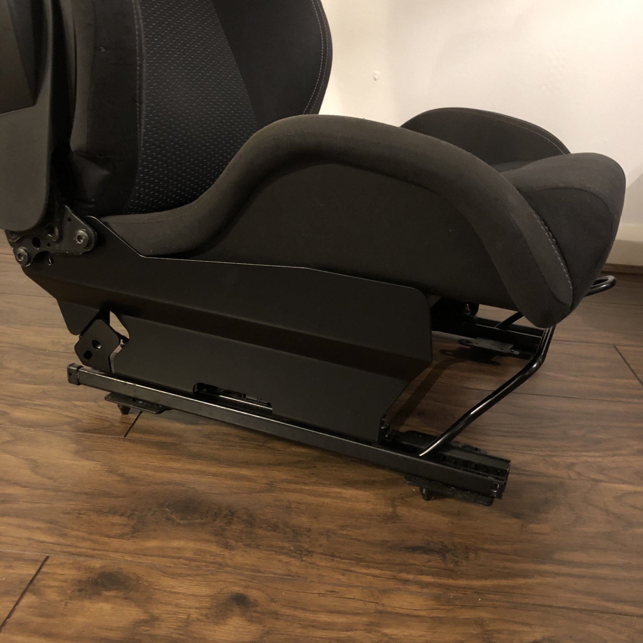

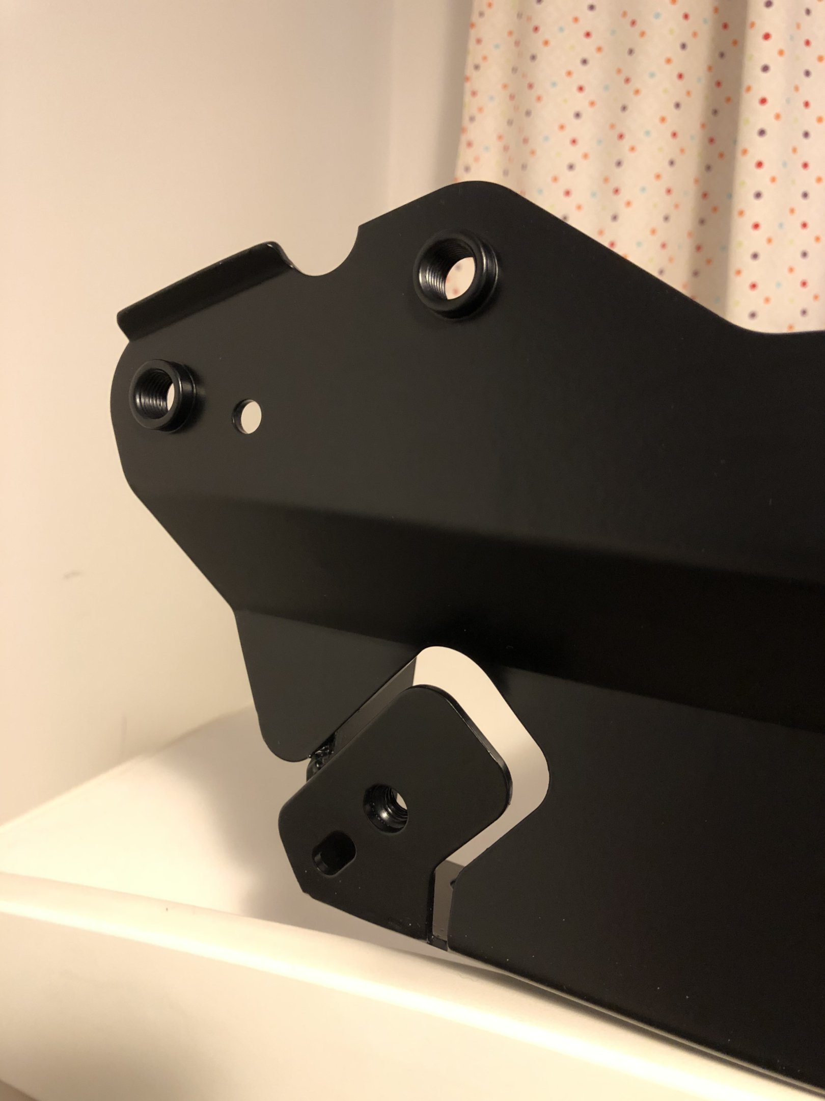

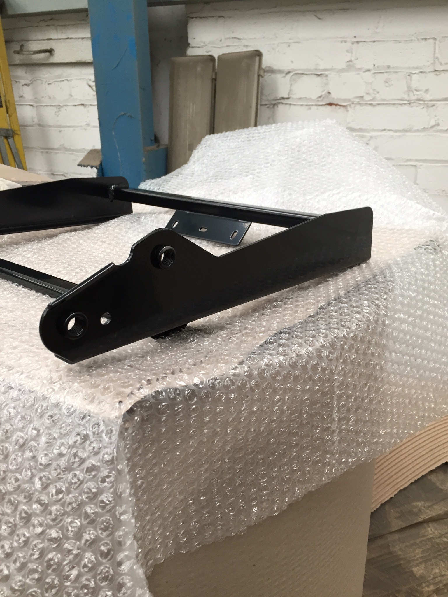

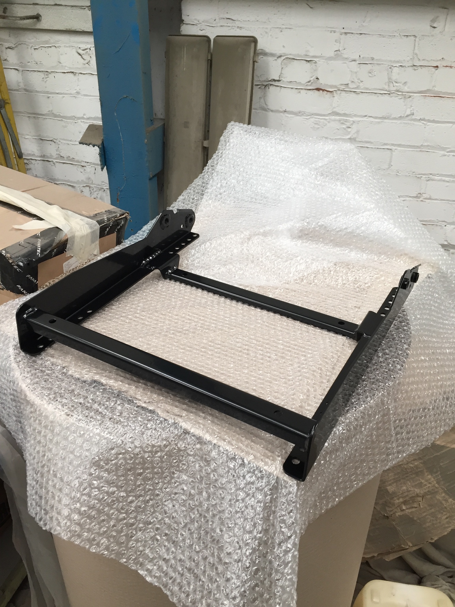

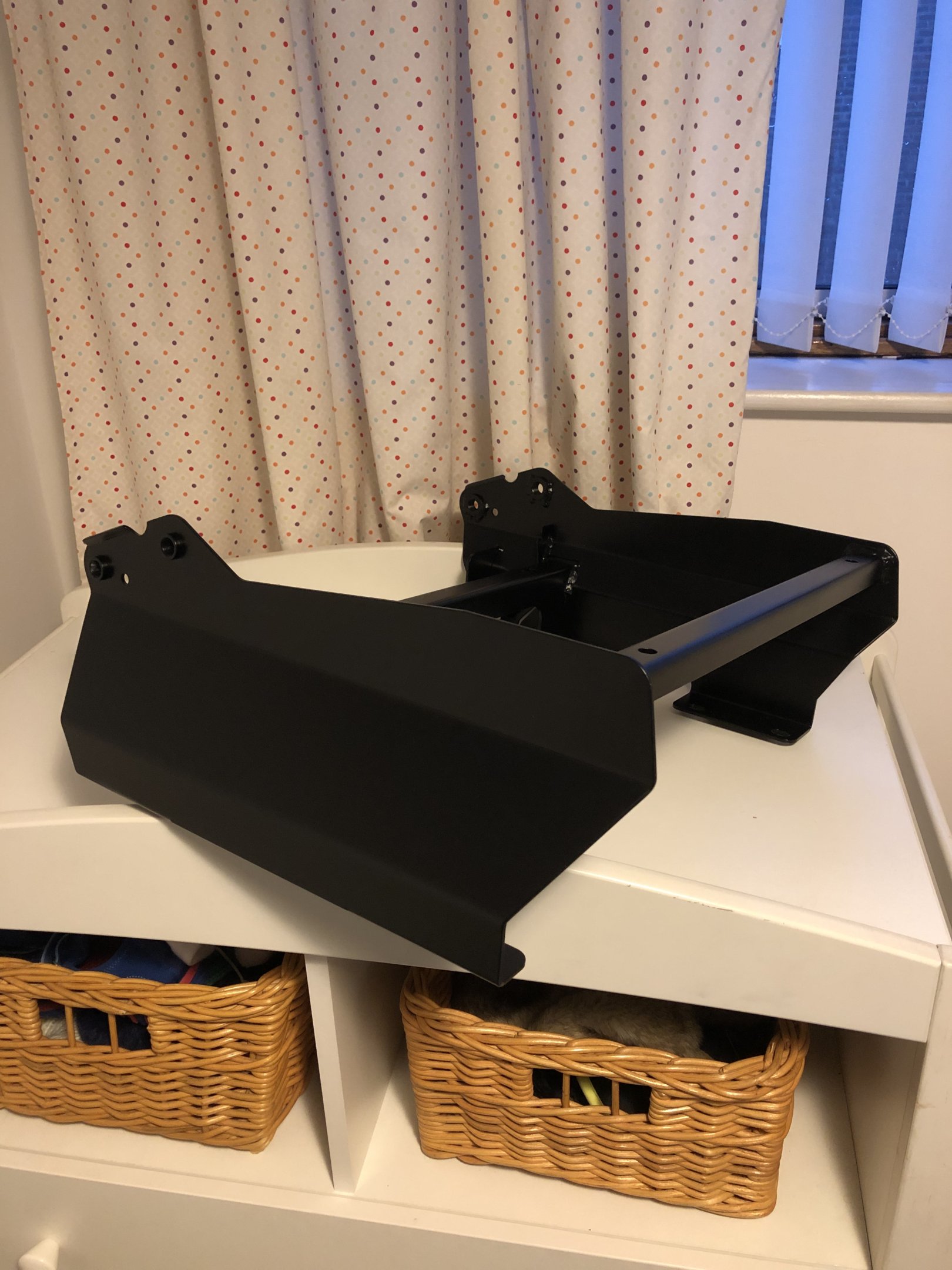

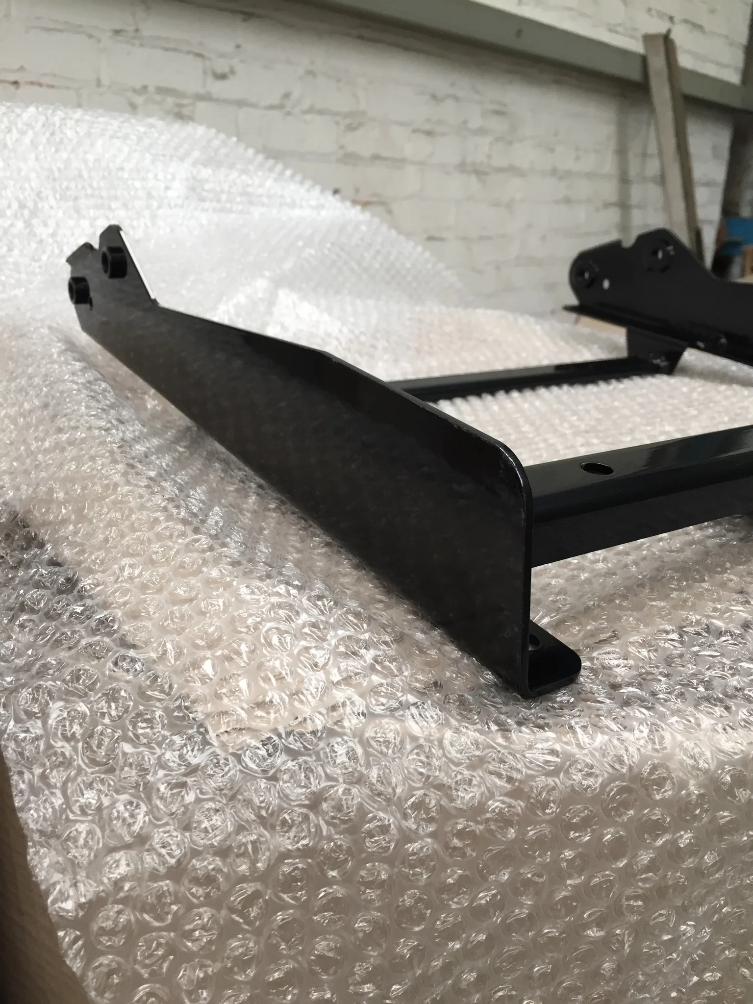

An update on some new products in my VBD line up.
The replacement CS seat base frames are now in stock.
These are used if looking to fit the CS seats from 197/200.
My frames allow you to now fit these seats into 172 etc on either standard Trophy adaptors or my VBD Recaro Trendline adaptors
Price is £140 each frame collected from Merseyside
Post is £16
Any PayPal fees to be covered

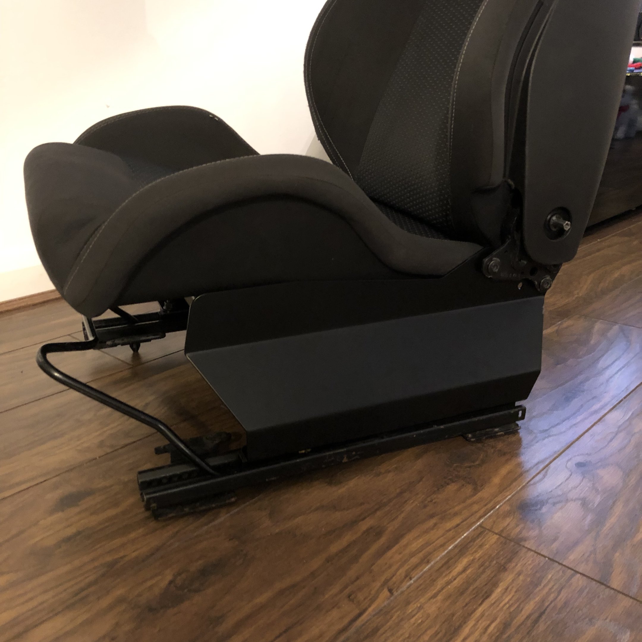

Update 2.

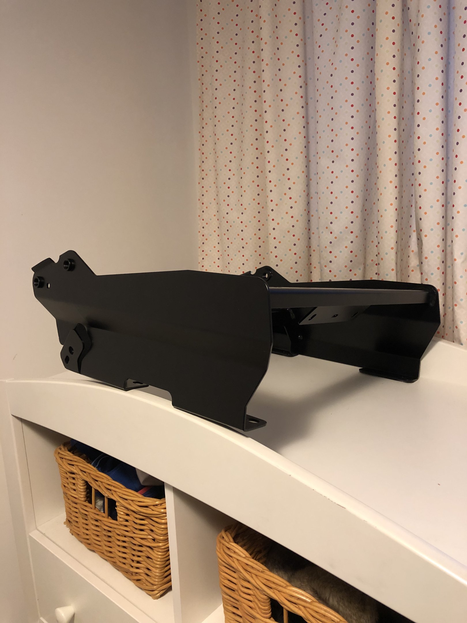

I’ve just finished my prototype VBD lowered seat frame assembly for the Mk3 Clio 197/200 Recaro CS seat.
These lower the seating position by 45mm.
Retain the factory look
Bolt upto the existing runners
Accept existing seat belt pre-tensioner
I believe my units to be the only ones available for both driver & passenger seats.
Price to be confirmed shortly.
Should be on sale January 19.
Pics to follow.

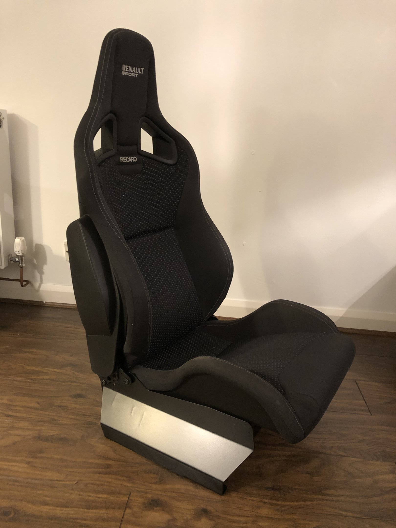

My VBD Clio Mk3 Lowered Recaro seat frames for 197/200 are now in stock
Price is £200 per seat frame
These are available for both driver and passenger seats.
