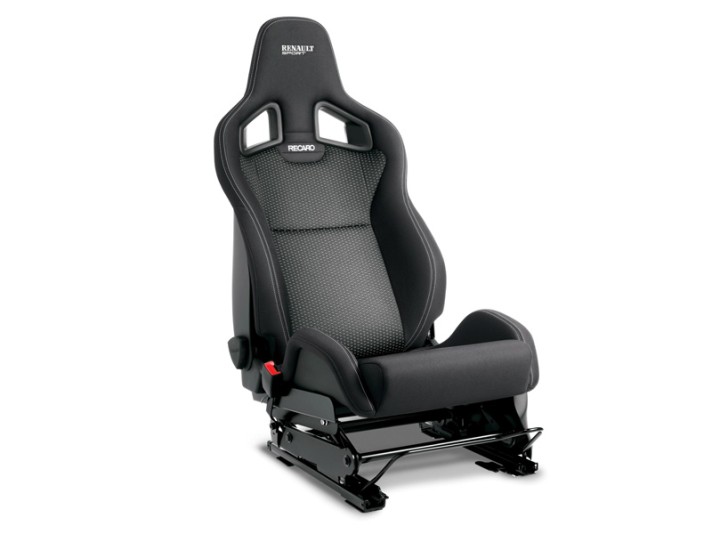

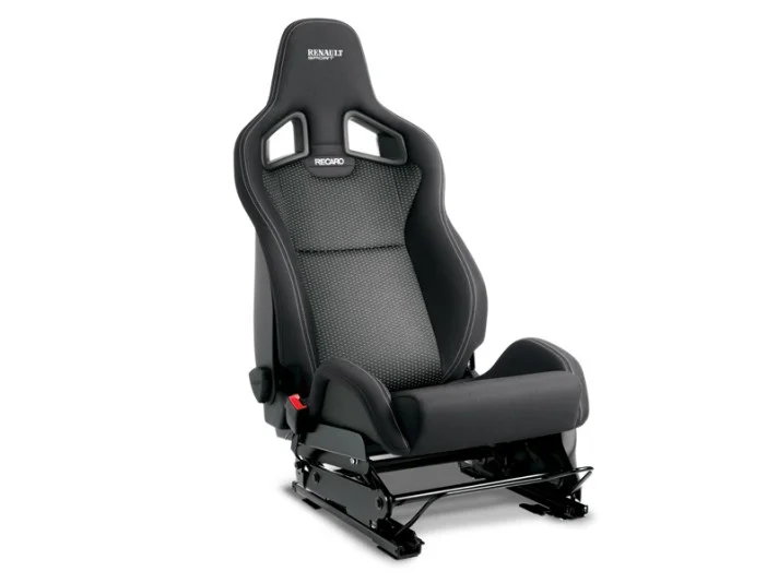

Disliking the R26 R stitching... kinda like Seat Leon Cupra / VW Golf R32 typo.
But why not fit Recaro Sportster CS seats as seen in the Clio II RS phase III.
Renault partsnumber.:
Leather/Alcantara reference 6000072864 : 1490 euro
You can get these from Recaro but without the Renault Sport stitching!
And with or without side-airbags.

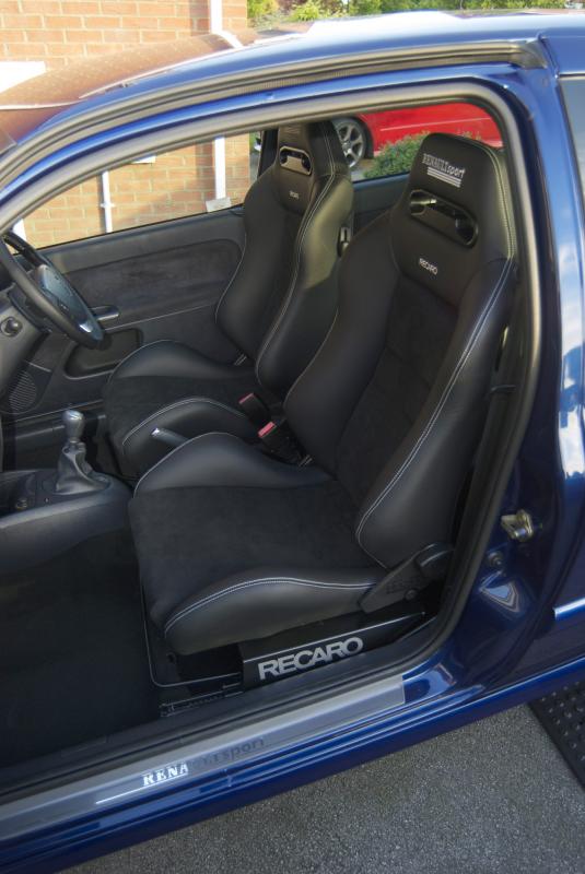

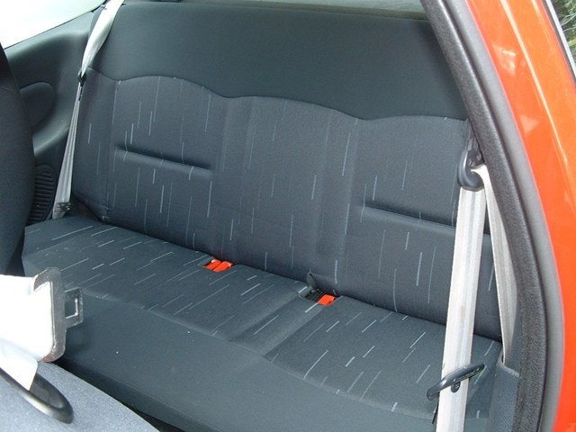

i have the recaros in my cup, and blacked out rear windows so from the outside you cant tell its a cheapo rear bench. i have a harness on the driver seat so no-one sits behind me and very rarely have anyone in the back, when i have they've not even noticed what their sat on......so ill live with them as they are, money would be better spent elsewhere. leathers look good though

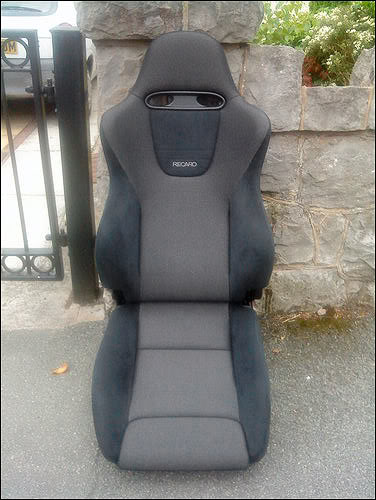

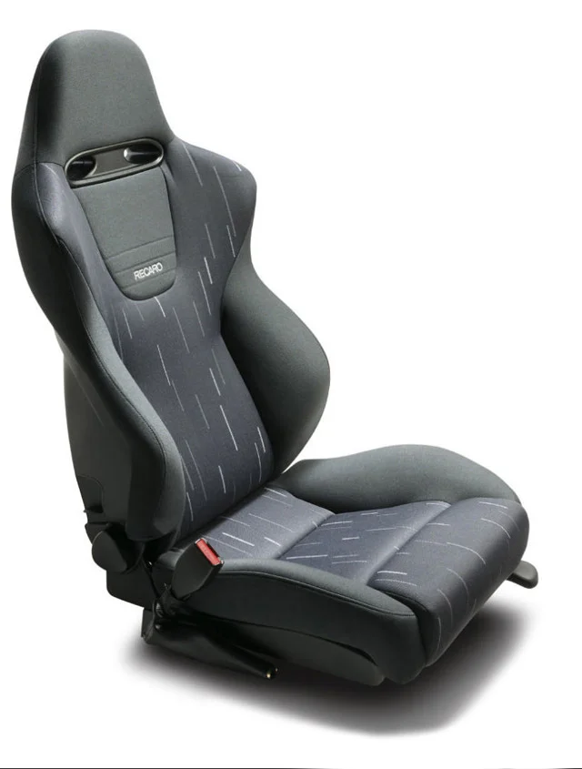

Is anyone familiar with the striped Recaro seats? According to http://www.cliotrophy.ch they were fitted into Clio Trophy's. But I cannot find any evidence, just two pictures of the seats only on ebay. I haven't found any other pictures, all Trophy's I found had the black alcantara/leather recaro seats.. Anyone here with pictures and information? What are they:
I actually quite liked the look of them compared to the ones that we got, there was a set on French eVay a while back and they were going for double what a set here cost!

Will the Recaro's fitted in a Megane 265 fit in a 2009 Clio Cup 200?
  Clio Cup 200
As far as I know, the recaro sportsters in the mk3 Clio and mk3 megane are a straight swap.
I hope so. I'm picking the car up tomorrow (fingers crossed) and on the way back home I'm picking up the Recaro seats that were taken out of a Megane 265.
I've got a feeling I'll need to change the sub-frames.
