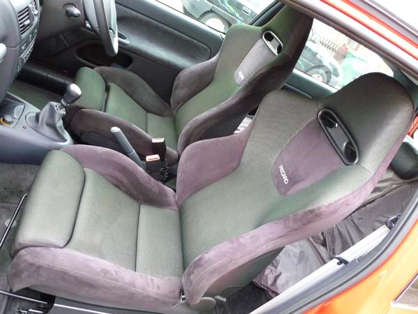

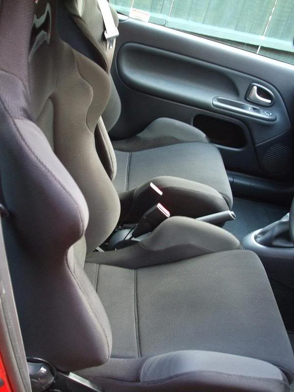

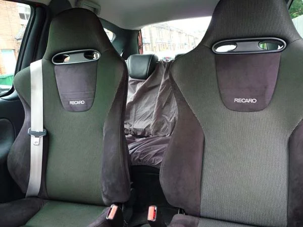

So here's a few pics including one of the underside of the seat that hopefully explains a little better how the seat and subframe mate together.
These are the seats in the car. Note the photo colour is not very accurate, although the seats do have a very slight green tint to them in some lights.
Another angle...
From the back...

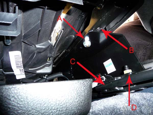

This is how they mount.
A. is the subframe mounted to the seat base. The Torx t40 bolt head sits in the seat frame and the nut below the subframe. At the rear of the seat, the subframe is bolted to the captive nut in the trendline seat base.
B. This is the Accord Type R Trendline forward captive nut. The spacing is too wide for the Clio subframe hence the need to use the different hole.
C. are the original clio sliding seat frames. These bolt through the floorplan of the car.
D. 13mm nuts that bolt the subframe to the clio sliding seatbase. There are 3 bolts on the tunnel side and two on the door side.
It's the same deal for the driver's side.
Only problem with the Accord Type R seats is that they don't have a forward tilt handle, so you have to tilt using the adjuster wheel on the tunnel side of the seat to let rear passengers in.
Weight for the passenger seat and subframe (without sliders) is 15kg.

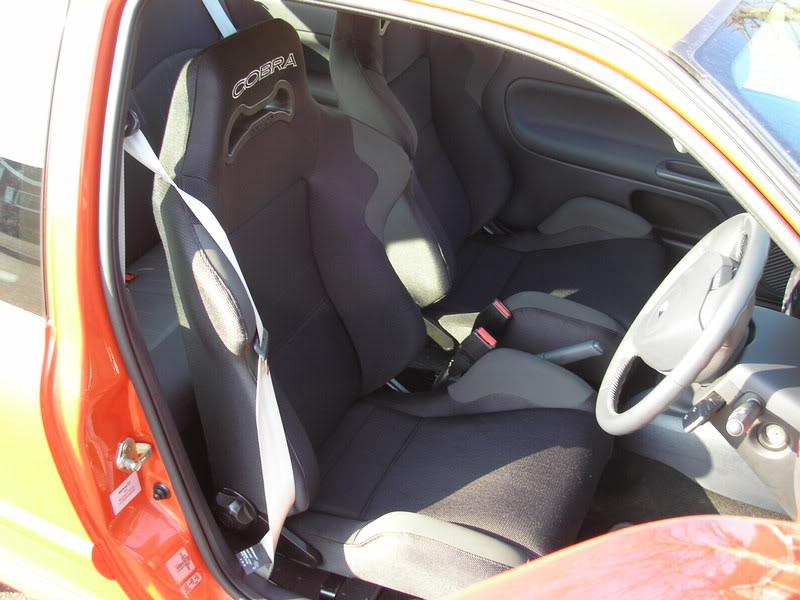

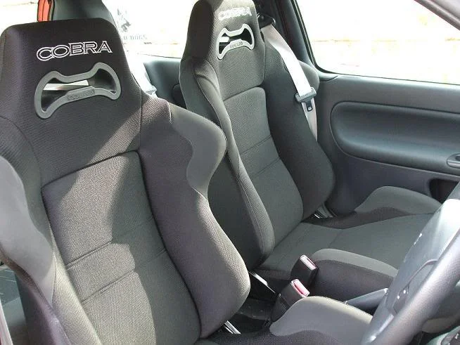

well done with your hard work! but i prefer my cobras! (much more keeping with the interior) looks factory and actually sits at the right height! ;)(spacers need removing)

I think youv done a good job mate but they look really high up i like to be sat really low like it Pauls car with his cobras
  2015 ST2(MO)/CorsaLE
^^ That is the only down side to the tredlines! there great! and look great! but they dont sit low enough! taking my washers out took the seat down by 30mm which seriously makes all the difference! ;)
4 and a half stars! LOL :)
thats why i think the cobra/daytonas do the job well! there a good price! they sit just at the right height (when washers are removed) hold you in very well! they recline and they also dont look out of place with the cup/ff interior!

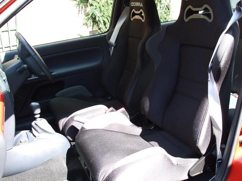

595 i fitted them and got 100.00 for my old seats! so 500 for x2 new seats is not bad imo (250 each one) people say they look cheap! imo thats not true! the standard ones look nasty! and after all its only a clio! i find them very cumfy! (im thin) and i dont get back ache like i did with the old ones! :)
the standard seats gave me back ache! and didnt do the car any justis! i think if/when i sell it people will see why i did this little mod! that makes a lot of difference!! + it was stooring the things there bloody heavy and take up a lot of room!!

That's a good price for a new set of seats. OK, so the material looks a little Mr Byrite in the first pic, but joking aside it's a no brainer between the Cup seats and the Cobras.

i like the material tbh! yeah reanult should have done a deal with cobra or the likes and put these in standard and not charged you tbh!
