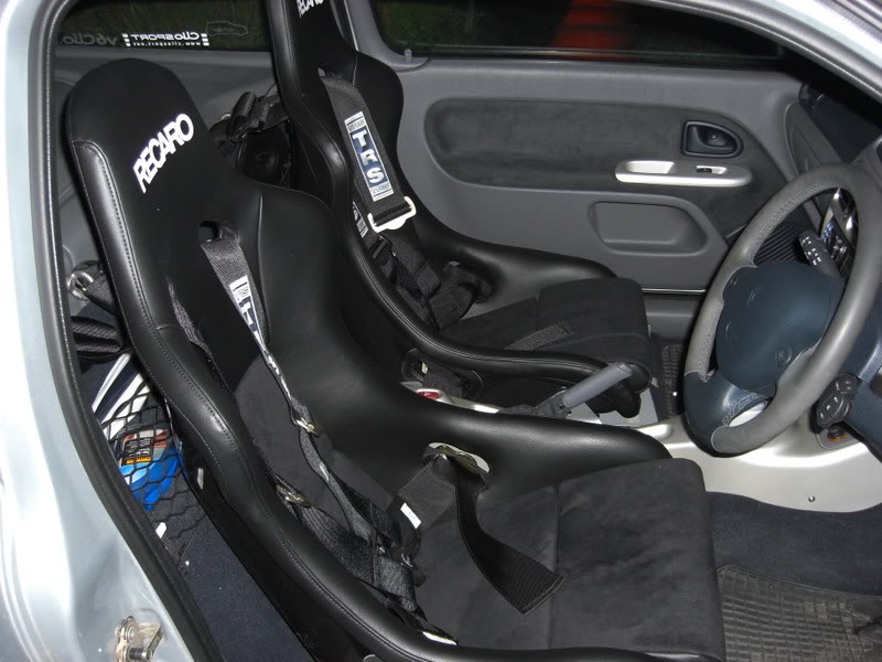

Recaro's and Harness' now fitted to the vee!!
  V6 230

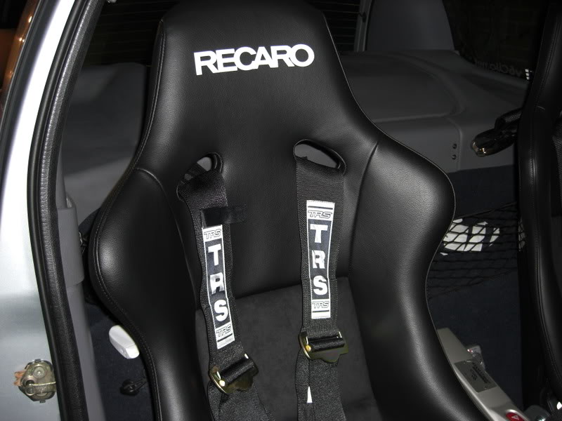

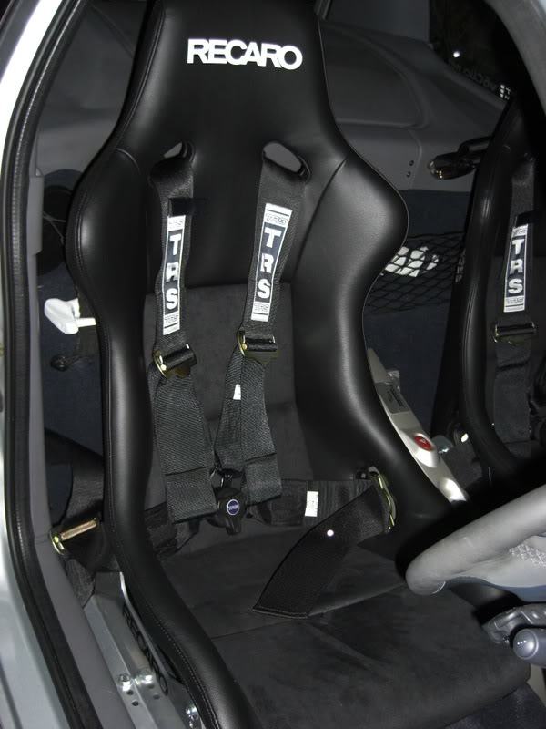

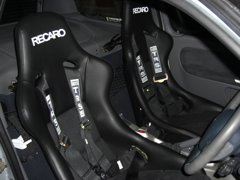

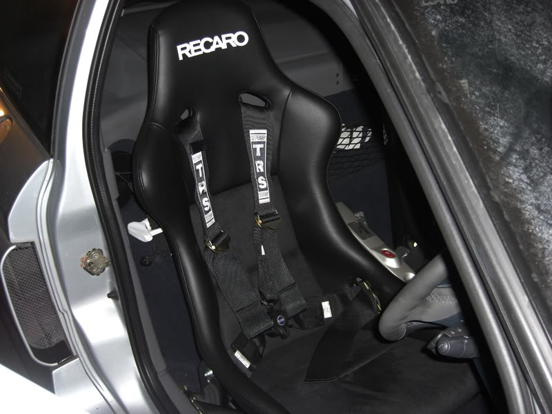

After what seemed like an lifetime (9 weeks) my Recaros were finally delivered and fitted at the weekend, anyone thinking about getting some DO IT!!!
Feels like a go kart now (although my seats are VERY low due to how I mounted them lol) and the weight difference between the standard and Recaros was amazing. :)

Lovely Indeed.... That is a Very Close bracing point for the Harnesses but I suppose its the only option.

How much did it all cost excluding the harnesses? Any pics of the eyelets and how they are fitted?

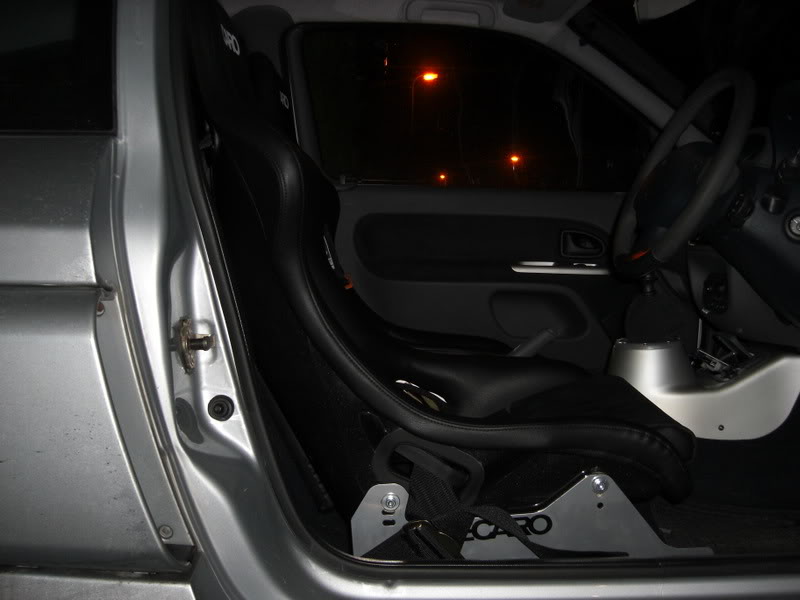

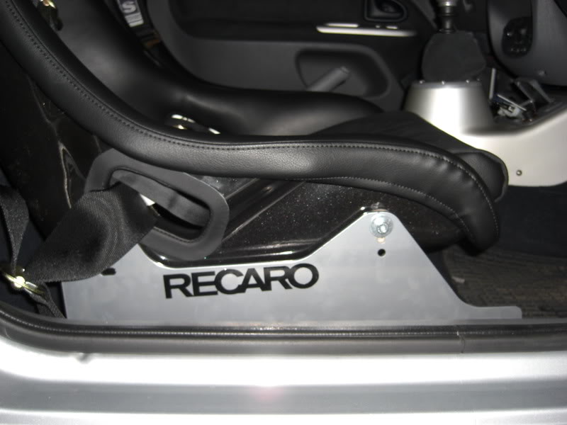

Cant remember exactly and dread to think lol but about 1100-1200 for seats and custom subframes.
No pics of eye fitment but basically M10 eye bolt into the original B-pillar mounts for outside lap belts, 7/16th eyebolts into subframe with lock nuts for inner lap belts and M12 bolts with stress plates, washers and lock nuts through the cross beam in the engine bay and M12 eye nuts. These are going nowhere in a crash lol

Where'd you get the custom subframes from? Or did you just get the recaro subframes altered?
  V6 230
Subframes were made by a contact from Yozza mate, made to order. They are very low and needed modifying but not difficult.
