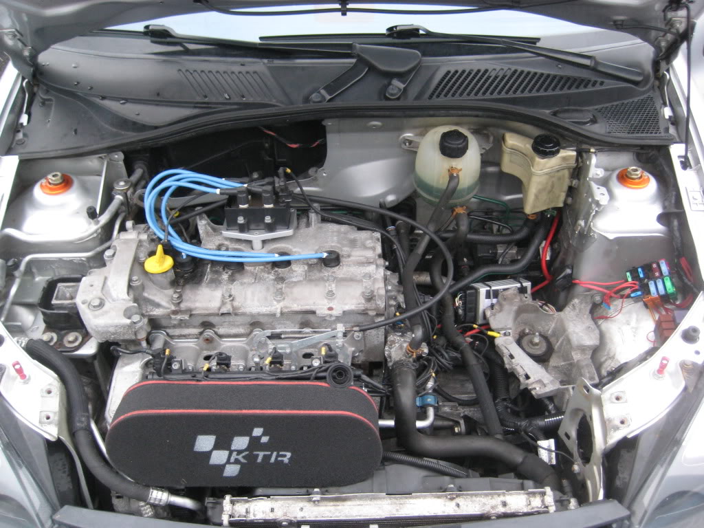

what do people do about the power steering pipe as the sensor on mne hits the radiator with the cup altenator on !!! radiator is currently in pisssseeeddd at the moment due to it not fitting properly
can you bend the pipe without it breaking, or just take the sensor out of it and weld it up , or will the power steering light stay on constantly
Have you bent the pipe salty?
Yes, It's been on for about 5 months now without problem. Just got some silcon and foam over it to make sure initially. Tis fine though. Like croc says it's fairly pony metal but doesn't need to be bent much. At least not on the Ph1, not sure if theres any differences. Speak to K-tec otherwise. They offer the entire package
I re routed my AC pipes.
Not sure it this pic is of any help
why do you need a cup altenator when removing the a/c why cant the standard one still be used
