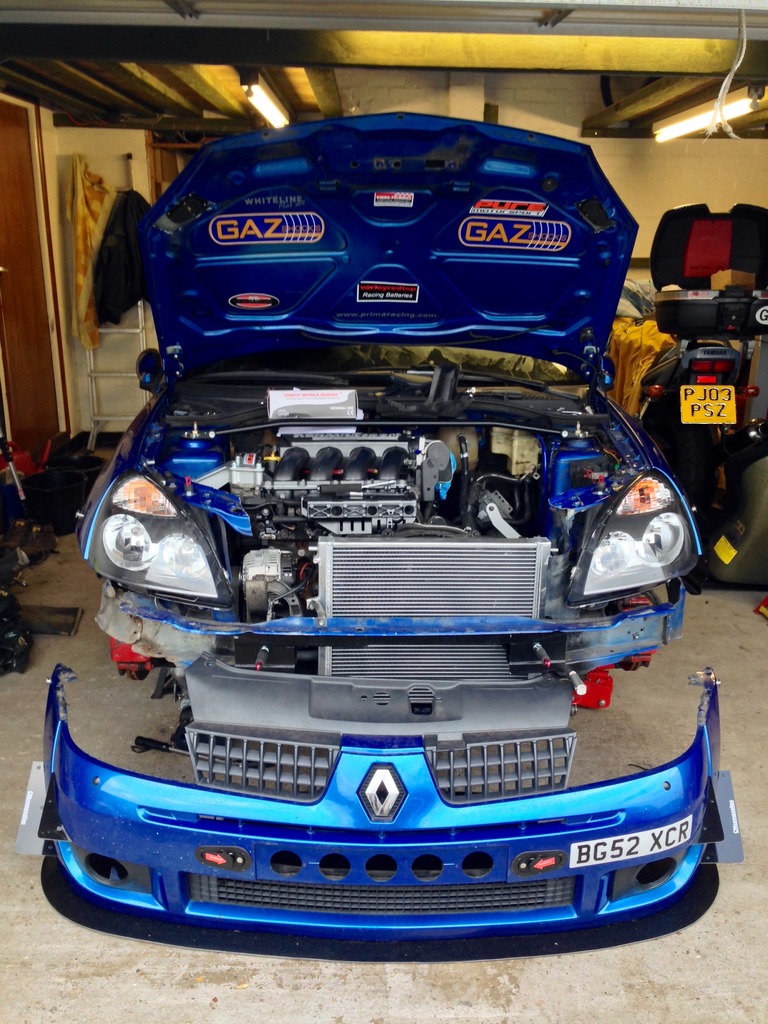

Hi,
Those folk with quick release front bumpers for loading cars onto trailers etc, can you post some pics of what you've used to fasten it and where?
Mine touches on the ramps as it is, and in due course I'd like to add a splitter so it will need to come off for loading.
Thanks

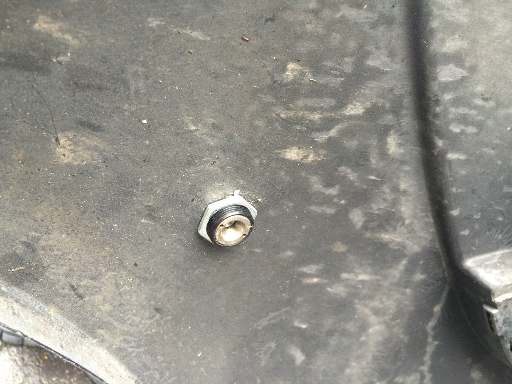

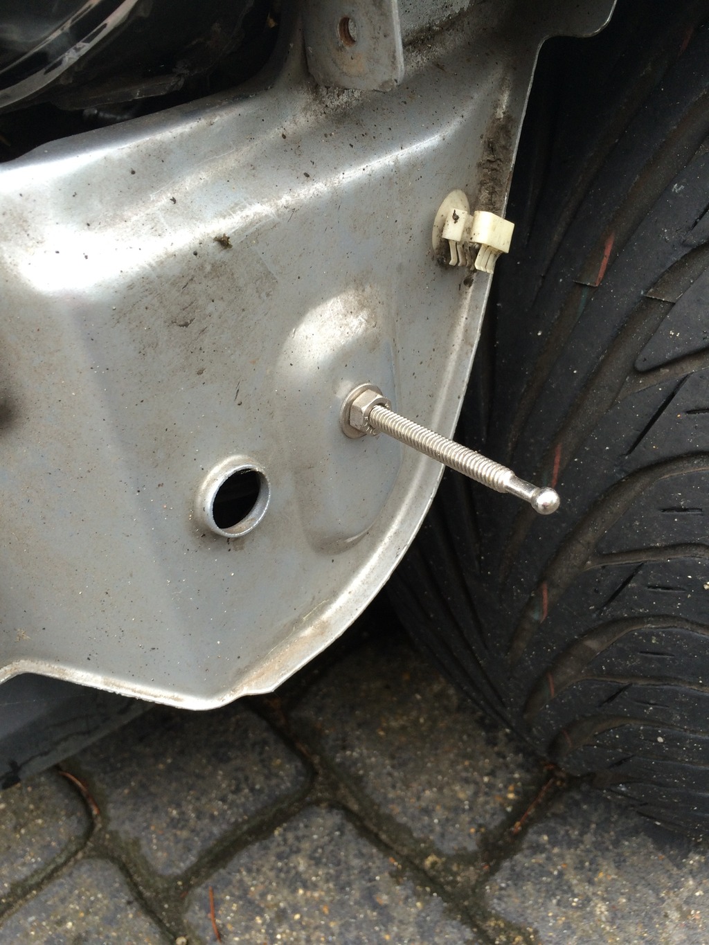

I found this on another thread.
@Chambers_RS, how did you fix the sides?
Cheers
Greeny.
  440i + 182

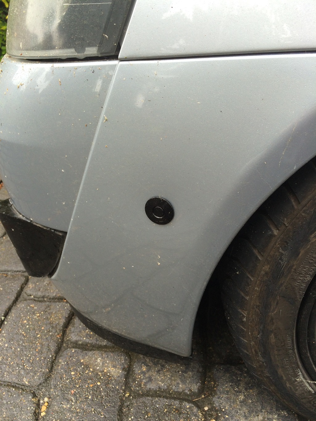

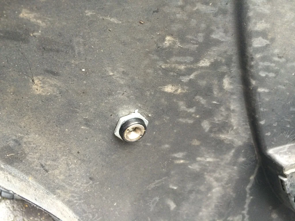

My sides aren't held in by anything apart from the clips, the above pic appears to just have aero mounts above the lower grill, although the I've seen many others use aero mounts on the sides of the bumper
GCC
  1.2Clio / 182!!
It takes a couple of mins to remove it normally.
I was going to say just this. Depending on how much of the undertray you have still in place it really does come down to the two side bolts and a quick tug doesn't it??
  Mazda3 2.2D 185BHP
Two bolts, and a few screws holding under tray and wheel arches to it.
can have it off in under 5 mins

I have the same as above picture. ^^^^^ no point wasting a couple of minutes when you can have it off in less than 10 seconds :wink:.
These are a good alternative to aerocatches http://www.quik-latch.com

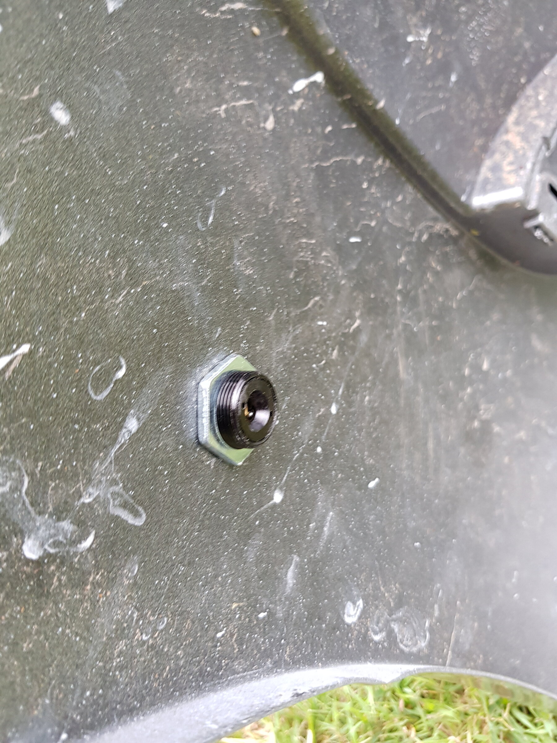

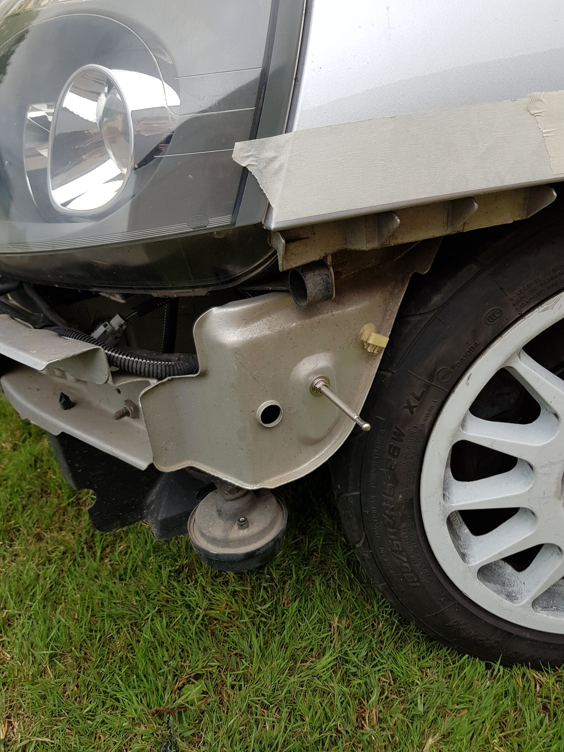

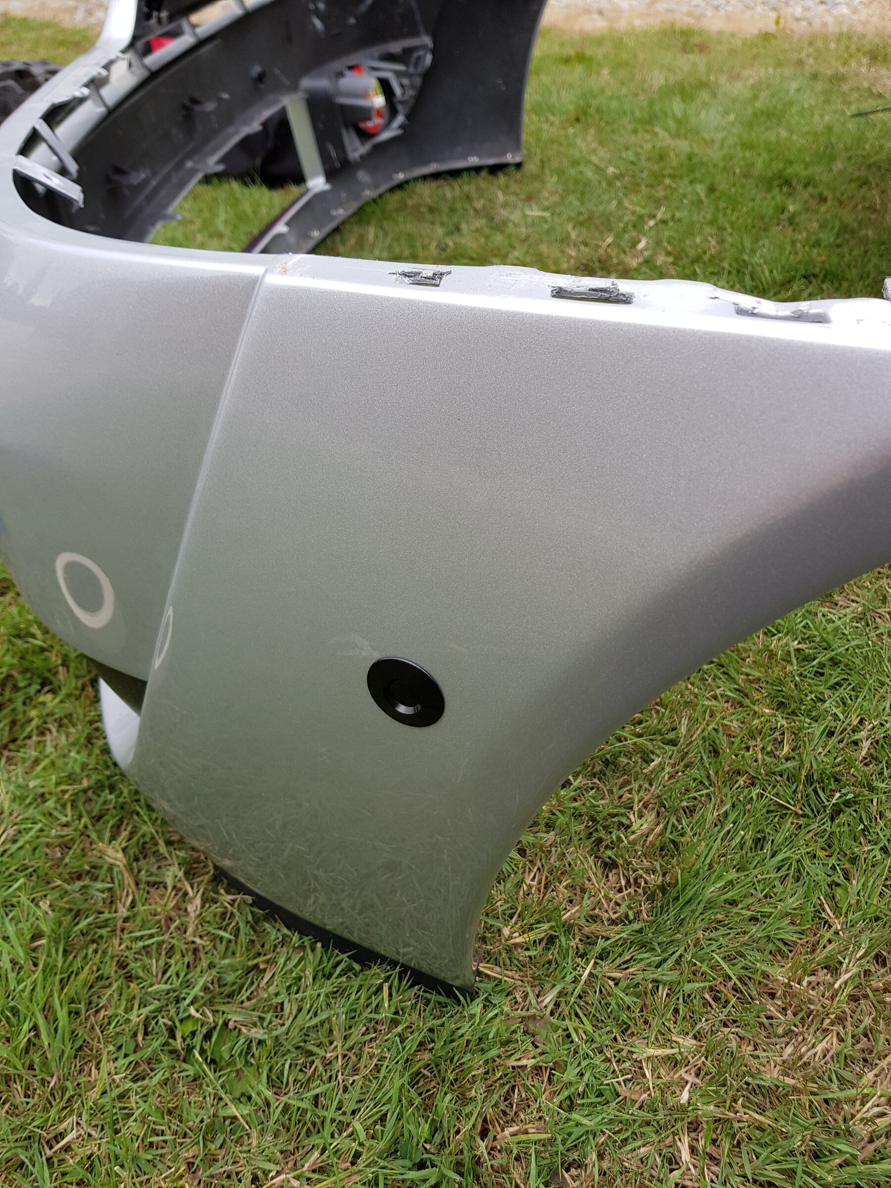

Do you lot remove the crash plastics behind the bumper?

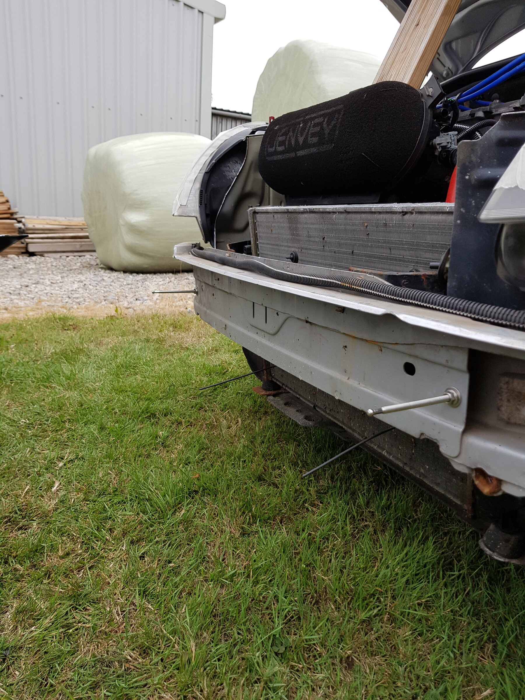

My front bumper is completley gutted removed anything not needed, you will need to make a small bracket up tho so the middle of the bumper doesn't sag but that can be done with a bit a plate and a bolt and nut bolted on the crash bar
VenomUK
  Clio 172
I've gutted it now and used 4 pins in the same was as @1985michael182 has above. Well pleased with the outcome and removed all sag from the bumper
