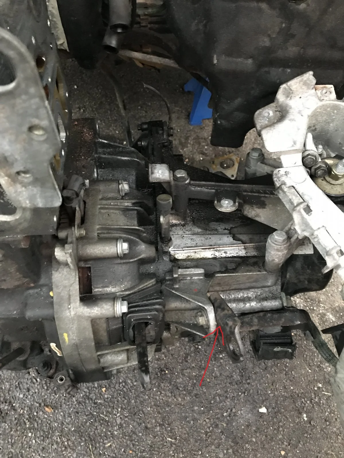

As a short term bodge, you could space the outer clutch cable stop arm, but clutch replacement is really what is required. See post 55.

Correct, a 2mm washer bought me around 6000 miles & 30mm of pedal movement before the clutch started to drag badly again, making engaging 1st or reverse whilst stationary nearly impossible.
A 2nd washer made very little difference.
