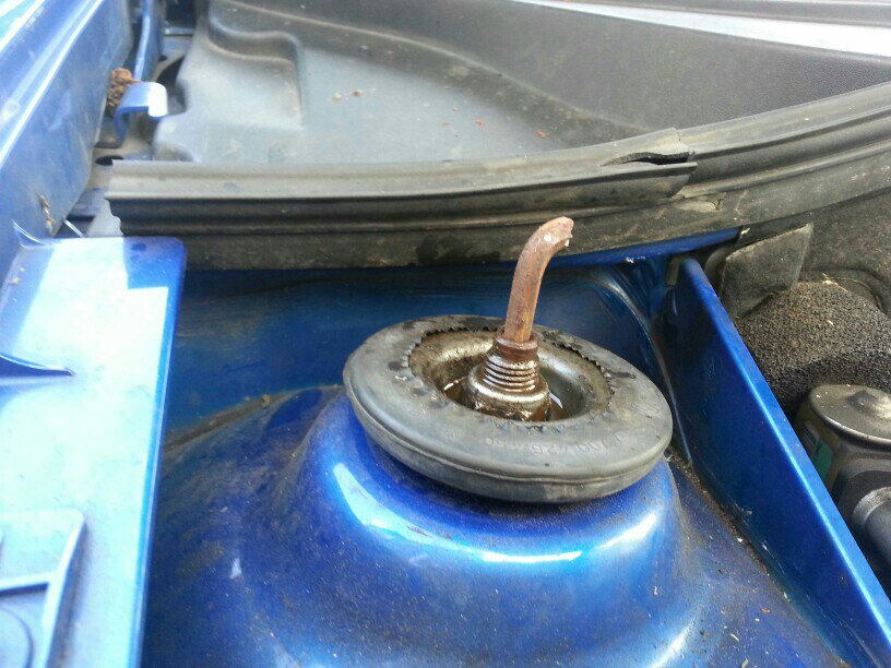

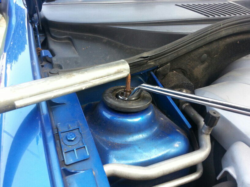

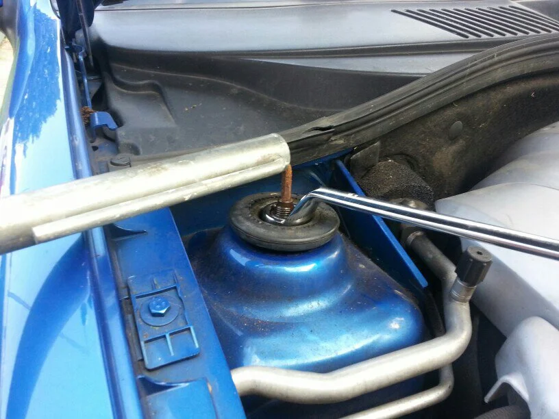

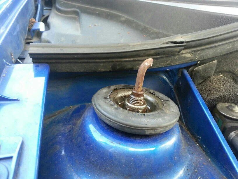

Trying to change the front springs but cant undo the top nuts.
Soaked them in plusgas and wd40 trying to use a 21mm swan neck ring spanner and a 6mm allen key but they just wont budge!!

Sounds like you've got Mickey Mouse tools lol. Have you got some sort of little pole you can use to put over the Allen key? That'll give you more leverage and strengthen it a little.
This is not working. ...

Yep, an airgun would be best.
If you can't get hold of one though, next you could try an adjustable spanner on that bit of the snapped Allen key.
It's very bad practice and I shouldn't really advise it but you can grip the shaft with some grips near the top to help stop the shaft turning.

Its not jacked up is it when trying to undo ? Will be easier with the car on the ground.
​Also don't bother with the Allen key , with the weight of the car on the ground it should be enough to crack it off , then use the allen key.
