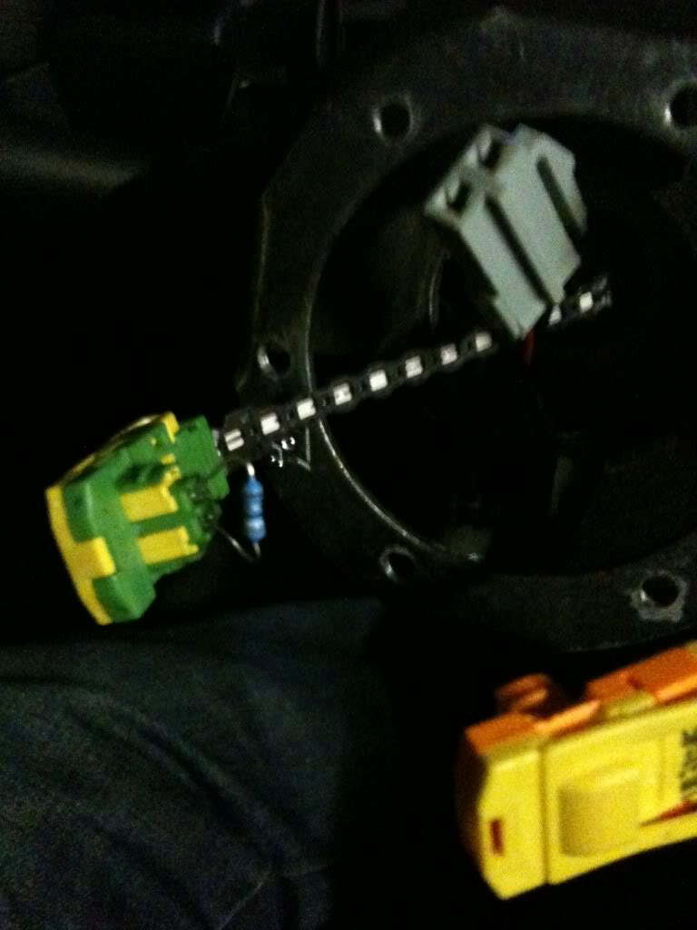

Many on here have had the issue were it has gone up in flames, im one of them, as it happend to me 2weeks ago were the horn wire touched the metal of the boss kit and up it went, lucky there was snow about otherwise car would have gone up in flames. i forgot to disconnect battery :o. so i strongly adivse you disconnect it
this is how to stop the airbag light being on the dash, u need to do this to both the airbag wires, i used 3.9 ohm resistors
