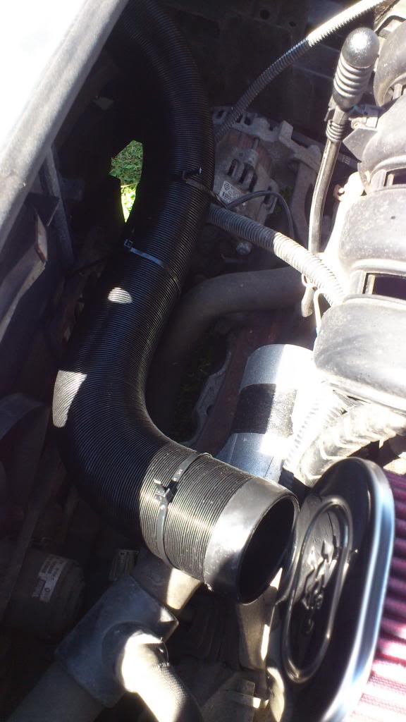

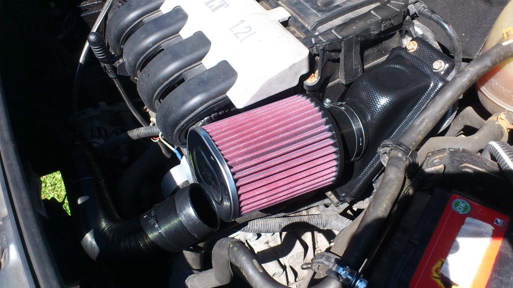

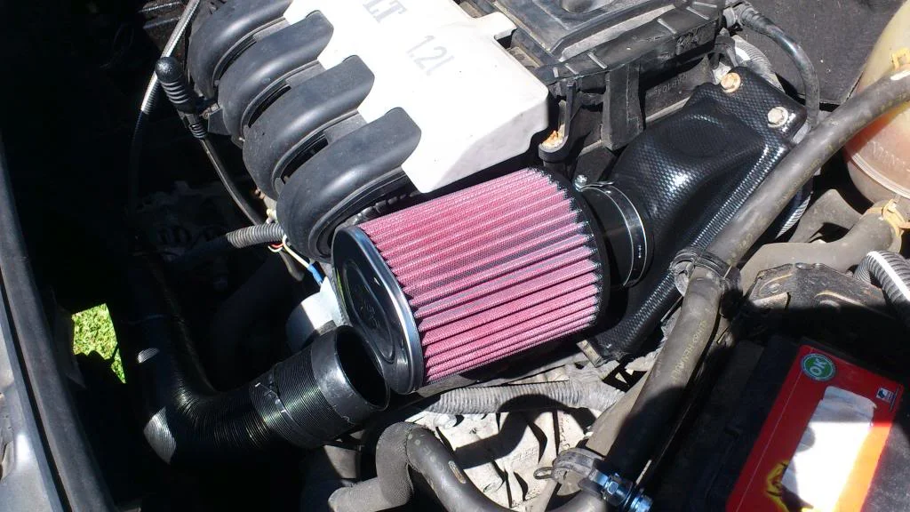

Remove the cold feed, then remove the top half of the airbox (it un-clips), take the filter out and un-bolt the bottom half. Keep the bolts you need them to bolt the adapter plate on then simply fit the cone filter onto the adapter plate u need to remove a bracket from the engine in order for the system to fit.
should look like this when finished :
Hope this helps brad
A 2004 will have a slightly different set up. As you look at the engine. Undo the jubilee clip at the top right. Then unclip the front most air pipe. Then the whole air box swings up from the front and pulls off the throttle body.
