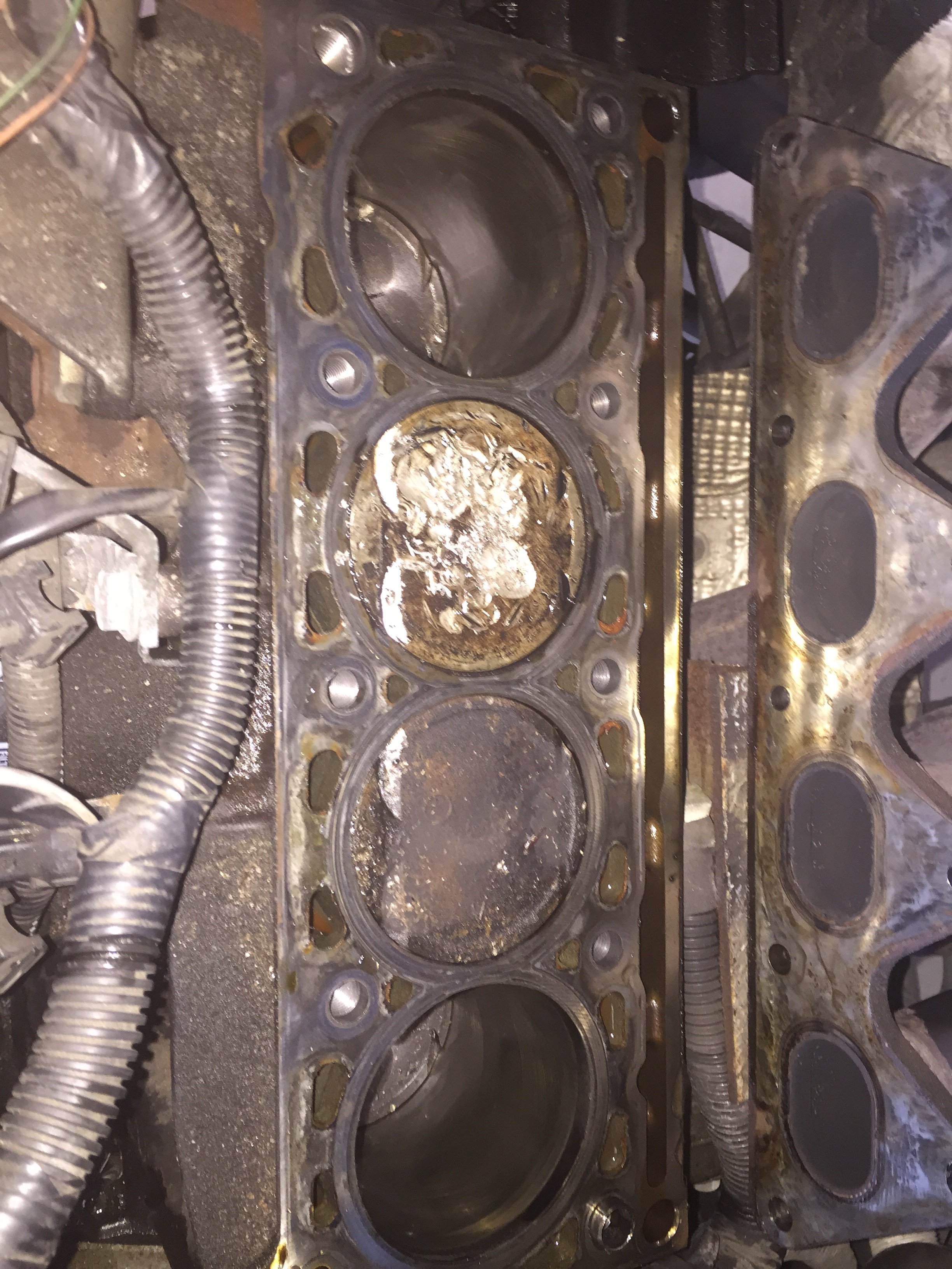

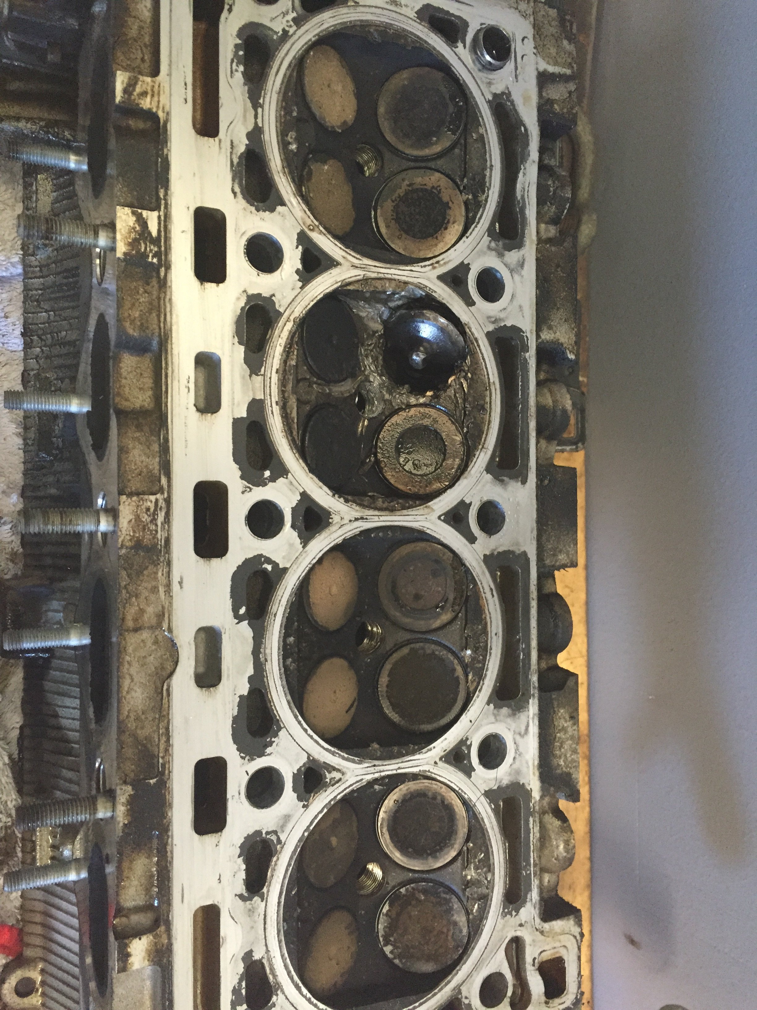

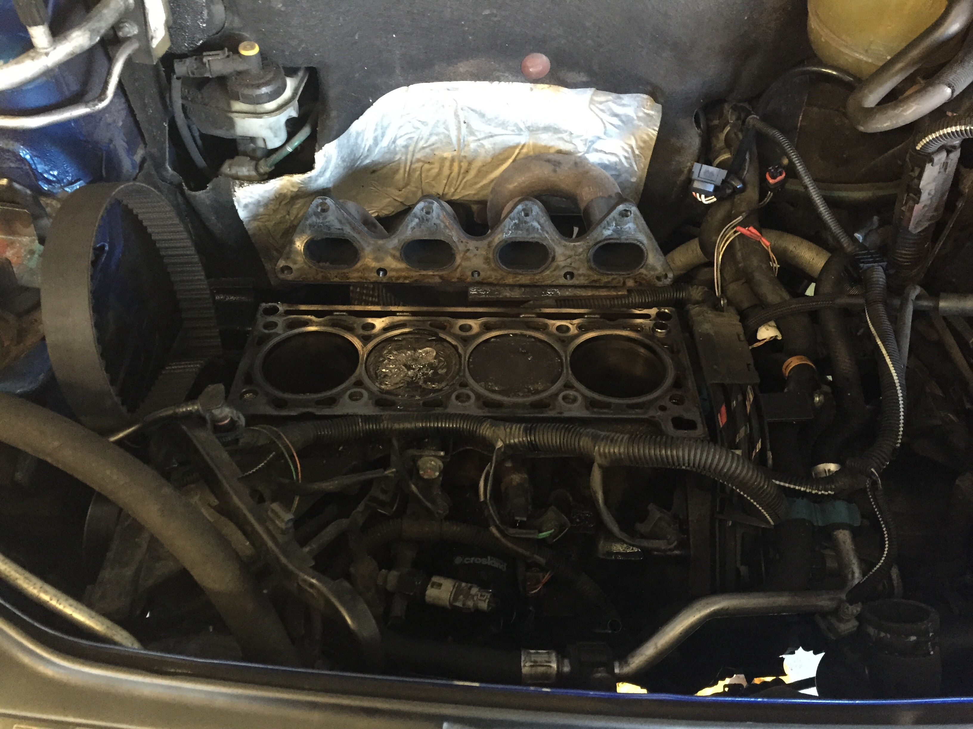

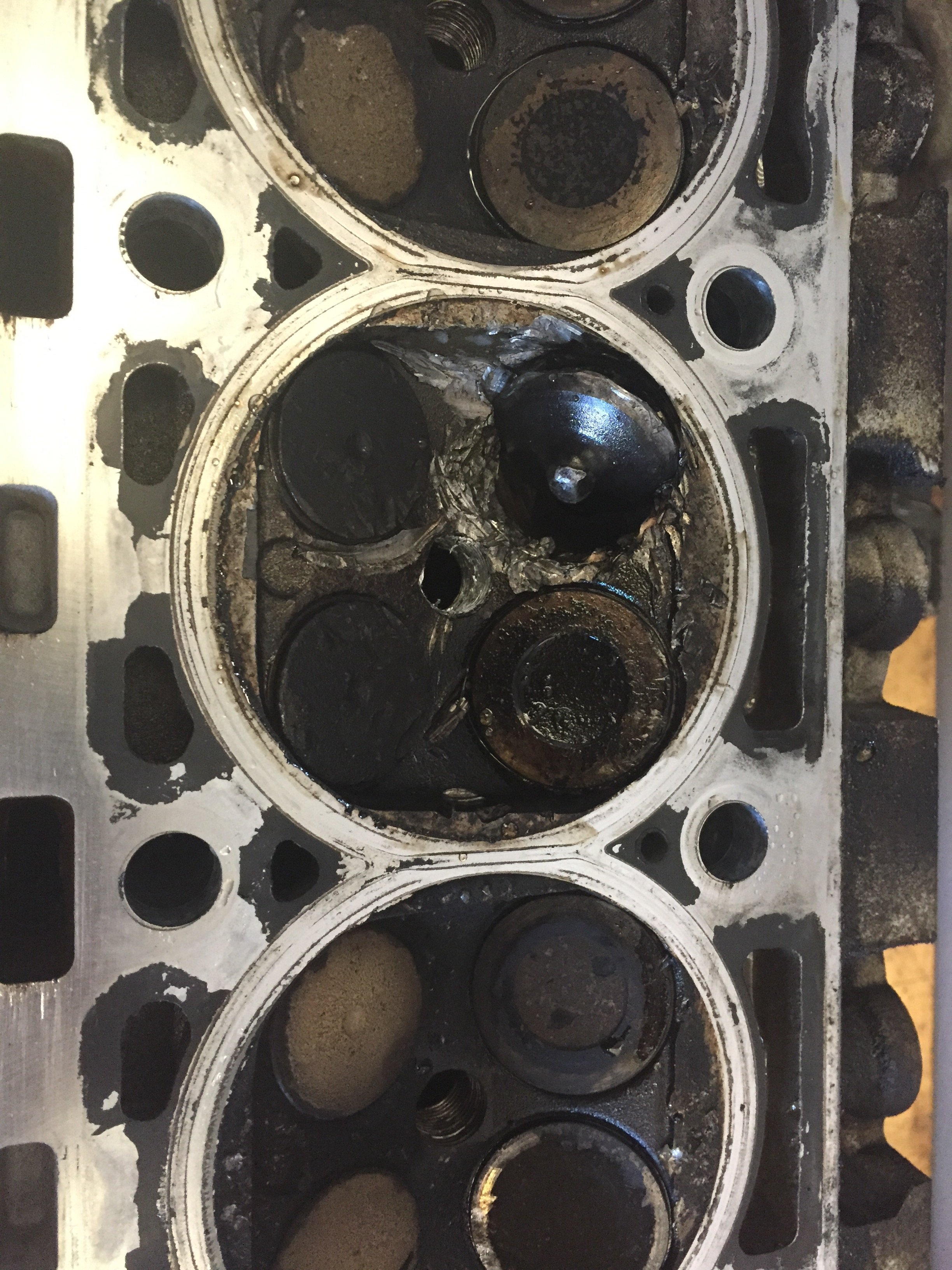

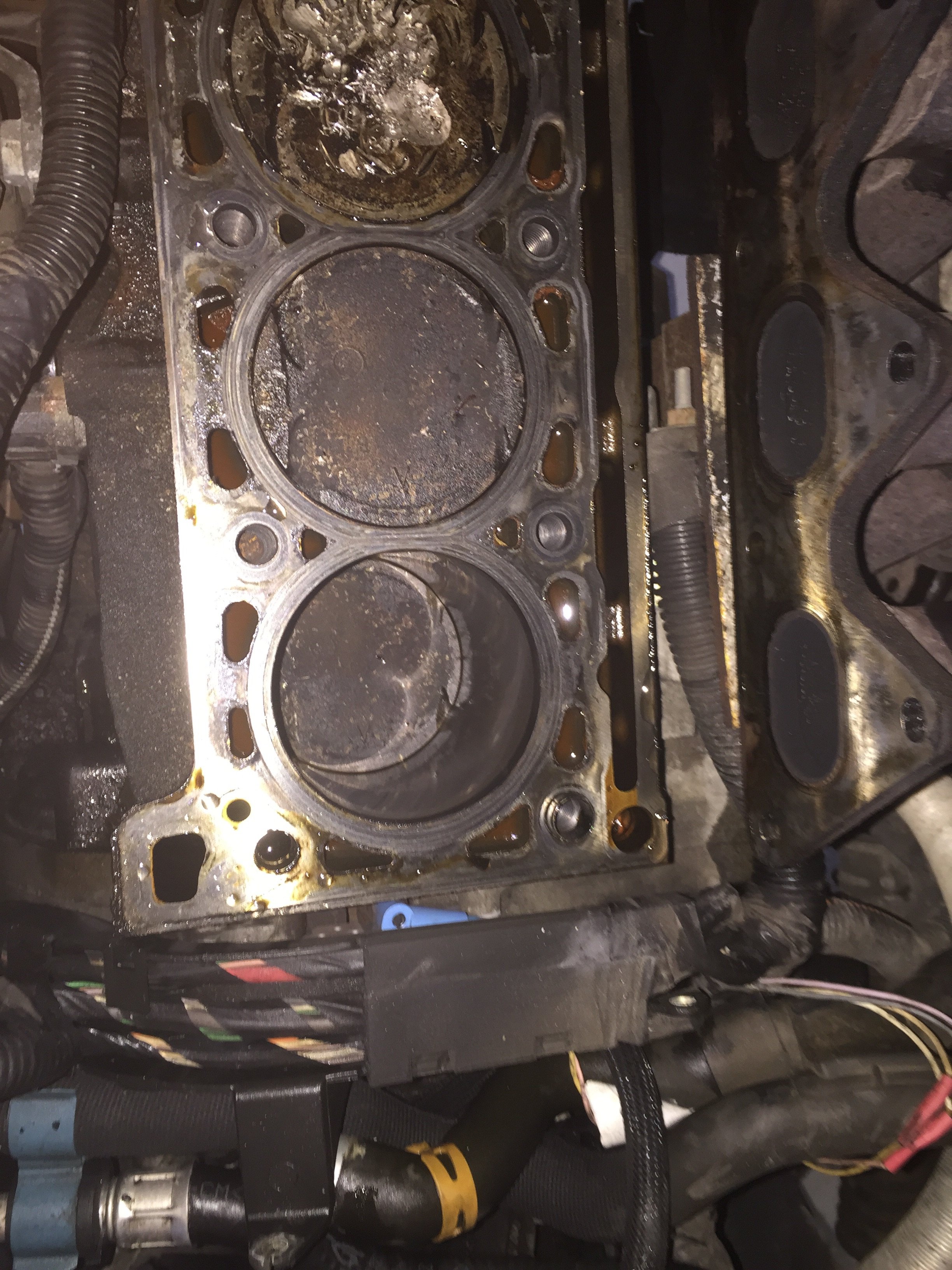

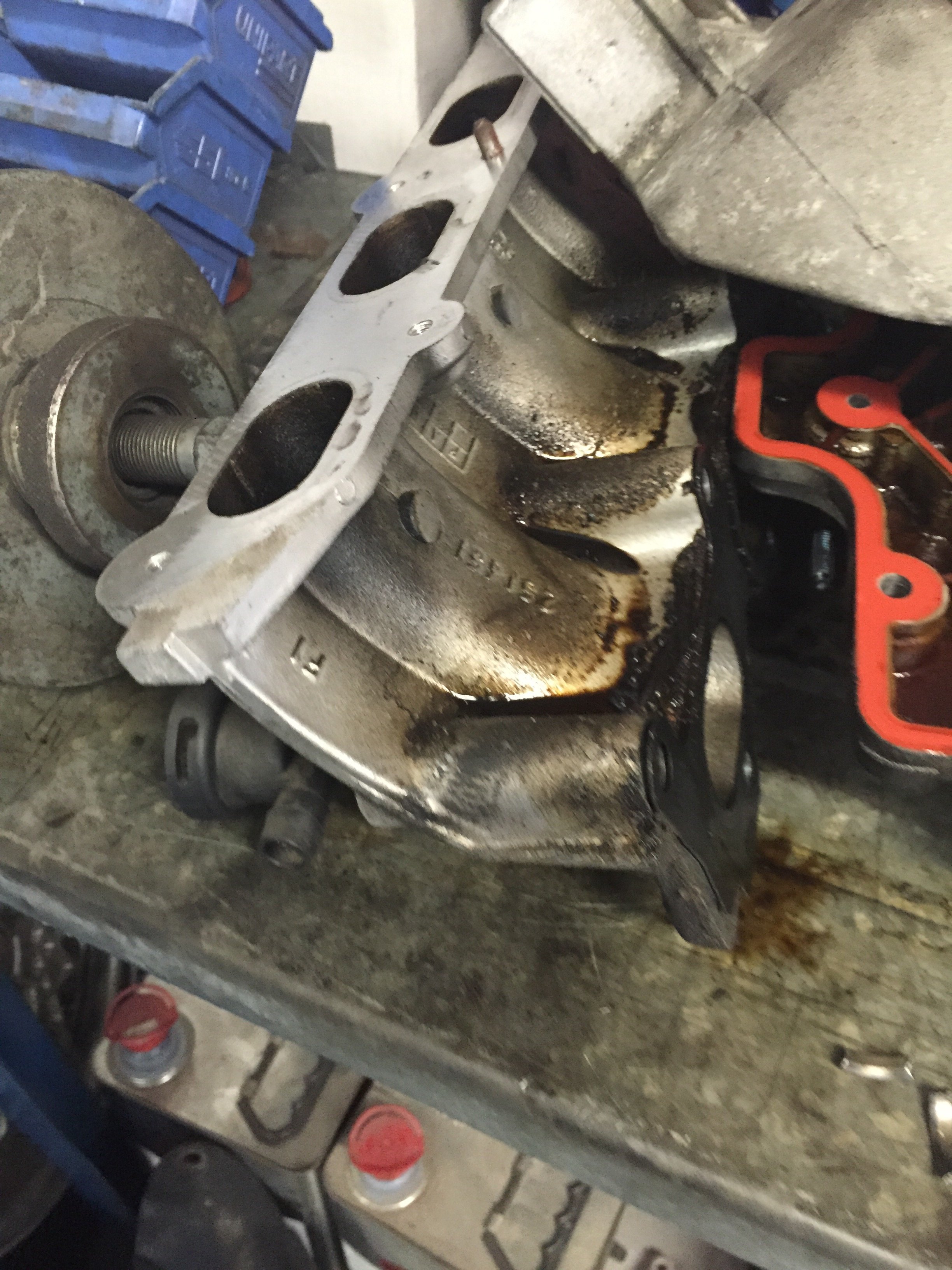

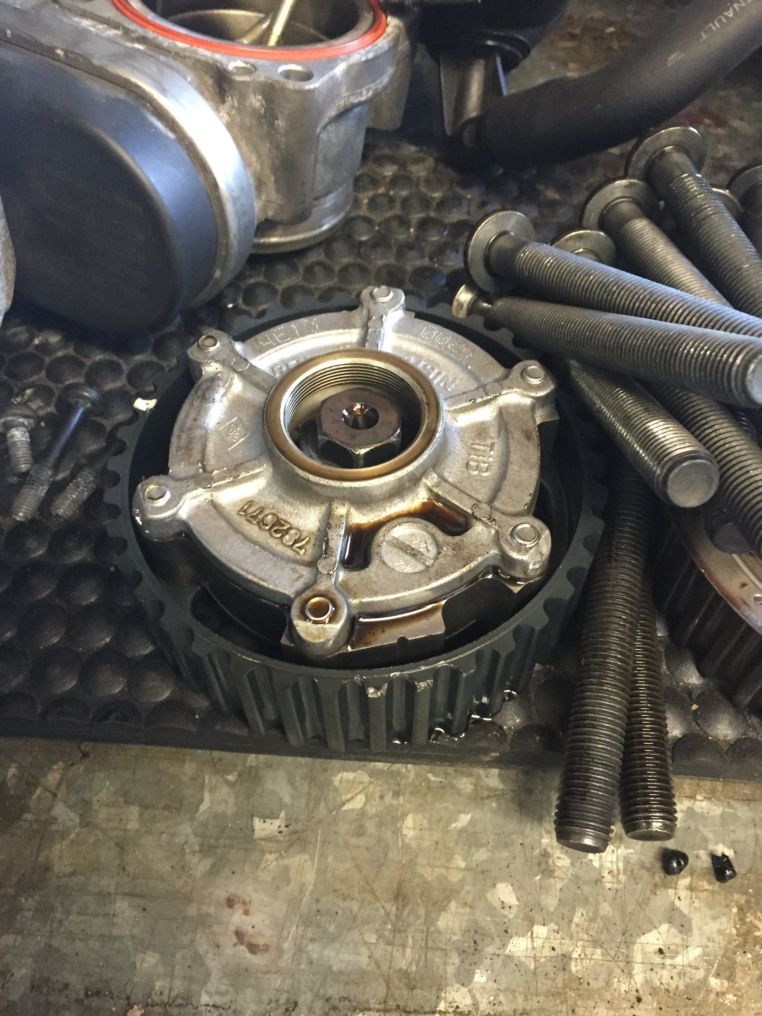

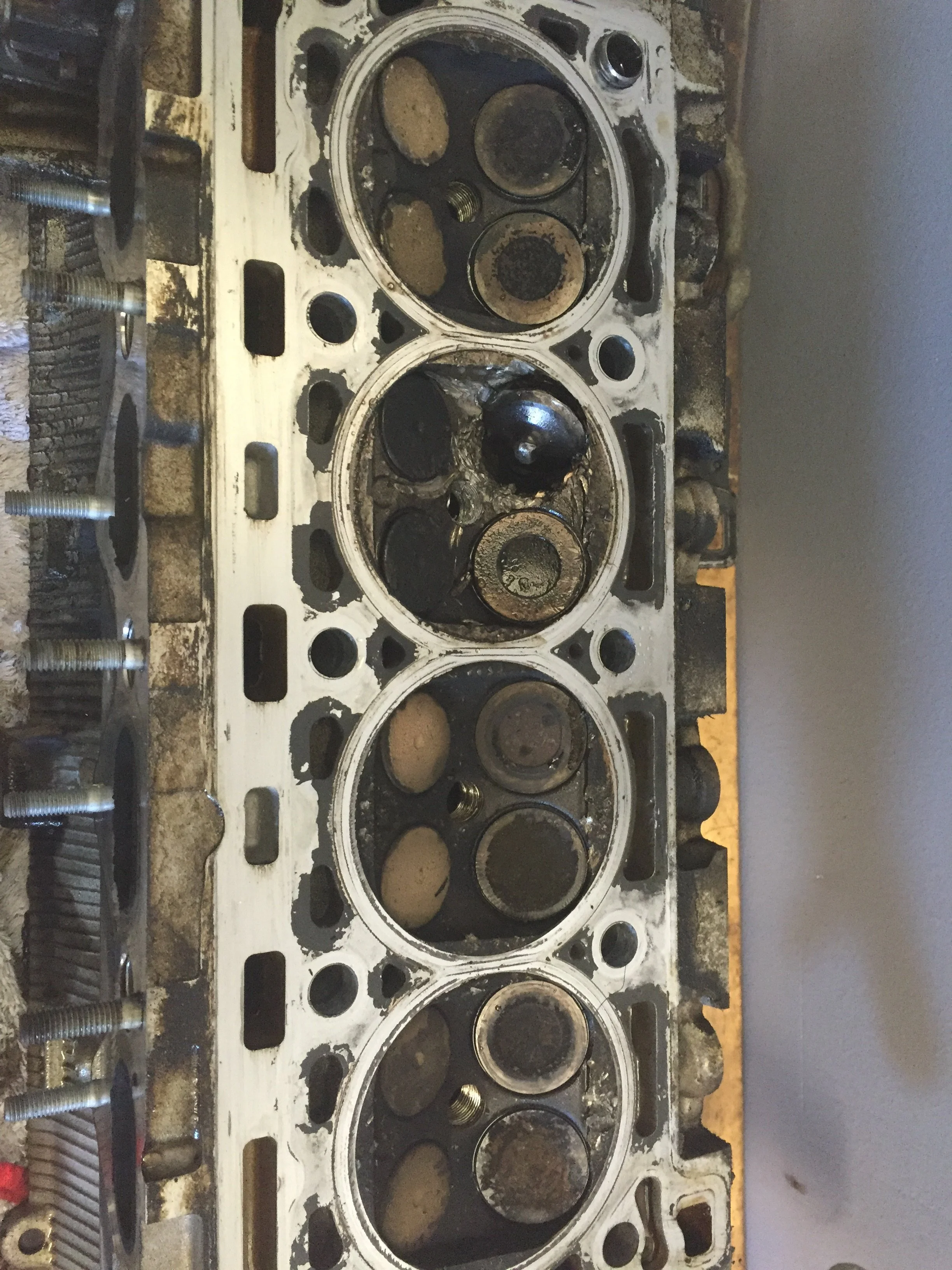

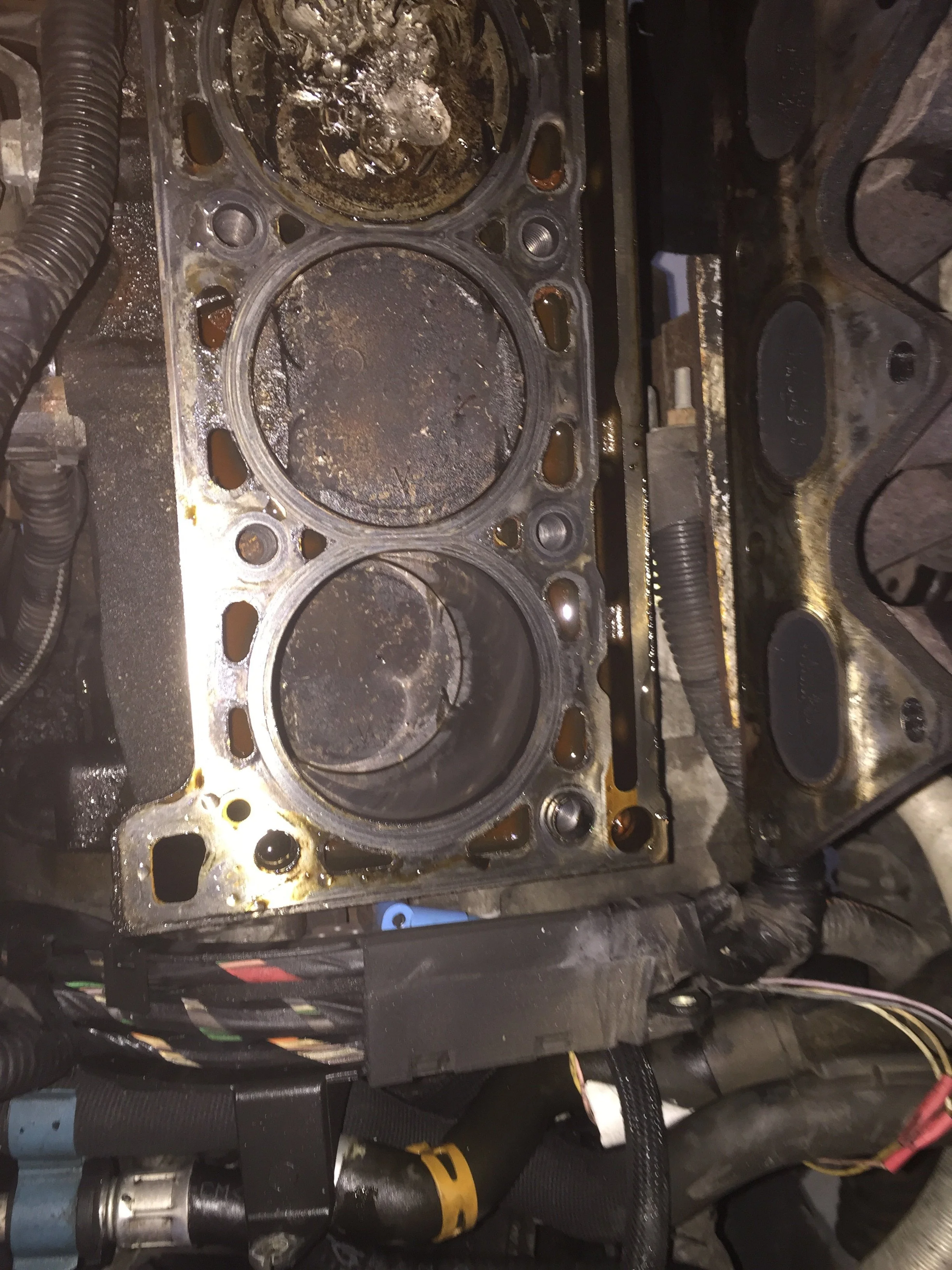

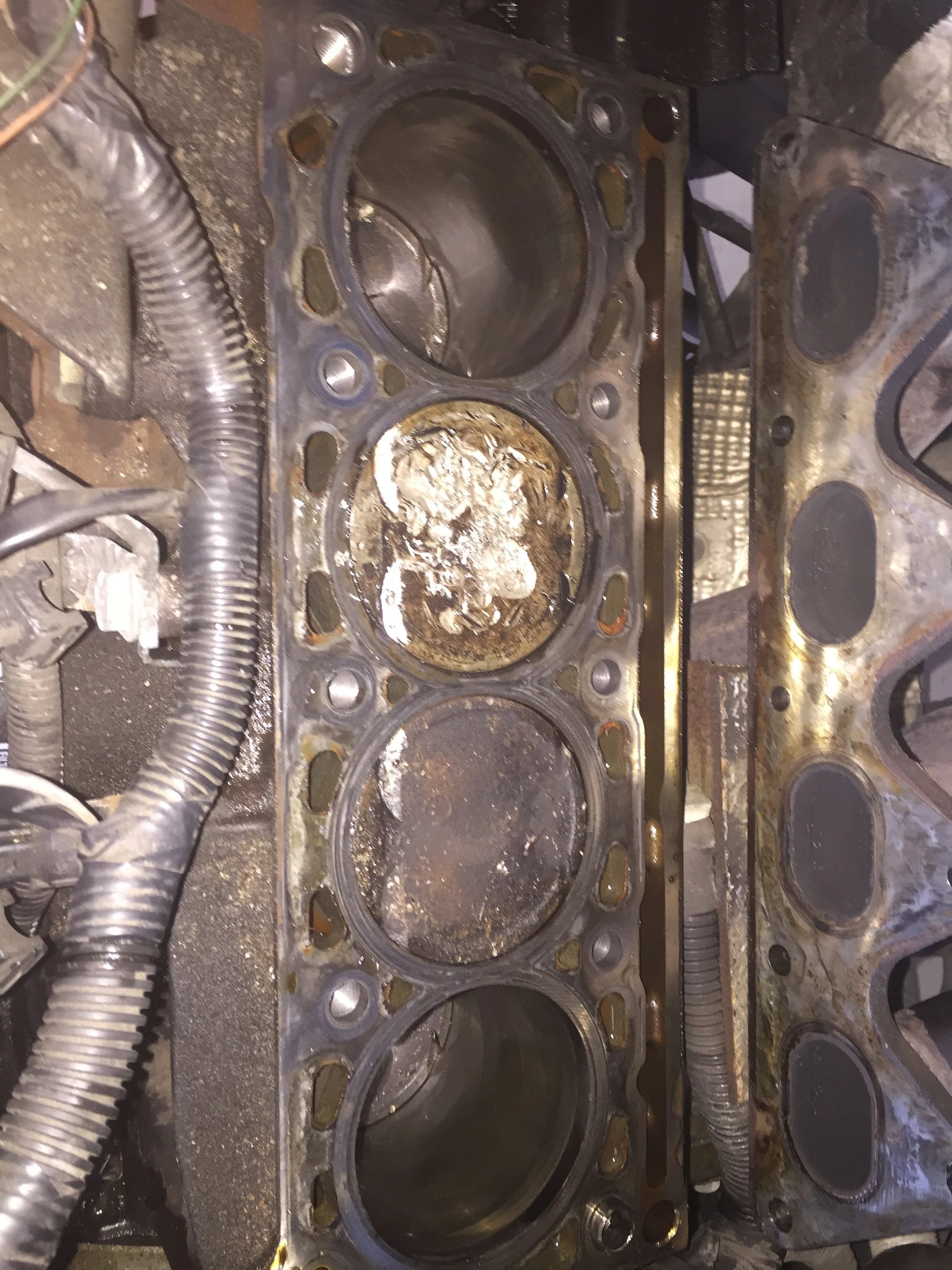

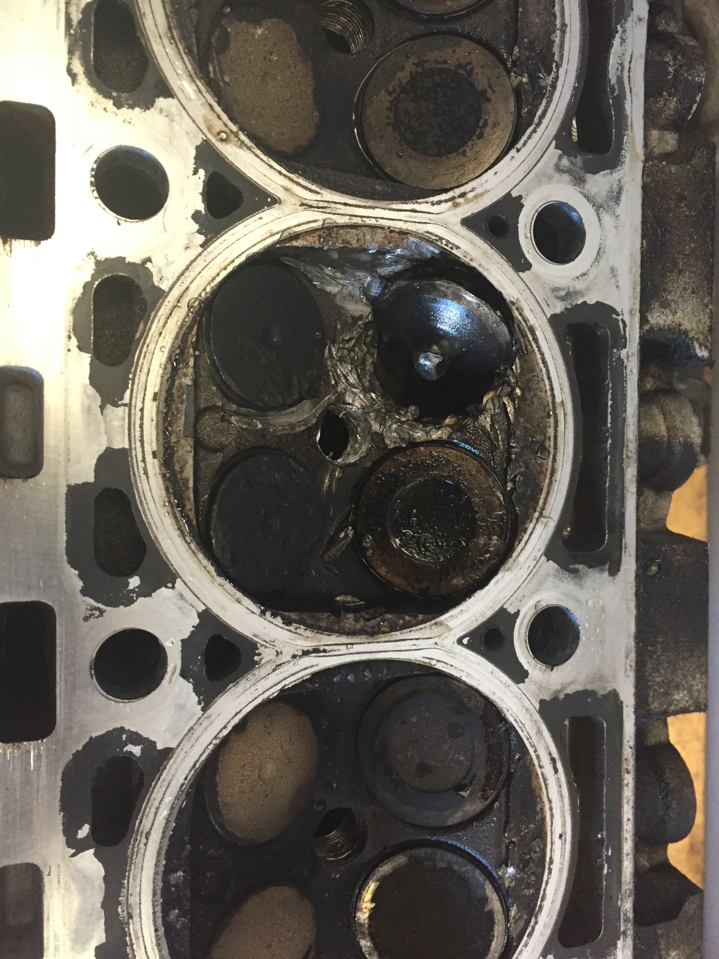

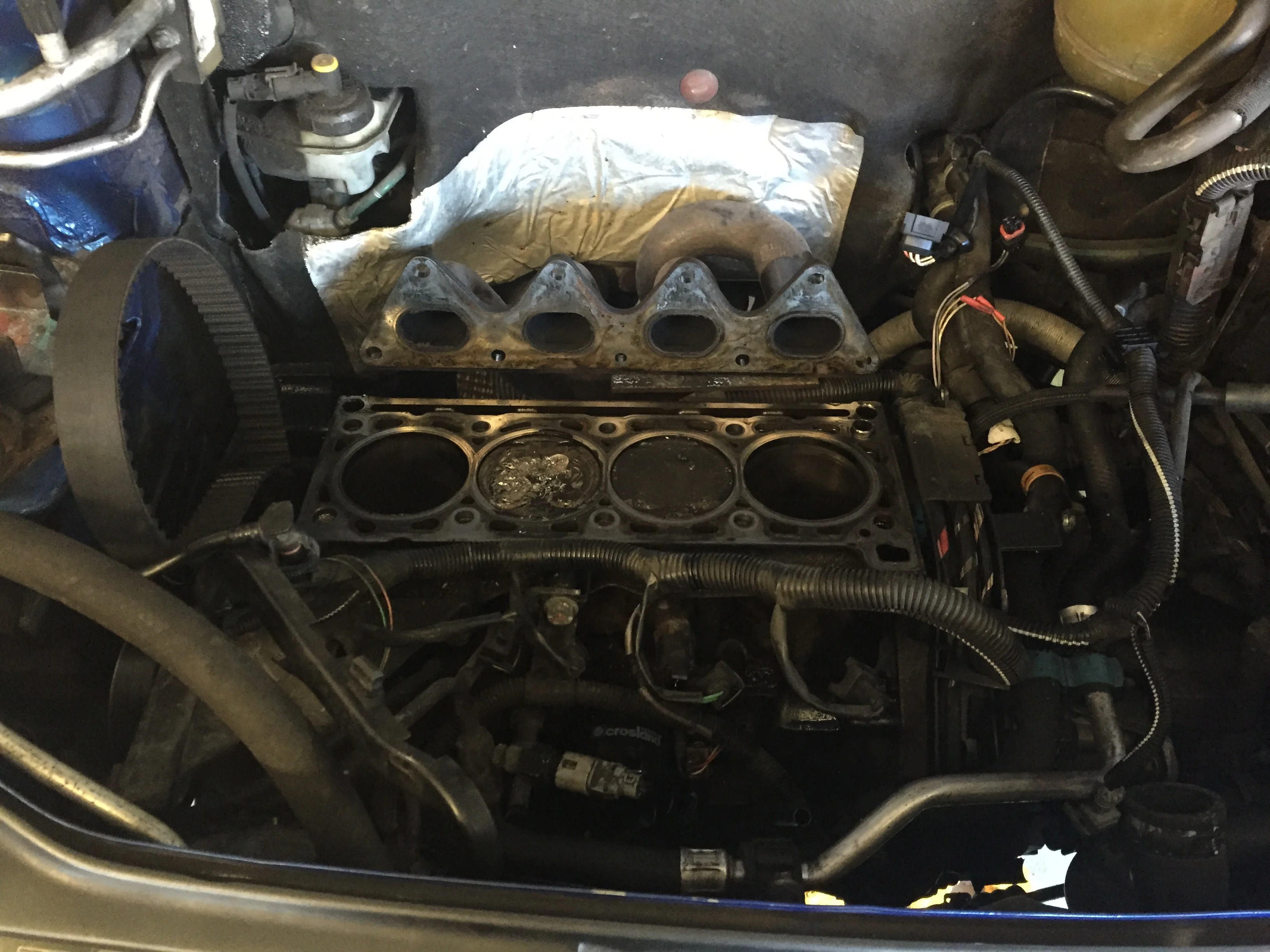

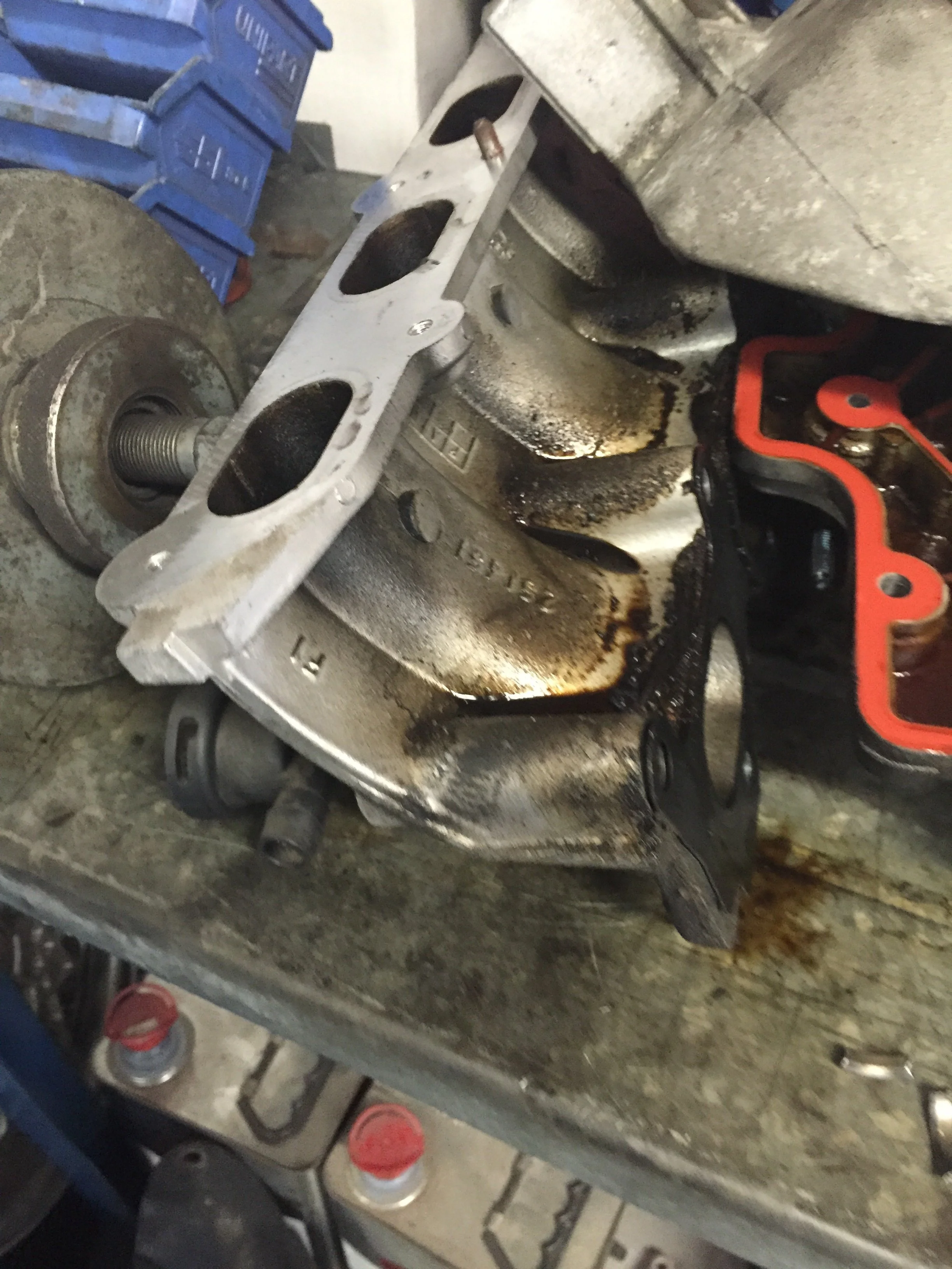

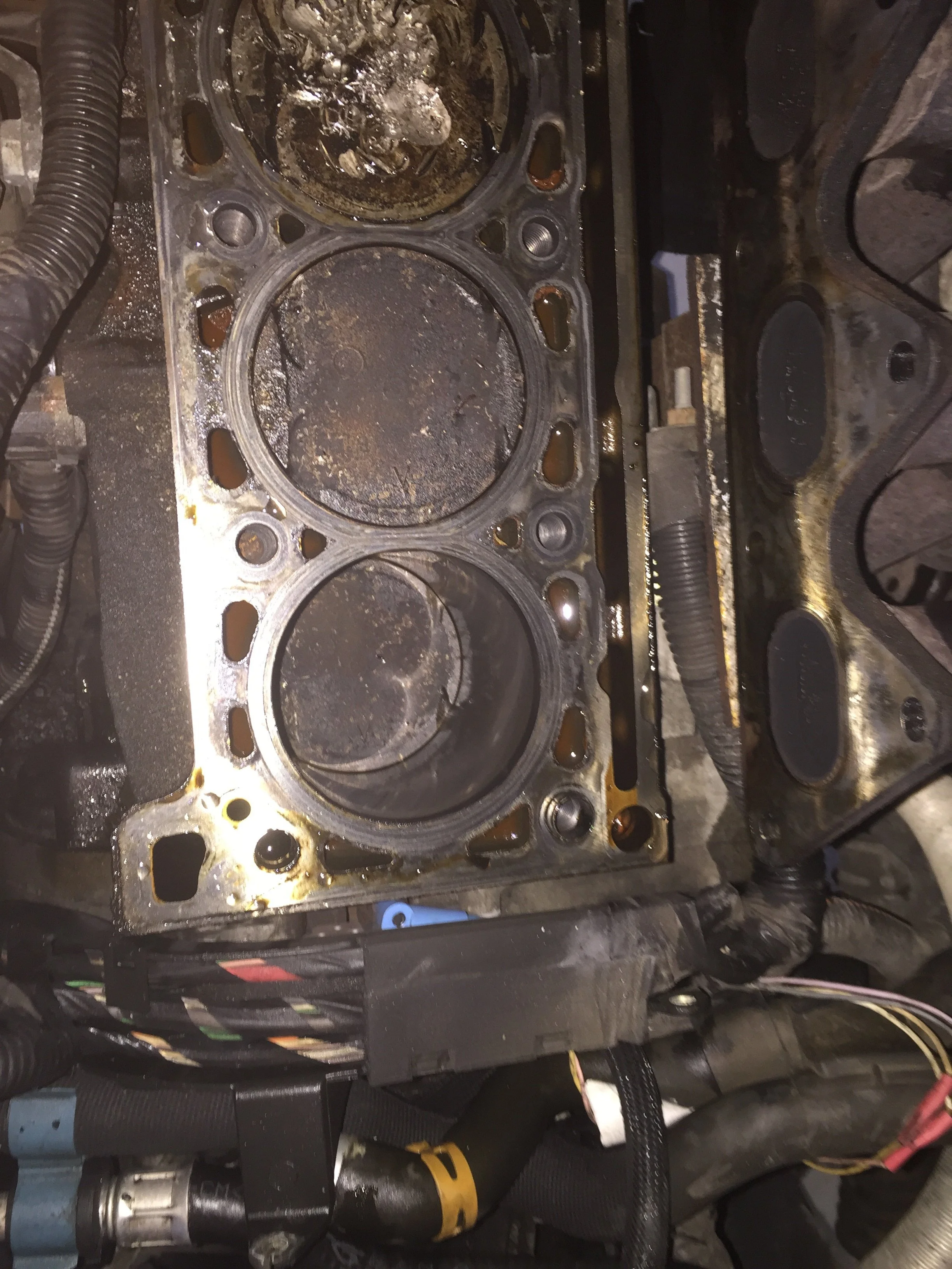

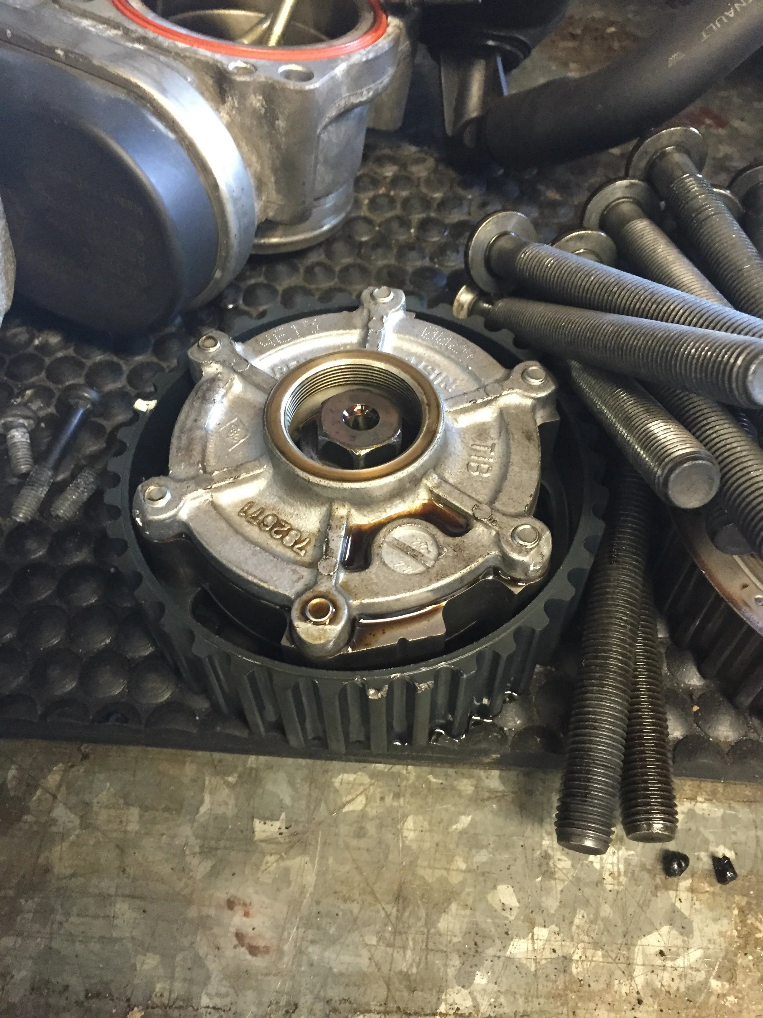

Hello guys been too the garage been informed that the piston is a goner !
Got some pictures that I took .. I need a new engine!!
There is very slight denting marks on the other Pistons but he has said that is from debris that has been chucked in to the manifold and blown back in to the piston chambers!
Don't know if you guys can comment on the pics and let me know what you think

  Renault Clio 182
Guys just noticed now looking at the pics myself but the 3rd piston in from the left looks like there is some indentations of the valves there don't like like just debri damage there? Am I right?

If it were timing issue it would bend the most of the valves. Not Cause that sort of damage.

I can't really see anything on the other Pistons from the pics and would expect something.. Are there any clear markings?
If not, it's hard to place the blame on them and you'll have to take his word.. They might be sound as a pound and totally honest in there findings, we're just guys on computers and phones typing sh1t..
Got some close ups of each piston and valve perhaps unless someone else can actually make anything out..
