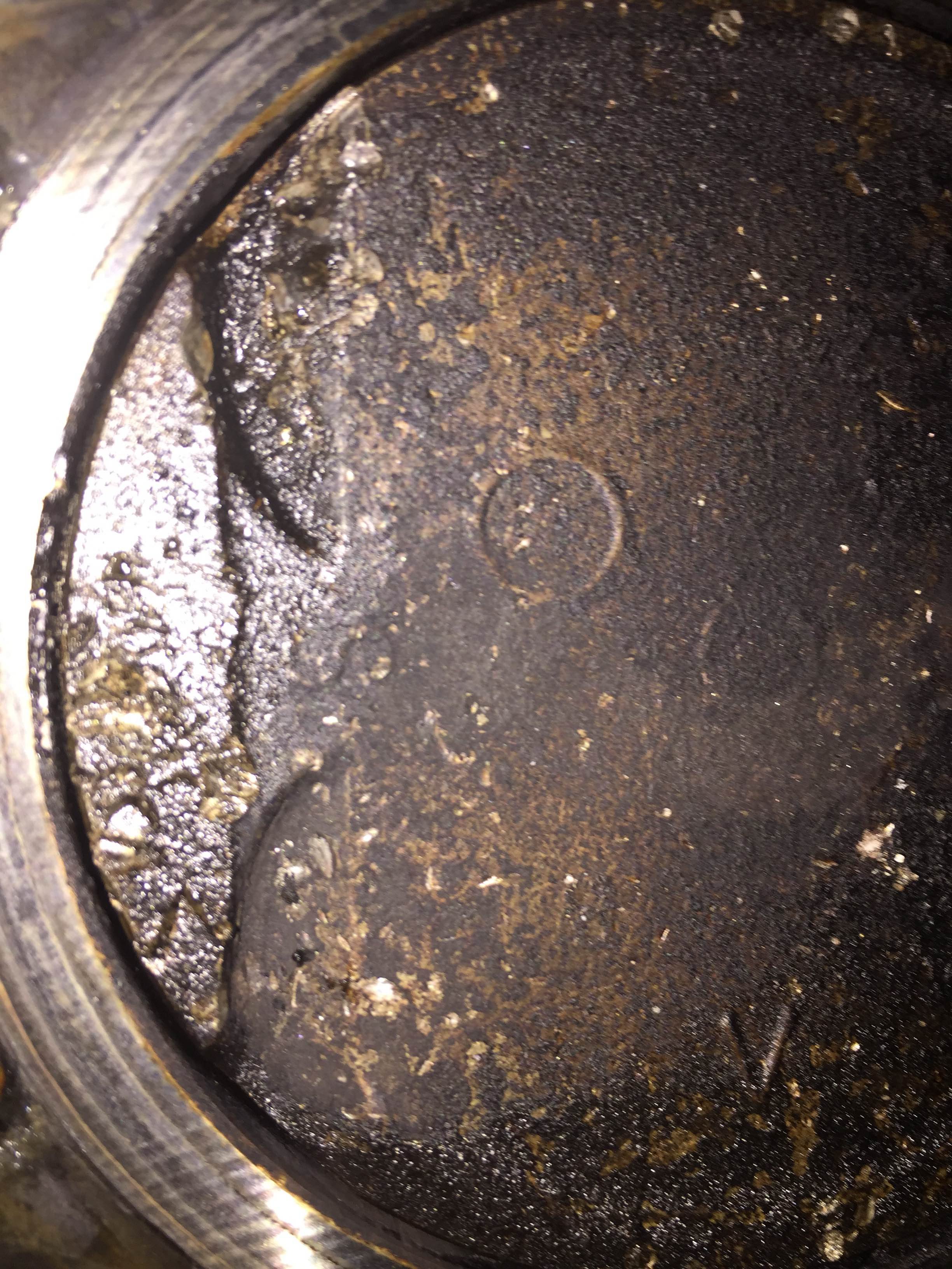

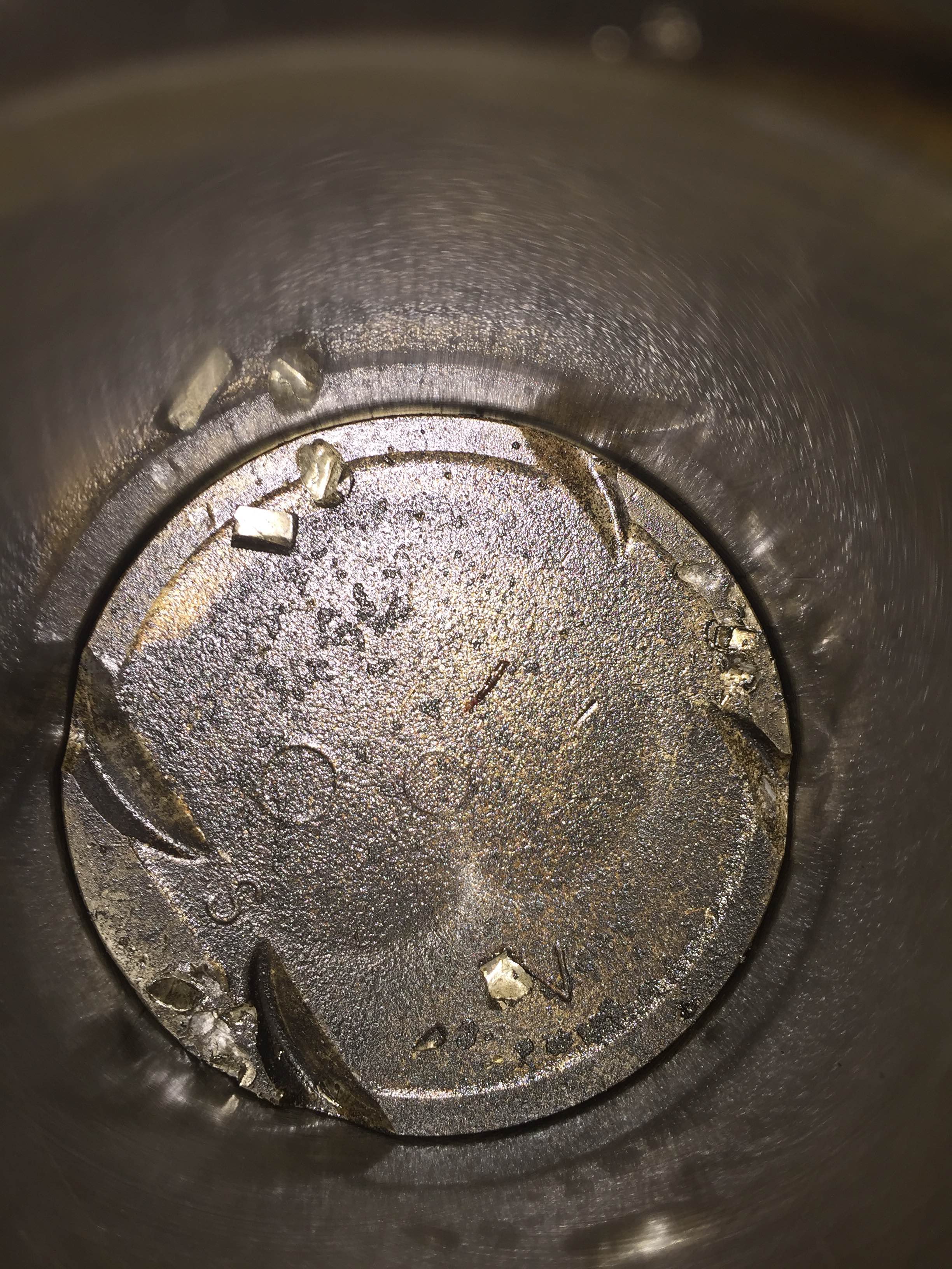

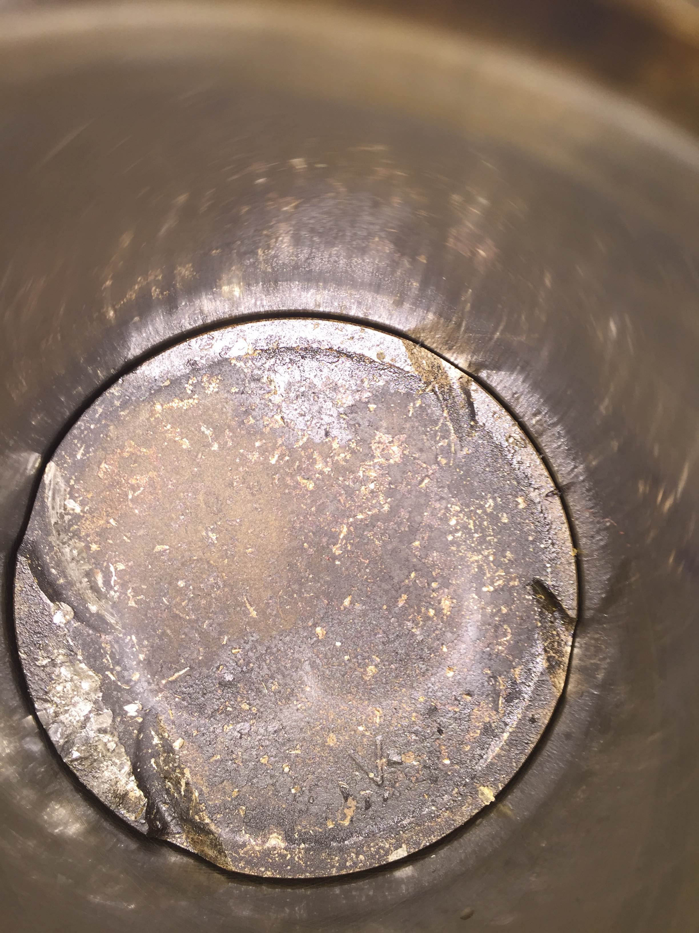

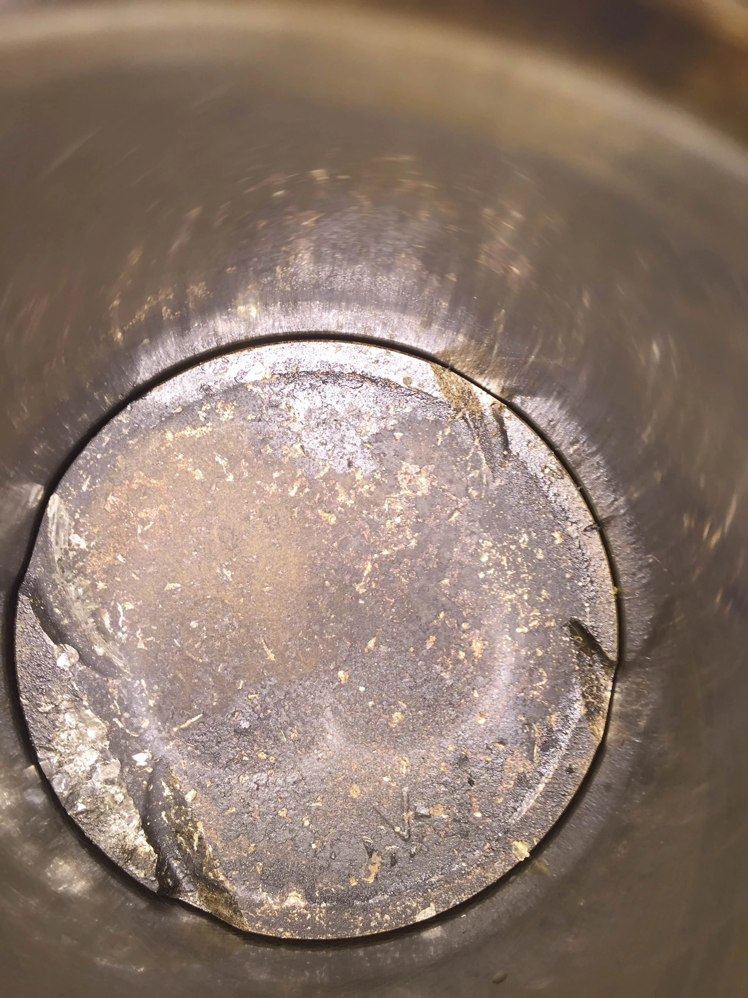

Went back to the garage today to get some close ups. the car is going to stay there until wednesday when it will be recovered to reno-tech in chelmsford.
There is defo the same sort of damage and marks across all pistons but obviously doesnt look as brutal as the heavily damaged one.

What would you expect Pistons to look like even after 100k miles? Should they still be a flat surface? No indentations?
pistons are fine other than damage from dropped valve. Cut-outs on the pistons for valves is normal.
Thats a valve failure on your engine, other pistons have been damaged via bits from the failed cylinder.
So now you know what happened it seems fair to me to pay the guy for striping the engine down and cost of storage in the garage.
