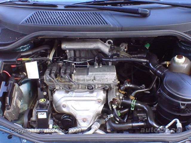

I have been looking for a new engine.. a 1.6l i persume
it lookes like a mess but it has 25 more kw than the original 1.2l engine so it could make a noticeable difference in the performance. The car only weighs 840kg and that's not a hole lot for a 1.6 to handle. I would probably get the engine for like 400dollars or so ( it includes the electronics, the gearbox and a hole lot of moving parts like the gearbox leaver and so on.. ) but i first wanted to check here, if anyone has done a change like this and how did they were with the results.

Looking for a new engine also. Found a 1.6l 66kw 8 valve one for good price and i think it's the winner cause i have been reading a lot of mk1 project's that have like 1.8l 16valve to 2.0 16valve engines and theire not so reliable at all :(
The 8 valve one would be cheaper to modify also though it only has 8 valves and the cost half the price as 16 valves :rasp:
I'm not too worried about the power cause i can always put a turbocharger on it and modify the intake what doesn't cost that much at all if you have set a target what power youre going after and not going grazy about it :D
