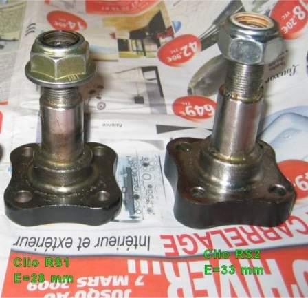

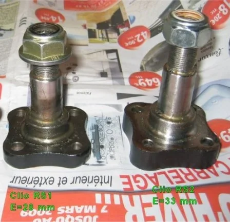

Stub axle is thicker where it bolts to the beam fwir to widen track, think 10mm but can't remember if it's 5mm per side? The 172 sized cable and up ever so slightly short on the outer, it's literally about 3mm as well!!
  PH2 172
Forgot about the stub axles on the back, 182 is still narrower than 172 Cup, with it`s et45 ( sorry I said 42 last night ) wheels.
I`m still puzzled you say the 182 cables will not fit the 172 as the outer of both are 1101cm LH & 1170 RH in all the catalogues I have seen.

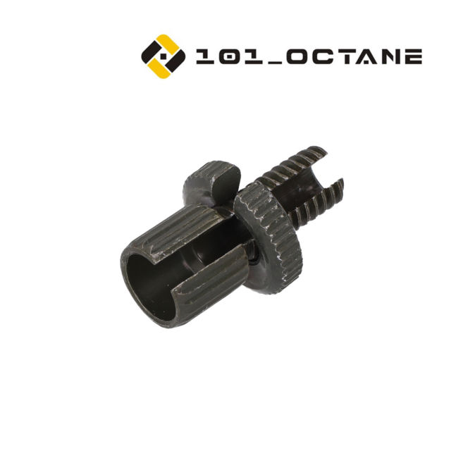

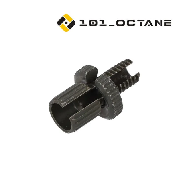

Stick one of these in.
  PH2 172
the 182 fits the 172 but not the other way round.
That`s what I meant.
So you are categorically saying that OE Renault 172 cables will not fit a 182, and that the outers are too short on both sides?
If you are referring to pattern cables, it would not surprise me if they did not fit either 172 or 182.
