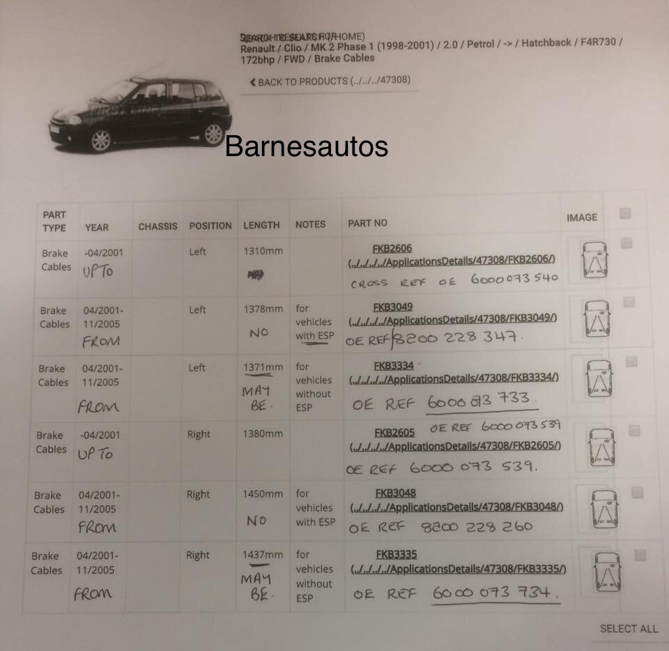

They have discontinued the 182 handbrake cables. This is my point. I got a first line one today. Will it not fit?
@bloke seems to have had some problem in the past.
All aftermarket LHR cables 8200228347 seem to have been manufactured to a specification of 1378cm total length, and an outer casing length of 1101cm.
If yours measures this, and does not fit, there has been a monumental c**k up.
I tried 2 different pagid ones from ecp, one was listed for a 182, the other for a 172
Both were fine in actual length of the cable, but both were about 2cm too short on the outer cable casing so it wouldn't slot home properly in the caliper
Correction, 1378mm/1101mm, not that anyone has noticed that these would fit a coach.

As a general rule if it isn't colour coded and has a white clip on the car end it's not going to fit.
This was my findings
I got an O/S Genuine Renault 182 handbrake cable a couple of months ago from my mate at local Renault Main Dealer no problem.
Fitted it no probs.
