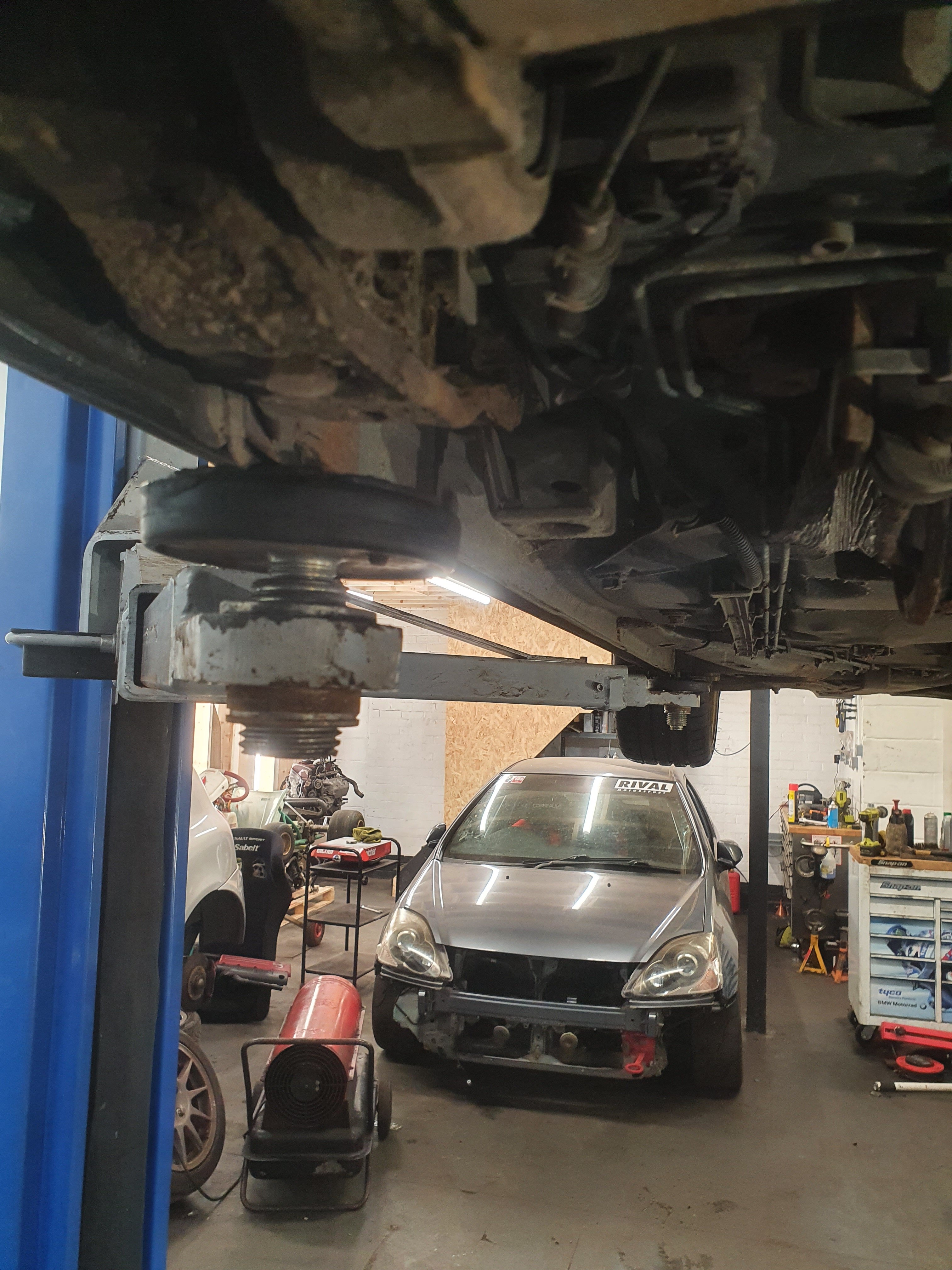

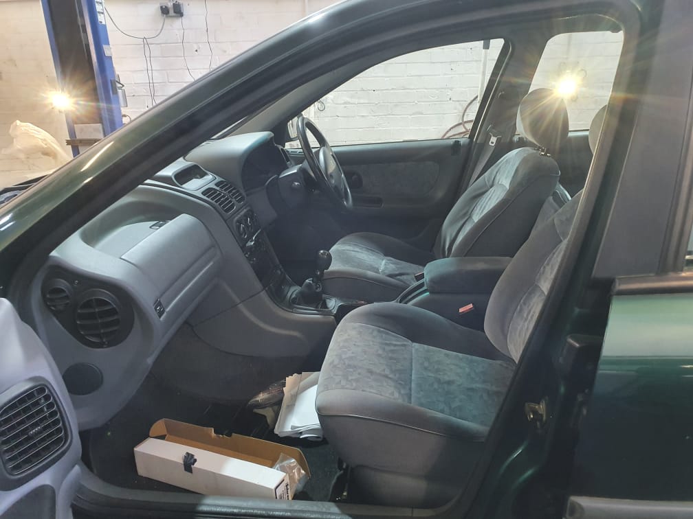

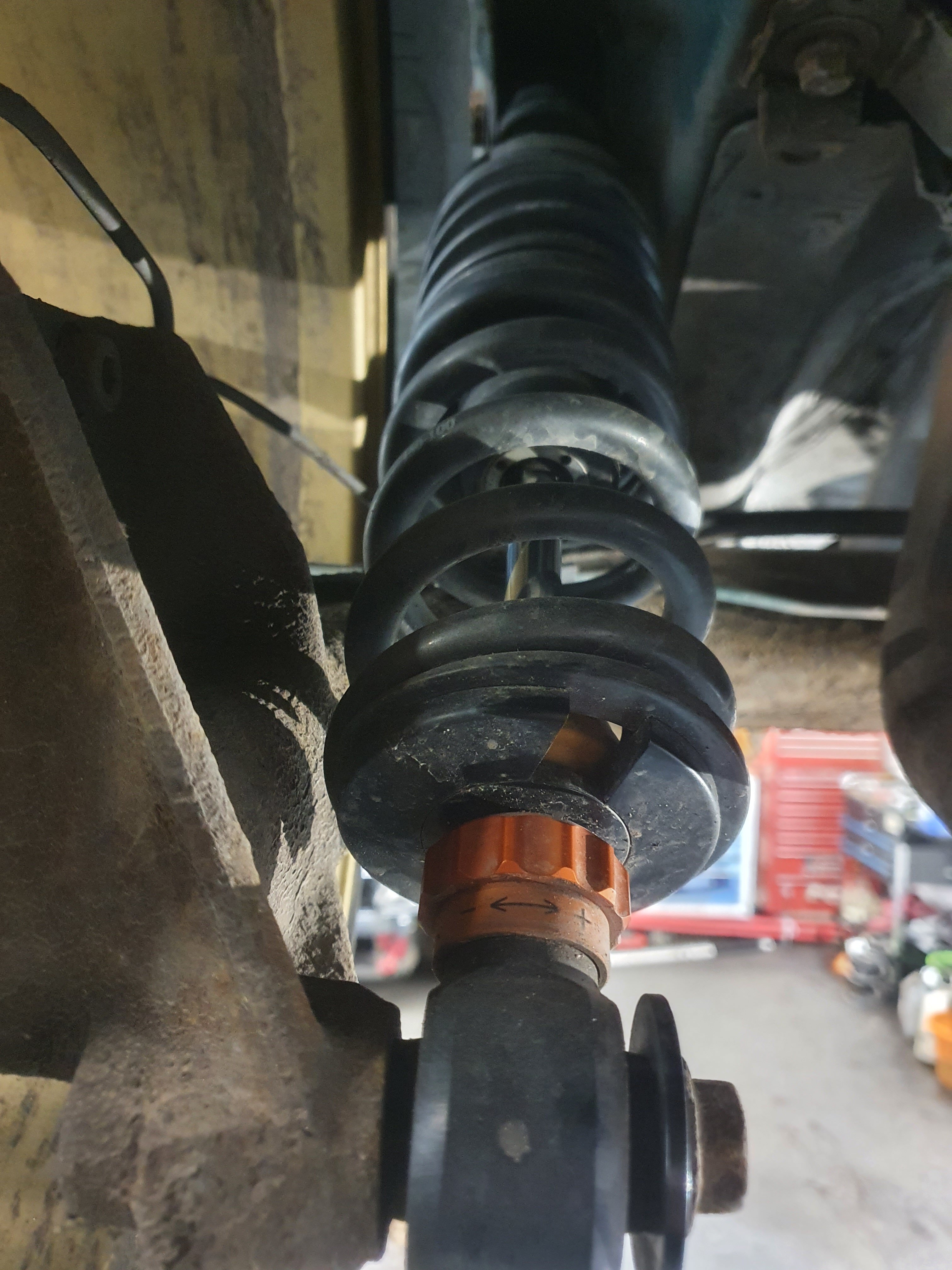

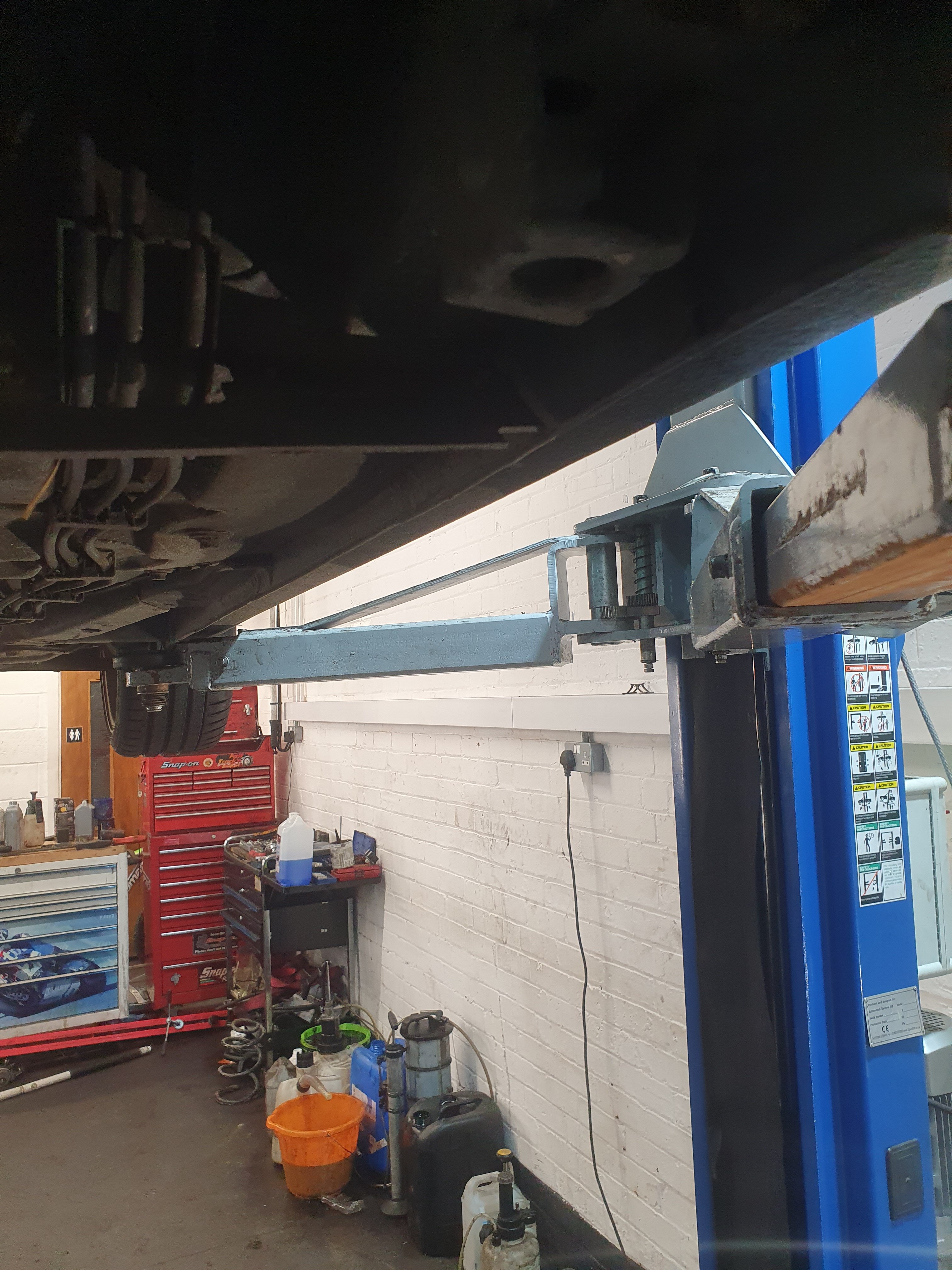

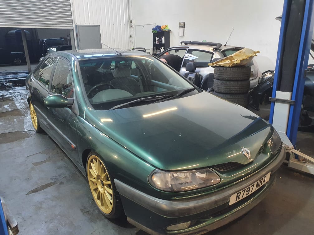

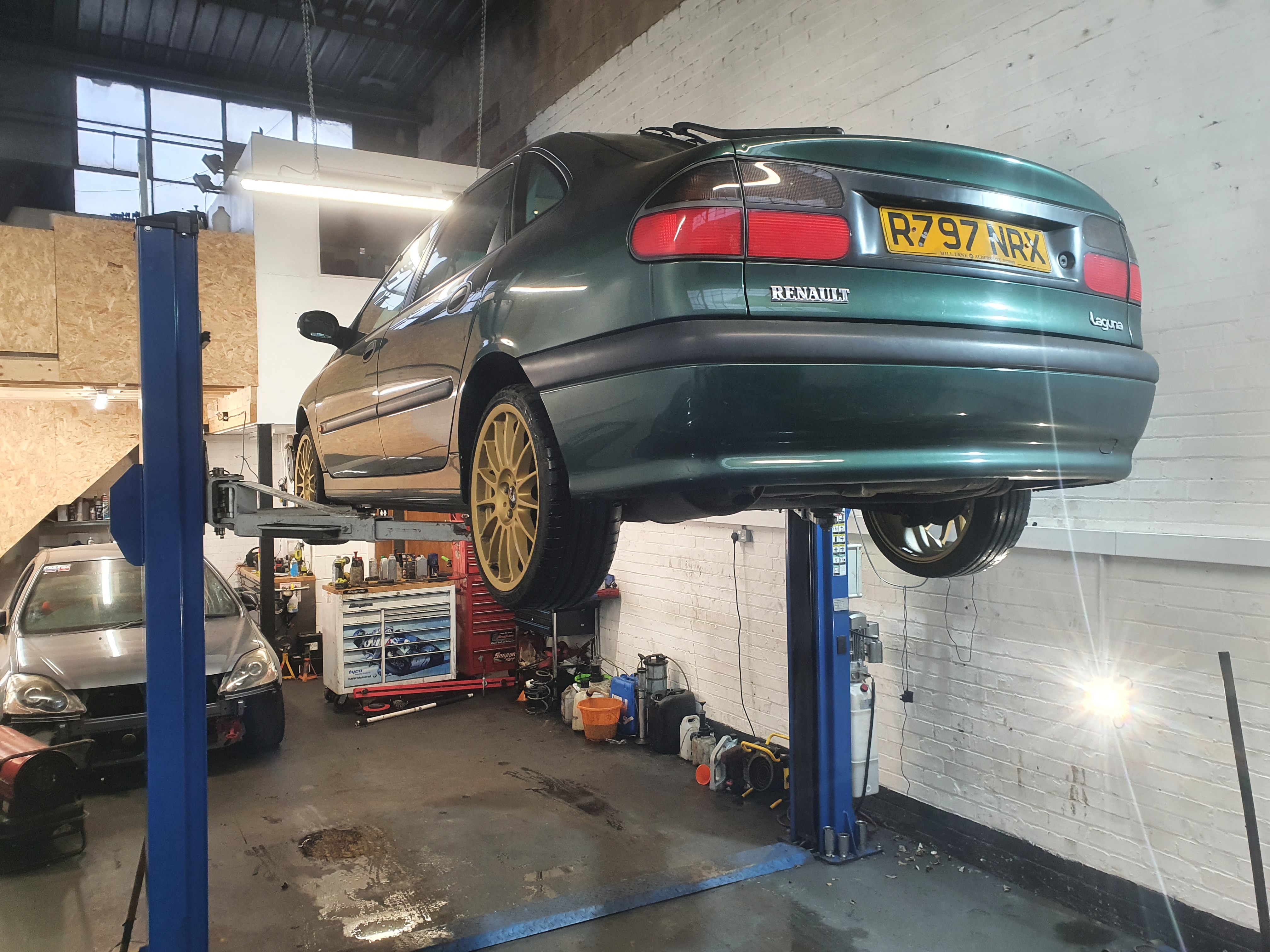

So had it up on the ramp today as I had a spare 5 mins and I'm a happy chappy!

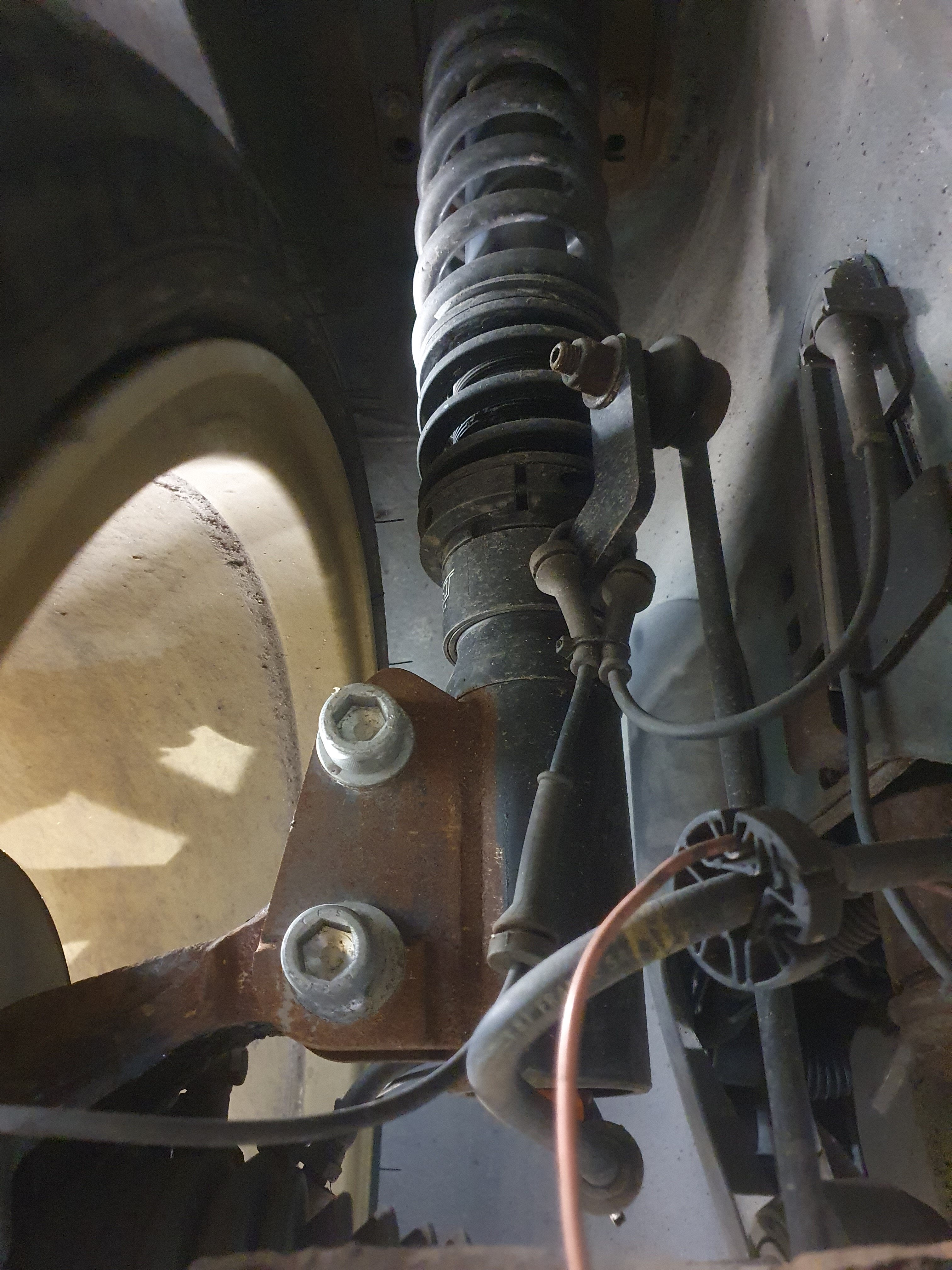

Its a very solid example to be fair. Love the AST suspension thats been fitted too.

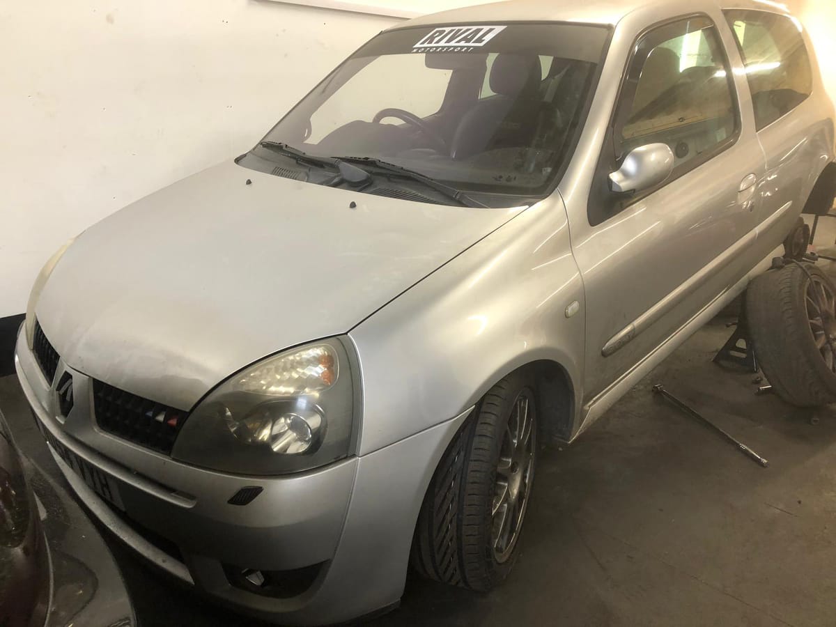

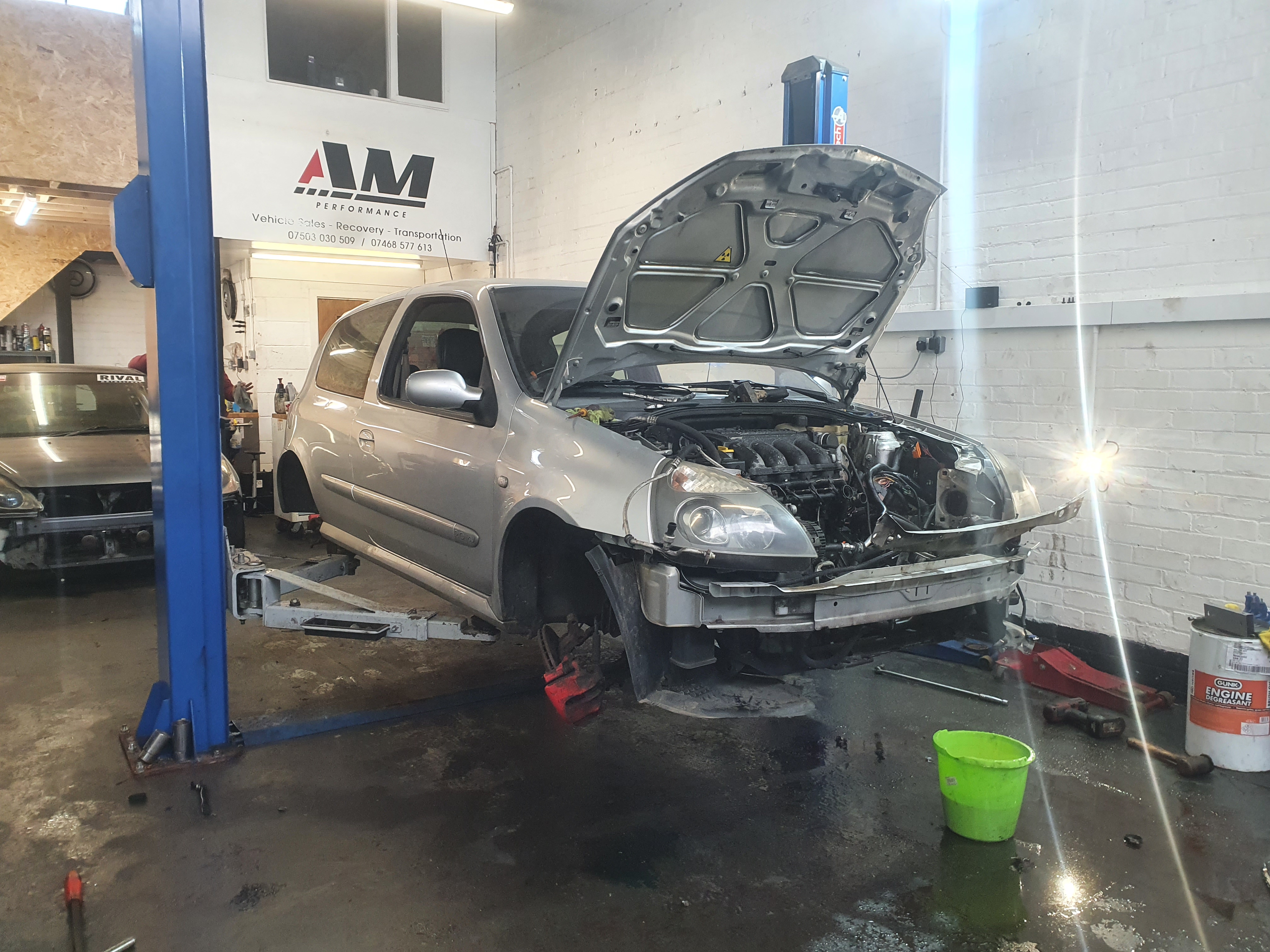

Hopefully come the start of next week ill get on with breaking the 182. Once the engines out of that I can get the laguna engine out and check fitments etc.
Plans are in action with Sam at arc for the cage come the start of April.
And yes in answer to the above questions it will be getting the full nescafe graphics treatment.
getikte
For everyone interested i will be putting the 182 up on the wider sales pages for parts tonight. If anyone here would like bits drop me a message. everything available other than the engine, loom and running gear.

So. Progress!
Thats the engine out of the 182.

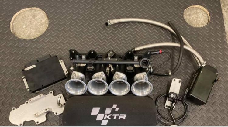

Also over the weekend managed to purchase a set of KTR ITBs complete with gen 90 ECU.
Not sure how to beging on getting the laguna electricals to speak to the gen90 but thats part of the learning curve.

Why not just use the Clio dash/clocks in the laguna and make a separate loom for the ancillaries?

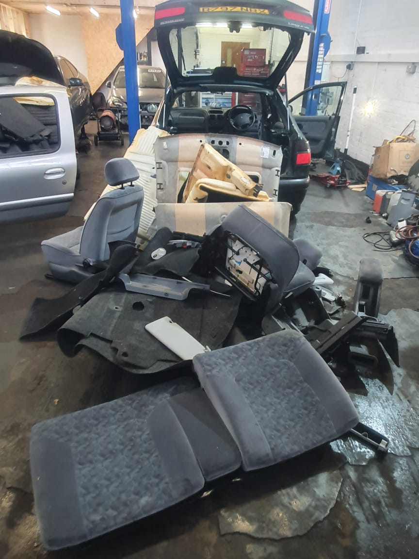

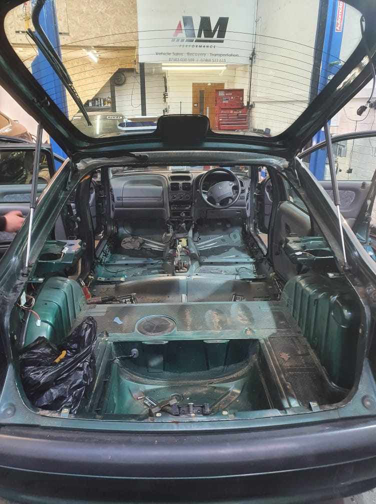

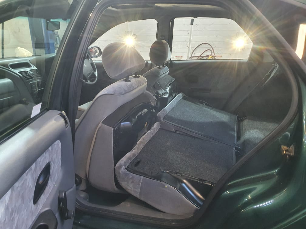

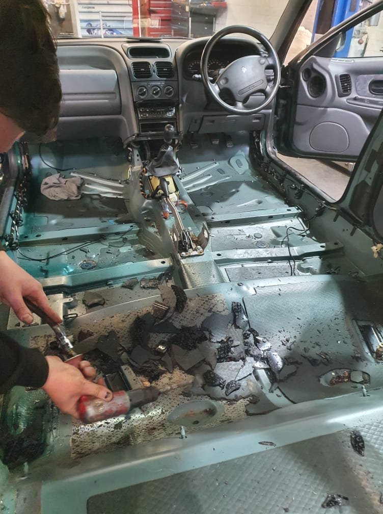

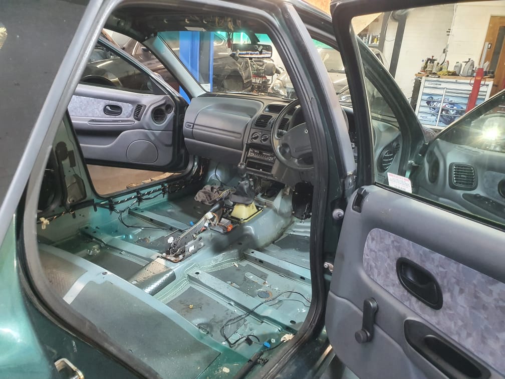

Spent the afternoon starting the strip down of the laguna. Really happy with the condition of the shell overall and im amazed how weighty everything in there is for a 90s car!
The car is booked in on 1st April for its cage so its nice to have a deadline to work with for that.
Still needs the dash out, sunroof out and carbon delete fitted and the fuel tank out along with doors removed and windscreen out in prep for the cage.

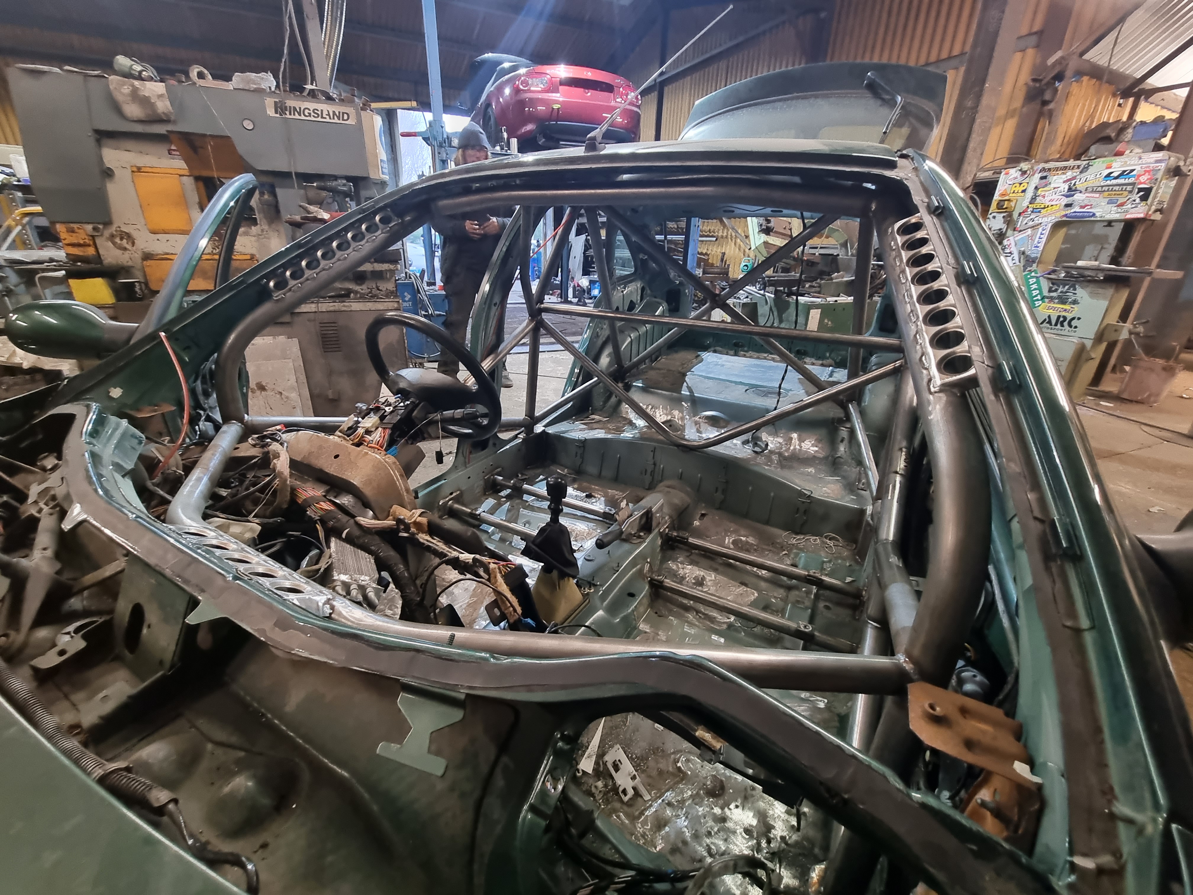

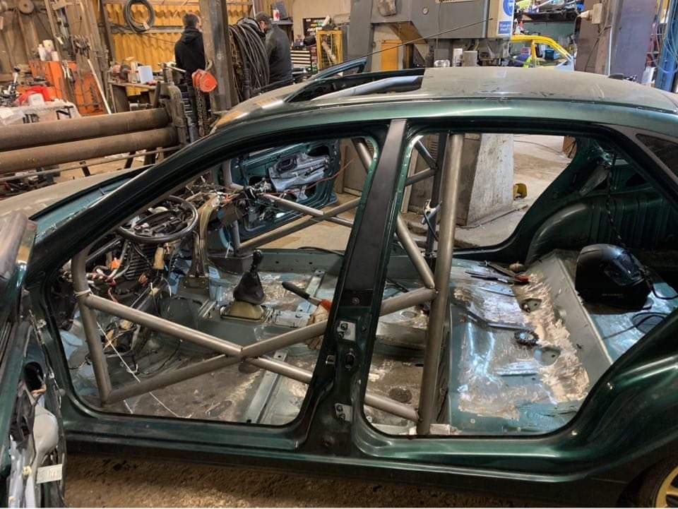

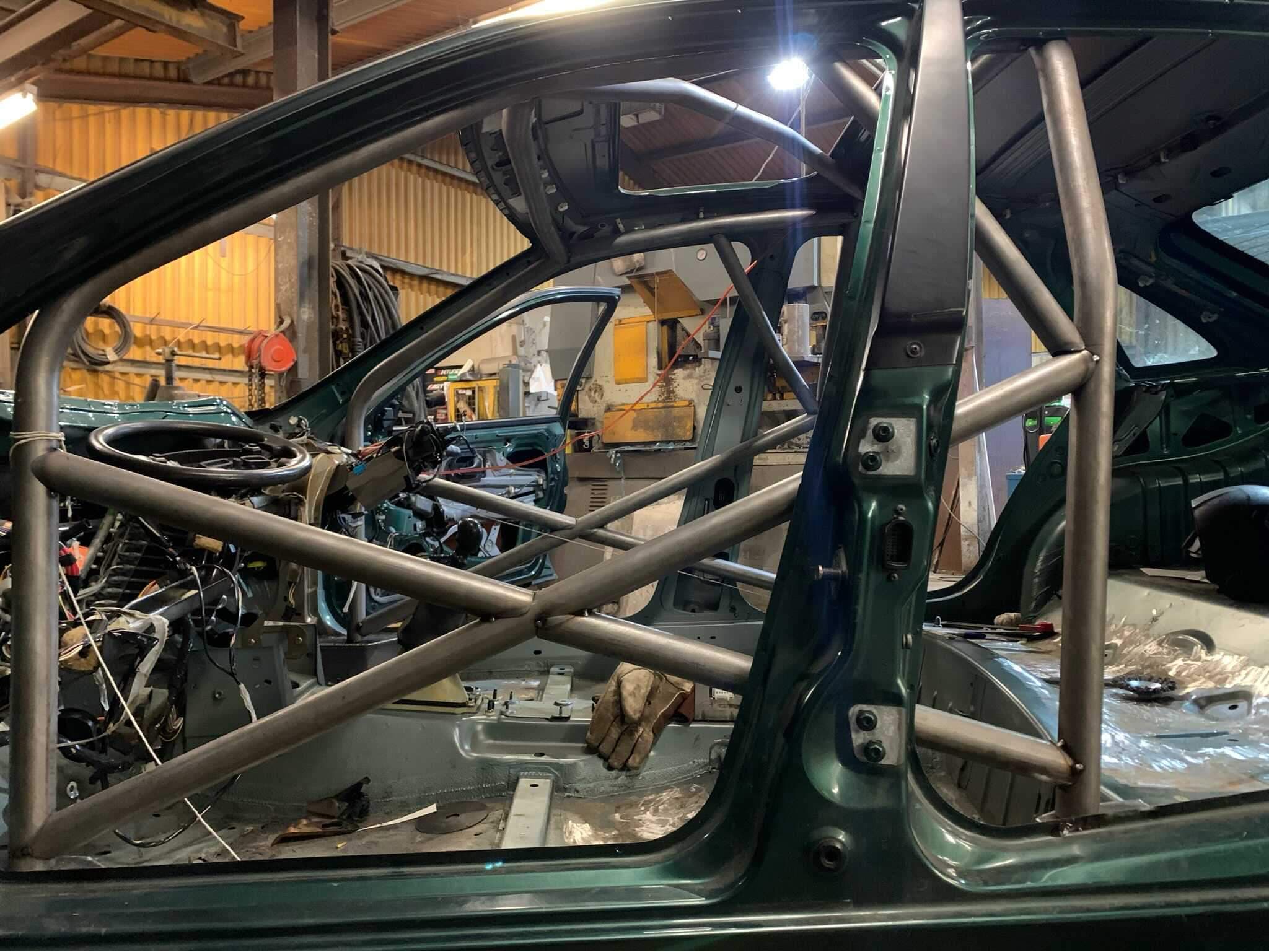

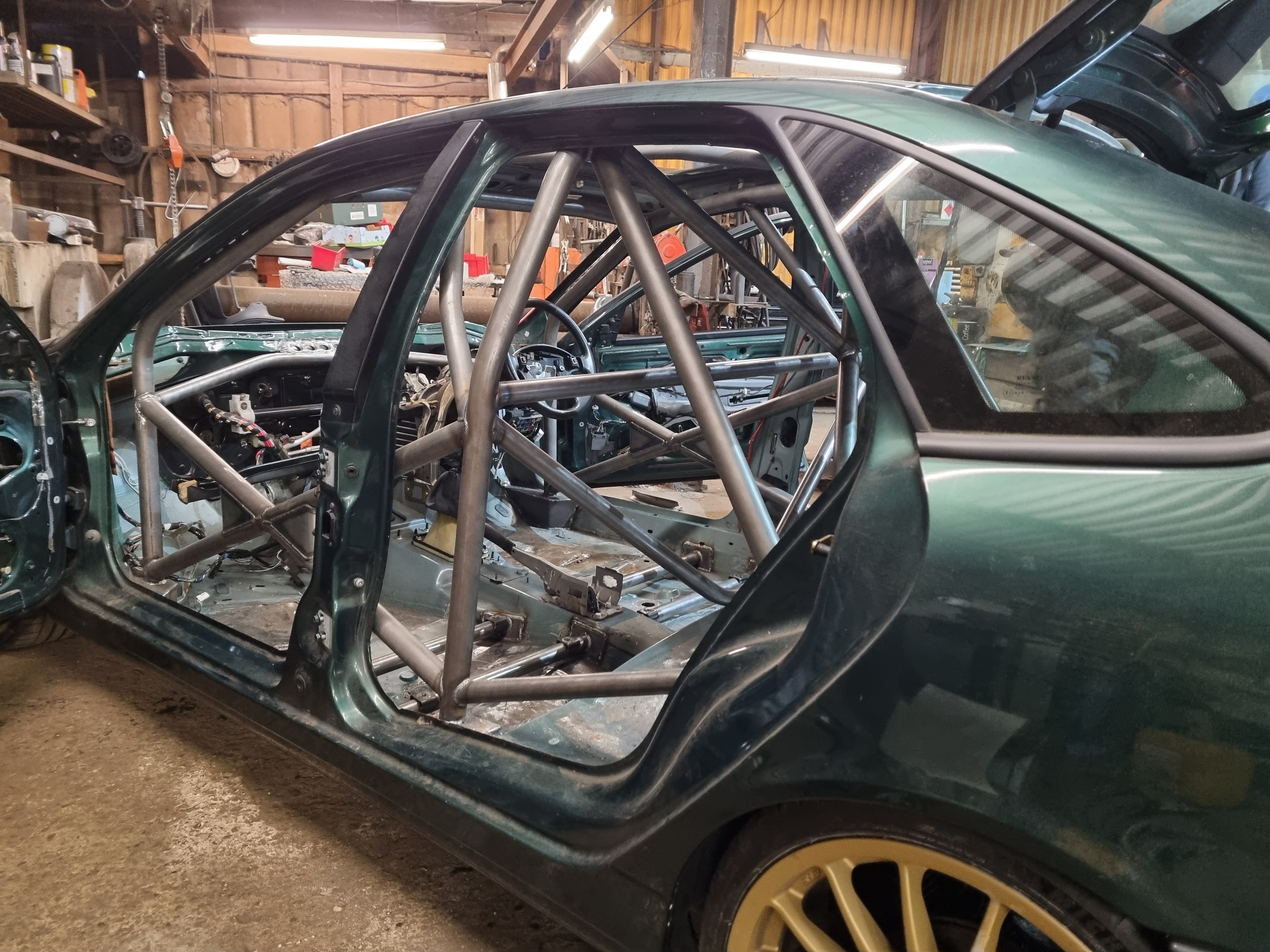

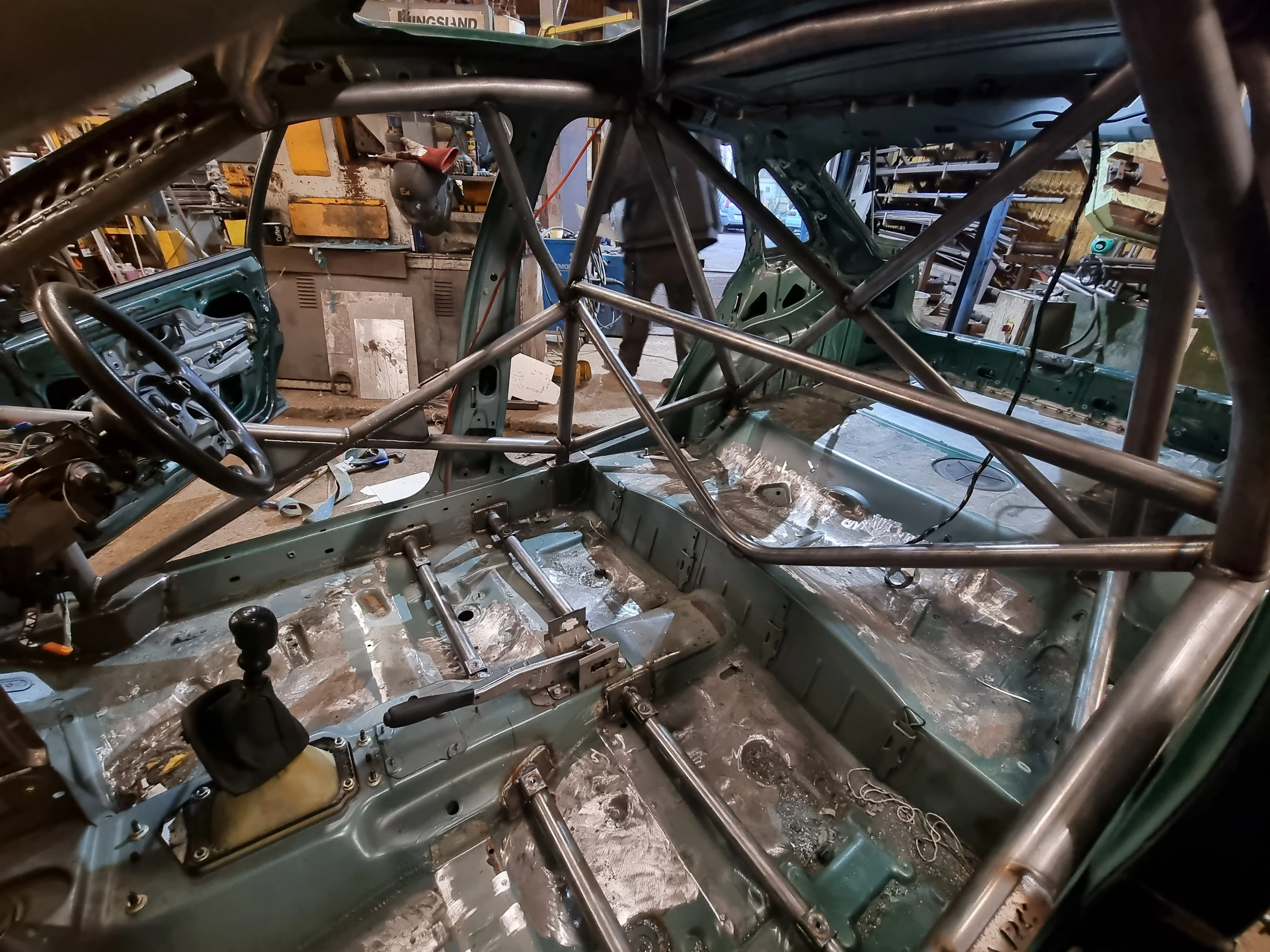

I got a couple photos of the cage progress from sam at ARC today and so far so good.
Im also having him do a flat floor on the rear whilst its in with him so quite a good bit of work going on.
Im taking the cup racer seats down on monday next week i think to do some seat bar fitting which will suit me then its booked in for an interior paint shoot the following week.
progress :)
getikte
Sam has been studying photos as best he can of the super tourers cage so its going to be pretty close to that.

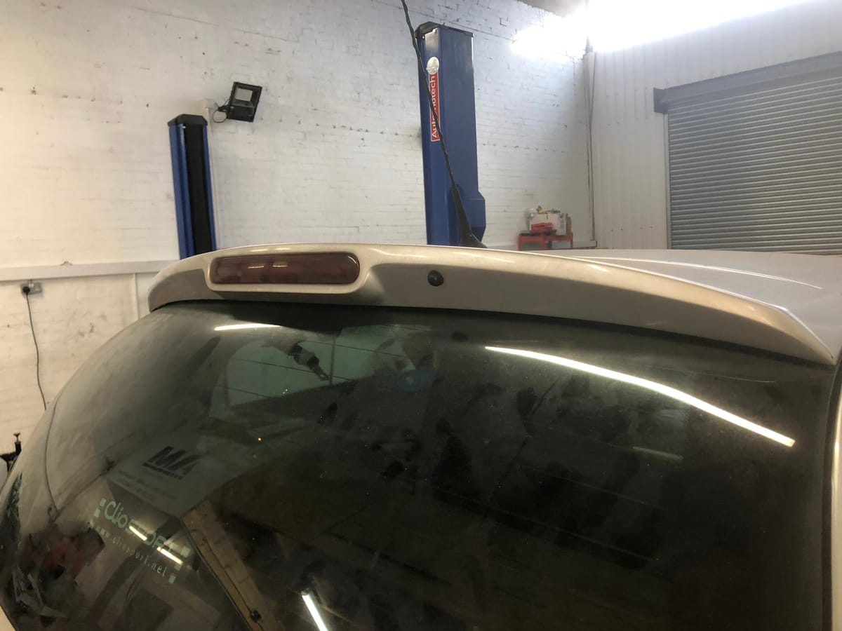

Fair, just noticed it in those pictures and didn't know if you were going to get it filled in properly or blank it off or put the glass back in.
The whole thing weighed about 25kg so it's defo not going back in! The lad next door to me makes Custom Carbon fiber parts so I think I'll ask him to sort something

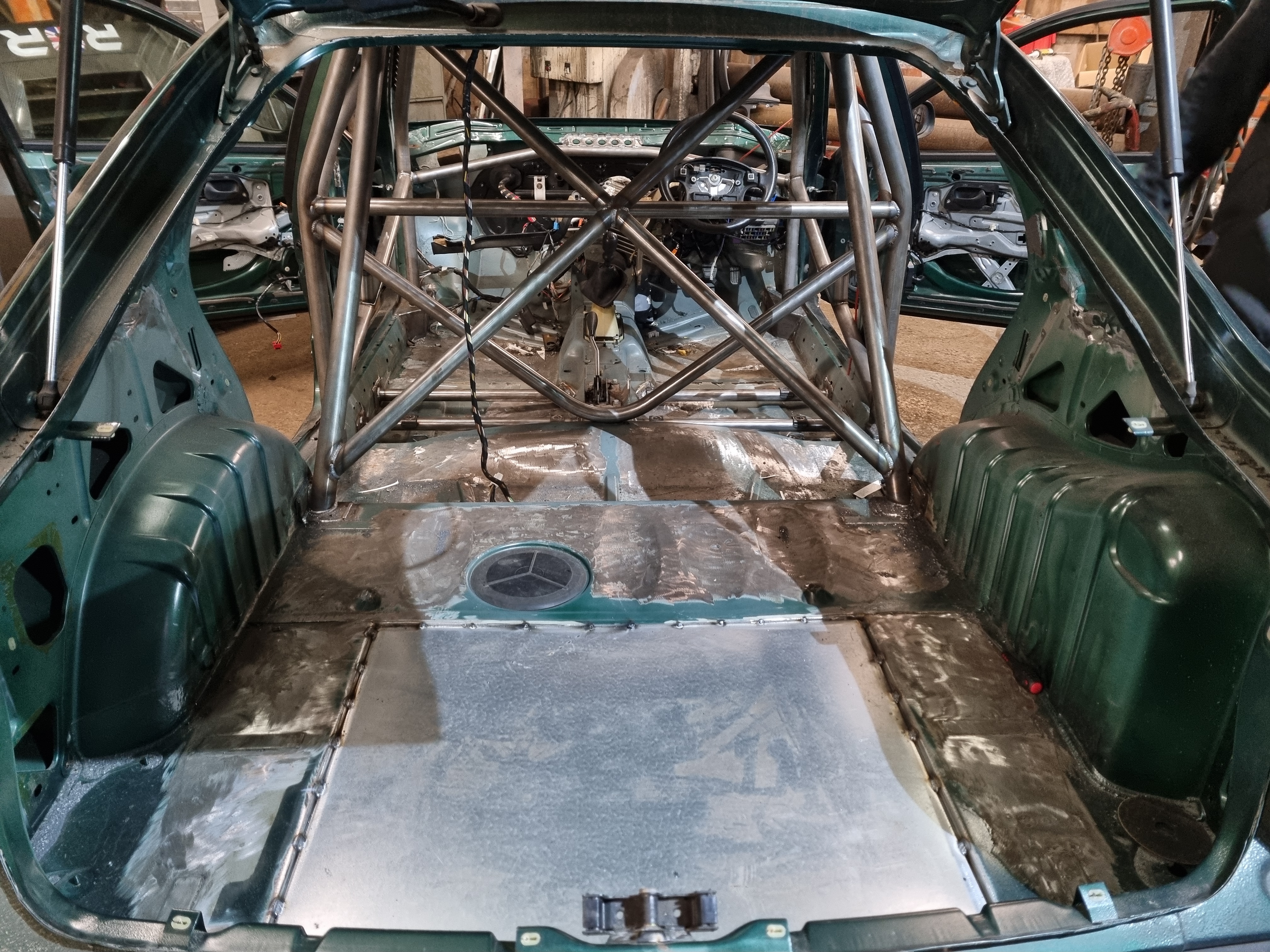

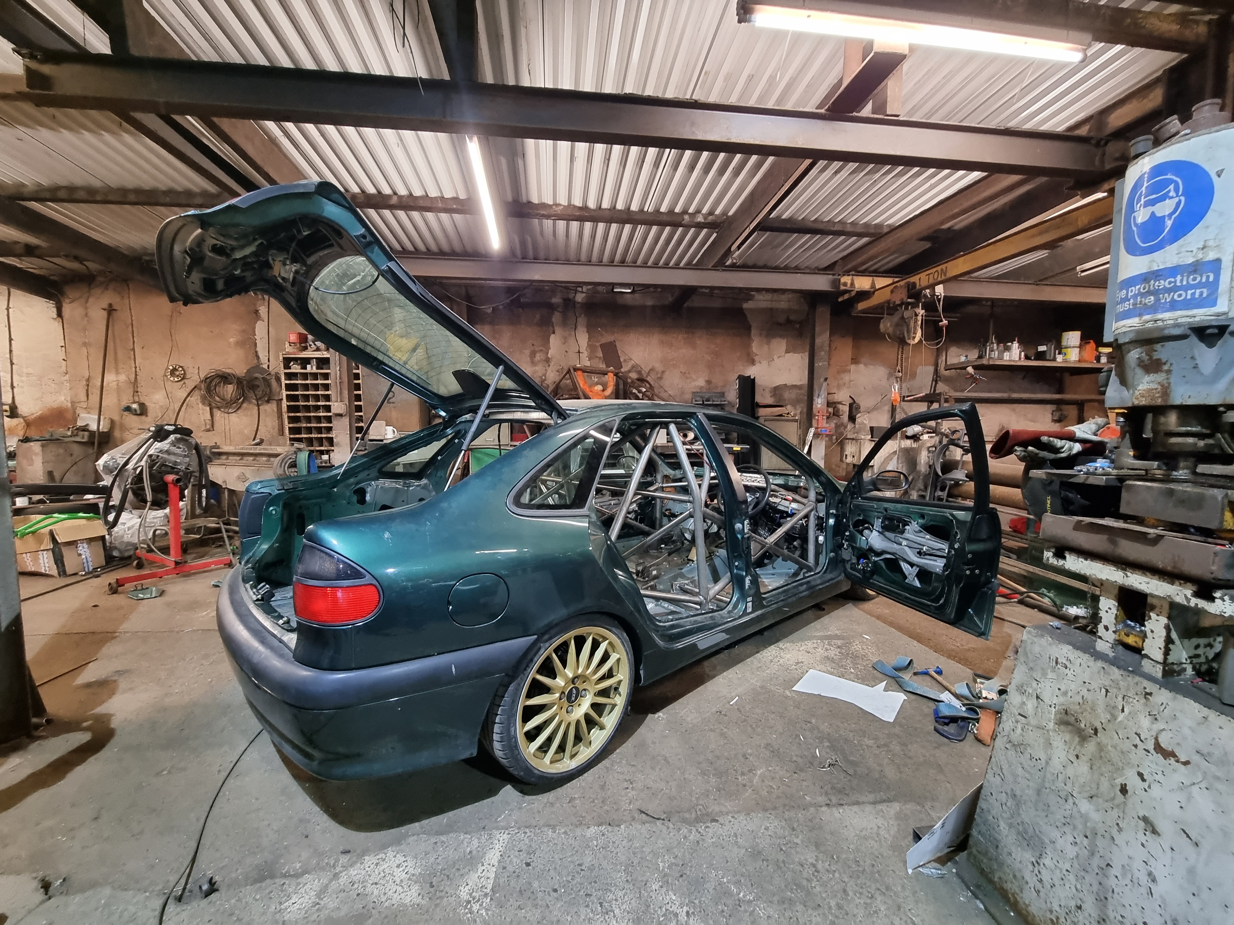

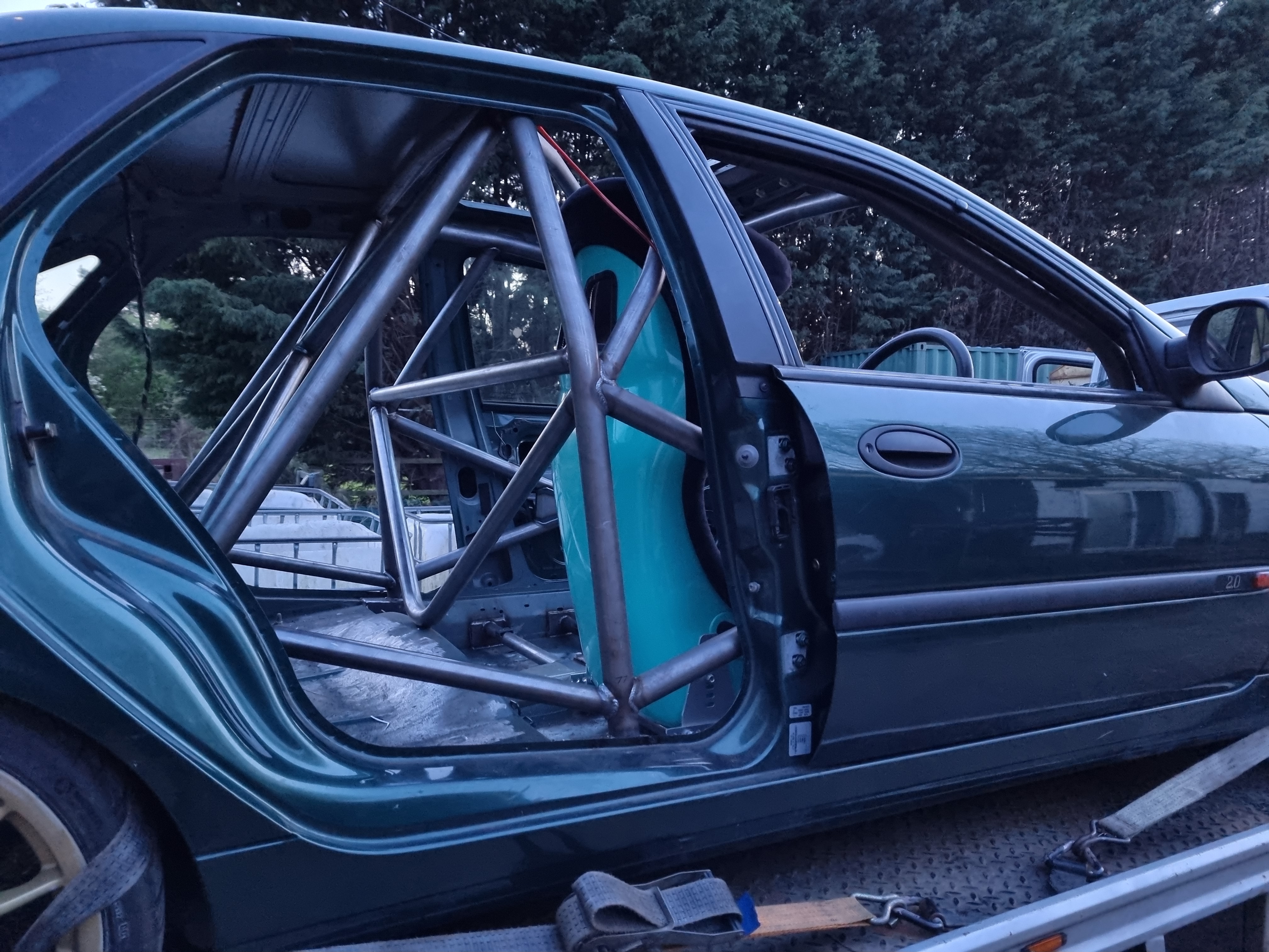

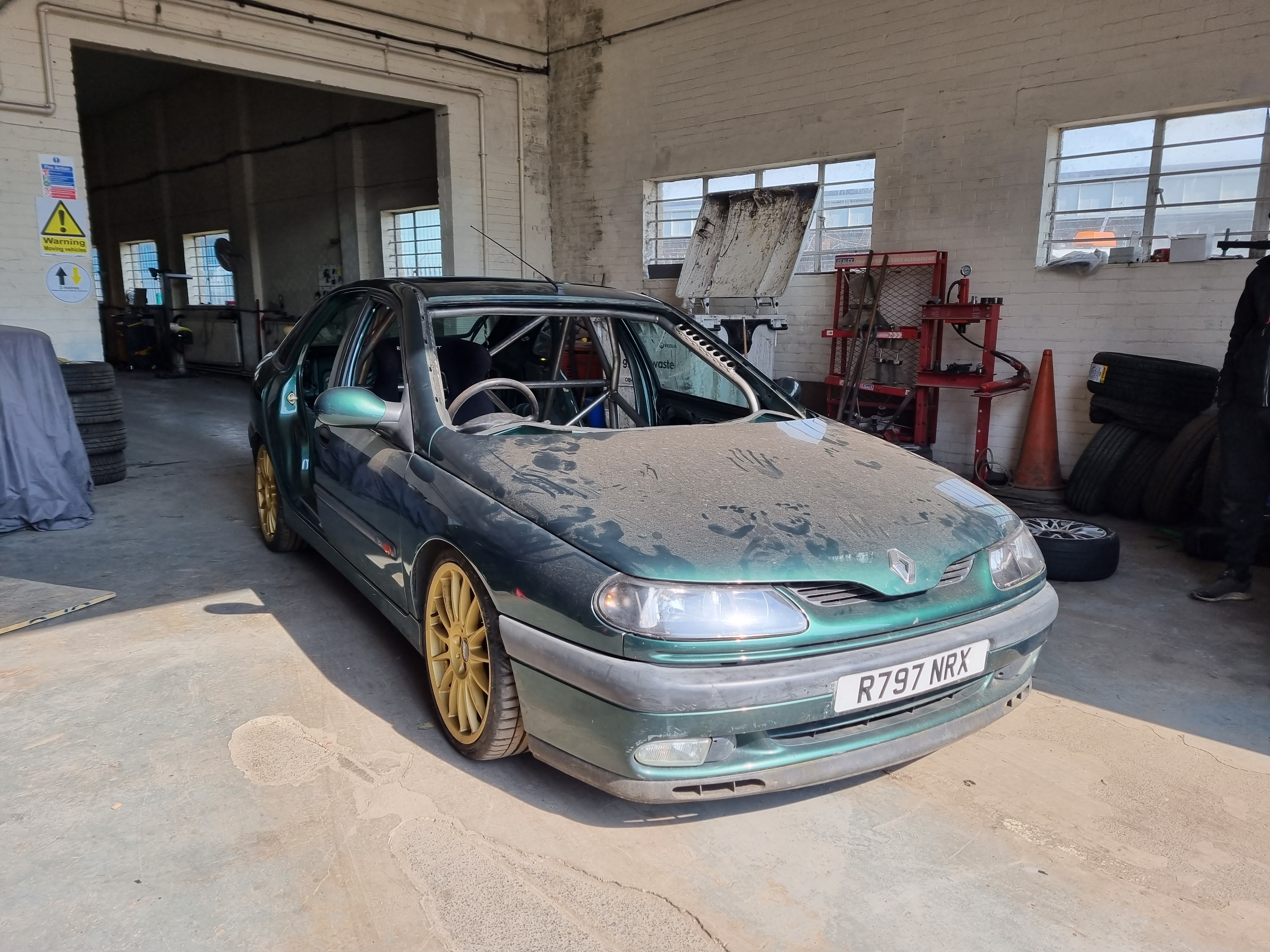

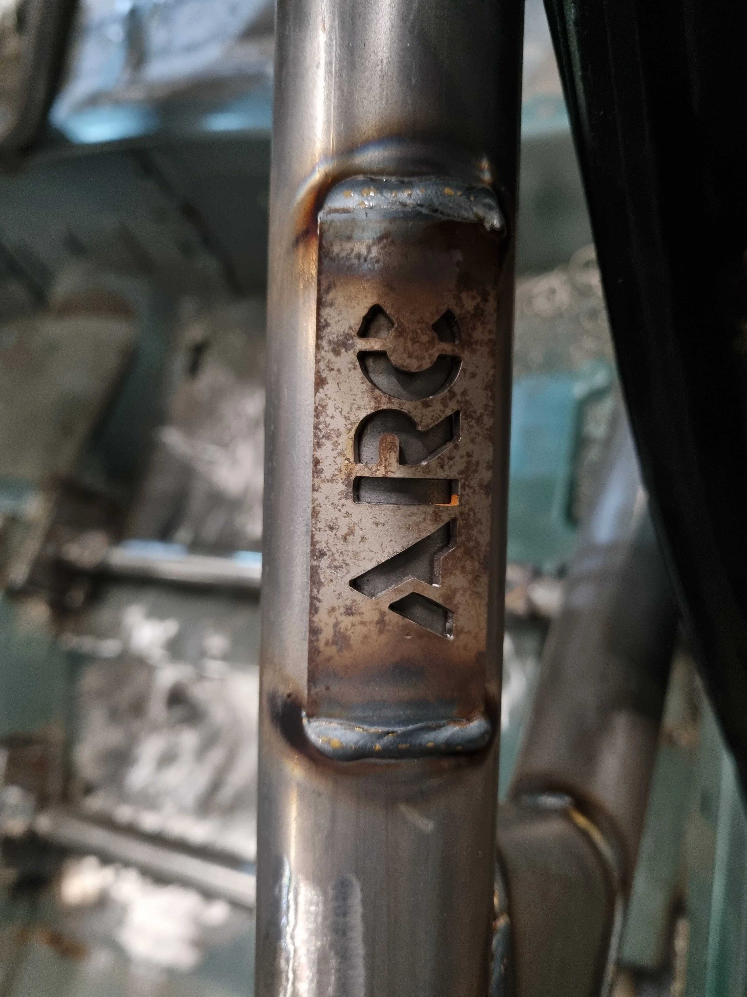

So that's the cage finished and what a job Sam at ARC has done! As well as the MSA spec cage which has plenty hints to the original super tourer cage I've also had the spare wheel well cut out and replaced with a flat floor along with the rear seat brackets drilled out and removed and then front seat tubes welded in.
Collected at 9pm yesterday and dropped off for paint 10am today. The seats are also being changed from the god awful pea green colour.
