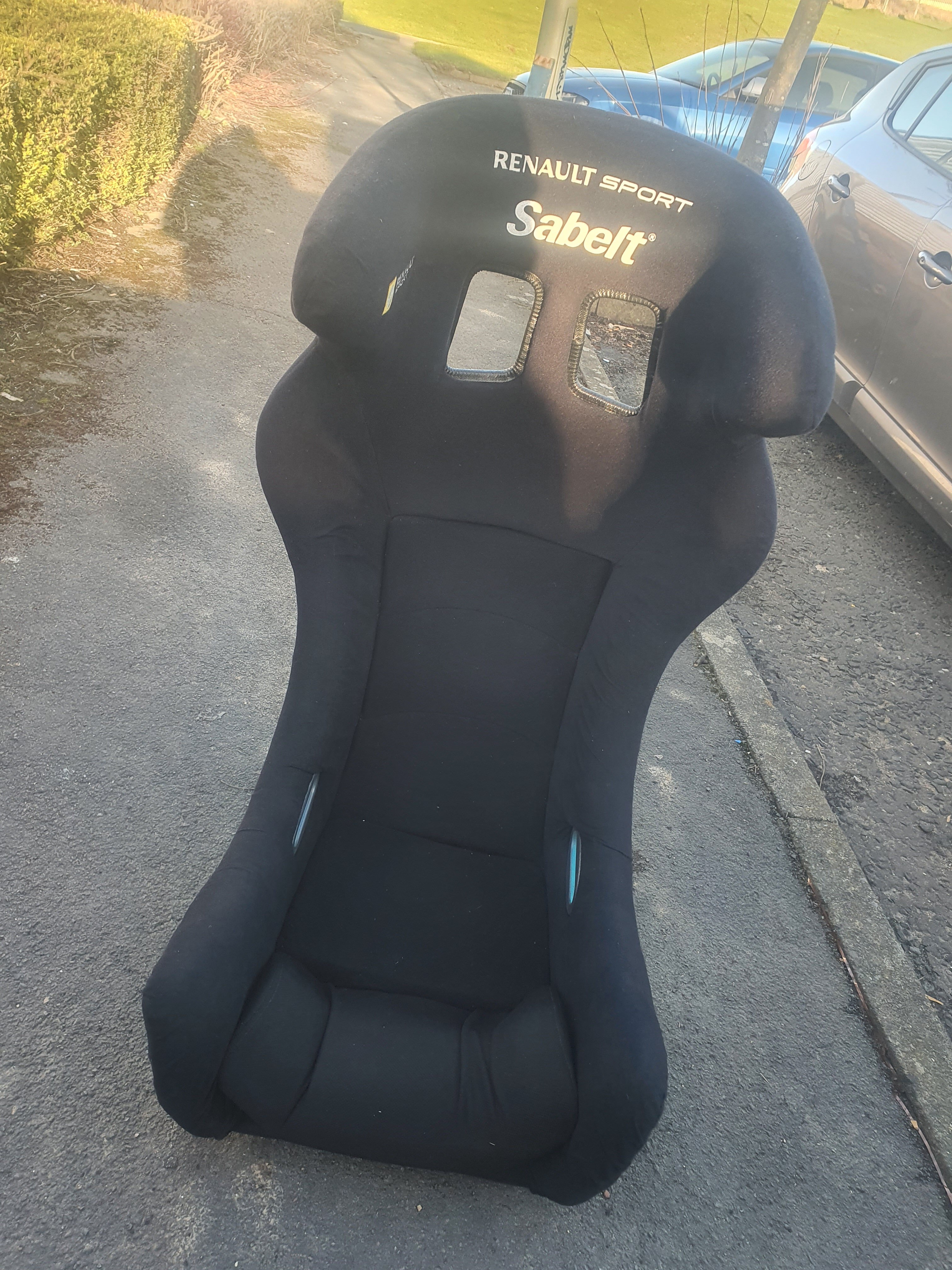

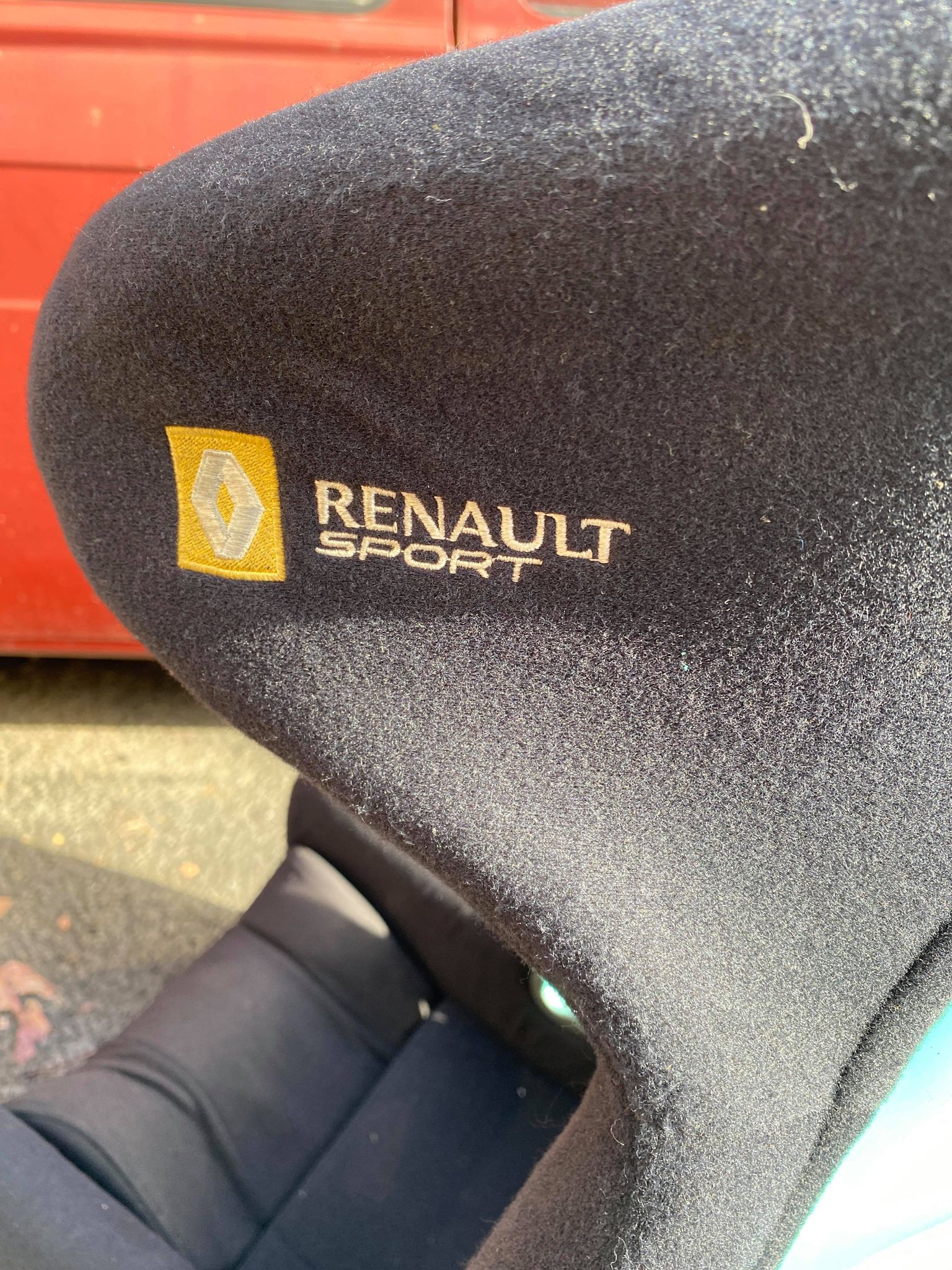

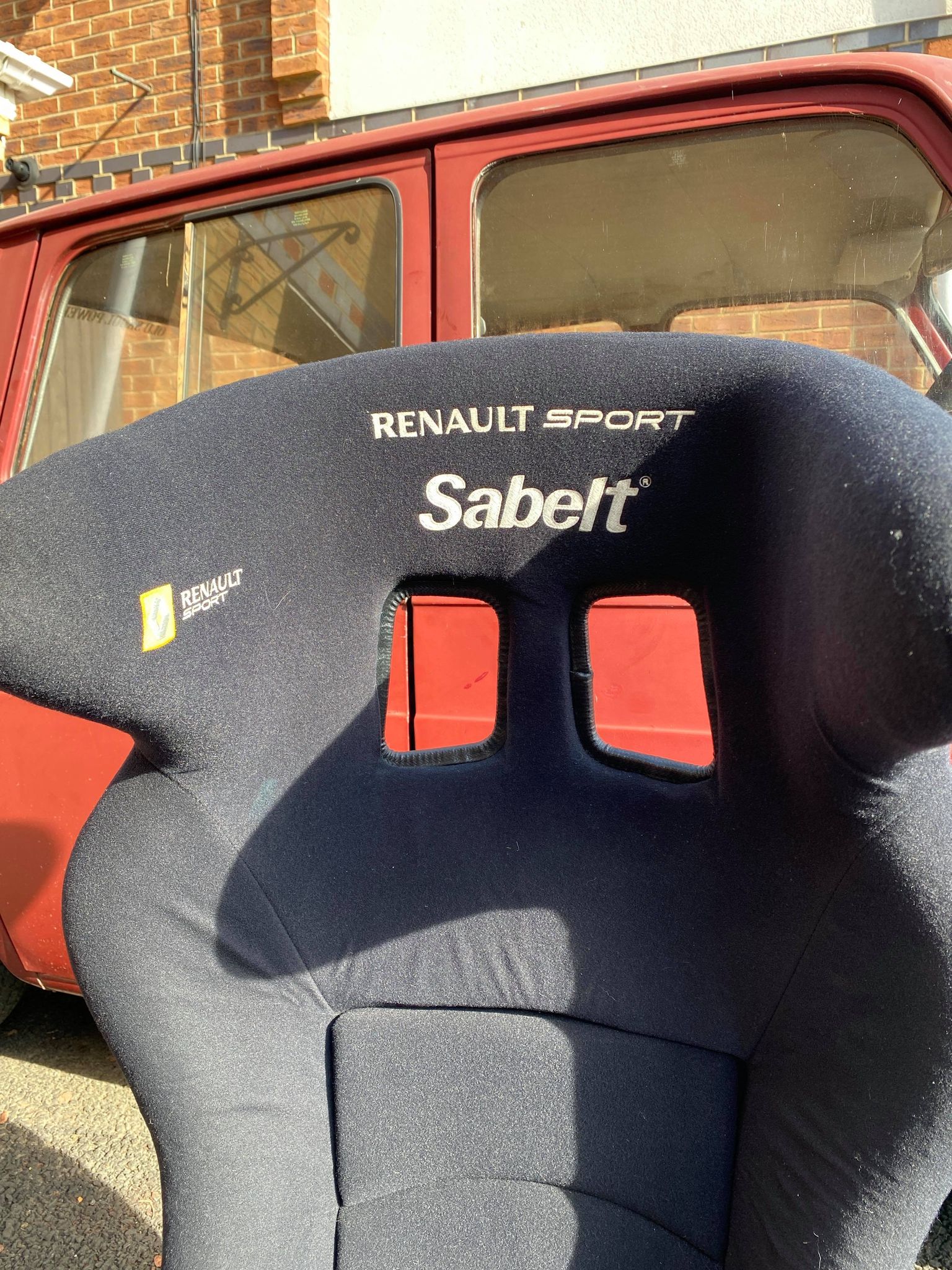

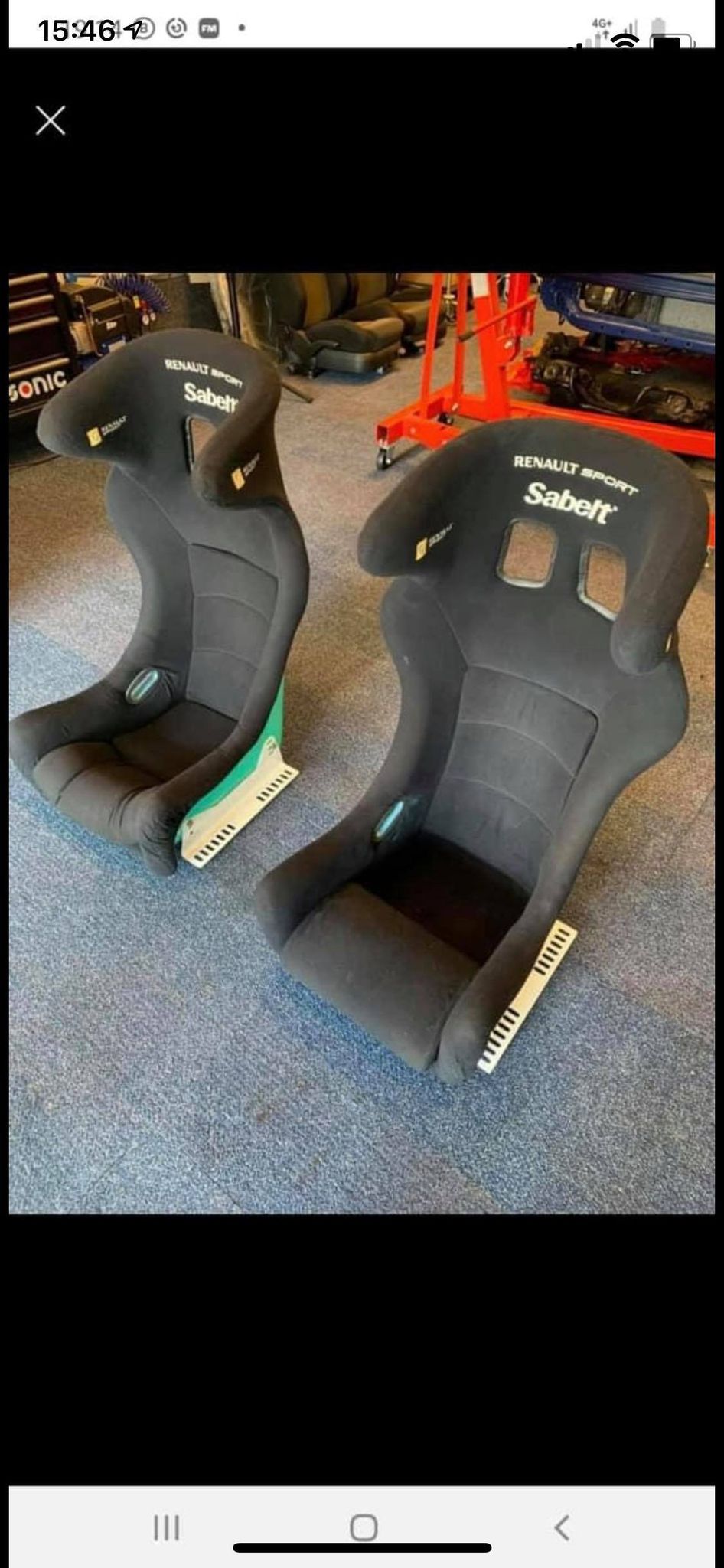

oh and ive just purchased these seats, I will only be using one so the other will be up for sale.
View attachment 1523560View attachment 1523561View attachment 1523562
Size? price?

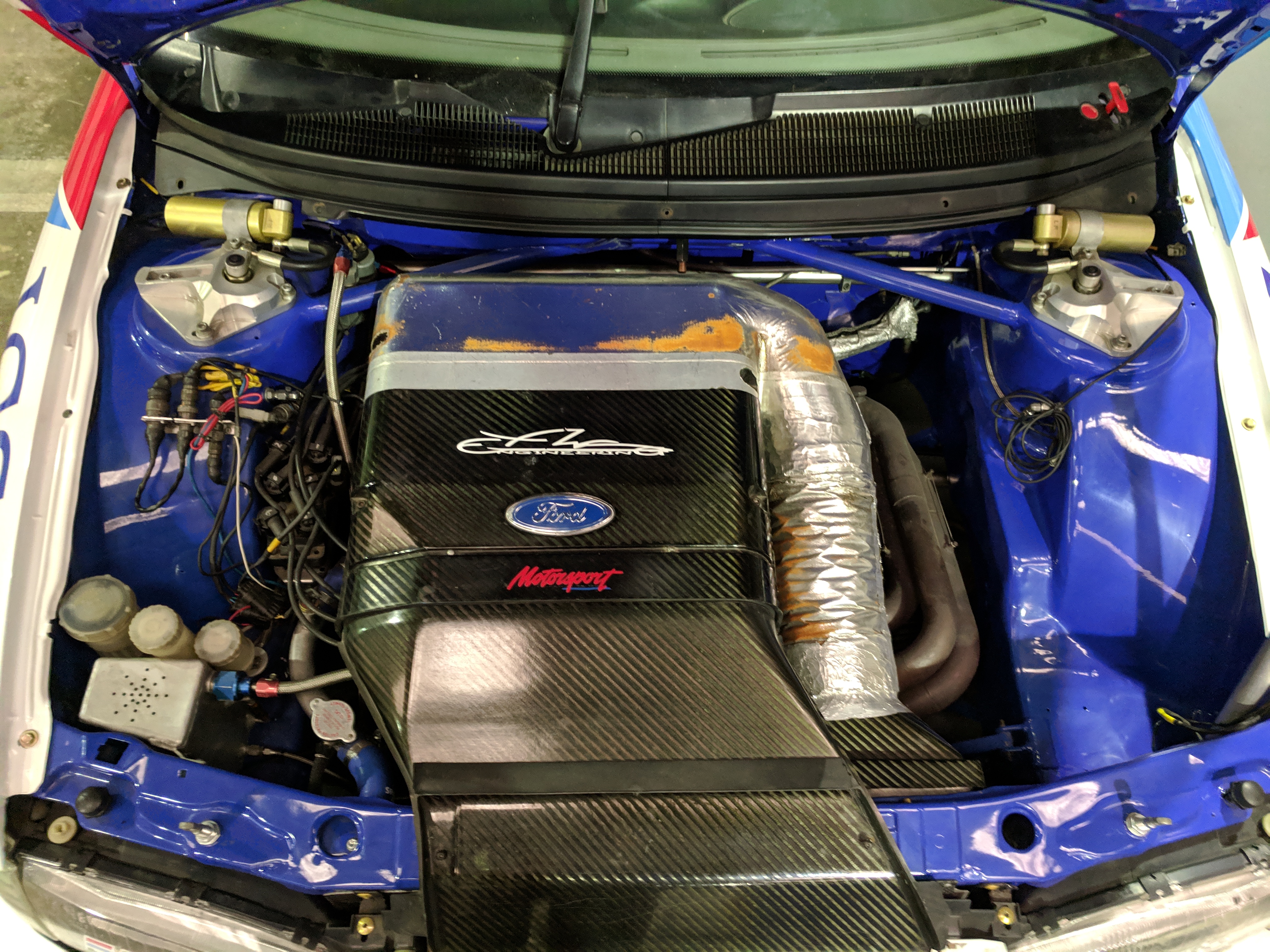

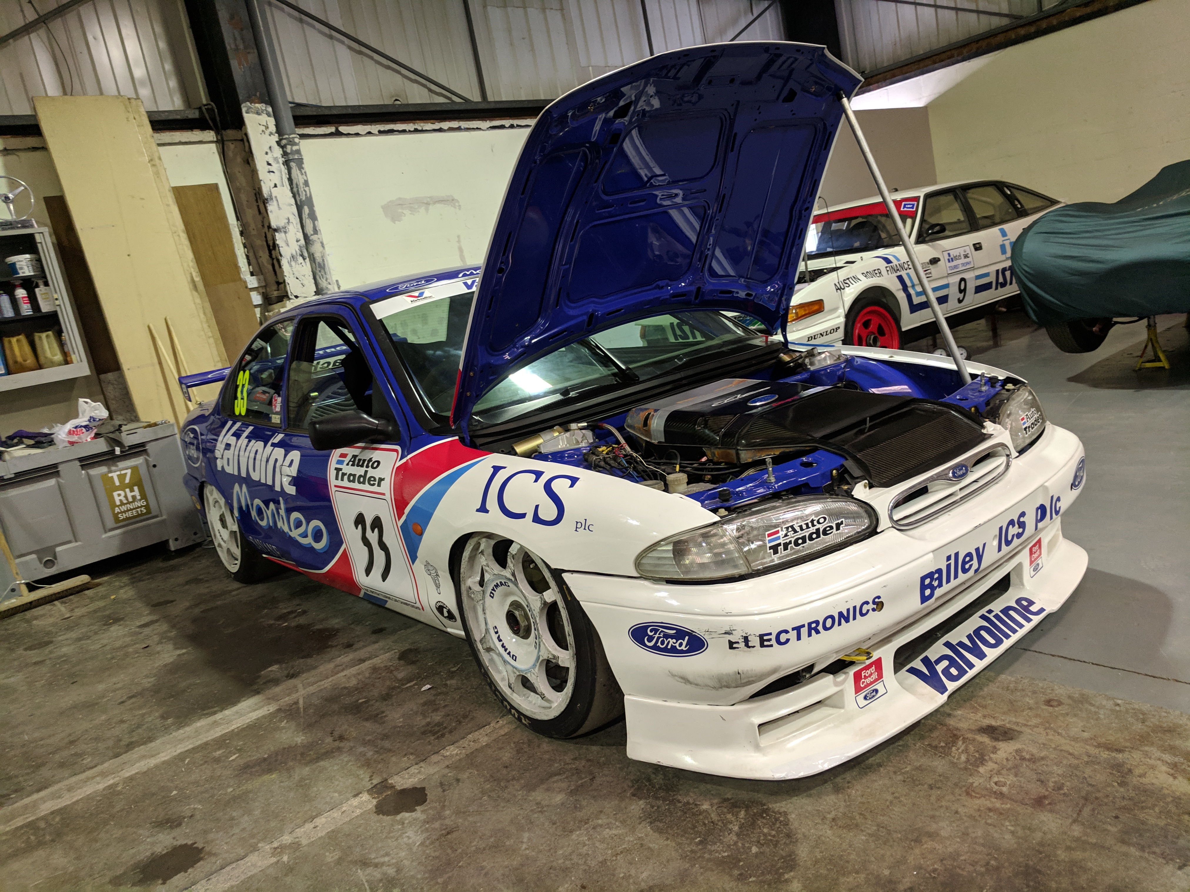

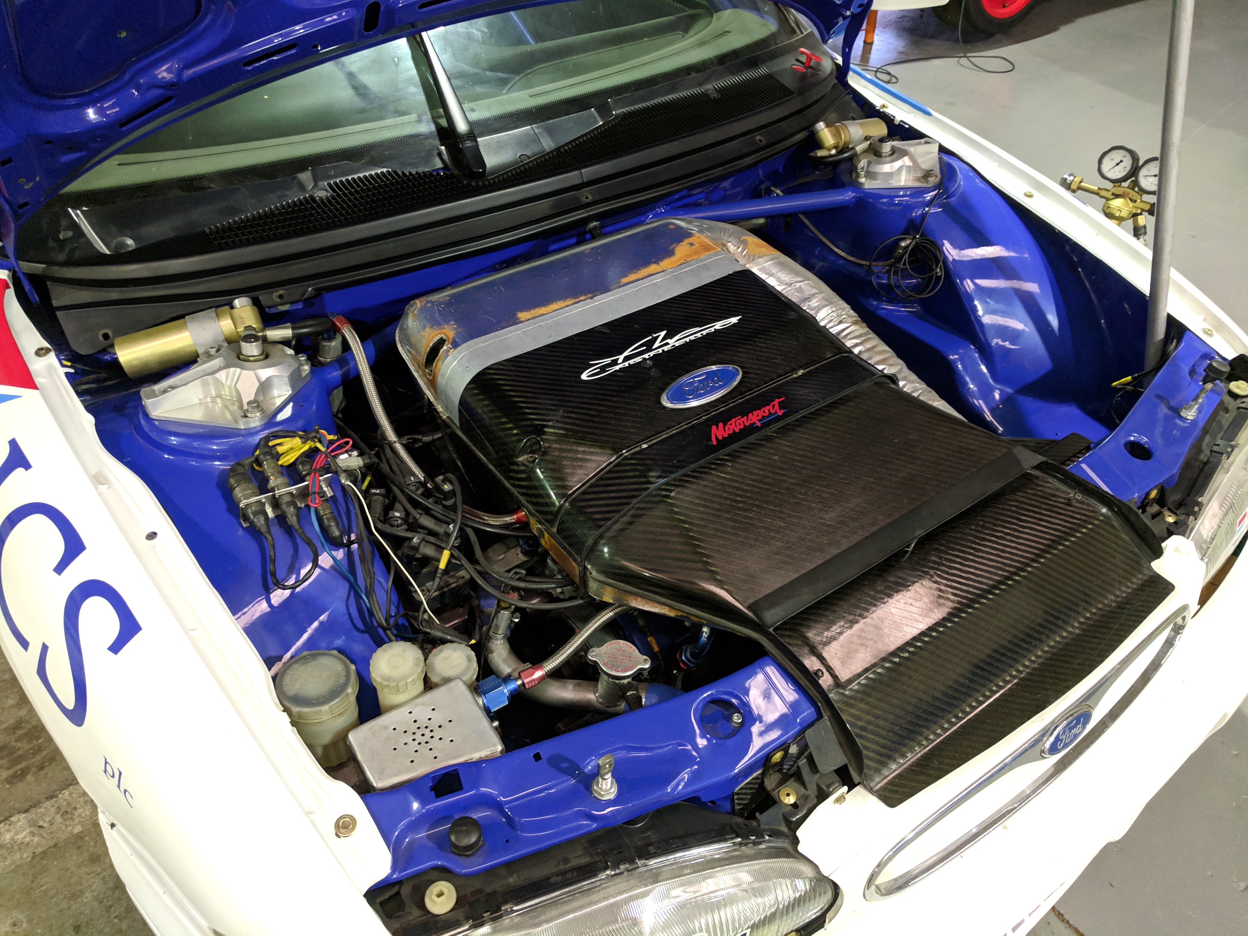

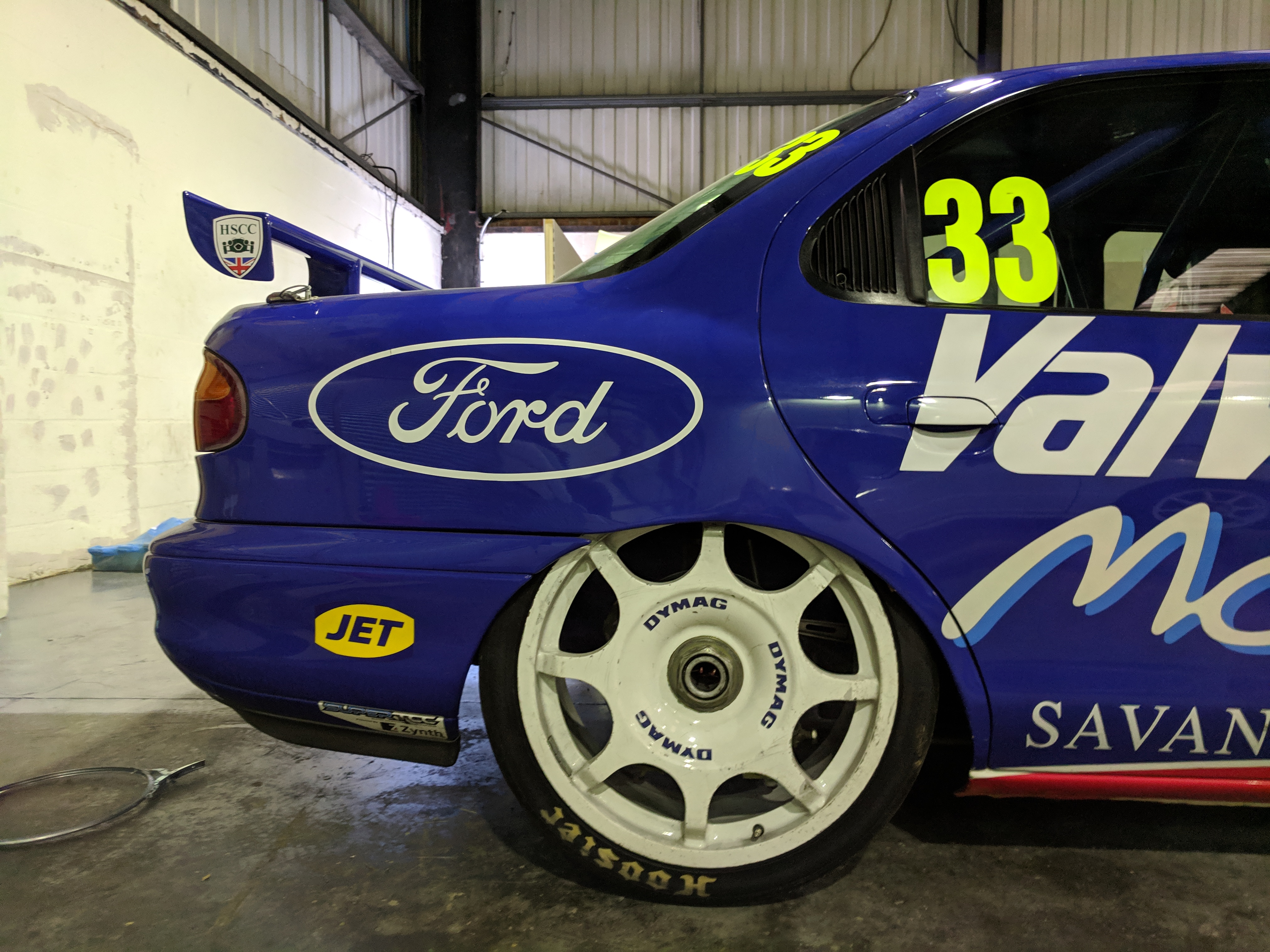

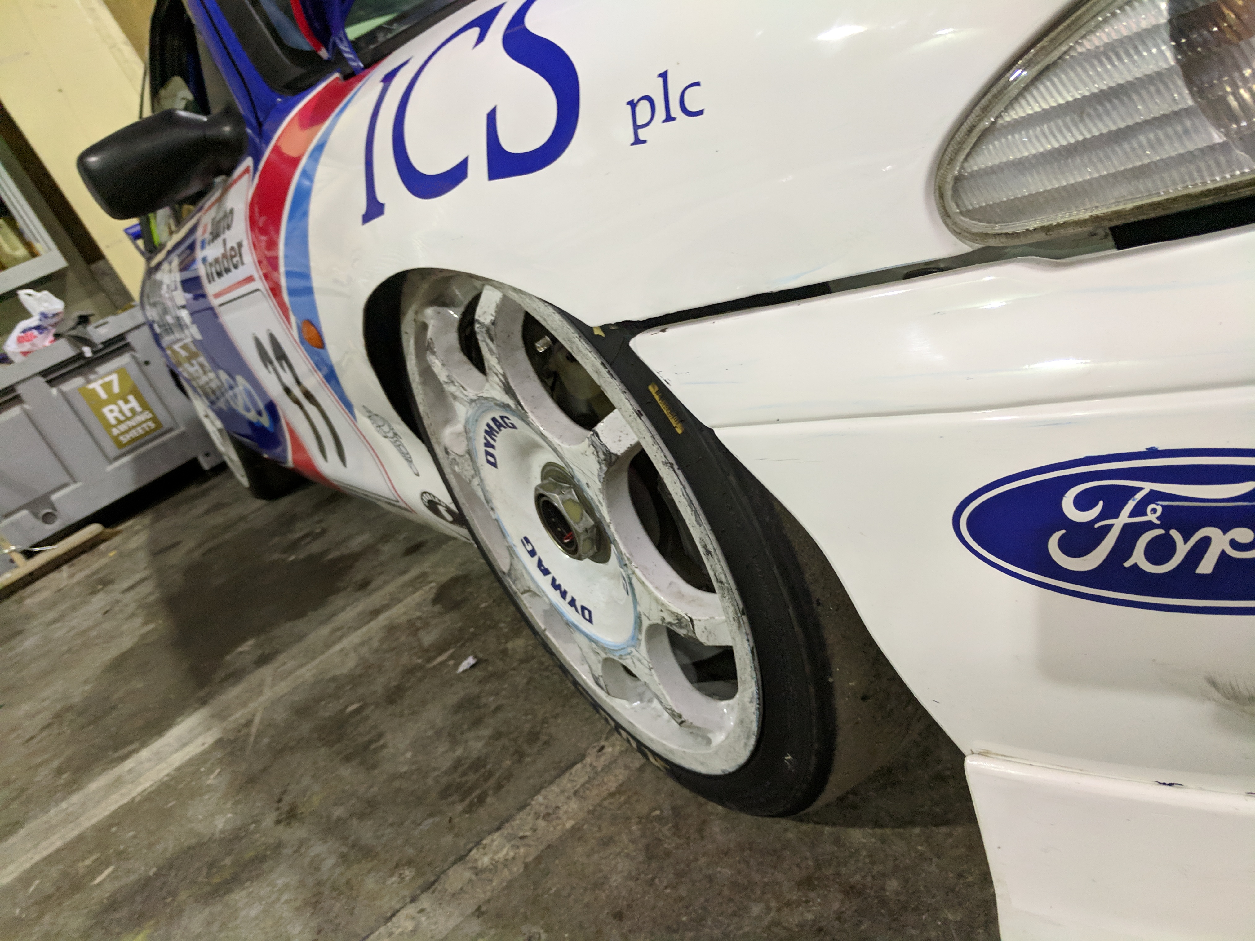

I think things started to go really mental from 1997. I took some photos of a Mondeo for a mag feature a couple of years ago and the engine was in a semi-sane position. Ride height was still mental though:

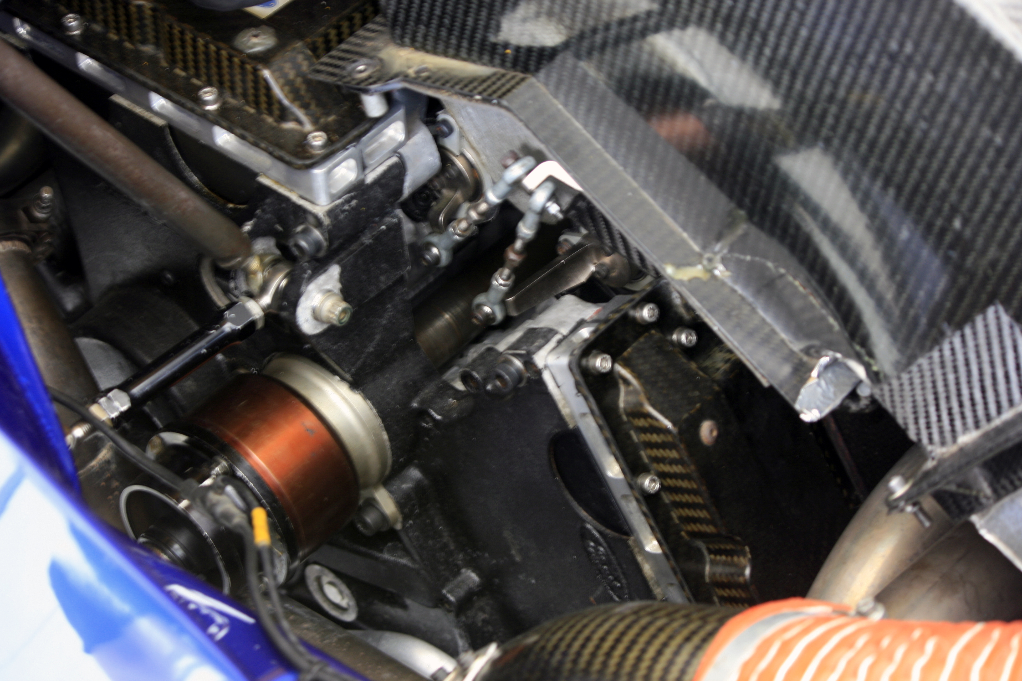

Certainly nothing like the drive shaft going through the V of the engine like it did on the Prodrive-built Mondeo at the turn of the century :LOL:

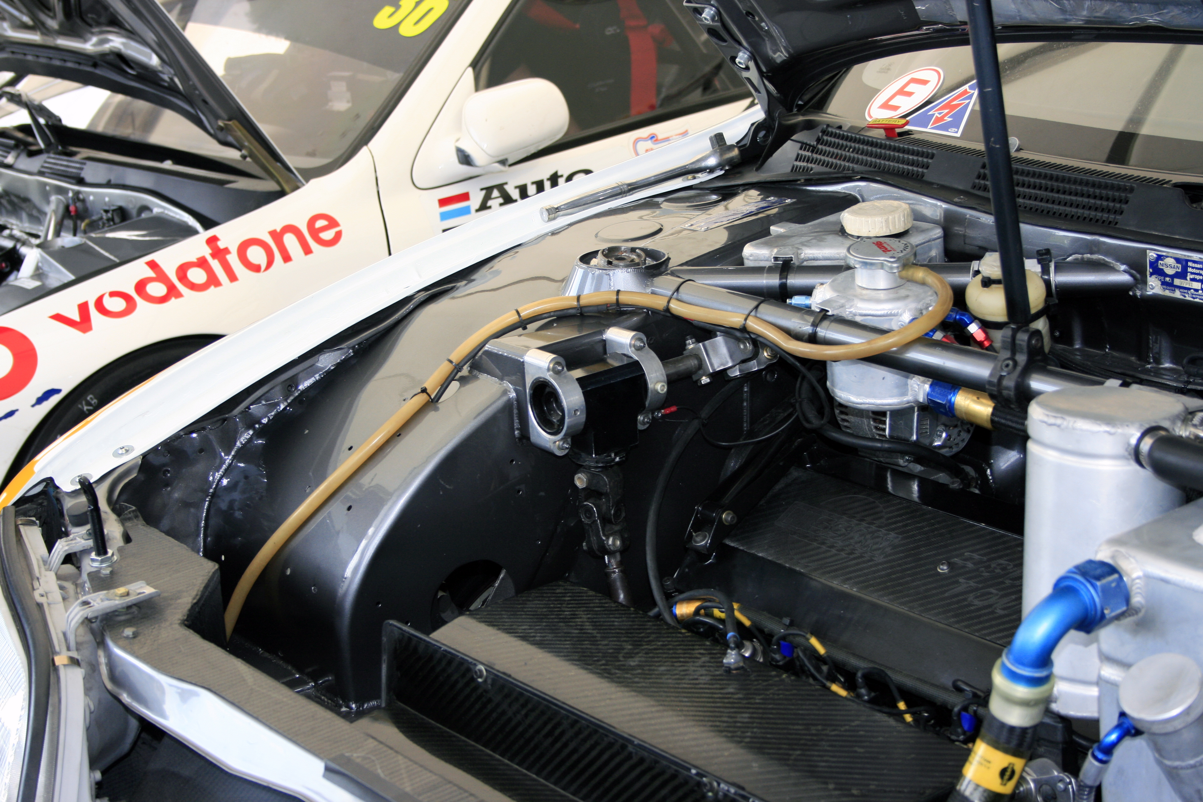

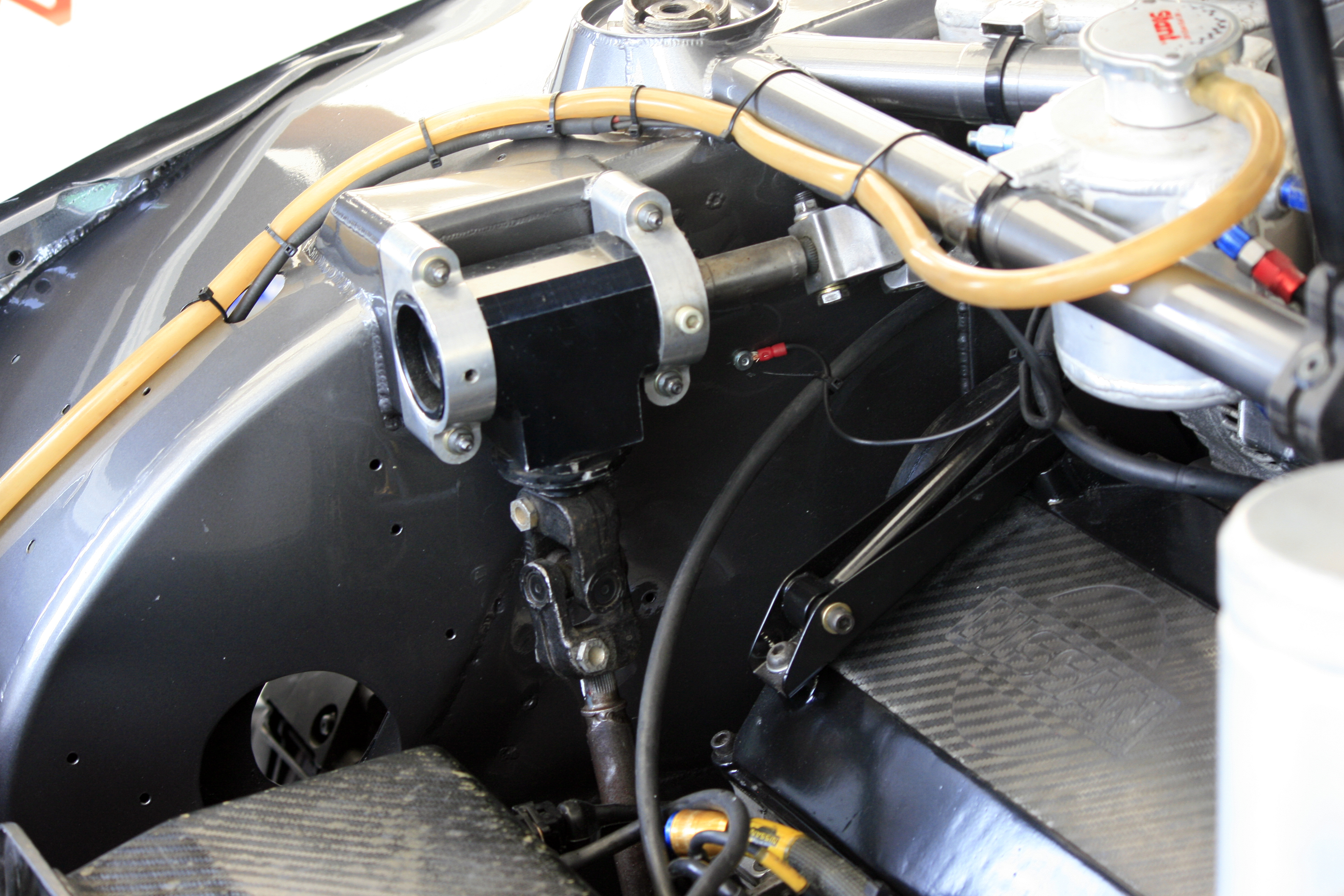

Or the Primera, where the steering column was basically horizontal, with a 90-degree joint to get down to the rack...

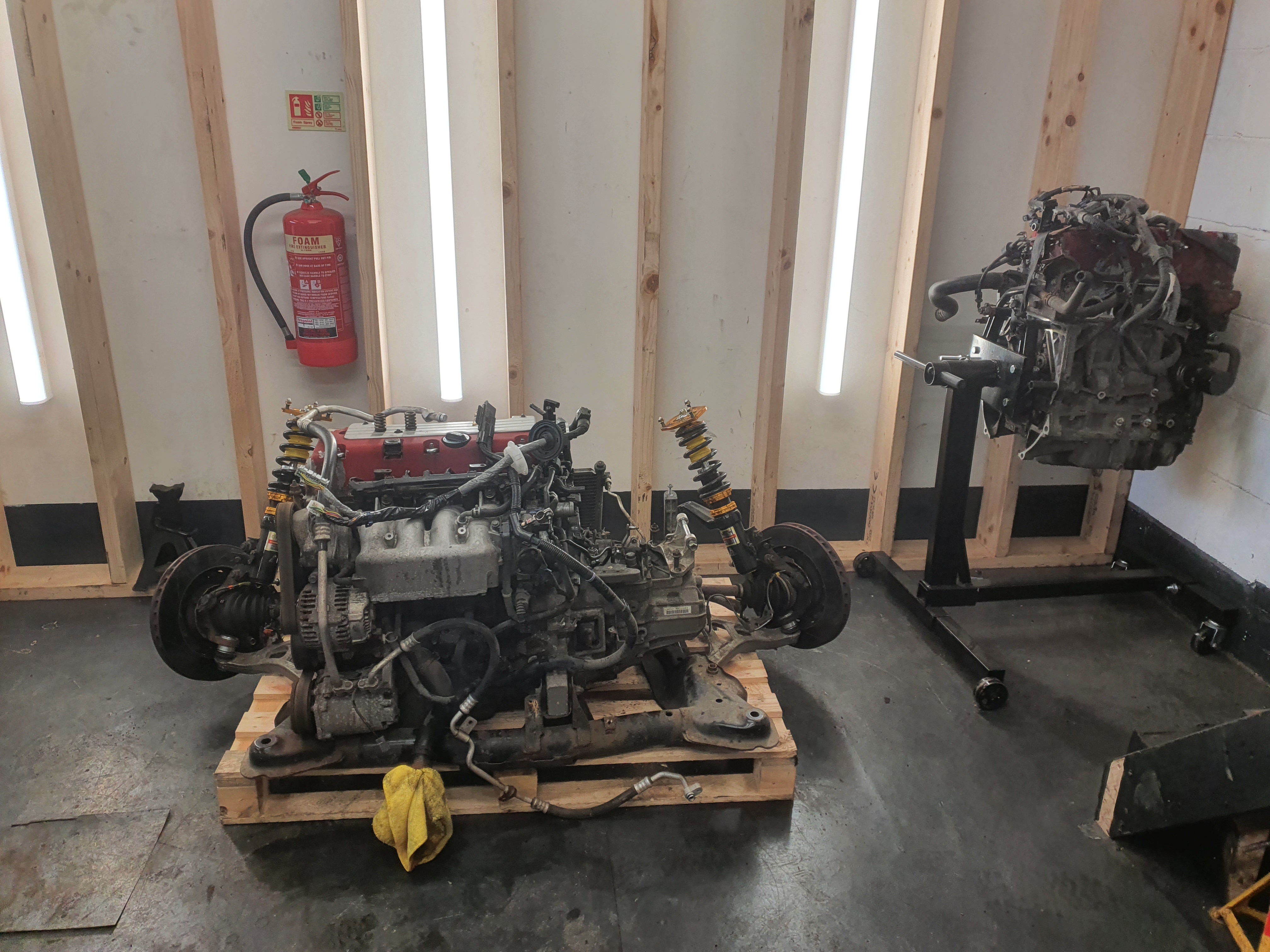

No, every man and his dog are banging bloody k20's into everything. If you must go Honda at least man up with the k24. But ideally for me it wants a Renault derived v6 on bodies
getikte

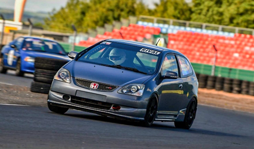

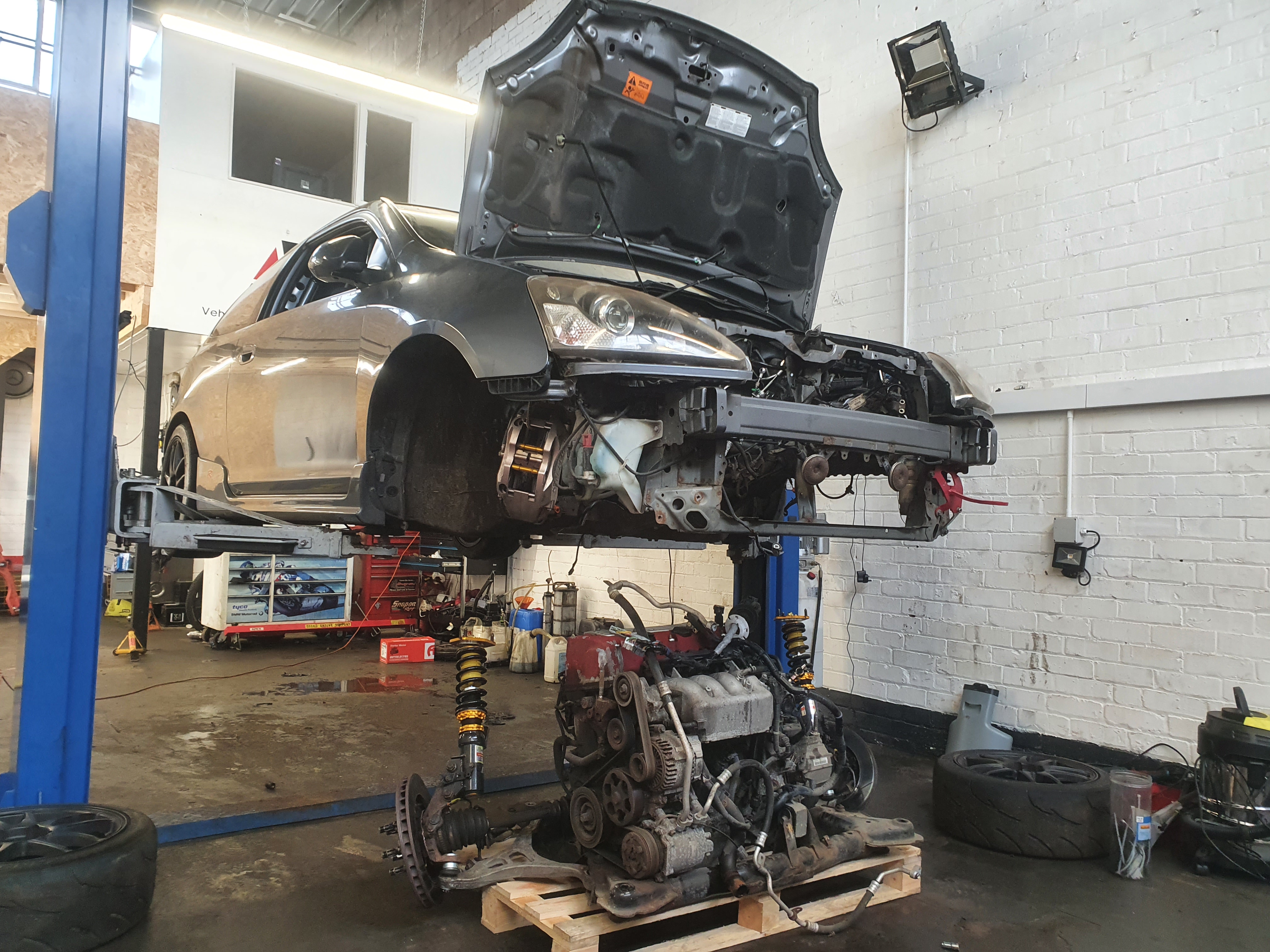

I've had to talk myself out of a K20.....
I've even got a spare engine sat there after my EP3 shat itself at croft last year :(
But I keep edging more to the F4R simply because renualt. 🤷‍♂️

Those pictures of the BTCC car show just how much work was done suspension wise. You can see how much of the front wing is cut away to accommodate the wheels and ride height

Thats mental, they got the engine so low they needed to put the driveshaft through the V?
Were these duratec derived?
Yeah. It was based around the Mazda V6 used in the Probe and MX-6 I think, as you could use any engine from the group at the time. Apparently it was completely reengineered though, and the heads were ridiculously heavily modified. That's what a £10m annual budget does for you though :ROFLMAO:
