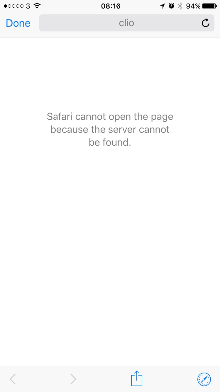

O I see when I try abs open it I Judy get thing

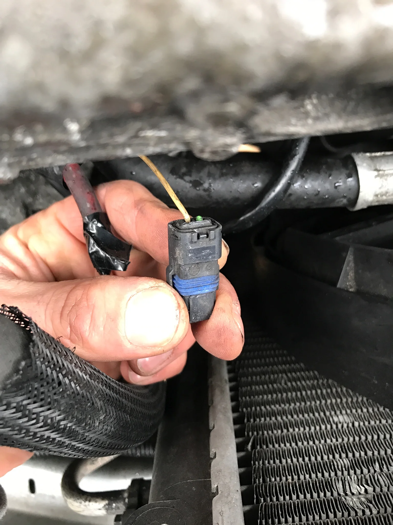

So iv got my old alternator of now and got a new one on order the hardest part was getting the rusty bolts out of the bumper to be honest. Only question I have is should this plug that goes into the alternator have another wire in it it looks like there was one
