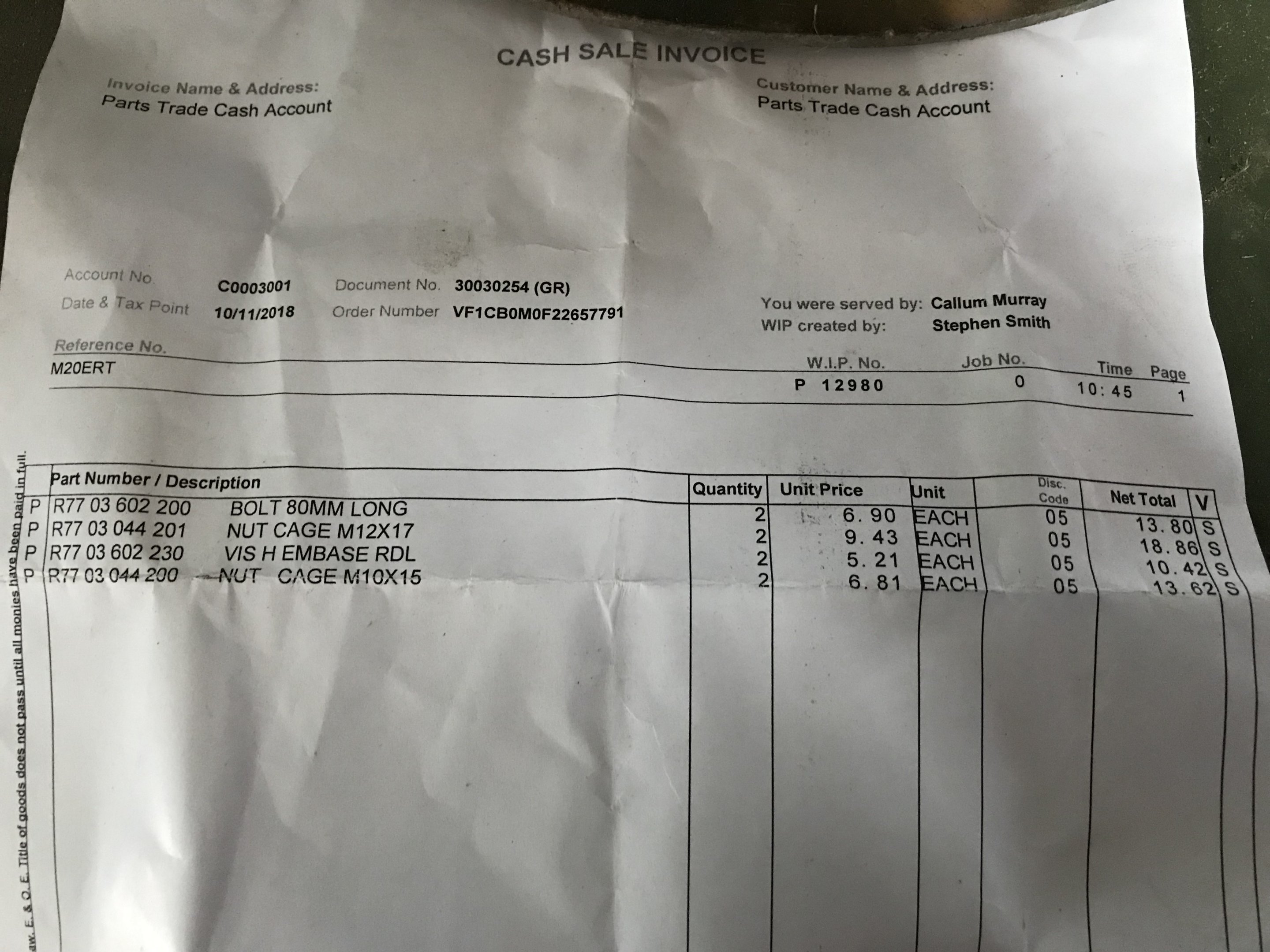

the new cage nuts and bolts, from Renault yeah and cost? got this job incoming on my phase 1 and have a feeling it may be a sod!

My Subframe has been nut and bolted on the front two at some point in its life due to broken cages so would be nice to get some part numbers up!

Yeah got them from renault. £68 for them all together. Will look today see if I still have the invoice for part numbers
Mertin
  Ph1 172&Ph2 172 Cup

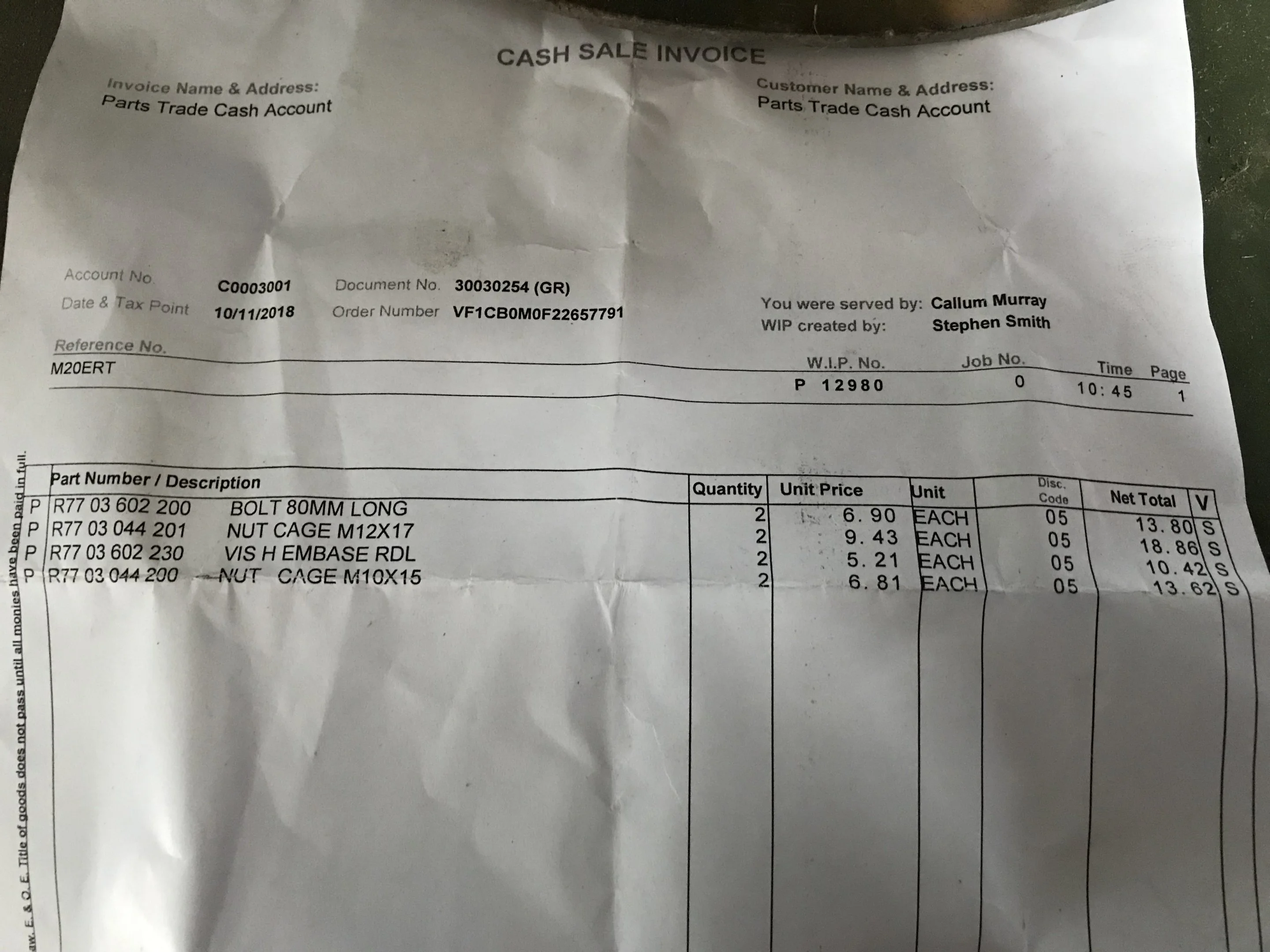

Part no’s for those interested, £68 for all 4
