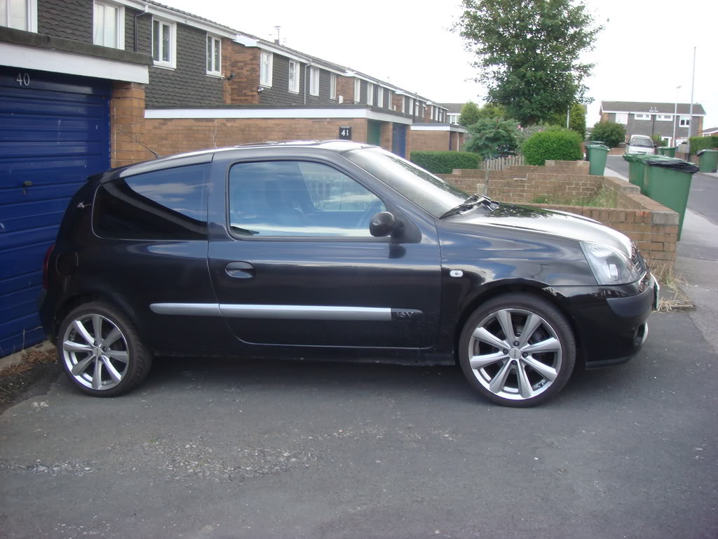

basically needs a new coat of paint (correct paint that is) i have a picture. you'l defiinatly notice why am needing a good reasonalble priced respray
probably best painting the wing too mate and do the whole side.
you'll notice colour match alot less bonnet to wing compared to wing to door as its different angles.
id say £200-£250
the wing seems to match the bonnet though, the door and rear quatre lacks a gold metallic.. and it looks lighter
thats a good price
yea but if you paint to the wing its just gonna be a solid edge as you gotta paint right to the end of the door, then youre just hoping it matches next time. If you prep the wing too, blow basecoat accross the side (not on the top) and then laquer the whole wing, itll still be the same colour to the bonnet, but the door will be blended nicely into it too.
wings on clios will always look slightly different anyway due to them being plastic
yeah i understand.
yeah i noticed wings are a diff colour too on normal clios, but non so much as worse as mine... stupid clio.. lol
