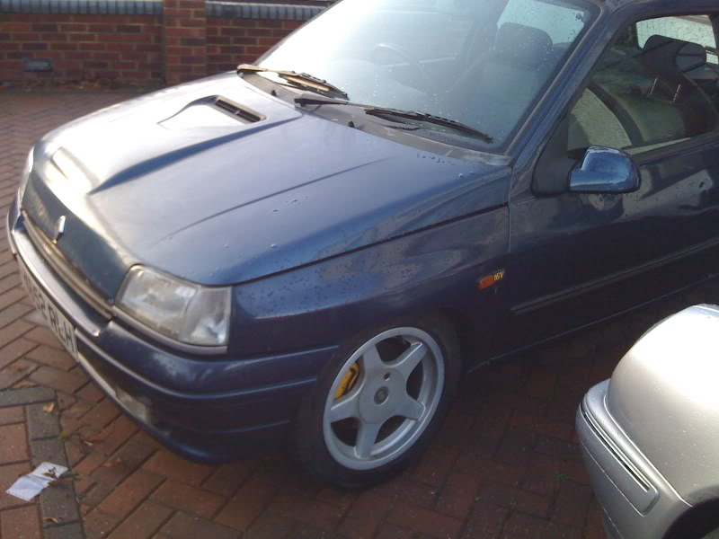

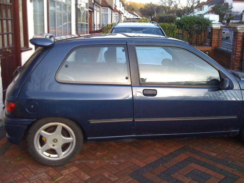

Bought K*** RLH end of 2008 with plans to give it a quick service and get it on the road,
Here's how she looked

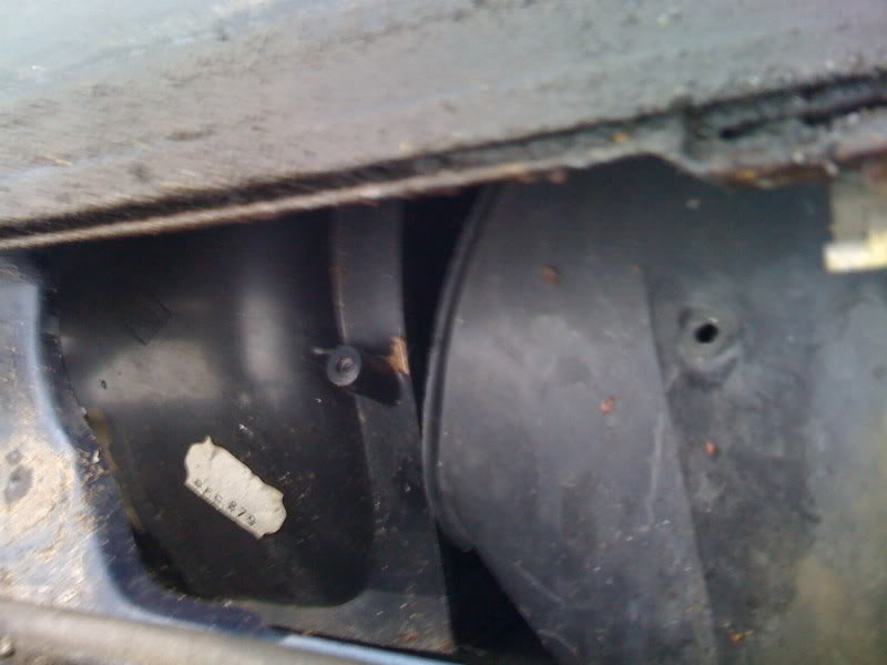

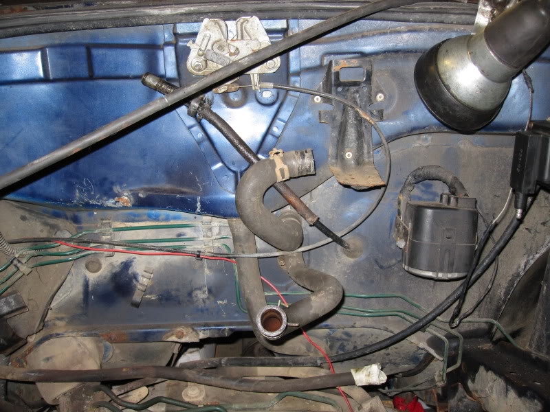

next day whipped the scuttle panel off and found that the plug to the blower had melted so a quick call to joshydee and a plug was with me next day, soldered that on and jobs a good un.

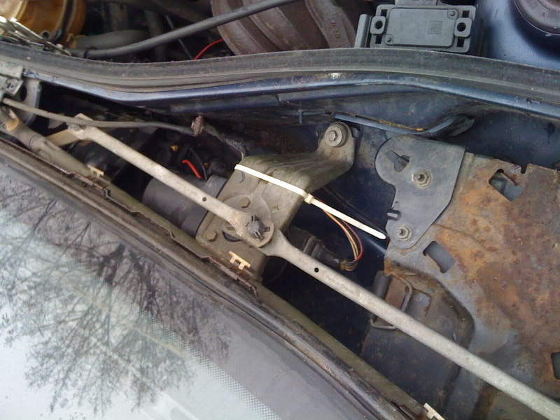

scuttle panel off
dodgy placement of the shield - lazy barstard however done that!

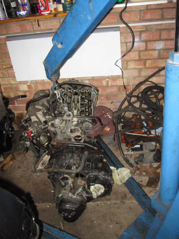

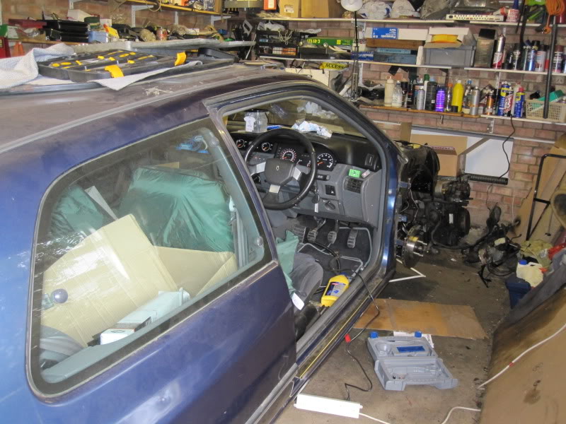

got the car in the garage and started looking at doing the cambelt decided forget doing it in car and to crane it out, do the deed and drop it back in.

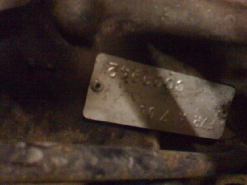

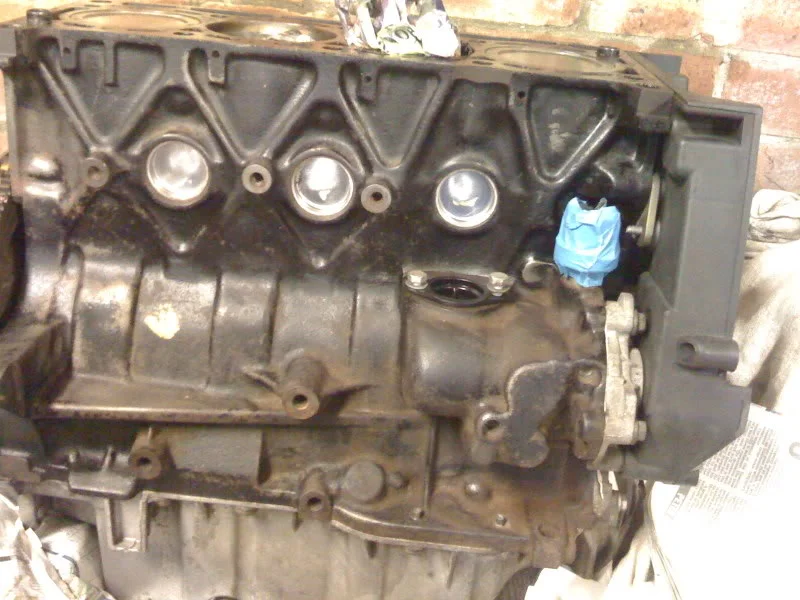

this got me to thinking that i should get new cams and lifters while the engine was out - then i decided to just get a F7R instead of the cams as better gains were to be had. fortunately for me there was a F7R (williams) block available 20 minutes from me (midge) so the day i decided to get one i managed to have one in my garage the same evening!

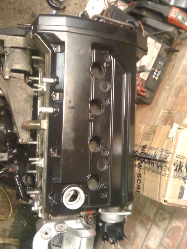

stripped the the head off and it was in really good condition already, dad took it to work and had it cleaned then when it got back i lapped all the valves in (a boring boring BORING job) and it was built back up using the new lifters and Catcam 225s.
at the same time i refreshed all the seals including the injector seals. had a problem with the cam seals as it turns out that there are actually 2 sizes available and ktec didnt know that (they supplied the seal kit) i suppose thats acceptable for a clio specialist
quick trip to reno and that was rectified.

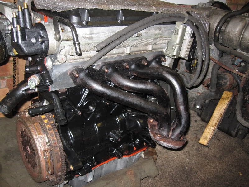

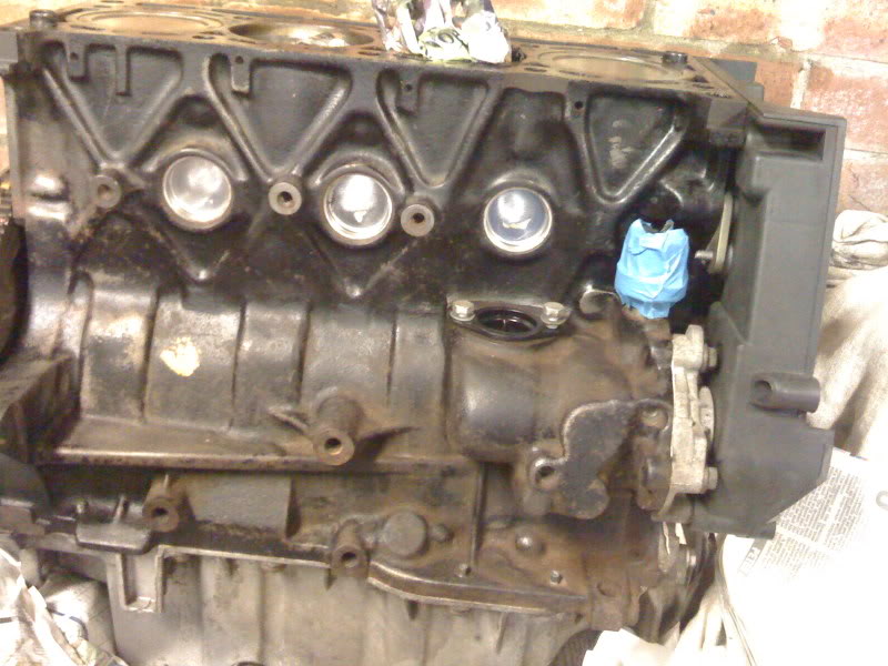

with the head built up gave the block a quick clean and a brush of paint - not 100% pleased with the result but i dont care anymore!
then the engine was built up and timed

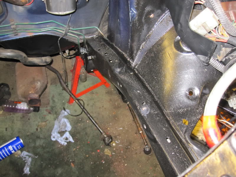

at the same time i started abusing the chassis with black hammerite - cue getting high in the garage at 1am off the fumes.

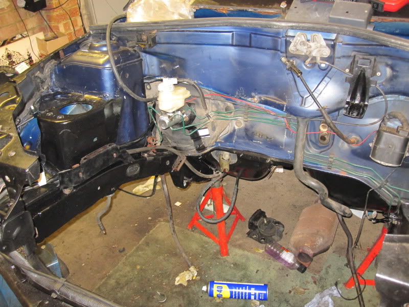

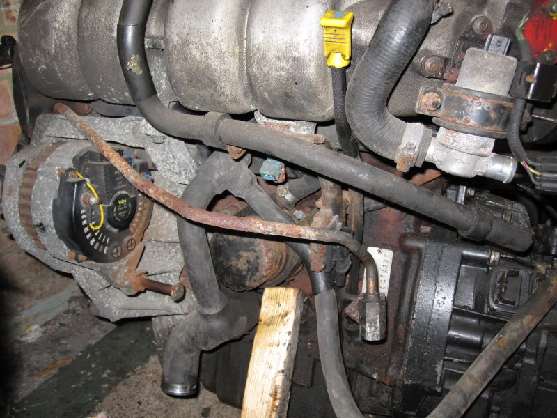

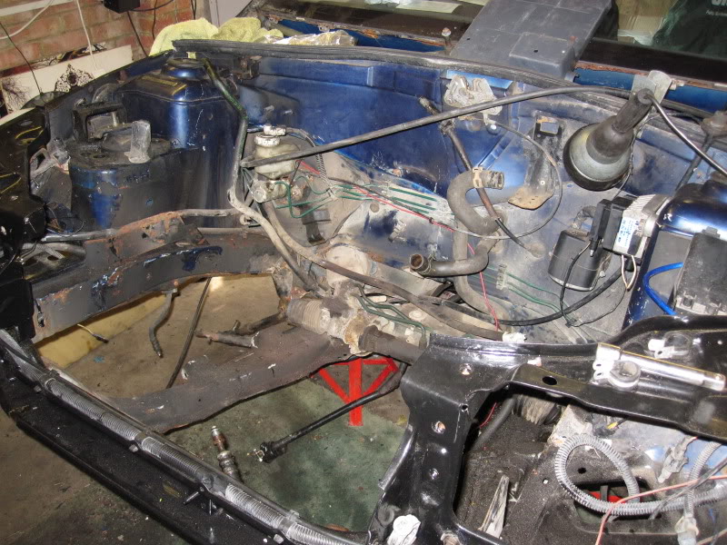

Then it was time to pull the retired F7P out
the bay was freshened up with some black hammerite - lost those pics though.

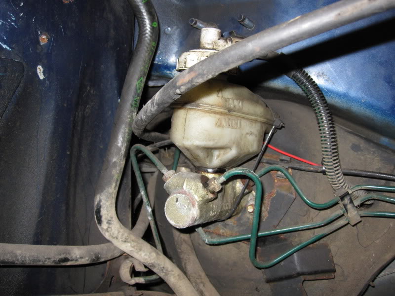

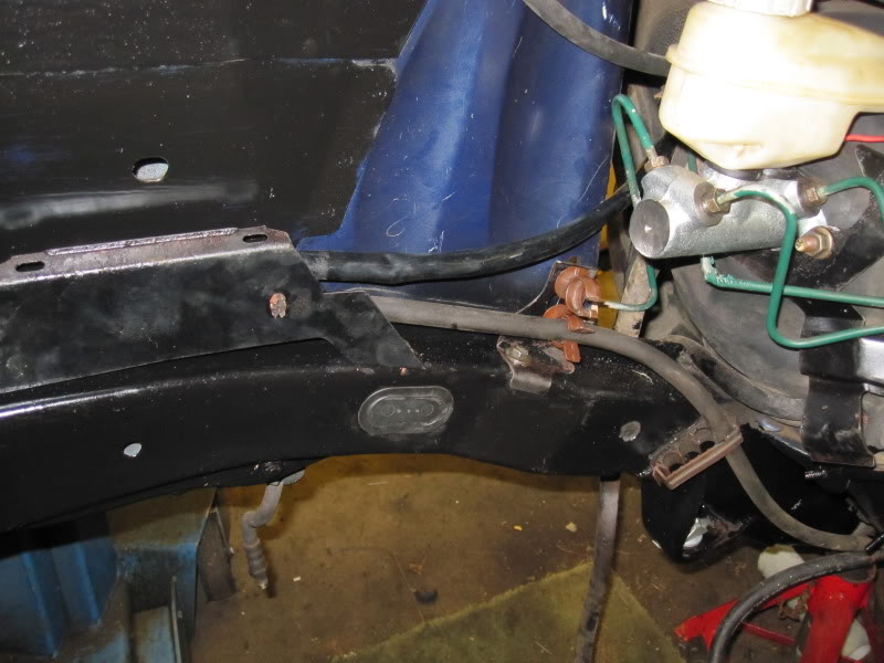

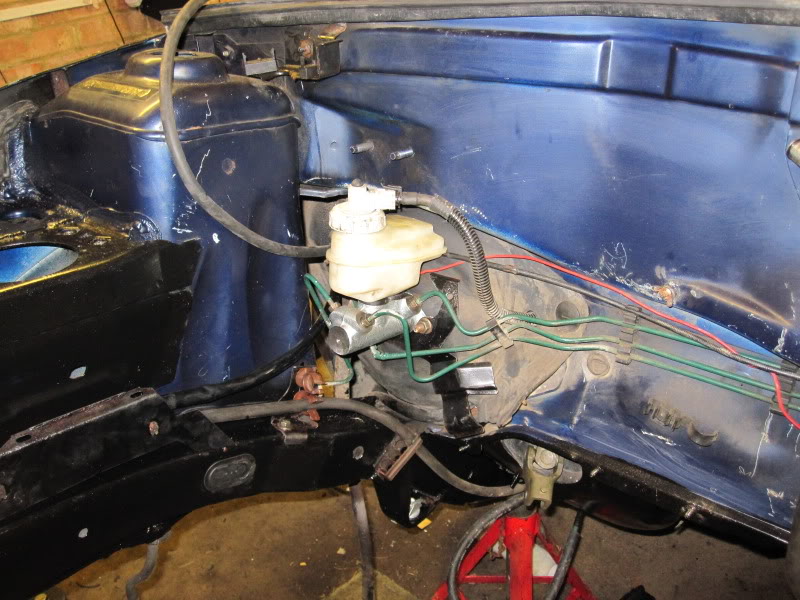

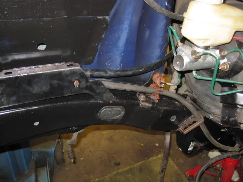

i then replaced the master cylinder (made sense to)
also replaced the front brake lines.

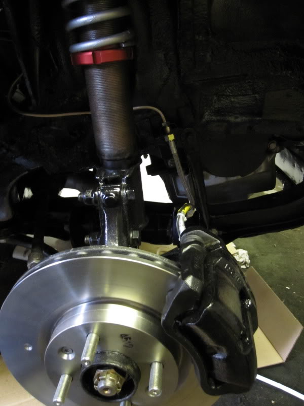

front calipers refurbed and re-sealed

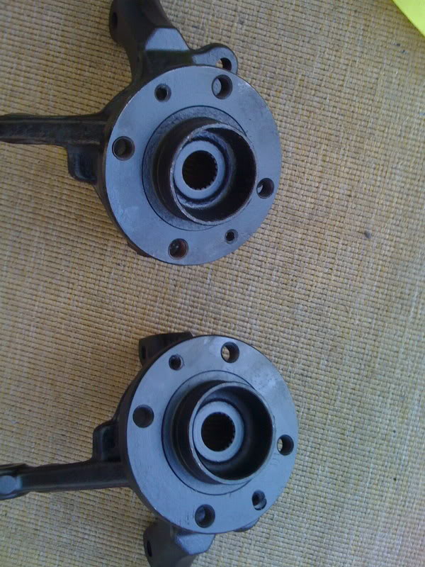

hubs refurbed and treated to new bearings

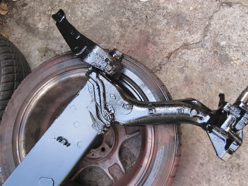

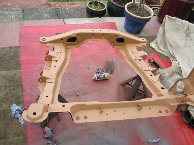

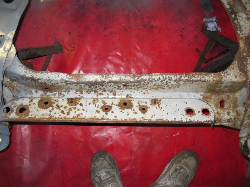

Subframe refurbished - pics only show it with primer on it but it was treated to hammerite and then a stonechip protection

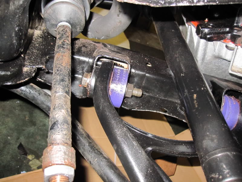

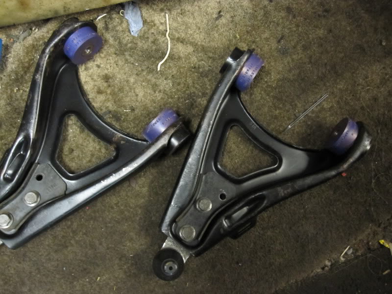

subframe was then installed along with wishbones and ARB all the bushes were uprated as well as the rear engine mount.
new track rod ends were fitted and new ball joints too.

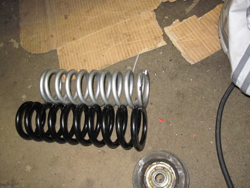

bought some AVO shocks off AJR gave them a repaint and replaced the 190lb 8" springs with 300lb 10" springs as the 190's were getting coilbound. the 300lbs made all the difference however i will be changing them to 250 as 300 is a little bit too firm around london.
this is how it was looking when it was all fitted up
pic is before i put the new springs on.

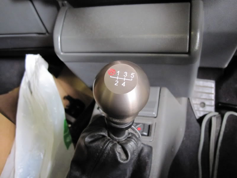

changed the crappy momo gear leaver for a smaller richbrook one

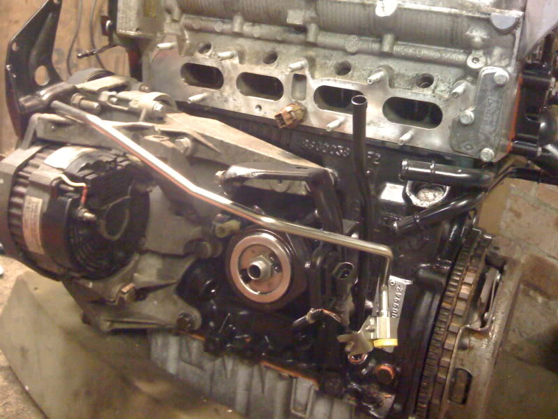

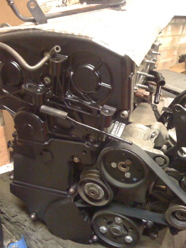

engine was then dropped back in and plumbed in - ended up buying the full samco set, loom was cleaned and retaped (another boring job) and the broken plugs were all replaced.
at the same time i installed a gunner chip to the willy ECU.

engine once it was all in

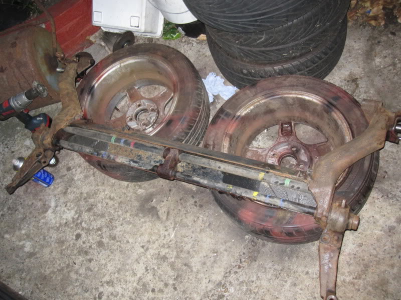

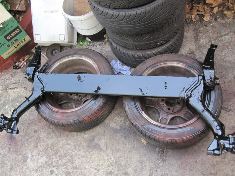

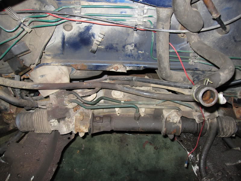

no pics of this but i removed the rear beam and painted it, replaced all the rear brake lines (what a t**t of a job) and fitted new brake hoses, load sensing valve, refurbebed calipers and replaced the handbrake cables.

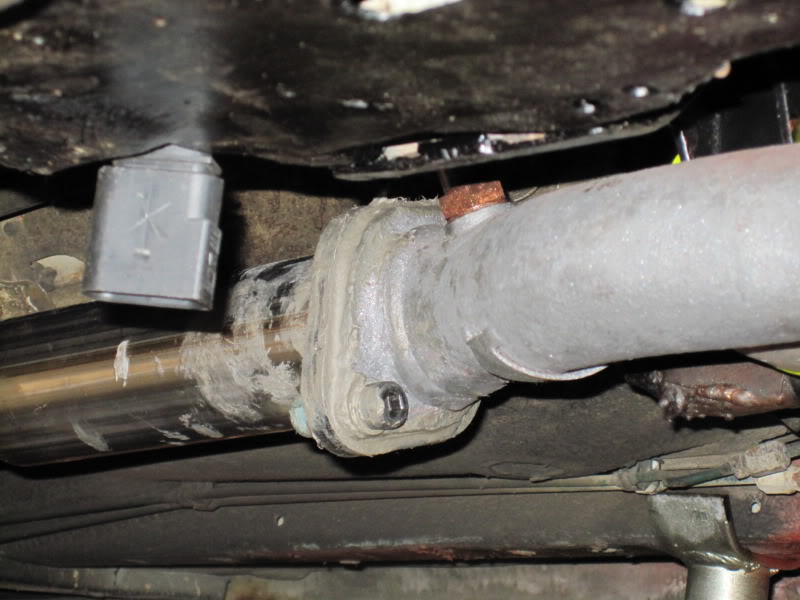

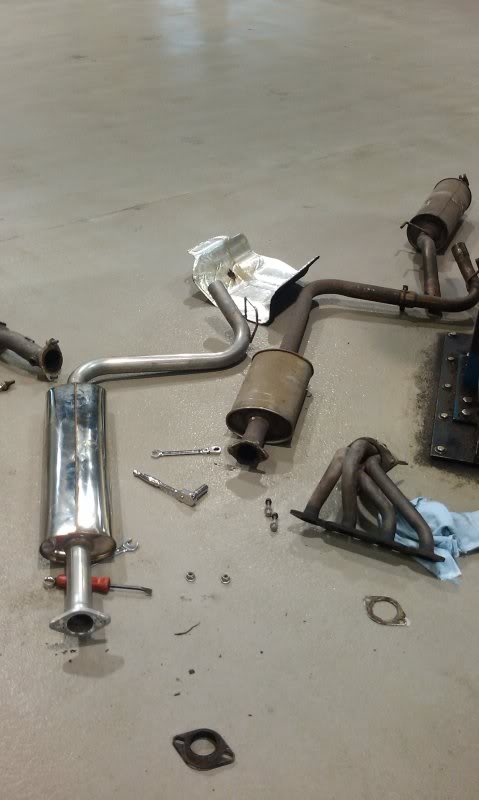

got a ktec decat and fitted after much deliberation
however am finding that the downpipe is very close to the driveshaft boot and the dogbone mount. should there be any additional heatshields in that area?
i have a new scorpion cat back system it will go on while it is at dads work on the ramp - dad will shorten the decat and reweld it and make everything fit nice and tight

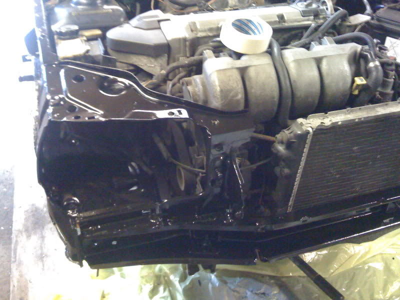

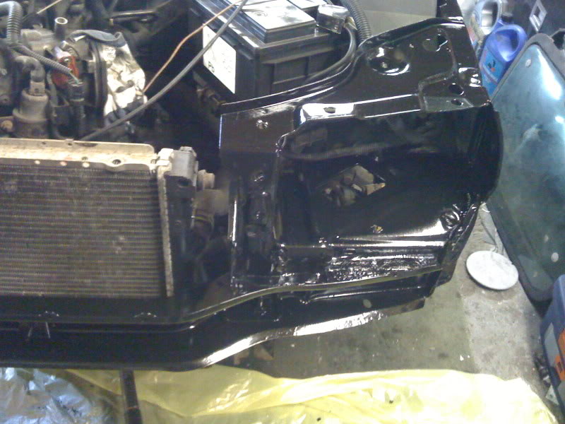

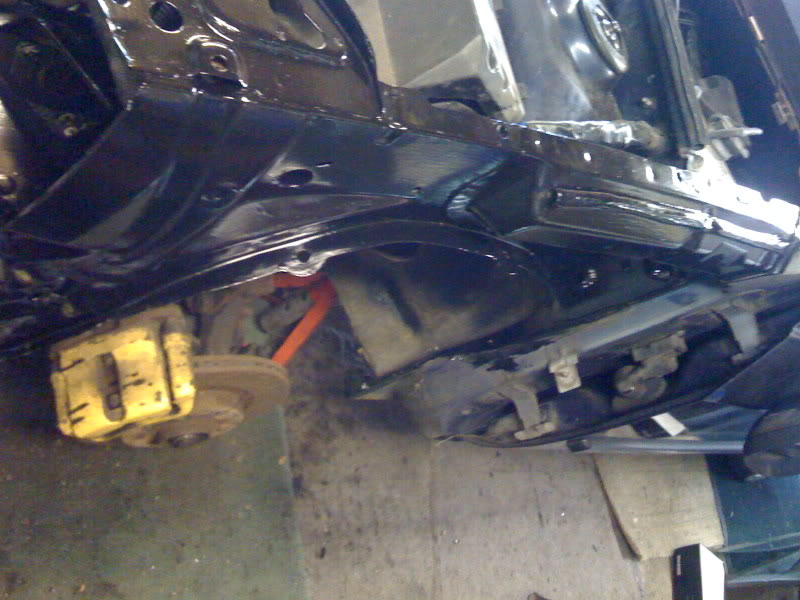

unseen areas of engine bay blacked with hammerite

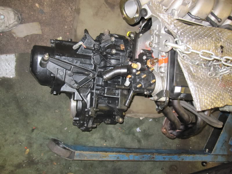

gave the gearbox a little clean
wishbones bushed up

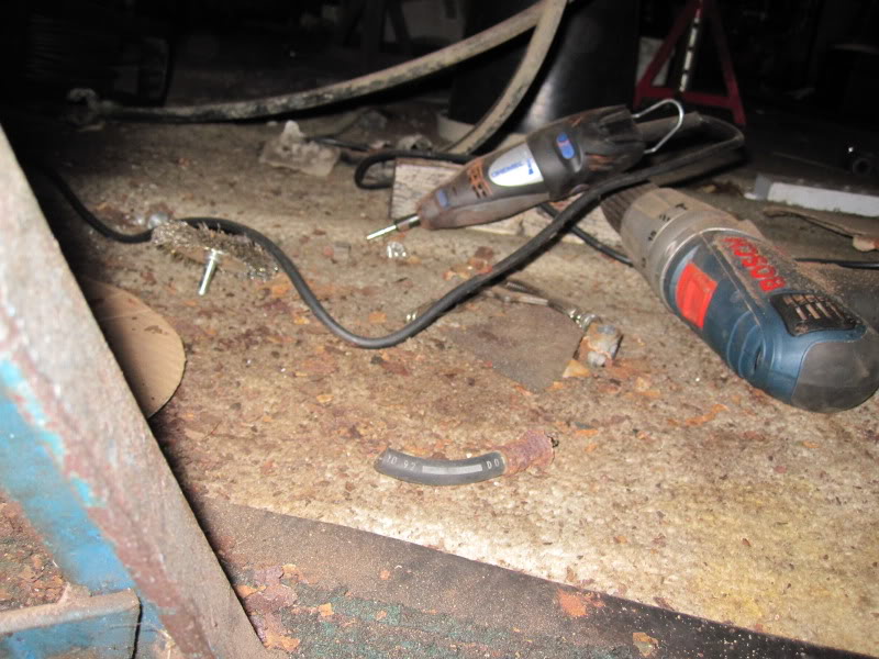

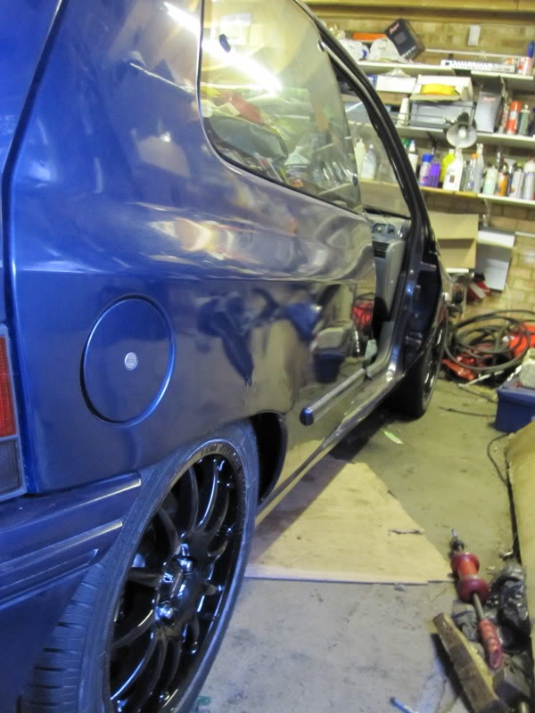

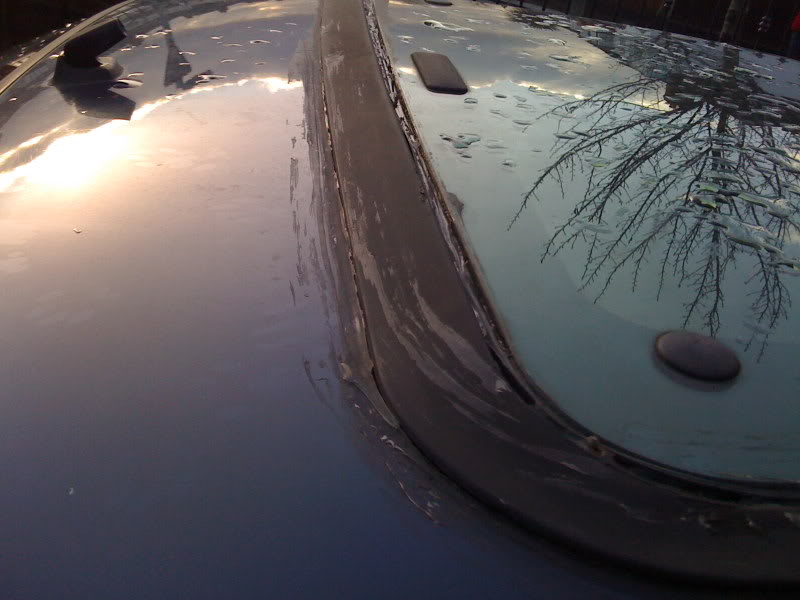

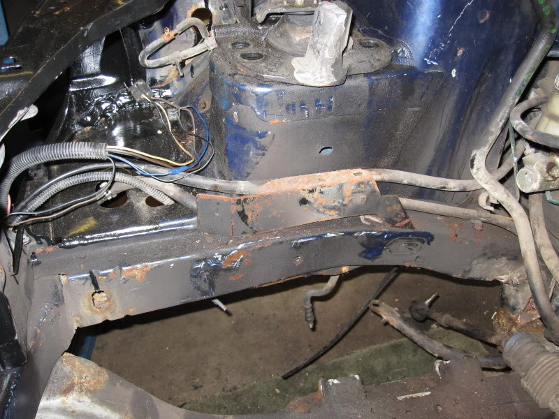

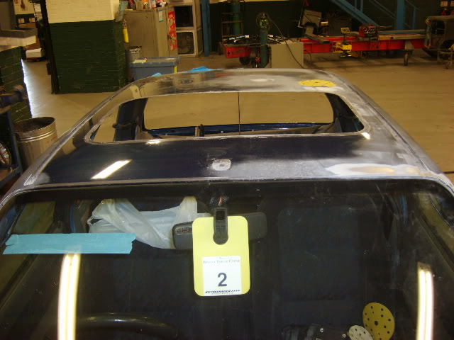

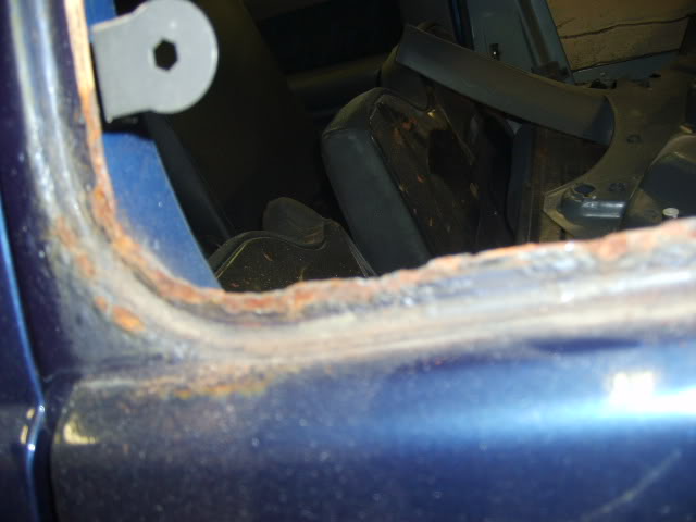

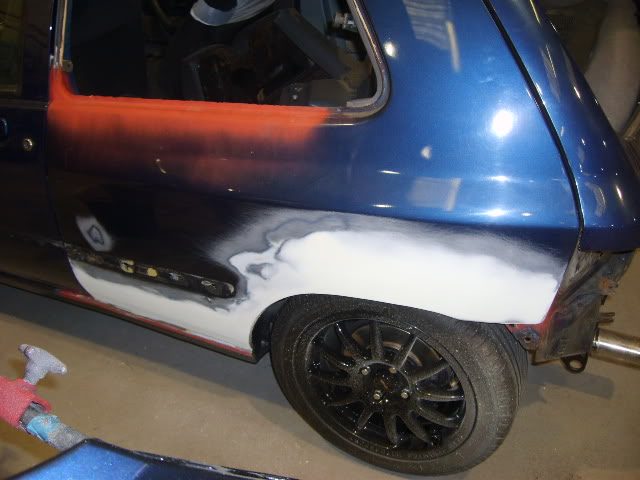

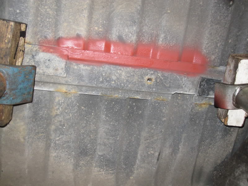

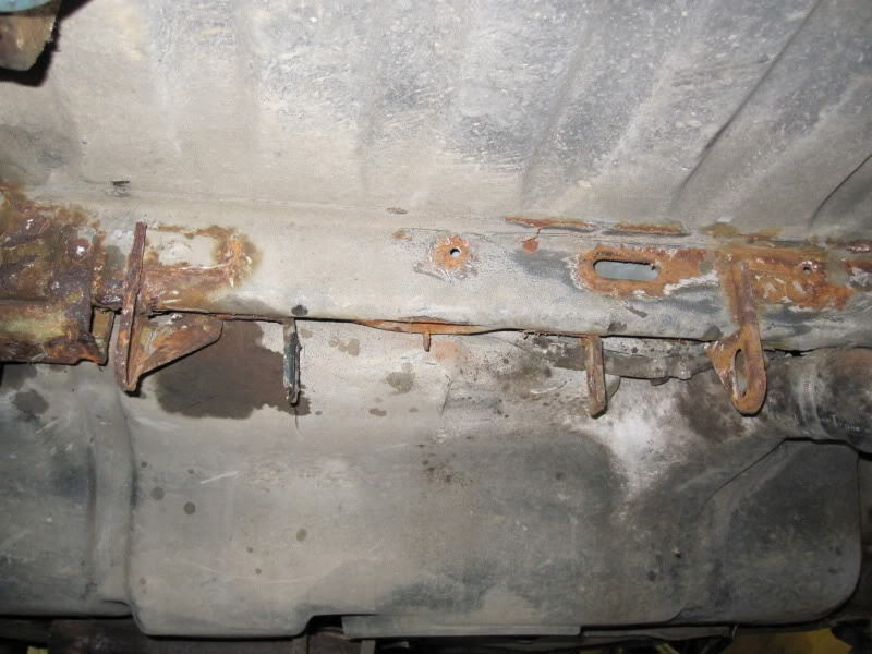

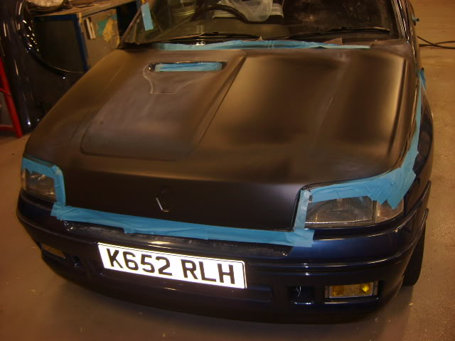

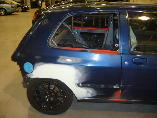

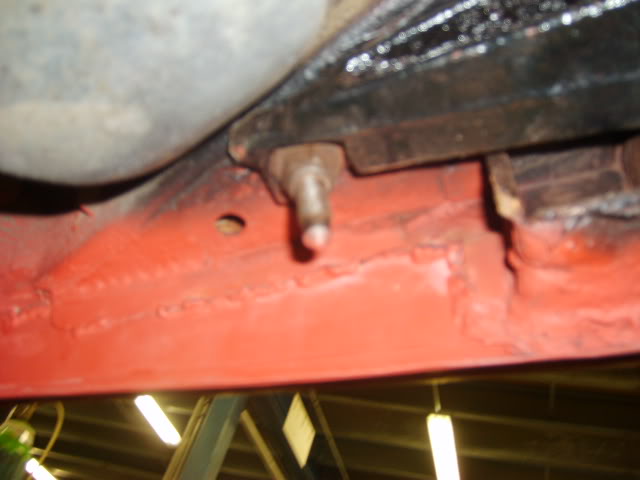

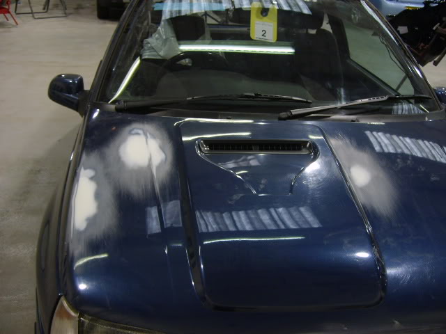

getting rid of the surface rust at the rear - bodyshop is cutting out all the rotten parts completly
i realised that hammerite is shite when applied to a surface that has been primed lol

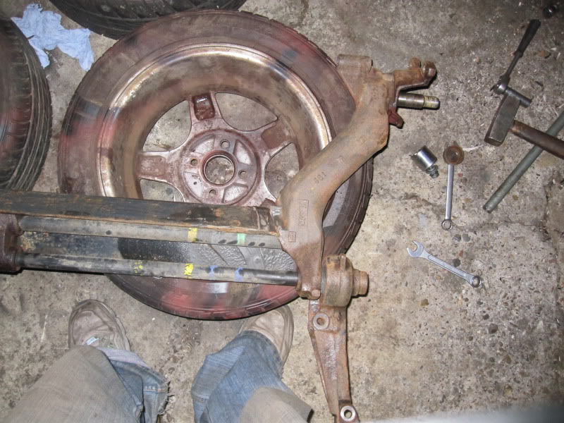

Rear Beam
before
after

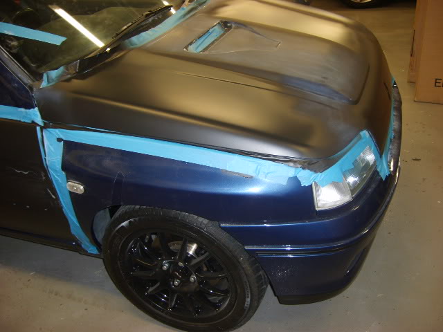

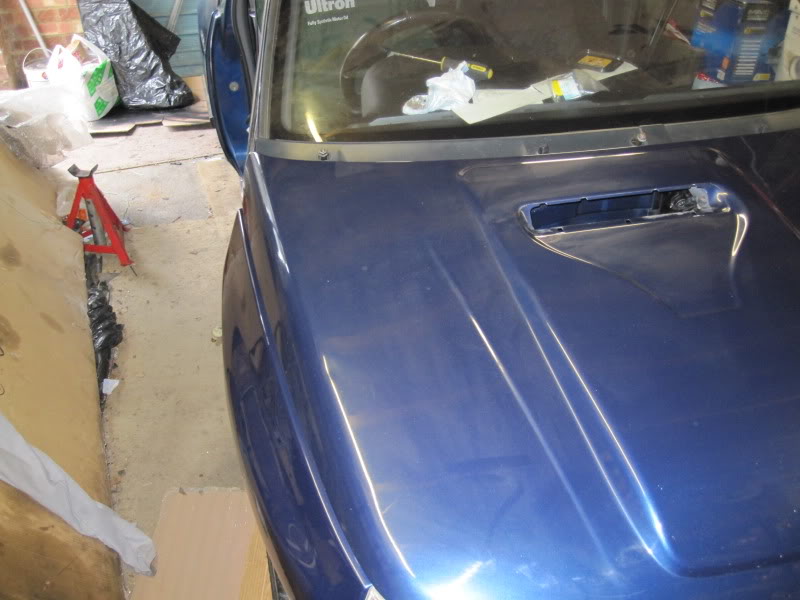

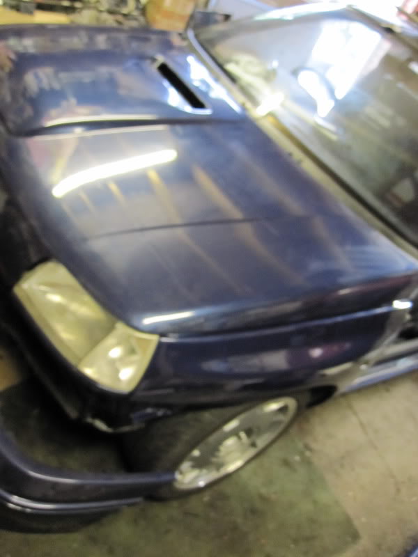

Wings & Bonnet on

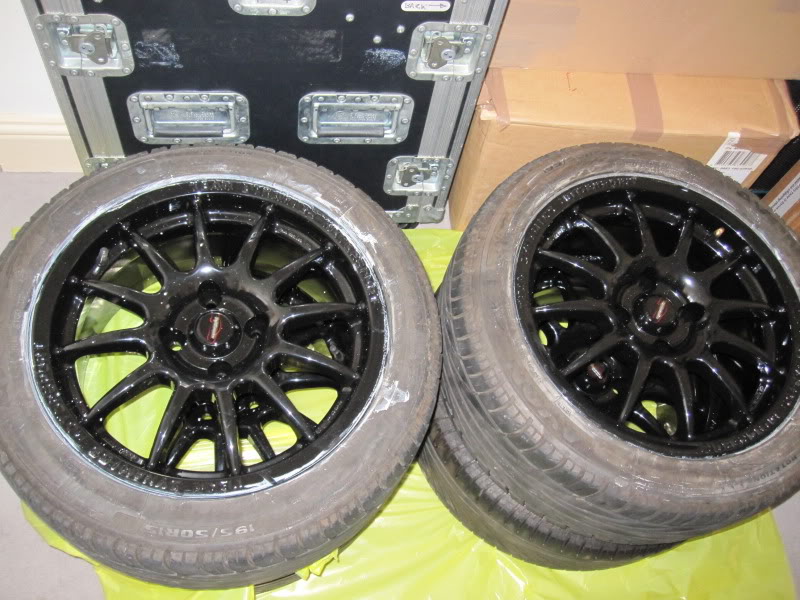

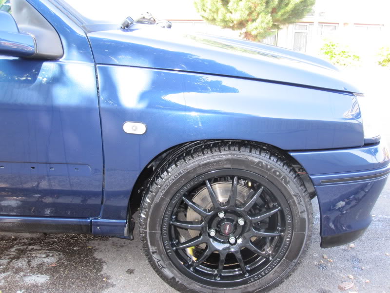

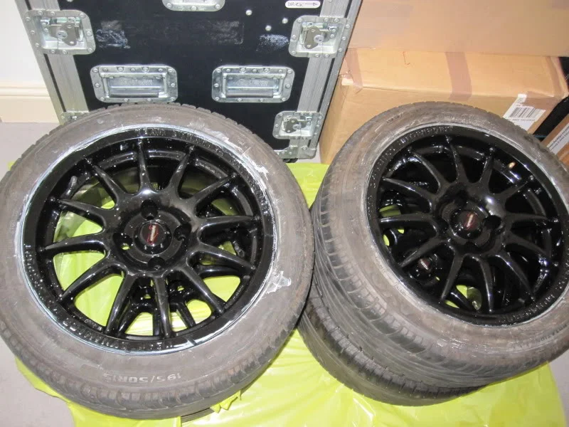

new wheels

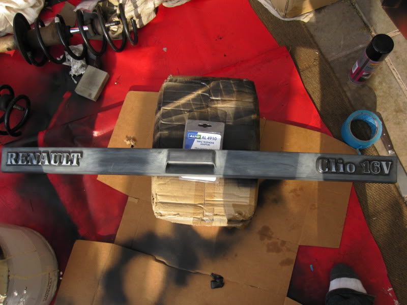

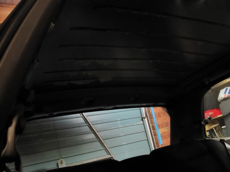

headlining out - easy job with a machete - headlining is still in mint condition too!

blacked bumper inserts
quick spring swap

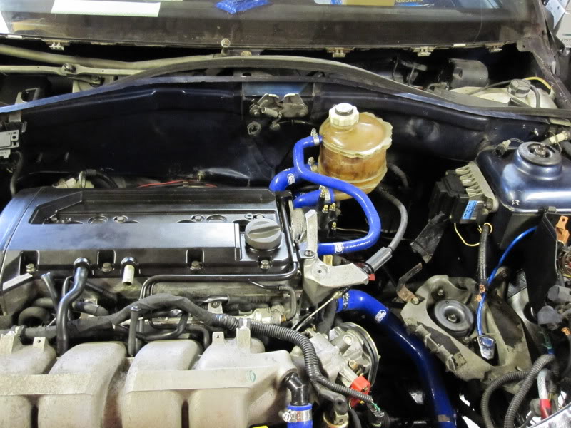

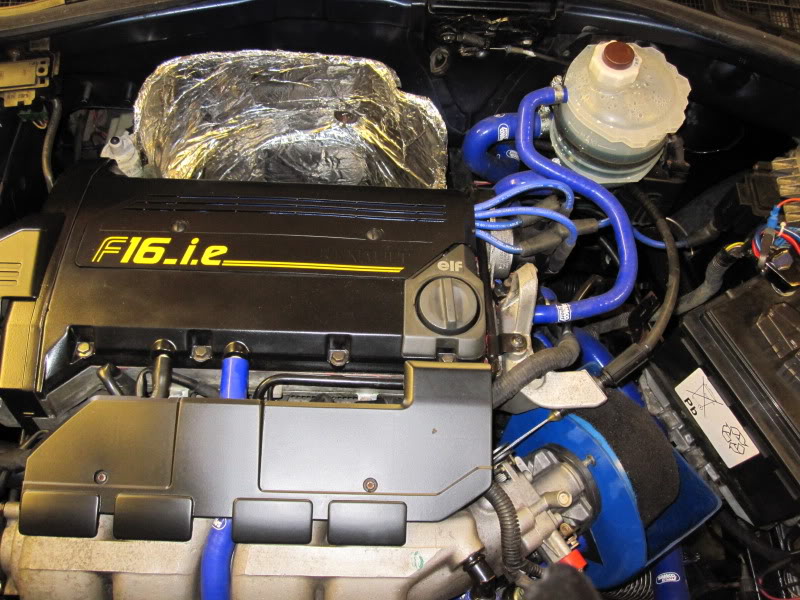

Engine Bay Photo
i have now got a new heatshield from midge - the one on there is a old on covered in kitchen foil lol

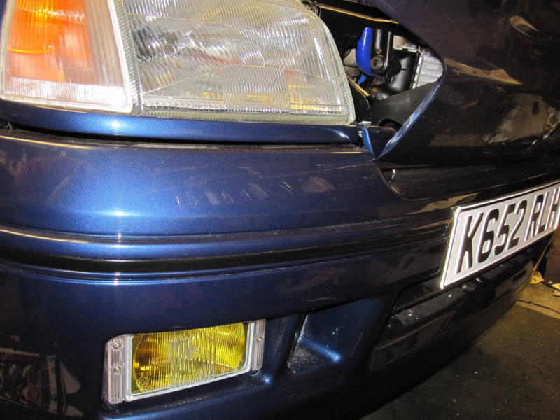

HID lights fitted (nicked from fiances car lol)
new yellow fog lights

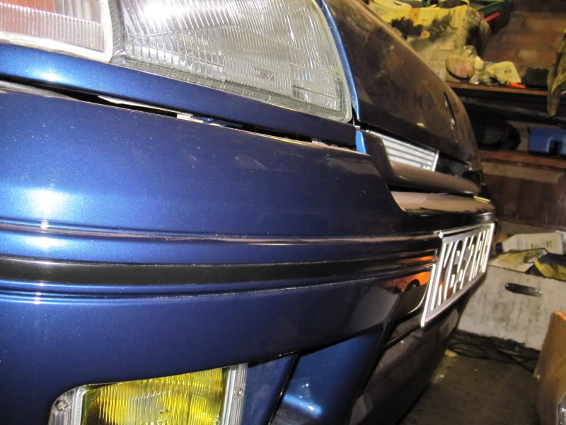

bumper inserts painted black
door handles colour coded
ph2 mouldings colour coded
PIAA dual tone horns mounted behind foglights (one each)
pH2 grill colourcoded and fitted
headlight strips colourcoded and fitted

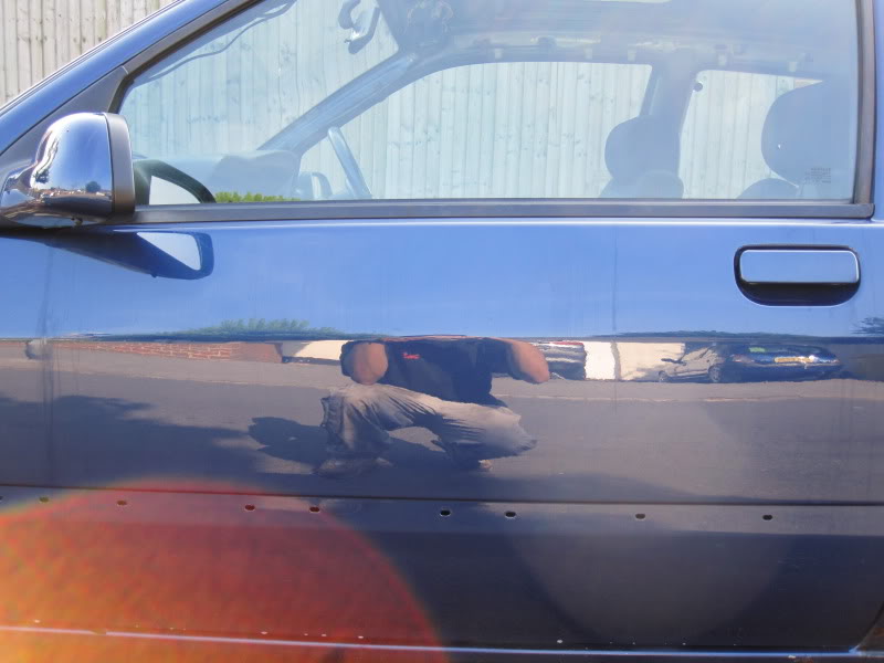

new doors to replace rusty ones (thanks dude from gillingham - i forget your name!)

Braided hoses all round
all brake lines replaced (had to be done after engine was in - doh!

One thing I will say though (I had a valver years ago) I had Avon zv's on it & tbh I found them awful.
  Chav Rocket
It's coming along nicely, nice write up too.
really? they were on some wheels that i bought a while ago and as i had them spare i whacked them on. what tyres are people favouring these days? ill probably change them soon.

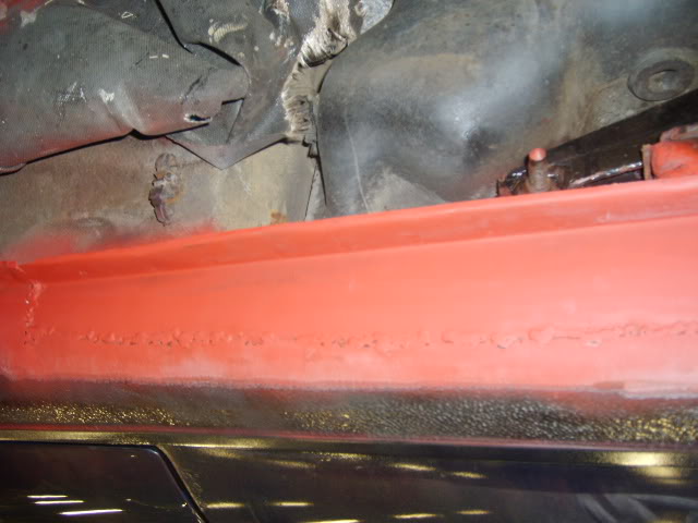

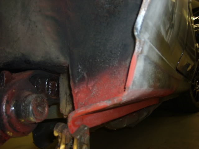

well at the moment its at dads work (Jack Barclay) and the arches and sills are being cut out and replaced as they are rotten.

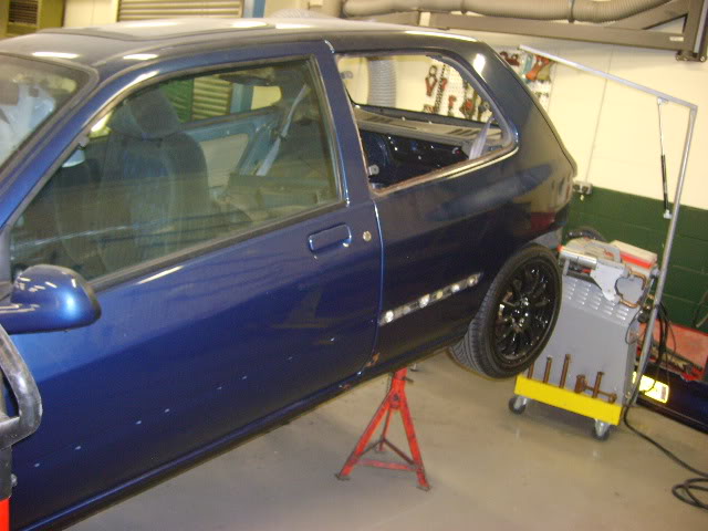

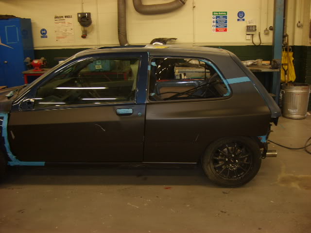

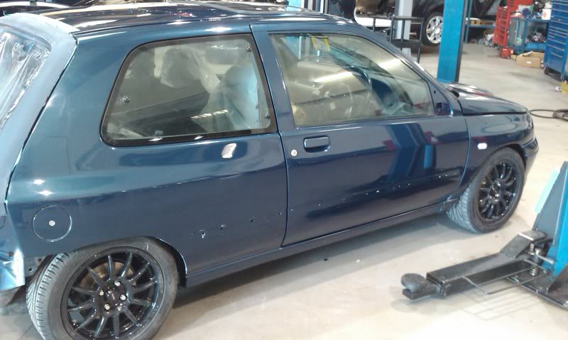

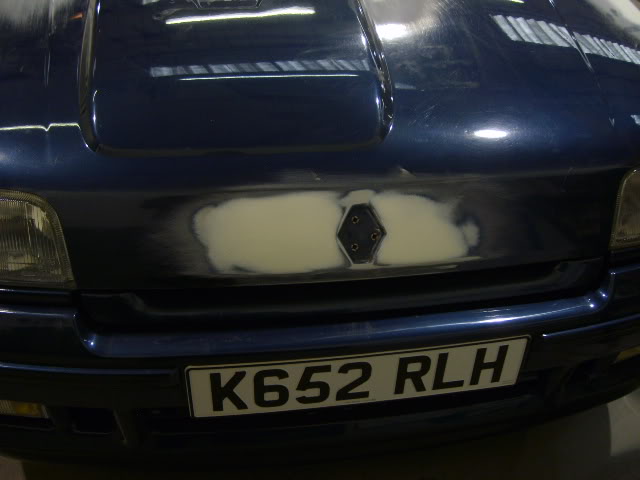

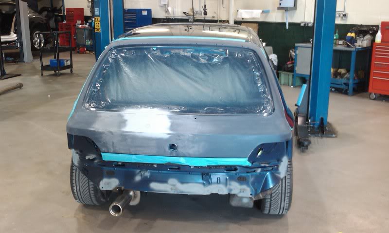

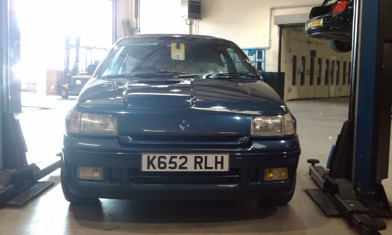

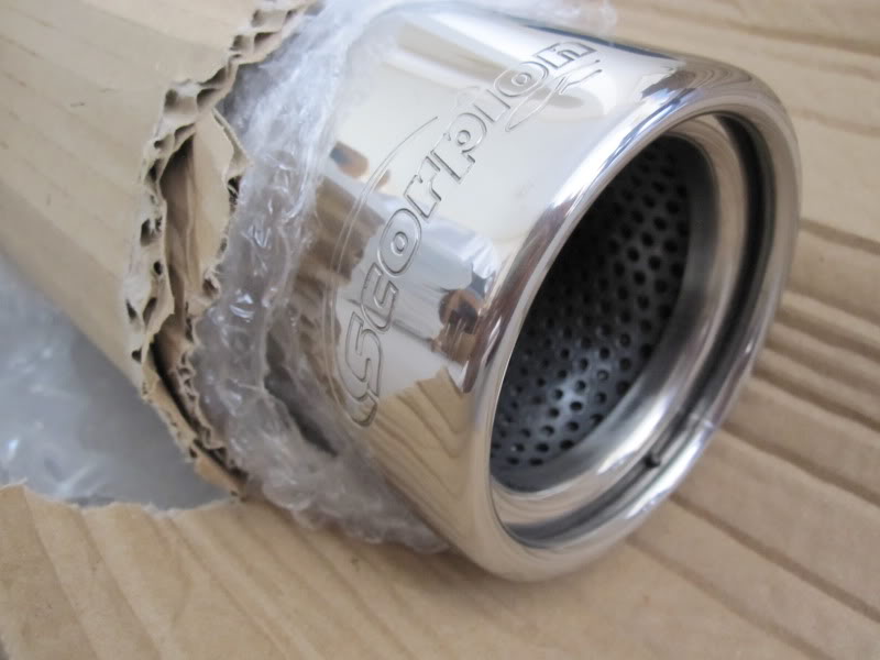

well its still at dads work in the body shop having a light tidy up- been slow progress for many reasons but its costing me less than it should so i havent been too bothered - on another note i'm now married - yay me! been to dads work a couple times to do some work on the car while we can use the ramp Installed Scorpion Exhaust cat back system and supersprint manifold setup which i had faced before installing. much better clearance from the downpipe to the driveshaft which was the main reason i got it. the new system is nice and quiet on idle, engine is still fresh so no hard revving. compared to the old one its a big difference the old one mainly because it was blowing in 2 or 3 different places!
fitted
if anyone wants a williams downpipe and manifold let me know. here is the car in the panel beaters bay

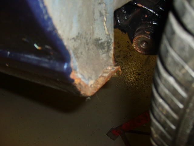

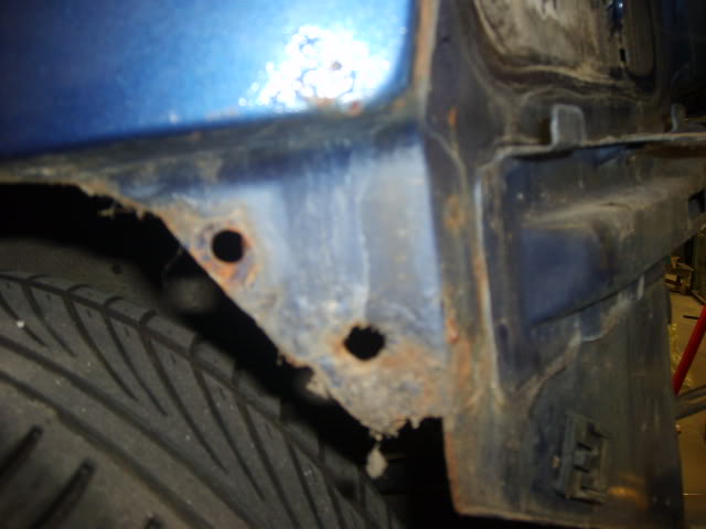

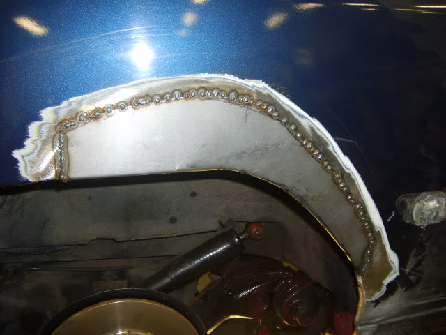

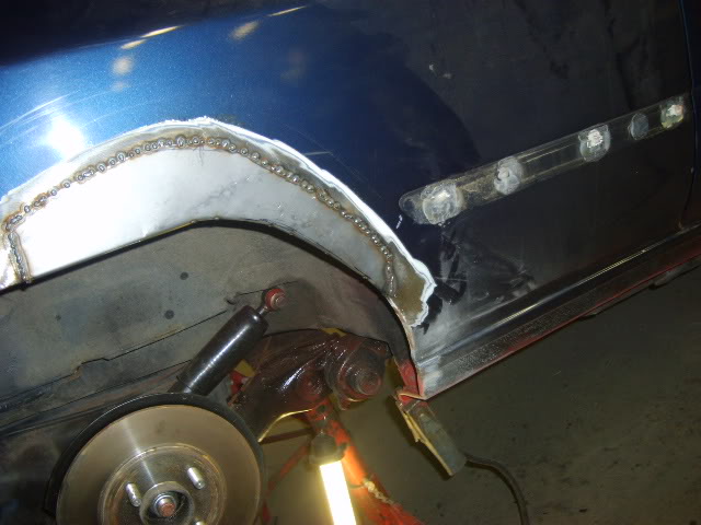

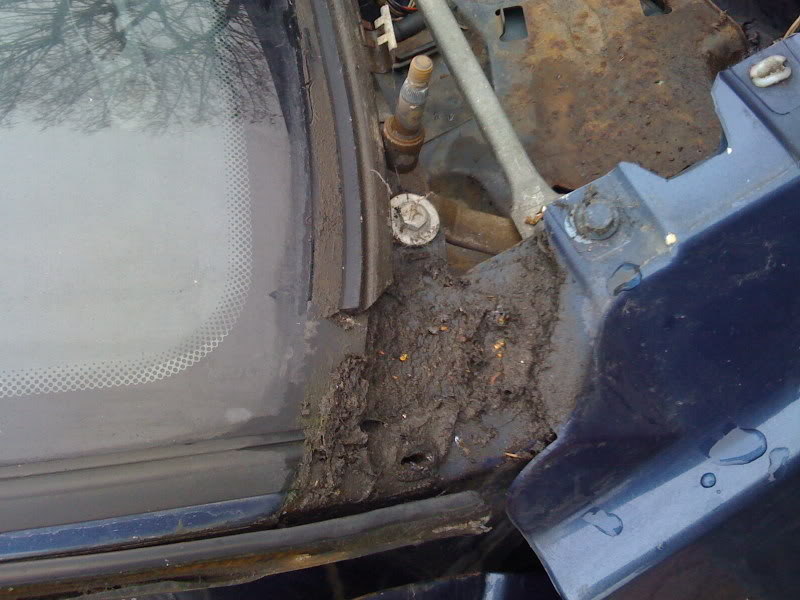

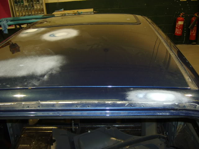

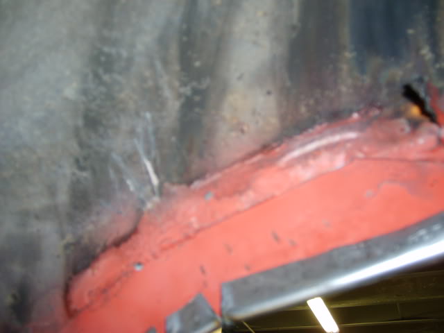

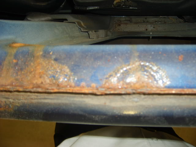

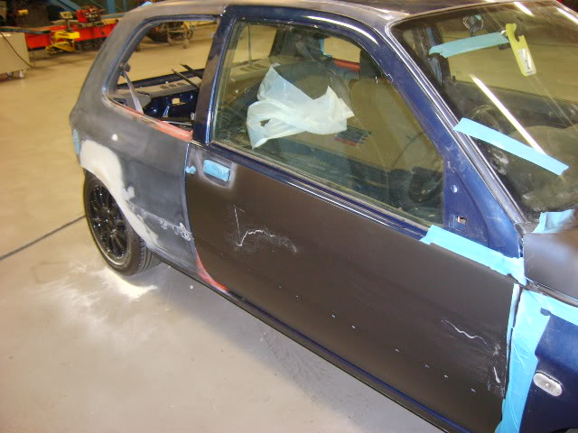

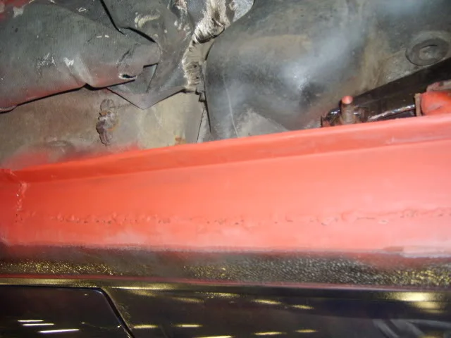

some of the discovered rust
if i decide to keep the car ill have it all done a bit more properly but for now it will do new arches
general prep pics

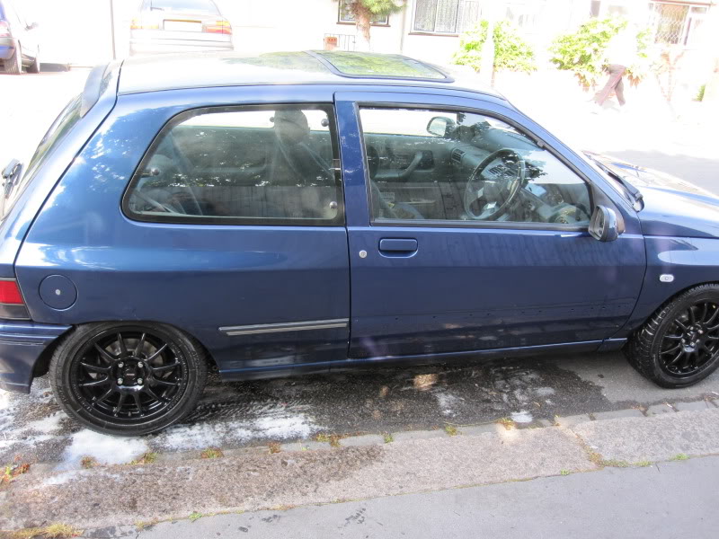

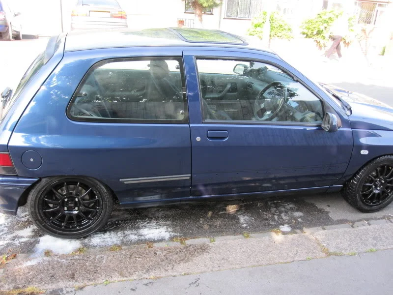

looking a bit nicer :)
compared to when i first got it
