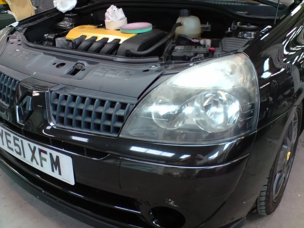

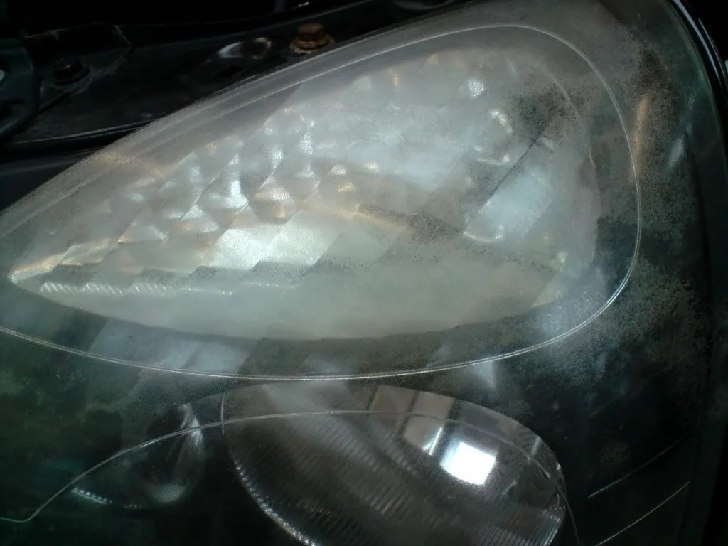

My headlights have been like this for a while now , all cracked and dull.
Not too sure how this happends but i know a few other clio owners that have this problem.

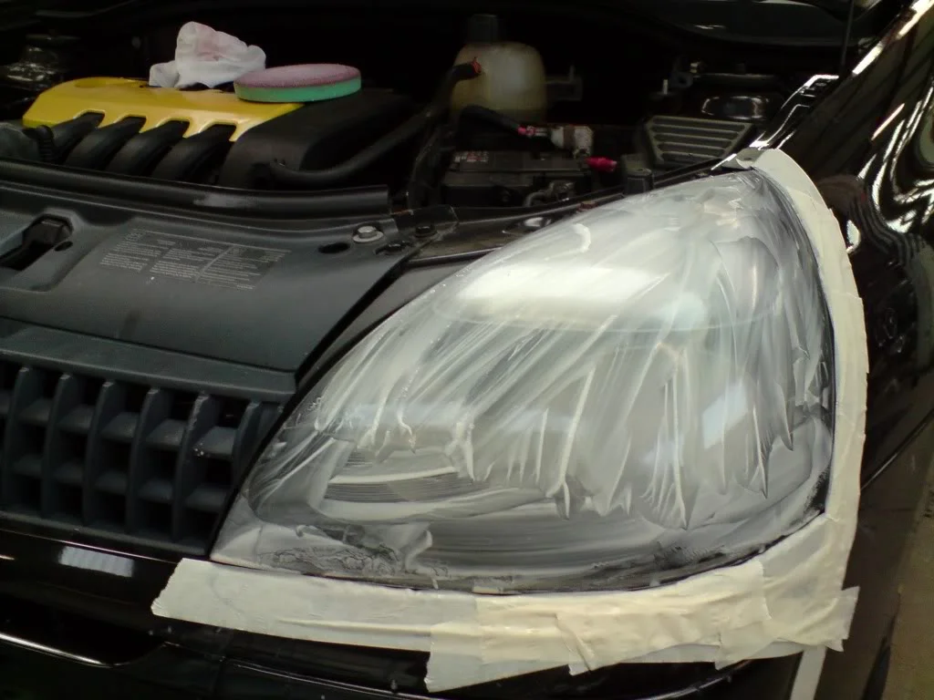

On the thursday lunchtime at work i got the car into the shop and masked up the lights.
I then got out the block with 1200 wet 'n' dry and began to sand out the marks.
After a while they looked spotless exept flatting down the headlights made them rather dull :(

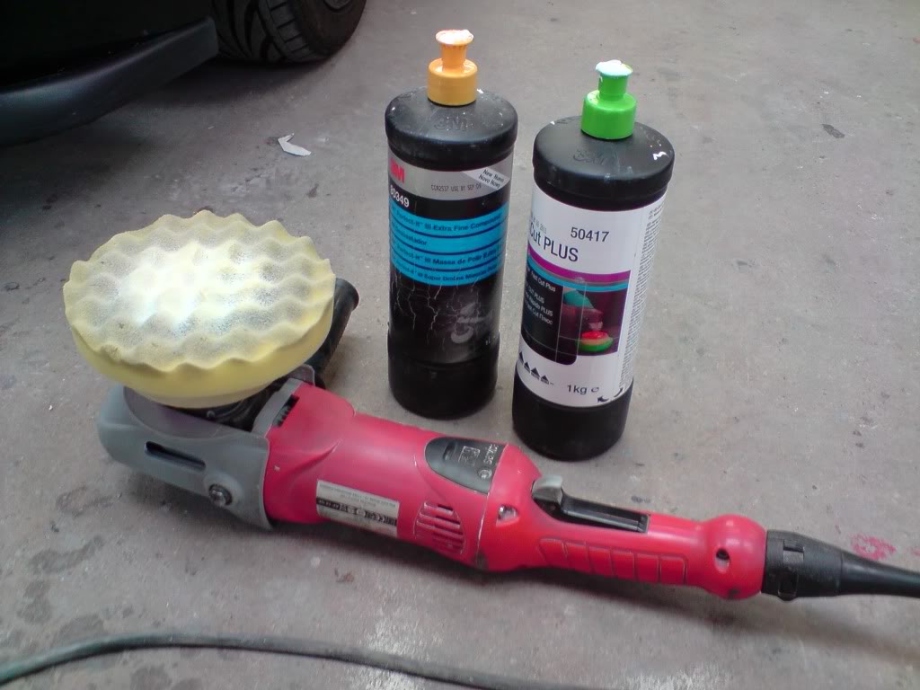

Anyway i got out the machine polisher and wacked on some compound ...

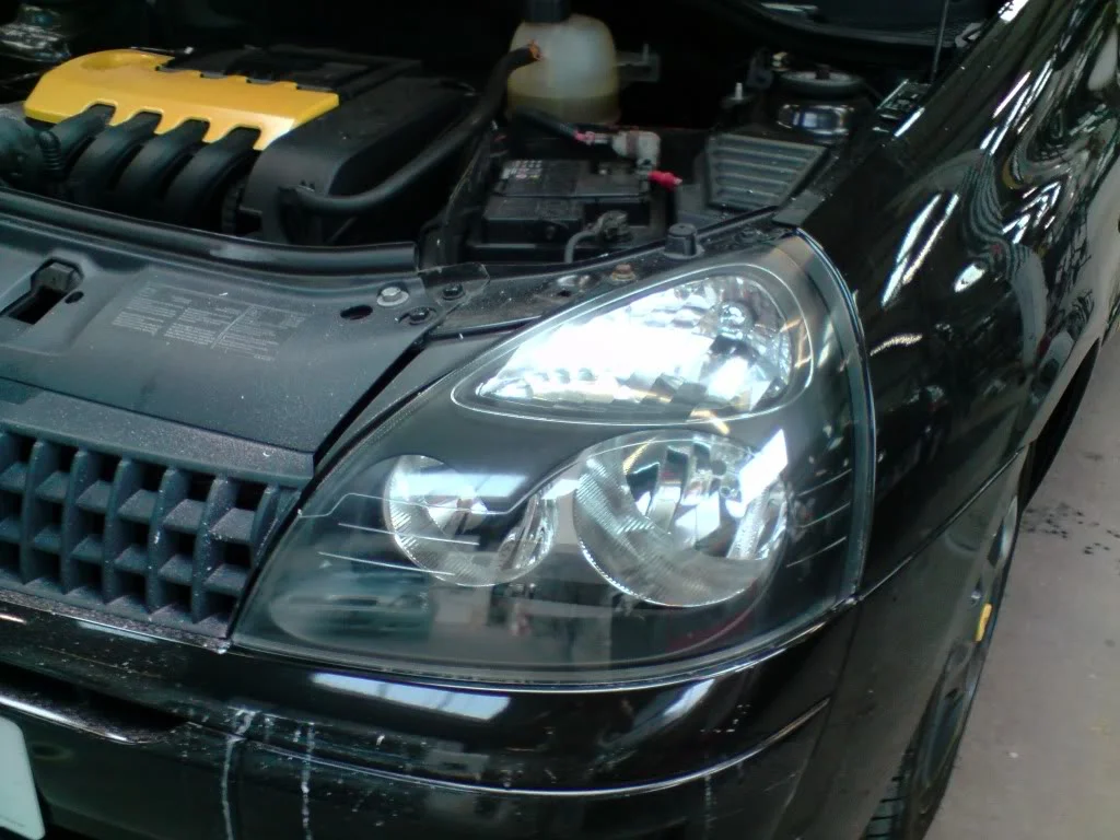

once i had apllyed a coat or 2 i did the same with ultra fine polish and finaly ultra gloss finish.

Good job :)

They look much better, what products did you use? My right headlight is by far so much more DULL than the other one :dapprove:

I used 3M fast cut plus , 3M ultra fine compound and 3M final finishing glase

didnt think you'd be able to do that with it being plastic actually! looks a hell of a lot better now

They look 100 times better, good work.

Really worth the 15 minutes it took me on lunch break tbh :D glad i was bothered to do it lol.
