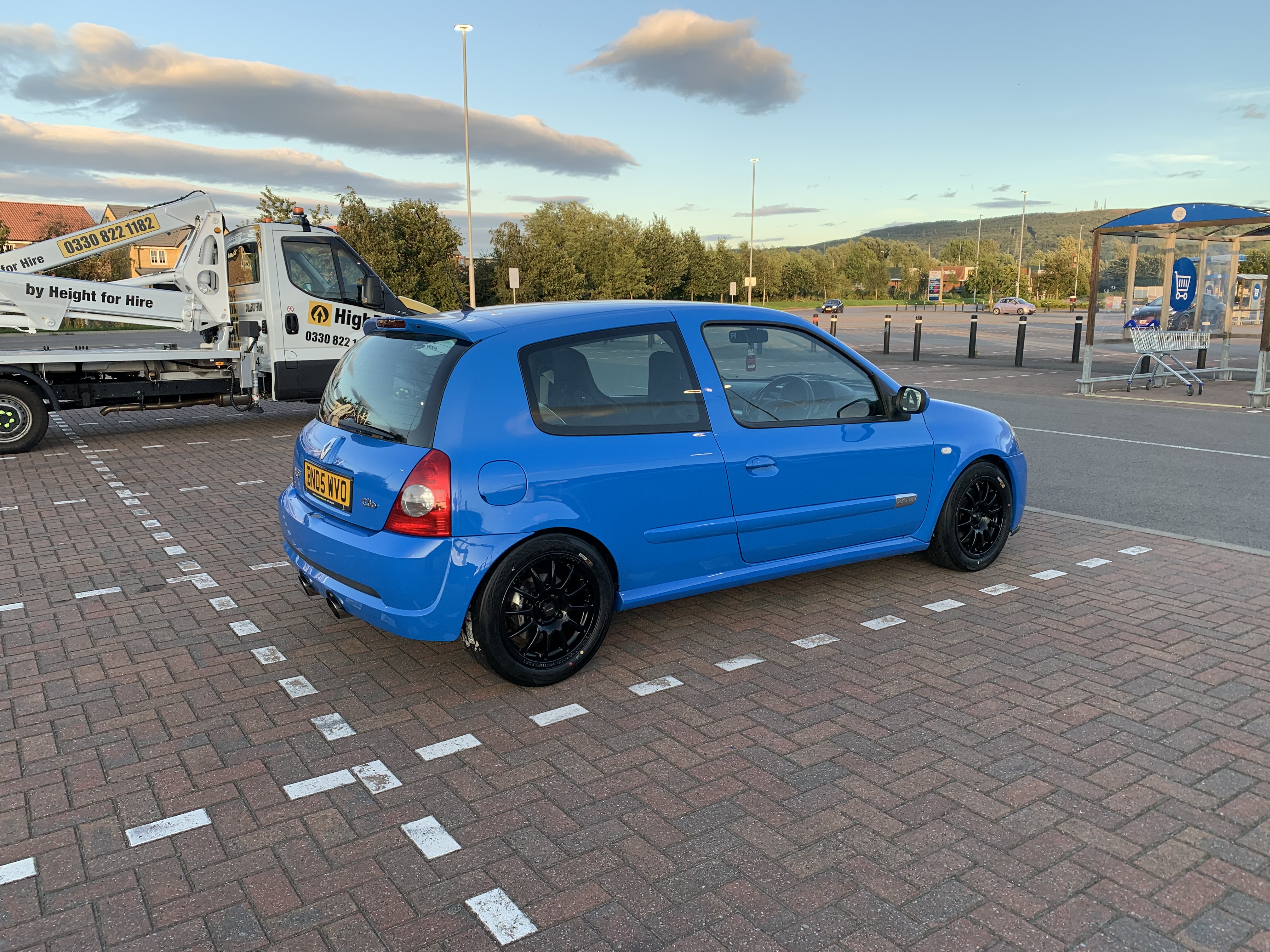

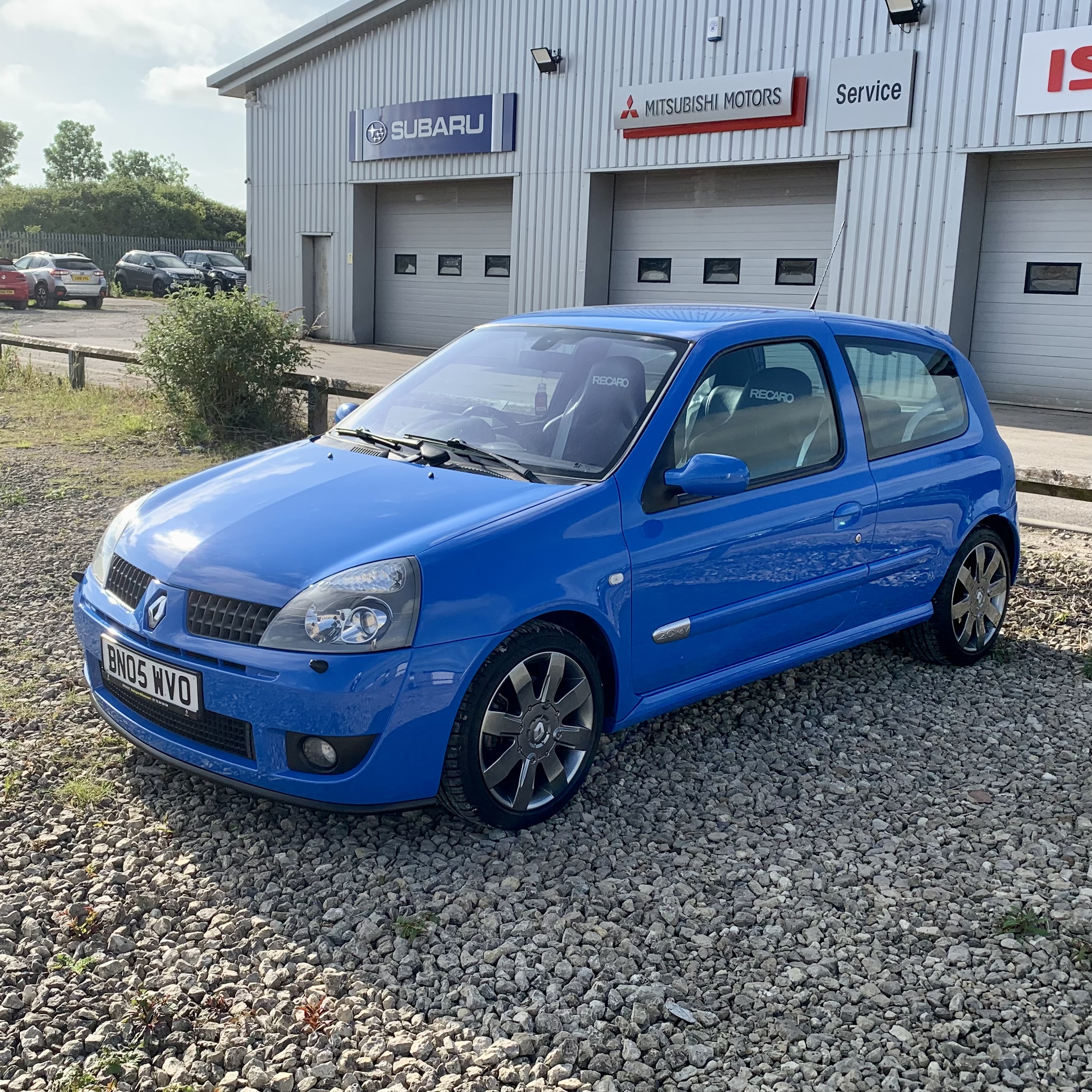

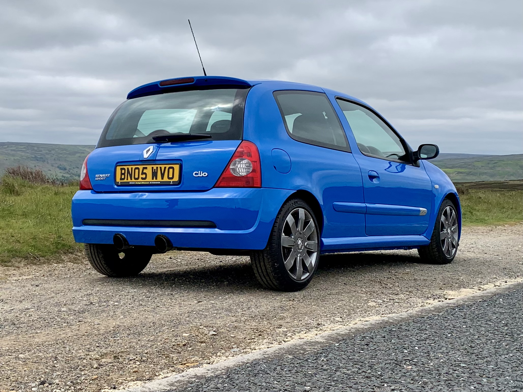

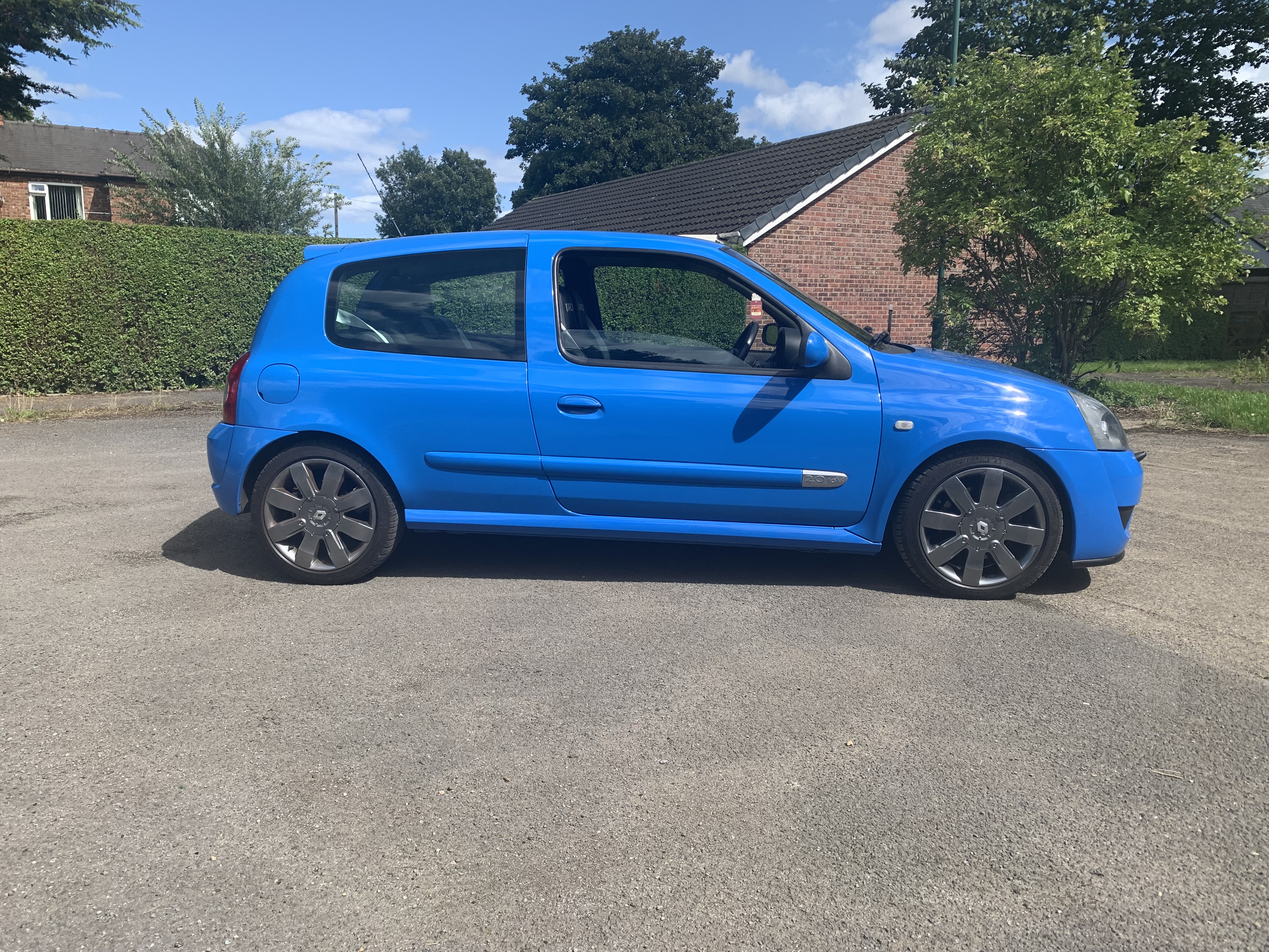

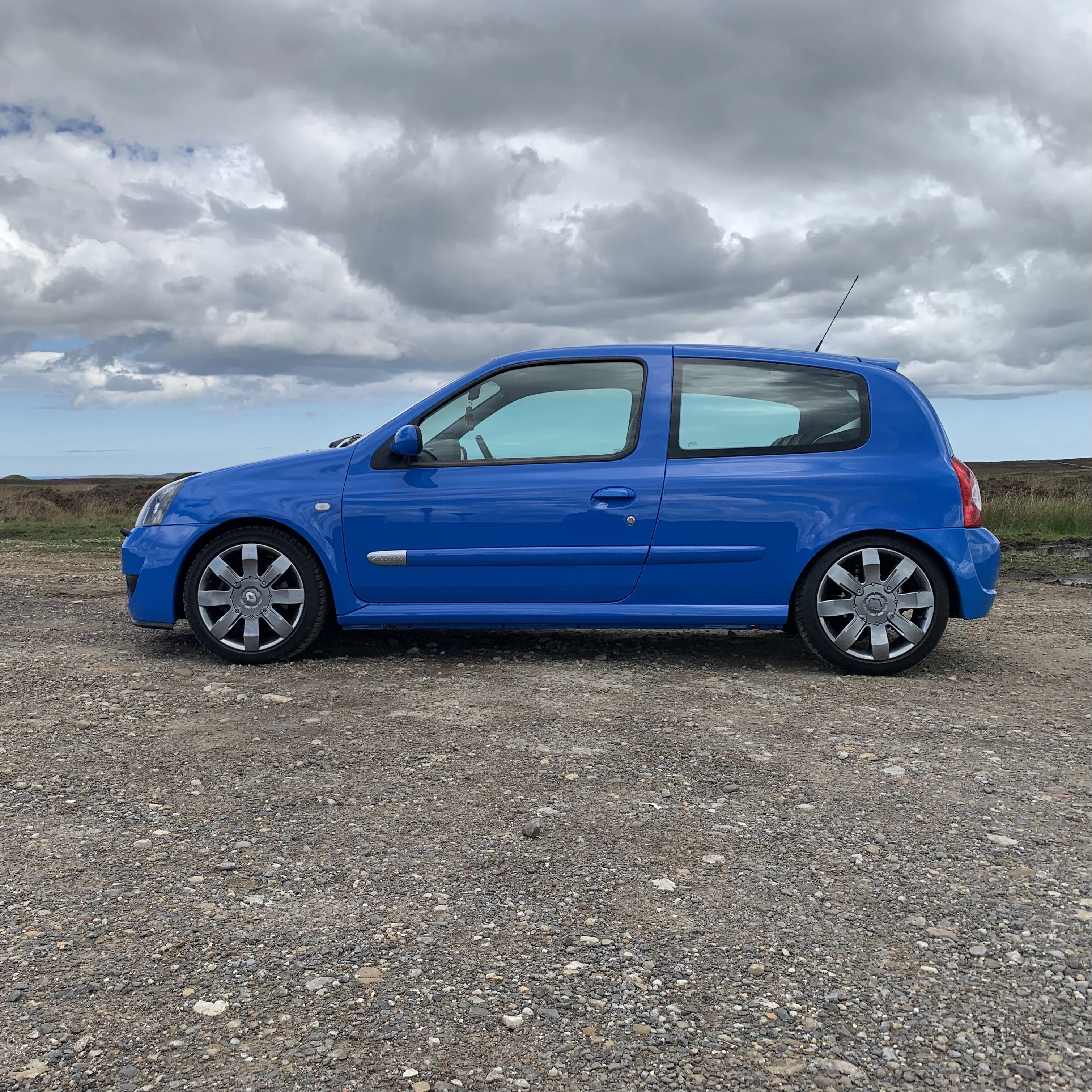

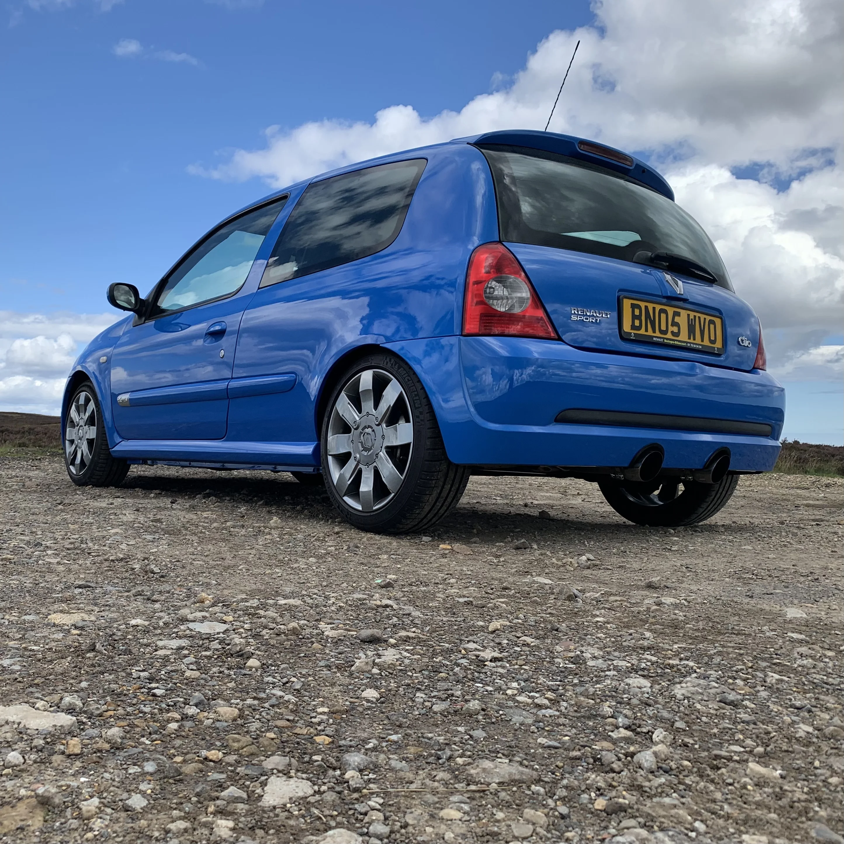

It’s great to be back out in these amazing little cars. Couldn’t help but take a pic as I was heading home for the evening. She got her 3rd wash since I bought her, but it‘s desperately in need of a proper detail. Going to get her booked in soon.

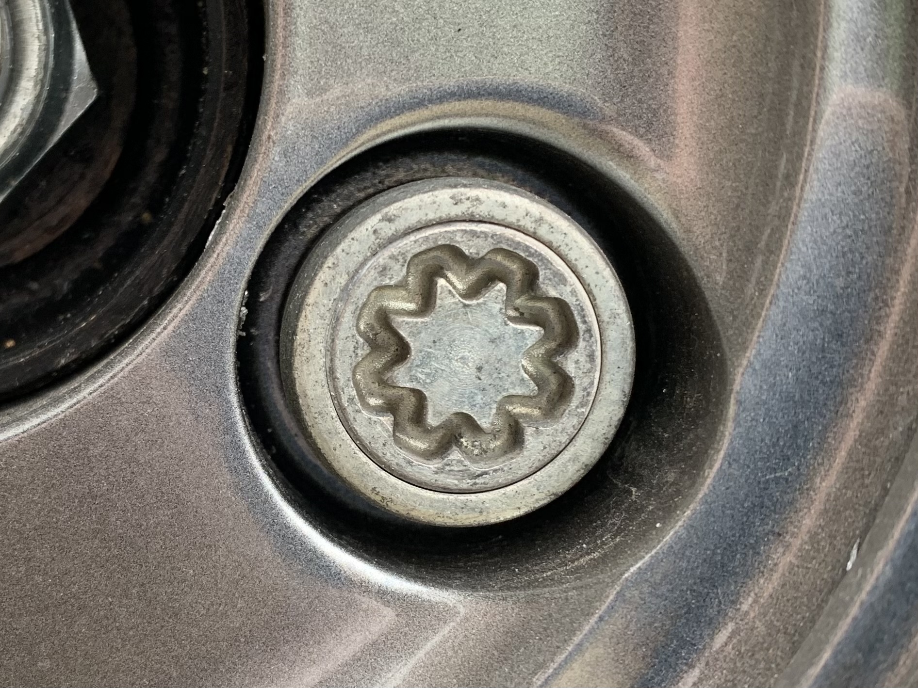

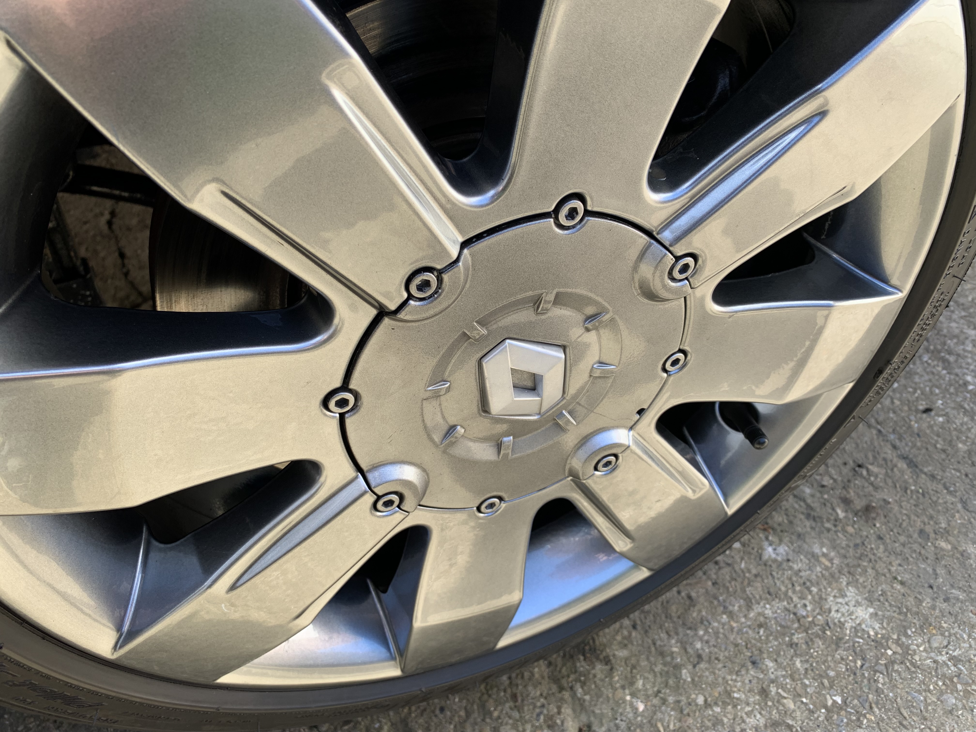

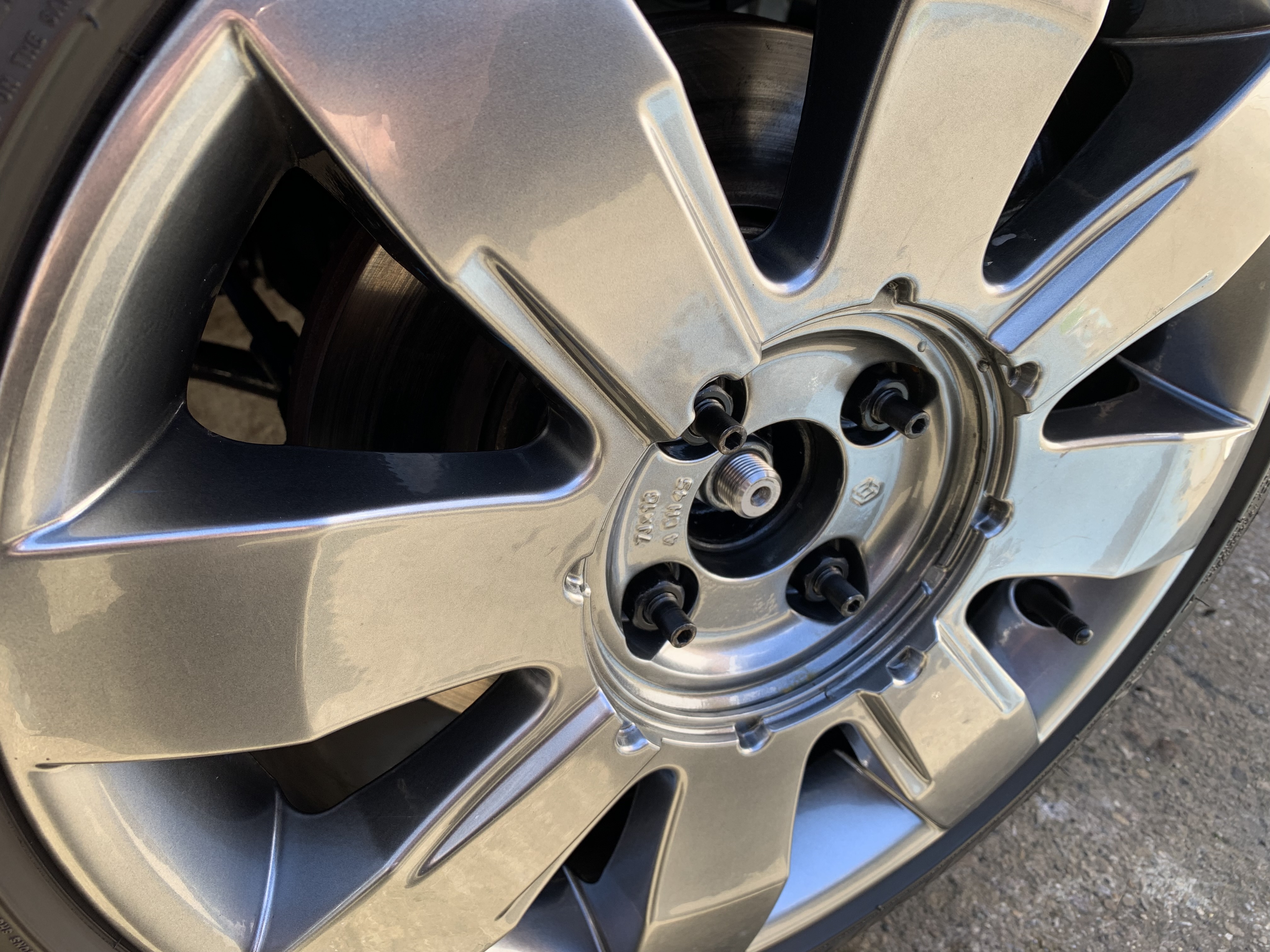

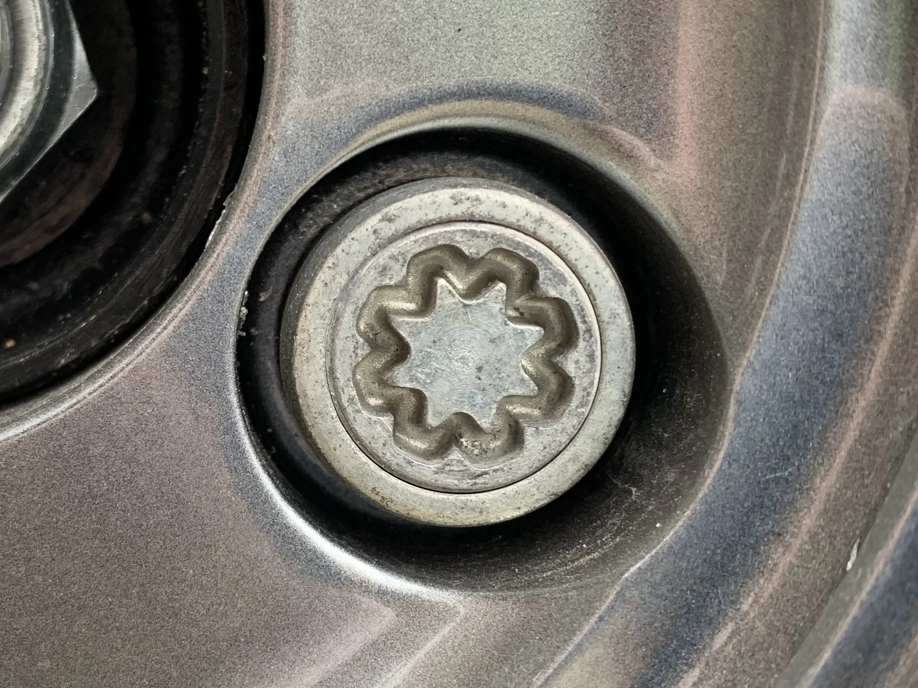

In other news I’ve lost my flippin locking wheel nut key. I’ve literally turned the garage and house upside down but to no avail. I have a feeling it was in the ashtray of old BG as I never liked leaving it in the RB whilst in storage. Spoken to the new owner but nothing has materialised.
I’ve dropped a message to my Renault dealer and will put a post up here of the pattern. No idea if these things can be identified or replaced but hopefully CS can help.

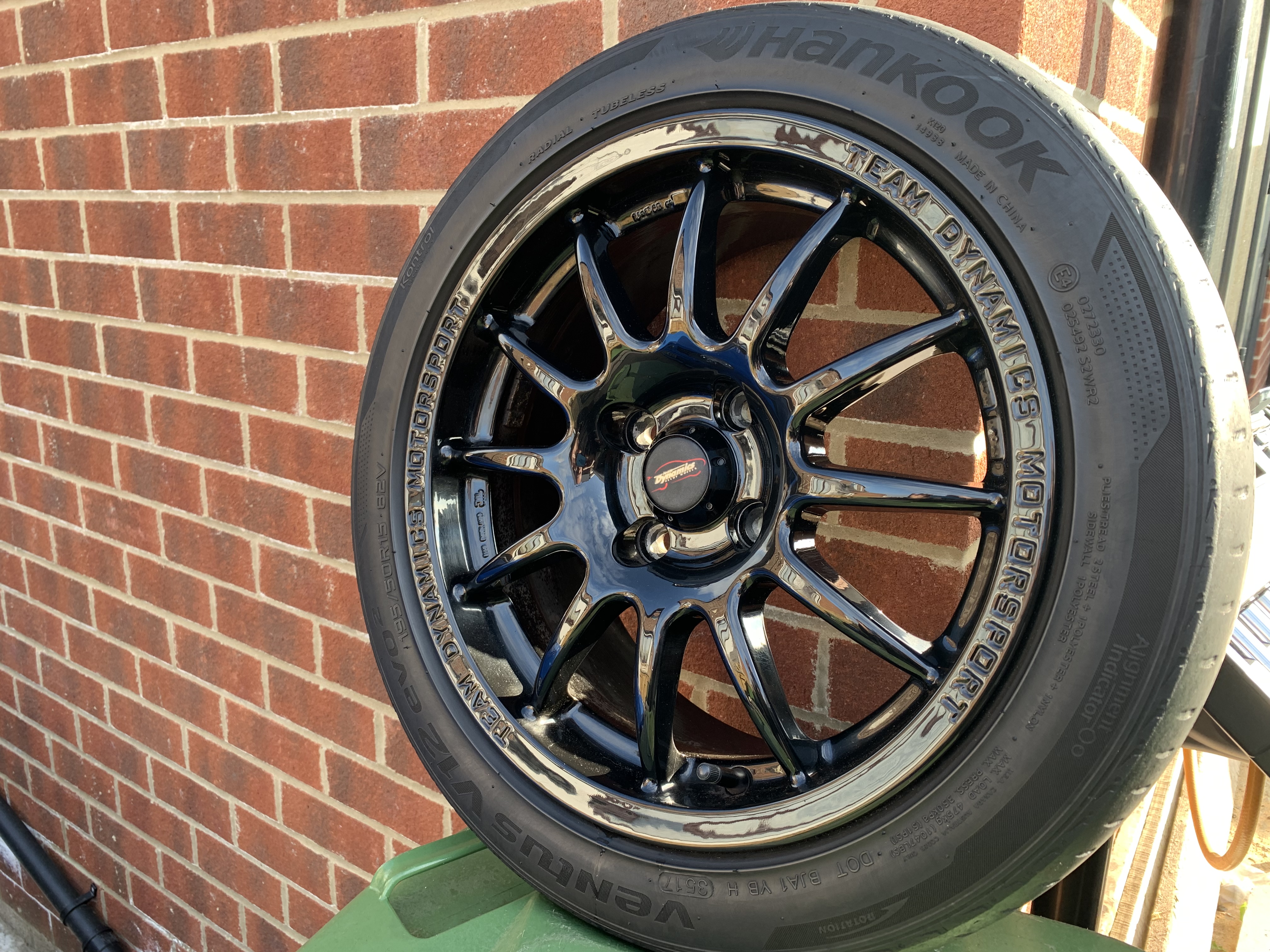

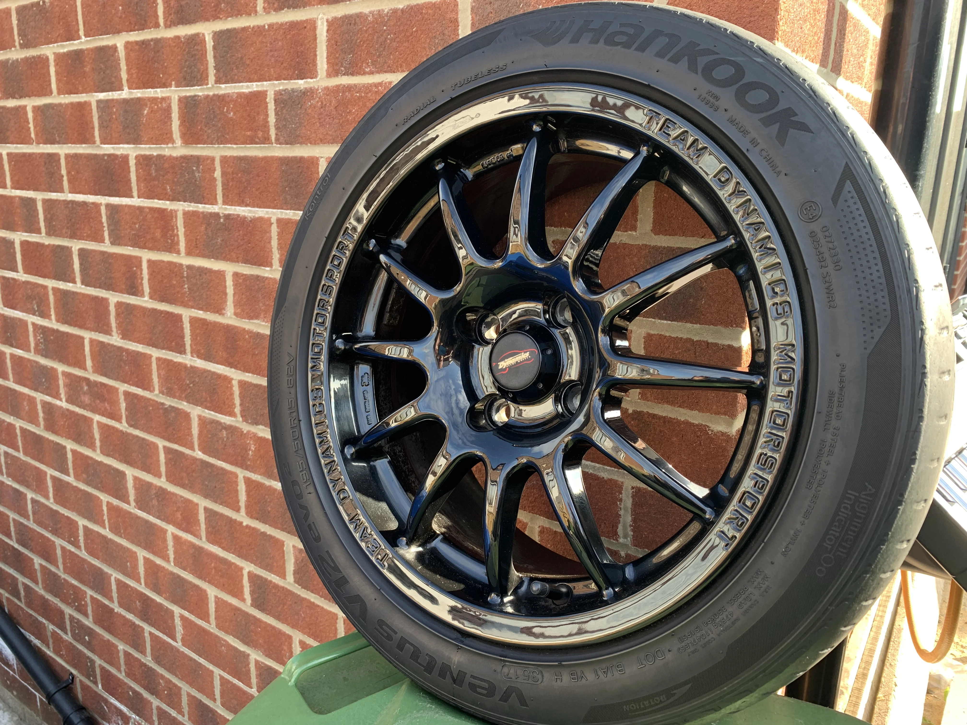

It’s not all bad news though as I did a quick midweek trip down to Derby to pick up some really clean Team Dynamics Pro Race 1.2 wheels. I‘ve been looking for a clean unmolested set forever after selling 3 sets of them 2 years ago 🤦🏻‍♂️ I’m f*ckin stoopid.

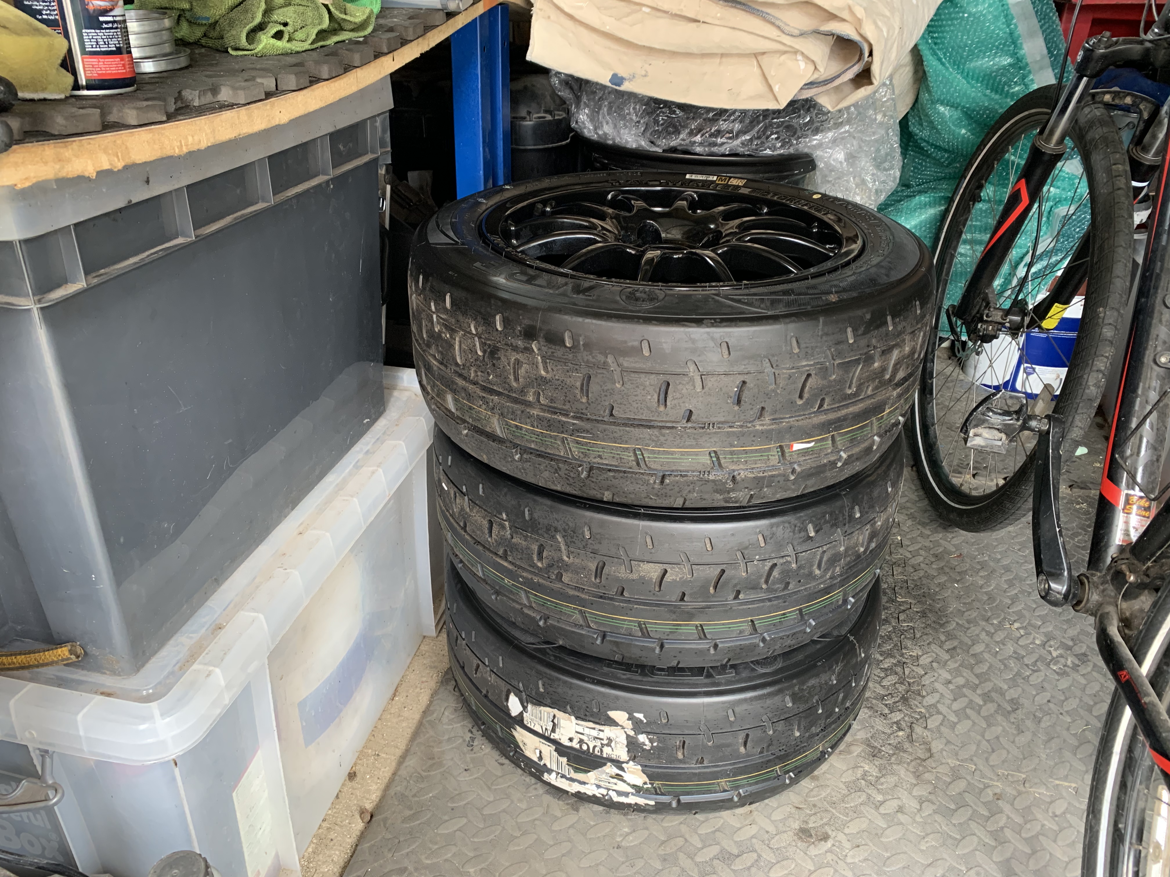

These won’t be my daily wheels, but I’ll use them for when I visit my local circuit. Can’t decide on tyres just yet. I usually go with A052’s as they’re a proven circuit tyre, but I’m also hearing good things about MRF ZTD’s. We’ll see.

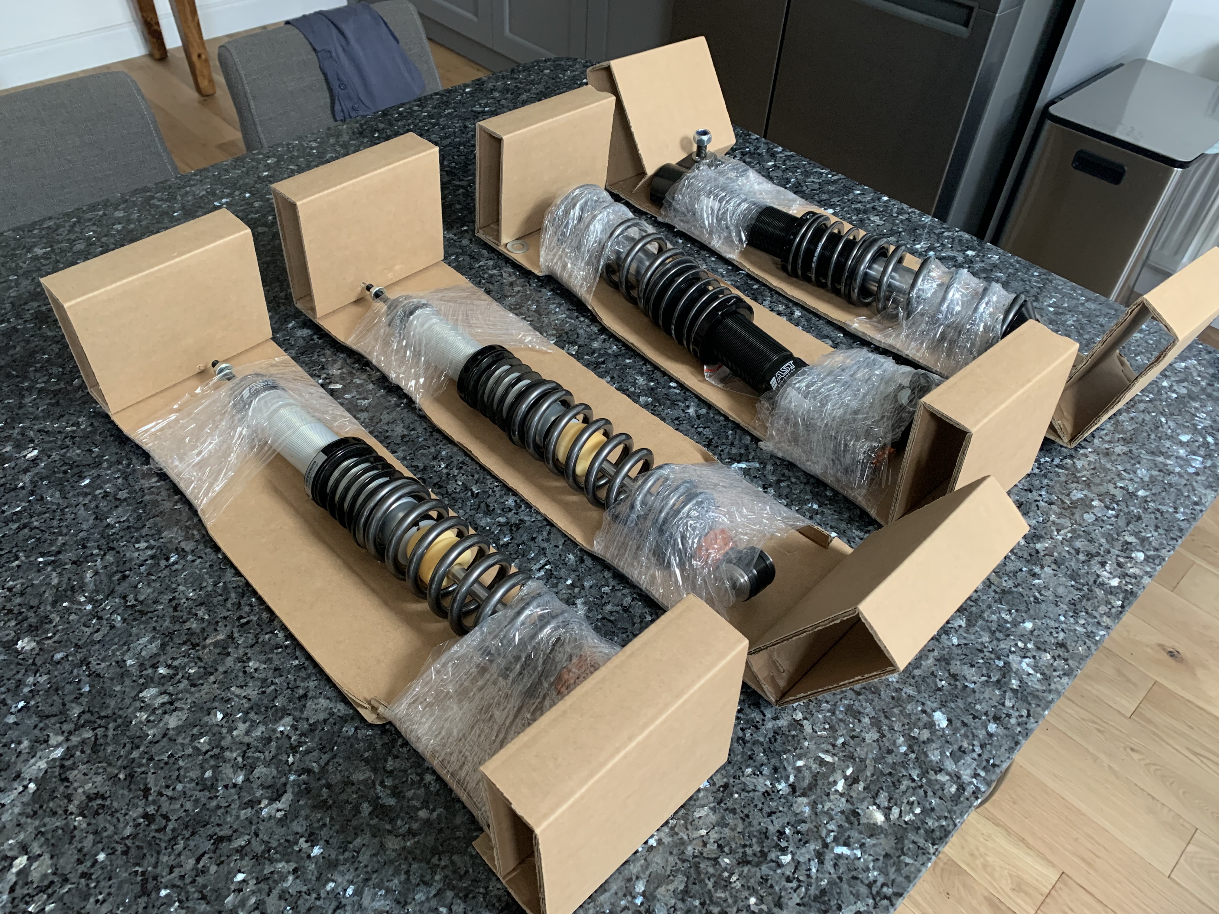

On the subject of suspension, 5 weeks after ordering my AST’s I made a call to see where they were after initially being promised 3 weeks. Allegedly something went wrong in the ordering process so AST Holland never picked the order up. s**t happens I guess, so it’s going to be July now before I get my hands on them.

Mr Trailer Man
Used those before for a replacement on my dad's Ford.
Sent them pictures and one turned up and fitted perfectly.
Wasn't the cheapest at around £50 though.

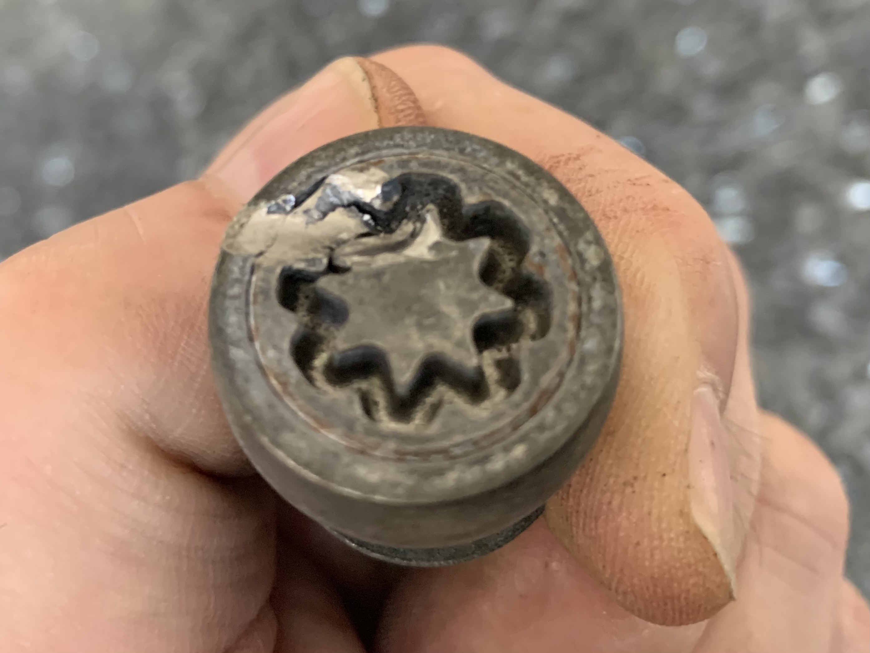

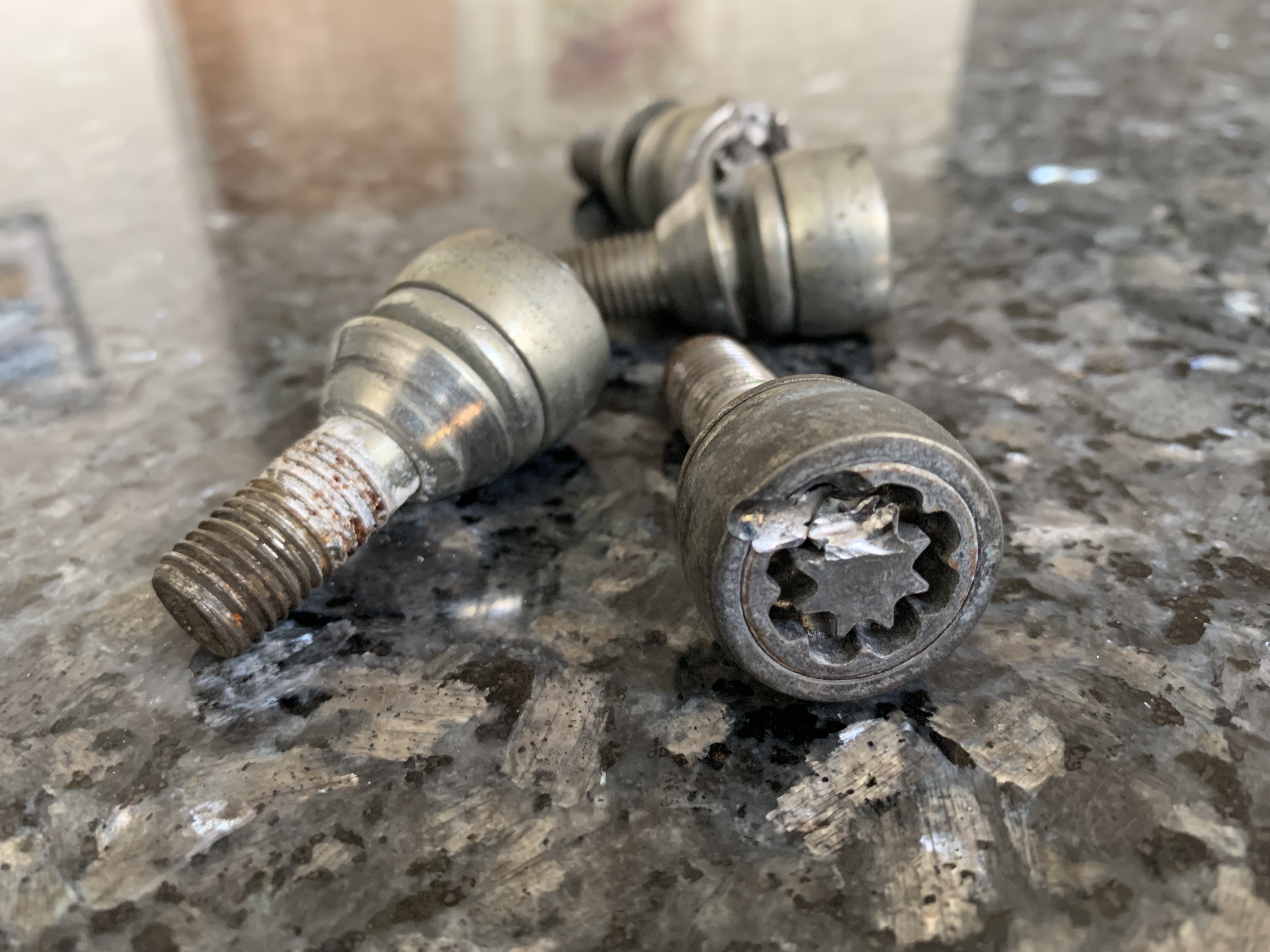

In my last update I mentioned I’d lost my locking wheel nut key. Thanks to @JamesBryan sending me a link, I was able to track down a replacement. It worked out at £45 plus £30 delivery but as I was ready to travel, thought I’d leave it until I got back.
I’m replacing the factory bolts with a stud nut kit, so £75 to essentially throw the key away seemed stupid.
So I gave it to one of our techies, who pulled out a hydraulic chisel, gave it a few ugger duggers and 5 mins later they were off.

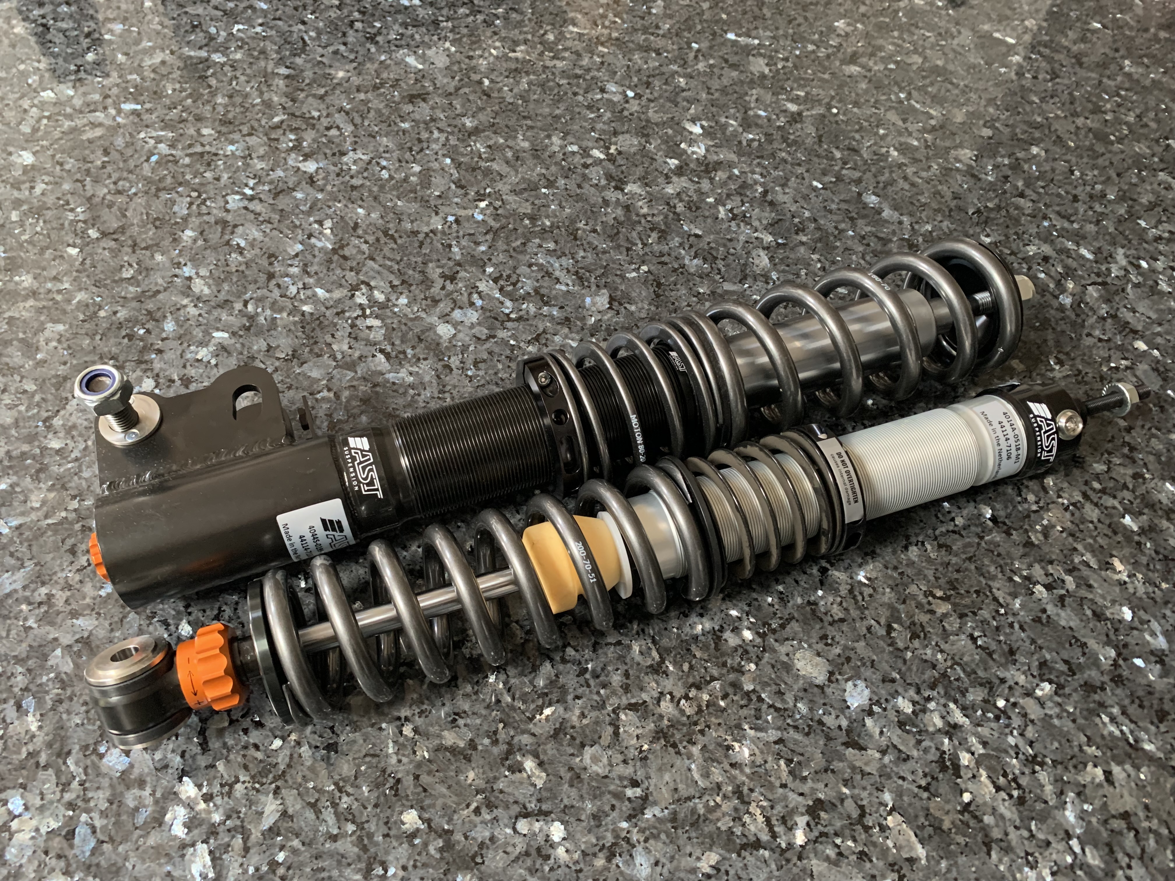

With that job out of the way, I can now look at replacing the suspension. Now I won’t go into the hows and why’s, but Cooksport managed to screw my order up. They’re a good bunch really and got it sorted.
A nice big box was waiting for me on my return.
After discussing my options with Simon at Cooksport I went with AST 5100s. As I’m using the car primarily for the road with the odd circuit day, I opted for 70NM front and rear.
I was going to get Cooksport to fit and set them up, but the delay clashes with other things I’ve got going on, so just need to get it booked in somewhere more local to me. A lad I used to use at Track Torque Racing in York has left, so I may still use them. But if anybody knows somewhere close to North Yorkshire, then drop me a pm.

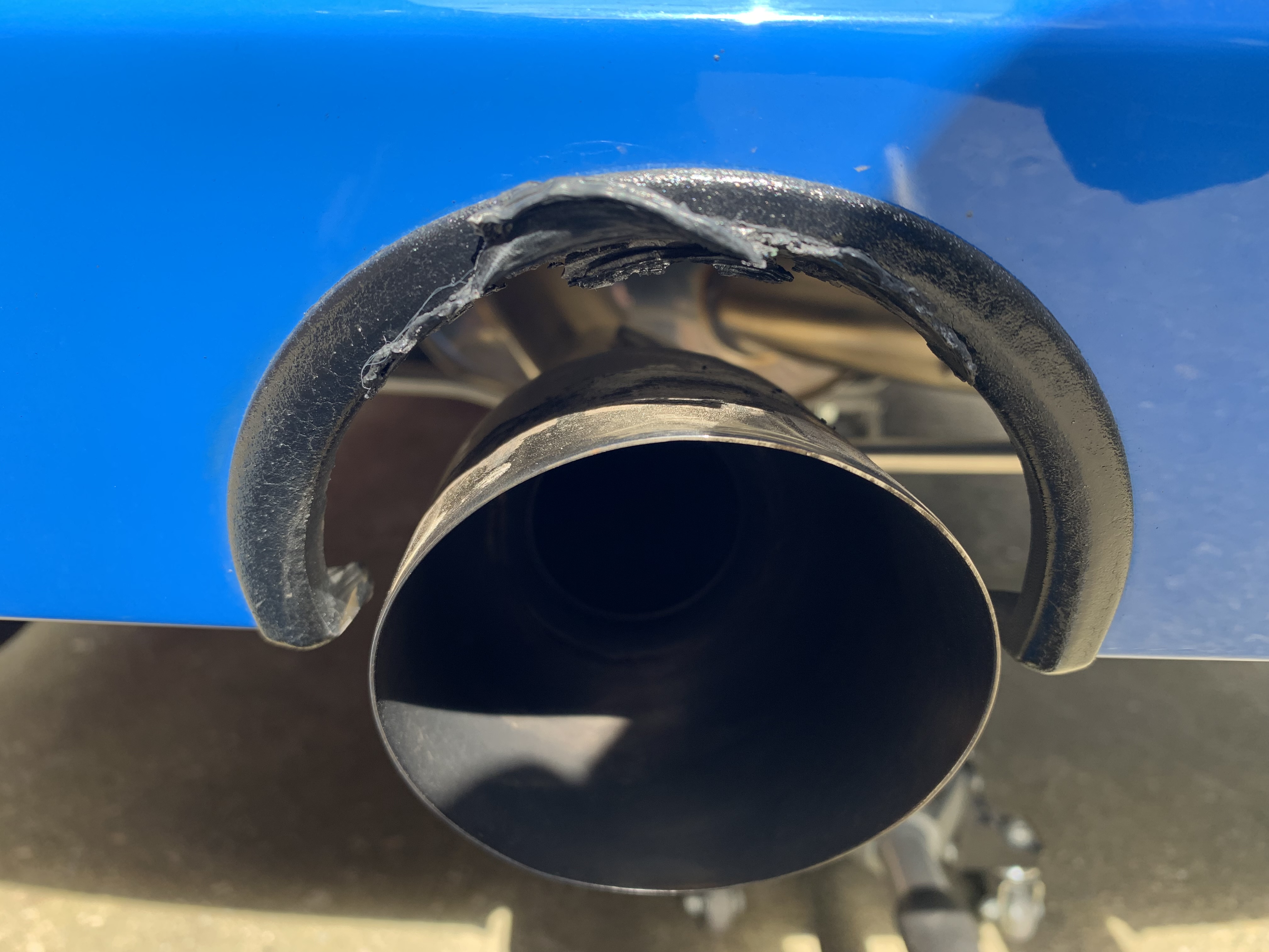

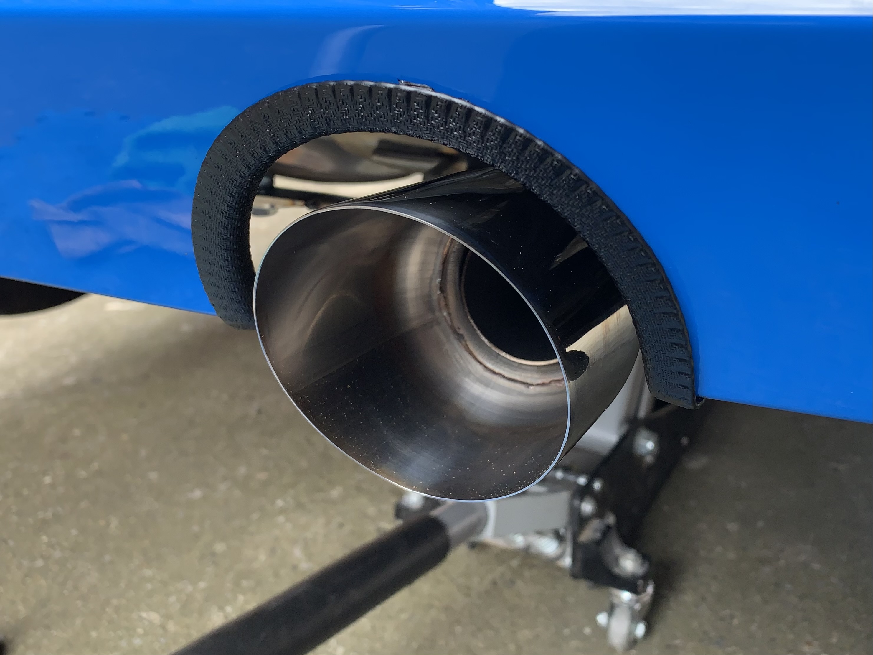

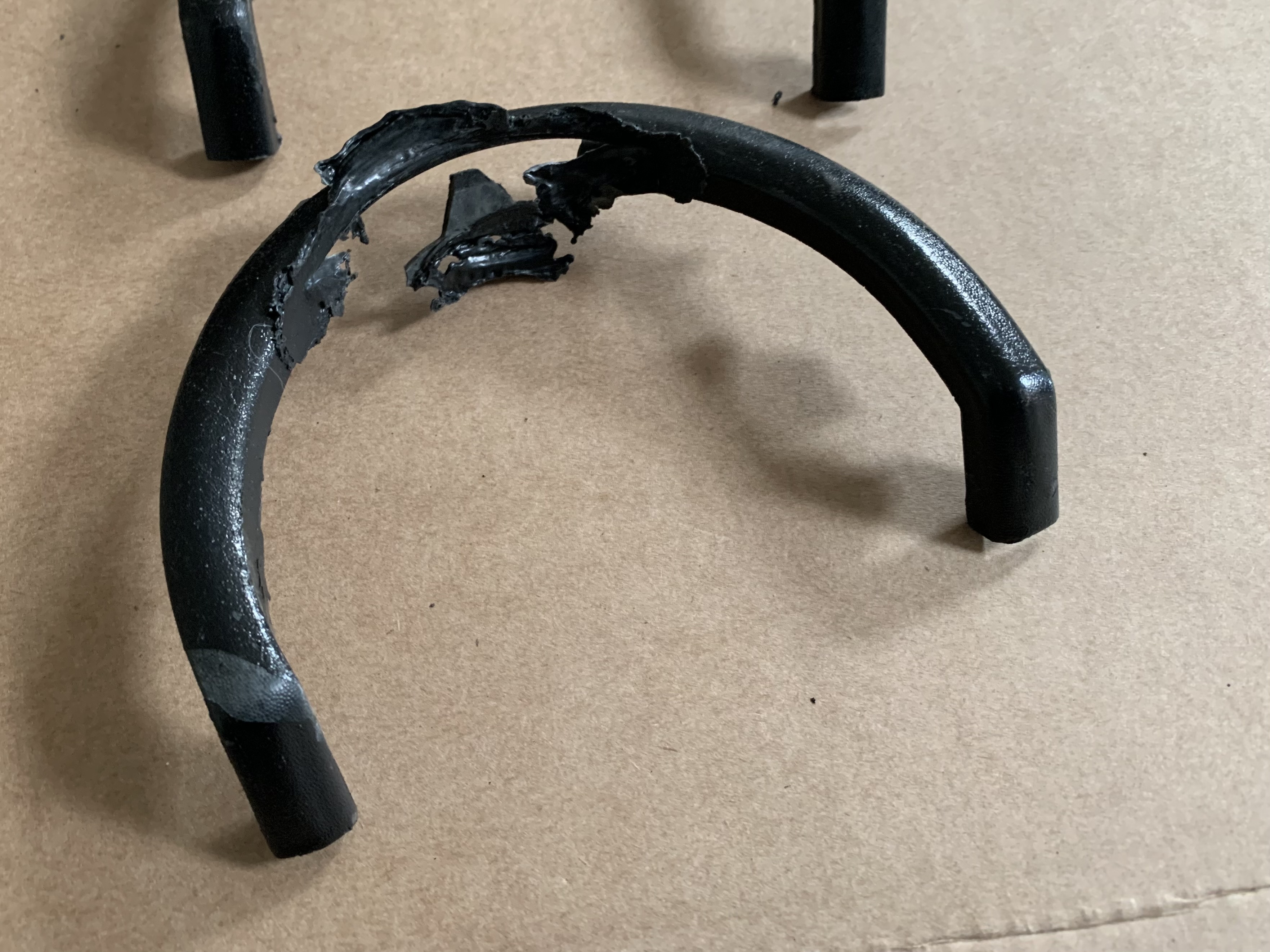

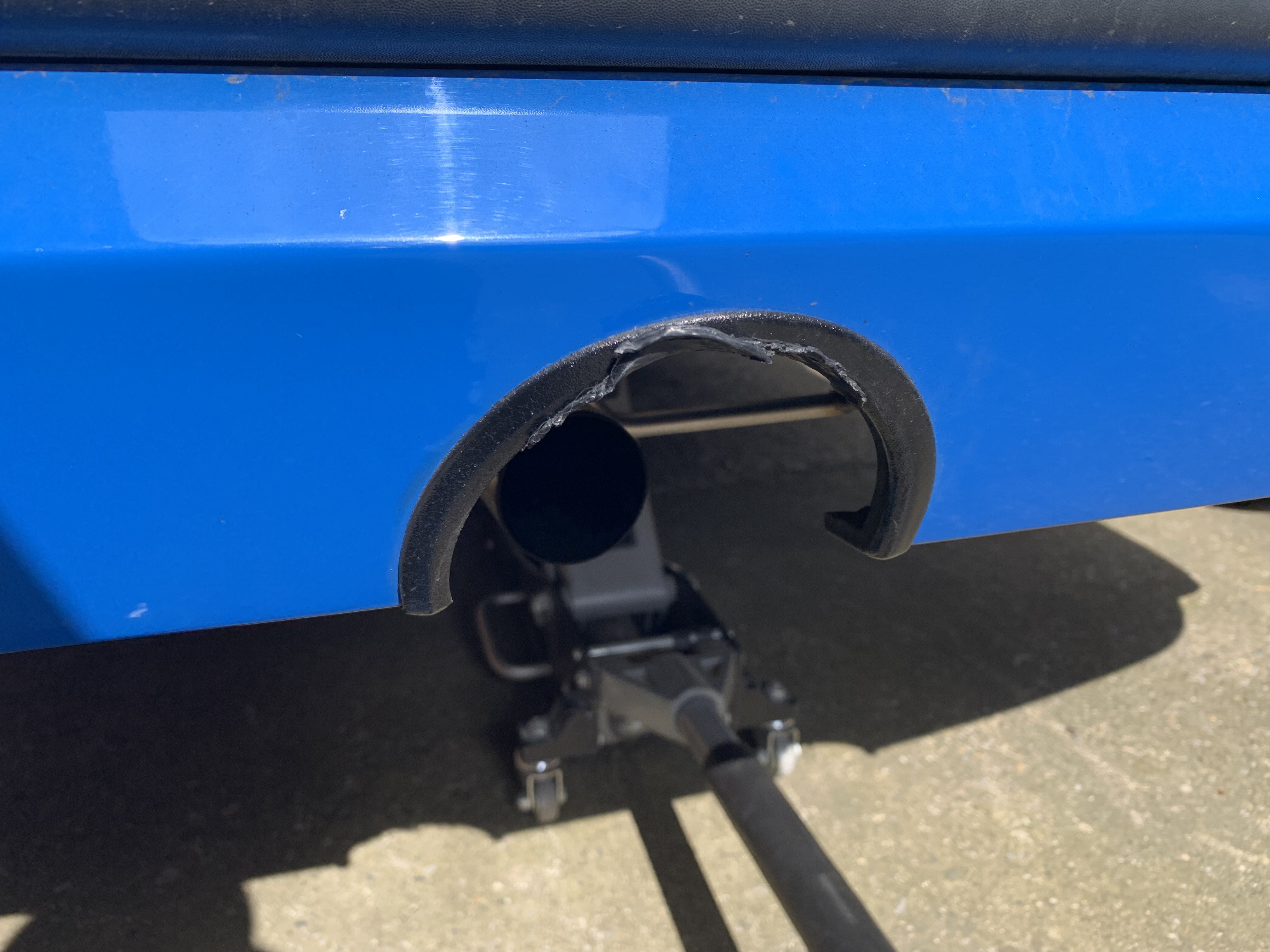

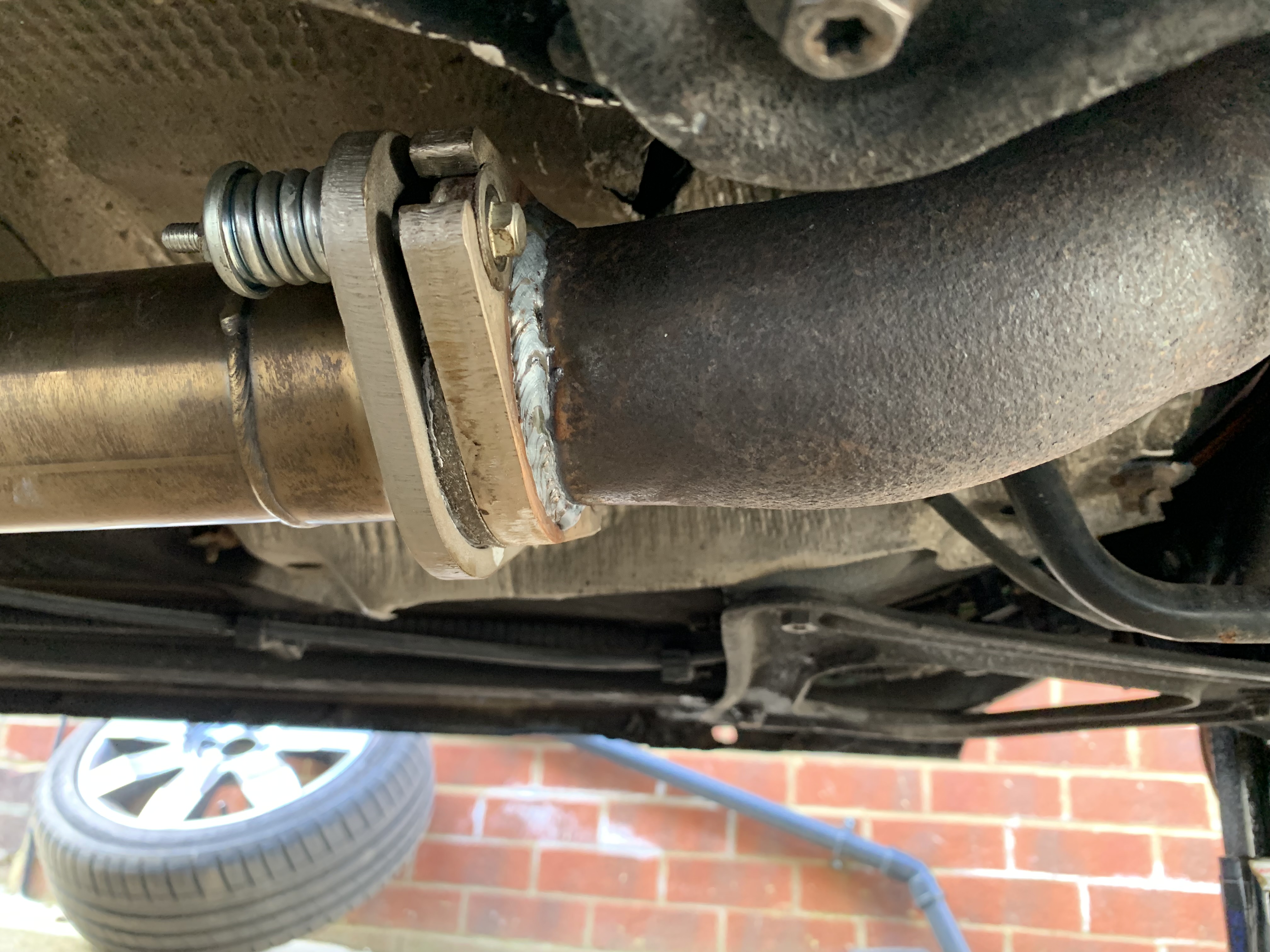

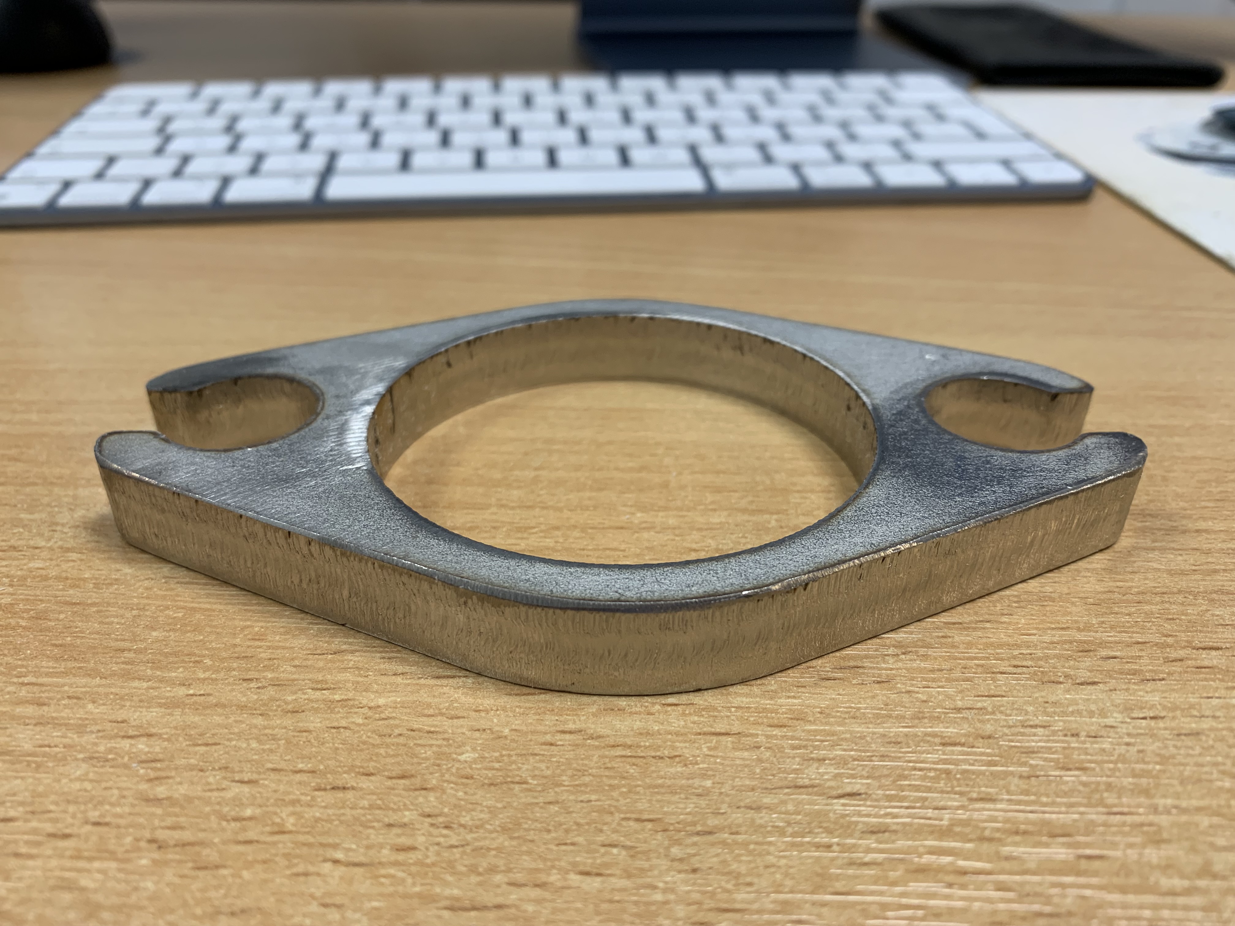

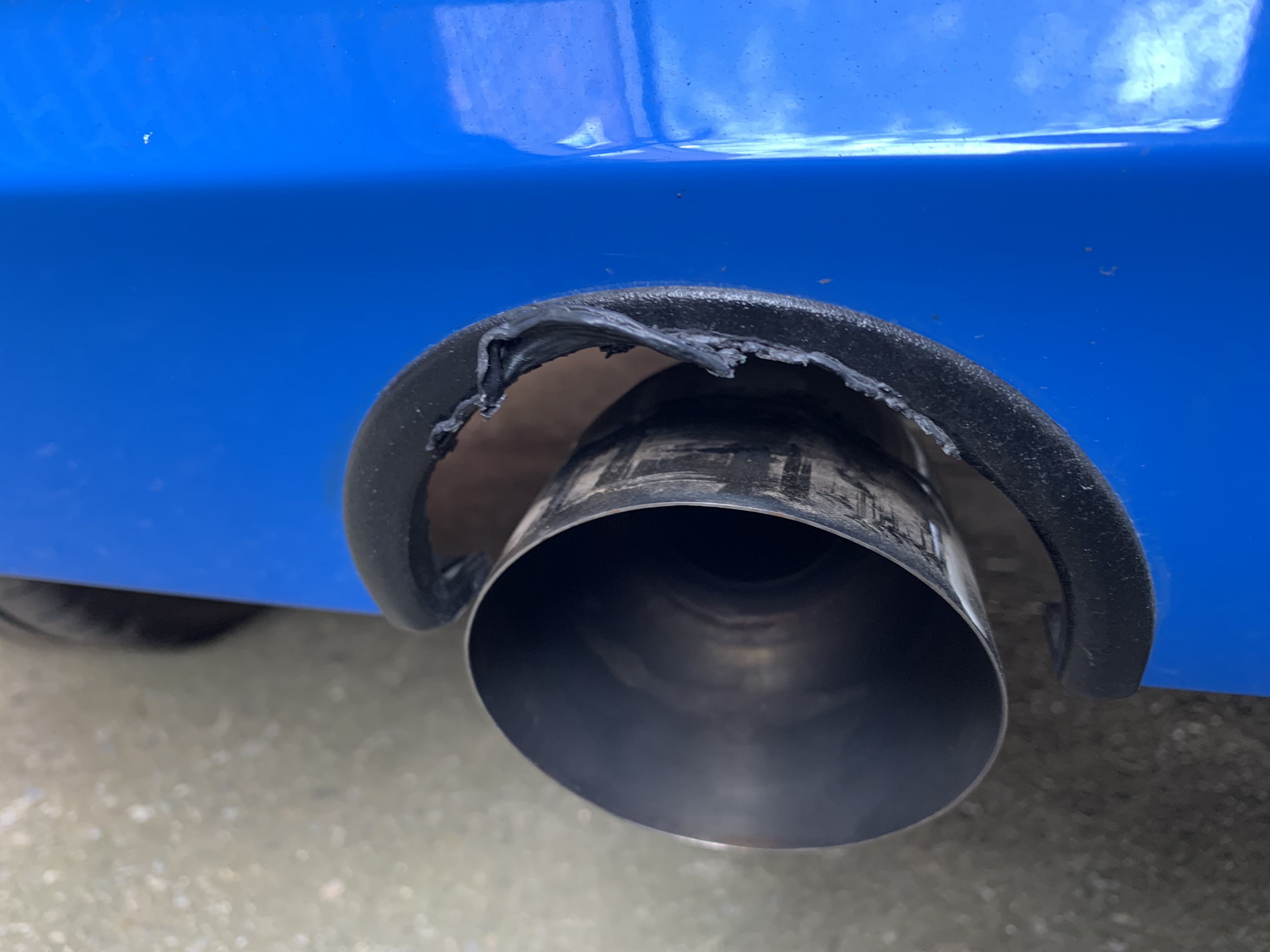

Bought a new exhaust flange off @16v_paddy then took it to my local exhaust centre (Sadler's garage in Darlington).
I was more excited about this job than pretty much all my other work. I’ve seen so many cars going home early on trackdays, that I’d be an idiot not to do mine. Lovely job.

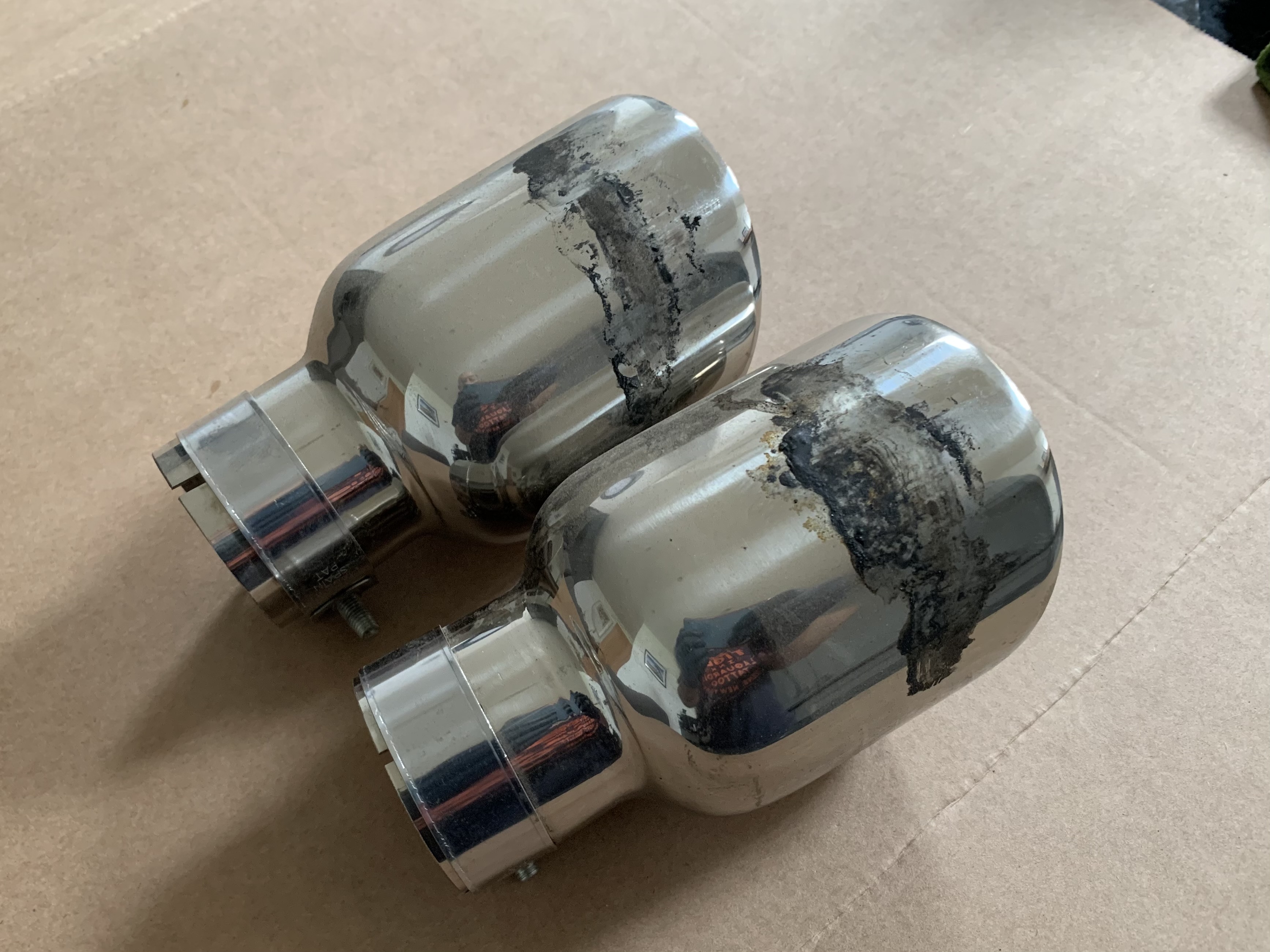

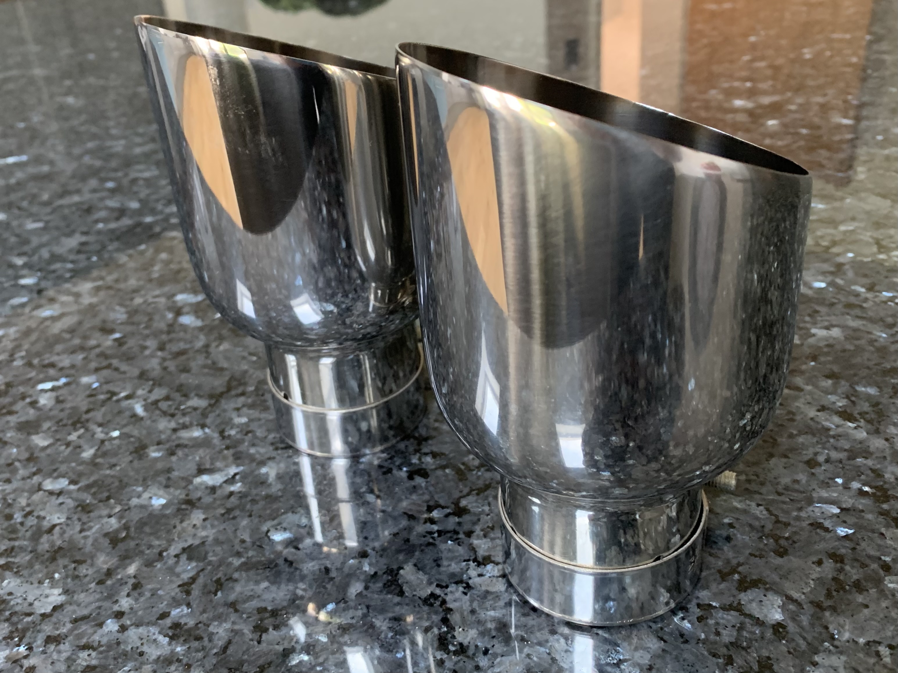

They also adjusted my PMS exhaust as it had a defect during manufacturing and the tail pipes were touching the bumper trims, resulting in meltdown.
I just need to clean the melted plastic off the exhaust tips now.
I have a nice solution to replace the trims. More of that later.

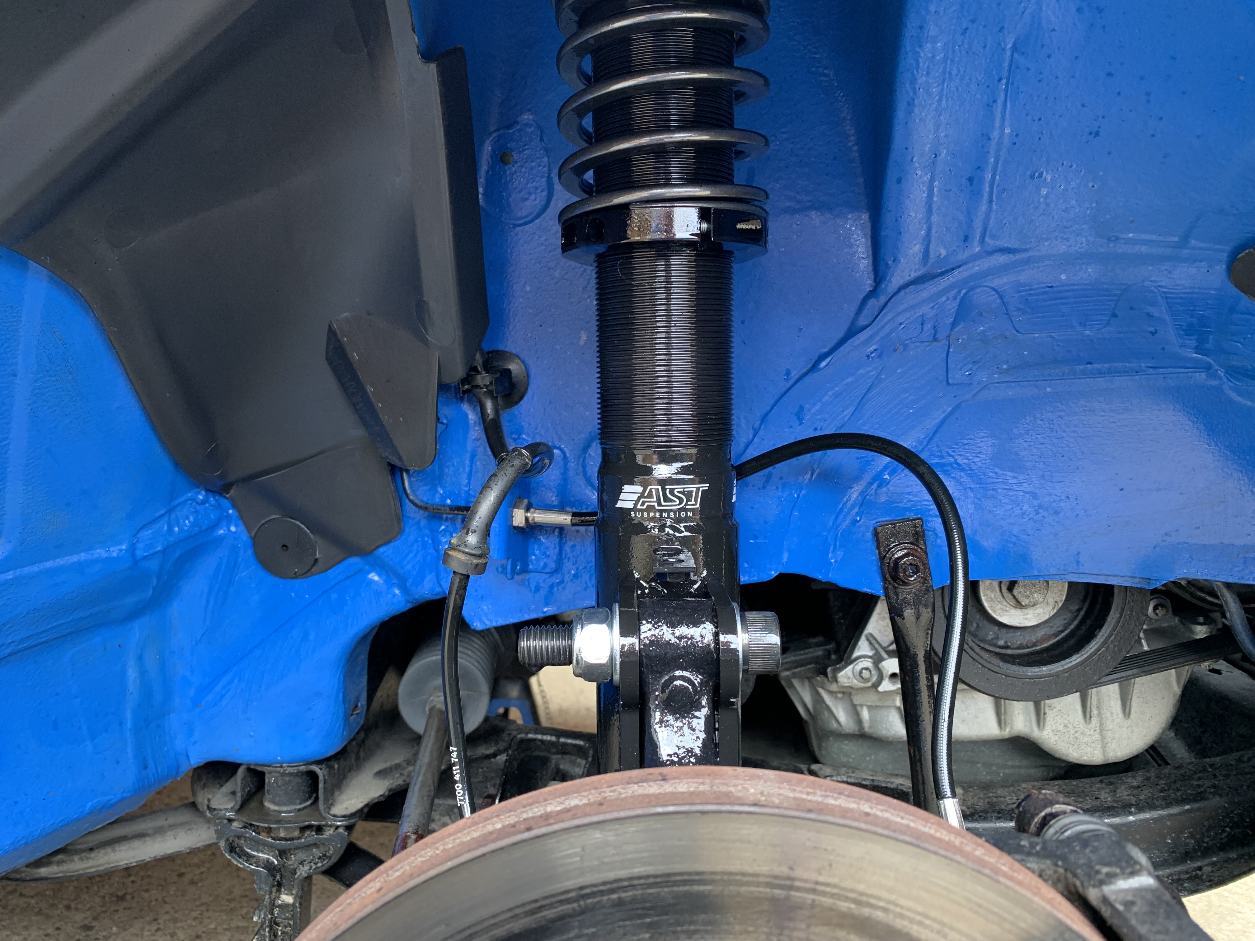

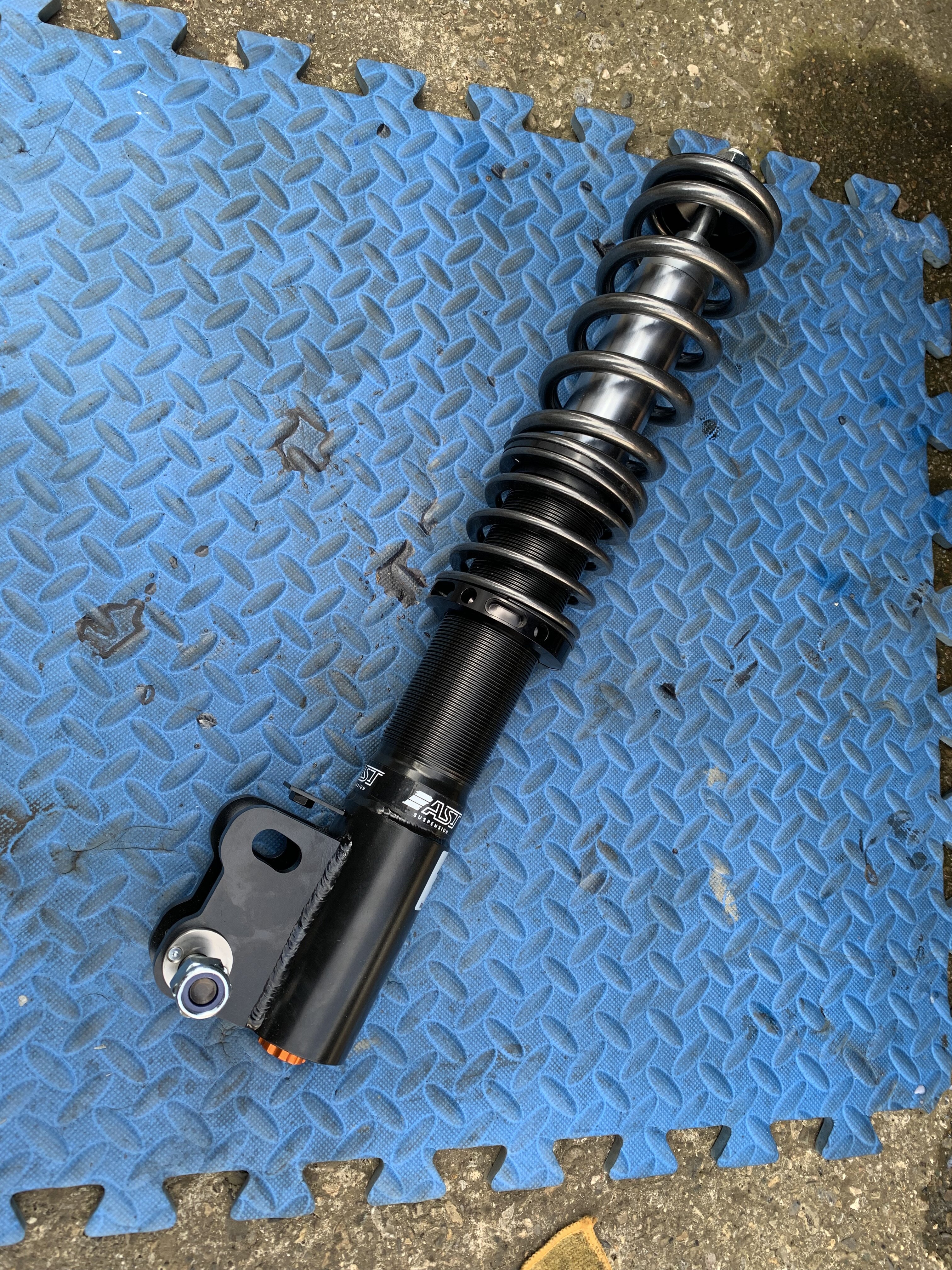

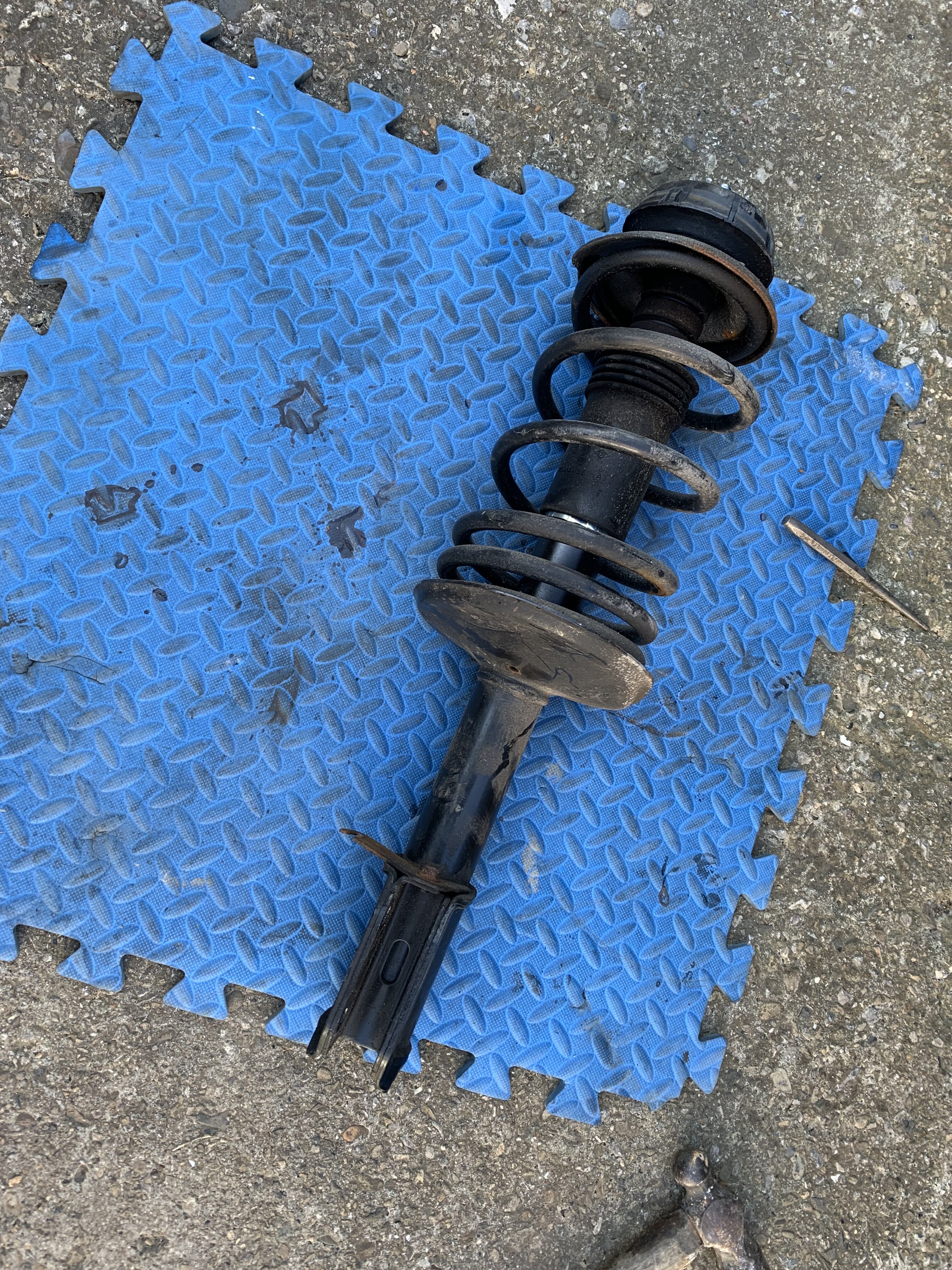

Last job of the day was to fit my AST’s.
Factory suspension off.
Shiny new ones on.
I haven’t played around with the settings as it’s going down the Track Torque Racing first week in August for full set up.

This was a picture of the car when I put the AST’s on the front. I’ll get some proper pictures when I get it all set up, but these are straight out of the box. You can see how lower it is already compared to the rear which was still on standard dampers.

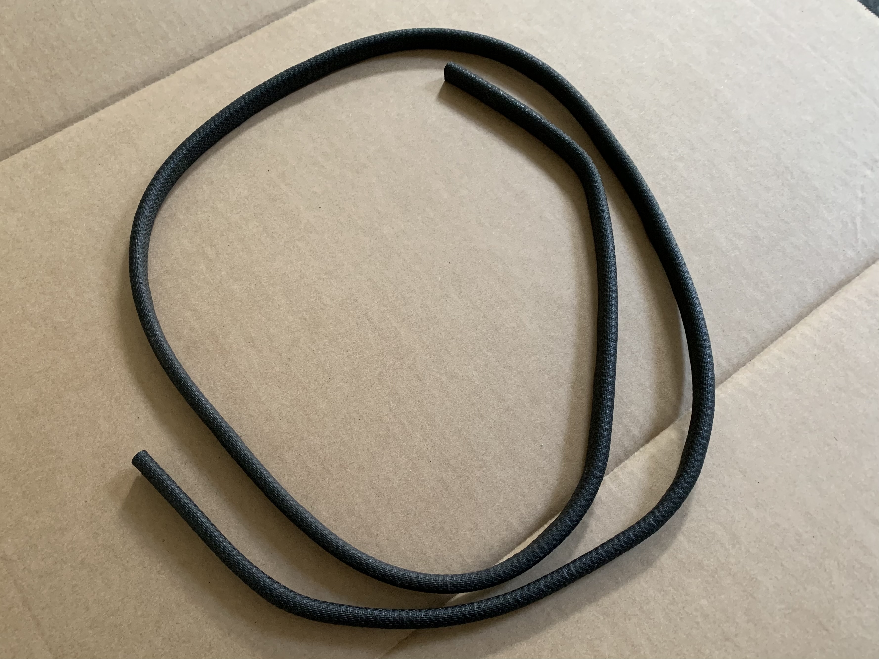

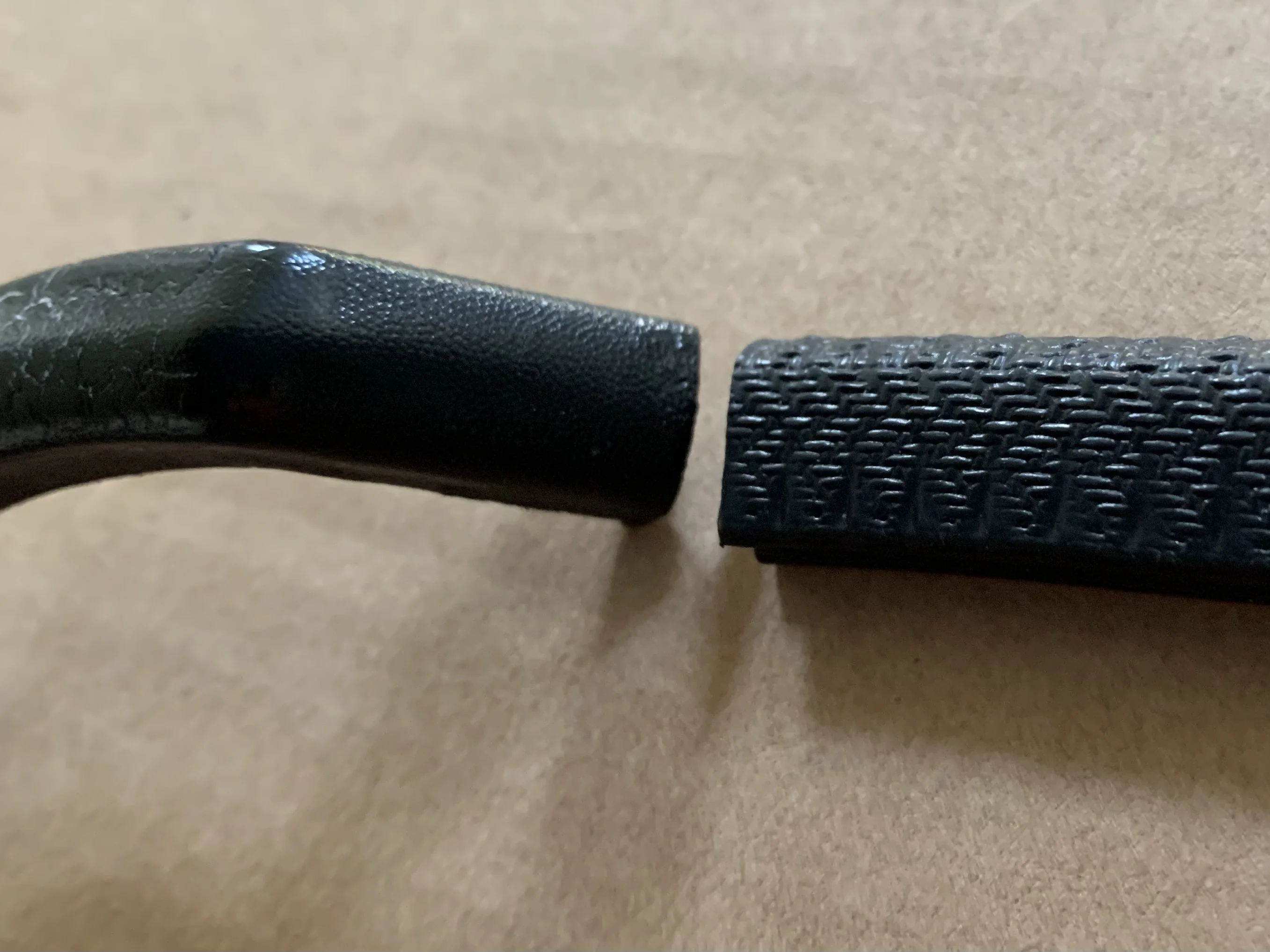

Time to tackle the melted exhaust trims.
And remove the melted plastic off the exhaust tips.
A bit of Acetone, a thumb nail and some Autosol did the trick.

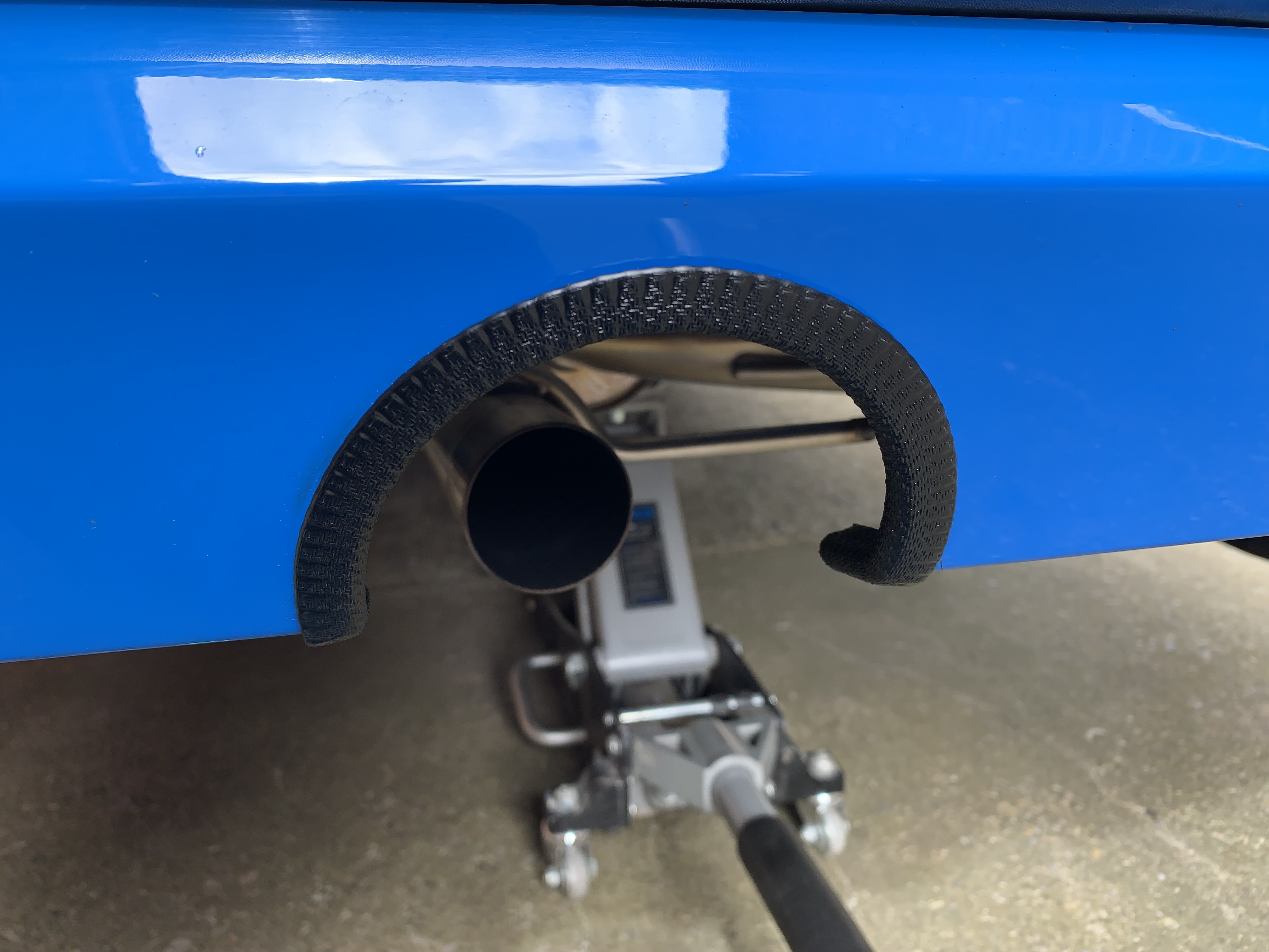

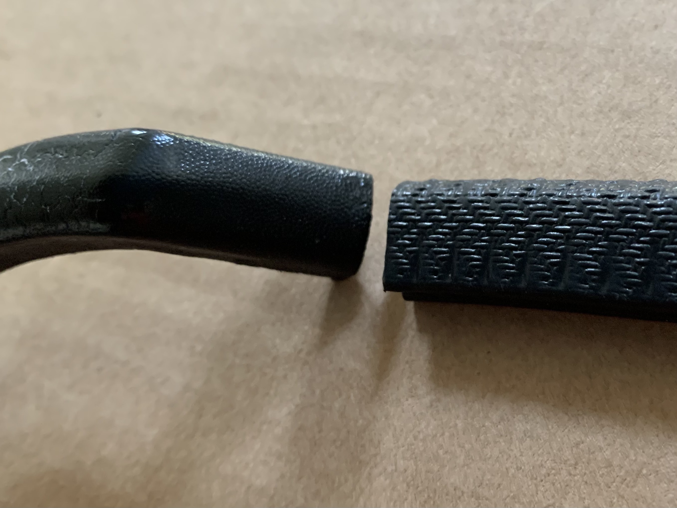

Got a length of plastic trim lok from my mates at CMRacing and cut a piece 27cm in length.
It’s virtually the same width as those ridiculously expensive replacements, which aren’t even that nice.
A gentle tap with a camping mallet and they’re on.

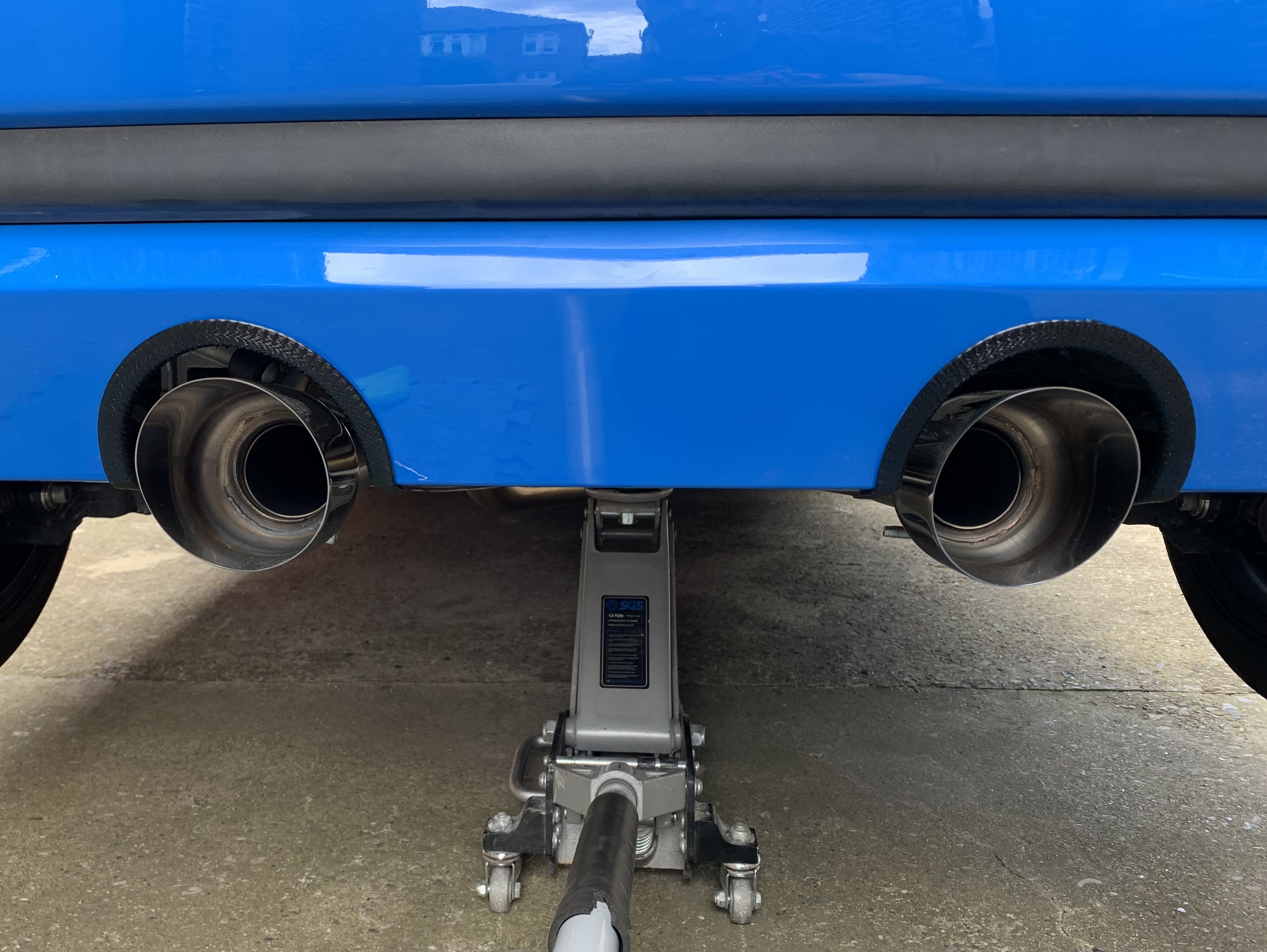

Then refit the exhaust tips and the jobs a good un.
They’re quite neat, in fact I prefer these to the cheap aftermarket replacements. Plus they won’t fall off. If you stand 10 feet back, they even have a carbon effect.

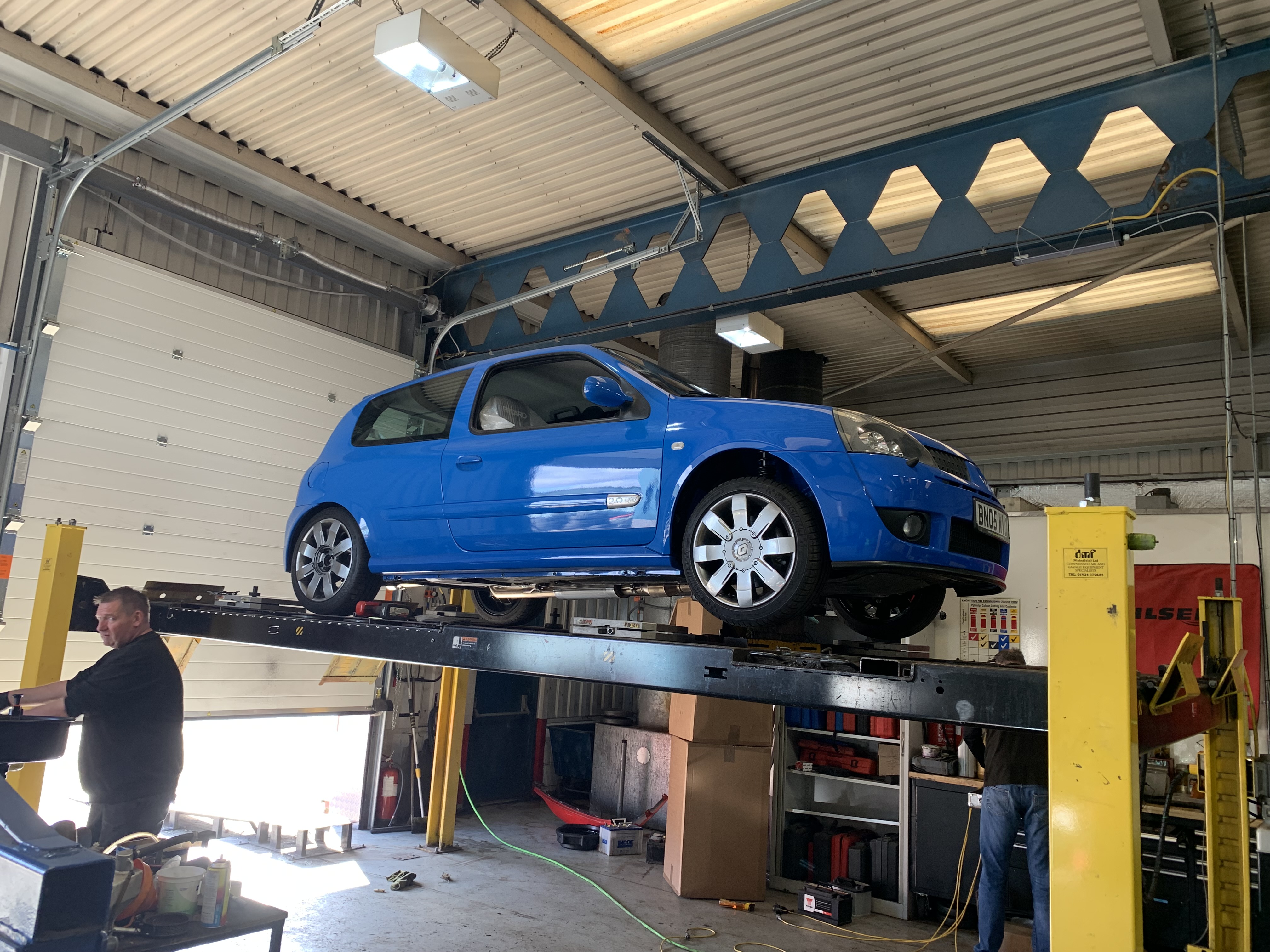

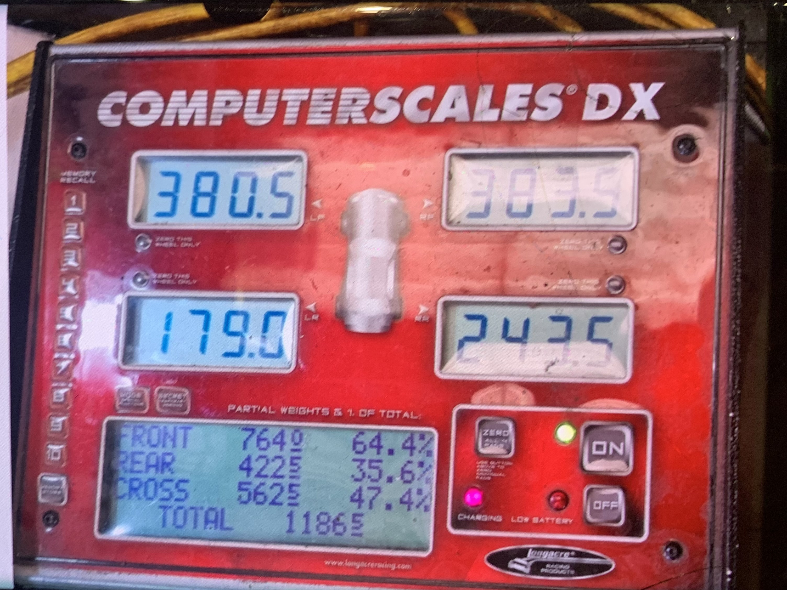

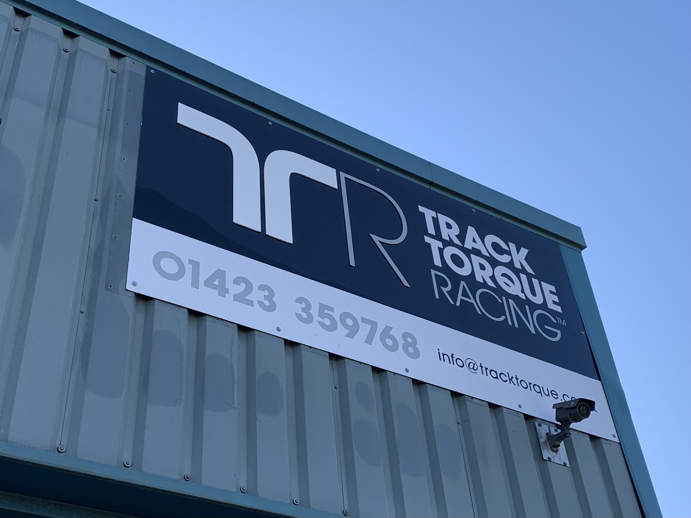

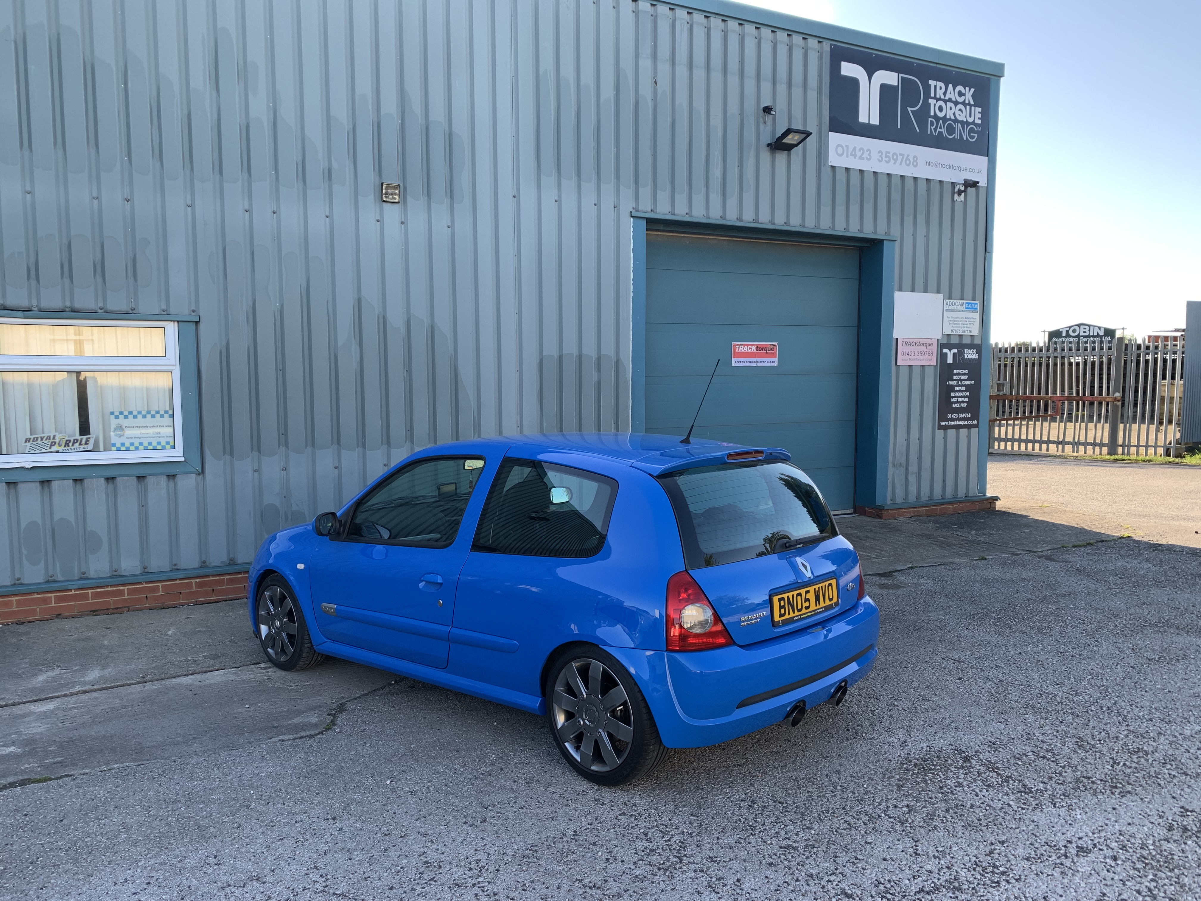

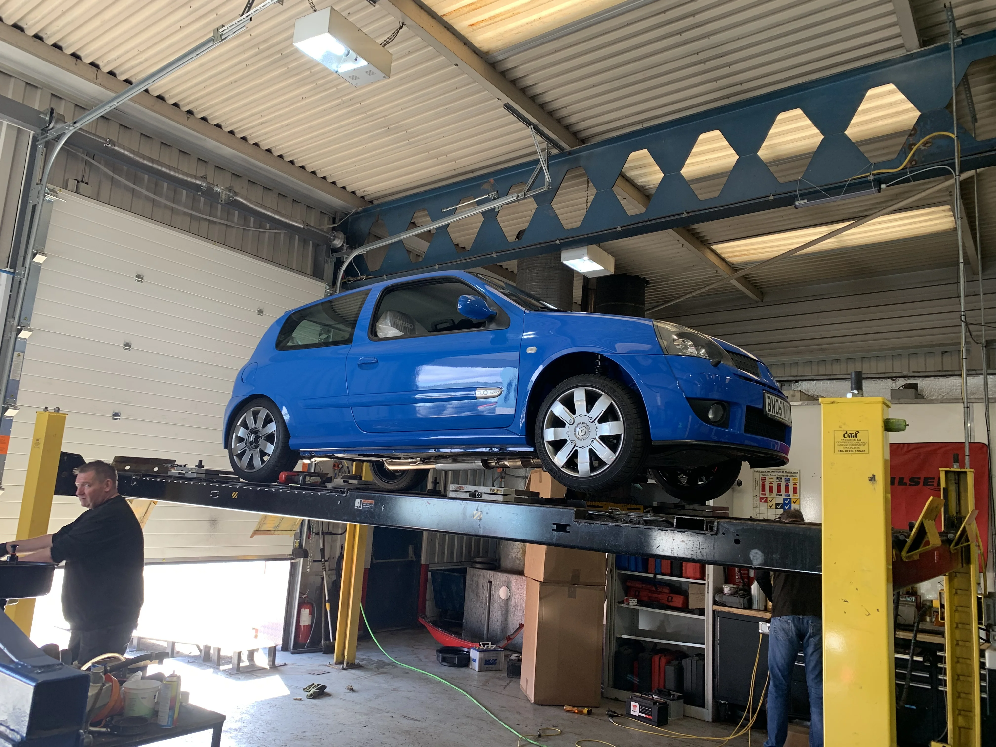

Took the day off to visit Track Torque Racing in Tockwith, York. They’ve set up my old track car many times and they know what they’re doing.
Work included setting the ride height, geometry and corner balancing.
Poor blokes face 😂 he wasn’t having a good start after hitting himself on the bridge of the nose with a ratchet. 🥴
I went for a fat lad setup at 100 kg. I’m not quite there yet, but winter’s coming 😂
The whole job took a couple hours.

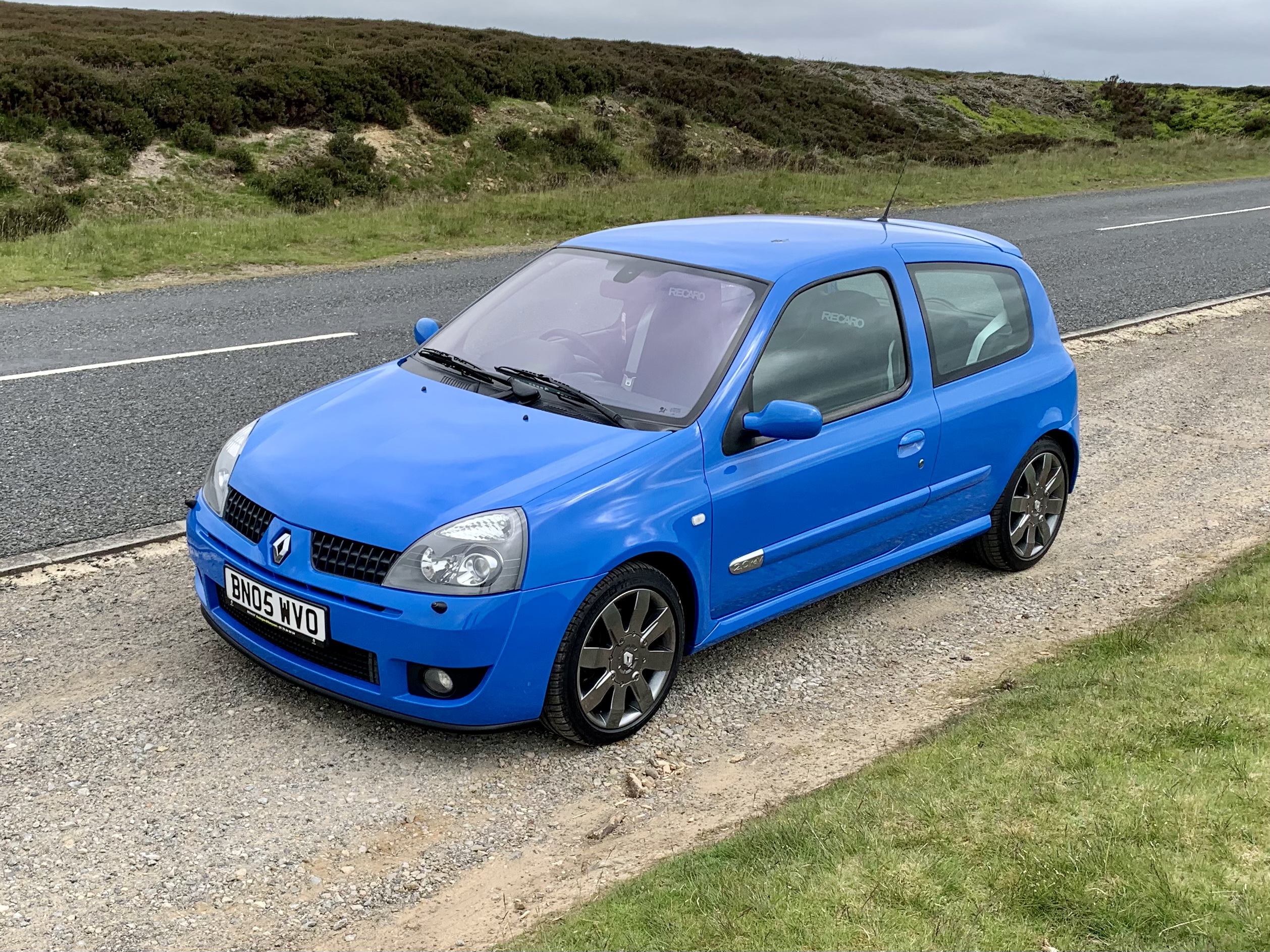

As it was a nice day, I decided to give her a blast across the North Yorkshire Moors.
What a difference. The cars certainly lively. Still compliant for road use, but I can tell it’s going to be pretty good on a circuit.

@Mr Underhill Have you refitted the abs cable bracket to the shocks.
I replaced mine for new ones from Renault, this was the part number 8200143718 if they are still available.
Hi Andy, yes I did. I realised I'd taken a picture of it missing. I'm rubbish at that sort of thing.
Mine were in really good nick.

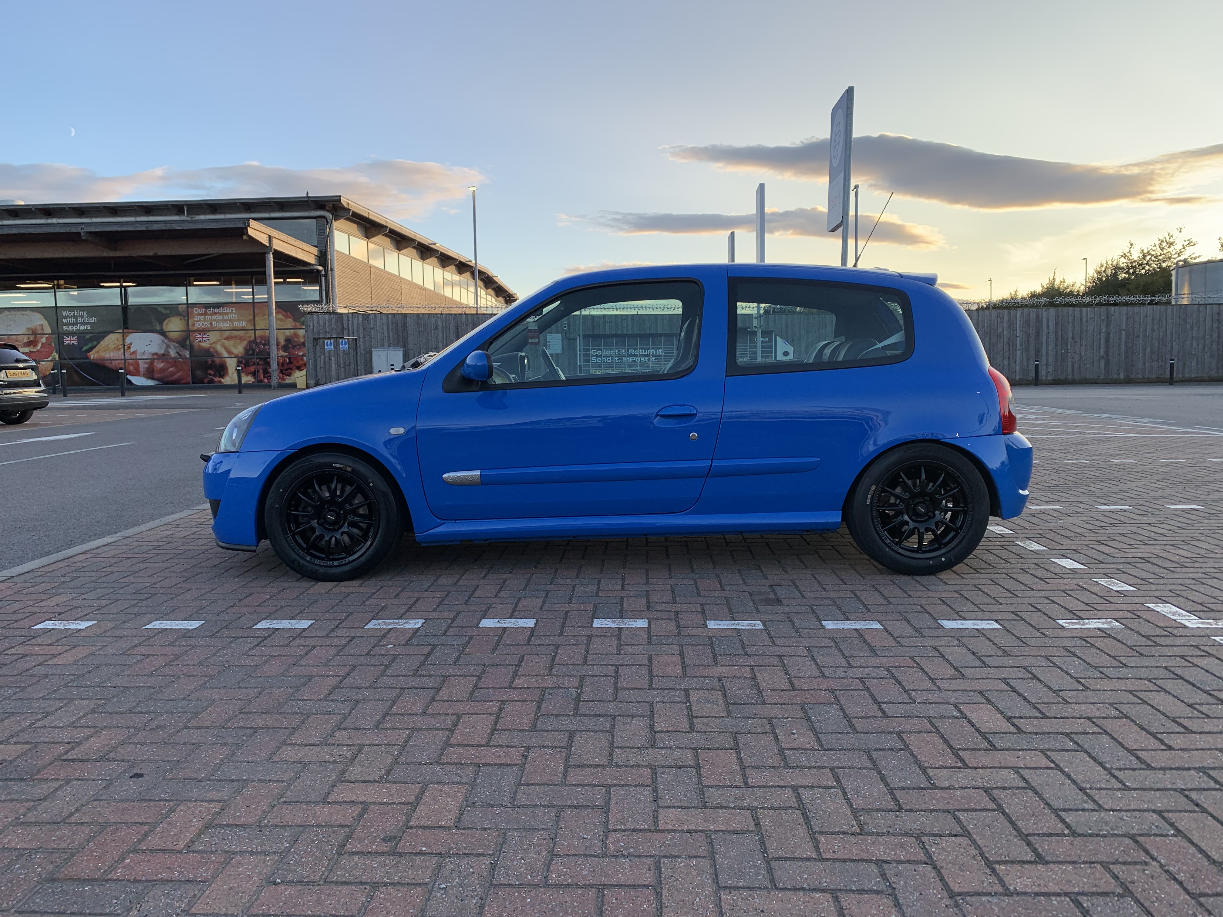

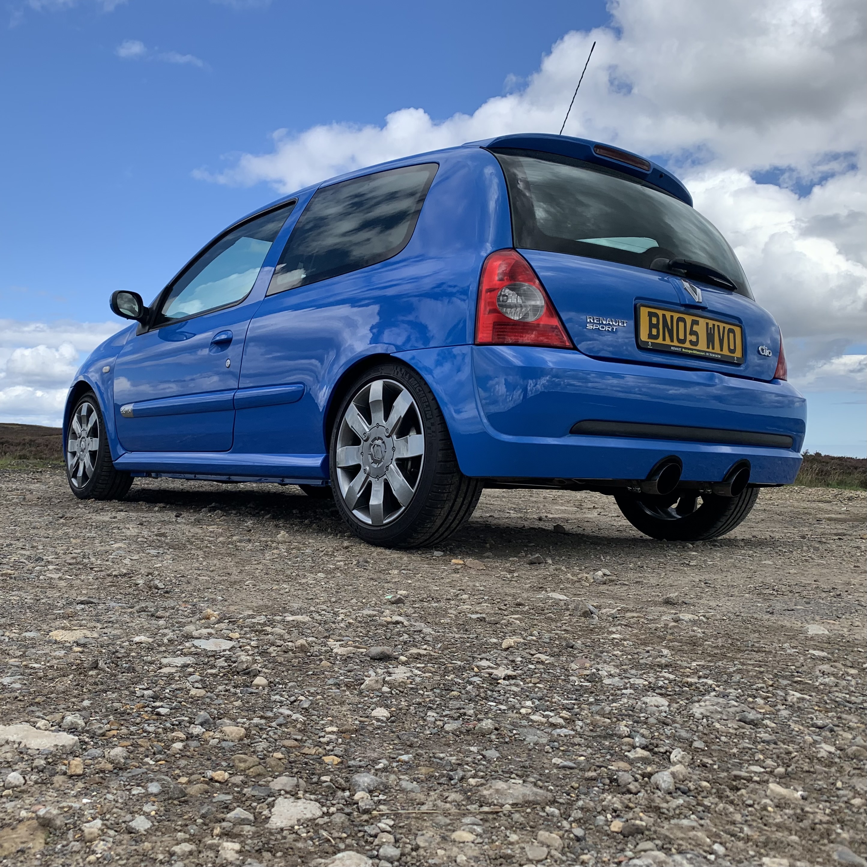

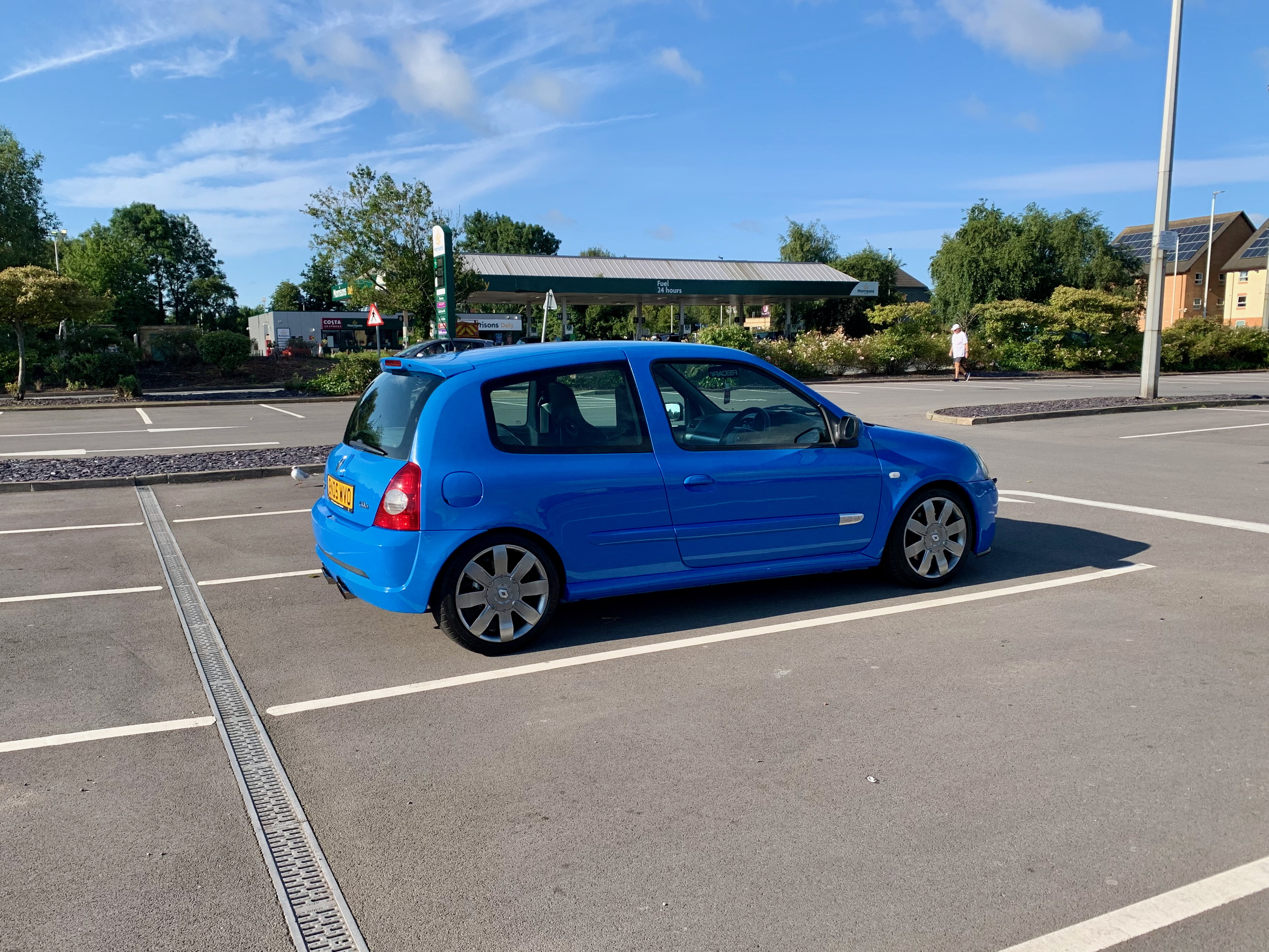

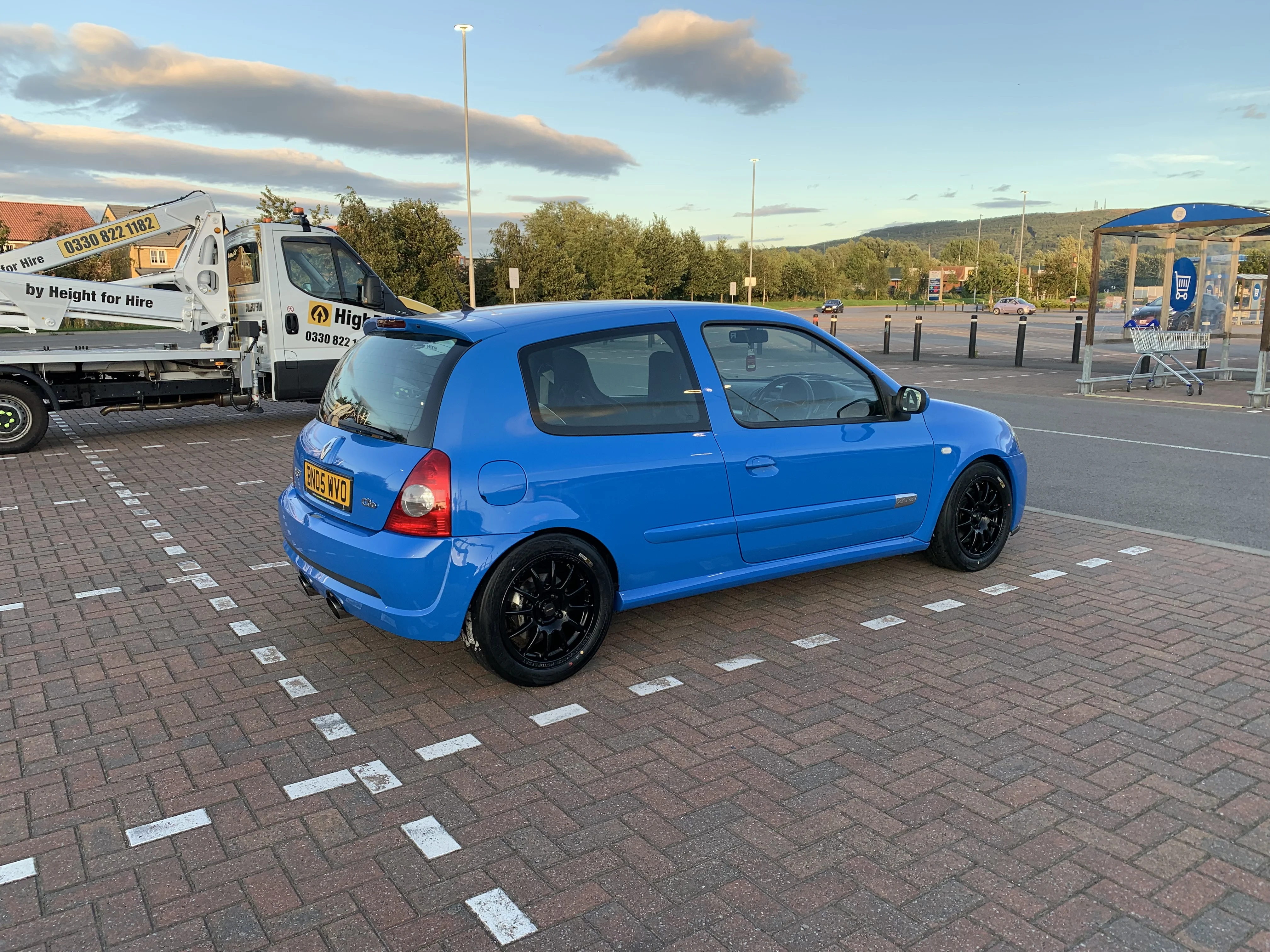

A picture I took of the car in Morrisons this morning, 24 hours after the fitment of the new suspension.
I'm going to have to get some 15-inch wheels on this sooner I think.
I made the choice to have it set up for the circuit as I won't be killing it with road miles and wearing the tyres out.
But I just couldn't resist driving it again this morning, despite having a brand-new Hybrid car sitting in storage lol
I have some 15" TD Pro Race which I'm using for track time, so might go balls deep and buy a nice set of Evo corse X3MA 7x15 and sell the Turini's.
Decisions, decisions....

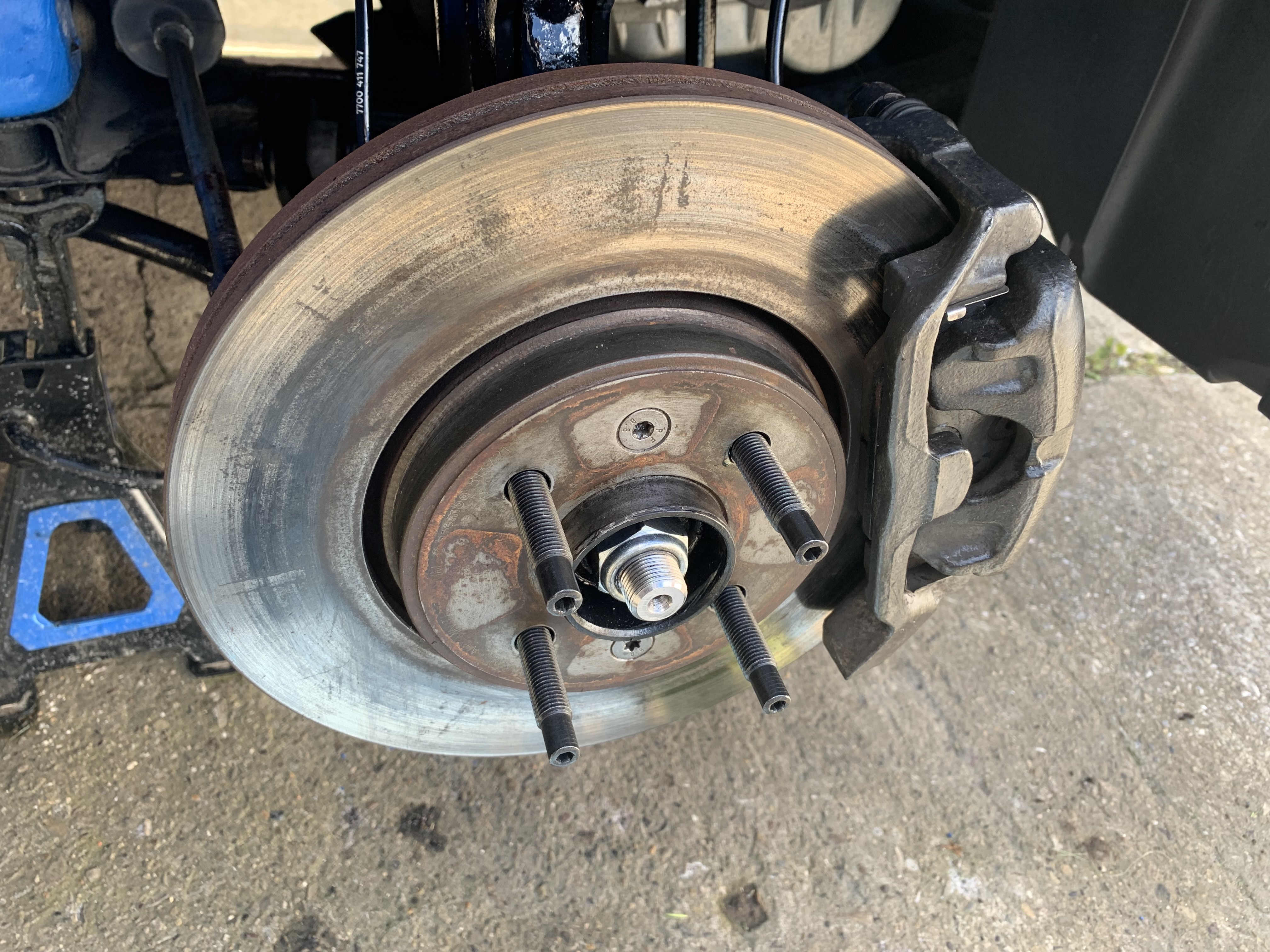

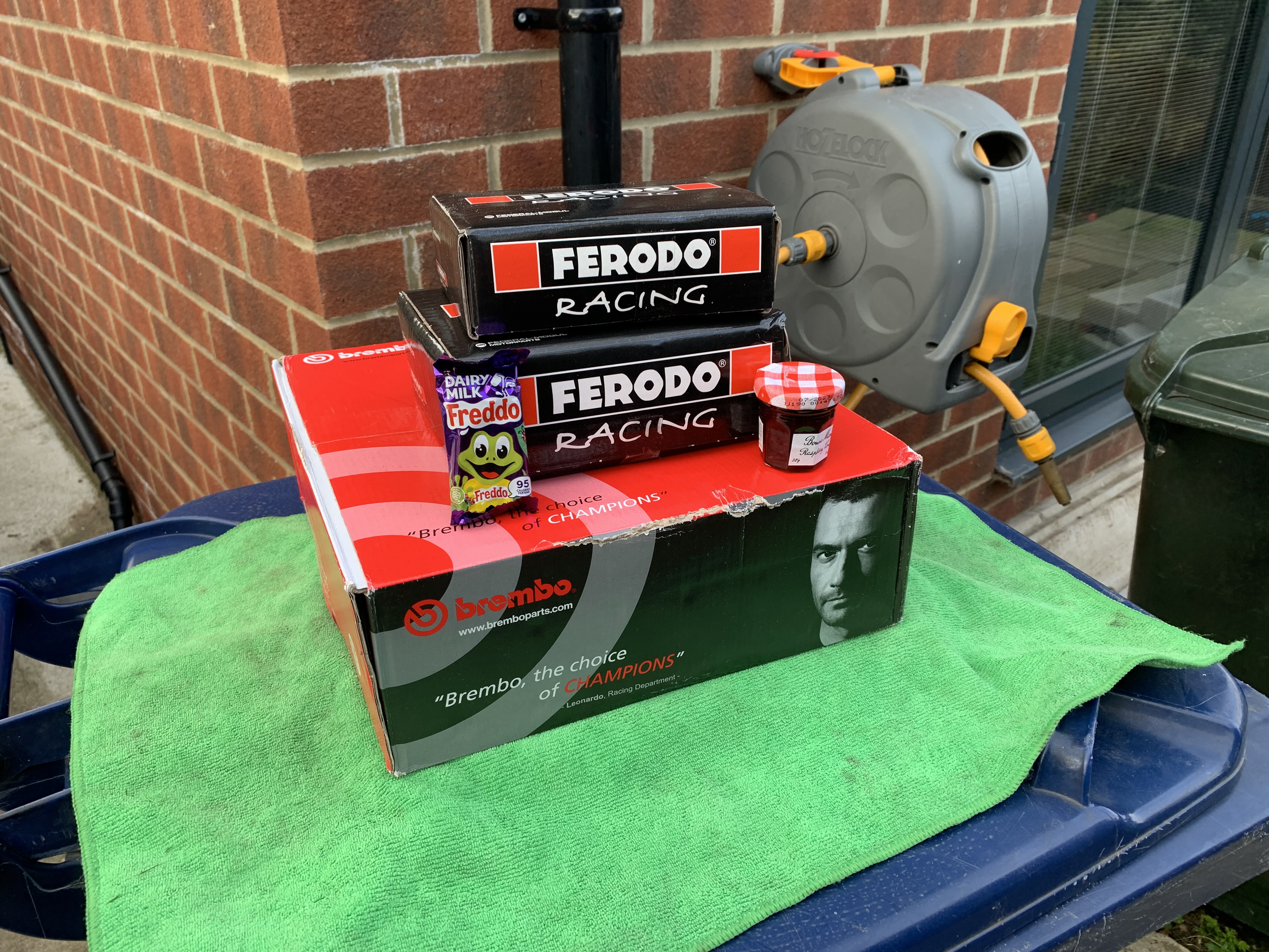

Forgot to update the stud nut kit, supplied by @FrogJam Motorsport. I went for 68mm as they’re ideal for cars running no spacers and TD Pro Race alloys. They’ll also allow me to run my standard Cup alloys with the centre caps on.
View attachment 1654404View attachment 1654405View attachment 1654406
@Mr Underhill This post gave me a gentle reminder that I needed to order a new stud & nut Kit. So you have cost me money :).
I also bought the 68mm ones from @FrogJam Motorsport as I run TD Pro race with no spacers.
Nice little gesture in the packaging which made me chuckle, I thought it was very clever marketing.
My Freddo and Jam is still in the box with my pads so will have well and truly melted by now. They’re a good bunch of lads and they give a damn. Are you going to CSF then?
Yes they are. Met them @ Donington a few years ago and had a nosey around the Clio.

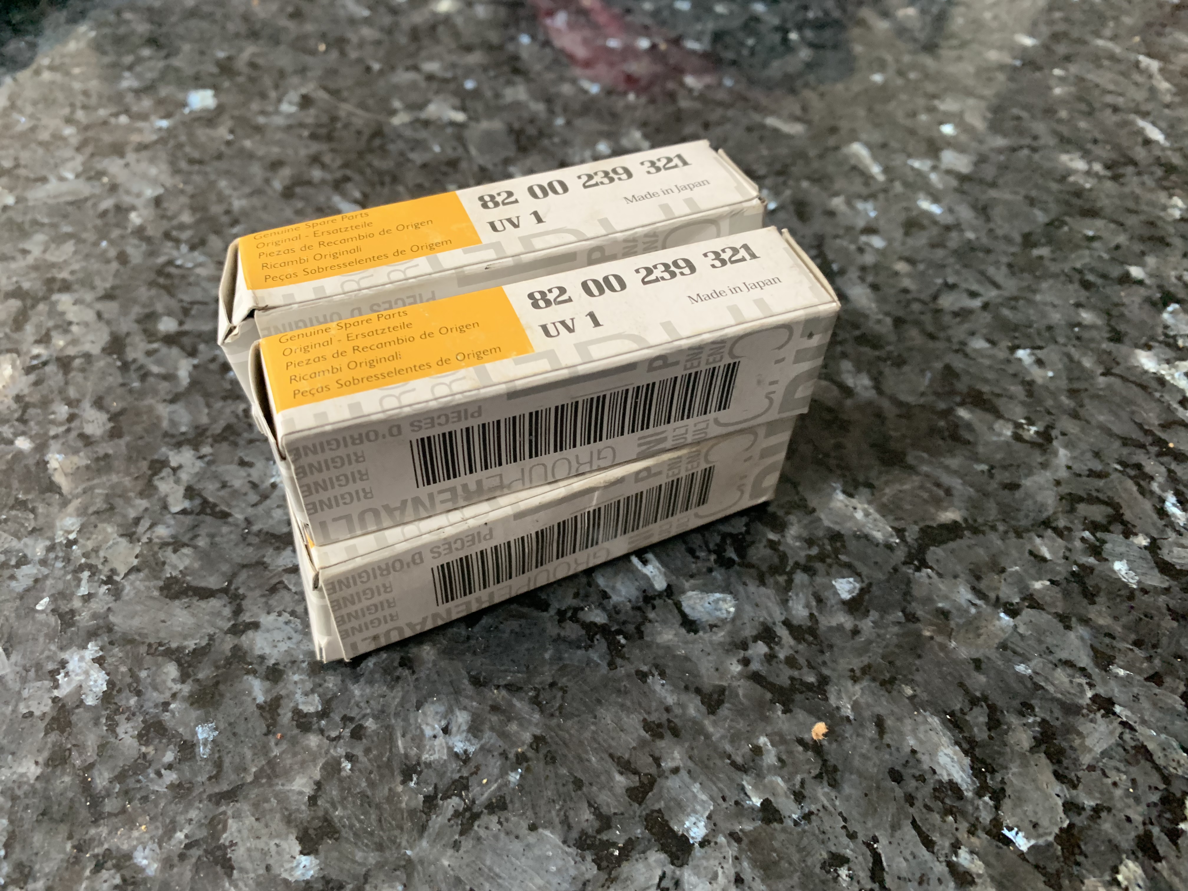

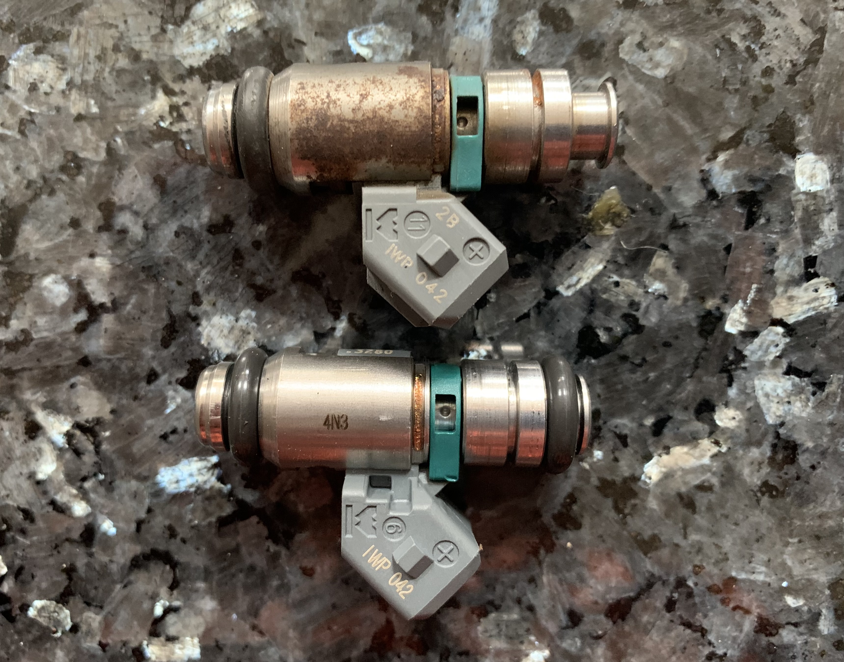

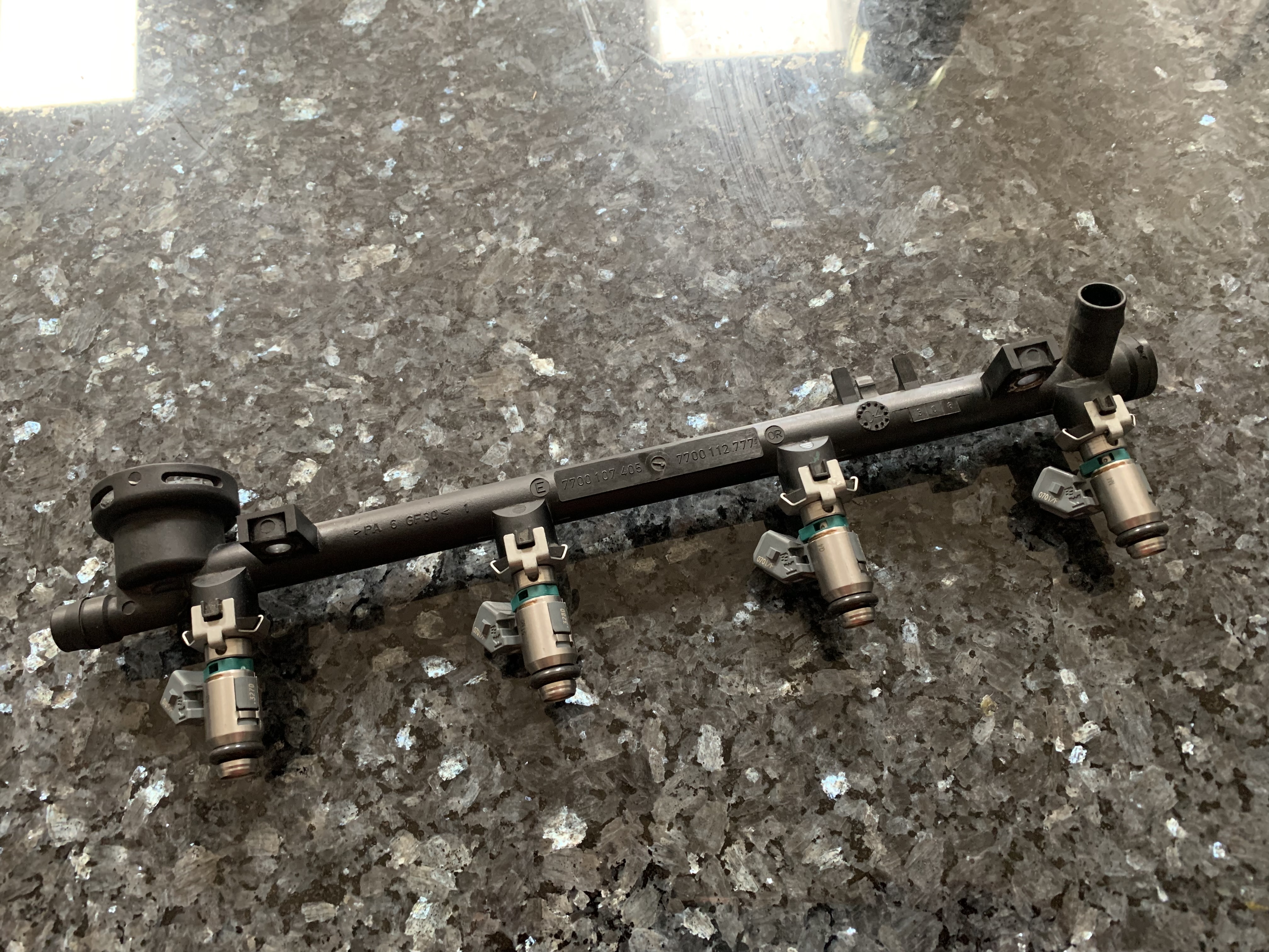

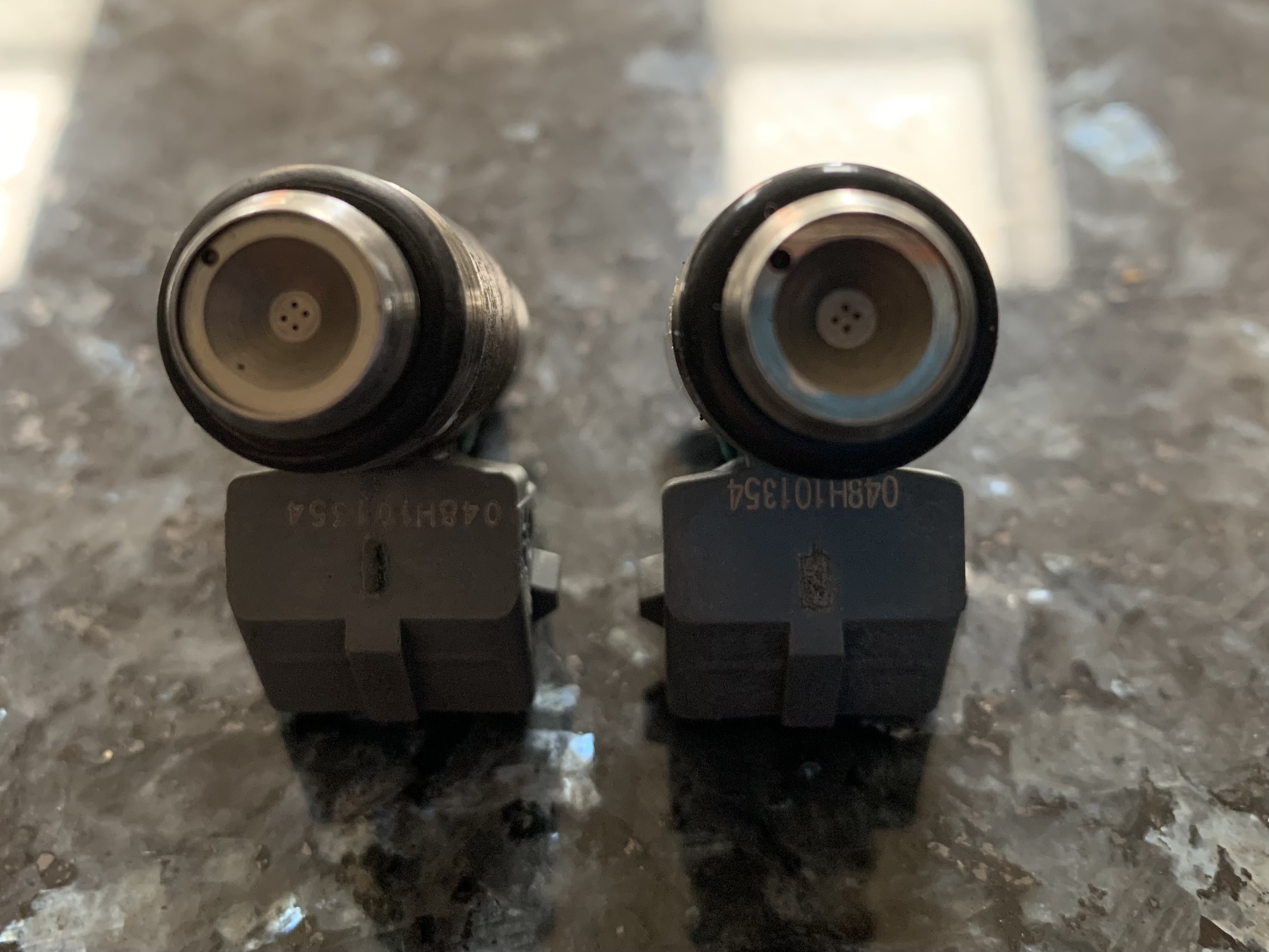

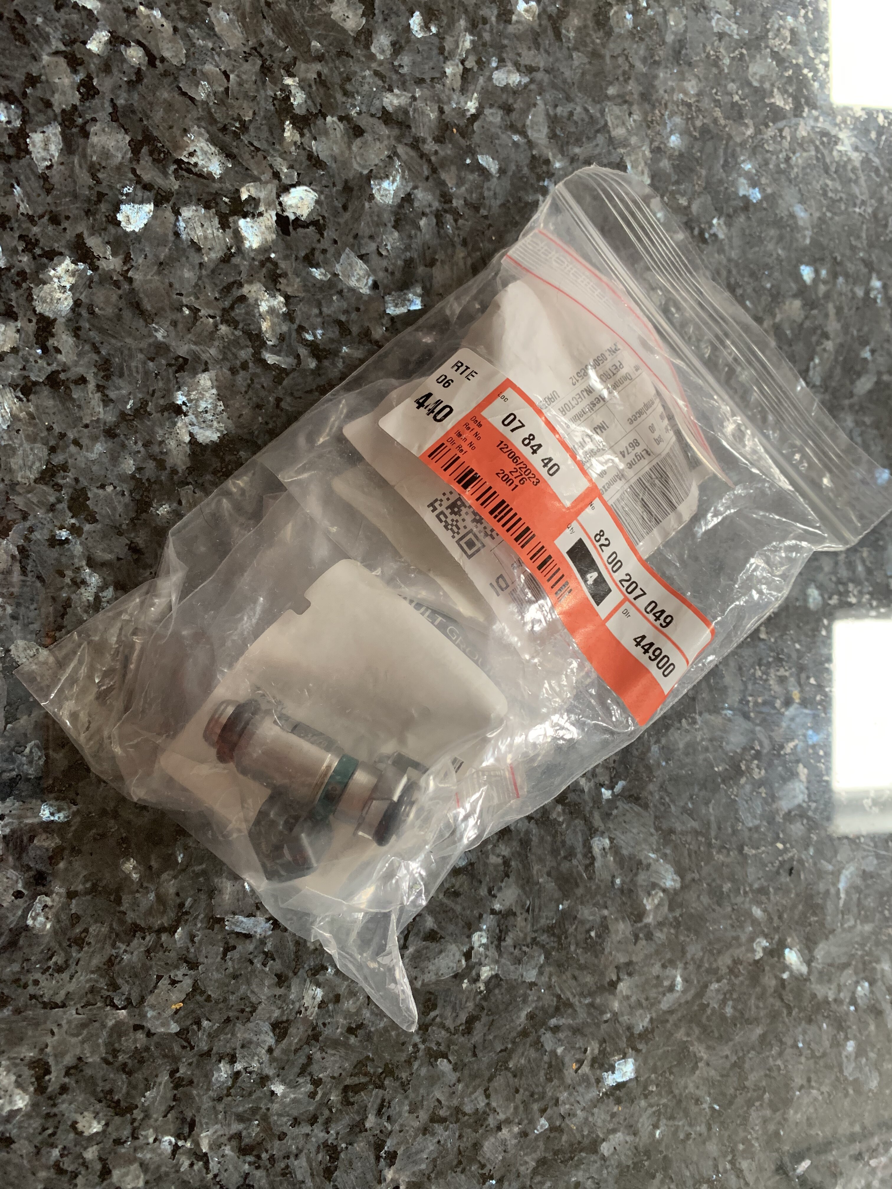

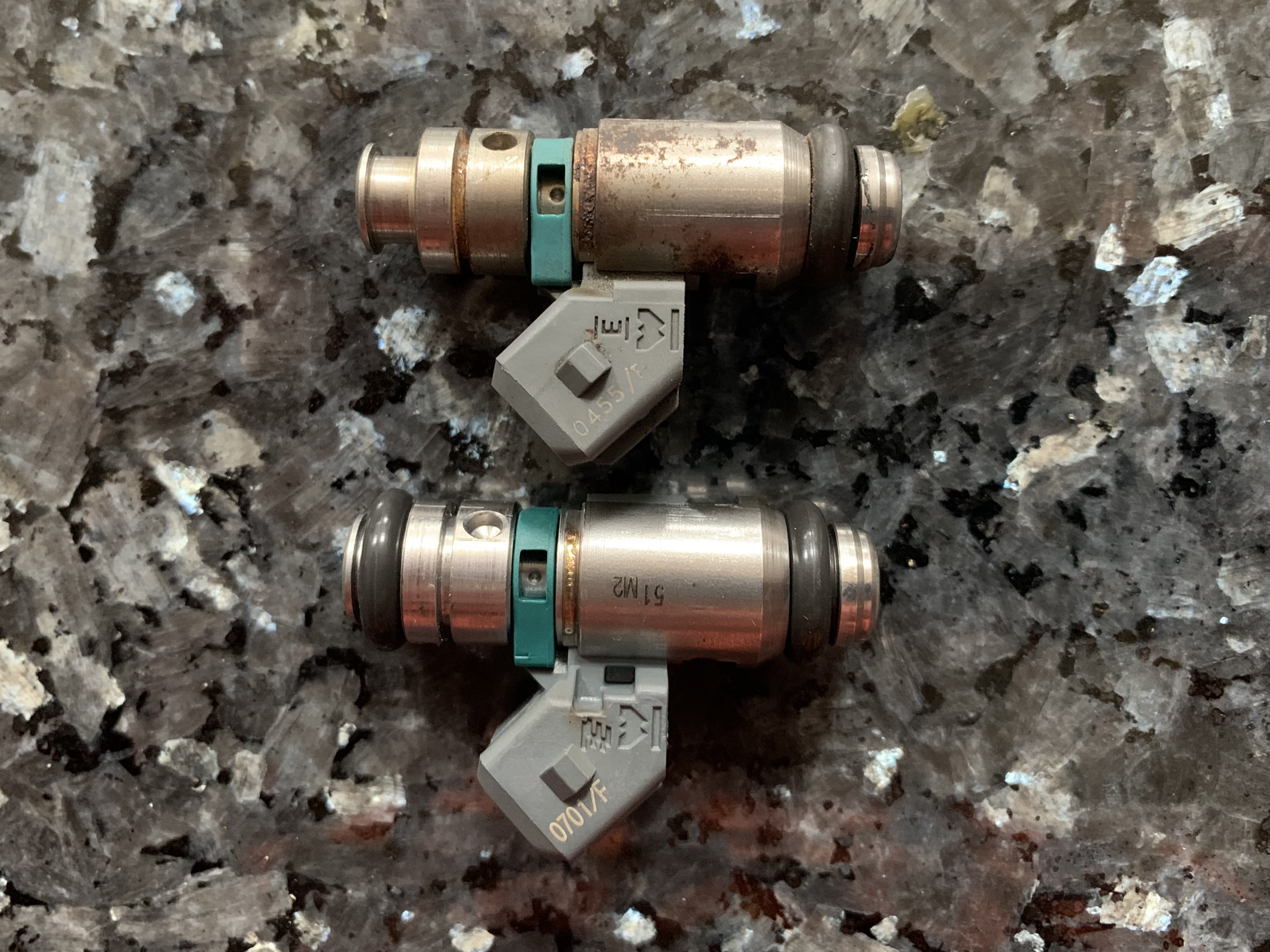

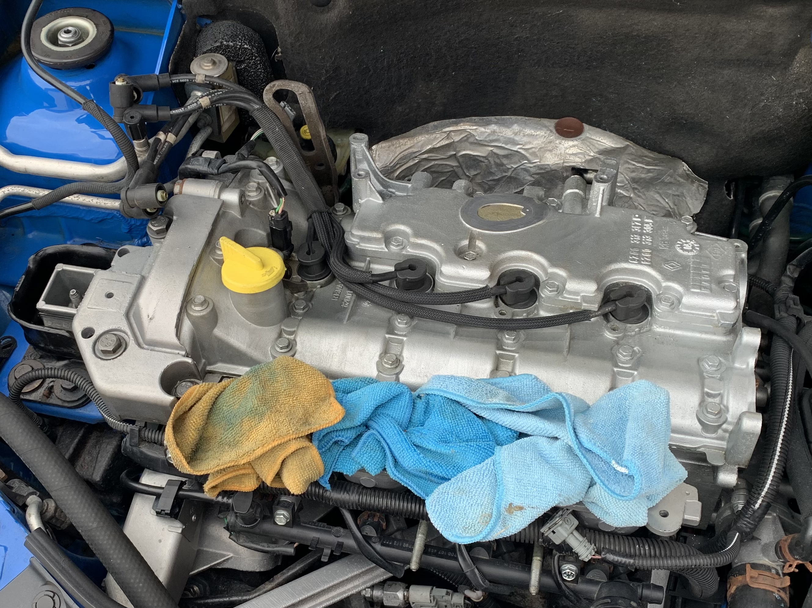

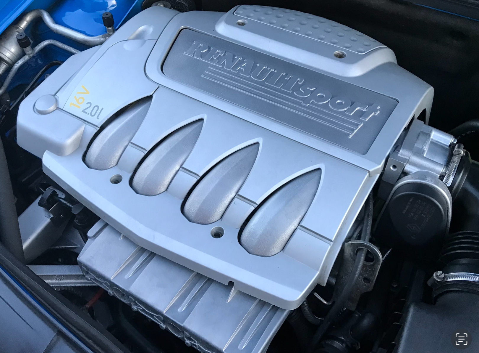

I’d bought some new injectors and spark plugs from Renault a while ago, but misplaced them. Had a good tidy up in the garage this morning and found them so figured I’d replace these just to be on the safe side.
I read a lot about cheap injectors from Amazon and have bought fakes before, so for an extra £28 for 4 injectors, it’s not worth taking the risk imho.
I have no idea where the old injectors were sourced from, but they seem identical to the genuine ones, other than a few numbers are different and the hole at the front is larger on the OEM part (Pictured right).
Good to see everything is still nice and clean under the intake and cover with no nasty surprises
It was covered in oil when I purchased it.

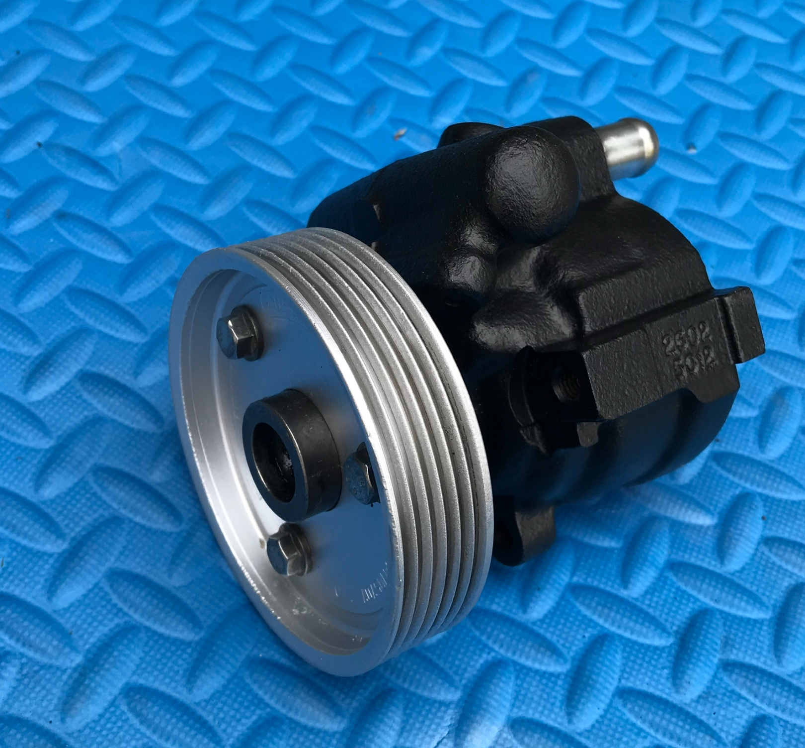

Now a few months back I noticed the PAS pump sounded a little noisy. Everything felt ok, but I suspected something wasn’t right. I’d mentioned it to a few people but they couldn’t hear anything. Having 3 of these cars at the same time, my gut feeling was telling me otherwise.
So thought I’d have a good look and there’s a leak coming from the pump. Damn.
Good job I have a spare.

So I’m standing there looking at my immaculate engine bay, with all its beautiful ancillaries and spotless paintwork thinking can I be bothered ripping all this apart it. Life’s too short to be stressing out. Bonnet slam.

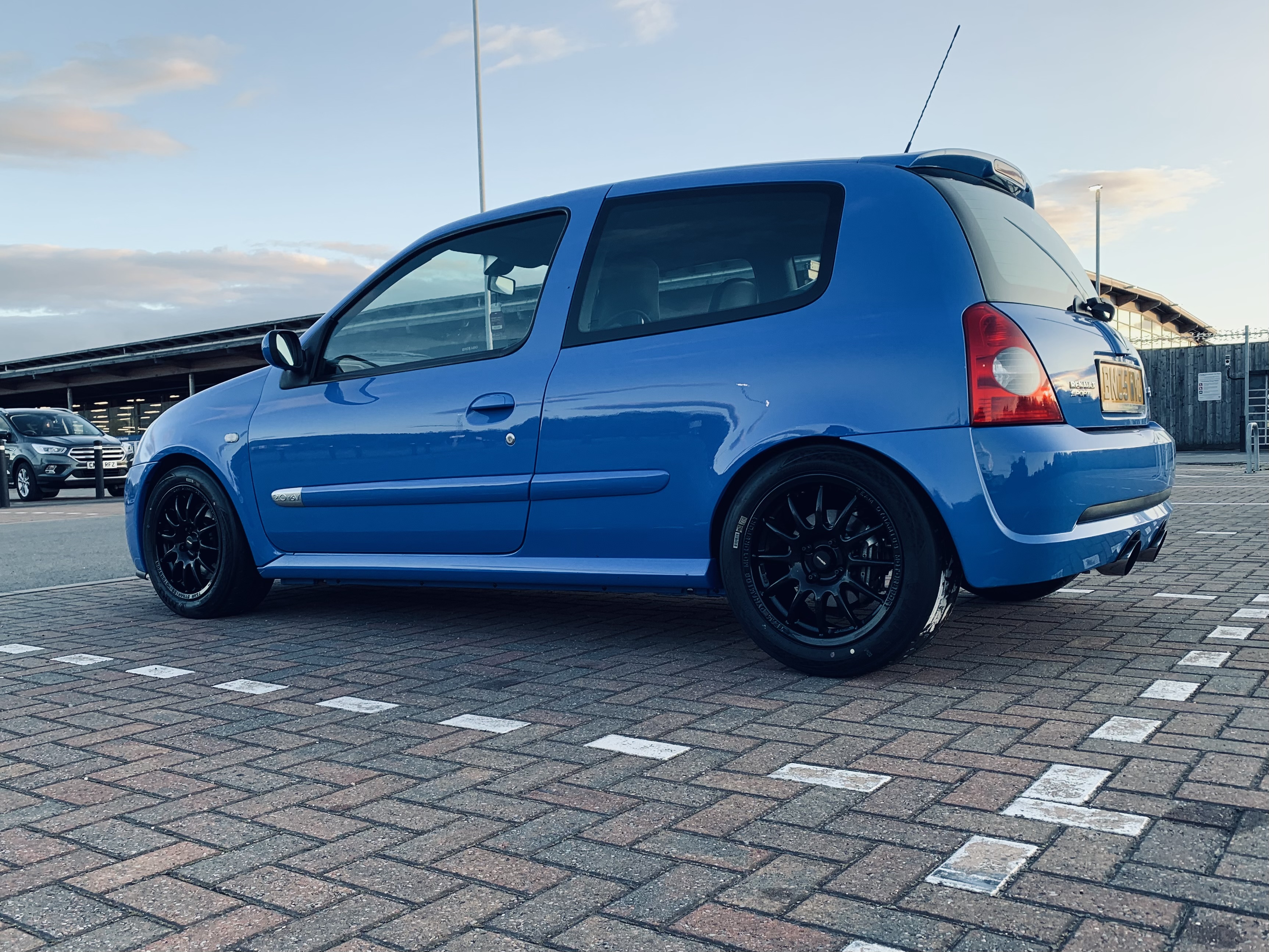

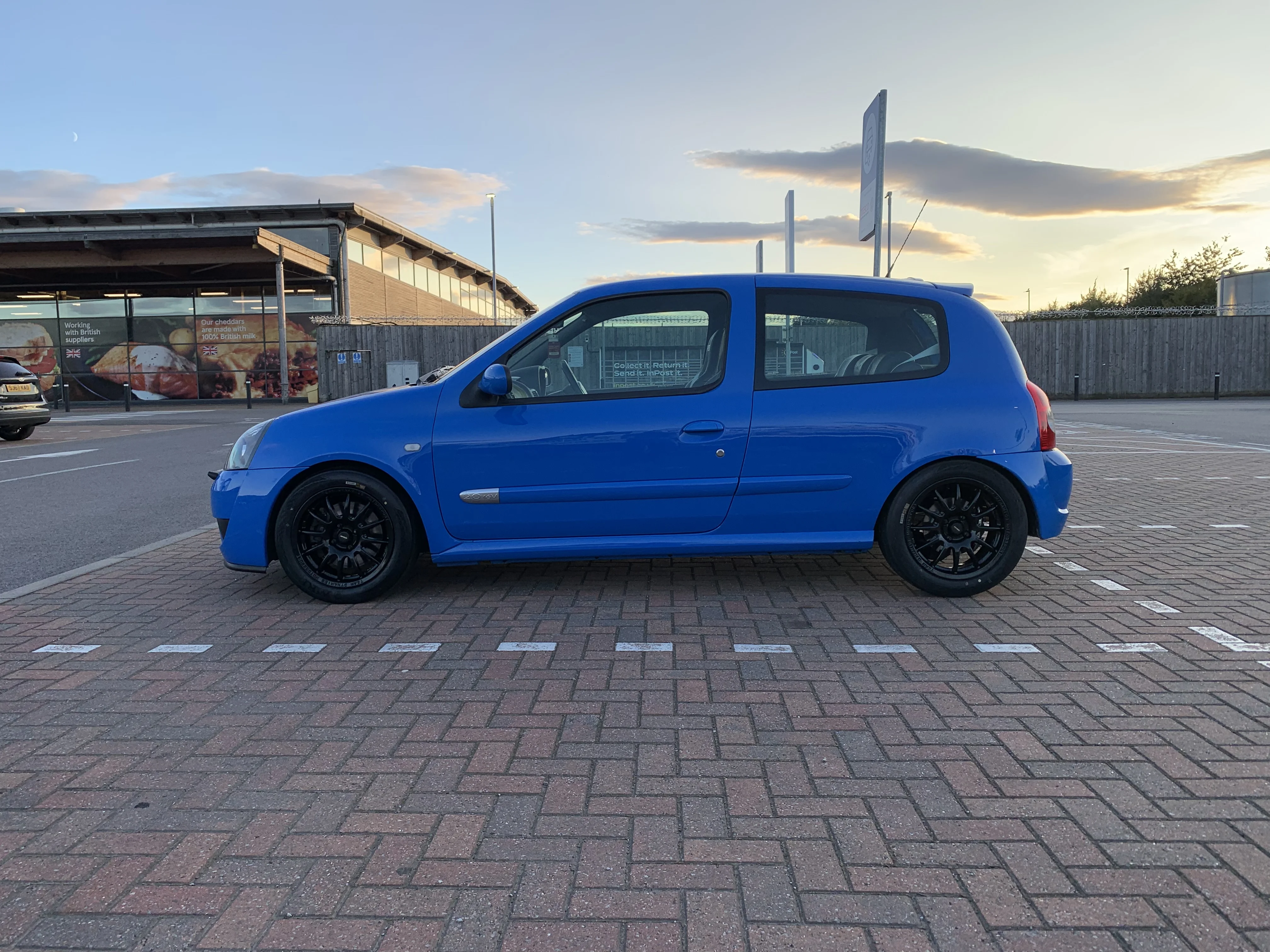

Got my tyres back today so gave the TD Pro Race a test fit.
So pleased with how it sits now. Near identical to my track car and rides just as badly on the road too 😫 Should be a hoot on circuit though.
