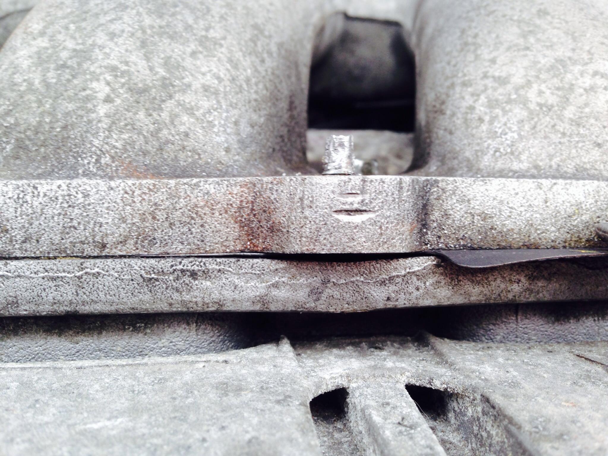

Right, problem solved - almost. Took the manifold off and filed away the bit of the bolt that was protruding through underneath - bolted everything back up, and - instant start up. It's closed the gap that had opened massively, but it is still there, just.
Now I need a new manifold as this one is a bit damaged from where the bolt hit it, and a spare bolt. Oh and my engine management light has come on.. I assume this is related to unplugging the gubbins on top of the manifold? Just that it's not really showing anything on my code reader.
Has it bent it slightly then, where the bolt has gone through and pushed against the lower part?
yeah exactly that mate - to be honest that pic makes it look a lot worse than it is. Was much more noticeable yesterday, before I'd filed the bolt down.
