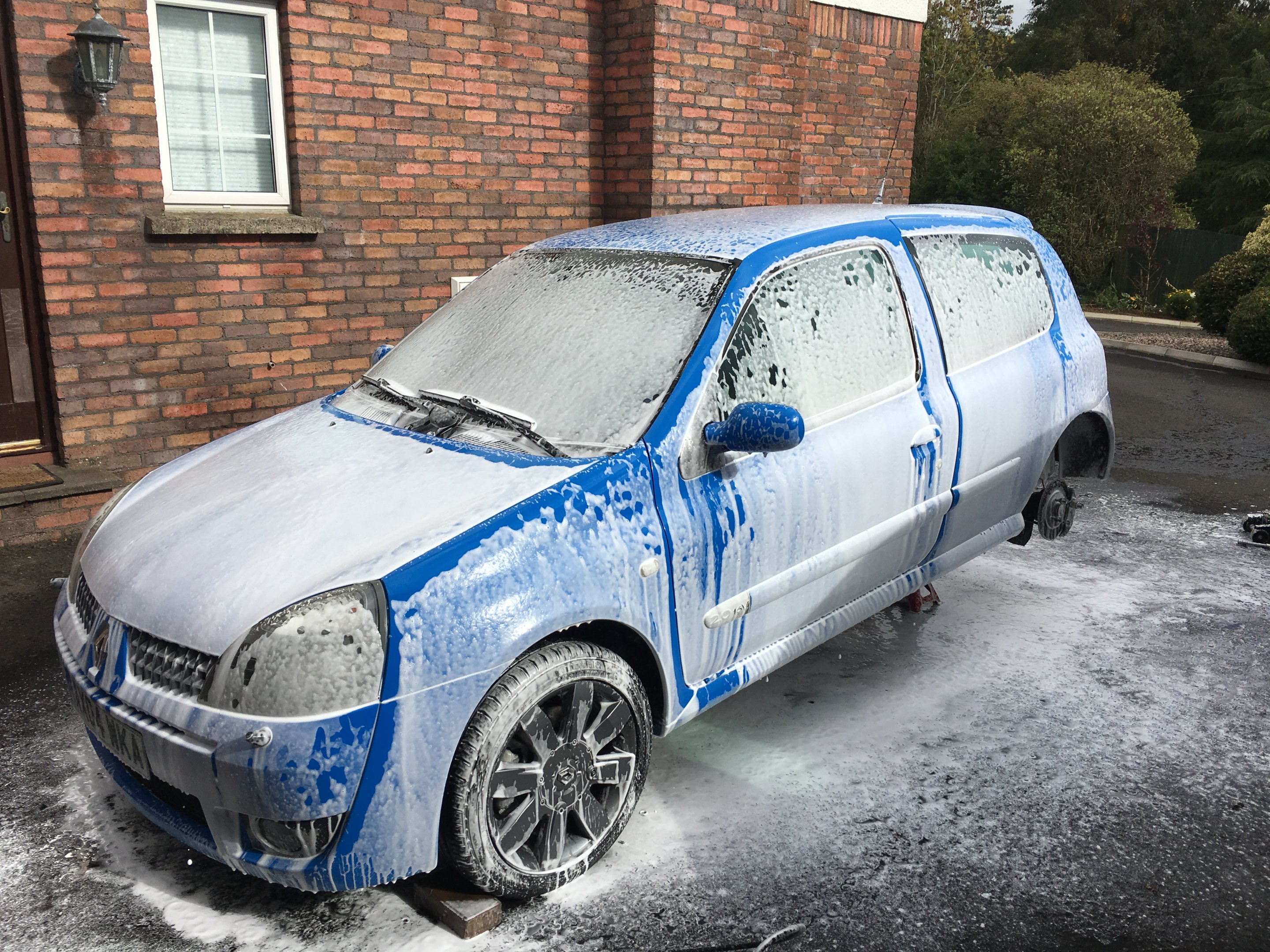

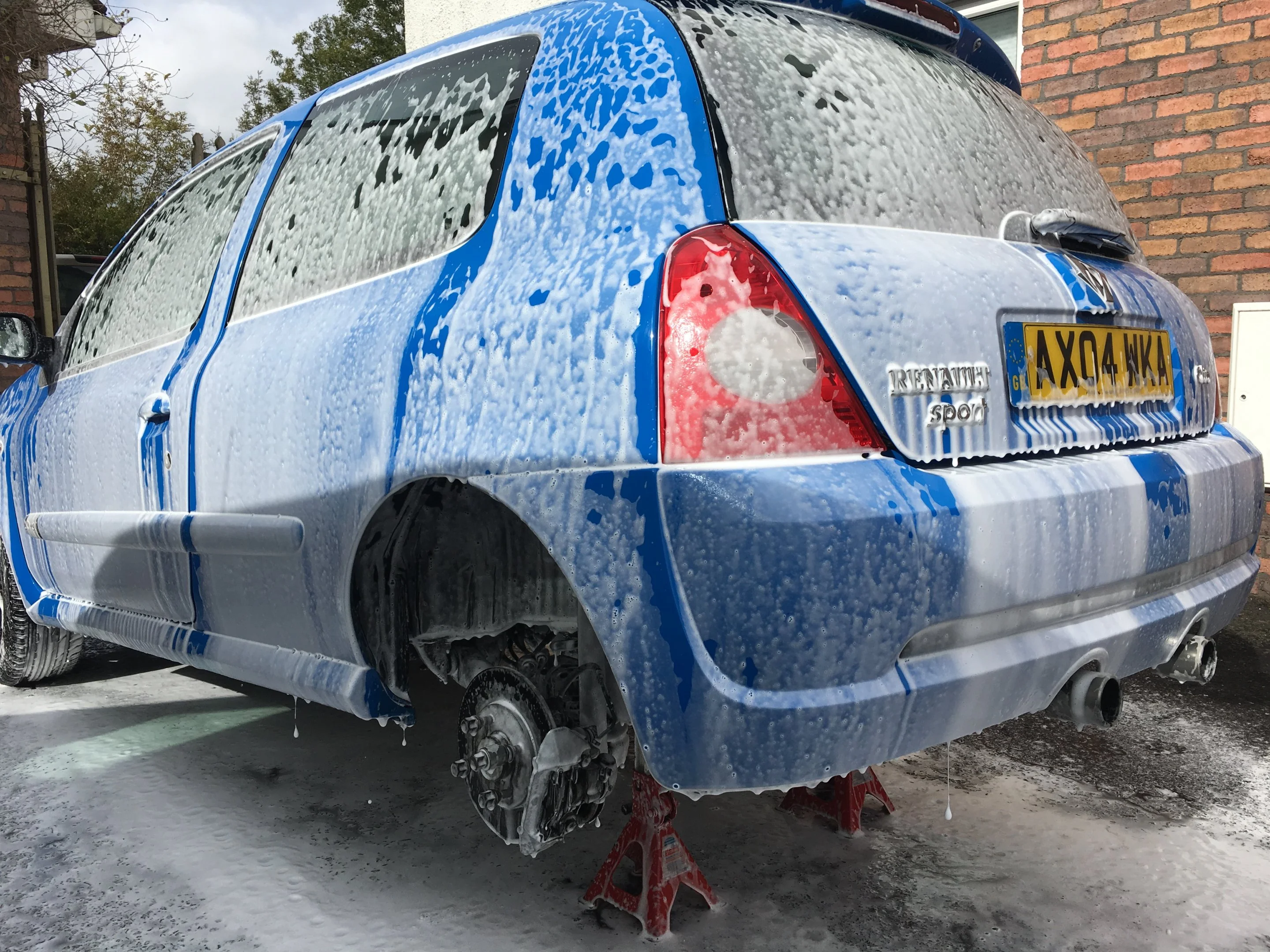

I then snowfoamed the entire car including below and let it dwell

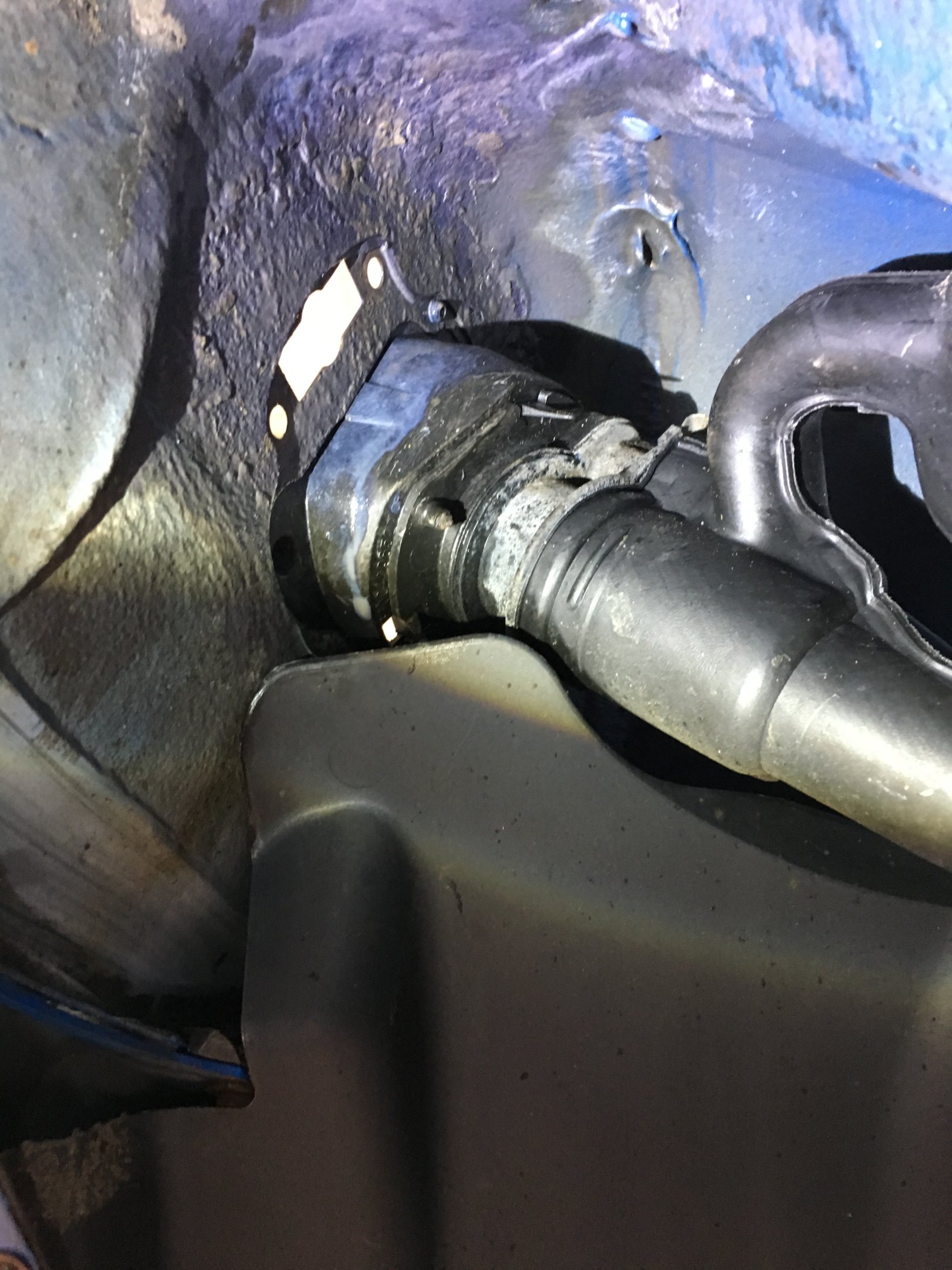

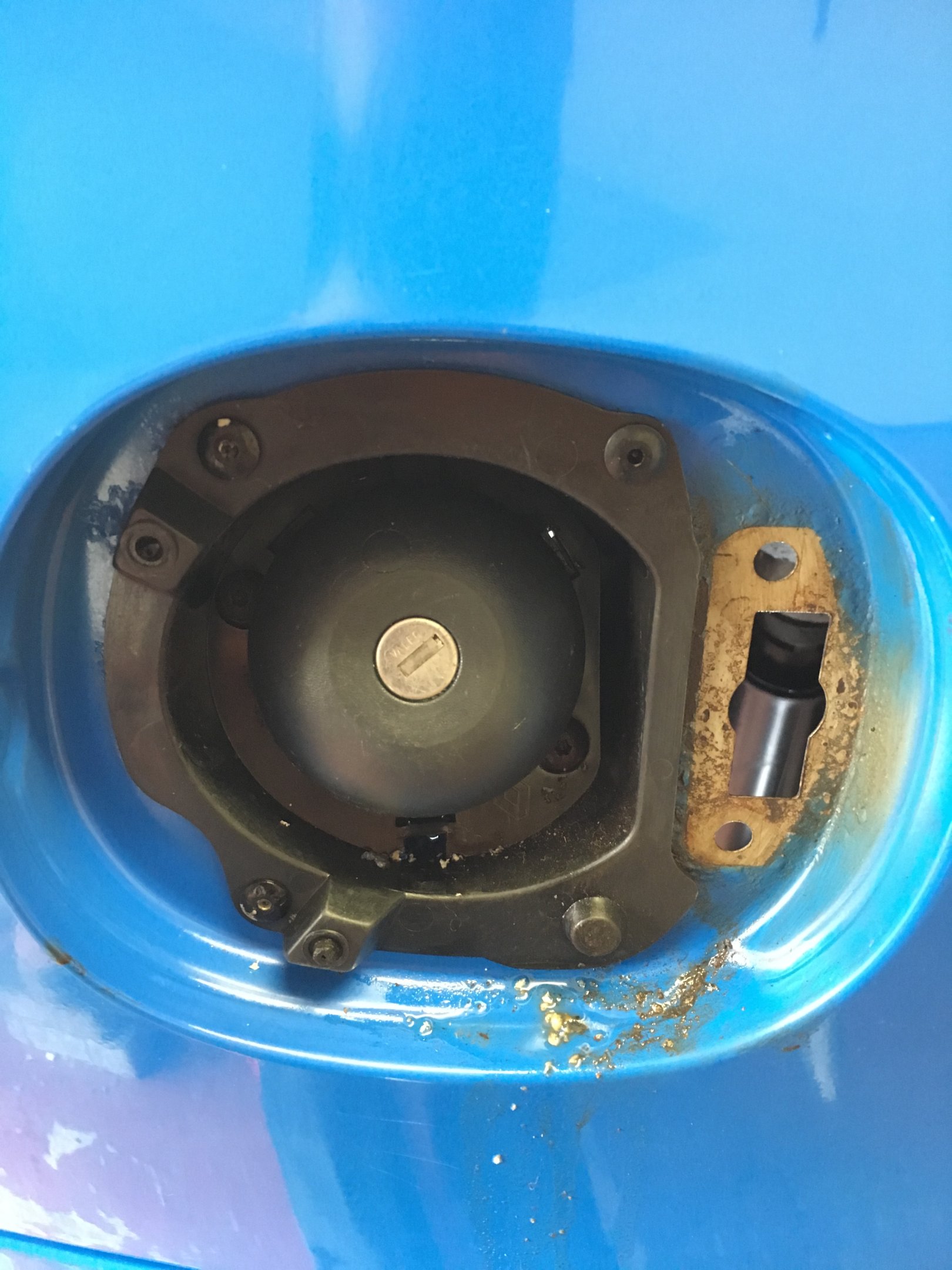

Behind fuel cap a bit cleaner after snow foaming and brushing. Both arches were cleaned with the brush pressure washer attachment,
I then washed, detarred, deironed with bilt hamber korrosol
l got the car inside and removed the fuel flap removed any loose rust and treated with loctite rust remedy. I will treat the back with black stonechip this week.
I got it all back together and then applied some Auto Finesse Tough Coat and topped off with some chemical guys speed wipe.
Car will be getting some paint work soon so the fuel flap area will be sorted.

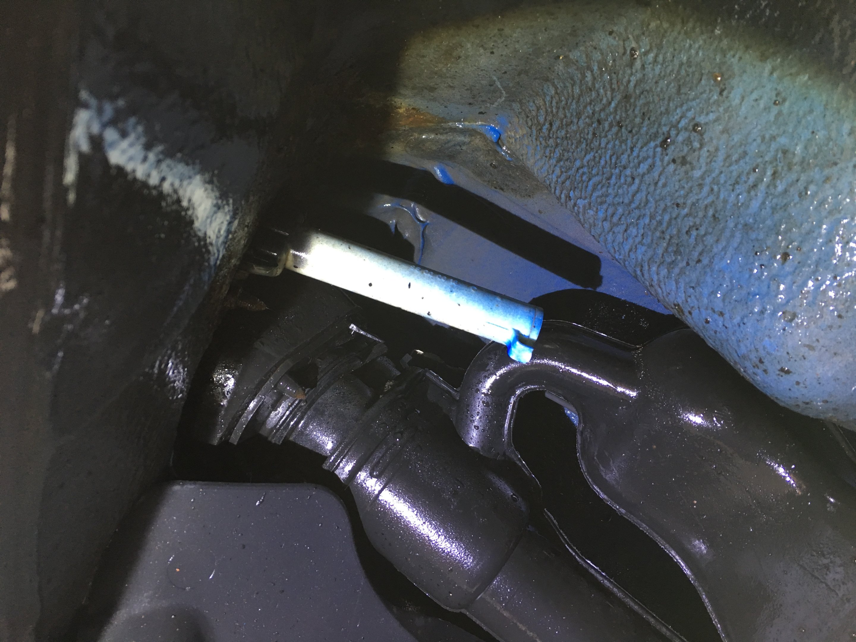

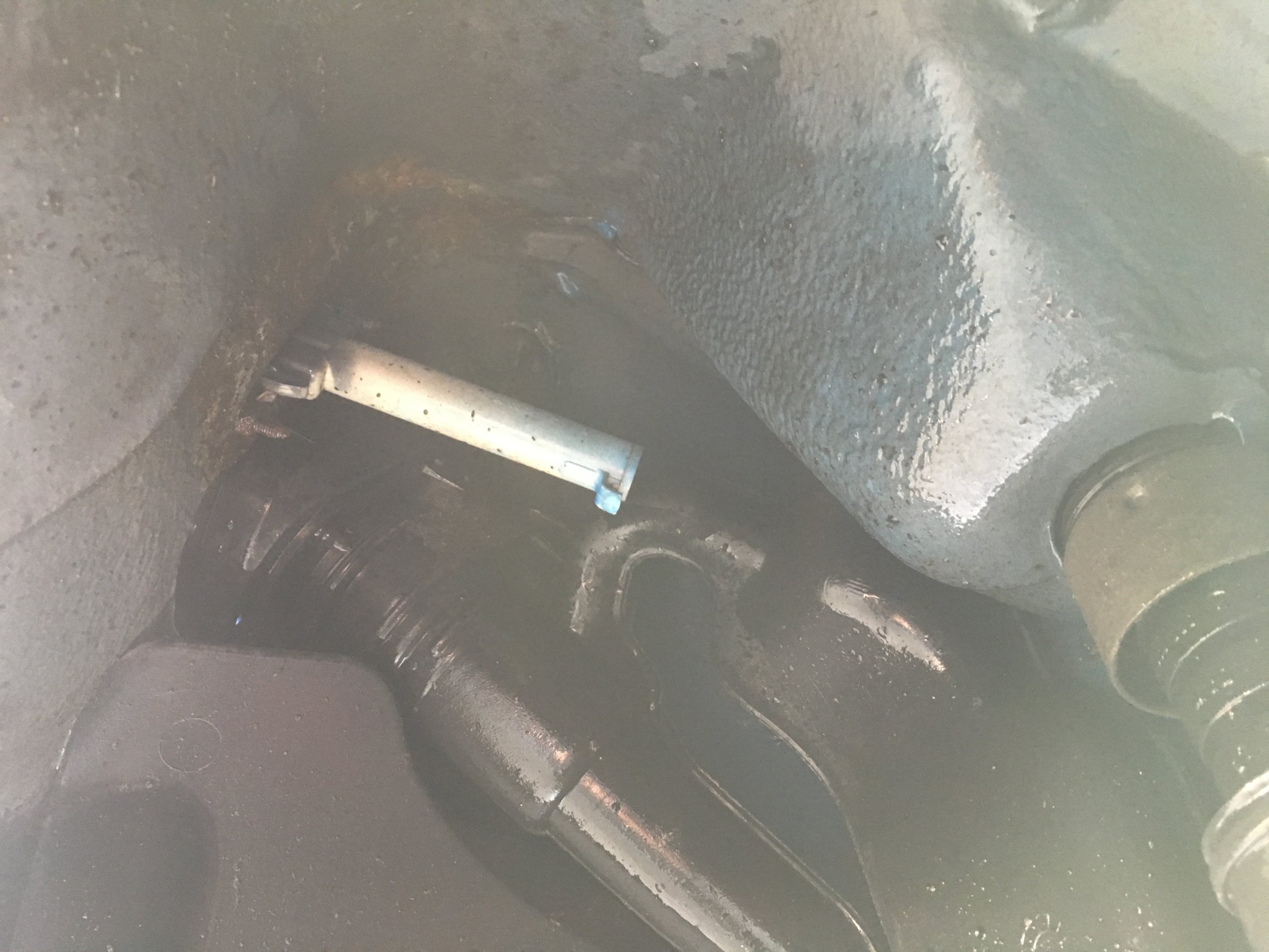

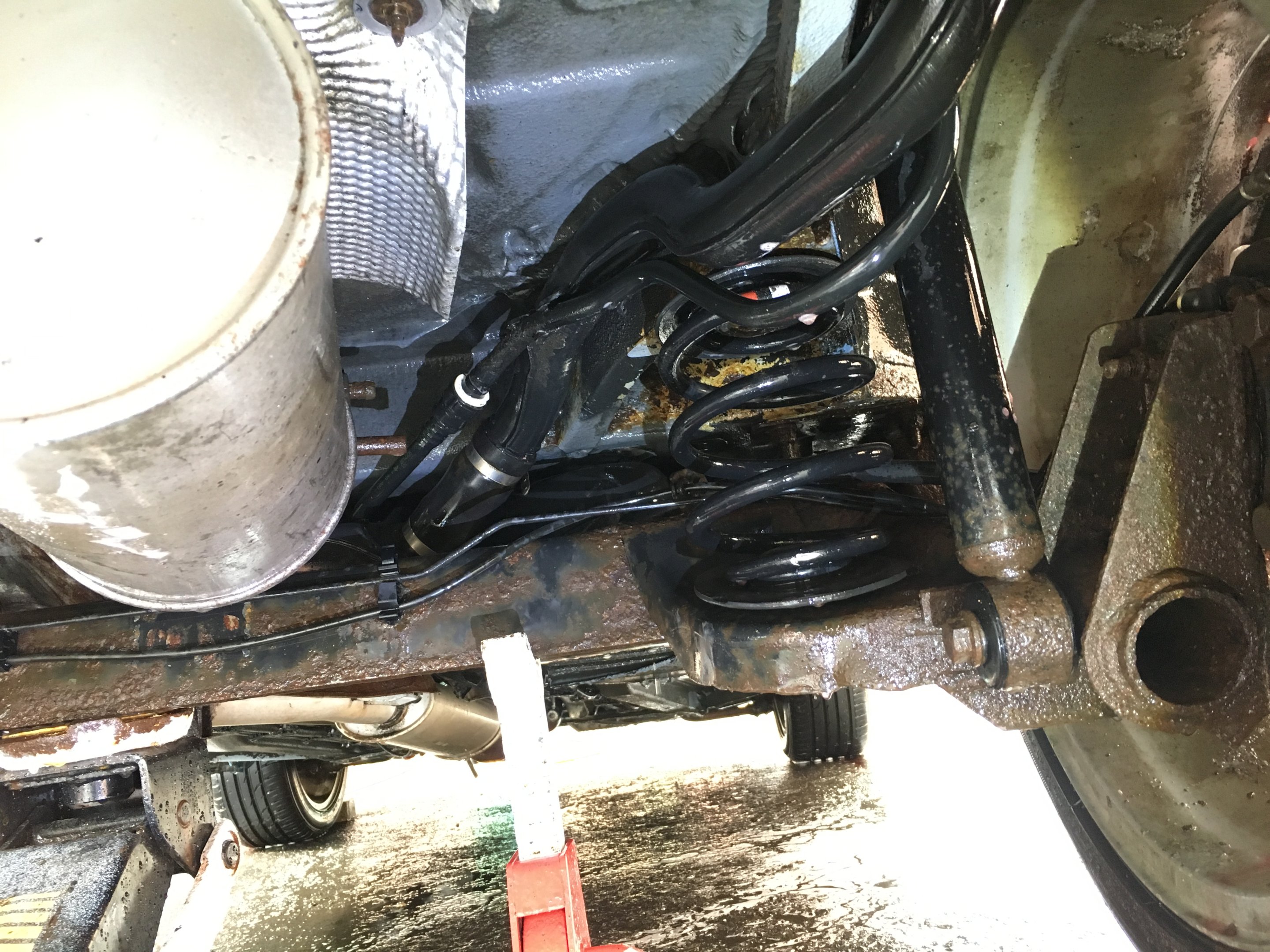

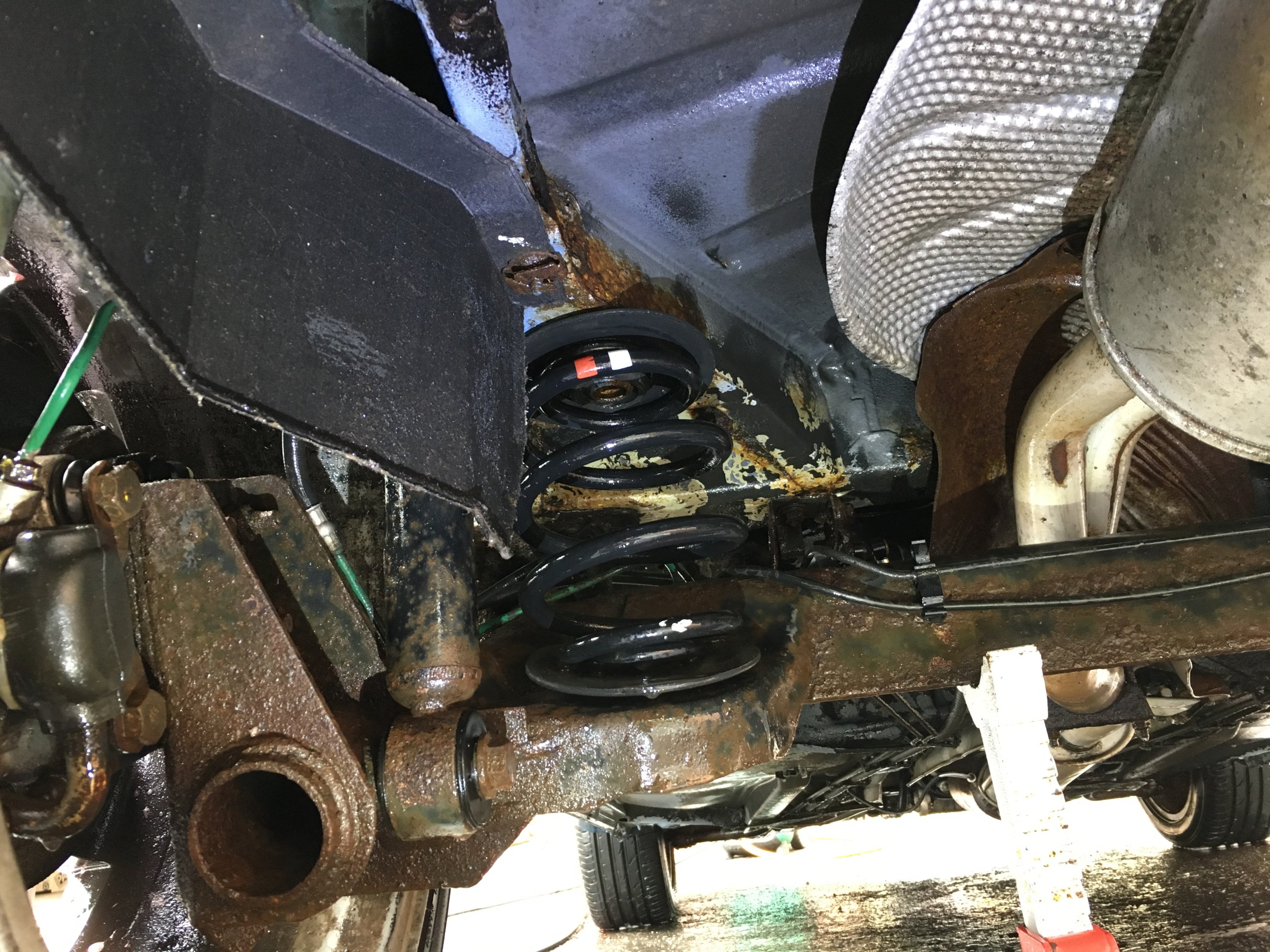

After washing below the car and rust inhibiting the rear of the fuel cap area, I then undersealed here and the whole rear of the car.
This is only after two days of driving since undersealing it and look at the dirt build up! I used new nut and bolts to secure the flap and put caps on the nuts to try an avoid bolt corrosion.

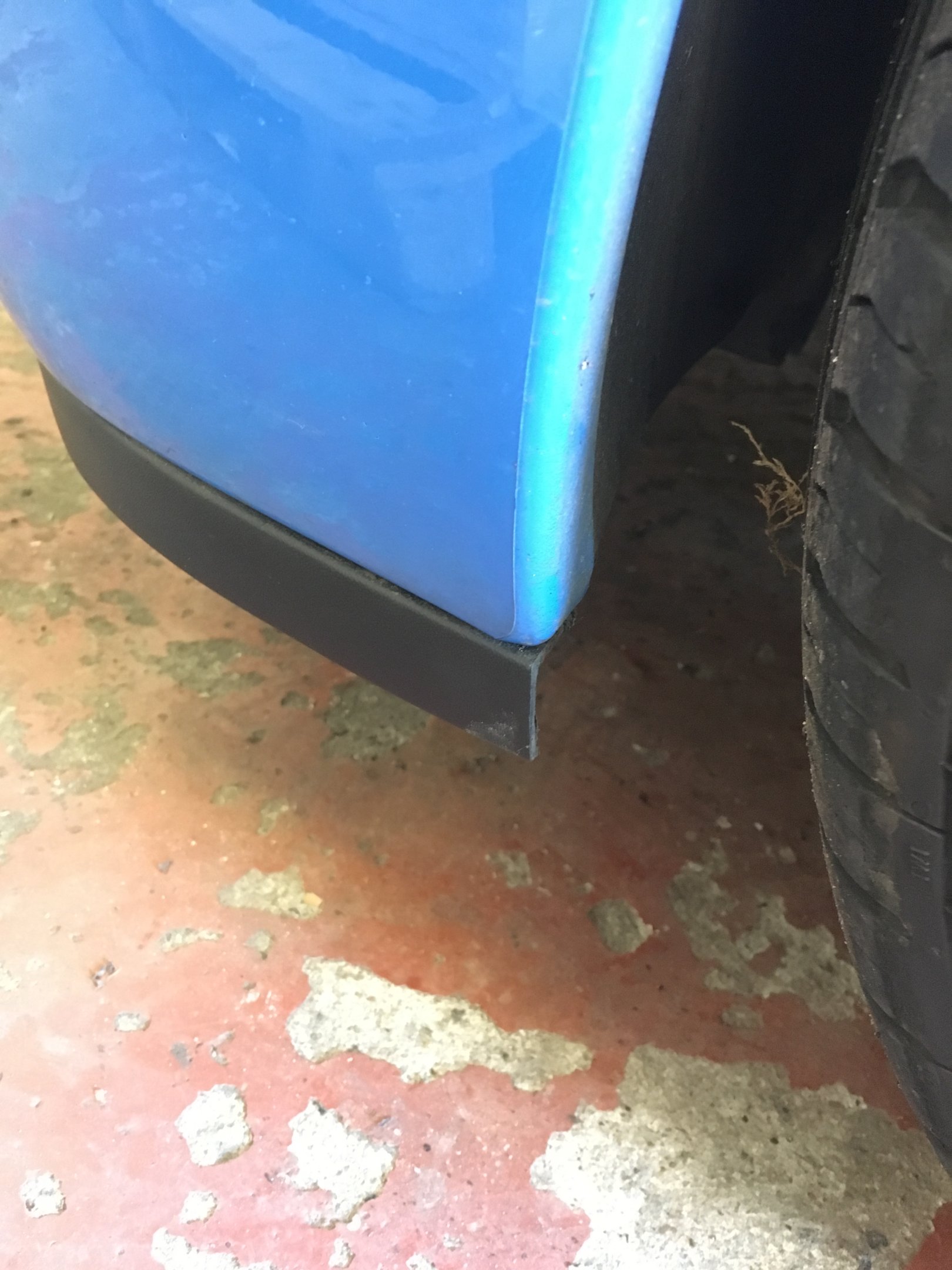

I also fitted my skoda fabia splitter

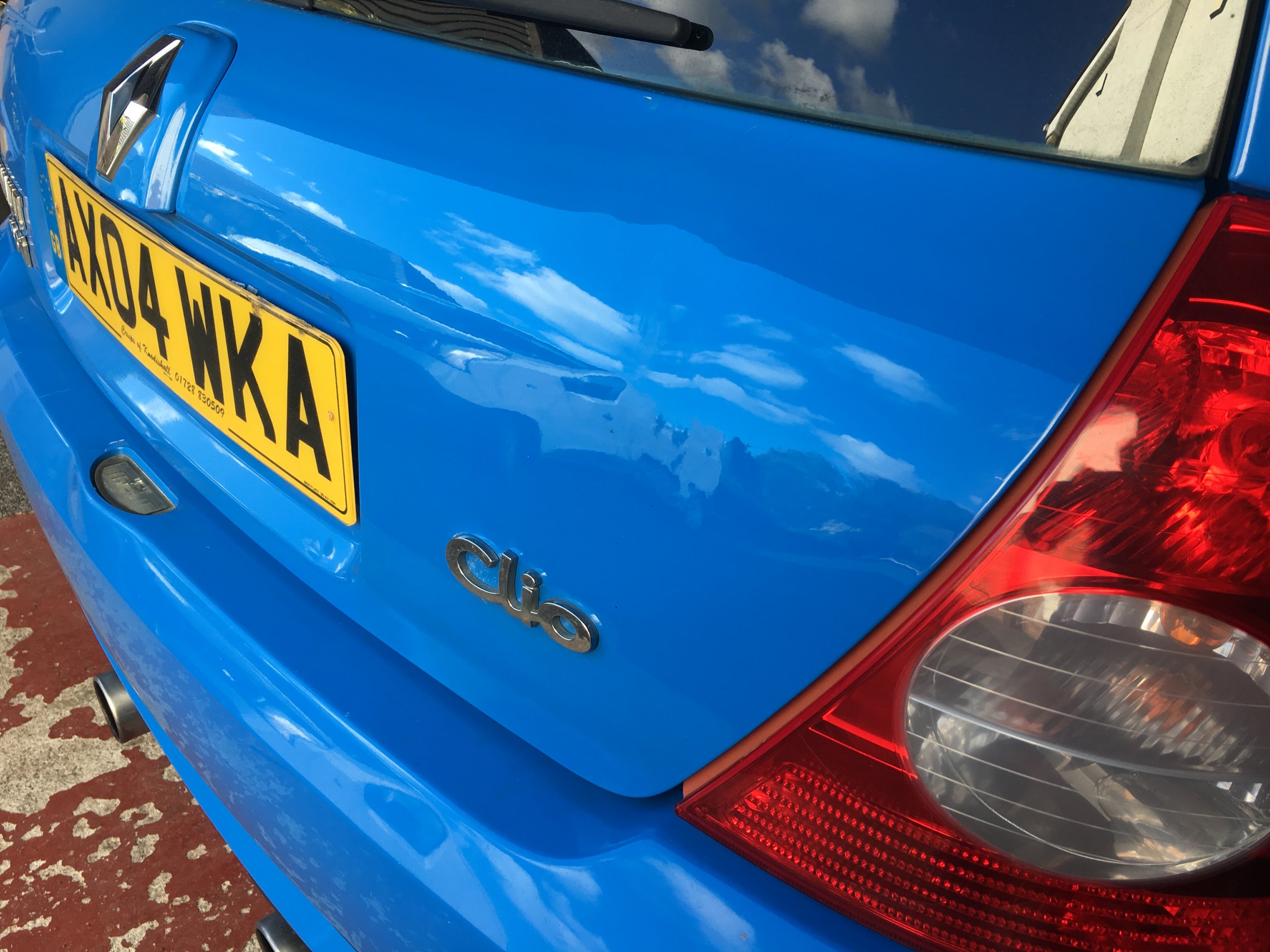

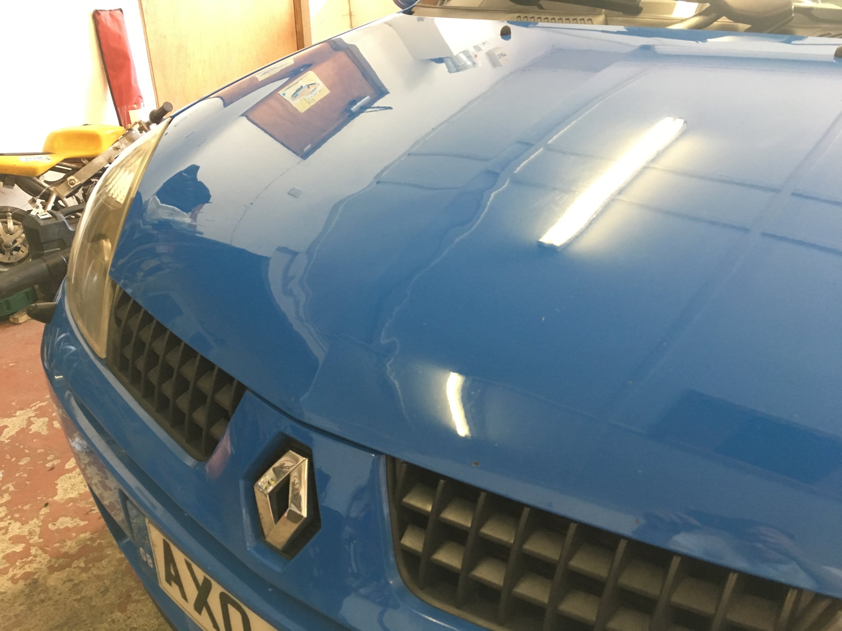

During last week I got my local PDR man to remove all car park dents on both sides and have a go at the bonnet and boot dents, this is the result
The bonnet is not perfect and neither is the boot but both are visibly much better, however will require paint to fix correctly.

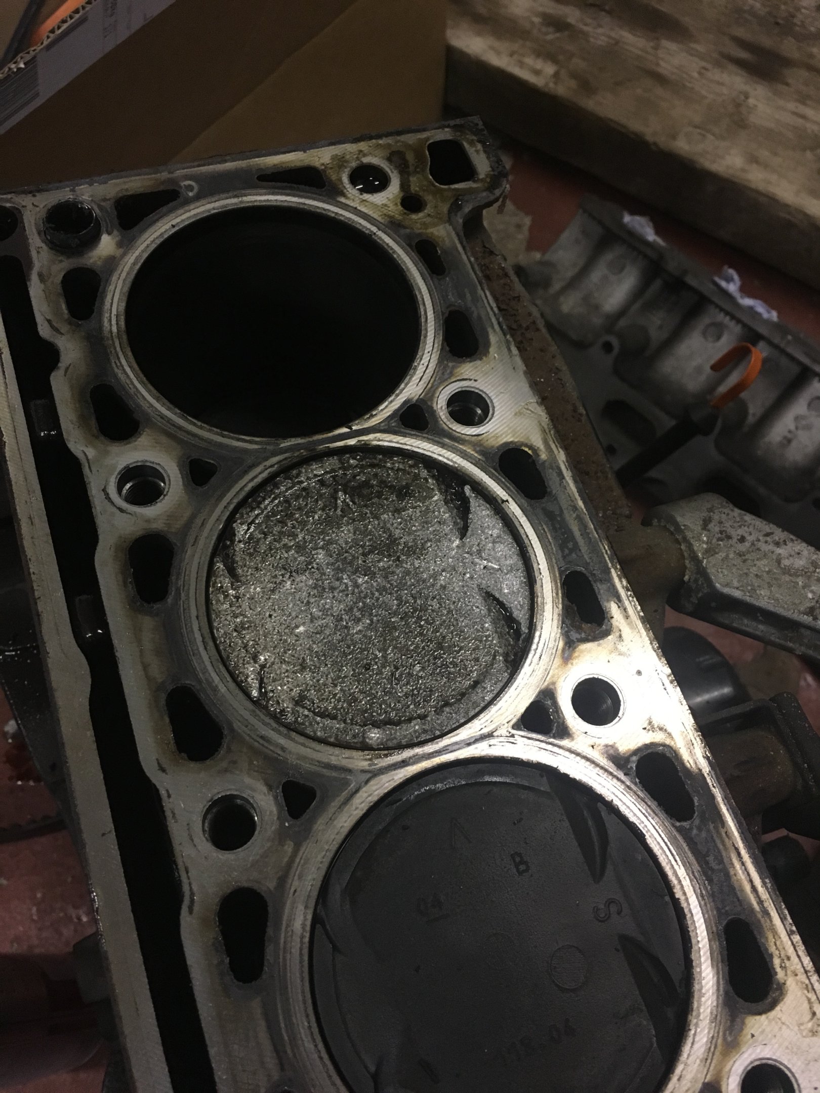

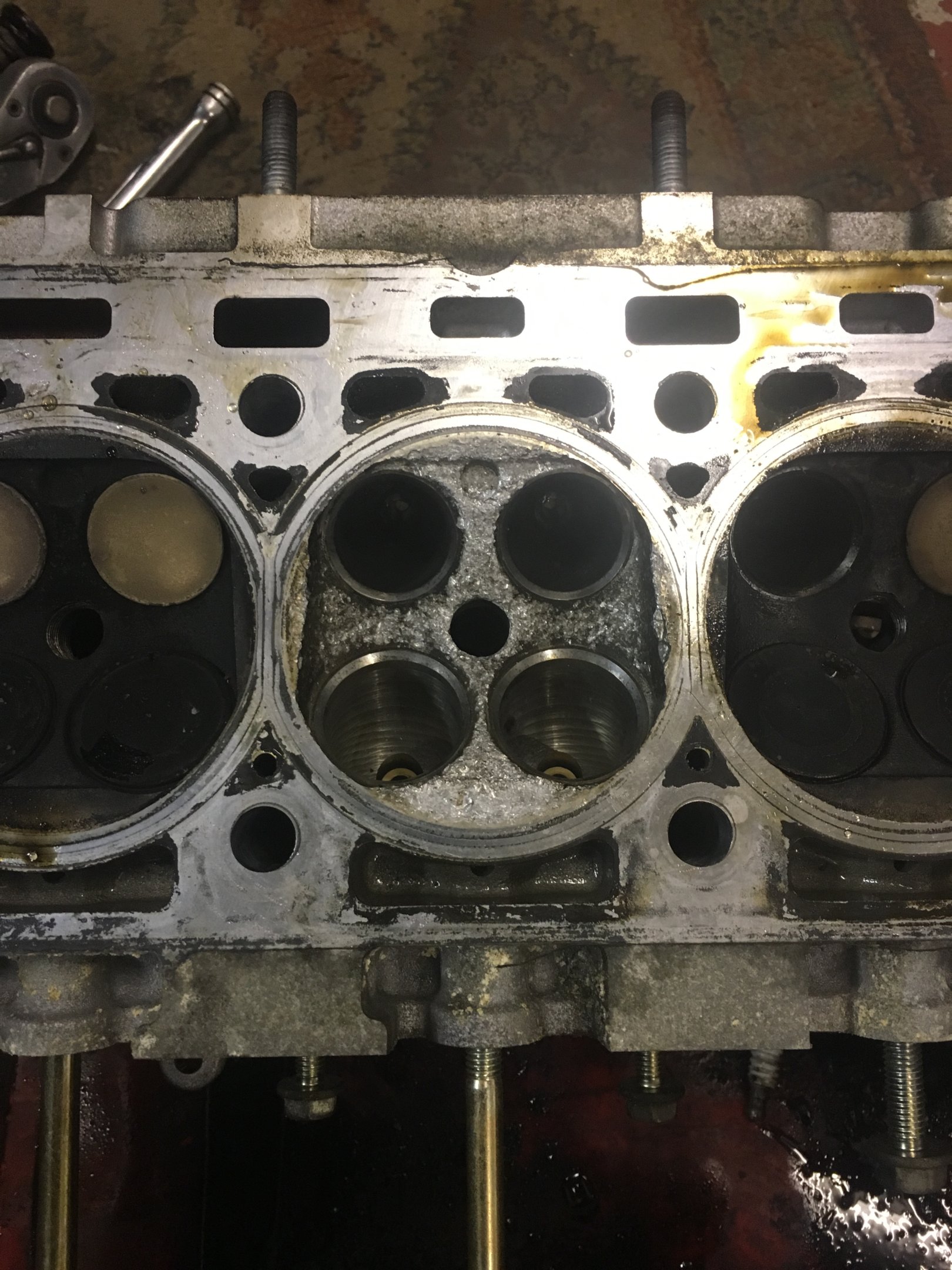

We removed the head from the cars original engine to reveal this. All valves were present and two visibly bent but removed for this photo.
Full discussion on this thread https://www.cliosport.net/threads/engine-failure-thoughts.822212/#post-11672625

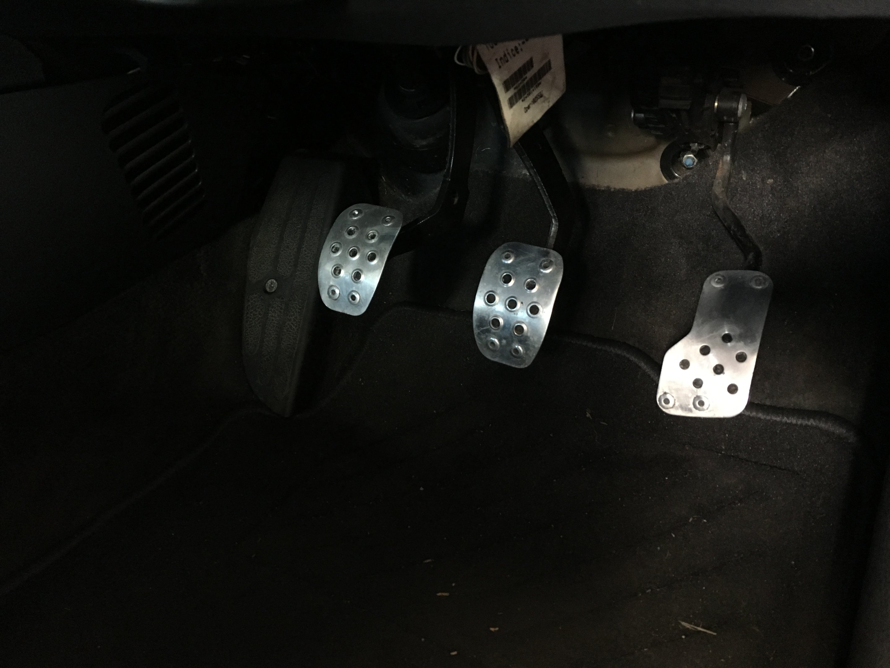

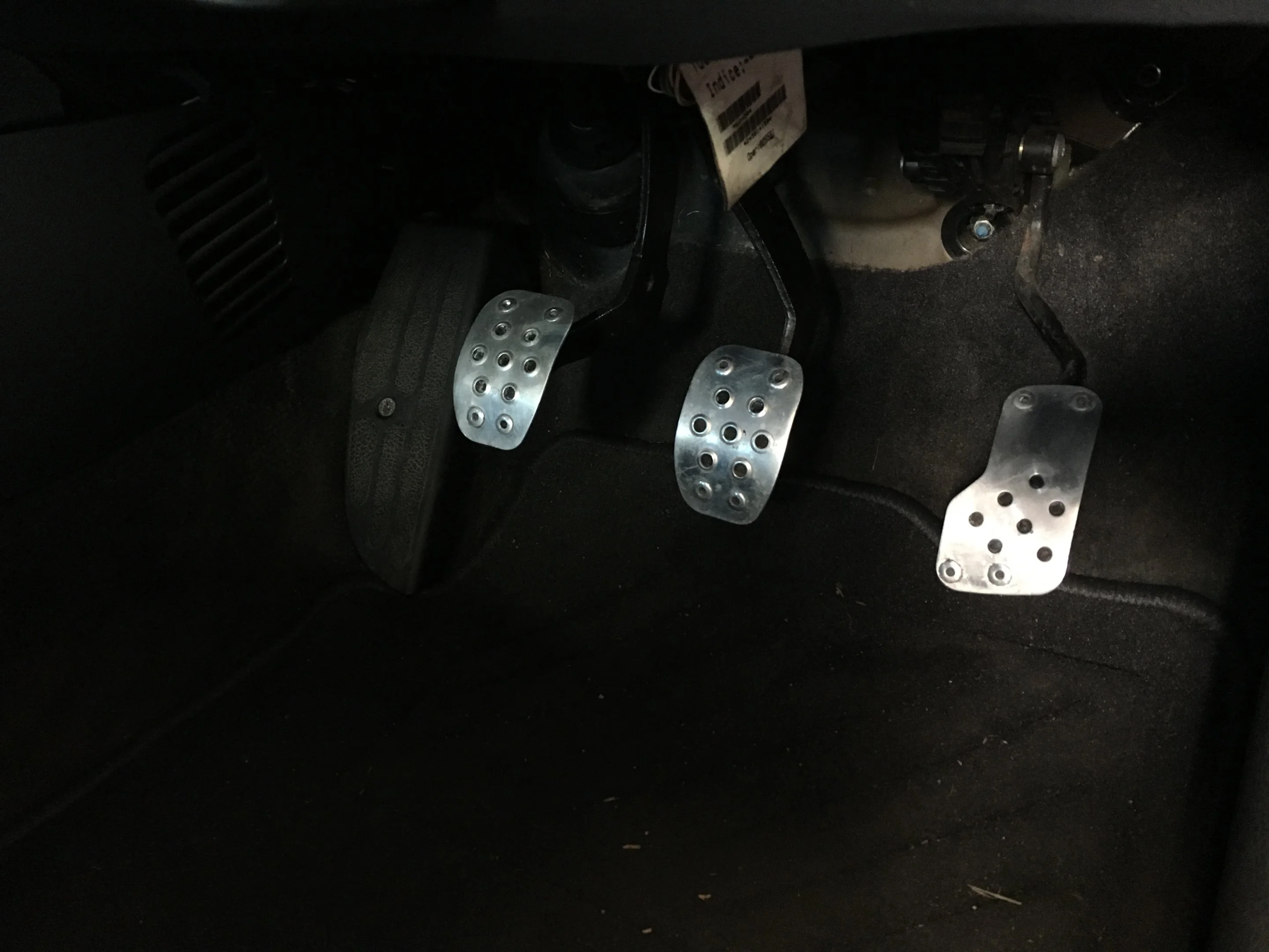

I removed the rubber from my pedals and they are actually in better condition than I thought previously. The last owner must of wanted more grip on the pedals and chose to fit rubber over the top of them. It was actually genuine Renault rubber covers that were on it. I cleaned and polished the pedals which left them like this.

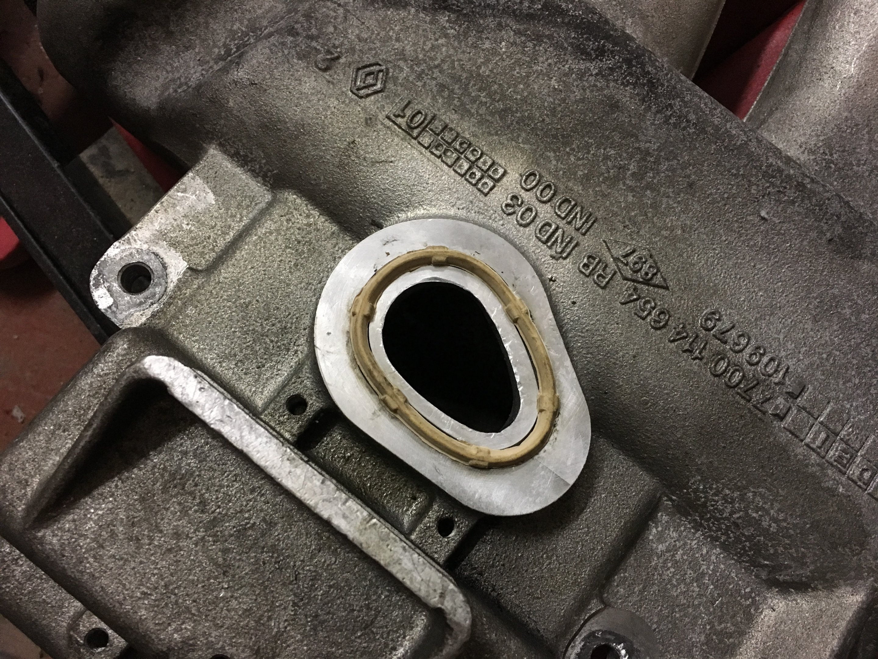

I replaced the seal on the bottom of the inlet as the last time I removed the inlet, this seemed to be letting a little oil onto that area below the inlet.

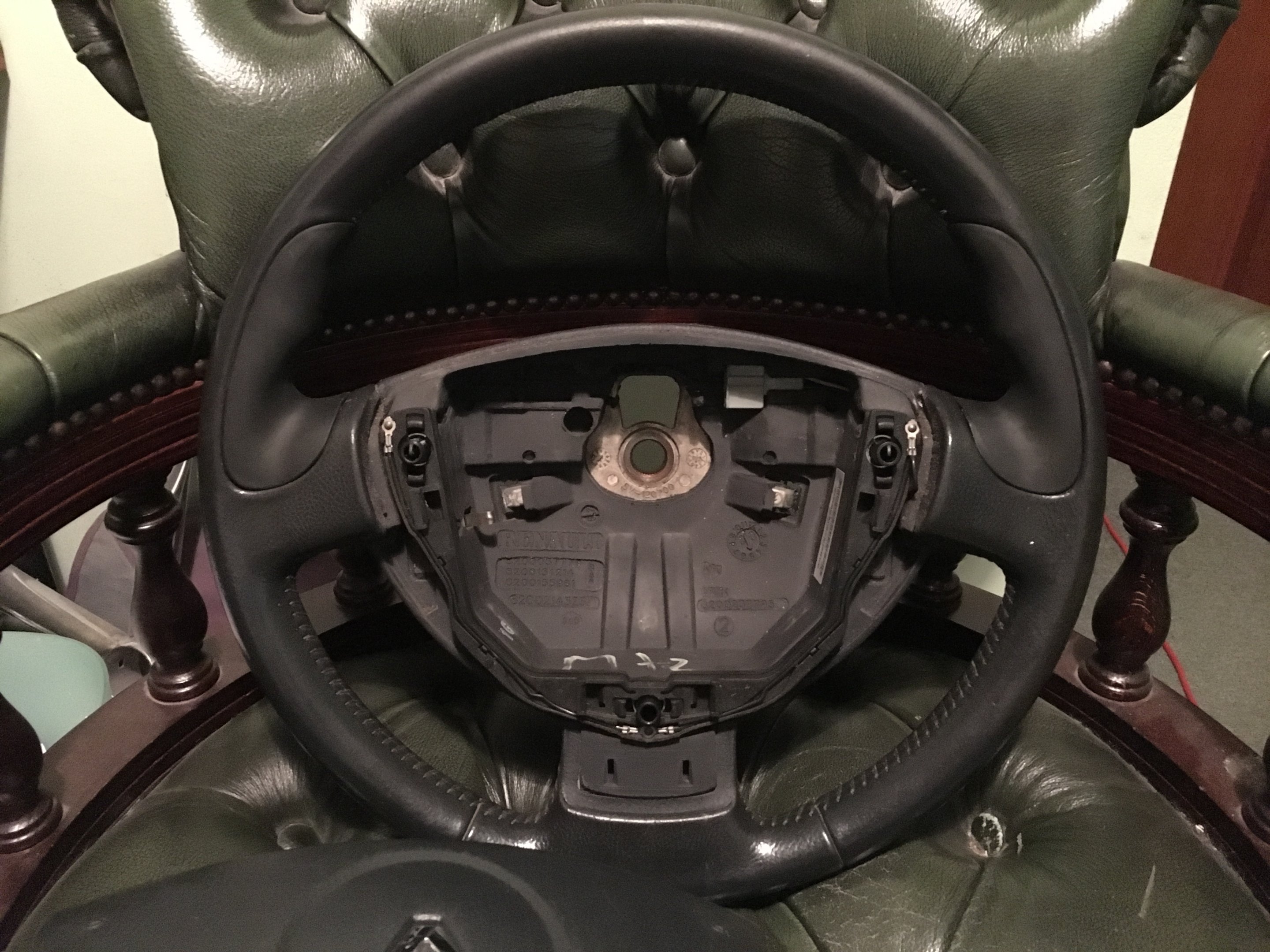

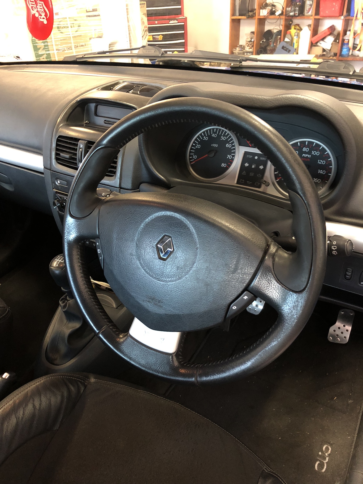

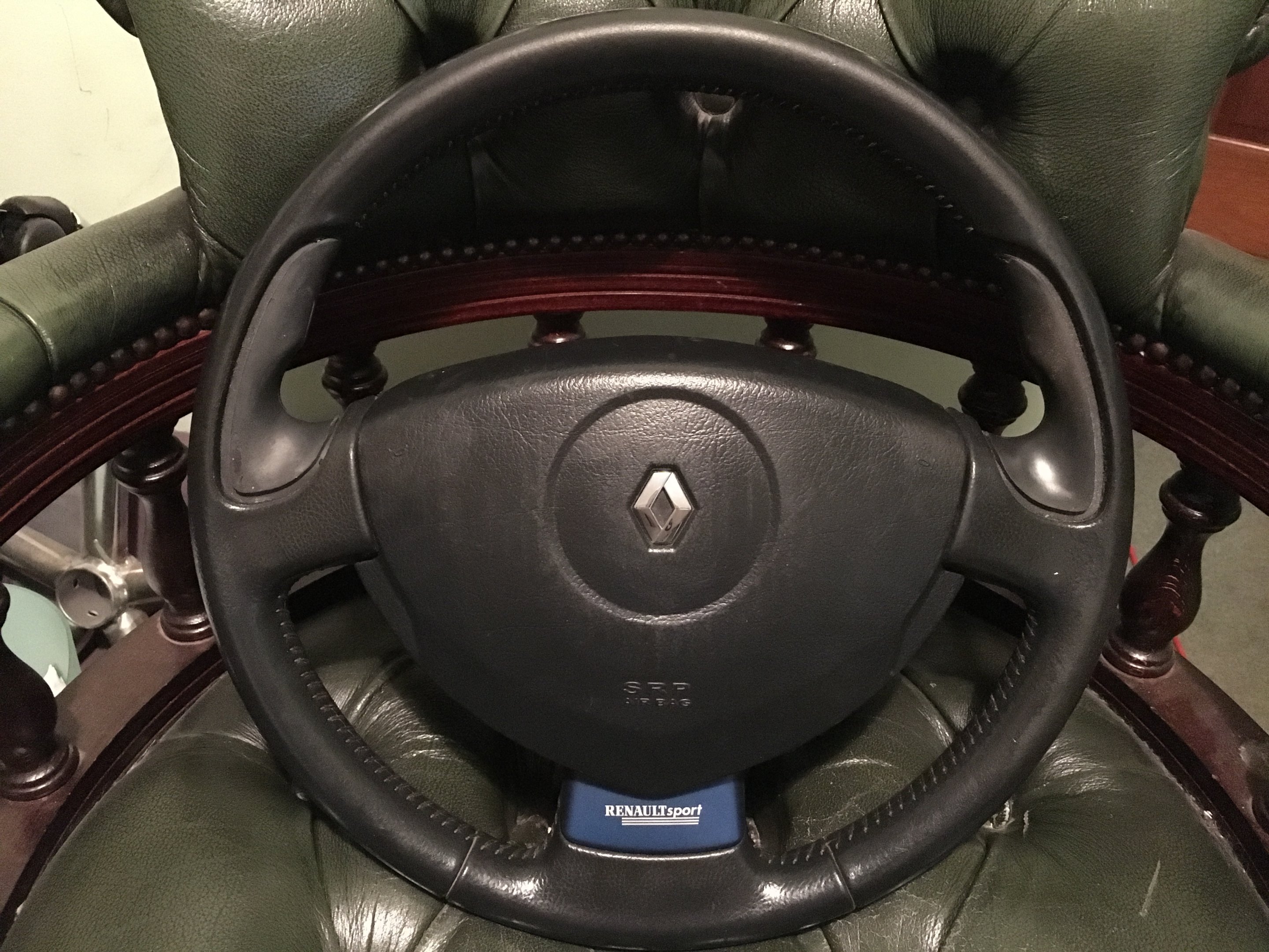

The steering wheel in my car was in very bad condition. Melted and mouldy from sitting before I got the car.
I'm thinking I may get it recovered in alcantara. Not sure yet.

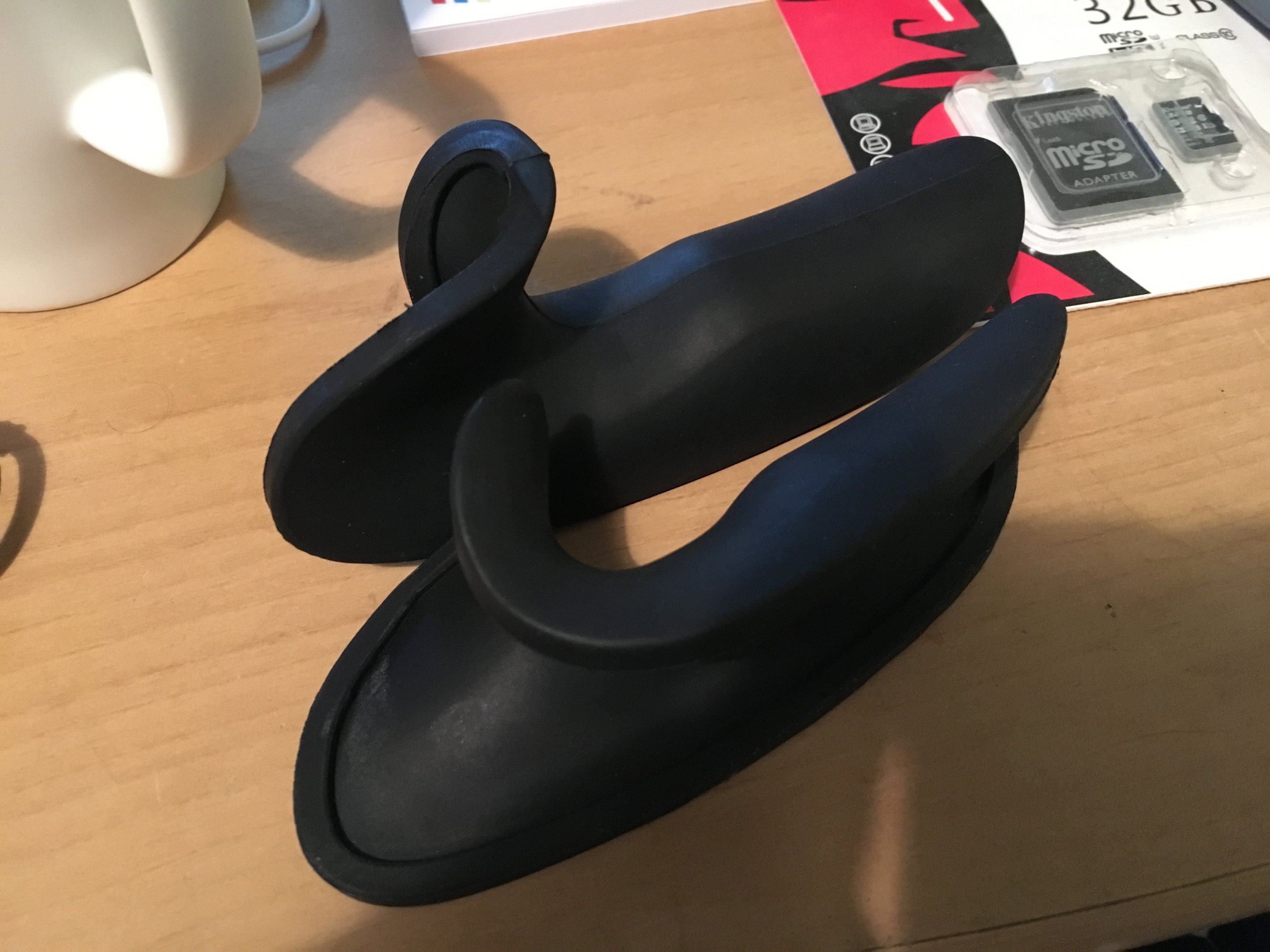

I got the hold of @Tom_1990 old steering wheel and removed the thumb grips
Replaced them with new ones
Can't seem to find photos of this fitted to the car. Next time there is daylight I will take a photo and add it.

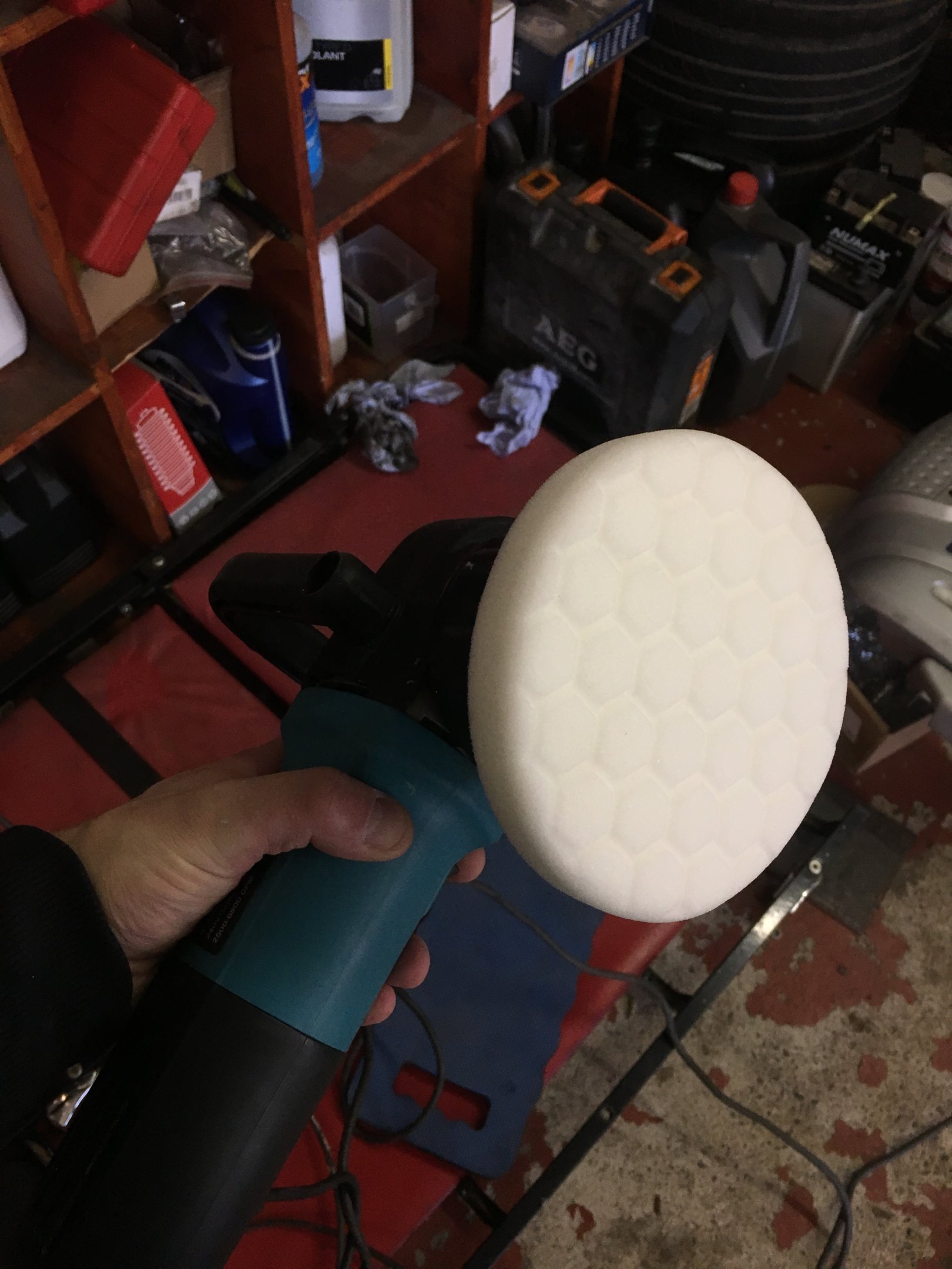

I recently got a spare saturday afternoon and decided to wash, detar, de-iron and clay the car followed by a quick polish using my Das 6 pro with a chemical guys hexlogic white pad and meguiars ultimate compound. This removed a lot of swirling, Still by no means perfect but freshened the paint nicely, I finished off with a coat of Fusso coat light.

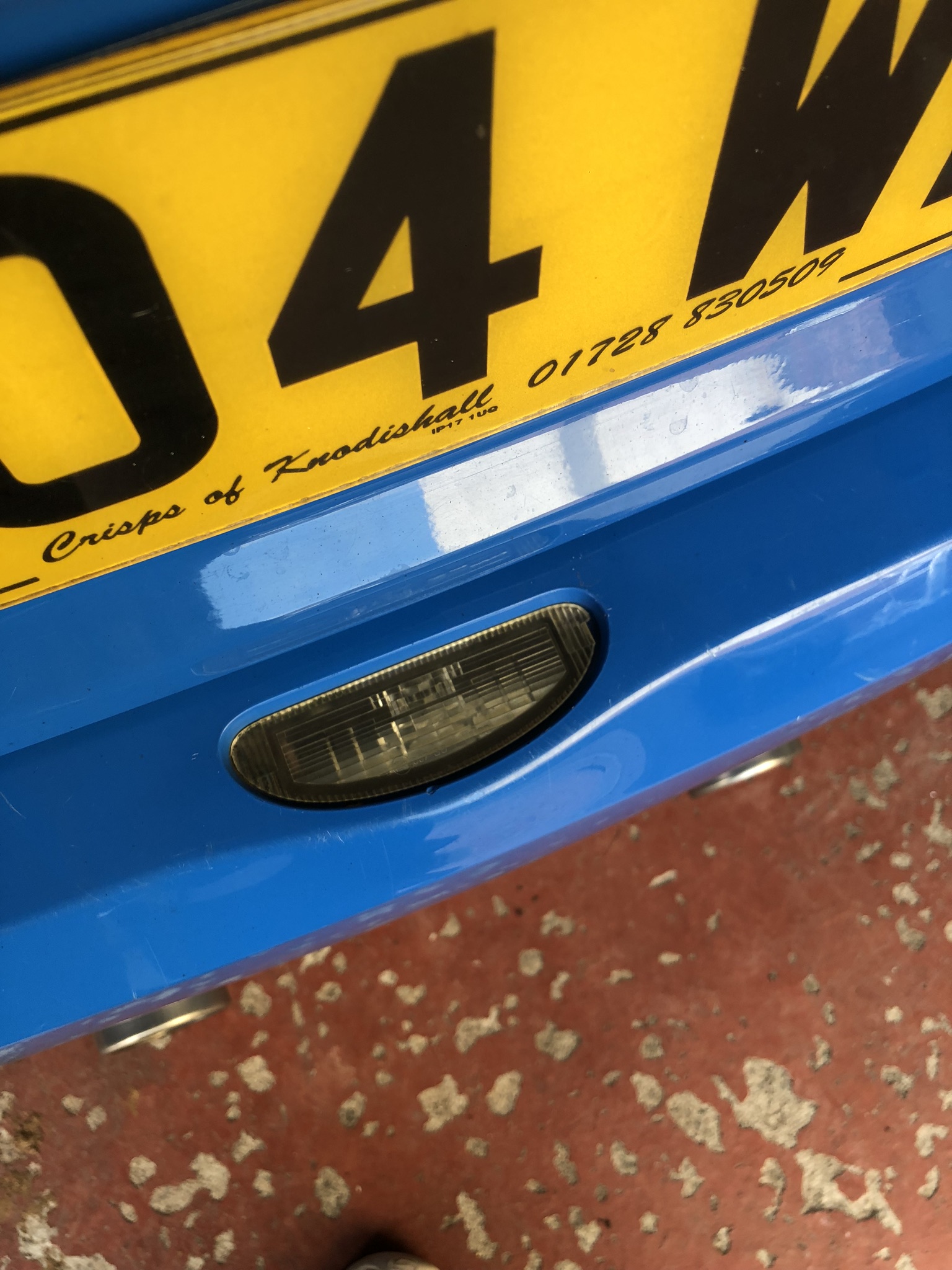

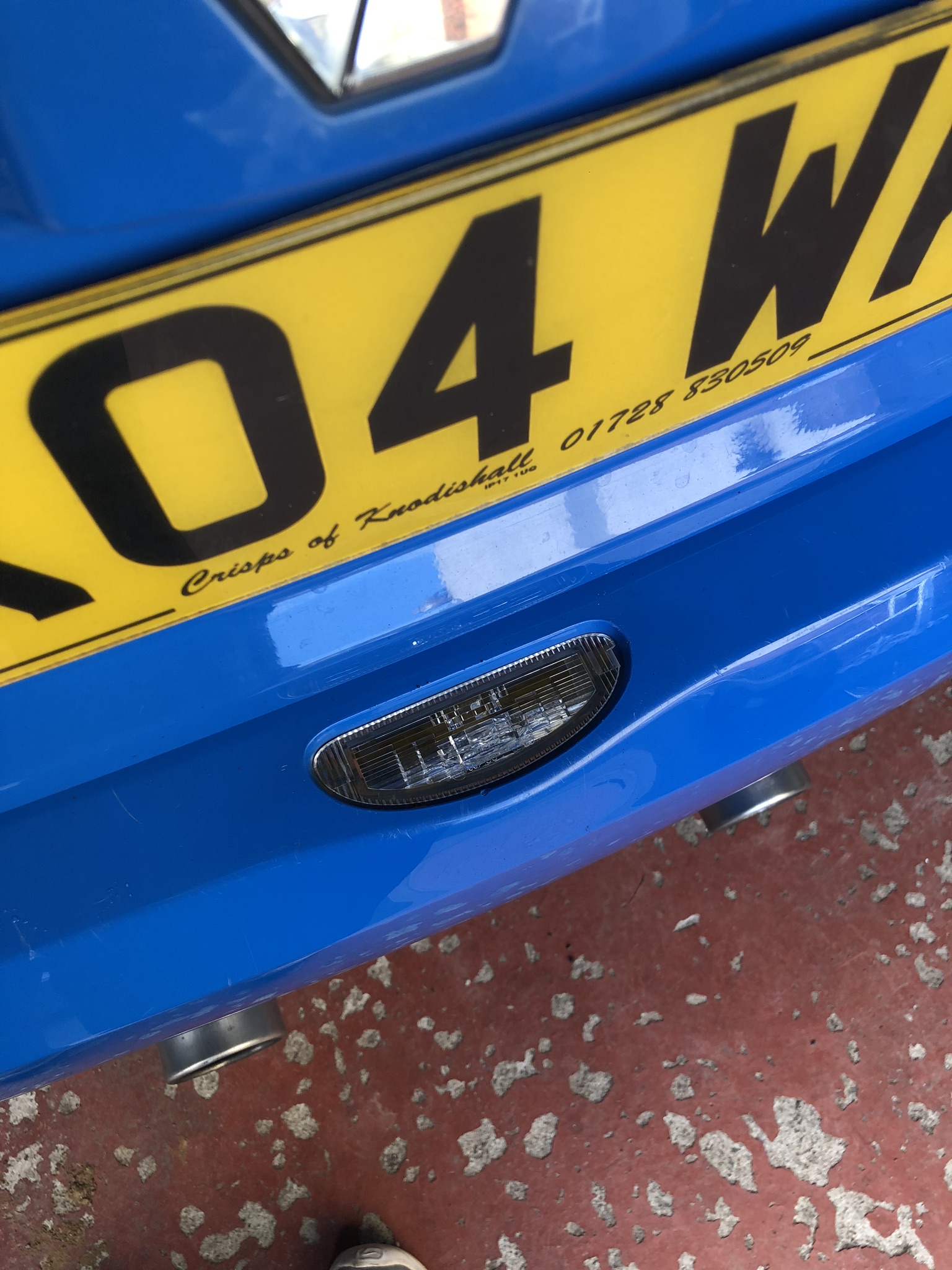

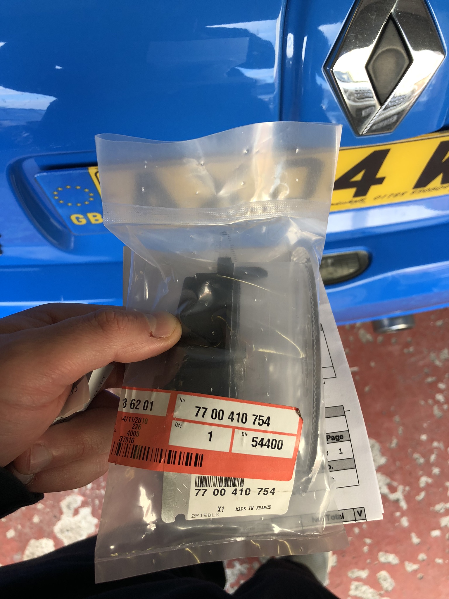

When I got the car I ordered a lot of stuff from my local Renault dealer. One item I ordered was a new number plate light. It was listed as no stock and no delivery date but not NLA. Last week it finally arrived to my surprise.
Old light
New light fitted

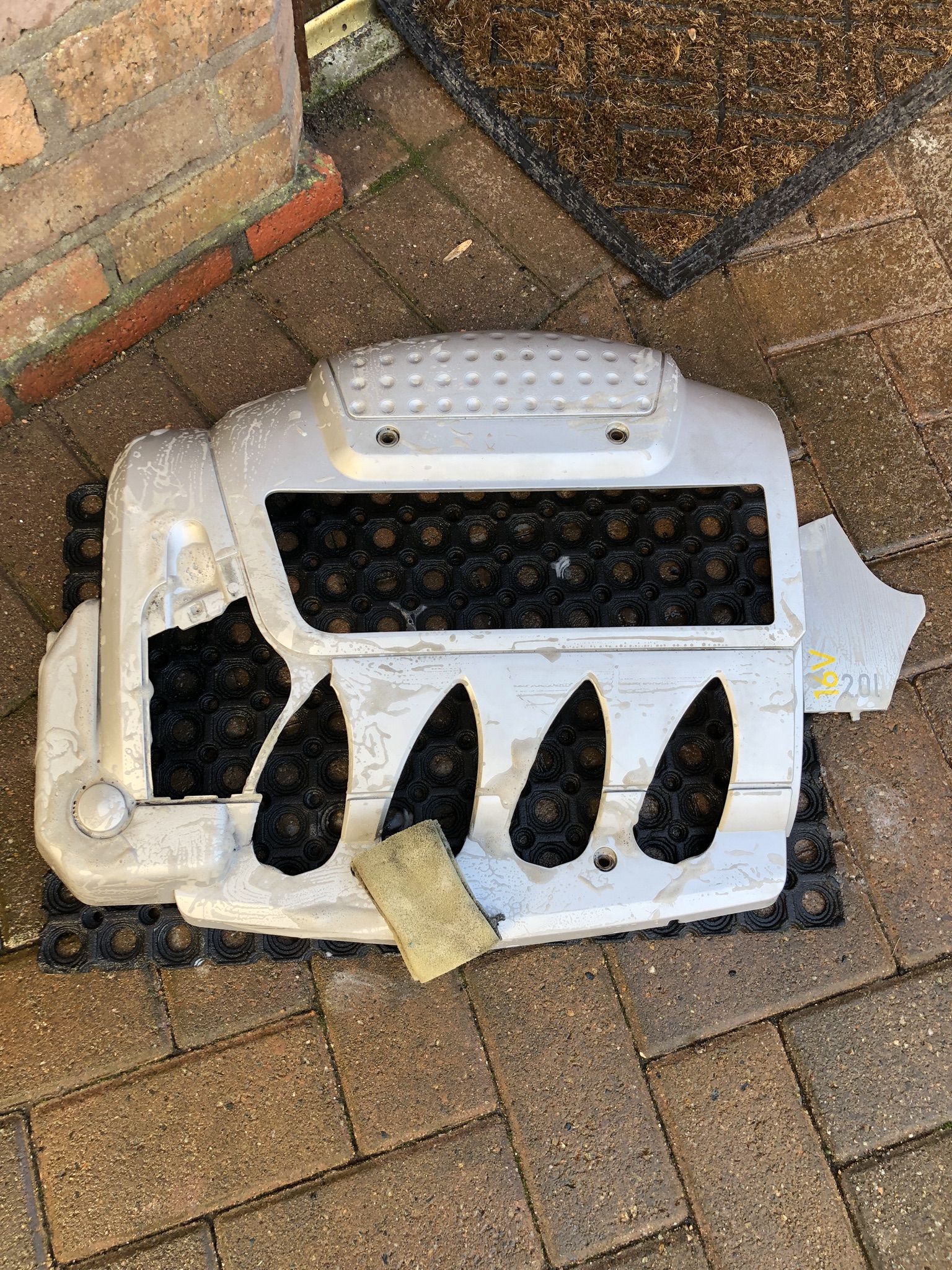

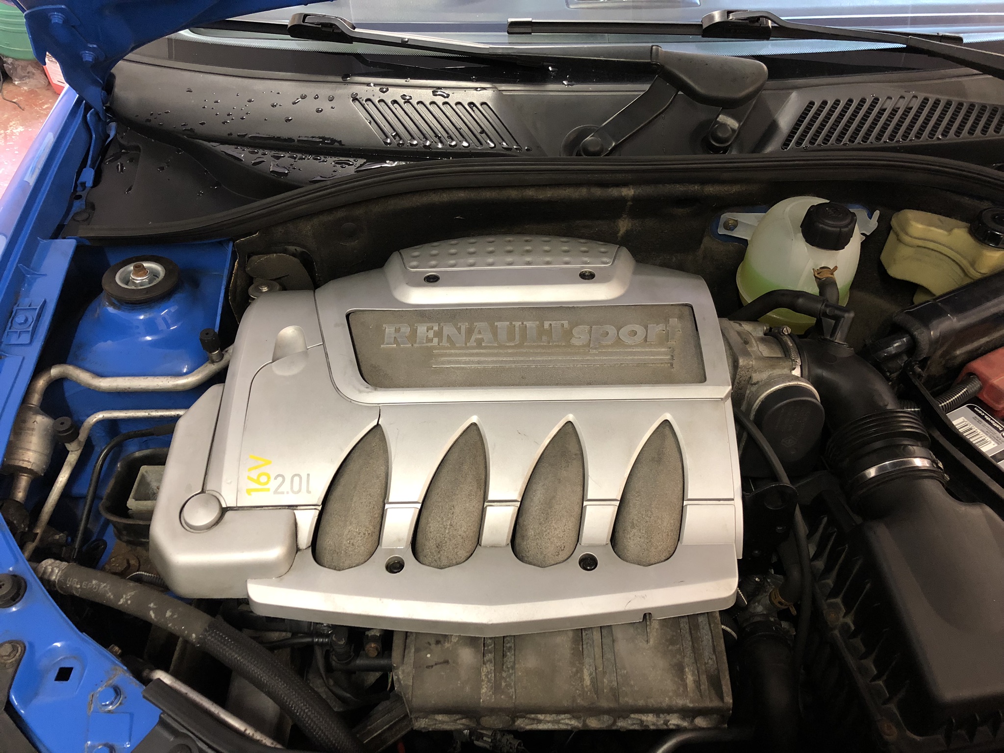

I removed my engine cover a few weeks ago, so decided to refit it again, but first I thought I would give it a clean
Fitted it
On my previous update, I didn't post a picture of the new steering wheel fitted, so I took a photo of it

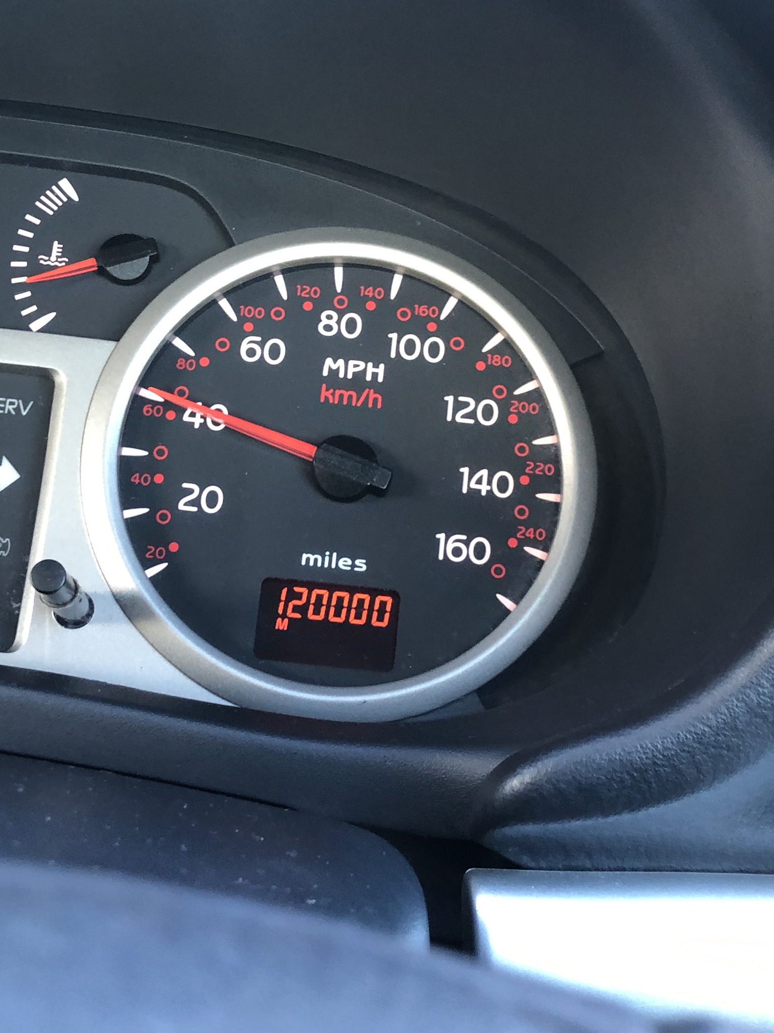

And she turned 120k today!

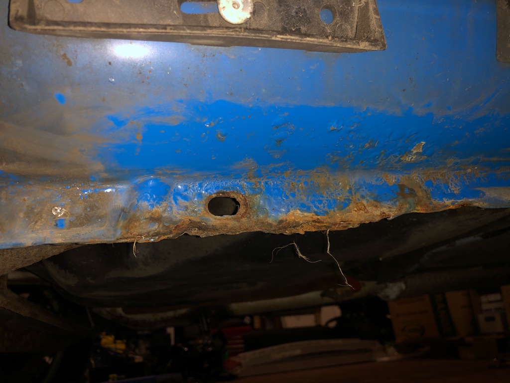

In the last few months the car hasn’t done much but about 3 months ago I found myself whipping the rear door cards off to find some rust. So I treated that. It was mostly surface with the actual sills still solid.
Problem was blocked drains. I cleared them, sanded the loose corrosion and treated it to some bilt hamber hydrate 80 and a some grey underseal. I can’t find the photos of this but it looks much better now.

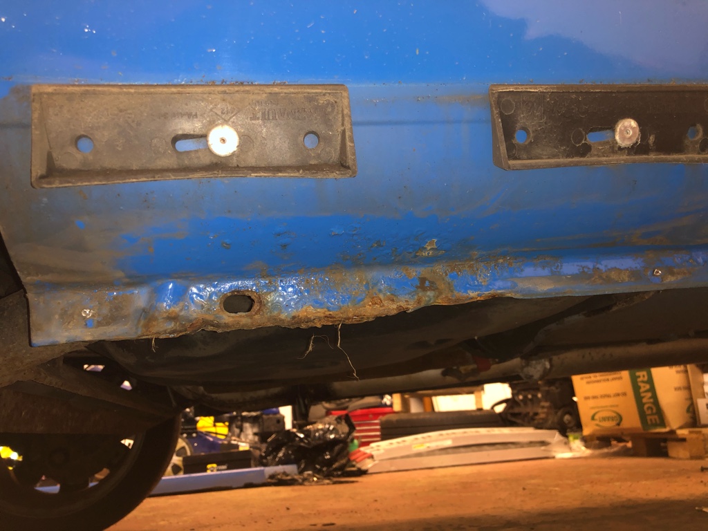

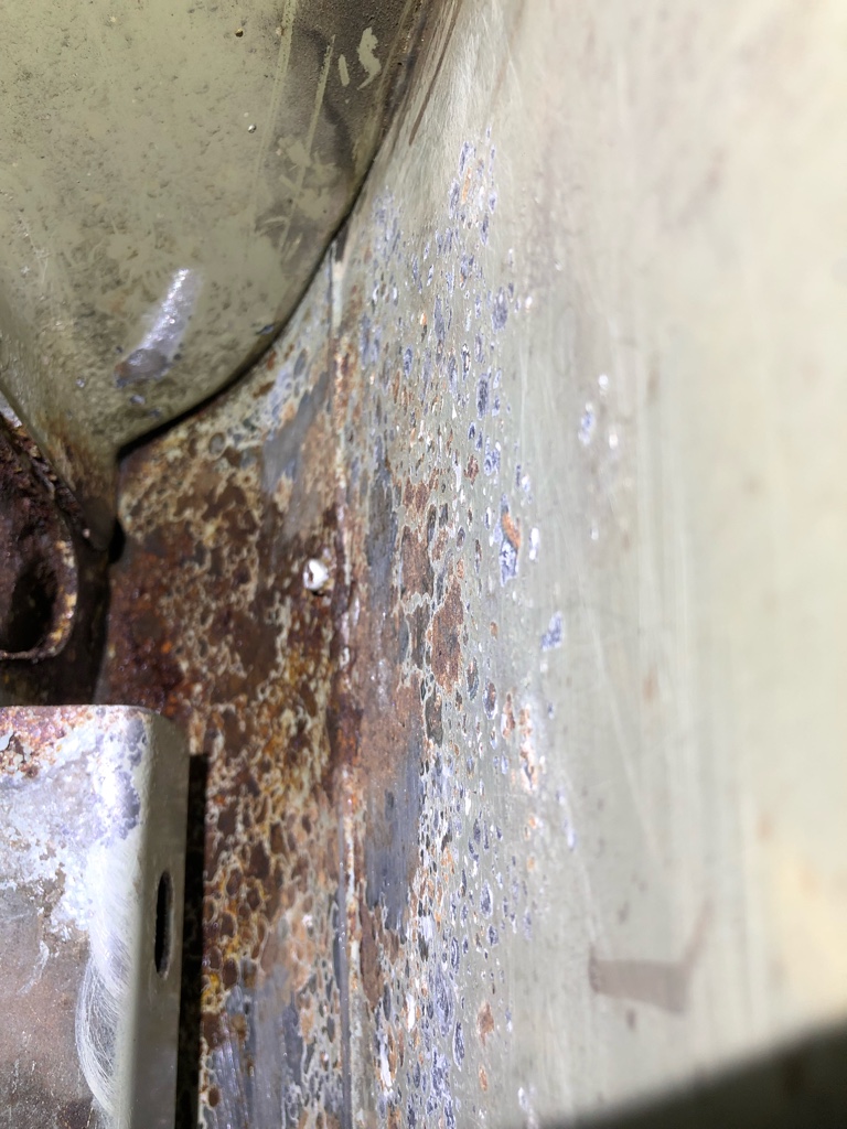

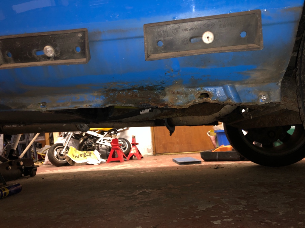

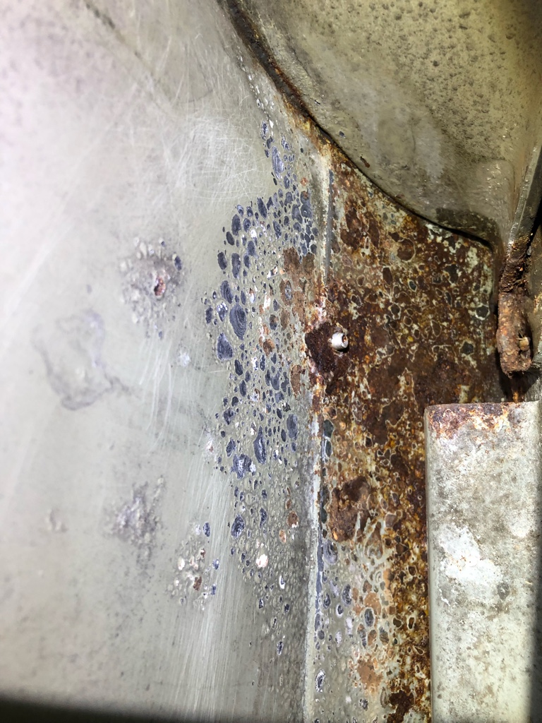

Today I got the car back into the the garage to start some work that’s been long overdue. We removed the side skirts and I was curious to see what the condition was like behind.
Here are the results
It needs washed as some of this is dirt but you can see there is some blistering starting in the paint. I burst some of them and there is clean non rusted metal behind. Both sills seem to be solid enough. Next step is to remove those blisters and treat to some hydrate 80 before the car goes to paint.

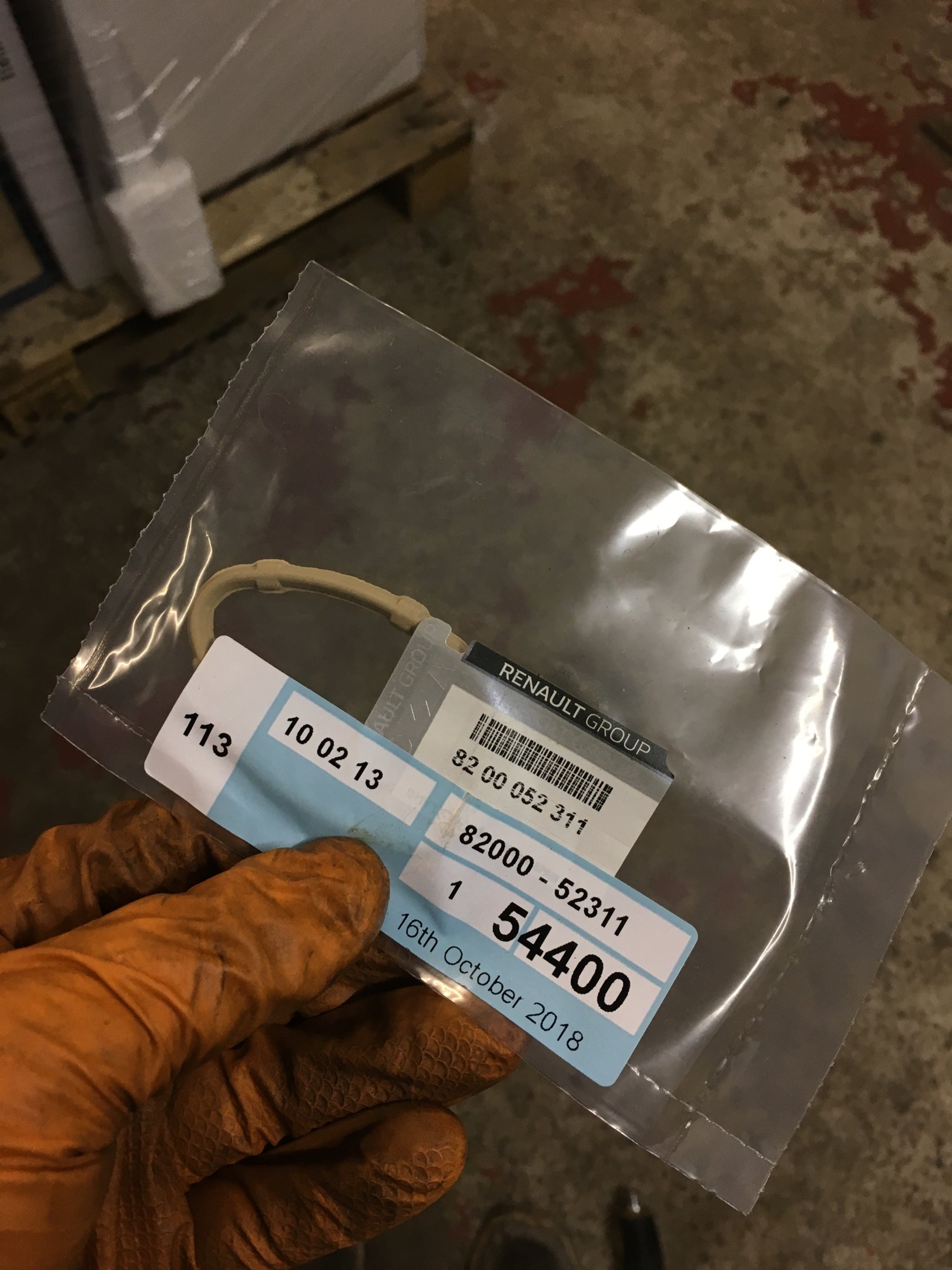

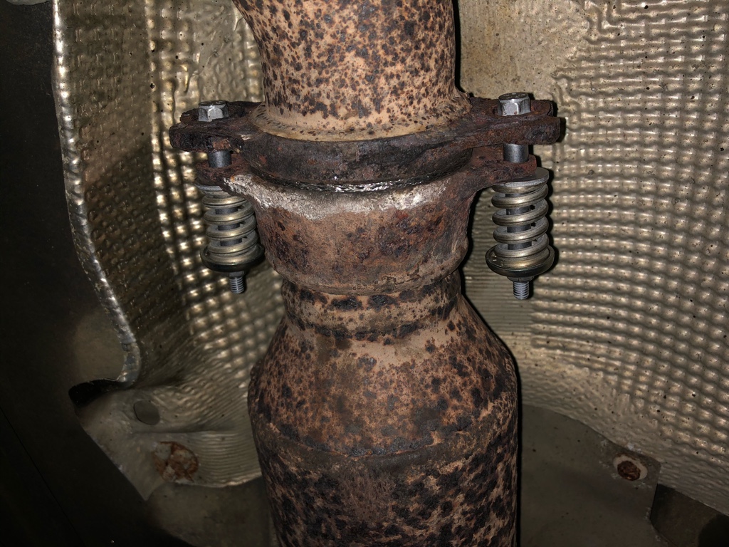

The car had needed a fire ring at the cat for some time as it was blowing slightly. I ordered the kit from Renault about 12 weeks ago and today it was finally fitted
