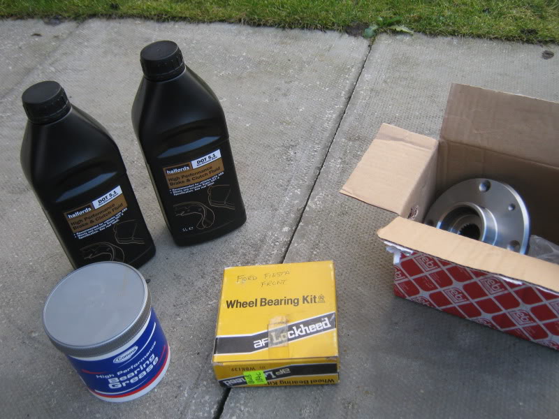

well bearing and hub flange changed, the bearing literally came out in bits everywhere when i pulled it off the driveshaft lol, hammered the old races out the hub, went to knock the new ones in and they went in wayyyy to easy, turned out they are i think mk3 bearing, thanks ebay...
so rang around luckily found a place that had a mk2 one in stock, got that, all fitted back together, camber adjusted/set to max again, tracking altered to suit both sides towing out a tad, all is well no more humming/vibrating from the N/S/F
brakes bled as normal, lots of air in as usual after a trackday, i just bled them as normal and just topped the reservoir up with dot 5.1

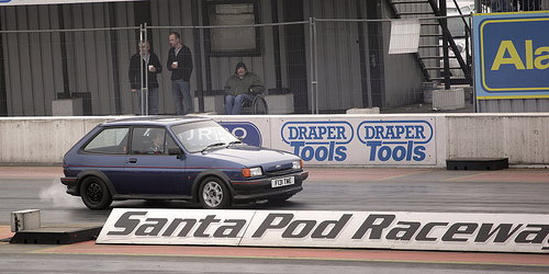

good weekend at POD at fast show apart from the exiting, good to see some old faces!
my best run was a 13.8 @ 104mph
i done my 4 runs straight away to get them out the way, kinda wish i didnt now as the sun didnt come out till dinner time which meant the track was quite slippery in the morning even with a small burnout to get some temp into the tyres, my reaction time was 0.4 seconds slower than on my last best run last time, i missed afew gears here and there, was still fun tho beating an e36 m3, an old scooby and a swift with a 15.8 haha

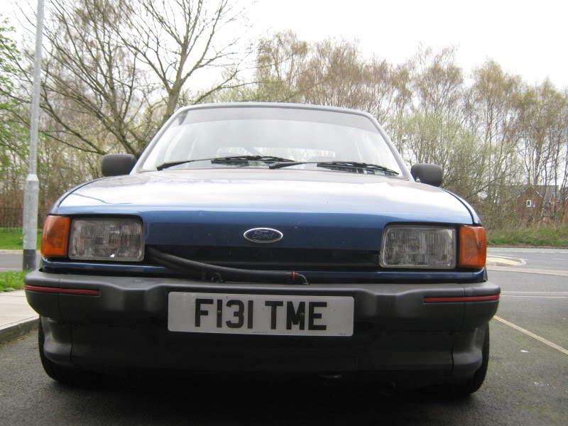

bonnet before (low on the right hand side as you look at it) -
how it is now, much better -

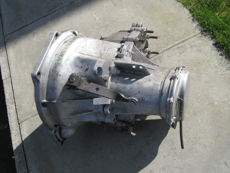

Picked up a new box earlier, S2 RST -
not sure on when ill be fitting it yet, all down to when a mate can give me a lift and weather dependant obv, never changed a gearbox with the engine in situ before, looking forward to giving it ago!

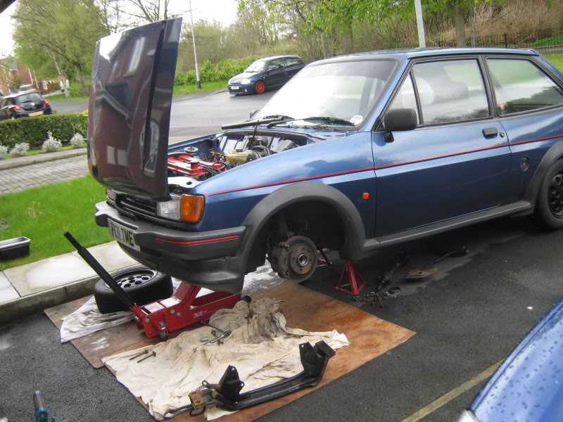

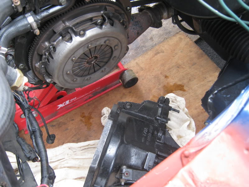

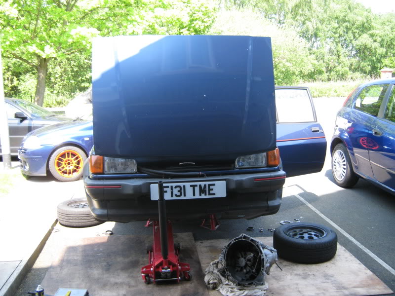

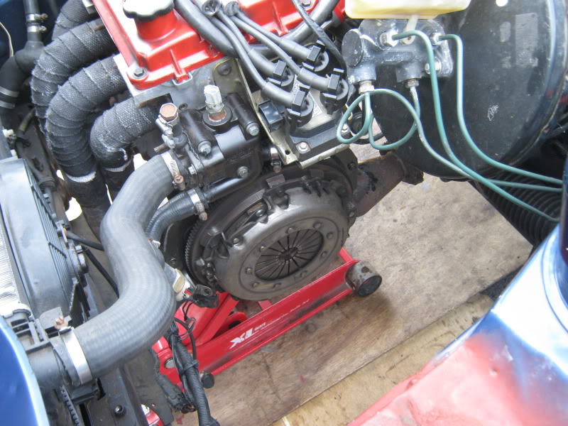

thought id make it a productive weekend... dodging the rain, cradle off, driveshafts etc all removed, engine proped up ready to remove the gearbox -
10mins later -
all back together, after alot of messing, cleaning up oil, took ages for us to sort the clutch cable, i have a working car again -

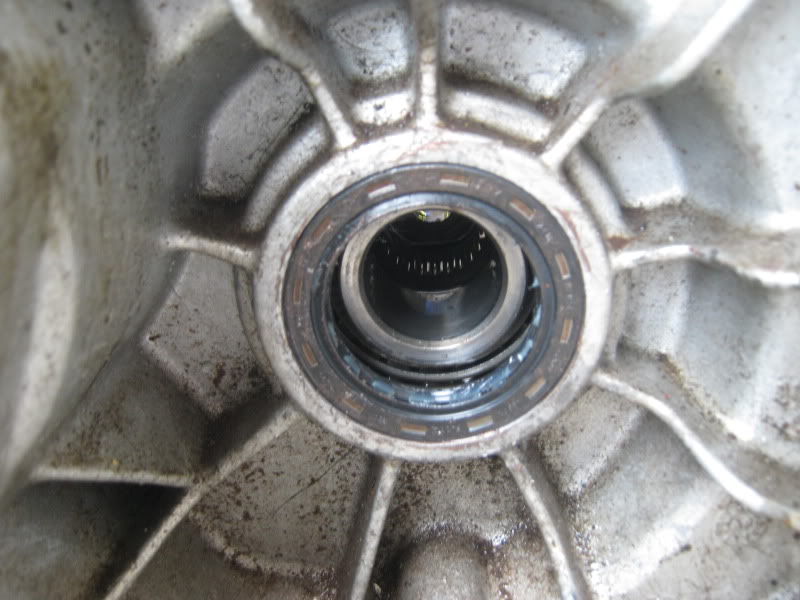

New diff seals fitted, waiting to be pushed all the way in by the driveshafts -
all back together and filled up with proper gearbox oil this time -

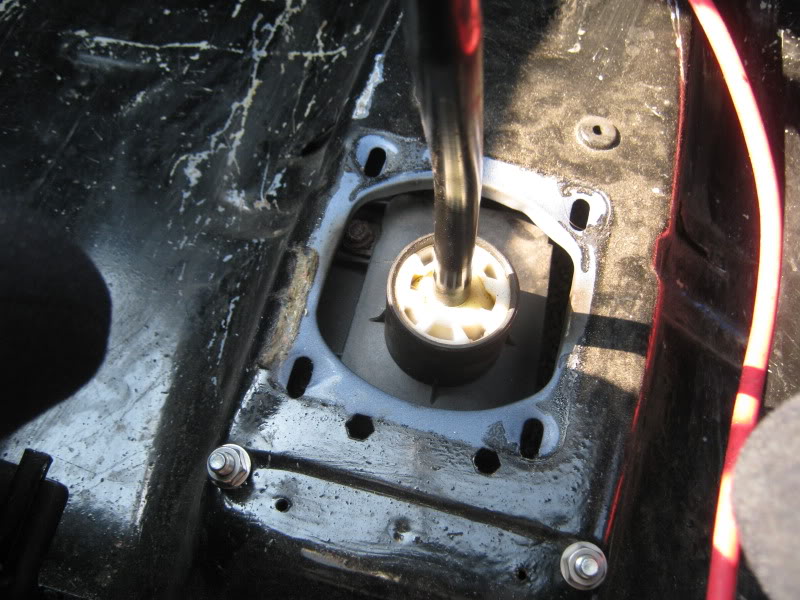

fitted the ZS linkage, turned out the bush has gone in neutral so it doesnt return to the central position after/when changing gear, so now need another one, sigh lol, altho some people are saying i need a return spring for it as theyre built into the ib5 gearboxs on zs' where as they arnt on bc gearboxs/xr2s.
picture of how the ZS linkage fits -

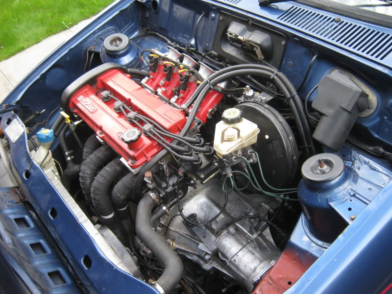

new vs old catch tank -

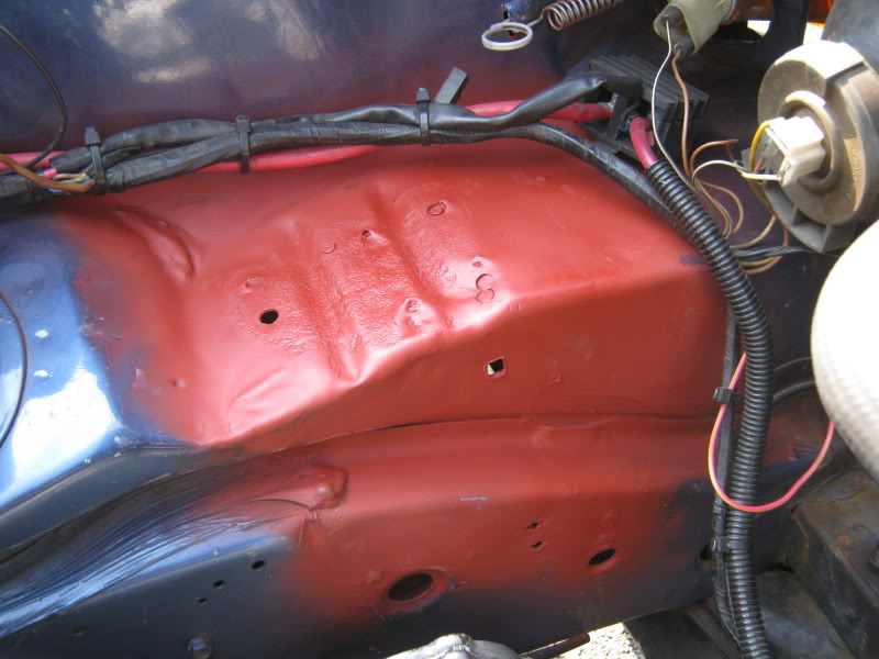

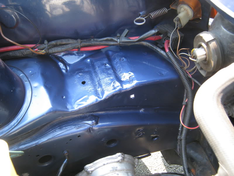

re sanded and primered the inner wing -
painted and laquered itll do for now, halfords tasman blue is a bloody good match -

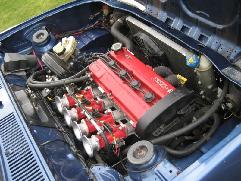

trumpets and inside the bodies need a bloody good clean as i havnt touched them since they were fitted over 18mths ago!

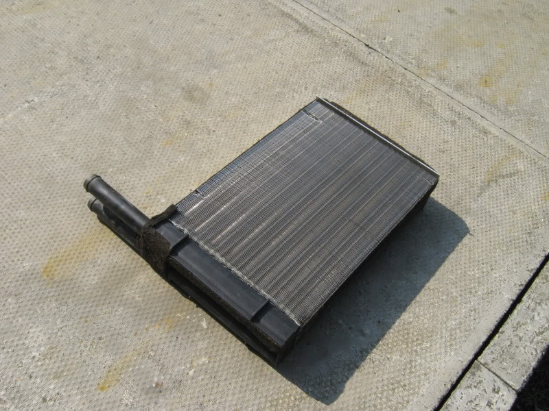

genuine used heater matrix -
will fit that when i get time to pick up the new metal clips from Ford which i ordered earlier as the plastic clips are known/have snapped when i removed the old matirx.

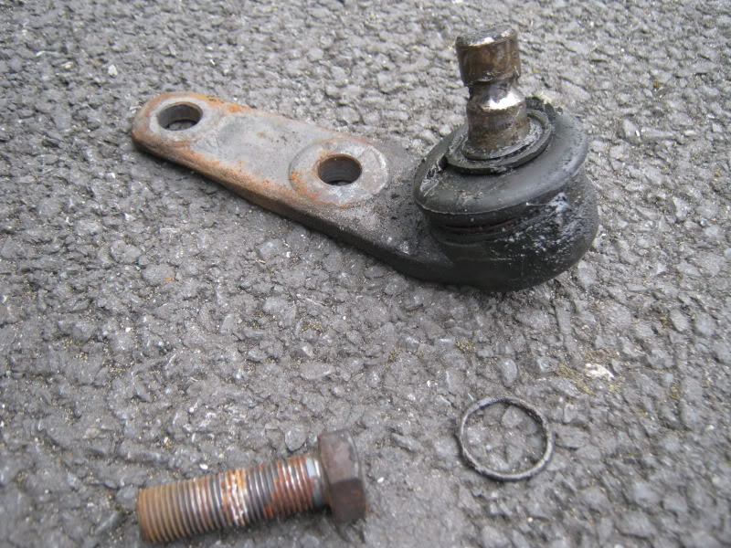

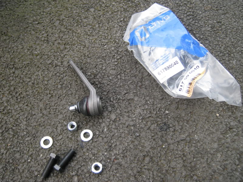

also ordered new ball joints from Euro Car Parts as both gaitors are split from the amount of times ive messed about with them now haha, they should be here towards the end of the week!
new ball joints -
old one, both had split gaitors like this -

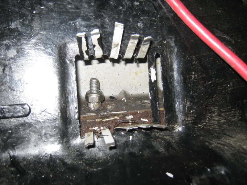

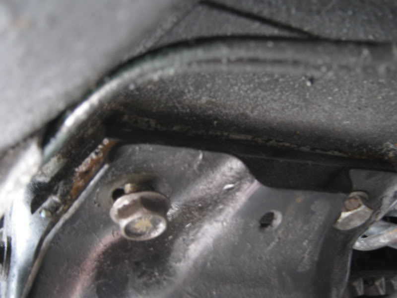

then did a spanner check on everything as i drove the car 50 odd miles sunday since refitting the gearbox, i thought something was loose... lol -
so ive put a new bolt in and cut the vent out in the floor and put a nyloc nut on it, strong as anything now -

New matrix is about 30mm wider than the xr2 one so ive been sold a wrong one, mare!

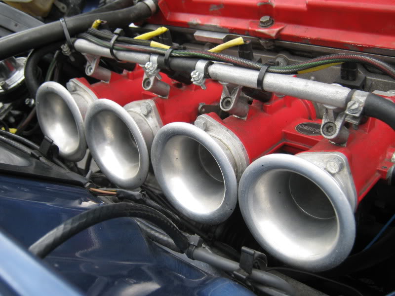

cleaned trumpets with white spirit -

got a new/correct size heater matrix which ill fit once i get back from Le Mans!
Started first time easy the other day after being sat for over 2 weeks since that thrash/run out.
fitted the heater matrix yesturday now all is toasty in there again!

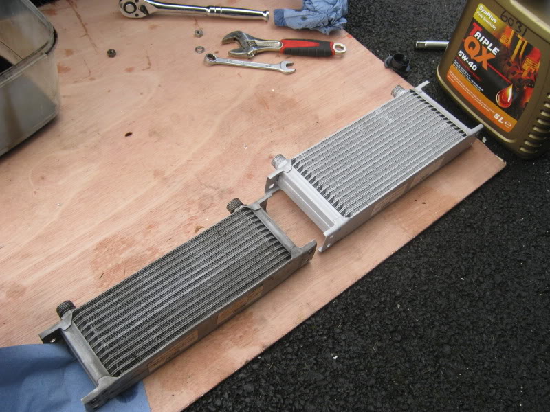

also ive ordered a Mocal 16 row oil cooler off ebay, that should see my oil temp stay as it was in november at oulton with the standard cams in hopefully as it reaches 120degrees slightly quicker with the cams in/it done at oulton in february!

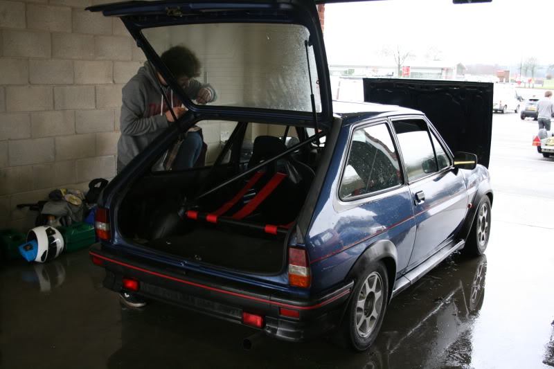

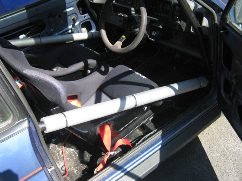

just finished bolting the seats to the floor, the plan was to weld in some proper bars but i can just get away with reaching the clutch with them bolted directly to the floor so ive done that using M10 Bolts,Nyloc nuts and Huge 4mm thick 40mm washers, and had my mate weld me up some spacers for the back of the sidemounts as the floor pan drops, all in all MILES more sturdy wish i done them ages ago now!
also booked the next trackday for in 3 weeks at oulton park, aahhhhhhhhh cant wait already!!
