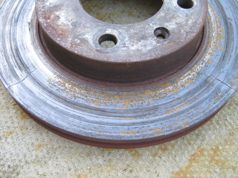

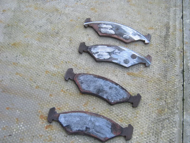

so, old DS2500 pads, lol -
and the nearside disc from where the 2 pads are down to metal came from, 2 cracks -
the offside disc wasnt cracked at all, dont understand how the nearside is braking more than the offside... down to the bleeding maybe?.. as they didnt unevenly wear last time/last year when i changed them...

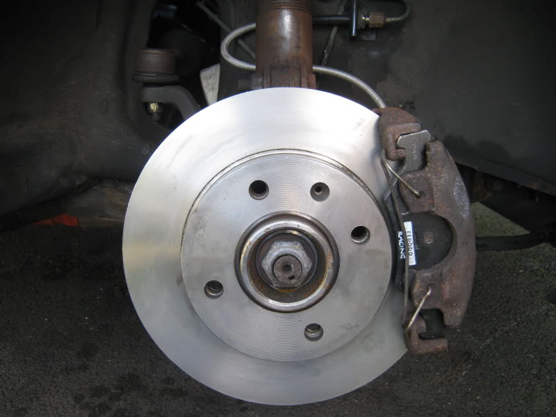

new Brembo HC discs and this time Ferodo DS300 pads fitted -
brakes are mega now altho they need bleeding as its still pulling to the left/nearside and i dont want that uneven wear again, so just going to see how it is after re-bleeding

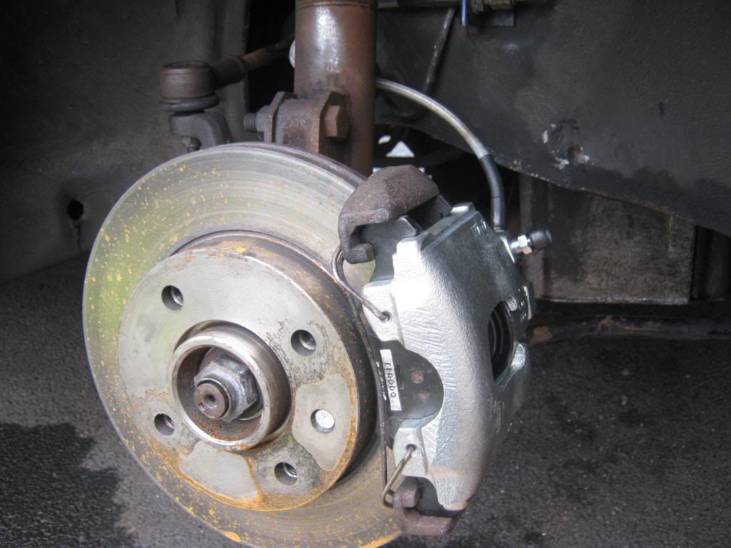

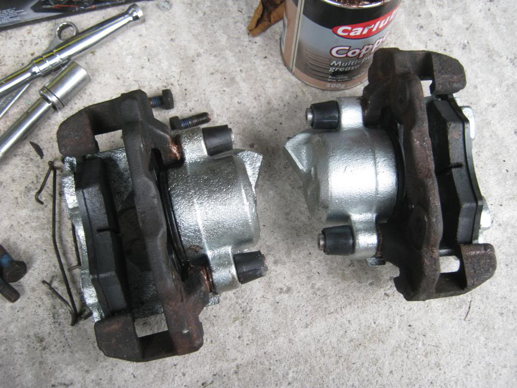

bled the brakes up and the car was pulling to the left front slightly/sign of why the old left front brakes were more worn than the offside, so i got new refurbed calipers 2 weeks ago, then found out they were wrong, one was meant for a solid disc and both i couldnt fit the retaining springs which grab the carrier and caliper together, so after alot of going back and too to Andrew Page last week i finally got these on friday, i planned on going Santa POD for RWYB on saturday but i was kinda pissed off and it was forecast 50/50 rain/sun for saturday so didnt fancy the 6hr round trip when there wasnt good weather guarenteed (i know this is the UK and we're never guarenteed good weather but still)...
so today ive just fitted them -
carriers and pads fitted -
and fitted -
so finallly have the correct calipers both fitted and waiting for a mate to come round and help me bleed them up!

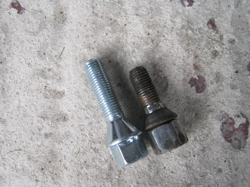

also got 8 longer wheel bolts for the fronts off ebay the other day -
new 35mm long wheel bolt vs old -
reason getting these is i dont trust standard length wheels bolts with 5mm spacers on track, i used to use 3mm spacers but as you can see above on the shocks where its shiny my tyres have been rubbing on track so just got the longer bolts for piece of mind

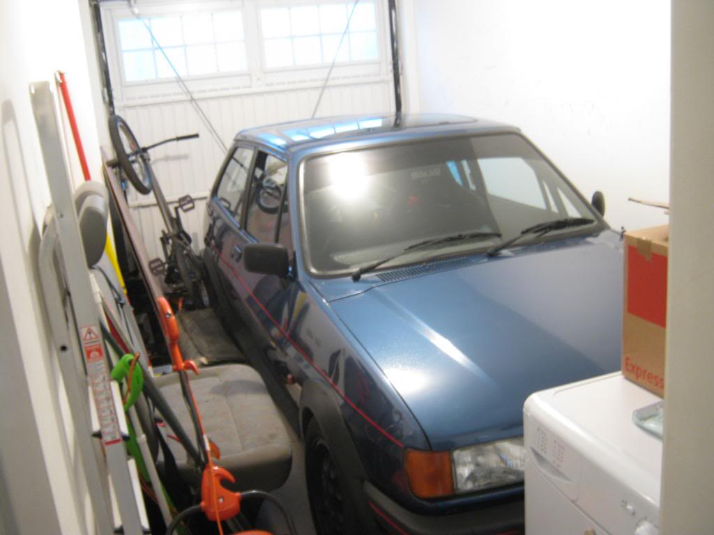

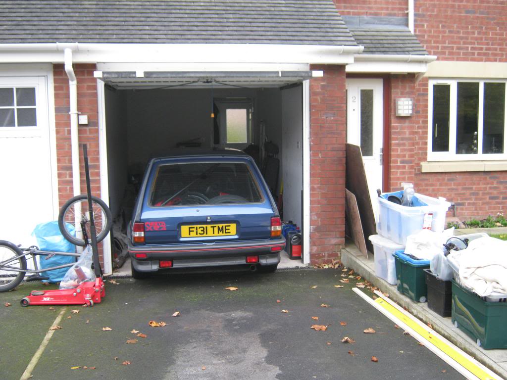

today i gave it its final wash of the year -
then did this for the first time since owning it -
decided to take it off the road till march, use the money on upgrading my van rather than insurance and tax on a car i'l hardly ever drive and not doing trackdays anytime soon, plus keep it out the bad weather for the winter as its not getting any younger haha

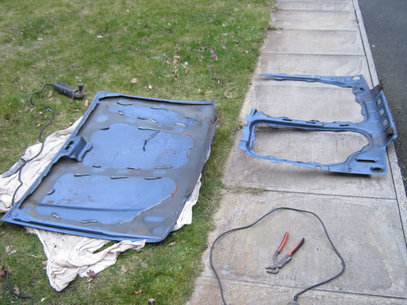

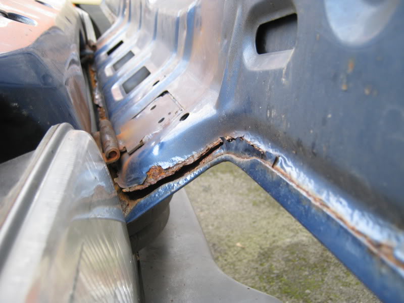

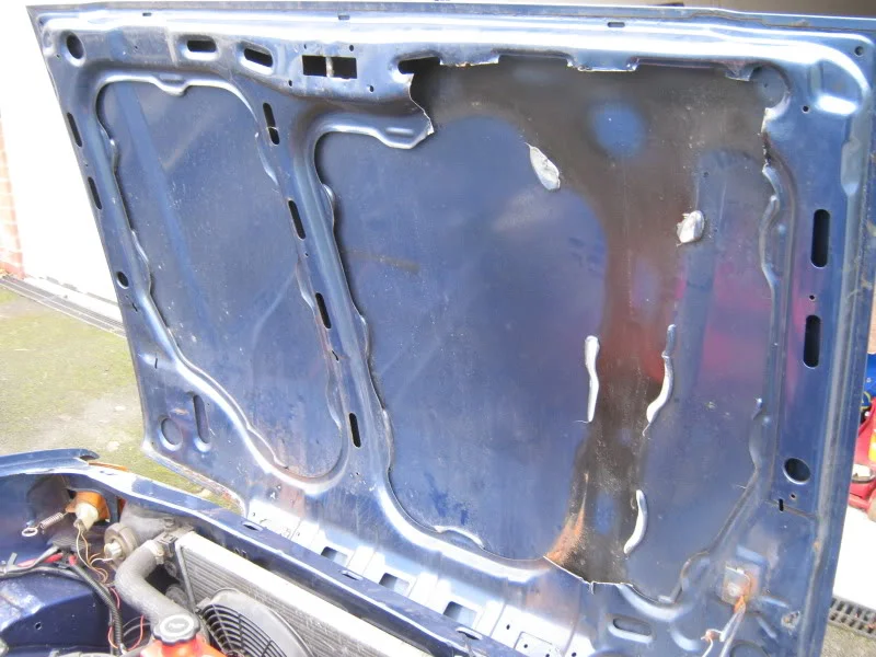

got bored so thought id try lightening the bonnet a tad, noticed this as i was doing it -
so left it here -

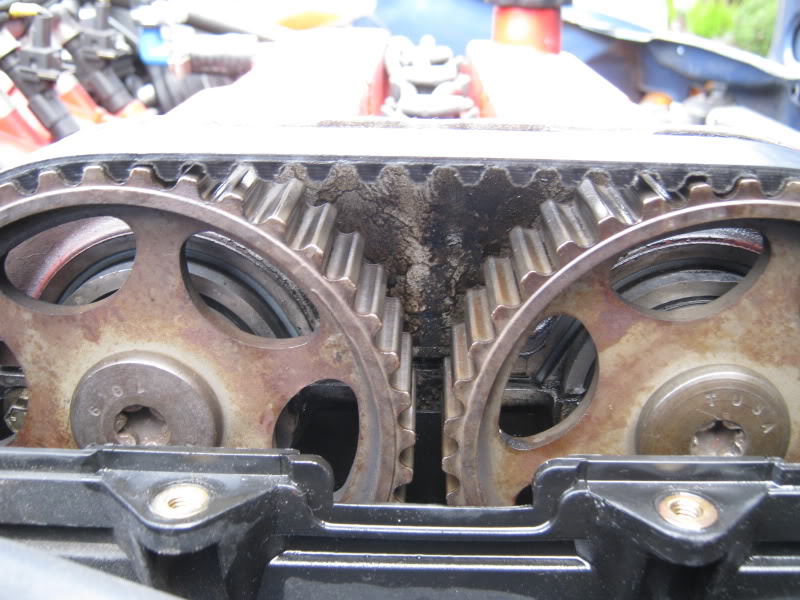

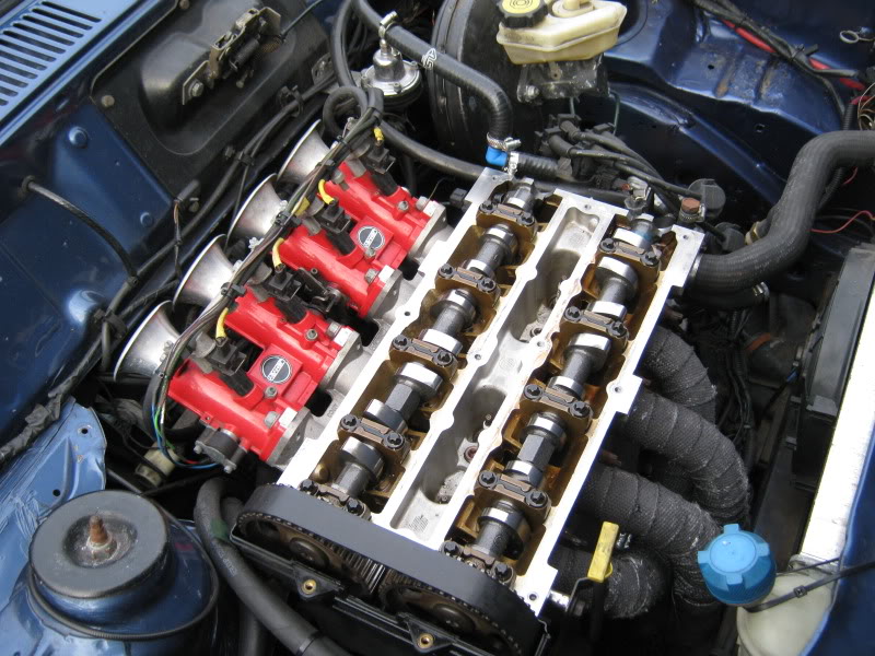

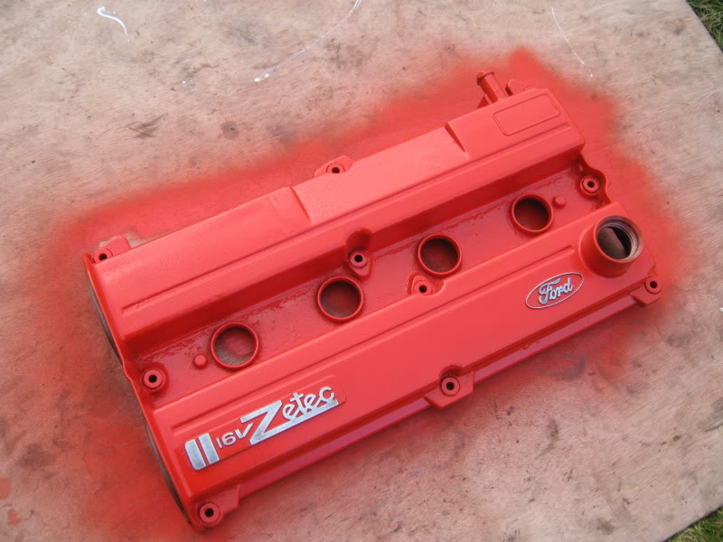

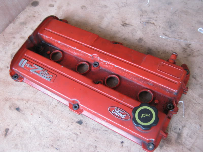

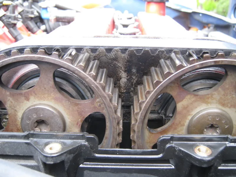

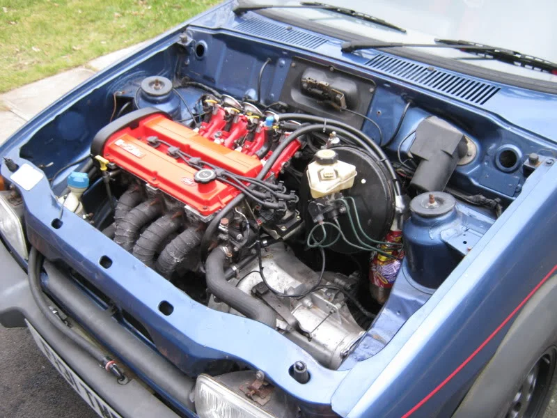

also thought id check out where the oil on my cambelt cover is coming from, its been leaking since oulton last july so thought it was about time i checked it out -
its either the rocker cover gasket which looks the favourite or the cam seals, so ive ordered a new rocker cover gasket and removed the rocker cover to give it a freshen up, also cleaned up the bodies -

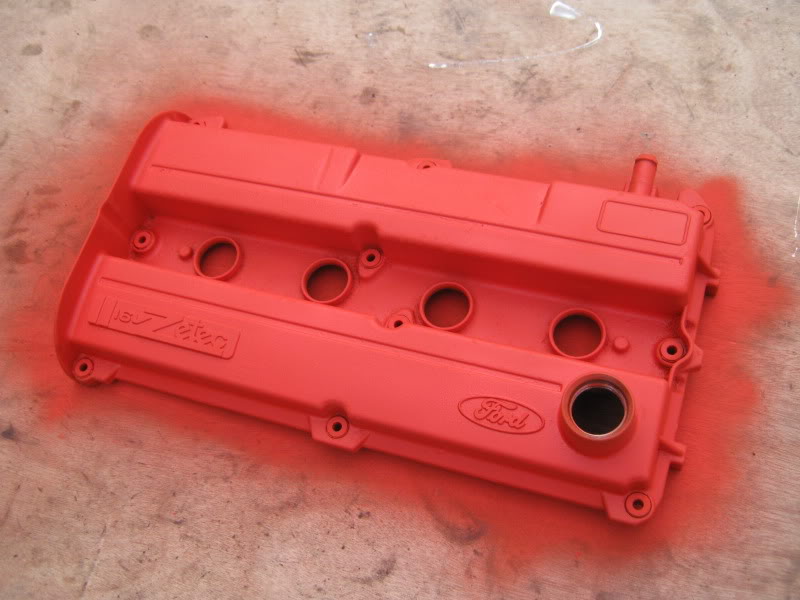

rocker cover before/progress/finished -
the paint reacted abit but it still looks miles better than it did beforehand seems as the last time i painted it was when it was first fitted onto the 1800 zetec 2 1/2 years ago haha

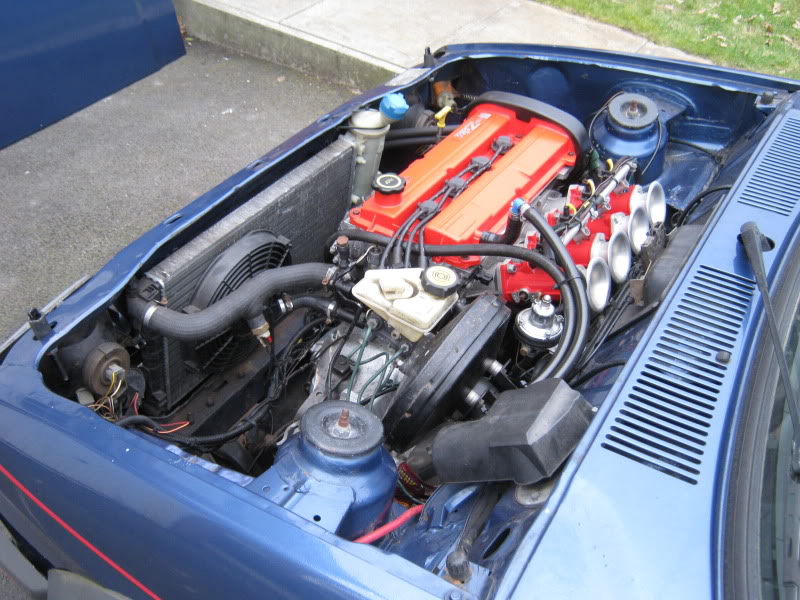

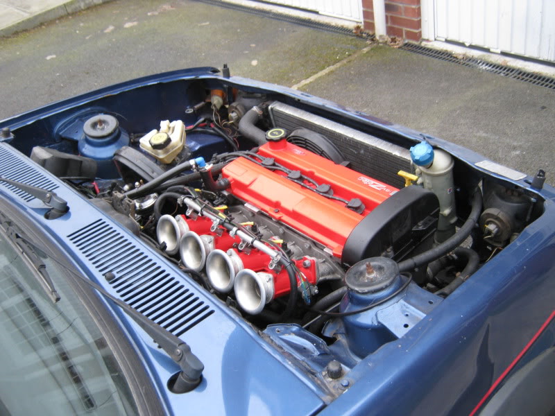

Rocker cover gasket done, will take a pic when i get the bonnet off which at the minute im waiting for a mate to come help/hold it while i undo the 2 remaining bolts, sh!t design, doesnt help with my oil cooler hoses in the way haha..
im removing the bonnet as ive got some bonnet pins so I can remove the rest of the innerskin and make the bonnet removeble for easy maintainence and a possible gearbox change in the next few months as I want a slightly shorter ratio one in a Escort S1 rst box

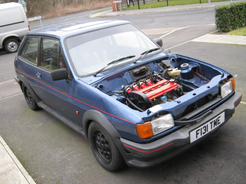

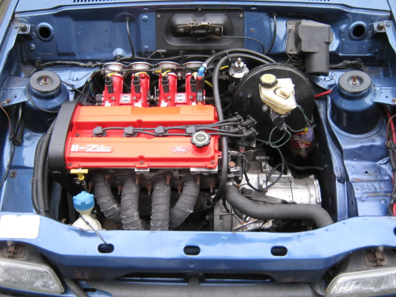

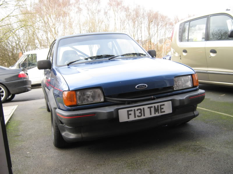

so, rest of the innerskin removed -

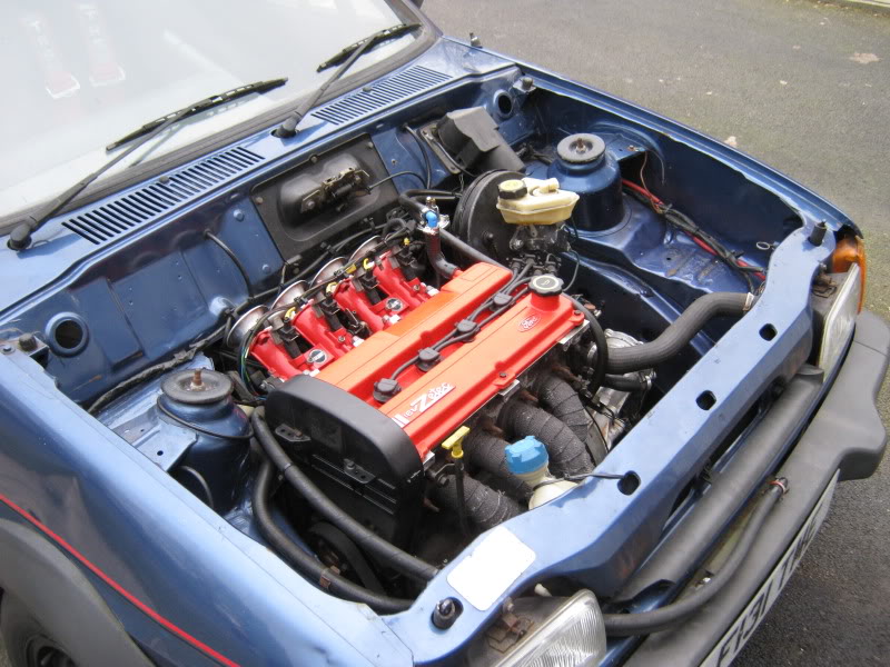

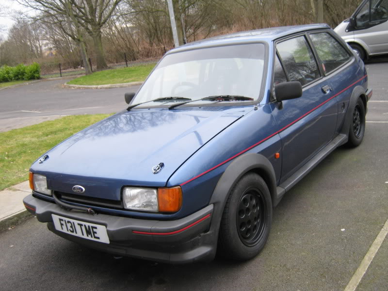

few pics without the bonnet on since doing the rocker cover gasket and painting the rocker cover again -
Pins fitted -
going to insure and tax in a week or two!
