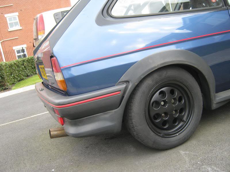

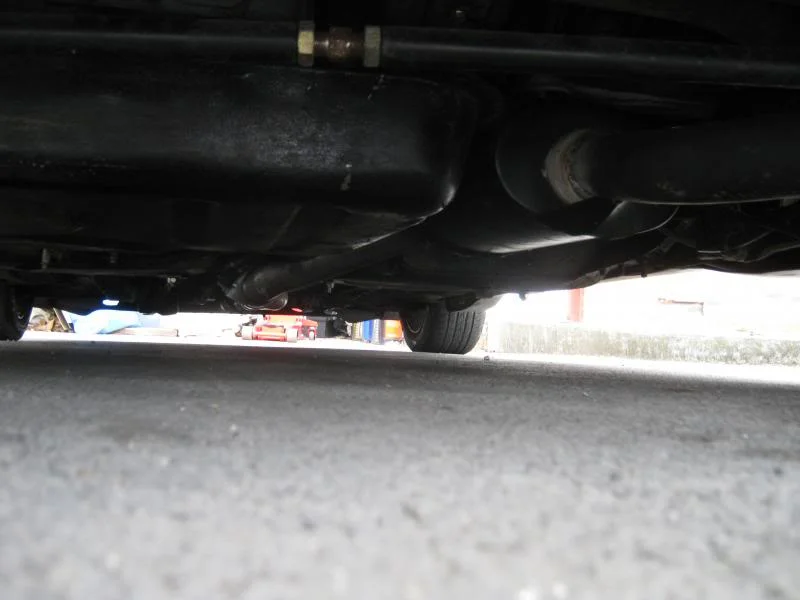

i've bought a 2.25''-2.5'' reducer and 500mm of 2.5'' tube for the exhaust for a new longer and slightly larger exhaust tip as i dont like the way the tip is short of the bumper on the Ashley Challenge System plus i'd like it a tad larger, they arrived yesturday so will be sorting that over the next few days!
  JDM Dc2
done 100 miles in the car sunday to bed the car back in after not driving it for 5 months, went buxton raceway watching drifting then went over the cat n fiddle for a hoon on the way home with a mate in his 8v mk2 gti, quick pic from when we were having a break inbetween the average speed cameras haha -

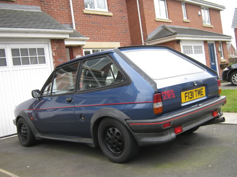

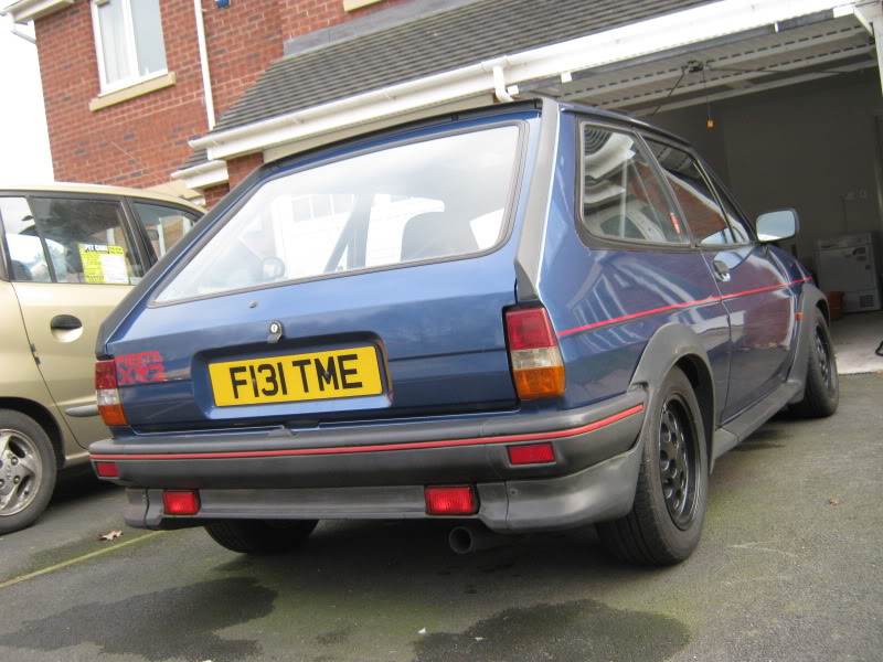

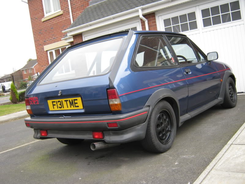

exhaust tip before -
tip now -
much better! sounds exactly the same which i was abit suprised at

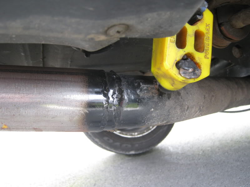

also put a spot weld on the centre section sleeve joint instead of making up a 3rd mount!

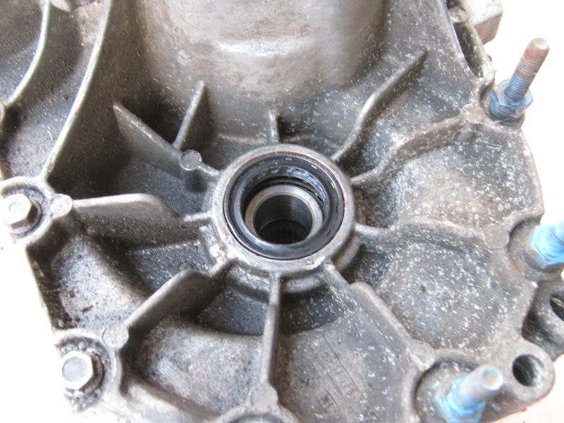

im going to get new diff seals from ford this week then get it fitted a.s.a.p.

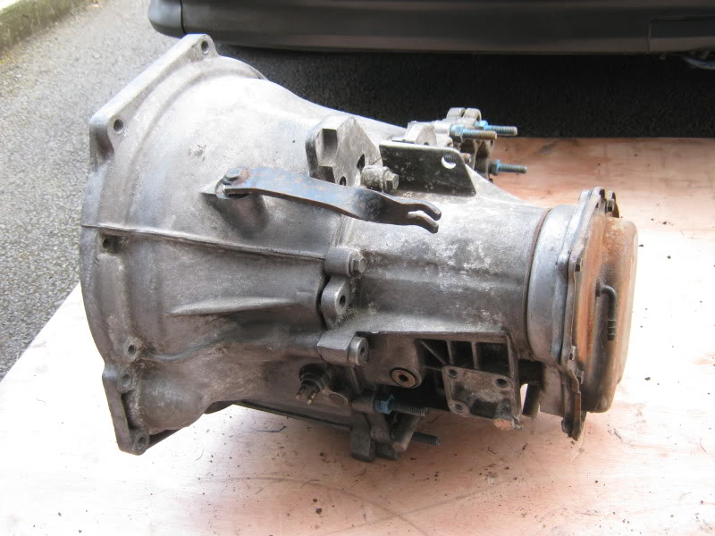

the S1 RST box arrived yesterday!

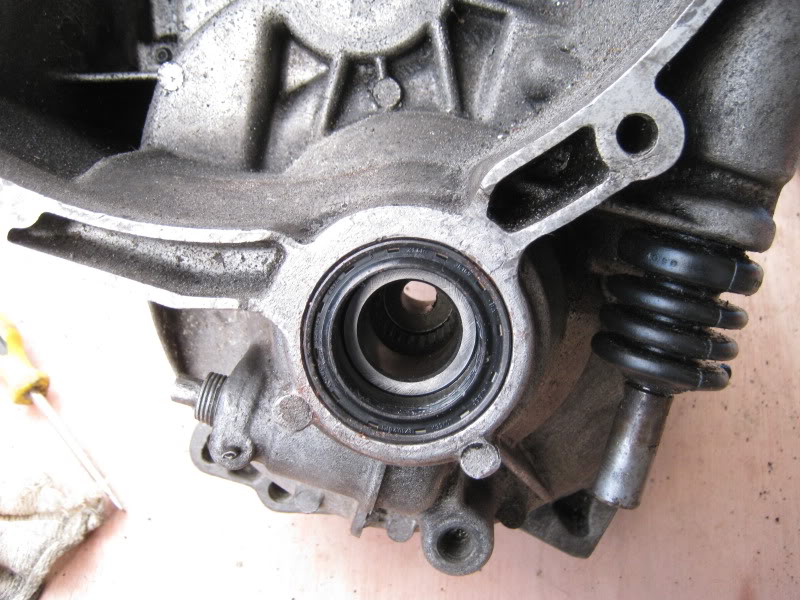

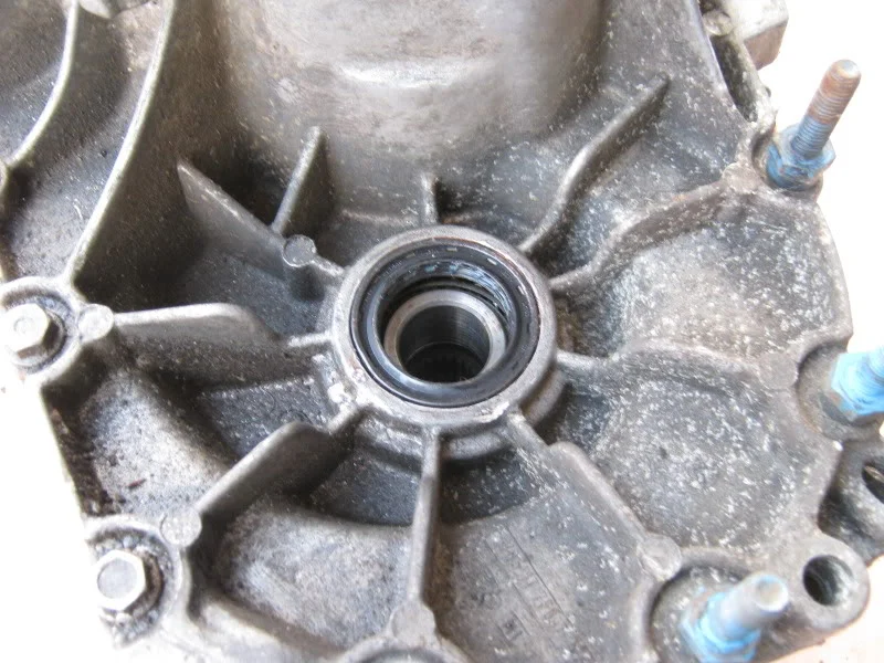

new diff seals fitted -

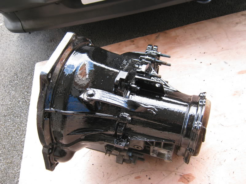

went over the box with a wire brush and a rag -
wasn't that dirty tbh just the usual bit of grime underneath from when it would've been removed previously, then gave it a lick of hammerite -

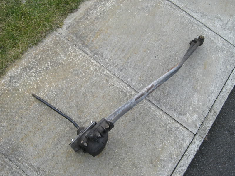

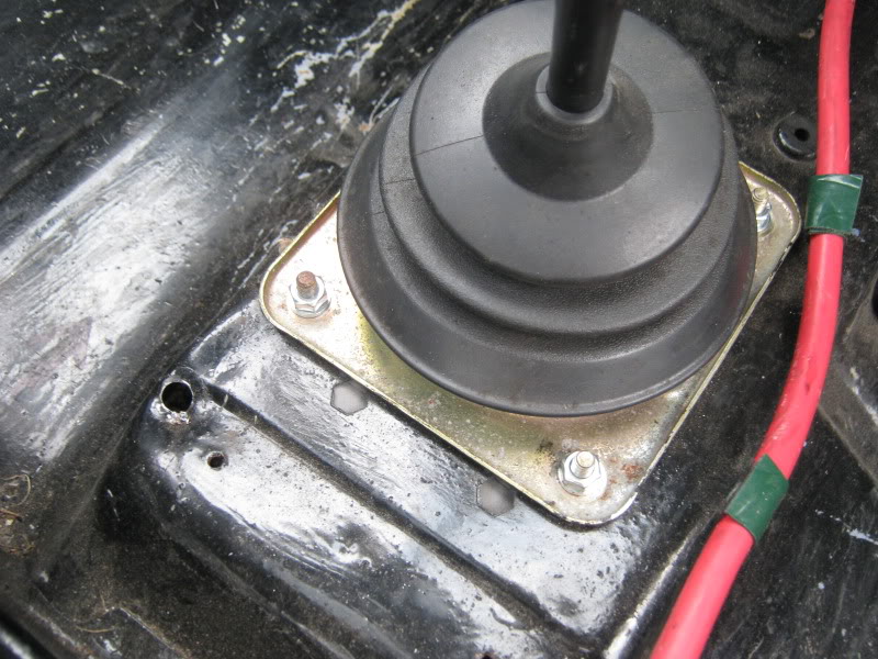

got this Escort mk3/S1 RST linkage on my way home from work from G's Escorts in Widnes -
bought this as a guess to hope it'd fit, I didn't have much hope and was expecting to have to change the rods after afew opinions... but I didn't all I did was bolt it up and it lined up perfectly -
happy times, the only thing that was different to the fiesta linkages ive had is the stabiliser bar is quite straight/doesn't dip down away from the floor pan so it's rather closer -
as you can see ive had to put the rubber fuel hose over the linkage and sometime probably this weekend ill be routing that on the other side of the tunnel if I can find some P-clips as I cant remember where I put them, ive just got away with the metal fuel hose by bending that a tad
anyways the linkage... the box feels 1000x better now with this even with the epic throw it has just like the old standard xr2 linkage I had before fitting the Zetec S/Puma linkage, the only downside is it kinda needs new bushes inside, just abit of bad luck I suppose as he could've picked out a better linkage altho I suppose Mk3 escort parts are all ~30years old now

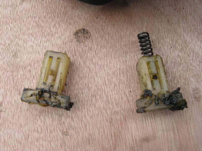

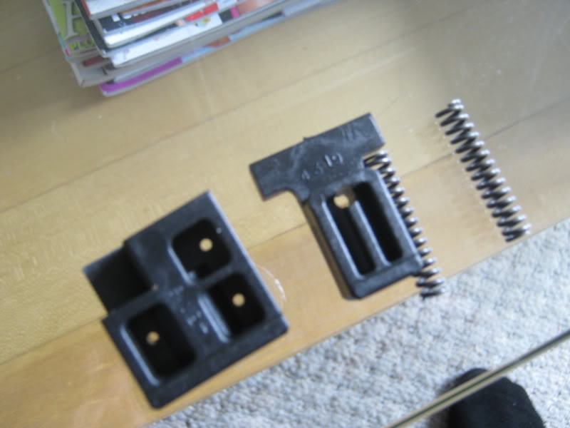

ordered new bushes for the gear linkage, they came yesterday, so today I removed the linkage and separated it to see whats what -
removed the bushes and springs to find out they were different ffs -
so im just going to return or sell on the black new ones I got and I just put the linkage back together, grim n greasy job, got abit stressed whilst doing it/refitting the linkage as I bent the stabiliser bar abit too much so had to remove it all again, bent the stabiliser to save re-routing the rubber fuel hose you can see in the other pictures that was kinda trapped between the floorpan and the stabiliser bar

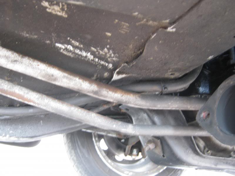

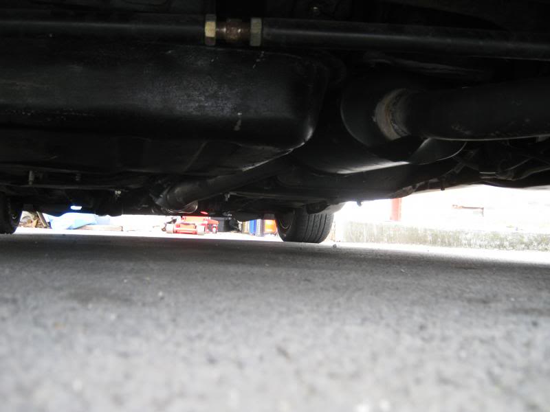

whilst the car was up I took this pic to show my mates welding work on the exhaust tip -

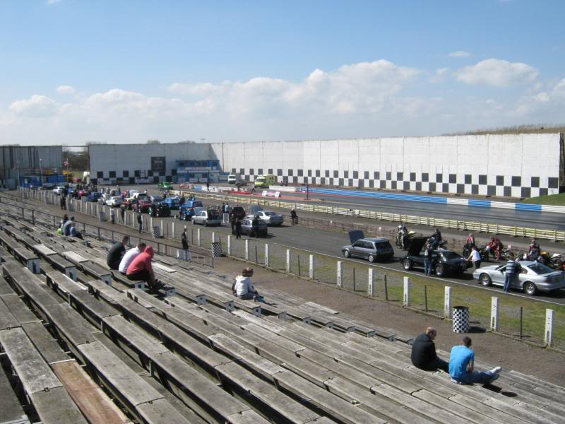

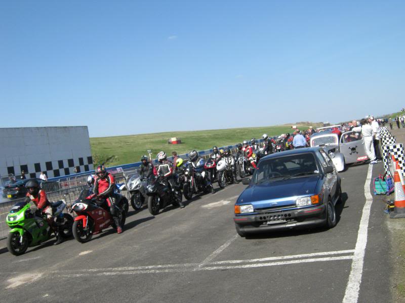

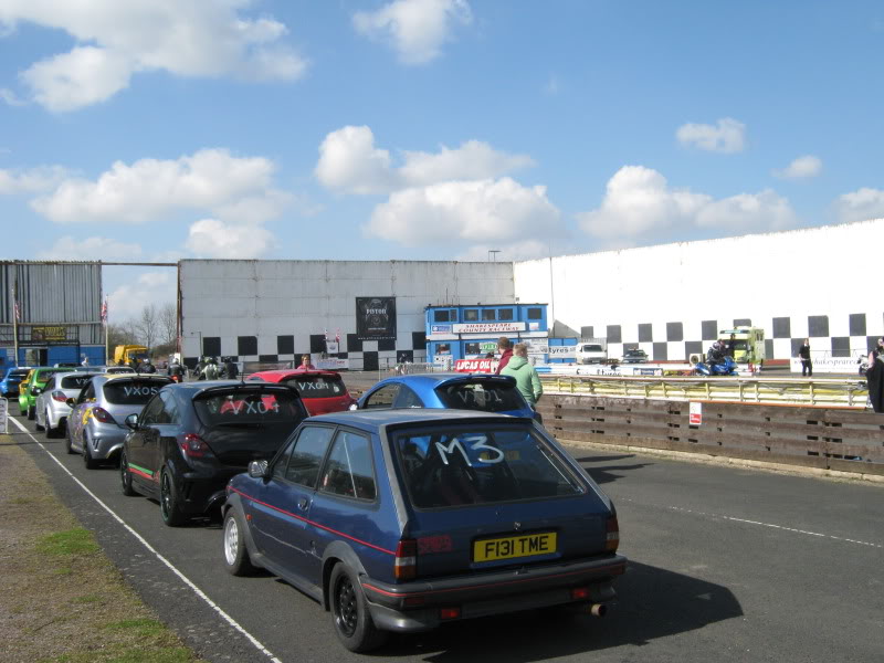

we decided to go to Shakespeare County Raceway instead of Santa POD, glad we did as it was half hour closer than POD and when we were queing we could watch everyone up the strip!
the day started abit grim as I drove onto my mates trailer my exhaust clamp on the centre section bashed the trailer and bent the exhaust back, after an inspection the manifold had bent... back to how it should be from when it drooped over 2 years ago when it was fully heatwrapped and bent with the heat, so now that's been pulled back the exhaust is sticking out over an inch further than it was and bashing the floor, so I need to cut off the spot weld on the centre joint and trim the centre section pipe down to suit...
anyways the times, I got 8 runs in, managed 5x 13.7's and 1x 13.8 and 2x 13.5's, the best being a 13.5 @ 104mph, so its an improvement over 18months ago to my last visit to POD so im happy.
bad thing is the LSD in the new gearbox, it was just spinning one wheel when attempting a burnout and with a sh!t handbrake my burnouts were a fail, im abit disappointed at the LSD but suppose you cant have it all, the gearbox is strong, I didn't miss any gears today with the new epically long throw escort linkage, I recon even with the old box with the great LSD the ratios were so long I couldn't stay in power band so I doubt I would've beat my 13.5 today anyways

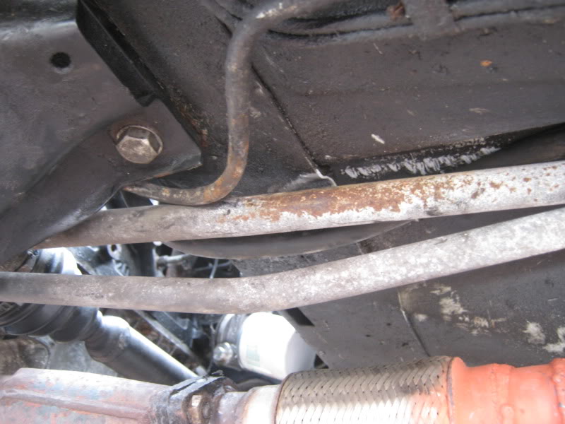

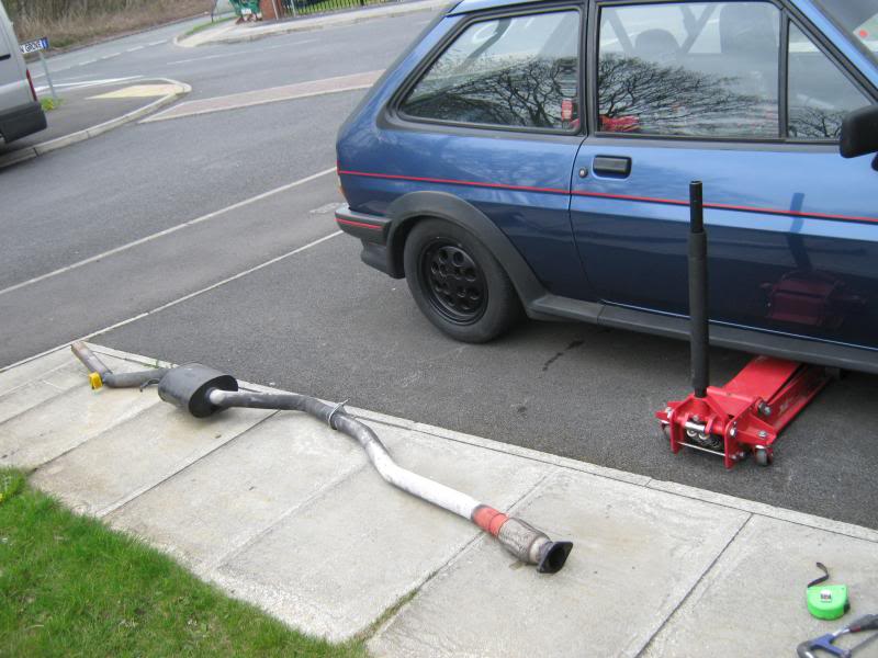

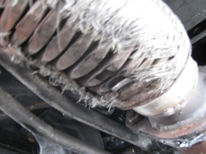

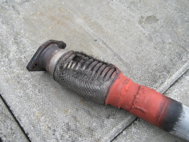

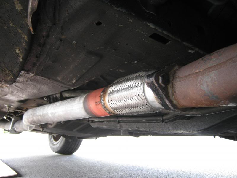

so, the exhaust... after bashing it against my mates trailer Saturday morning and it moving back the manifold, I went to remove the back box and set about chopping an inch of the centre section, before that I thought id check the manifold and flexi properly as I was under the car then I noticed a couple of holes in my flexi -
so, new flexi time after over 2 years from when it dragged on the floor all the way home from oulton park, exhaust removed -
better pic of the knackard old flexi -
so im going to take the centre section to pipewerx tomorrow as im off work and get them to weld in a new flexi and get them to shorten it an inch!

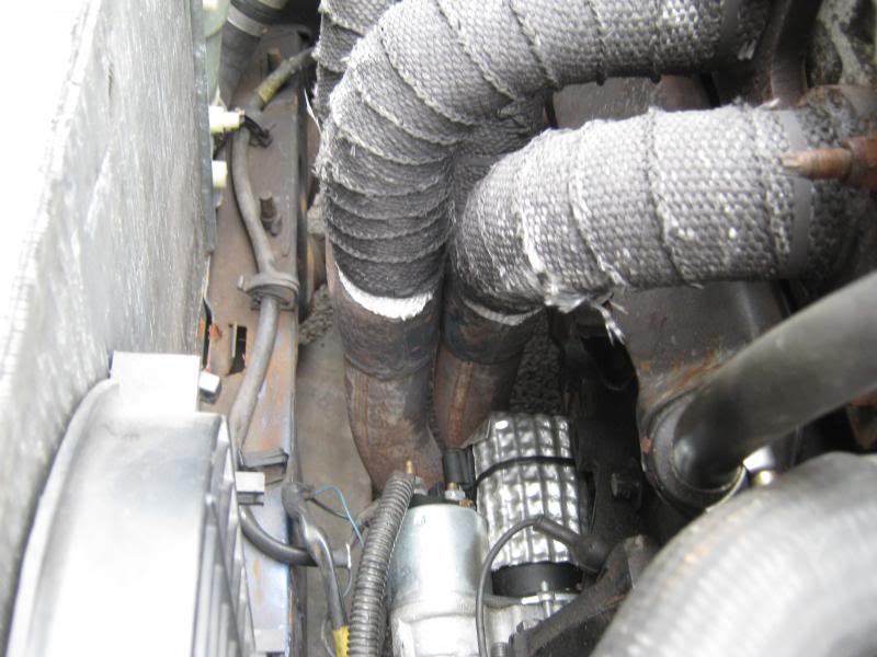

pic of the manifold now its bent to how it should be, used to be 5-10mm away from the front crossmember after it bent at oulton 2 years ago when it was fully heatwrapped -

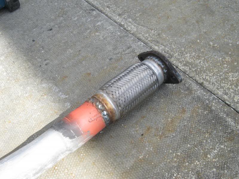

got a new flexi from pipewerx then went to my mates he welded it on/in for me after I chopped the old one out and marked it up etc, its 1'' shorter than the old flexi -
fitted -

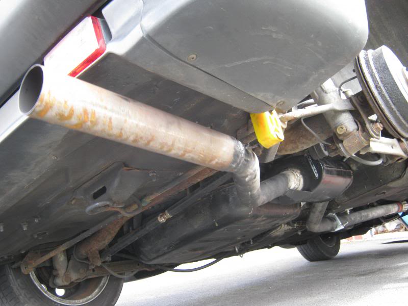

since these pics I adjusted the clamp on the centre section and tucked it up more -
pic of how the tip sits now -
just need my mate to put another tac weld on the centre section sleeve joint so it doesn't droop down!

had my mate tack weld the centre section on the exhaust again after replaceing the flexi so it wont droop down or slip on the sleeve joint.
