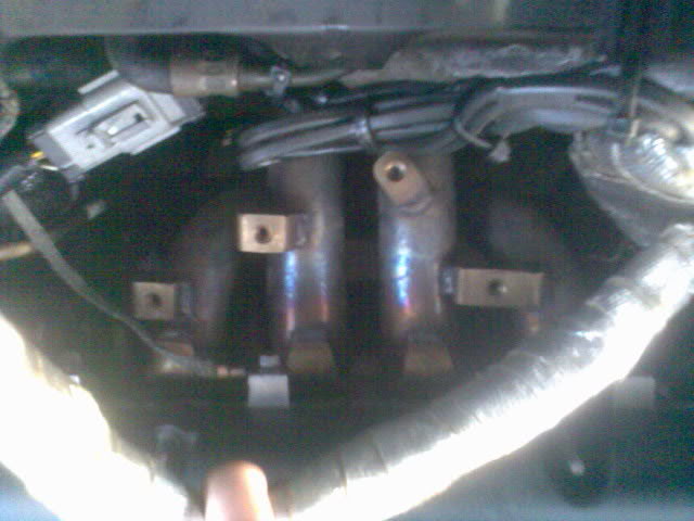

  • Milltek 4-2-1 manifold,
  • Milltek hi-flow sports cat,

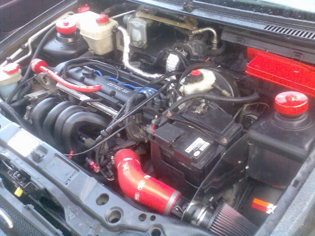

  • K&N universal air filter with samco induction hose,
  • Heat shields & cold feed pipe with trumpet,

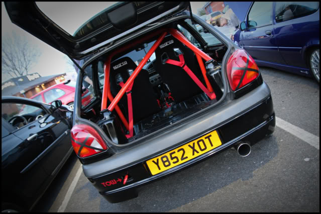

  • Sparco sprint 5 buckets with runners,
  • Sabelt 3-point harnesses,
  • Fusion fabrication bolt-in half cage powdercoated red,

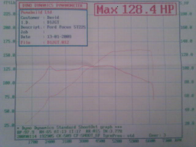

Power -128.4 bhp @ 6200rpm, 132.2 lbs ft. @ 4600rpm, in 3rd gear with the piston riongs and valve stem seals gone. It produced 119.4bhp @ 6400rpm, 118 lbs ft @ 4100rpm in 4th gear at RST in leeds. Should be around 130-135 bhp now with the chip on!

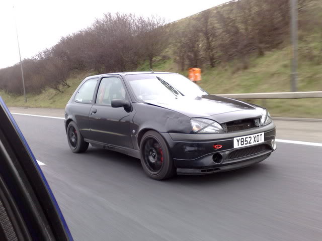

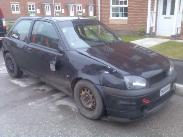

had a crash on valentines day -
Overtakin 2 vans and a car on the A49 on the way back, got past the 2 vans then the car decided to put its indicators on to go right, so i slammed on, locked up did a 180, bumped up the kerb and slammed into a fence, damaged the front wing, side skirt, wing mirror, rear quarter panel, front grille, needed a new rear beam, needed a new tire and trackin doin, cold feed trumpet snapped off
, or well sh*t happens, gotta love the steely

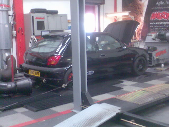

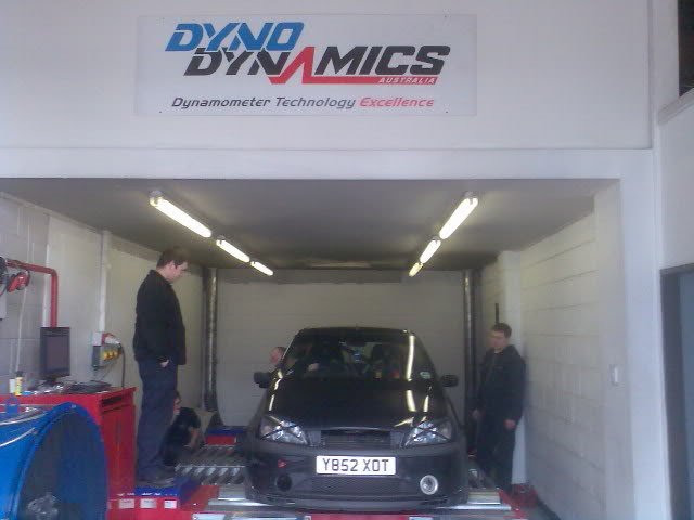

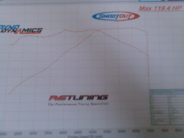

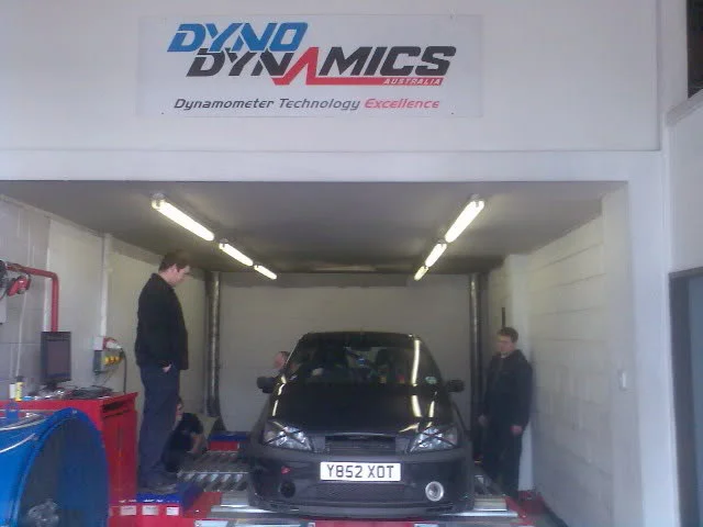

then there was a rolling road meet at Rs tuning and i was having alot of trouble through pumabuild with my chip si i had to run with cams and no chip or map...
Rather disappointed with the result as were everyone else apart from the standard cars, happy with the smooth curve tho, but ill say it again when i get my chip the power should keep goin UP... lol
119.4 bhp @ 6400rpm, 118 lbs ft. @ 4100rpm at the fly.
96.5 bhp @ 6400rpm, 96.5 lbs ft. @ 3400rpm at the wheels.
They were defo runnin LOW! didnt help that the cars were run in 4th gear instead of 3rd.
heres a pick on the M62 on the way home...

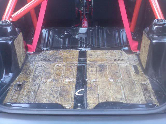

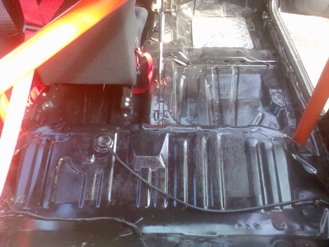

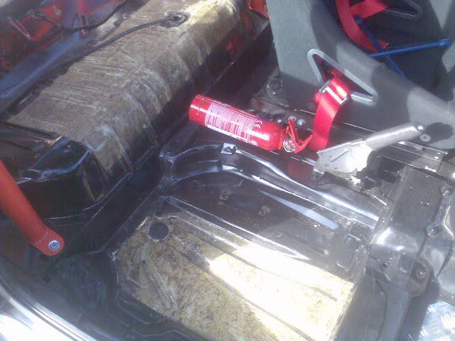

Then started stripping out the soun deadening...
sprayed up -
to be continued...

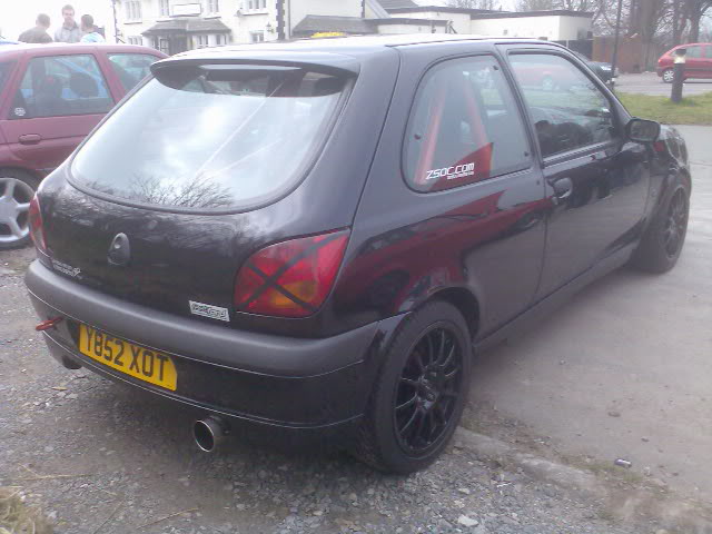

just a quick pic from a meet at the end of march...

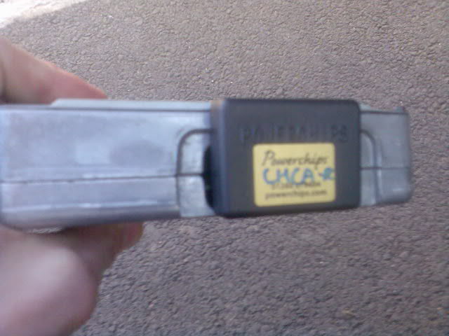

then a few days later finaaly got my chip...
It feels alot quicker now, especially in 2nd and 3rd
When it was on the rollers at RS tuning it revved to 7100rpm cos of the standard limiter was removed and ready on the chip which was fault and this is my replacement, now it bounces off the standard limiter at 6800rpm

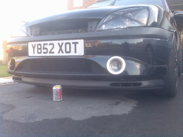

Quick one of the front end -

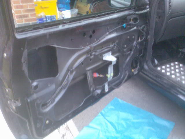

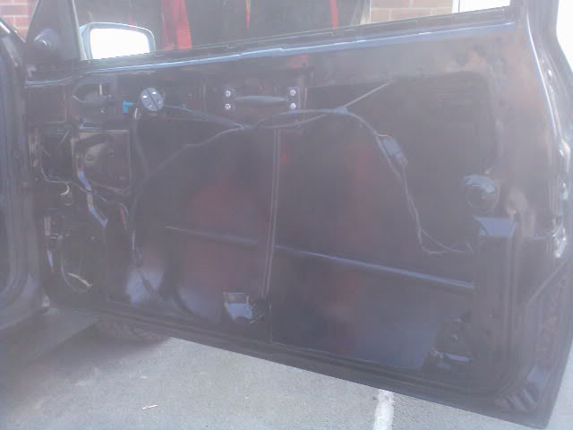

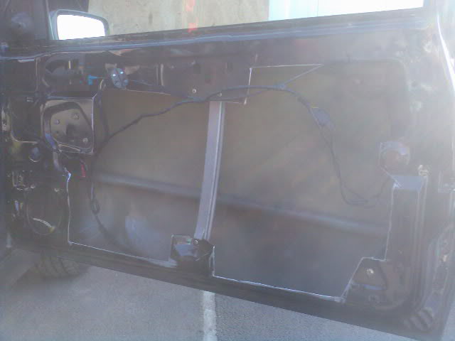

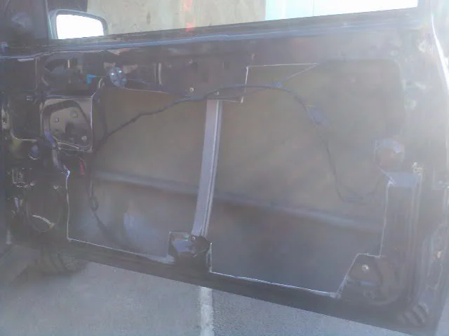

Then a few days later i decided to get rid of the headlining, door cards, radio, spare wheel...
then attacked the doors with a grinder -
All sprayed up with new handles -

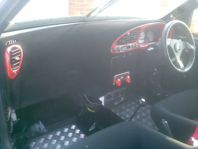

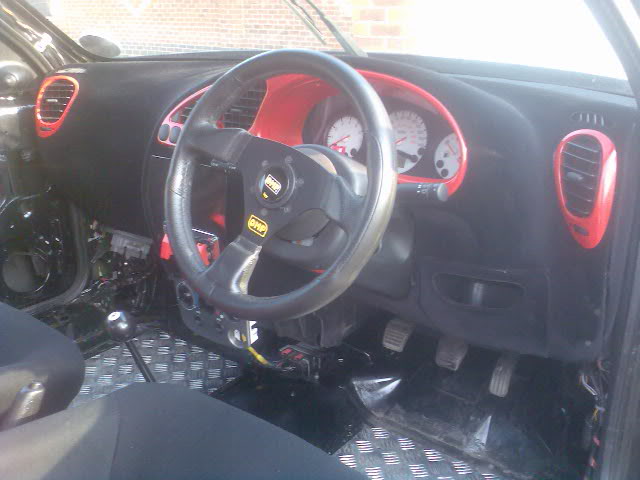

Then came a flocked dash which a mate was selling for half the price for which id pay to get mine sent away :D... its ultra light as he stripped out all the matal supports and plastic brackets so now i cant have a radion anyway, also adam anderton sprayed my heater surrounds for me aswell (cheers adam)...

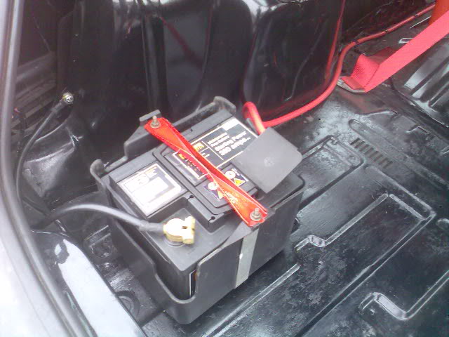

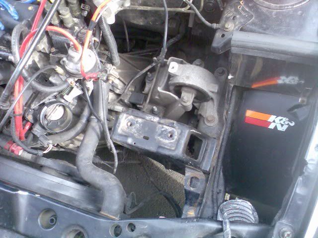

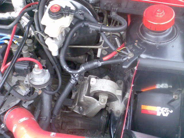

and last week i relocated my battery...

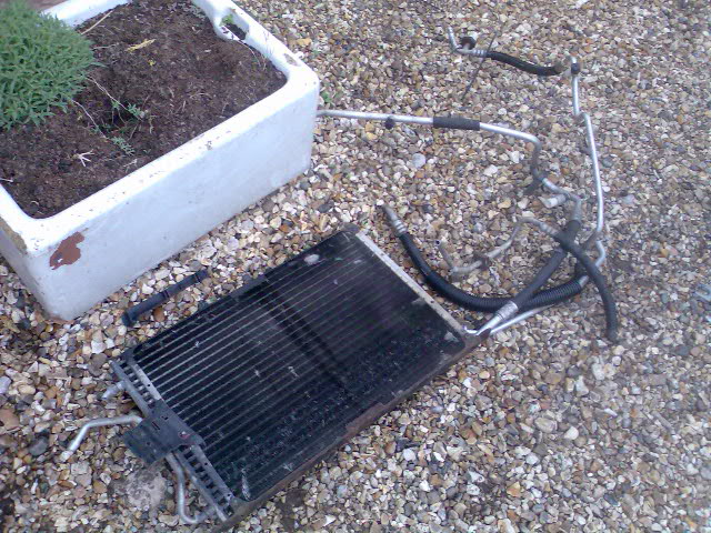

then removed some of the aircon (rad and all the pipes) how the bay looks without the pipes (alot better) -
to be continued...
continued...

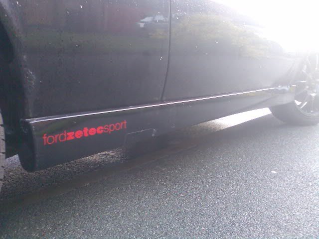

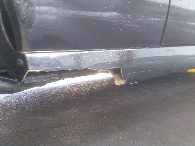

only got the new side skirt since the crash 2 weeks ago -
damaged one -
new one -

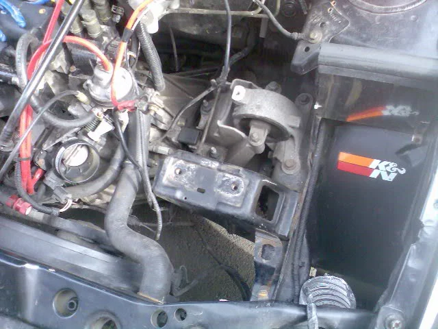

Then last weekend i re-located my battery...
After removin the battery and filter -
then bodged up the wire temporary till i could get hold of some conduit and cut the battery mount off with a junior hacksaw lol then snaded it down and painted -
then i got some conduit of f0xy )cheers jord) -
in the boot -

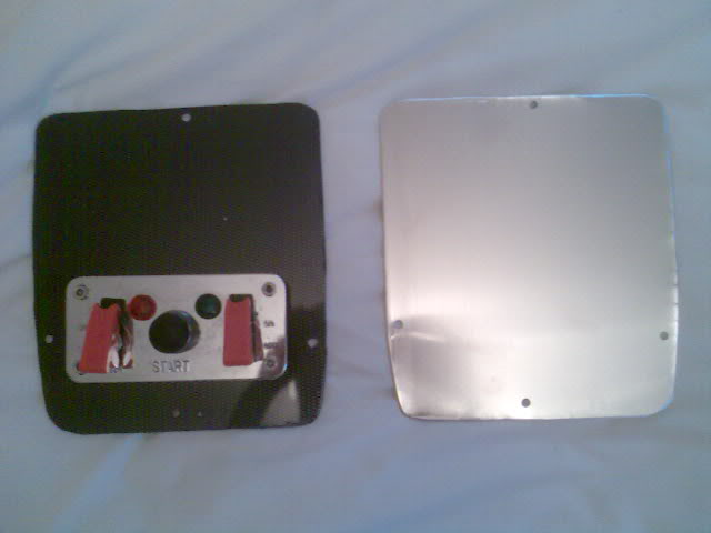

thats basically it for now, oh i cut this earlier for my dash as the switches were never wired up not even in my mates car...
Old fake carbon fibre with un-wired switches compared to the new 2mm aluminium
hopefully jordan will rivett it on for me tmoz... cba sprayin it so might just get some kool stickers for it...

every modded car on the day at RS tuning were ALOT lower than expaected but all the standard-ish cars got more than expacted!??
apparently in dyno shoot outs dyno dynamics are meant to run cars in 3rd gear not 4th, at pumabuild on their rollers (dyno dynamics aswell) in 3rd gear it made 128bhp and after the re-build it was 9 bhp less? thats defo not right so next time when i go on the rollers im going to go awesome GTI in irlam as thats where i went fdirst when i just had my exhuast and filter and it made 115bhp, which isabsolutly spot on, so next time in a couple od months ill go backj top awesome and it should be between 130-135bhp...
tbh im not bothered about bhp, more bothered about 0-60 and 1/4mile times, they'll be getting done soon as i plan to go down to santa pod for 'run what yer brung' in the near future and ford fair in august they have a 0-60 strip :D
Nice work so far. Ive read the puma 1.7 inlet manifold can help improve torque. Altho if it was me id be dropping a 2.0L Duratec in there
generally speaking 4th gear on "most" cars is as close to 1:1 ratio. If you run in 3rd gear you are giving a false reading
basically if you want to impress people you "cheat" and run the cars in 3rd = naughty
not true in all cases, and some rolling roads do things differently, but it does go on on legit RR's, as the owner of the car you should find out what gear offers as close to 1:1 drive ratio and then hence question the operator

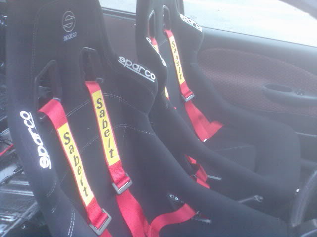

buckets and harnesses this pic was ALONG time ago as you can see still have the door cards in lol -

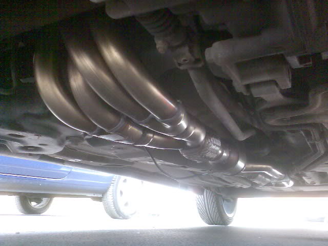

also my manifold and sports cat -

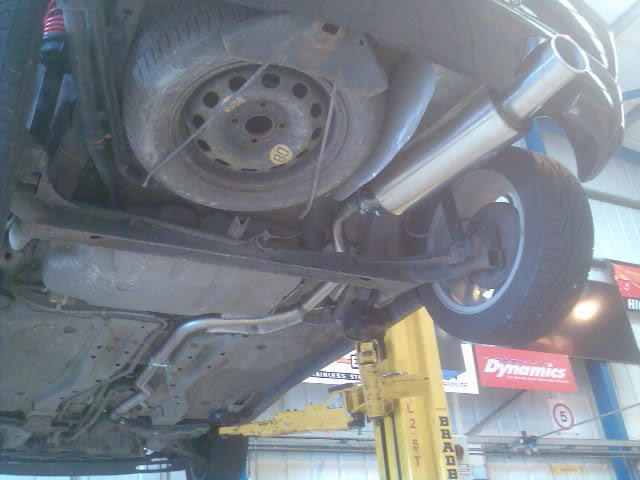

when i got the piper cat-back fitted last summer -

the graph from when it was on the rollers at pumabuild the day i had my cams fitted with no chip or map it made 128bhp and 132lbs ft. :D, now with the chip on the power should keep goin up no go flat after 5300rpm, as the peak power from these cams is around 6500rpm...

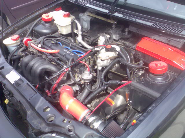

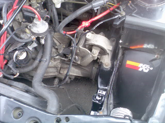

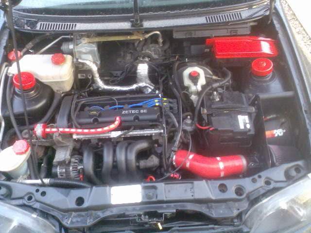

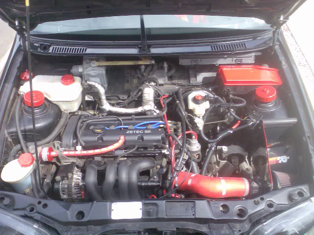

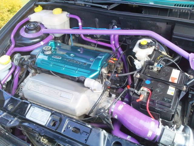

Like the engine bay picture. Looks alot tidier than standard.
In standard form the ZS engine bay always looks messy, wires all over the place.
ive tidied up as much as i can, as i said ill get some pics up, here they are...
before i removed the battery and air con pipes and rad -
and how it looks now :D
