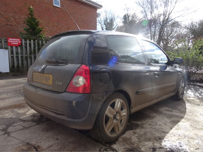

Bought this back in March last year to use for road rallies (12Cars), track days and the occasional drive.
It took me a few months to get it road worthy and save up for insurance, tax etc.

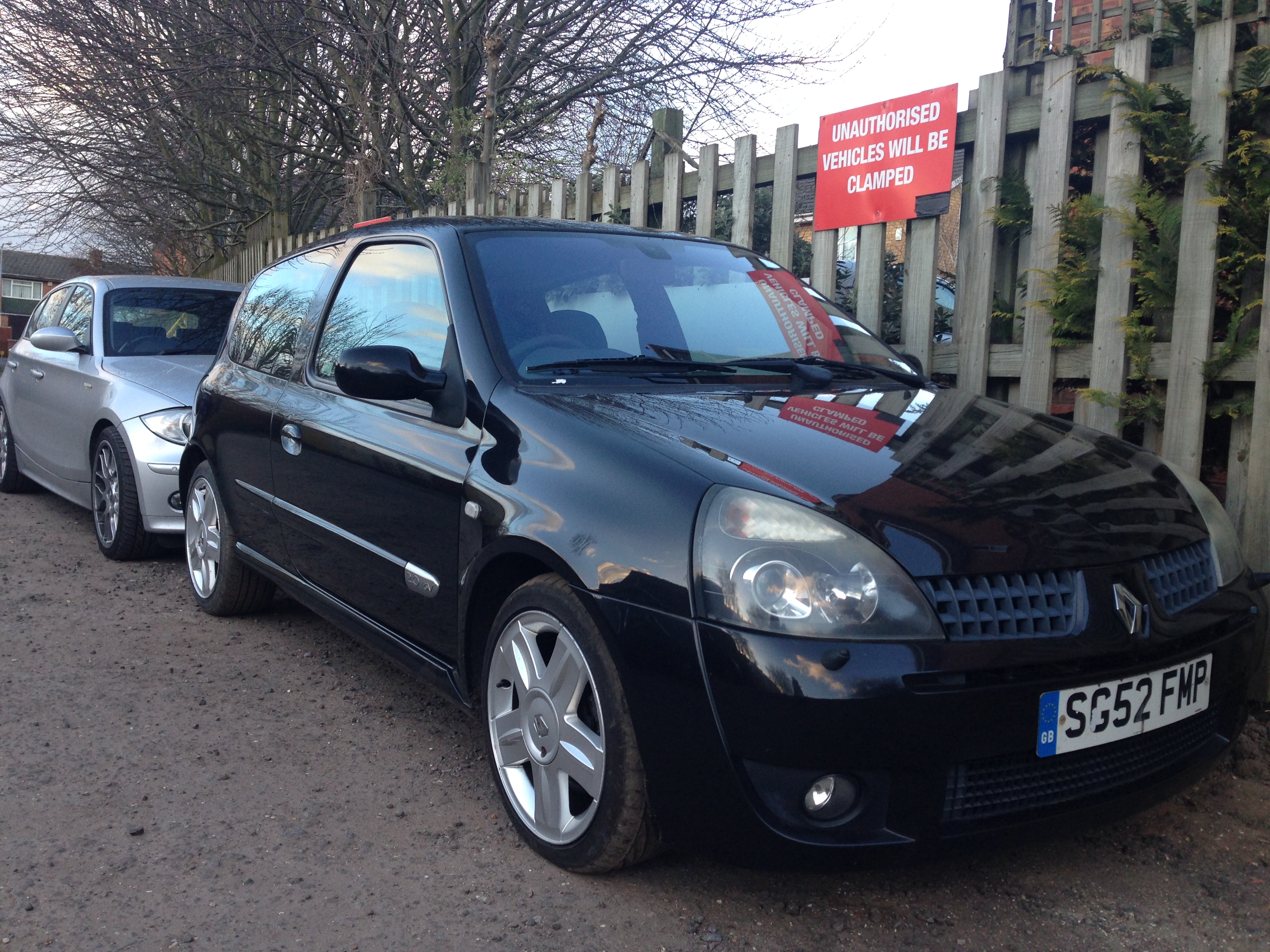

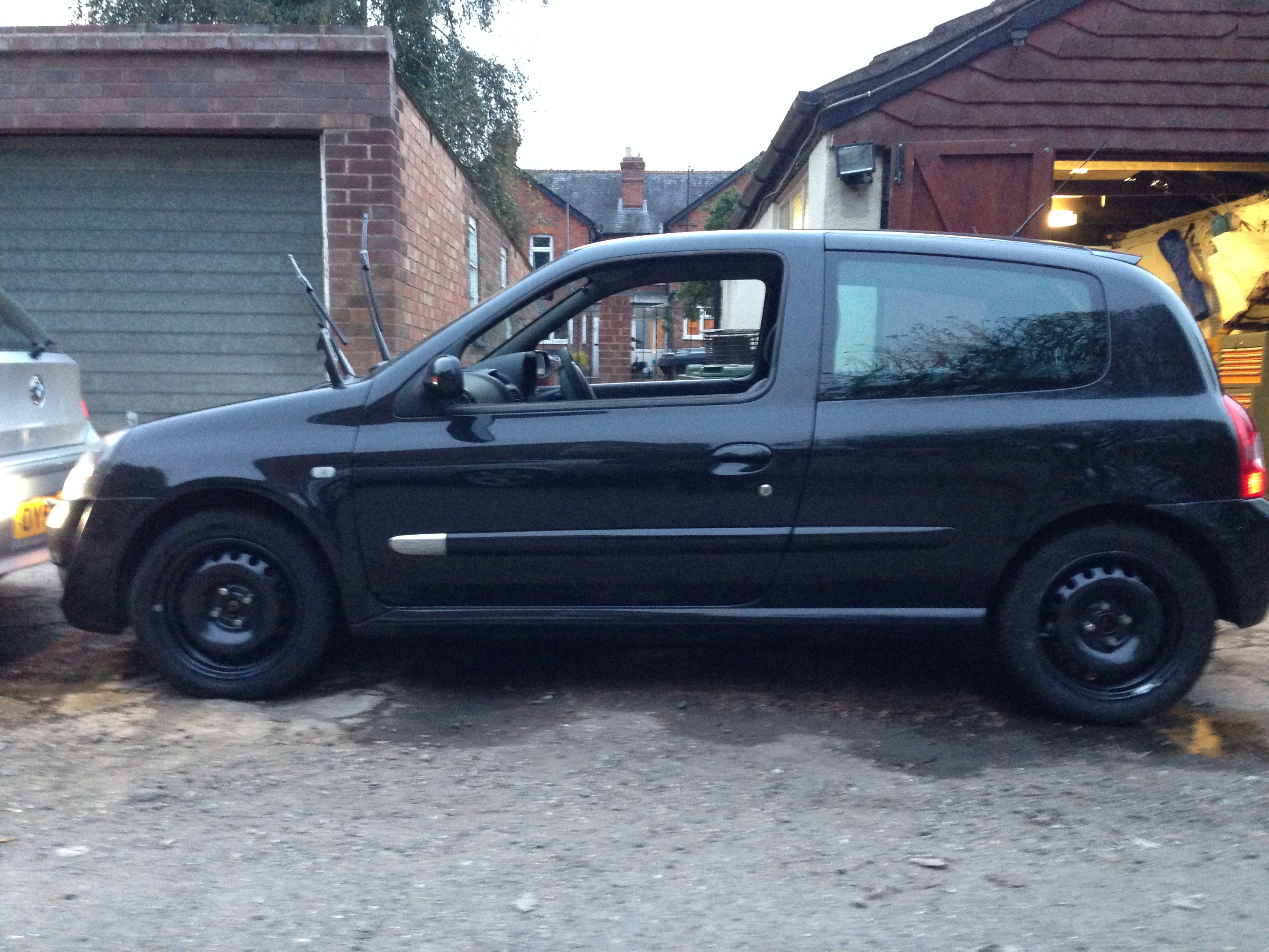

This was it once I bought it..
The rear interior was striped out so started by replacing that and getting a set of steel wheels to use for the Road rallies because they would be cheaper to replace if damaged from pot hole punctures.

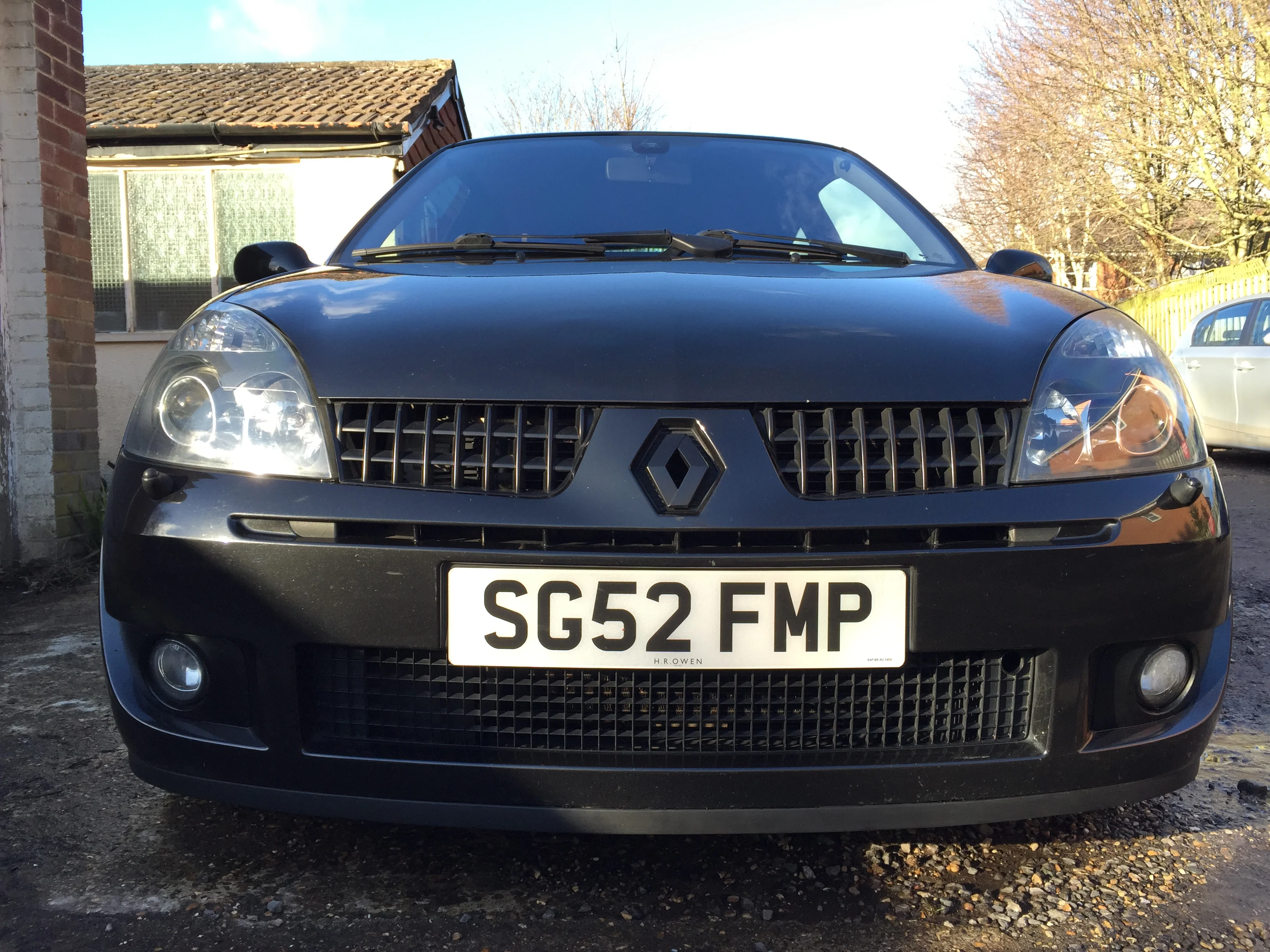

- Sprayed most of the plastics, grills and wiper arms satin black.
- replaced all the bulbs to LED and Chromed Indicators.

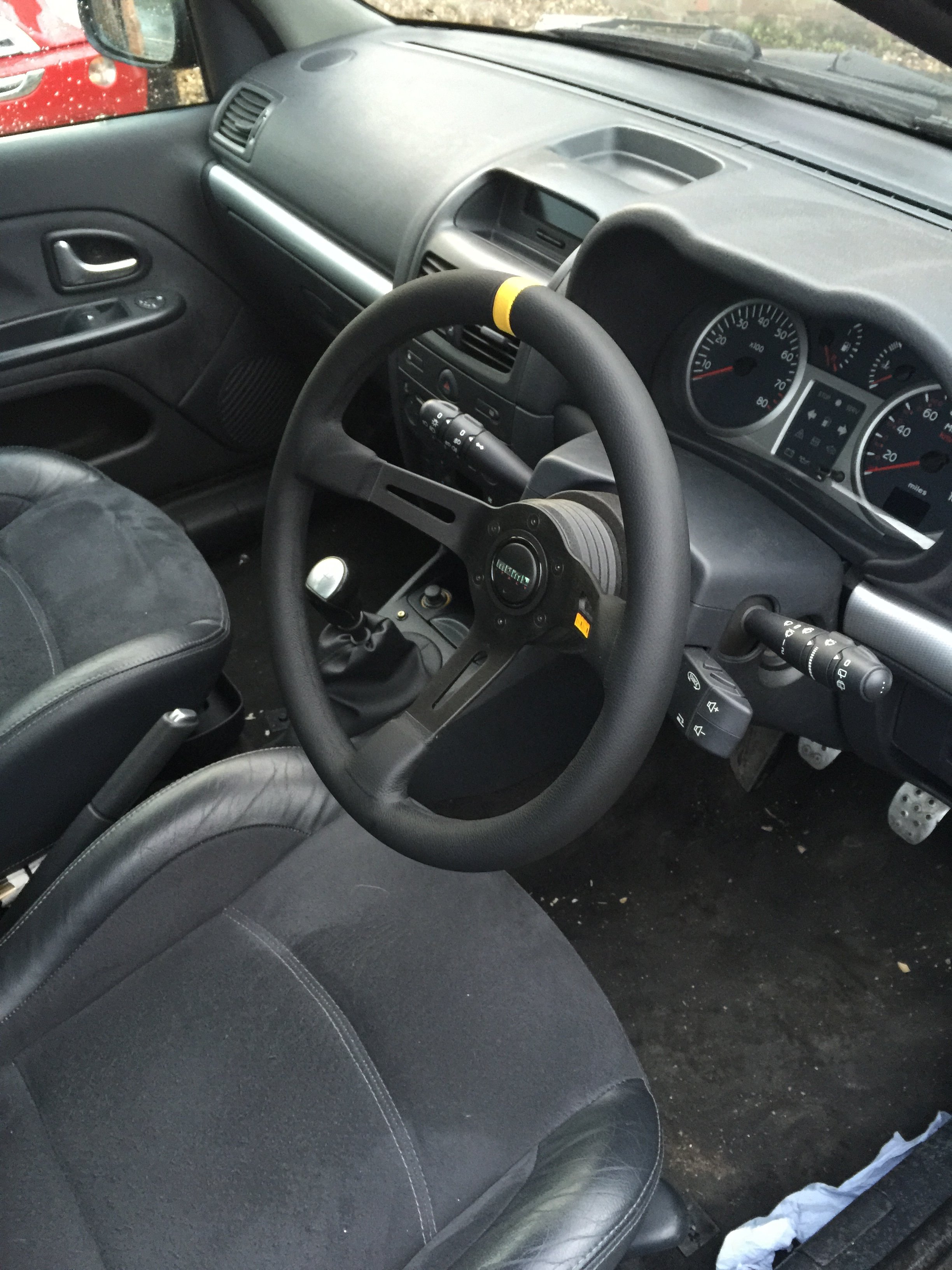

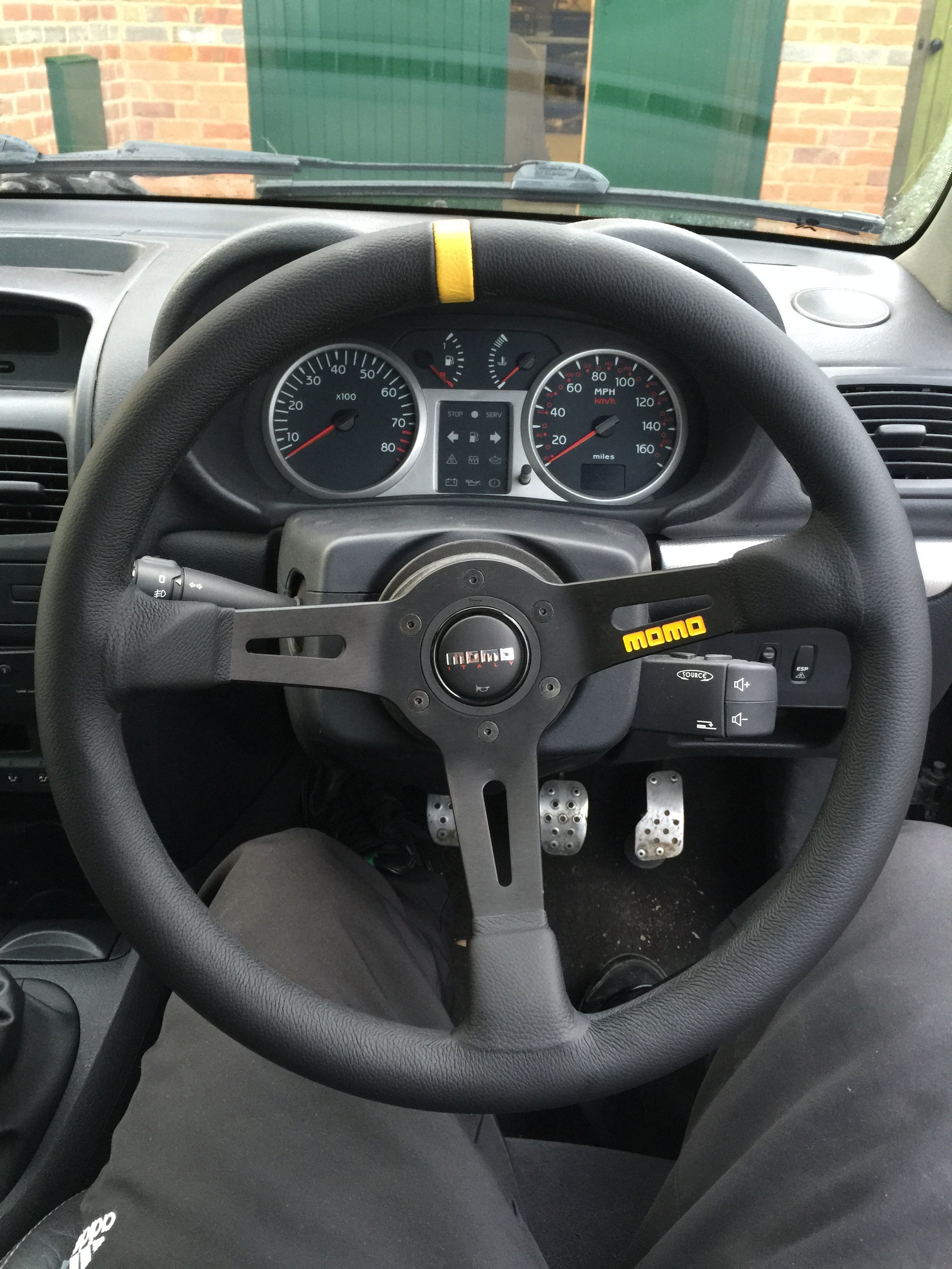

- Changed the Steering wheel to a MOMO dished one.

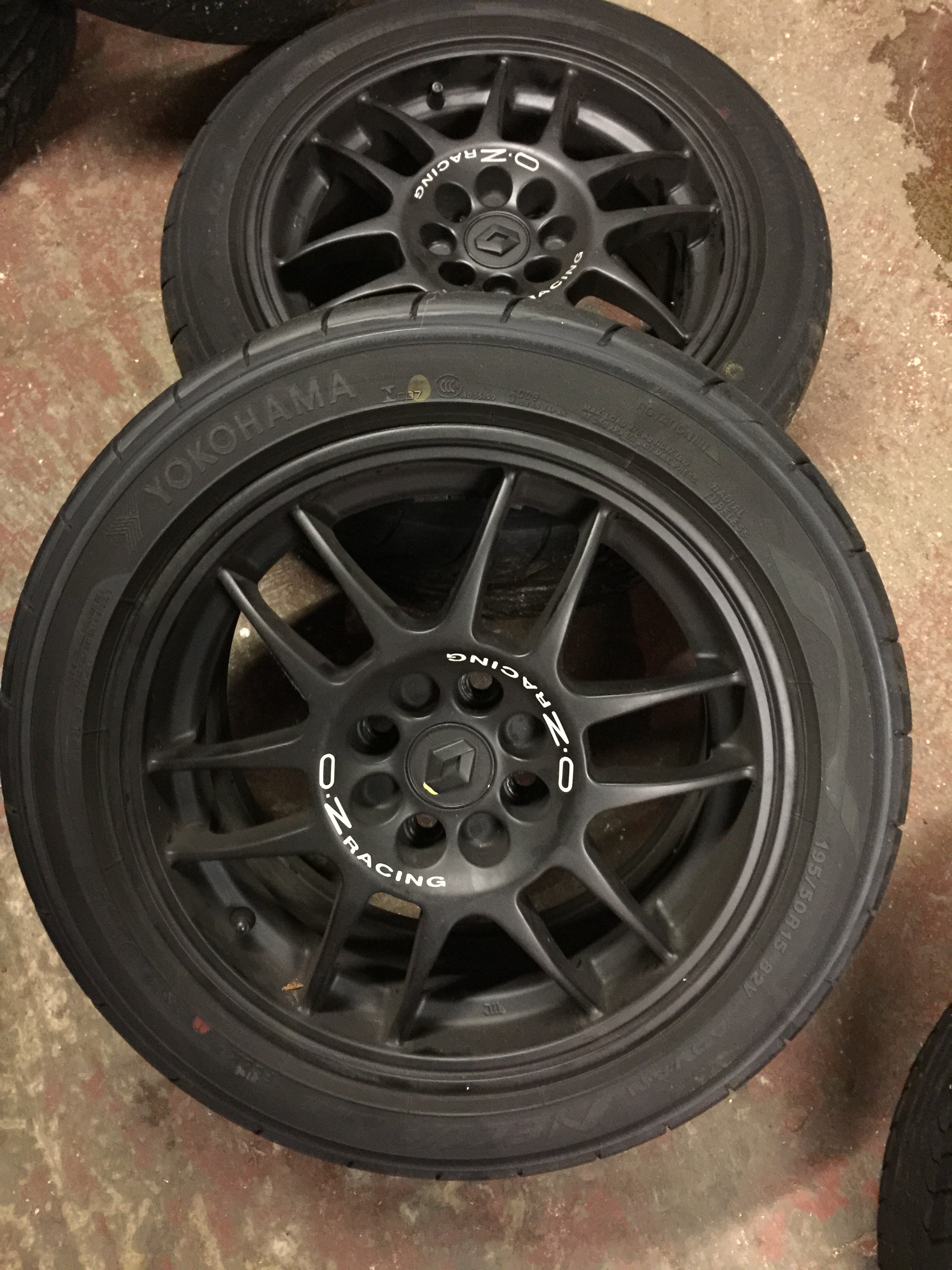

- Bought @Cub.s OZ F1's the other day just need to get a set of tyres before they can go on.

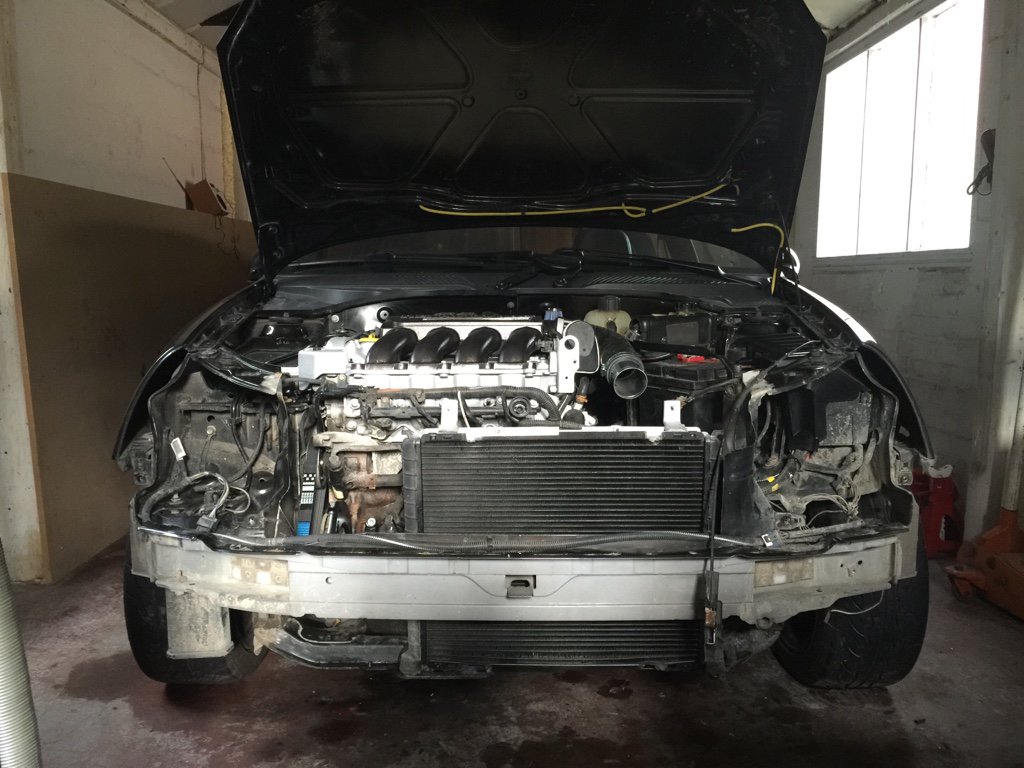

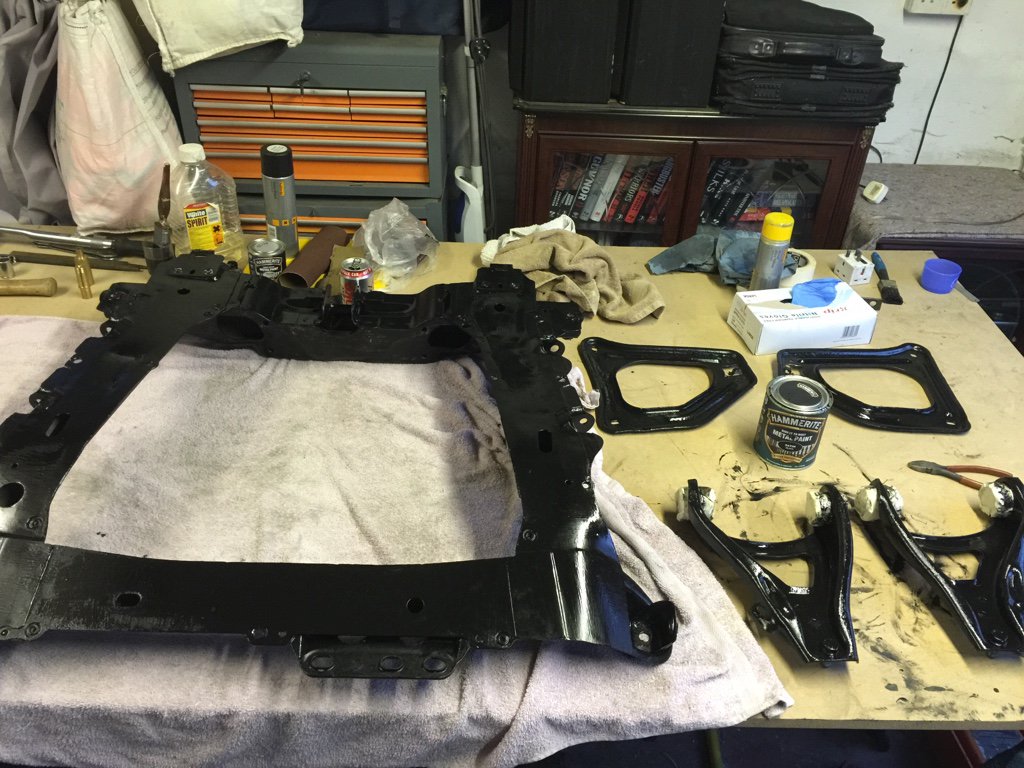

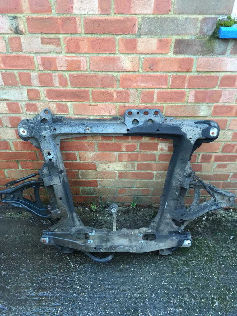

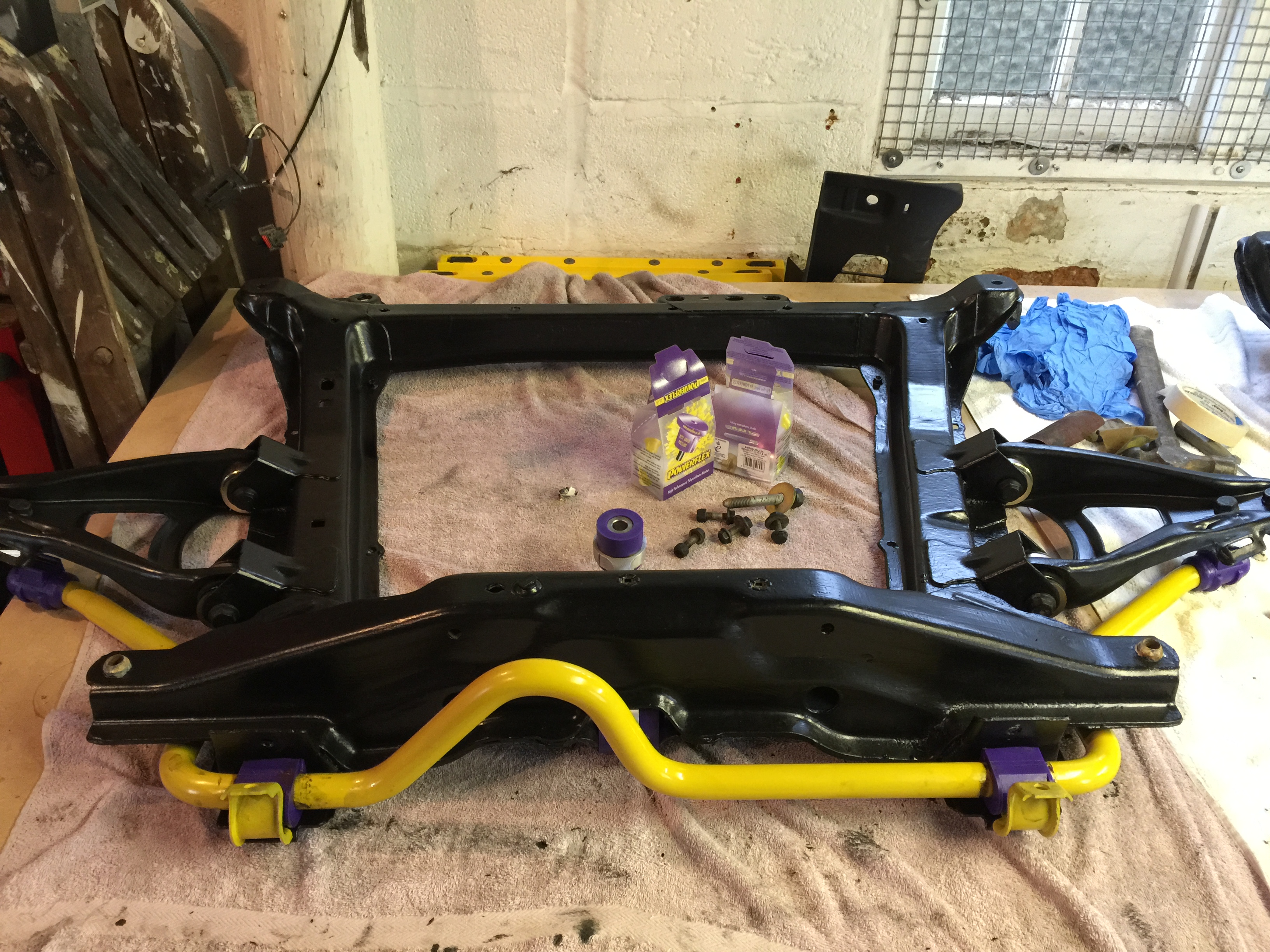

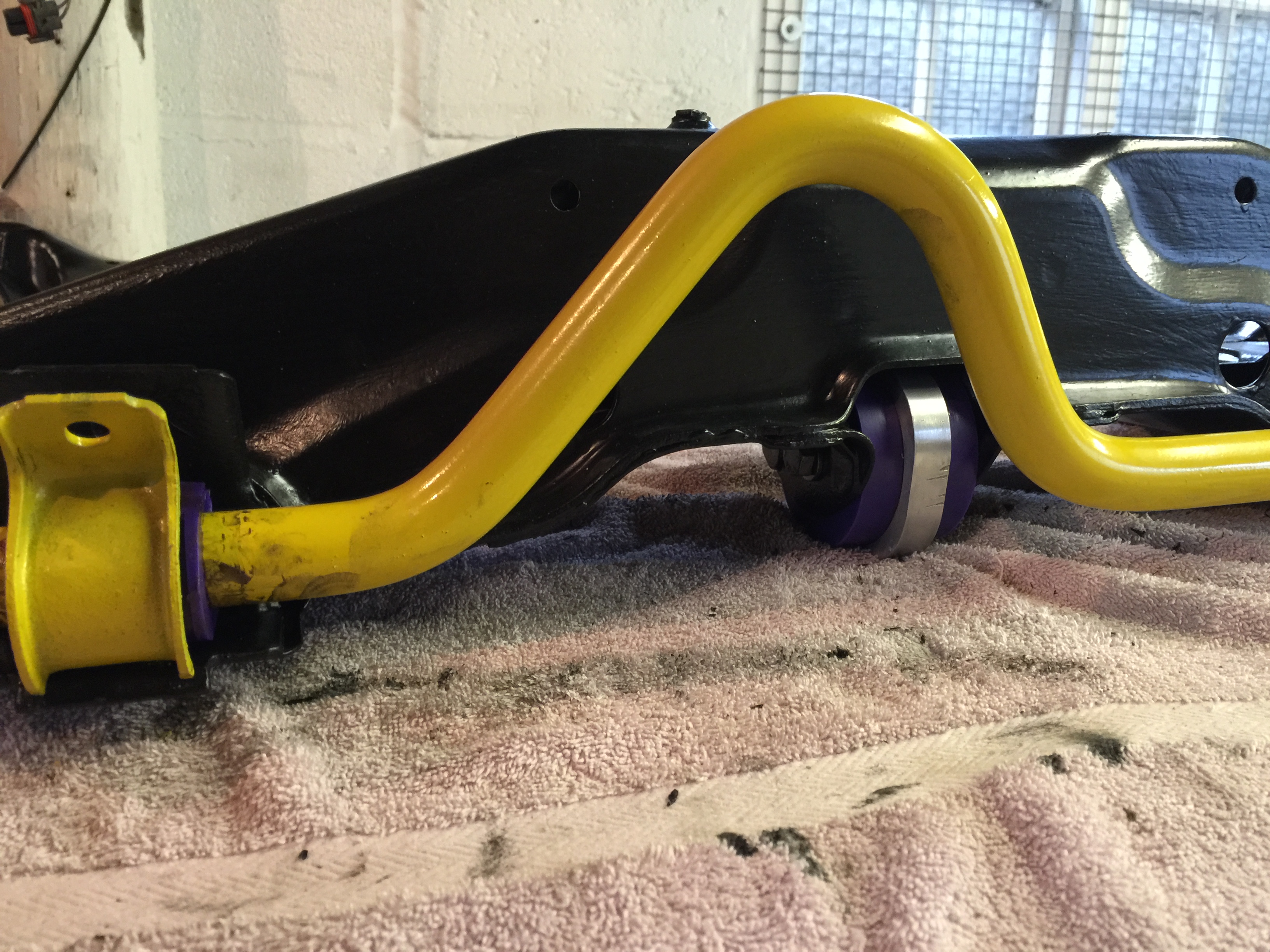

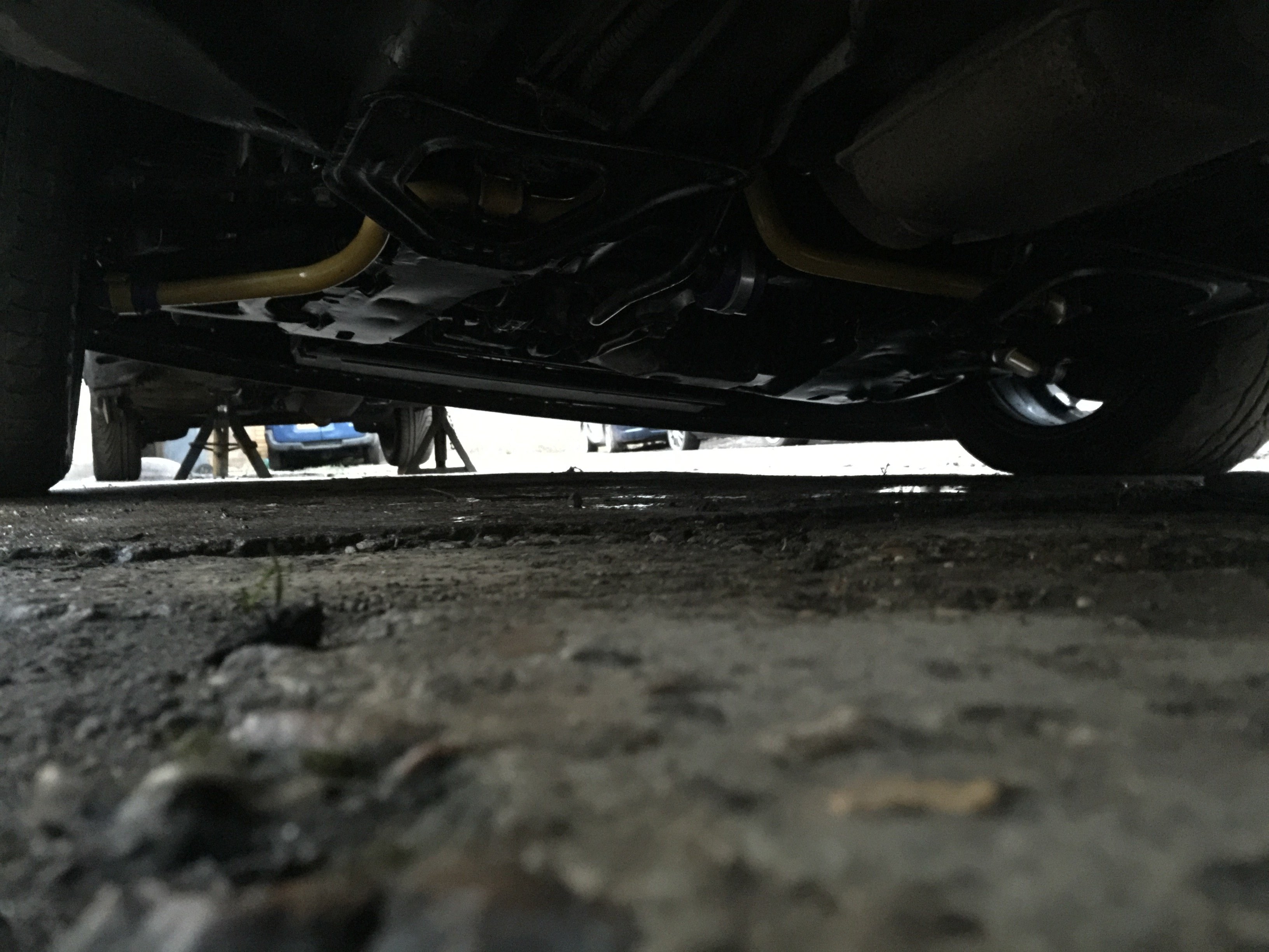

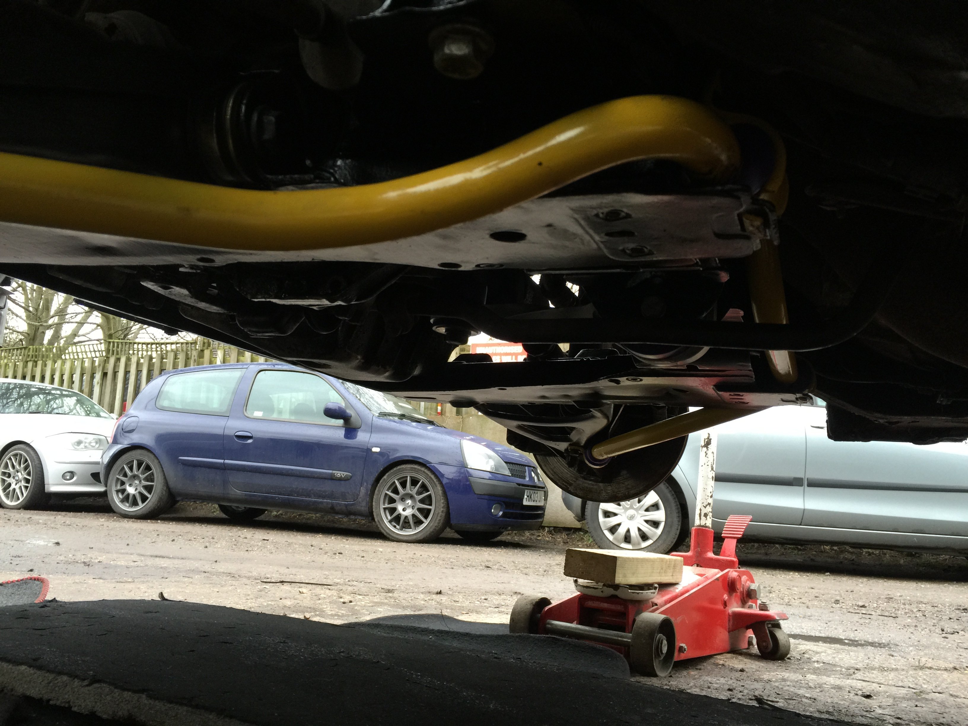

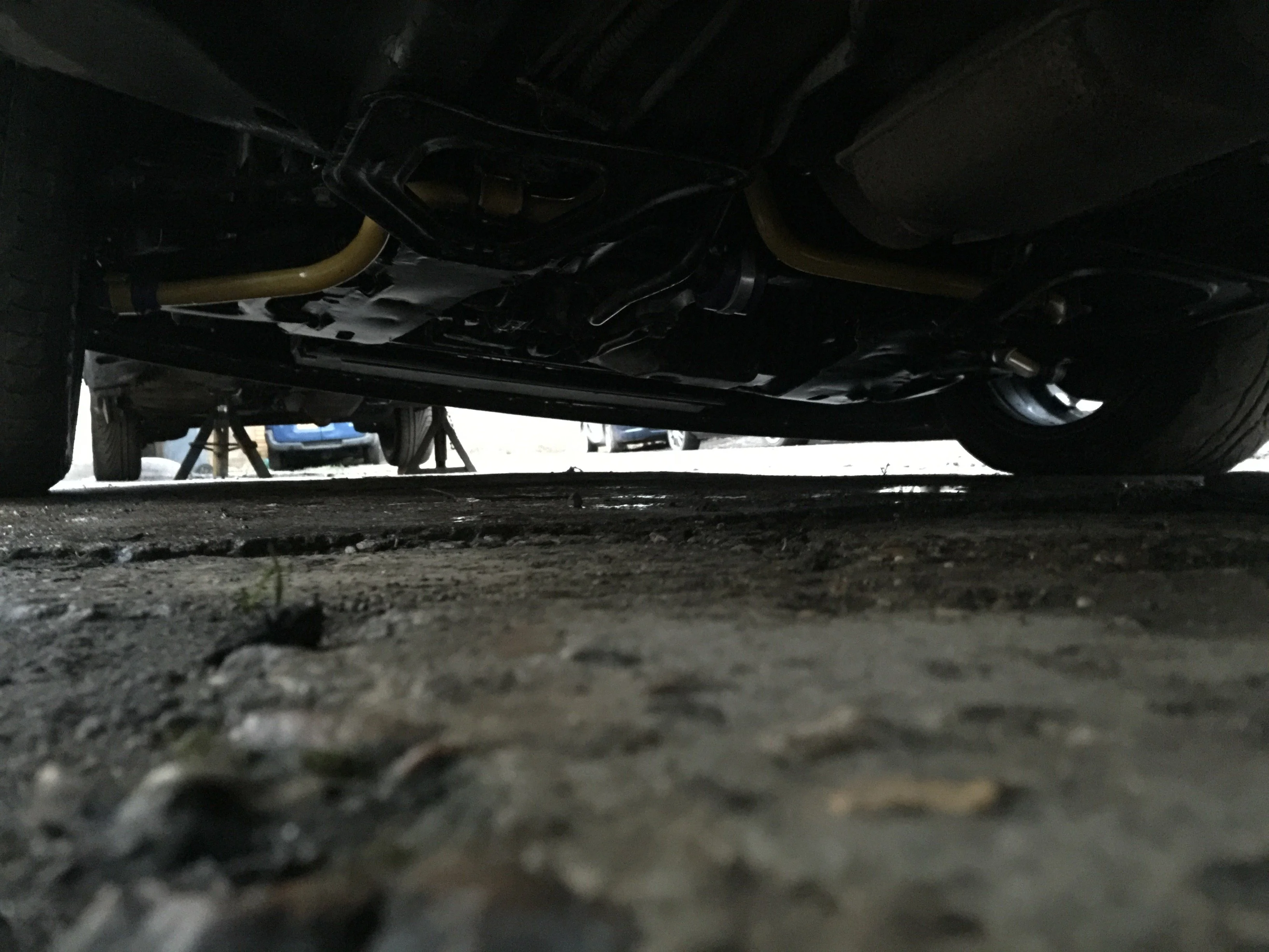

In the past week I have removed the subframe, wishbones, ARB to paint and fit the powerflex bushes

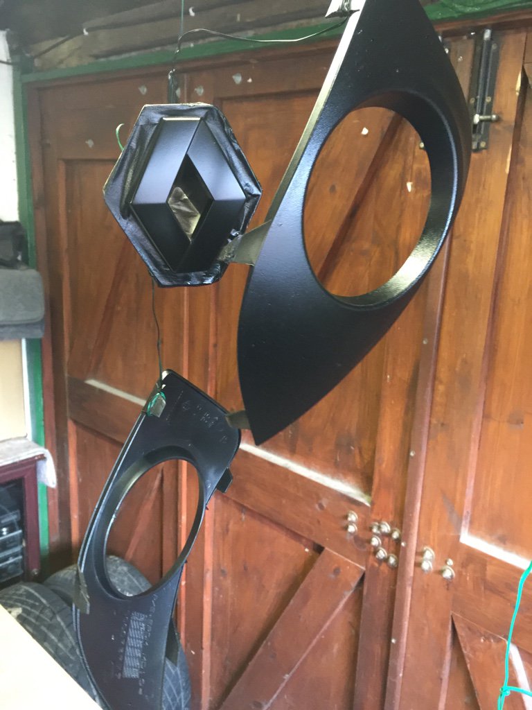

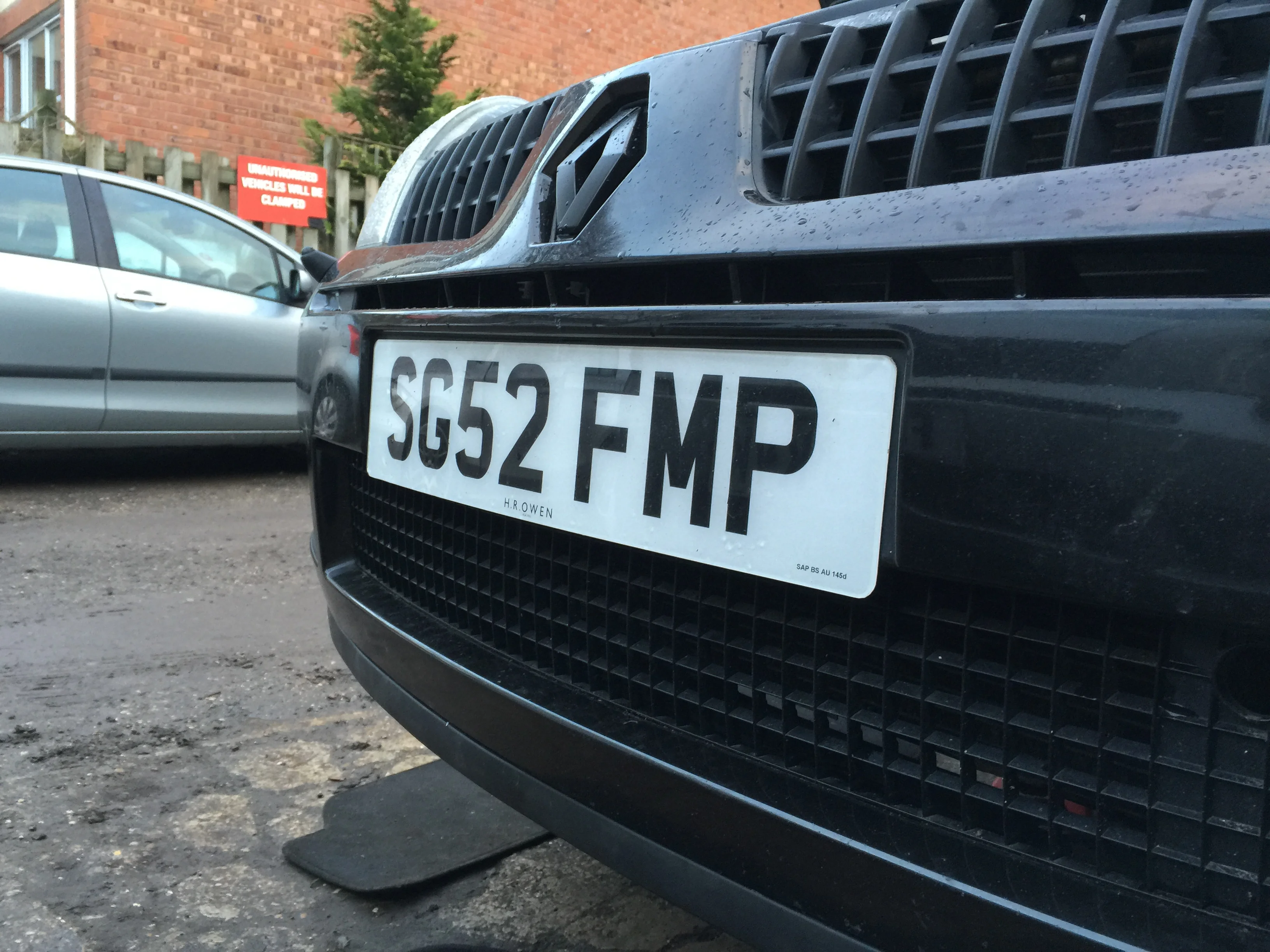

bought a fabia front splitter and second hand K-tec exhaust until I can afford a new recessed one
And also why I had the bumper off to fit the splitter I sprayed the badge and fog surrounds

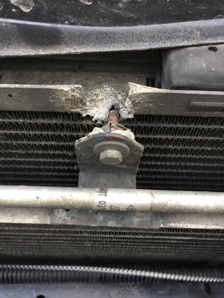

While everything was off I also found the radiator had perished where the air con mounts to it
Has anyone else encountered this ? If so what did you do to fix it ?

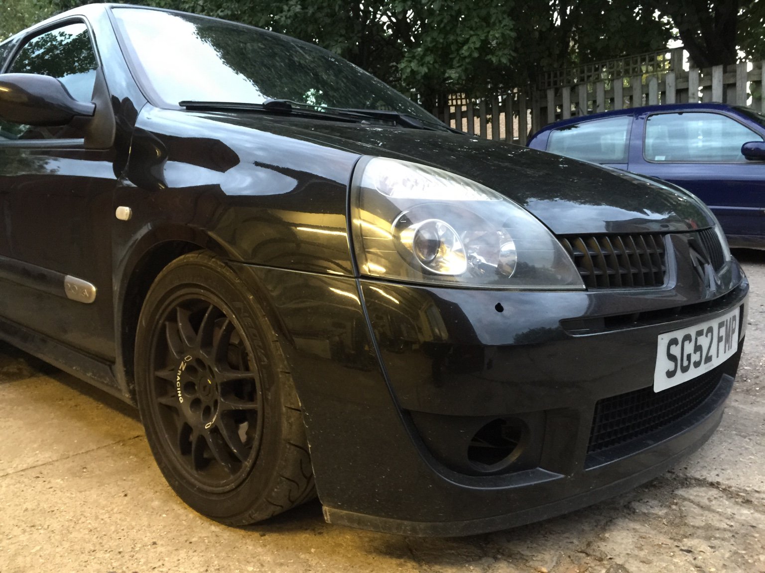

Over the past couple of weeks i have finished painting the subframe and ARB and also fitted the powerflex bushes now.
Front Splitter fitted too, surprising how much a difference these make.

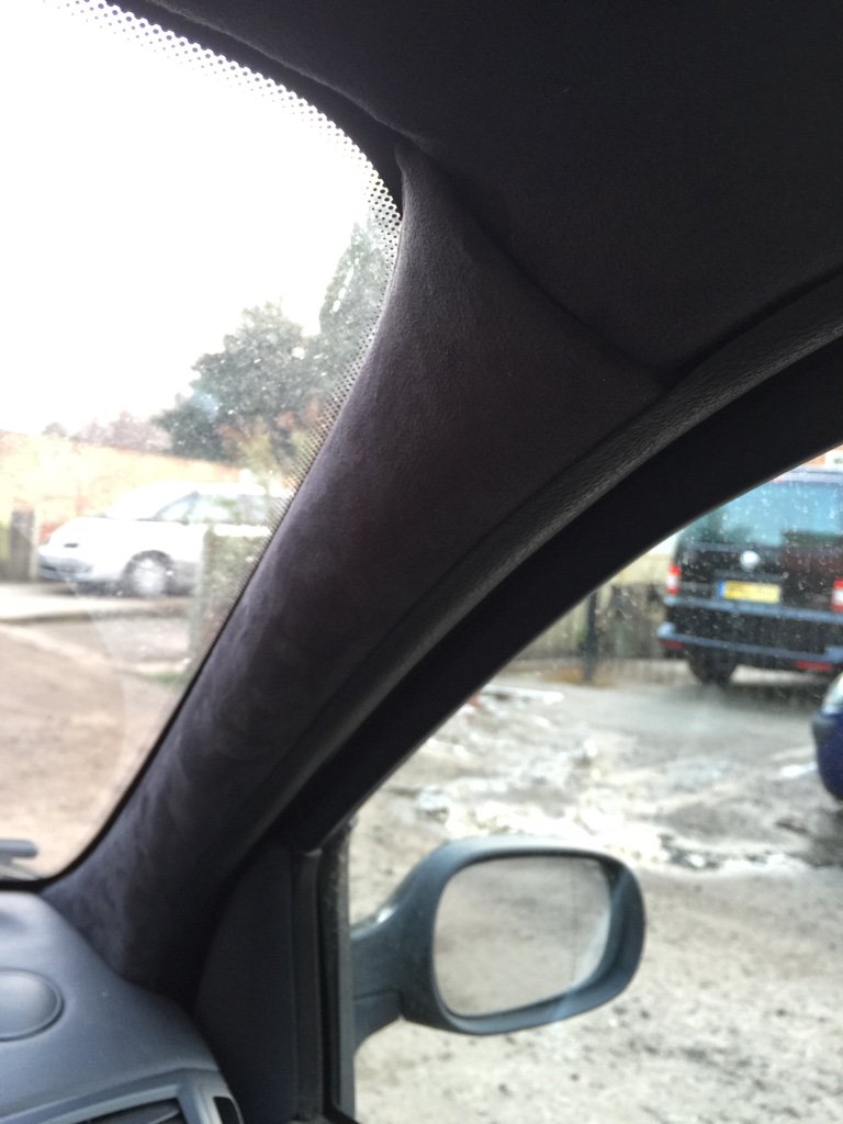

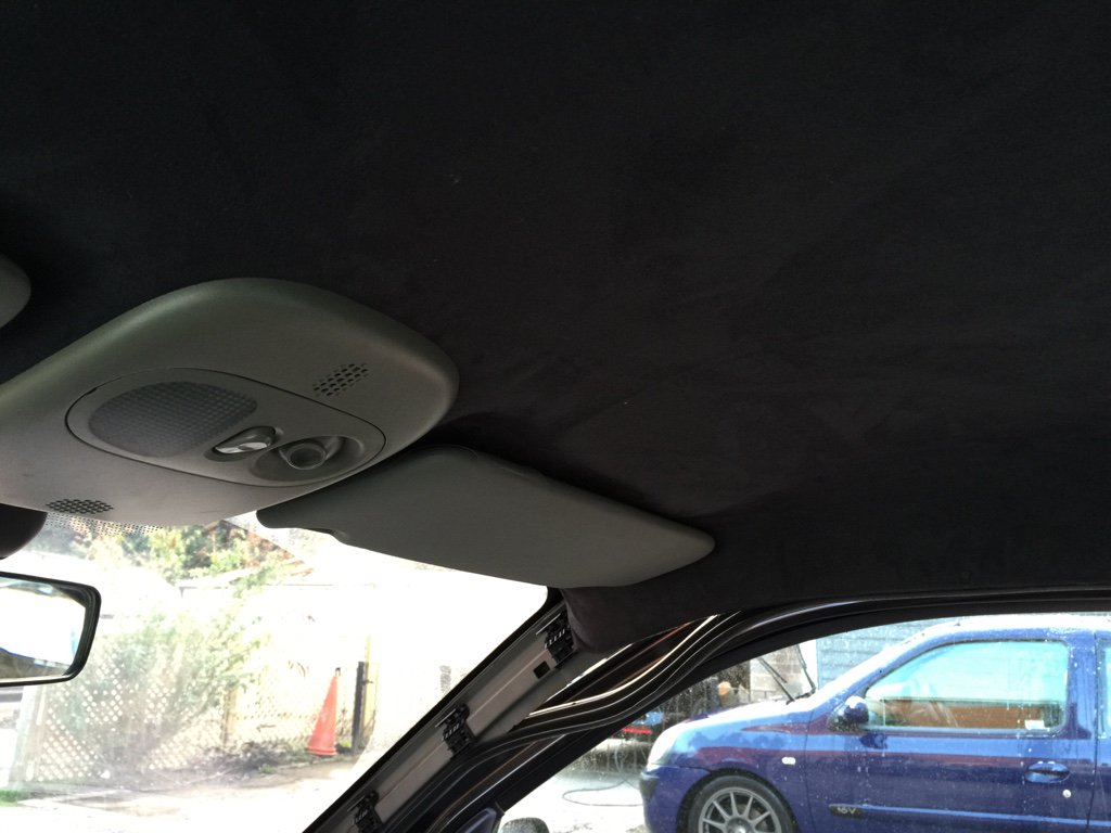

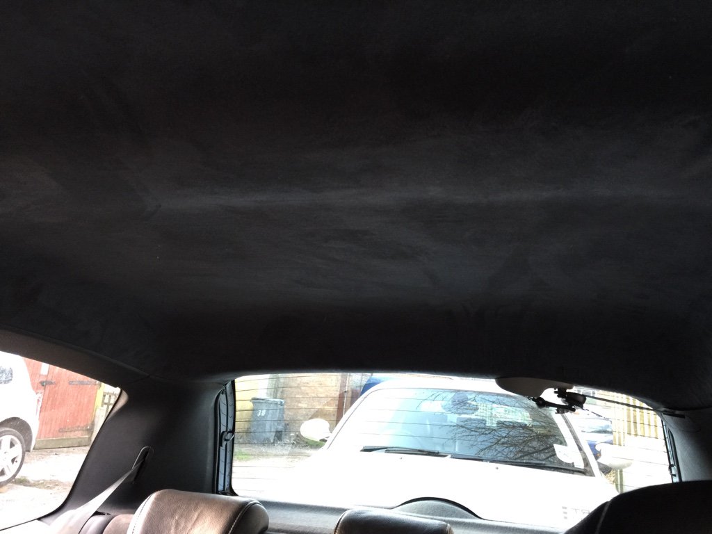

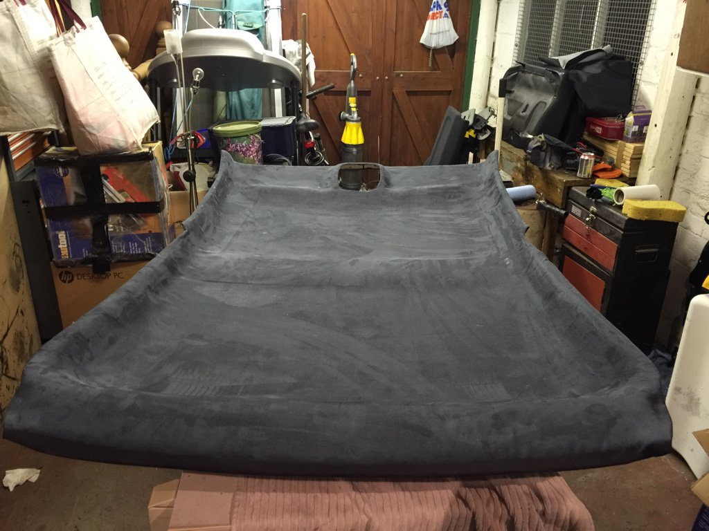

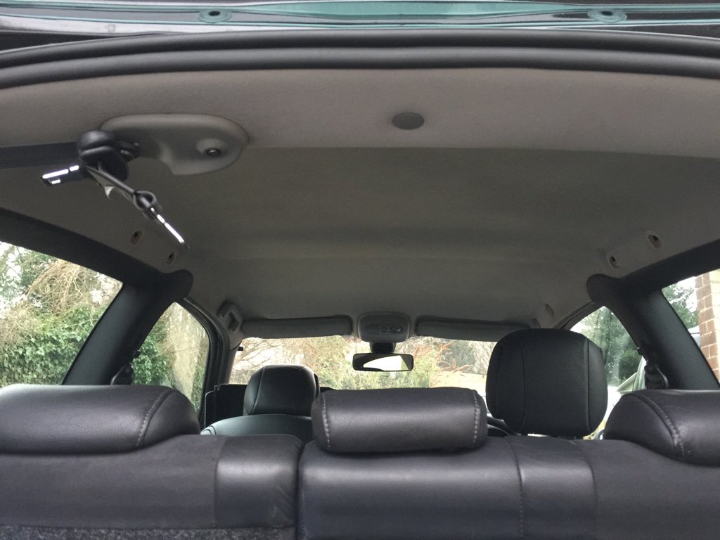

Last week I removed the headliner and re-trimmed it in alcantra
Found it quite hard to get it to stick and fit with any creases as it was the first time I had ever done anything like it. Pretty happy with how it turned out and just need to spray the sun visor and light to match the grey plastics to Finnish it off

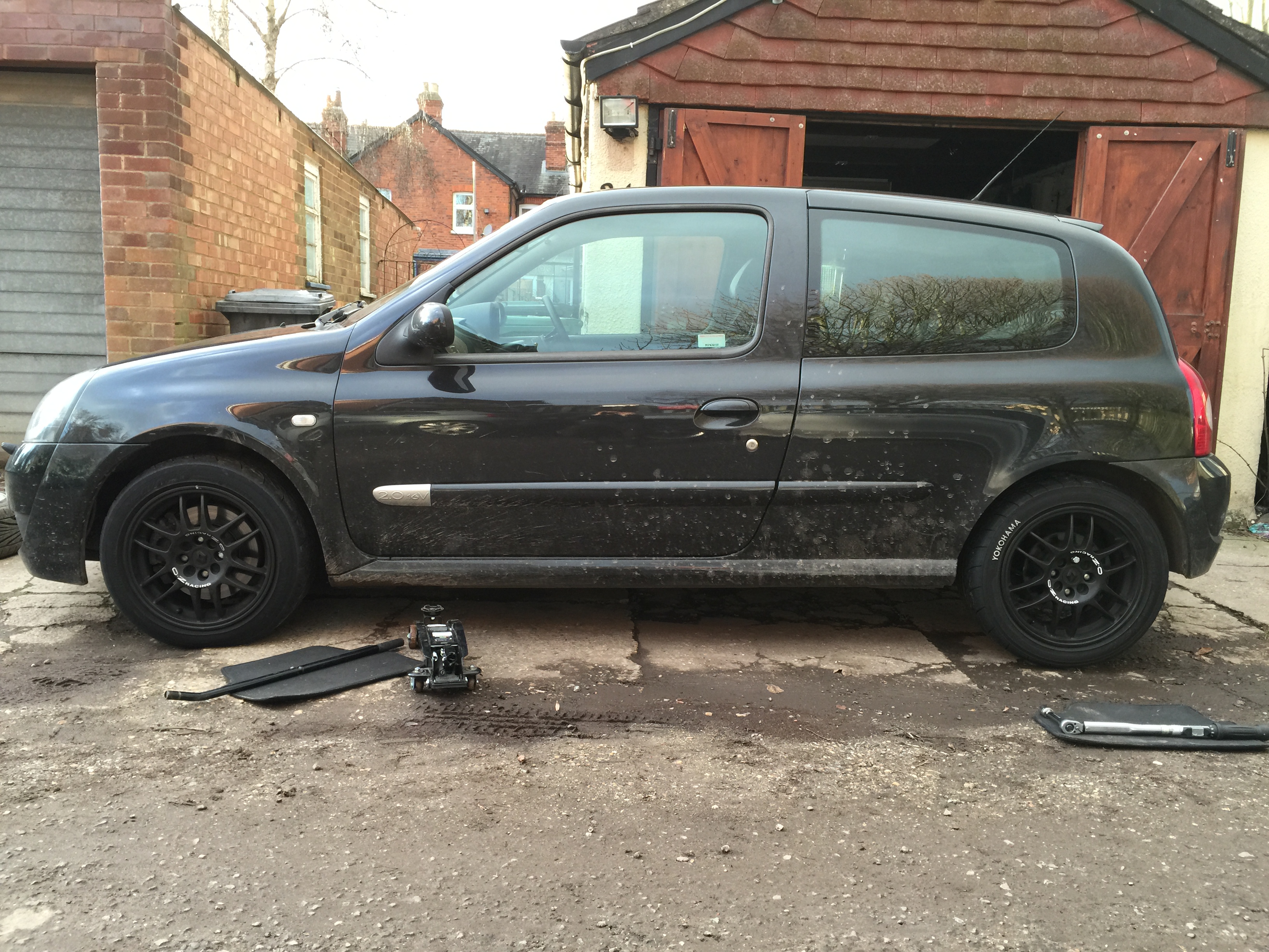

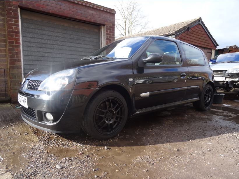

And then also took some random or how the car stands atm
looks good, where did you get the alcantra material from? wouldnt mind having a crack at this myself.
Cheers I just got it off eBay, was one of the first ones that came up. Wasn't a perfect colour match but close enough for what I wanted and not like it's right next to the existing material. So can't really notice.

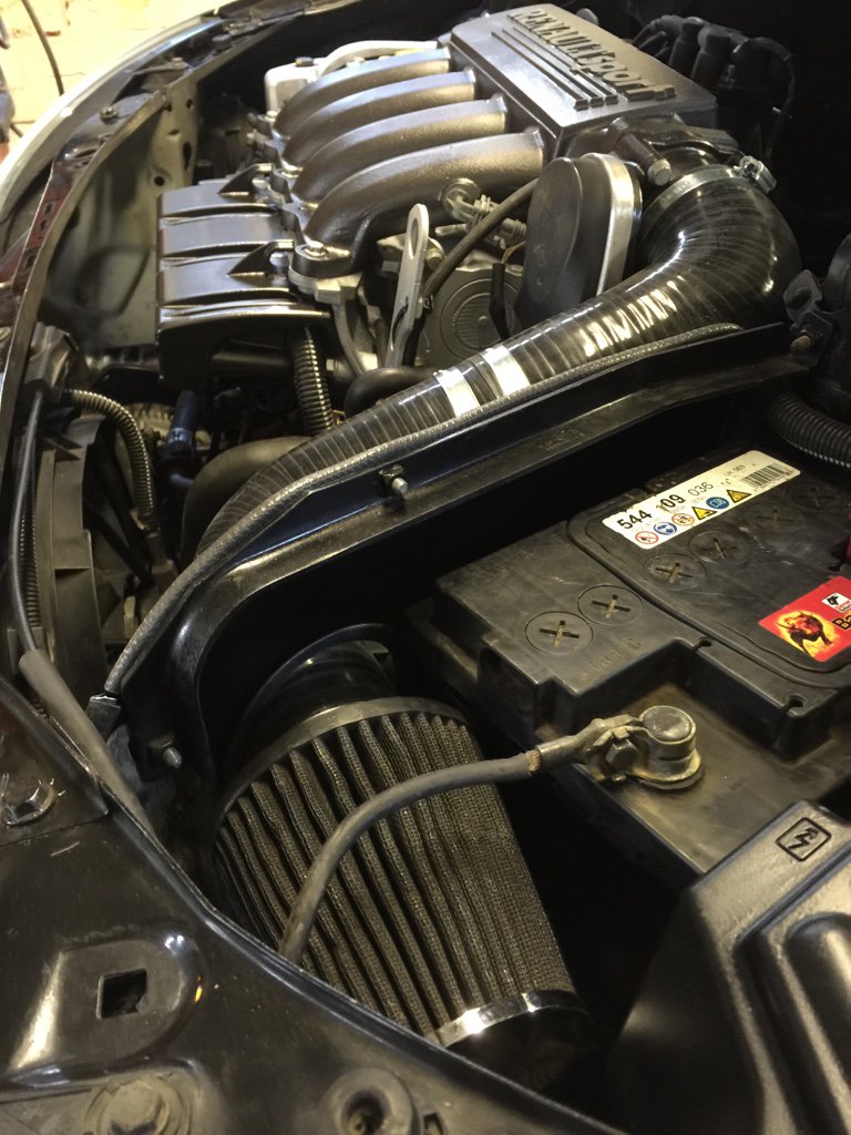

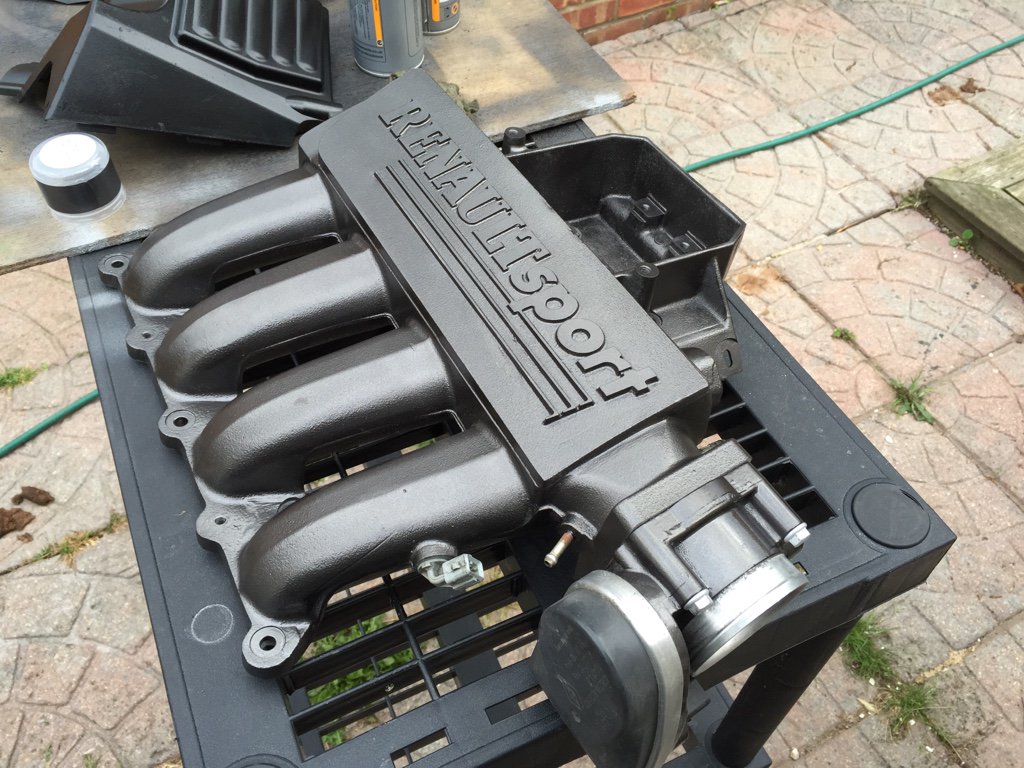

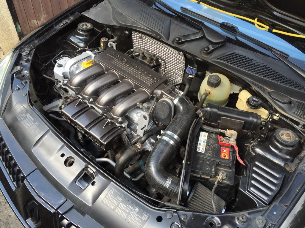

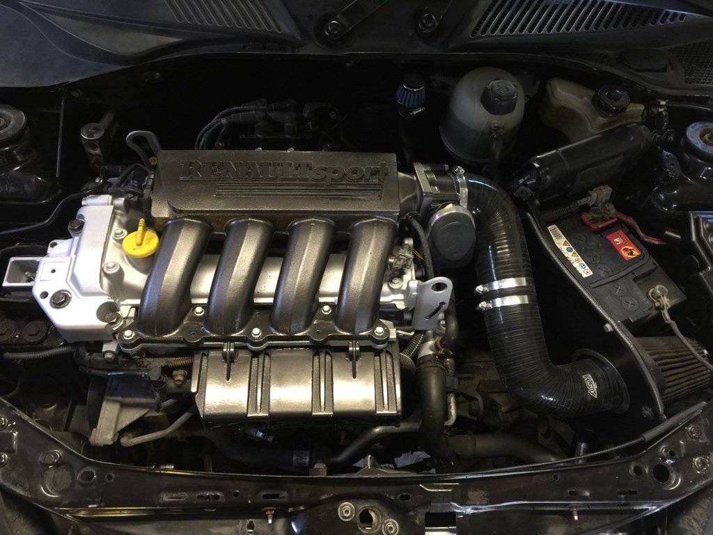

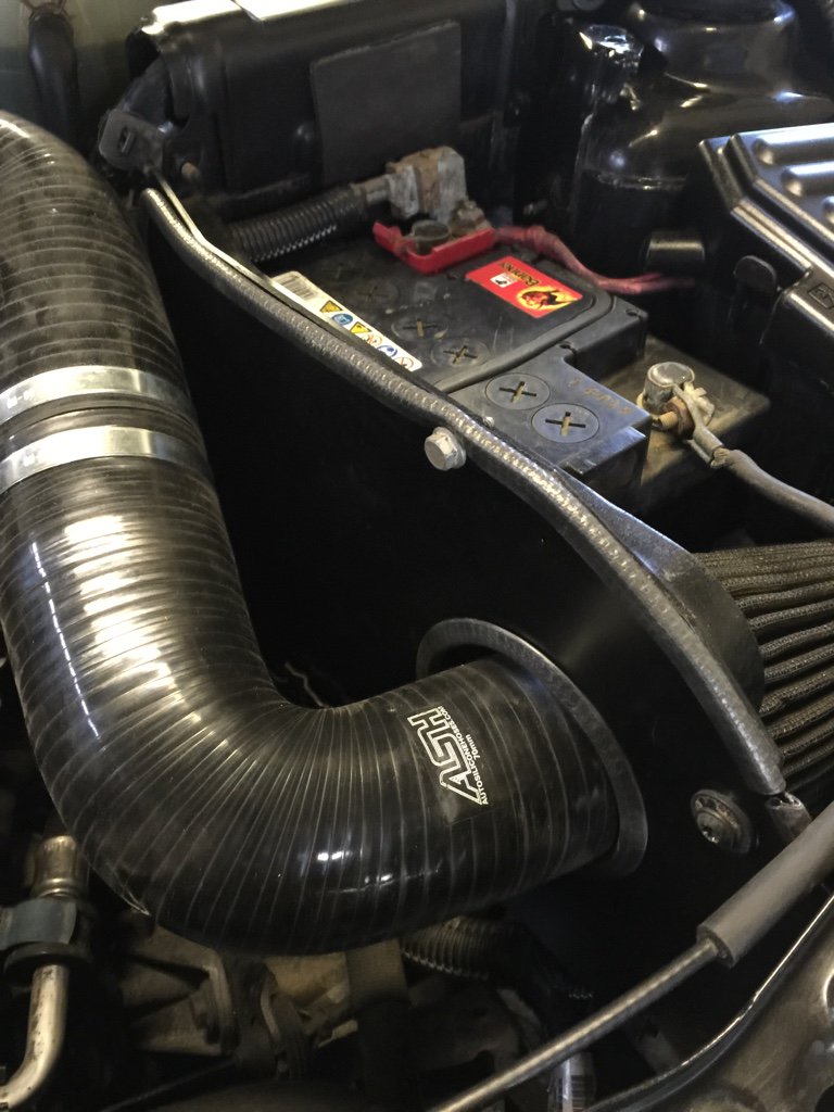

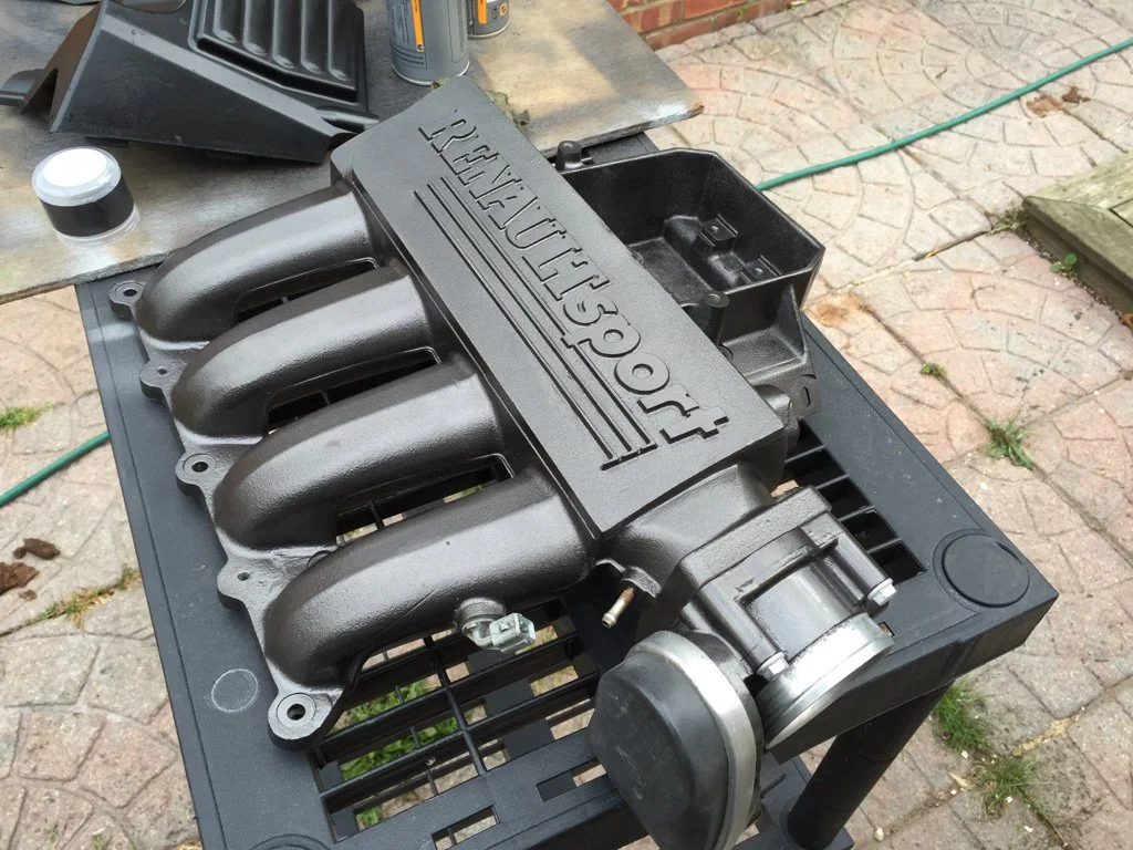

Over the last few weeks I've gathered some bits to refresh and clean up the engine bay which I'm going to start this weekend

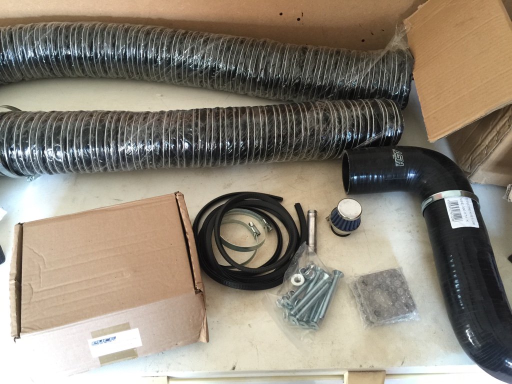

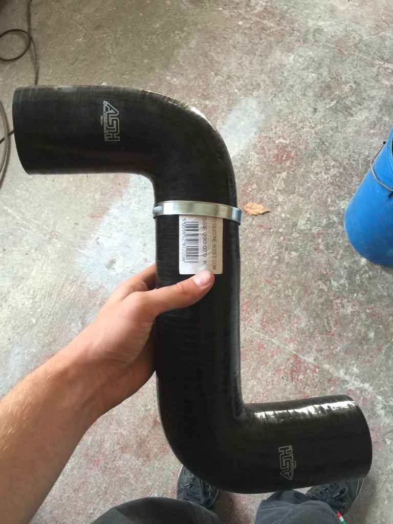

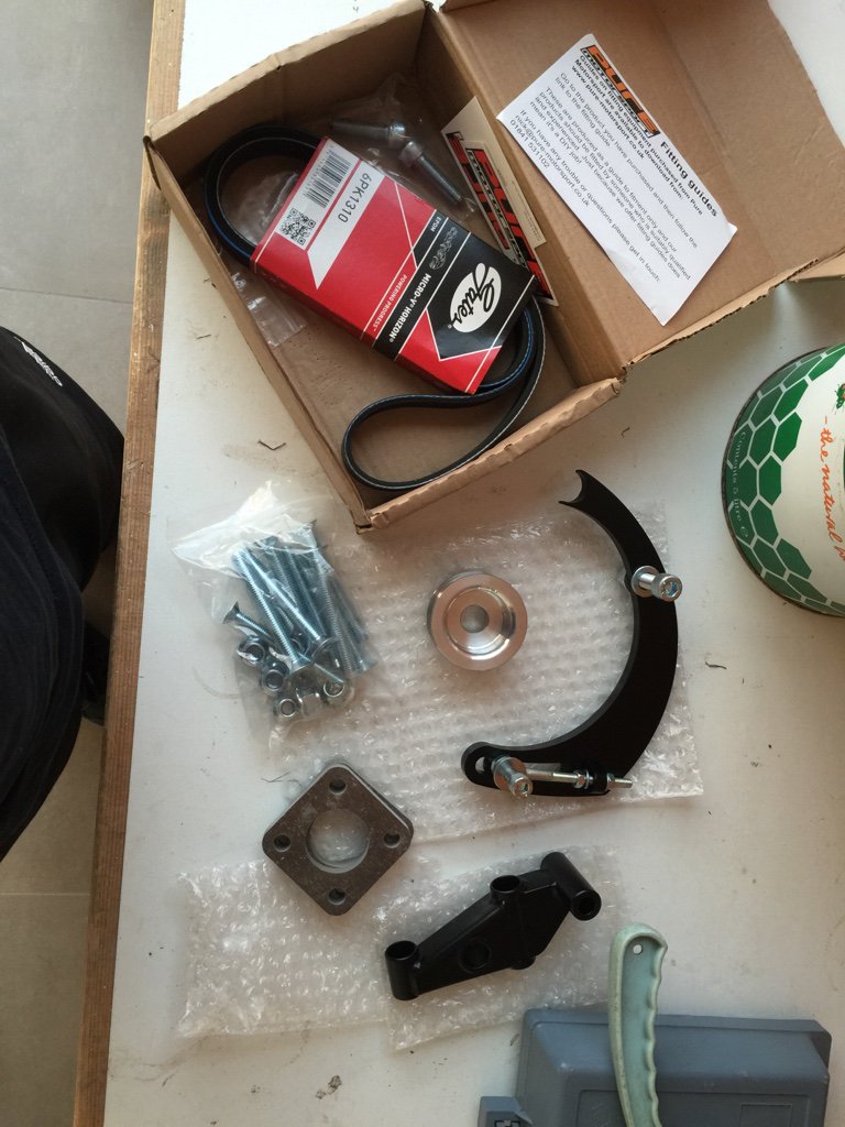

Going to make a ktec style induction kit
Also bought the PMS air-con delete kit and rear stud axle spacers
Lastly I'm going to make up some brake ducts. Bought the ducting and made some deflector plates at work which I hope will work well enough
Still need to get hold of the NS wheel arch so the ducting and be held to it before I can do them

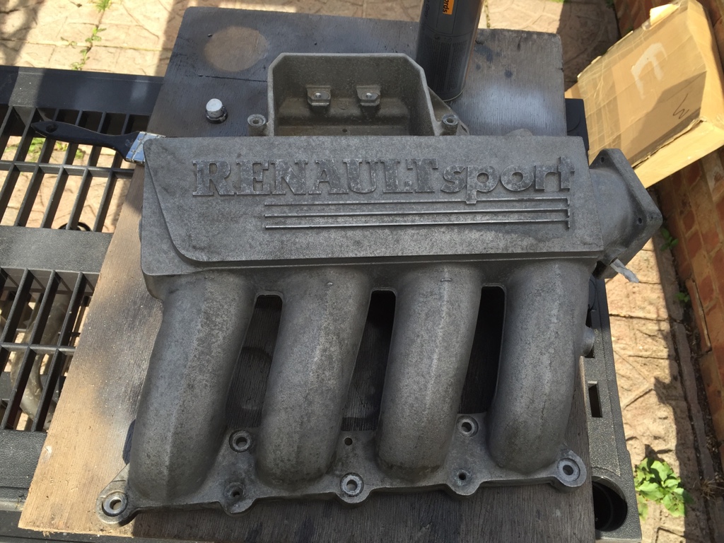

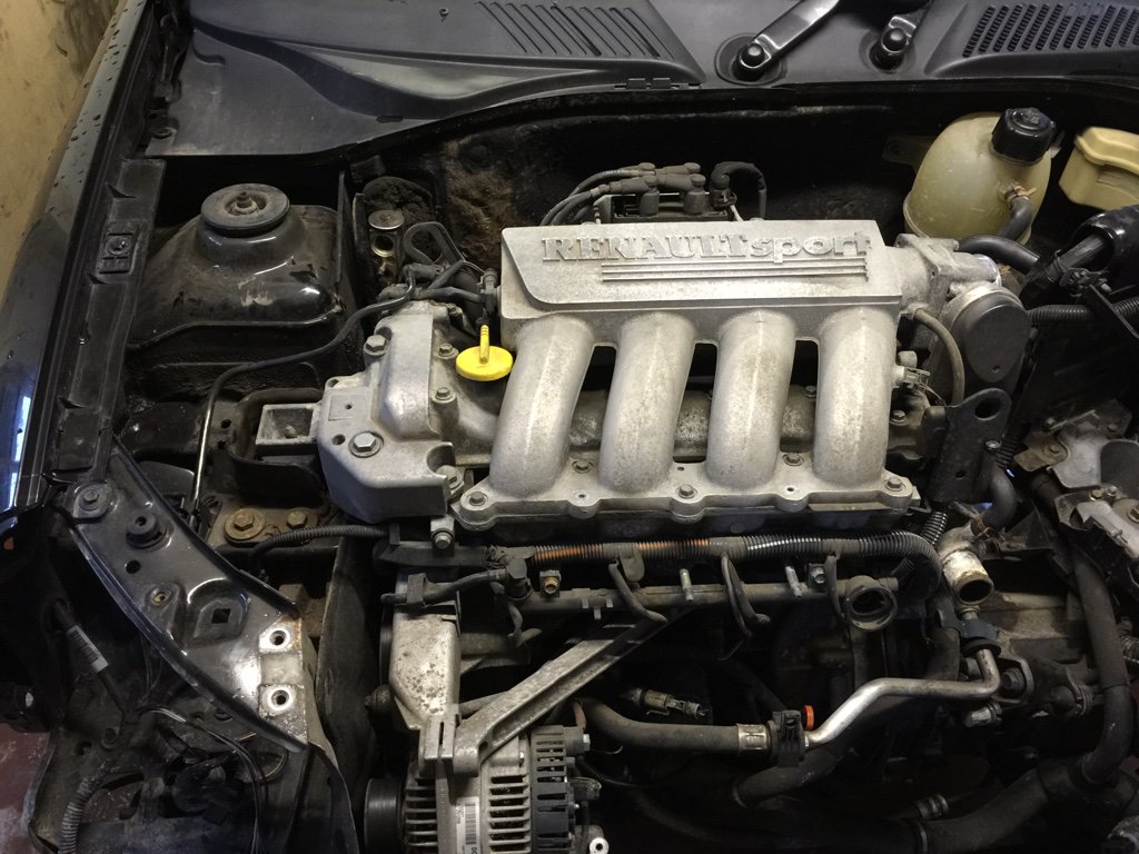

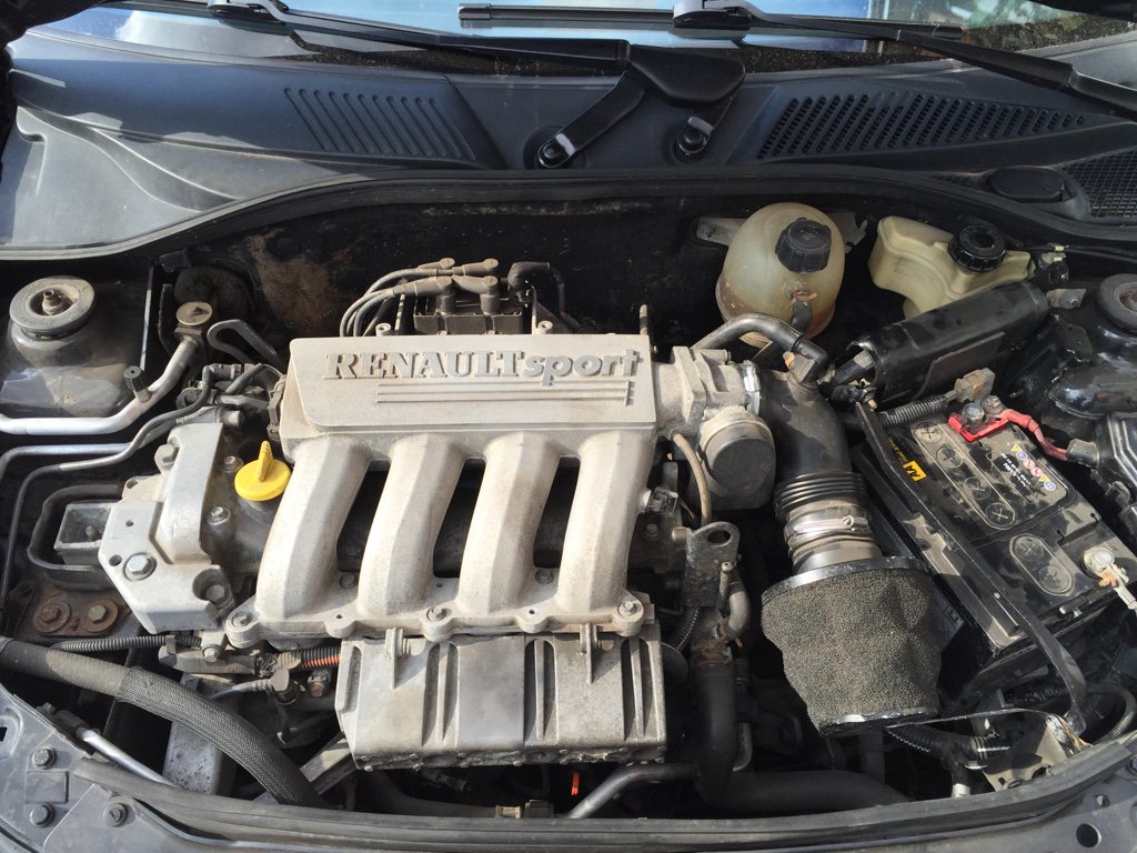

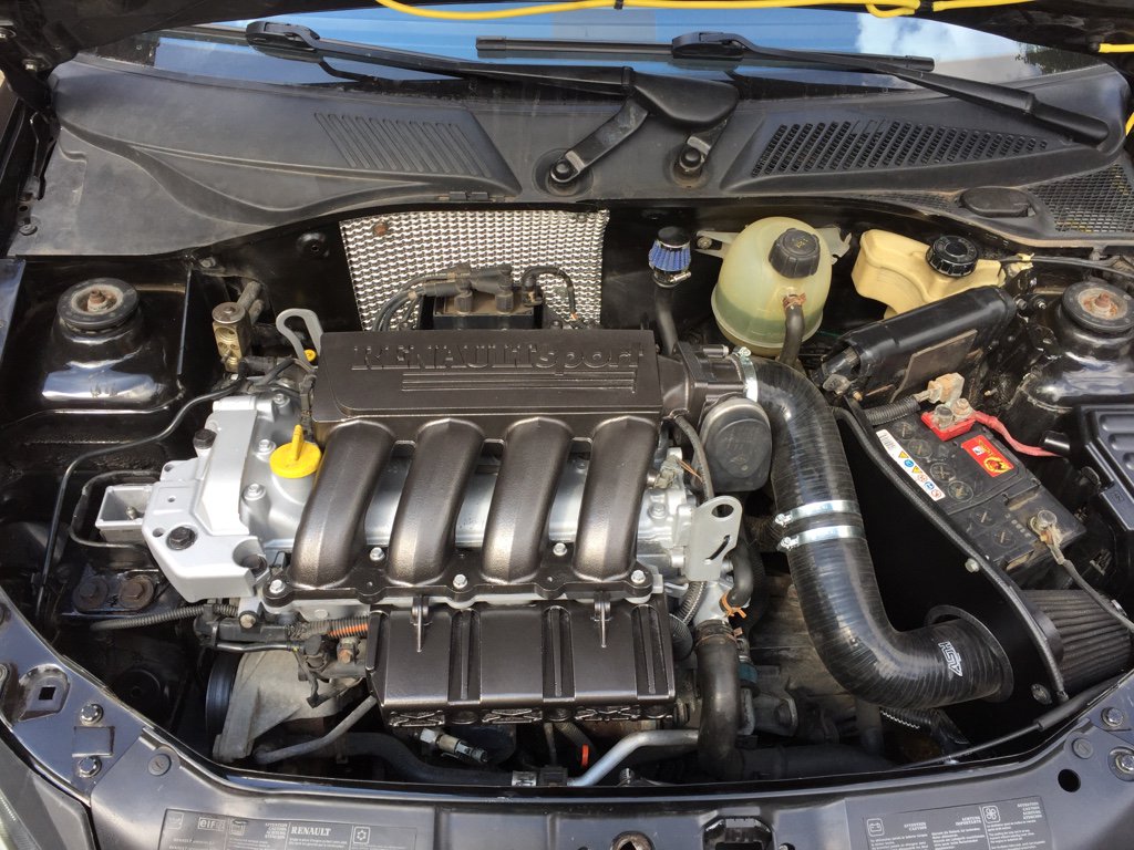

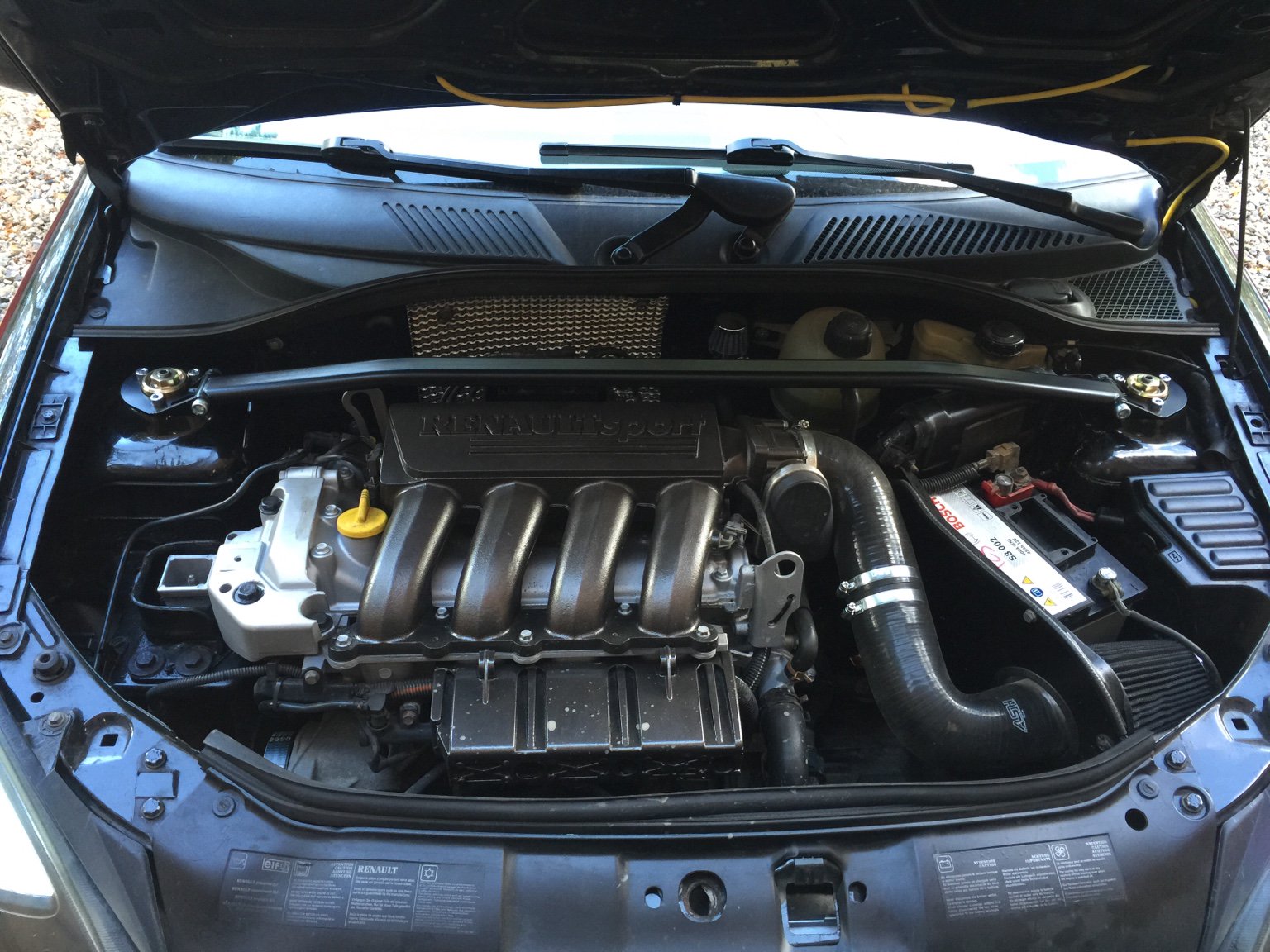

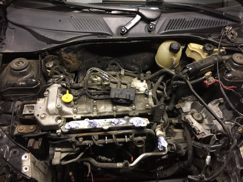

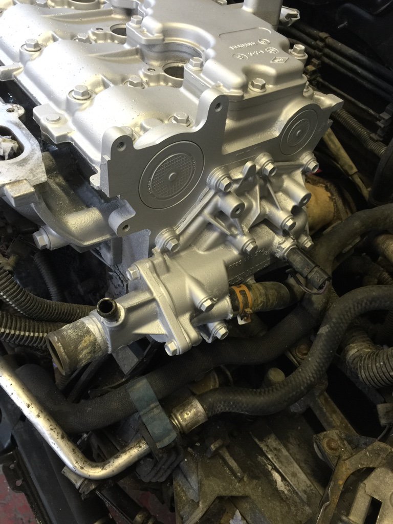

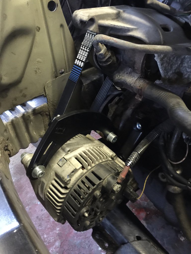

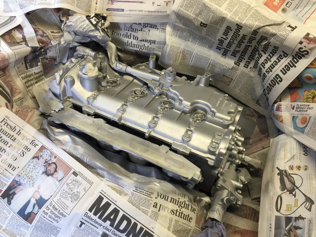

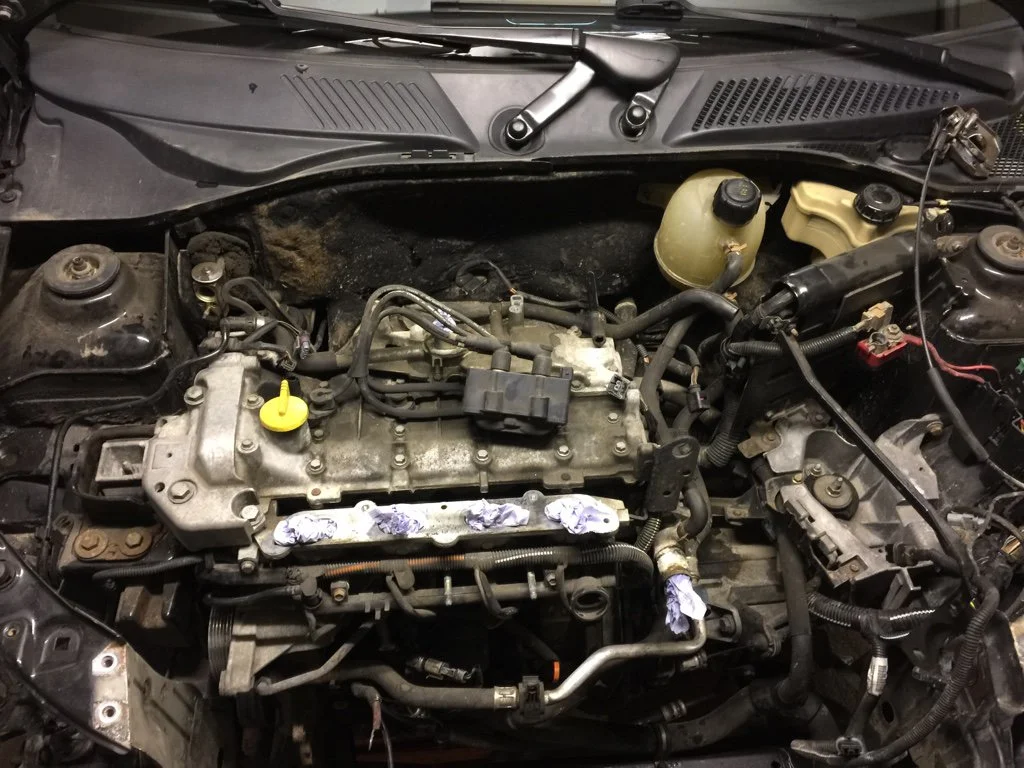

Spent the last week fitting all the bits I got and cleaning the engine up ...
From Before :
Then after ...

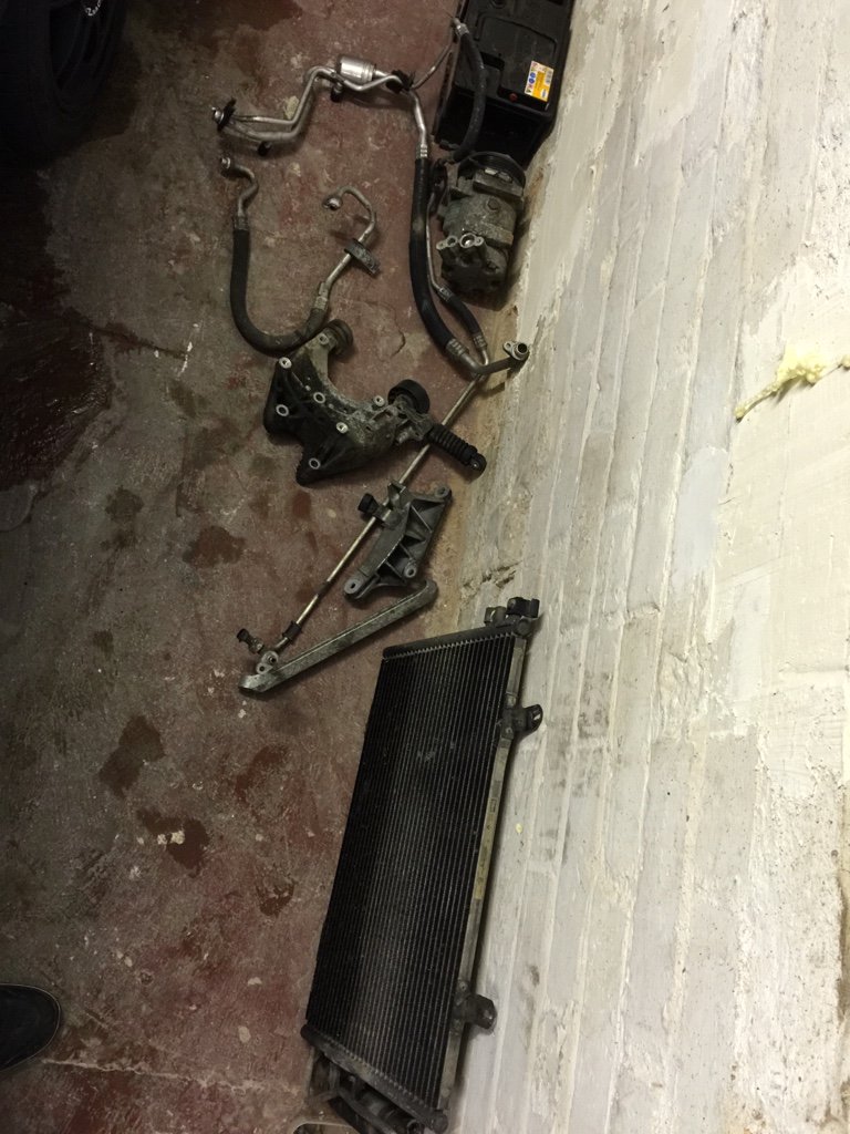

Still got to finish taking out the air con bits from under the scuttle panel but that can be done when I got a little more spare time
This is most of the bits that have now been removed, quite surprised at how much it all weighs ..

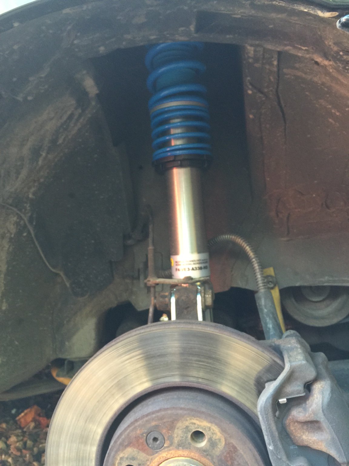

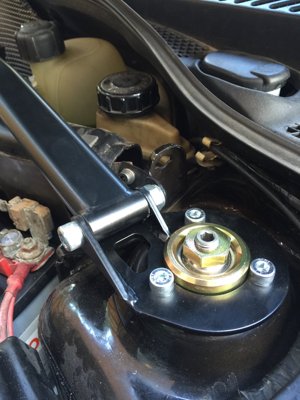

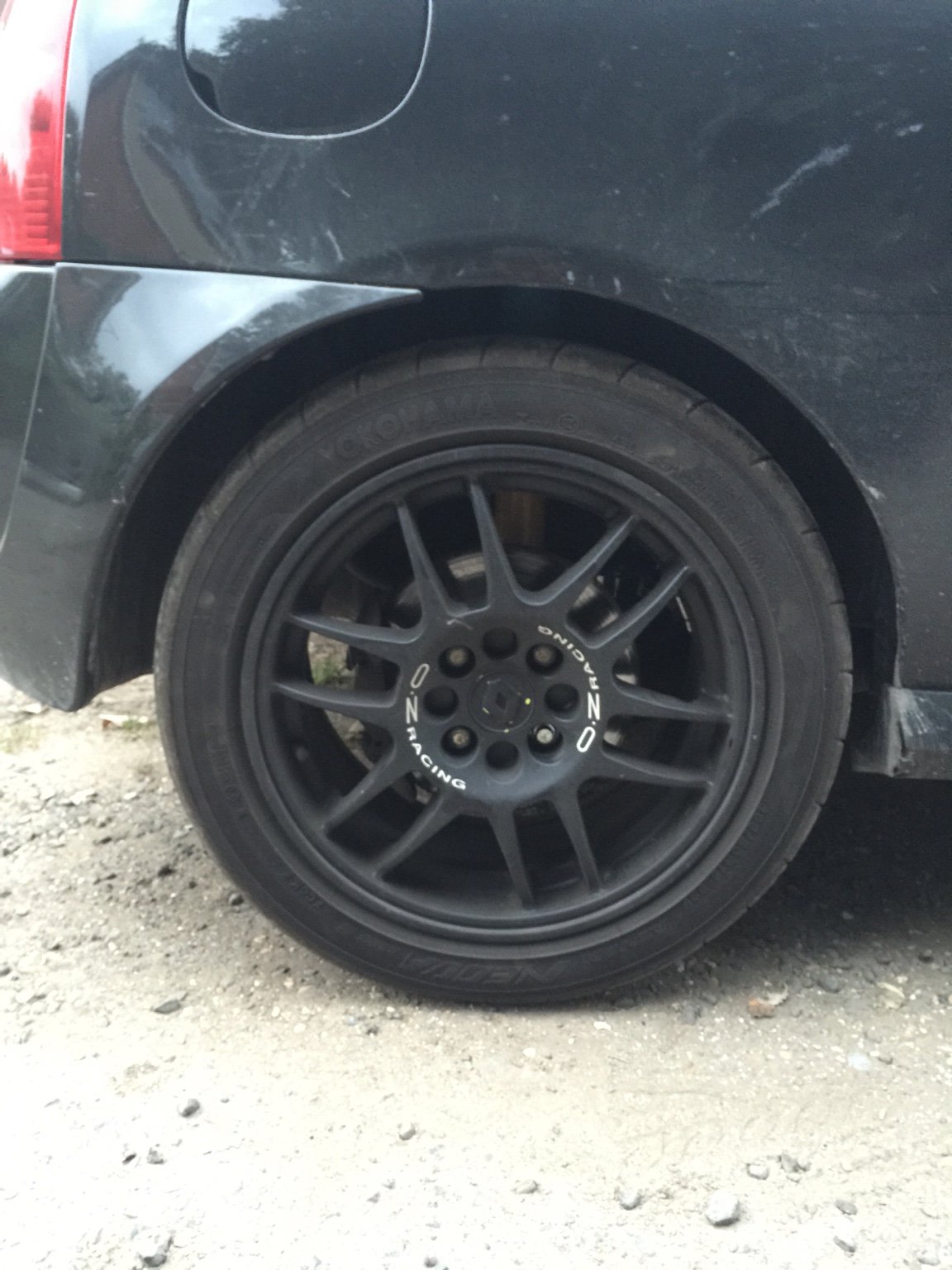

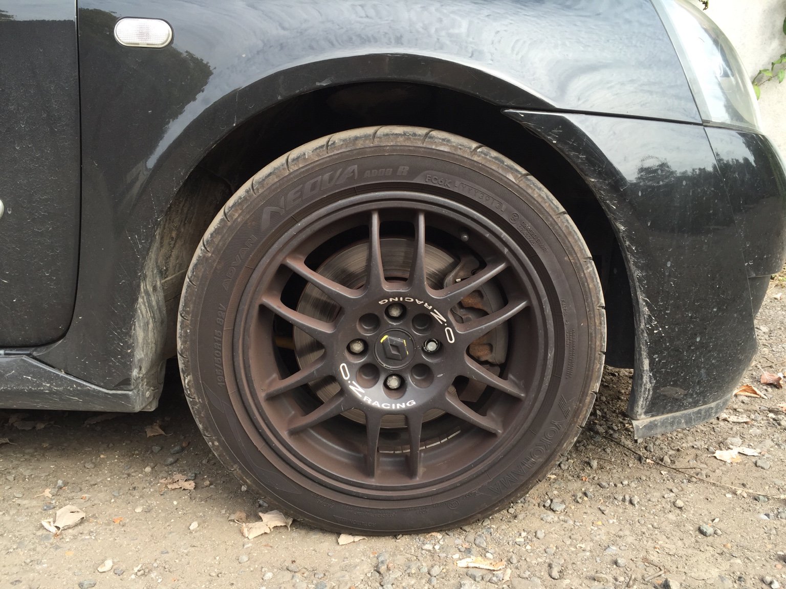

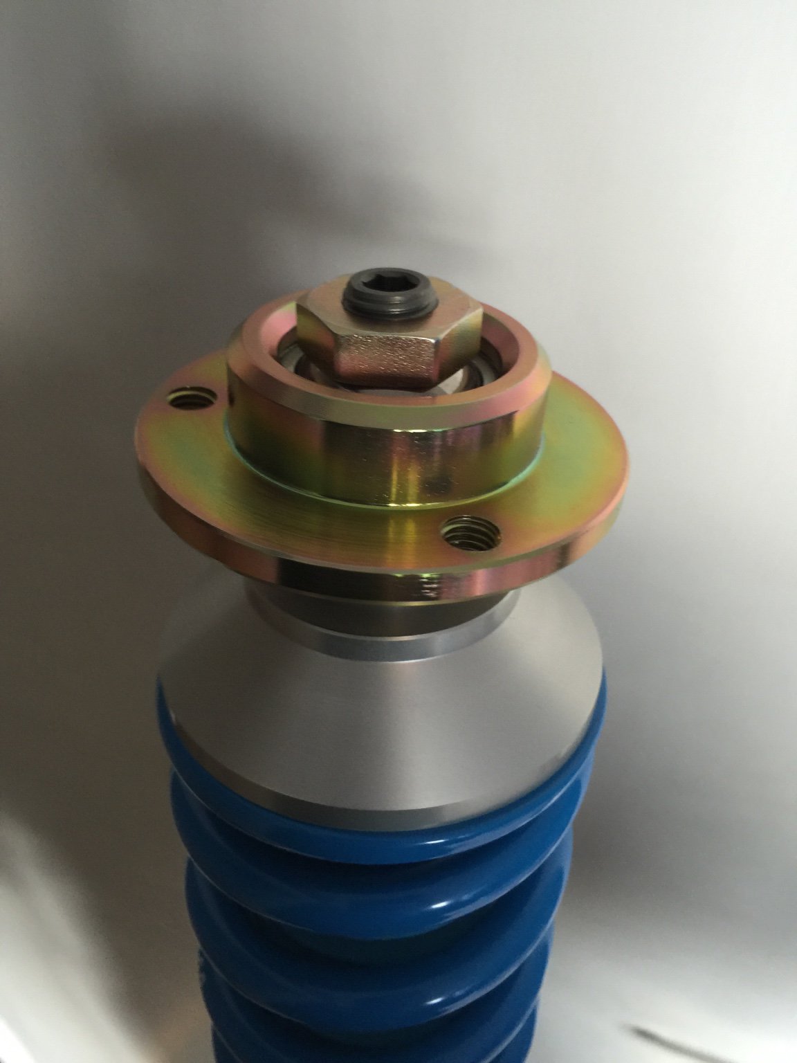

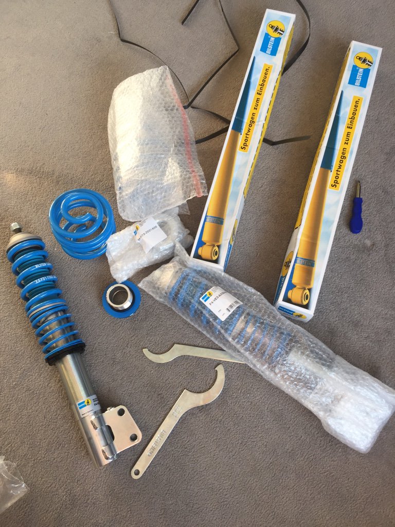

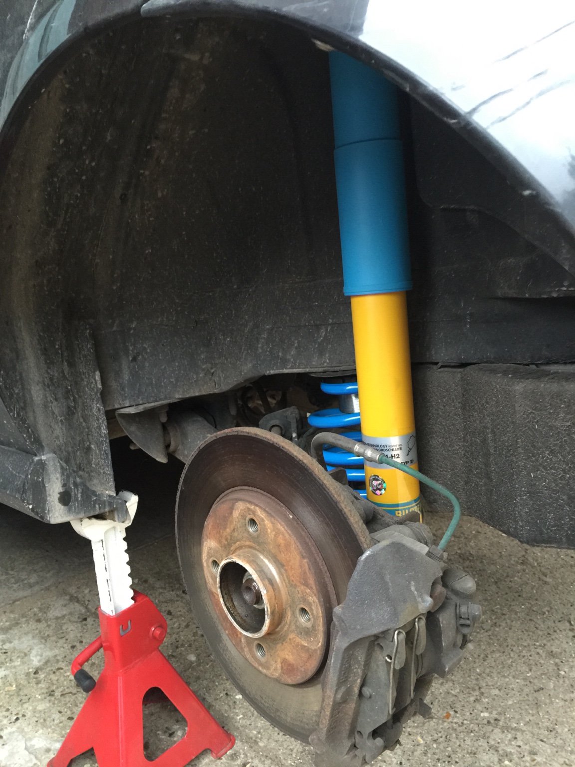

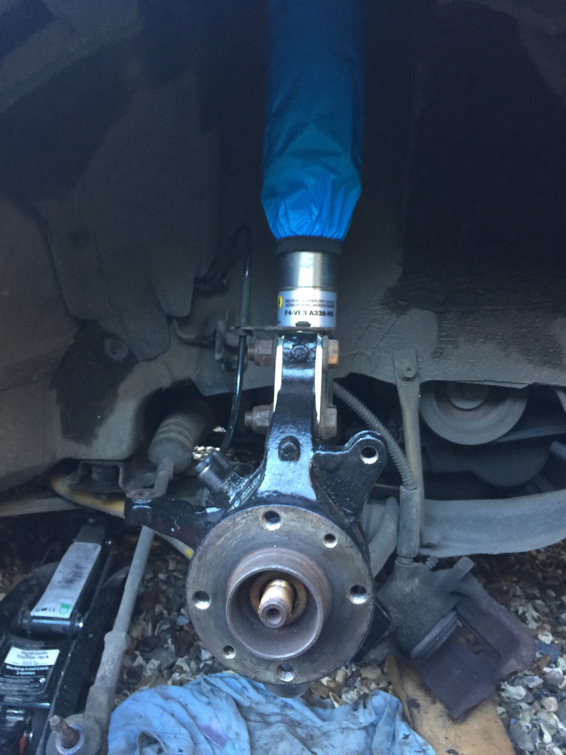

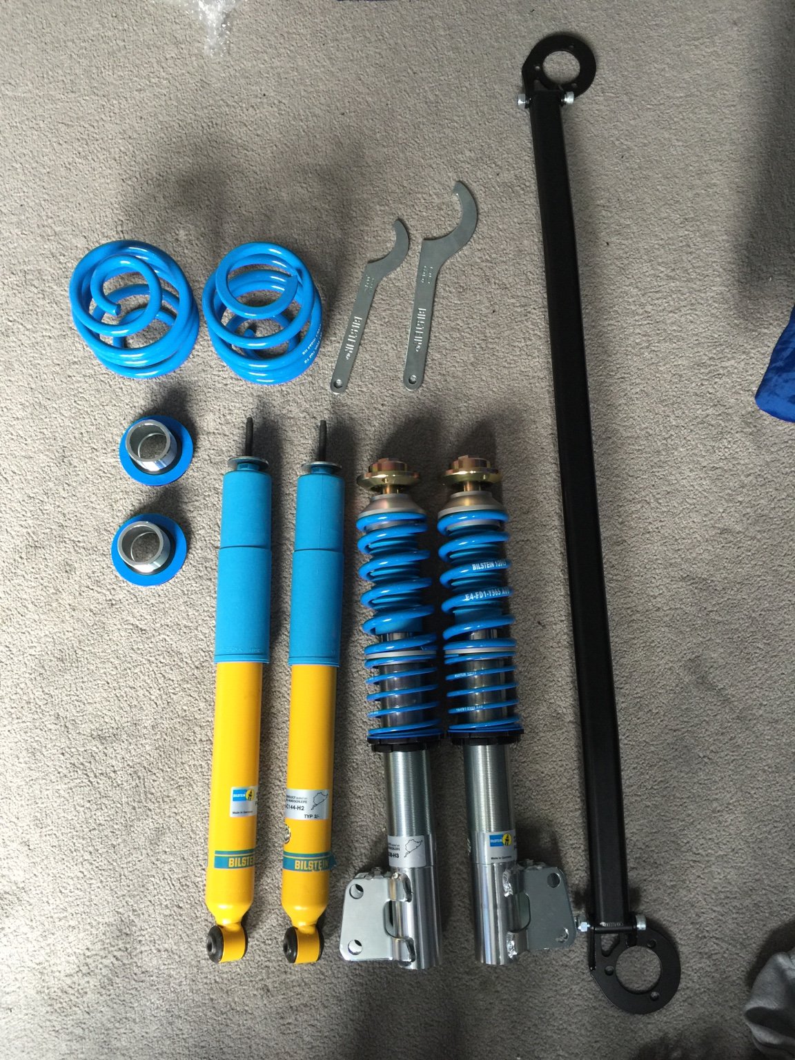

Last weekend I had a Friday off so got the Bilsteins fitted and also the PMS solid top mounts and strut brace.
Then I've spent the last week adjusting them to work out what position is best to have them in
This was before (I know the car needs a clean :L)
Rears
Fronts
I started on the rears first as I knew it would take a lot less time. Before and after:
The picture does actually make it look higher then it looks in person but I'm going to remove the rubber bits between the spring to lower it a tad more as it still needs it.

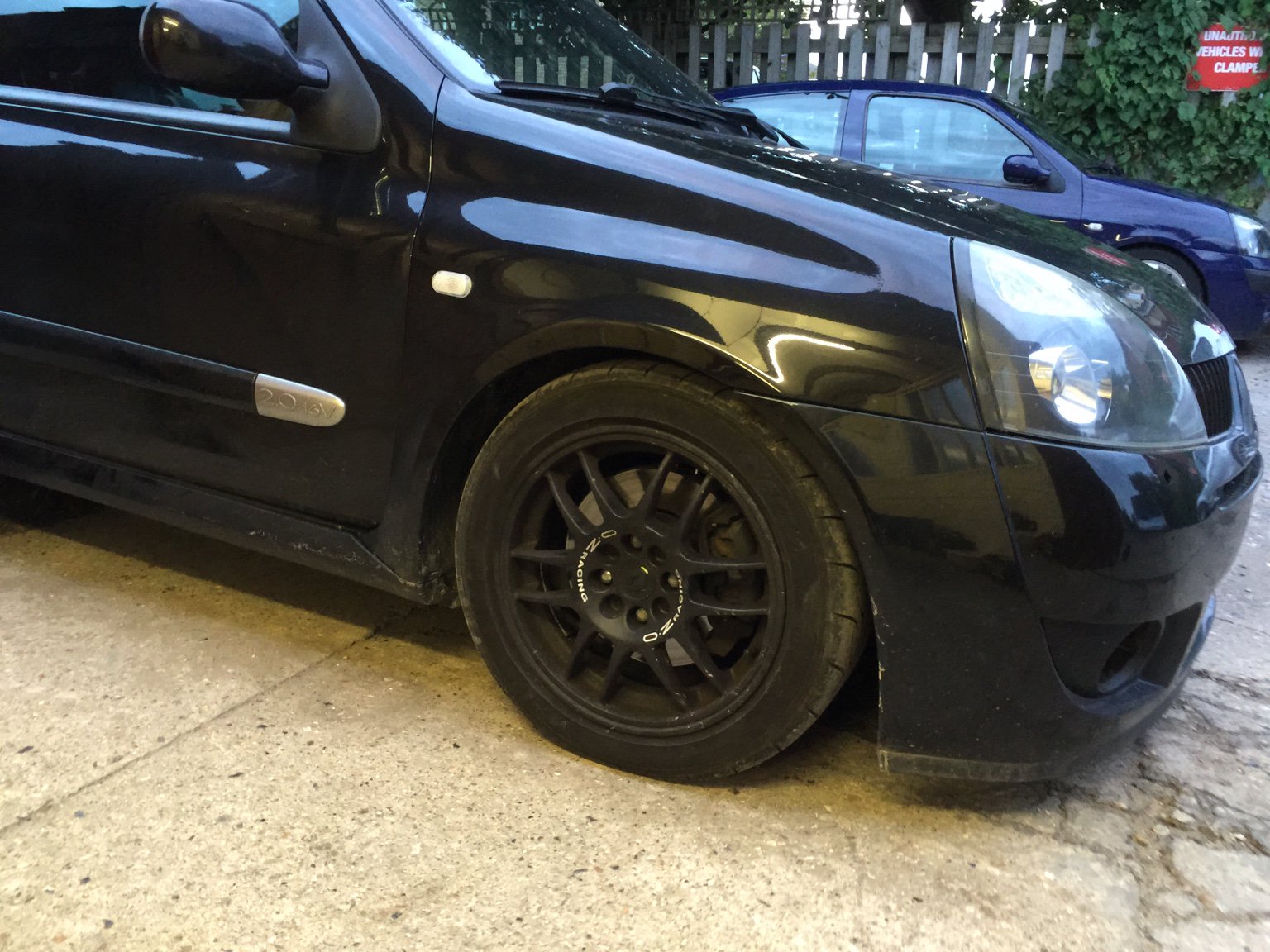

Next I cracked on with the fronts and the PMS top mounts.

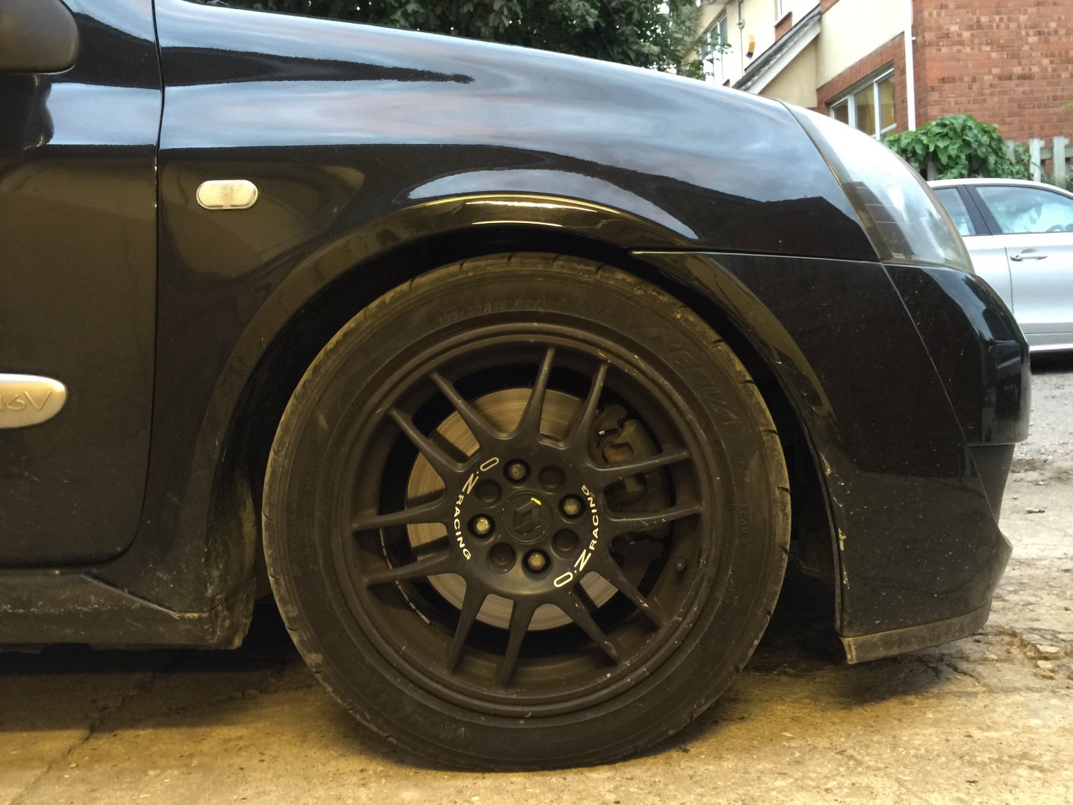

Then this is at the height it's set to at the moment, may need to raise it a little again as the arch liners rub abit on hard cornering.

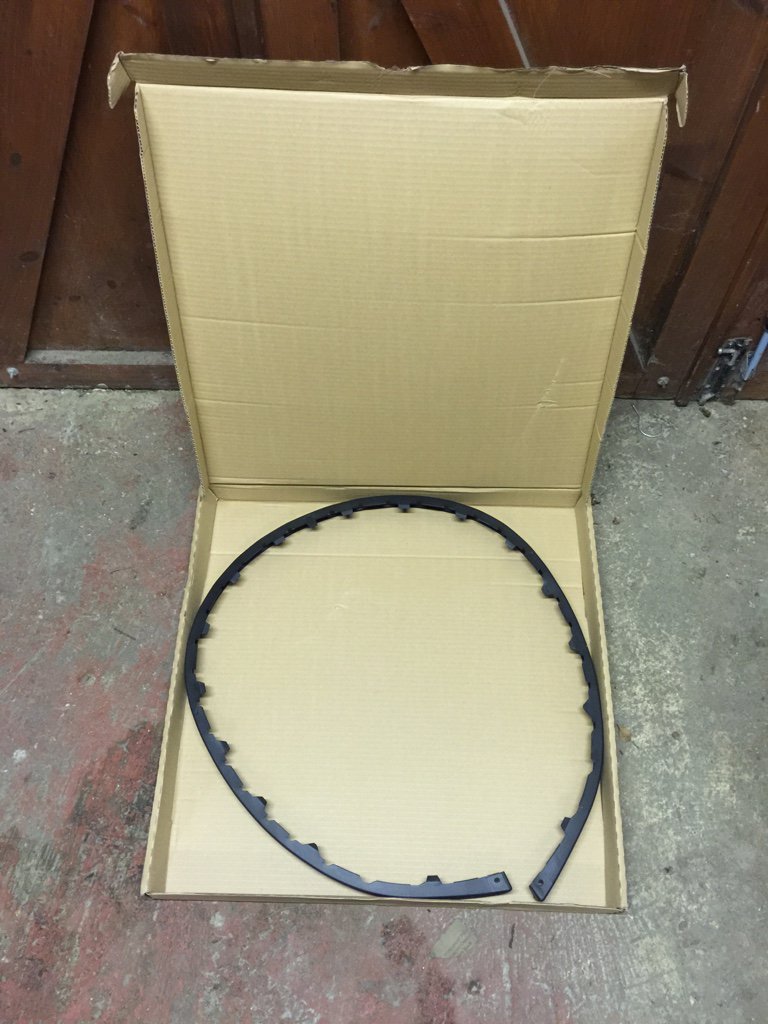

Where did you get the aly from? All the stuff I've found on the net seems quite expensive.
I just had it lying about in the garage no idea where I got it
Can't remember the size of what you need
I'll check and have a quick look if I get a minute today

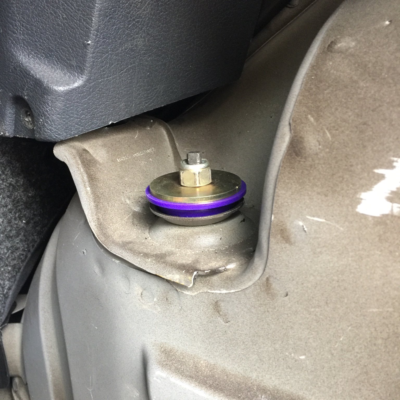

I spent some time realigning the exhaust as it vibrated on a heat shield now an then.

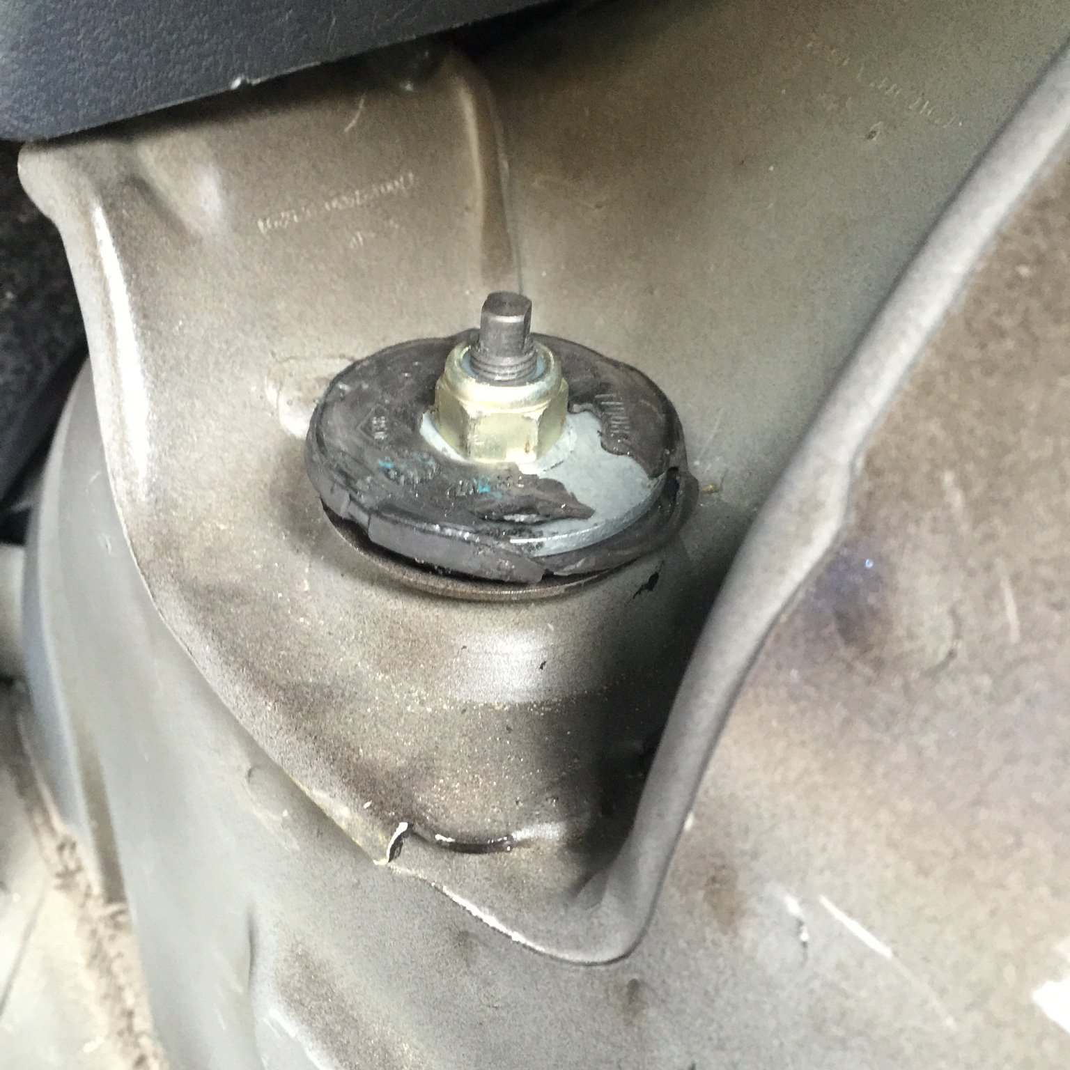

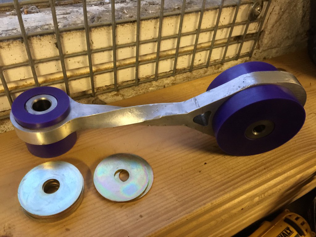

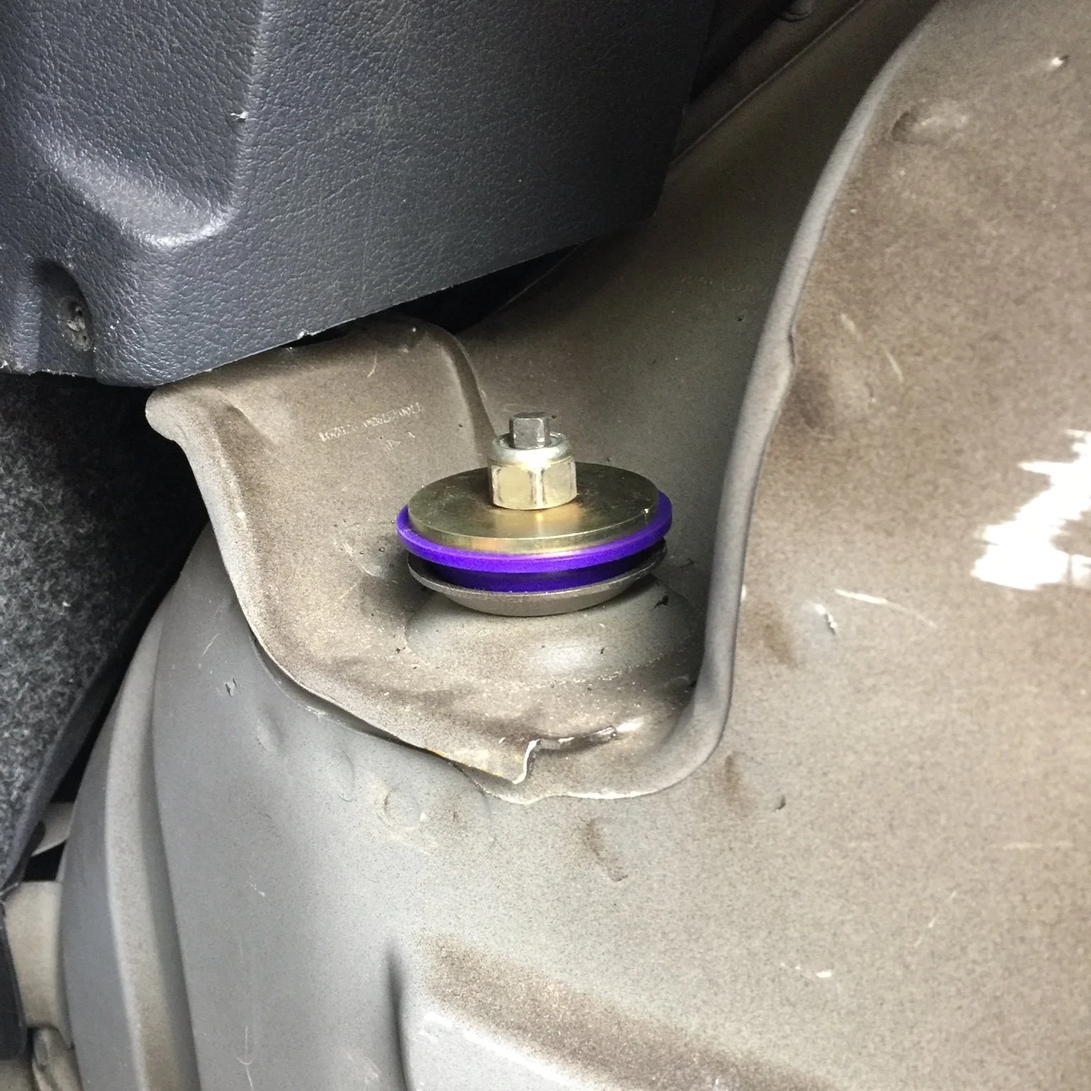

Also fitted some Powerflex rear shock bushes . As the old ones seemed to have the plastic falling away
Old
New

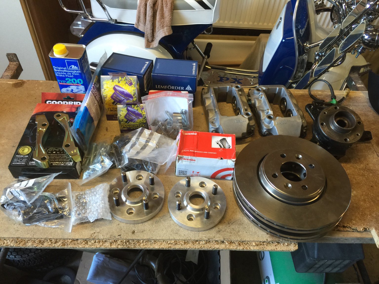

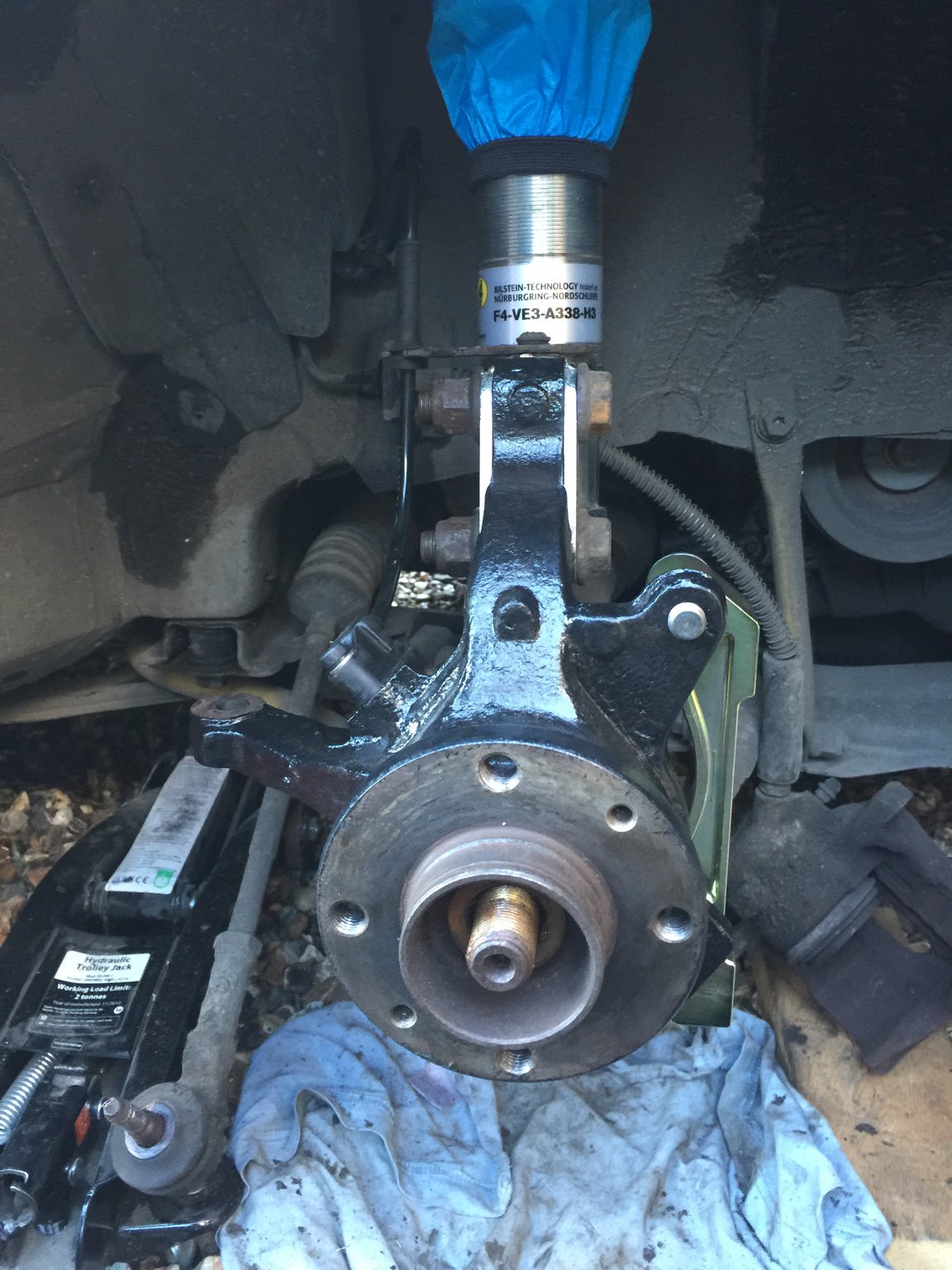

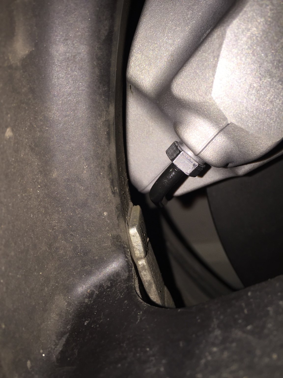

Over the last few weeks I have been collecting even more bits for a front end refresh to fit over Christmas while I'm off from work
I have now got new, ball joints, eibach camber bolts and Powerflex steering rack bushes and the new top engine mount they do

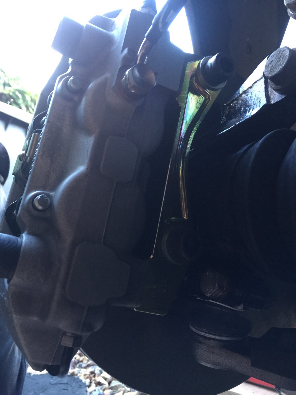

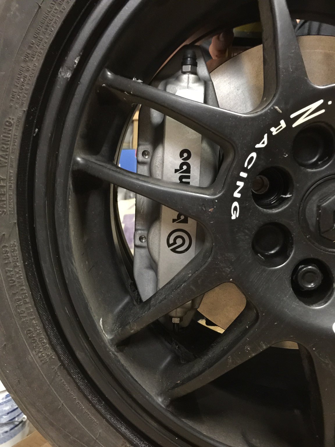

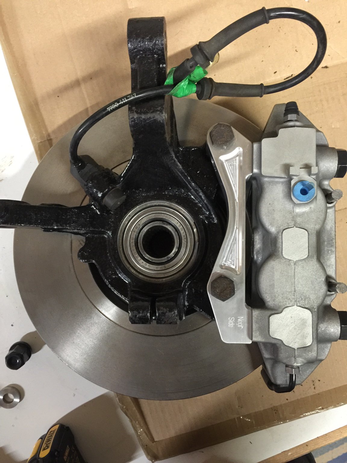

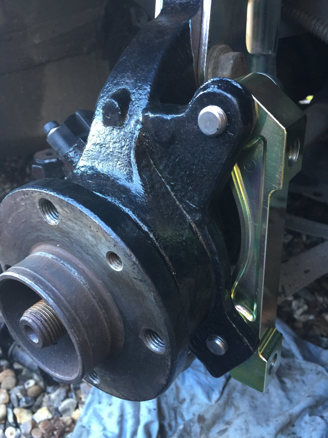

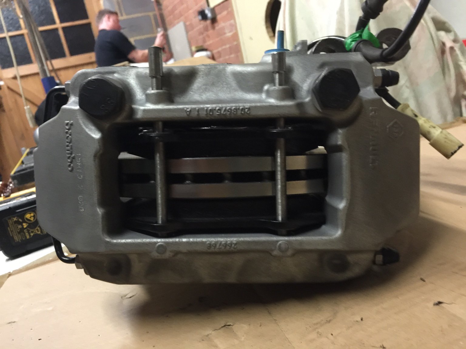

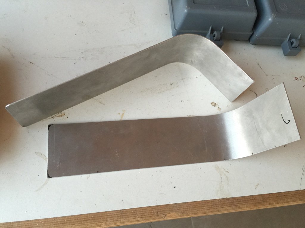

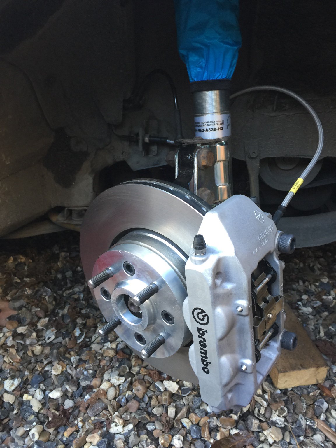

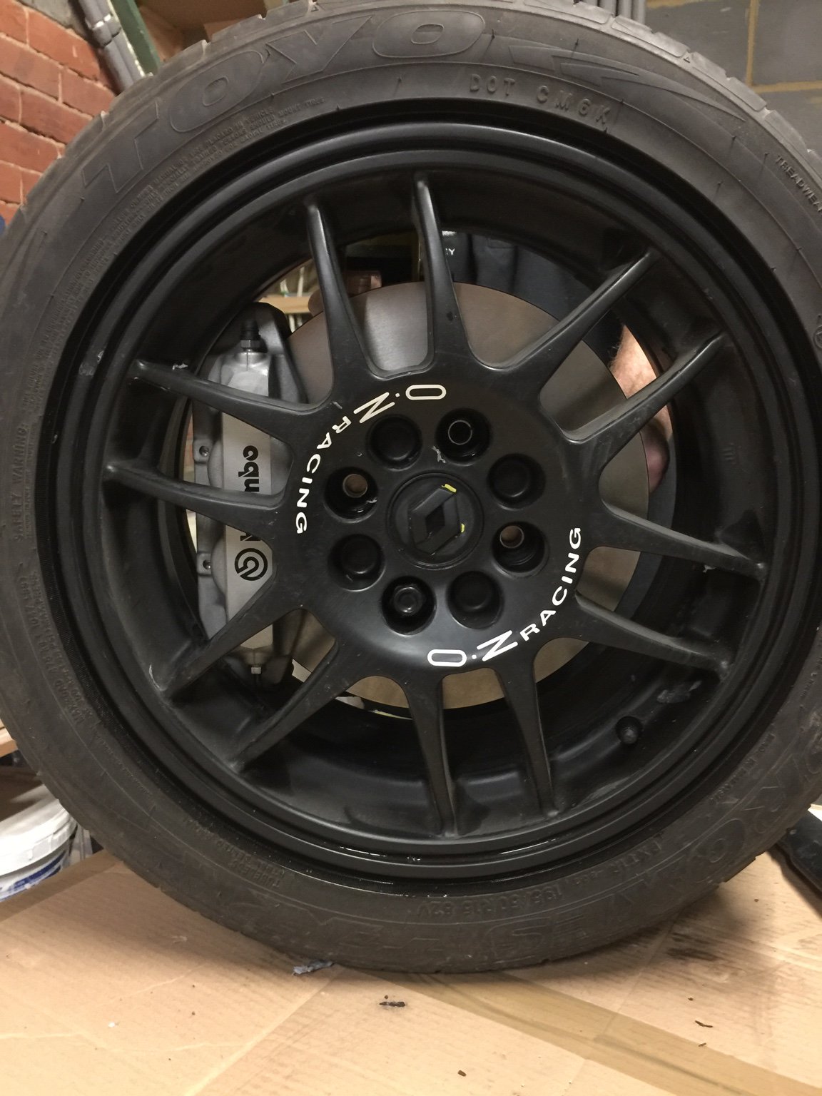

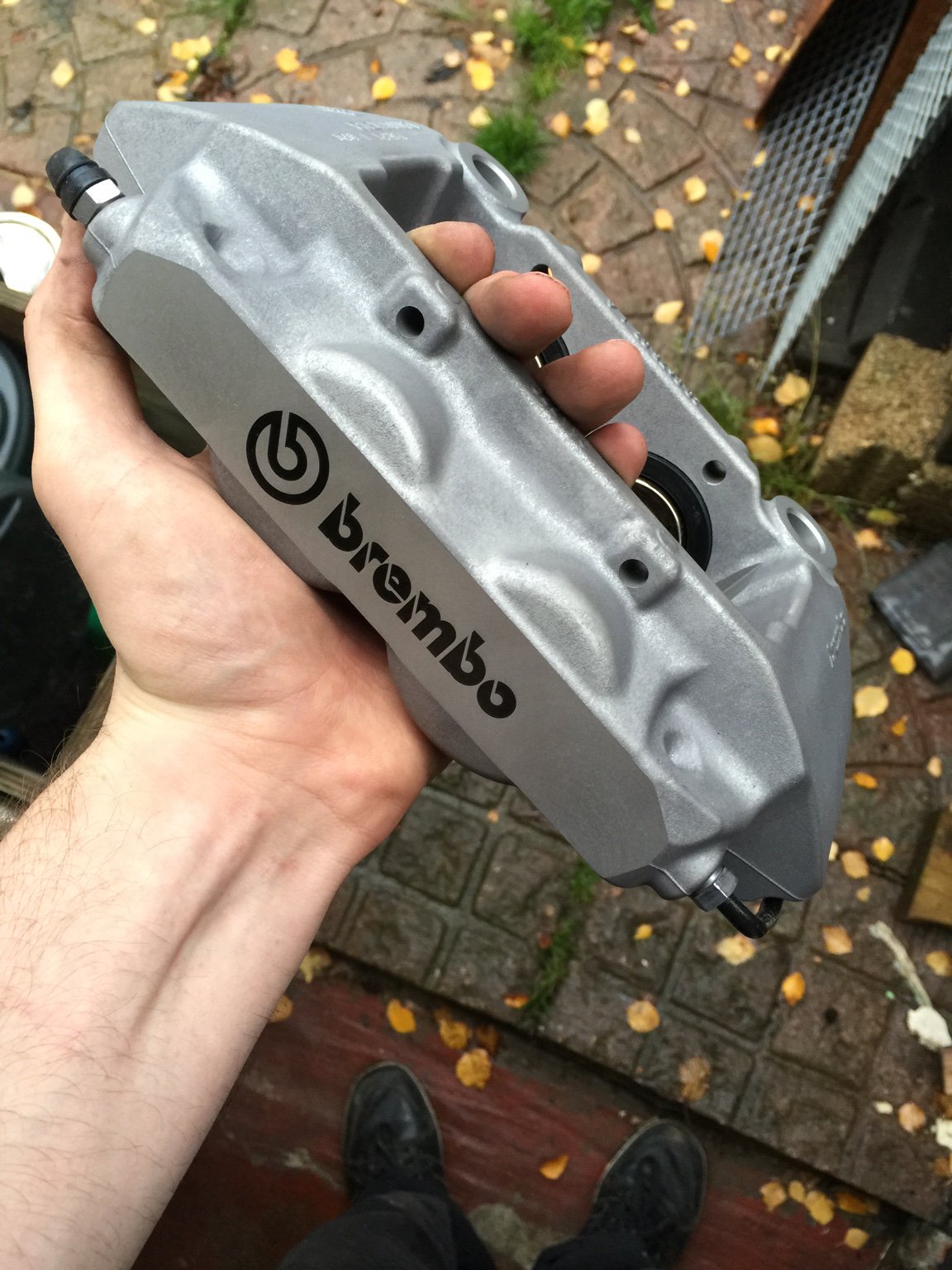

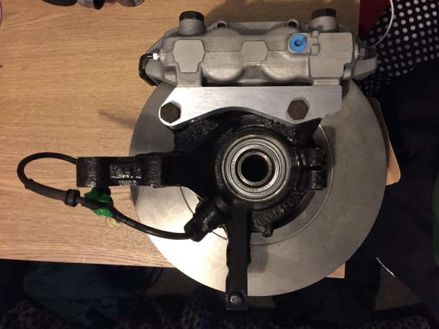

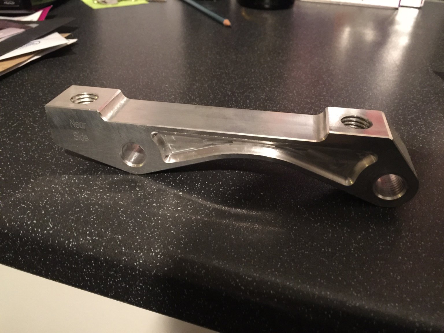

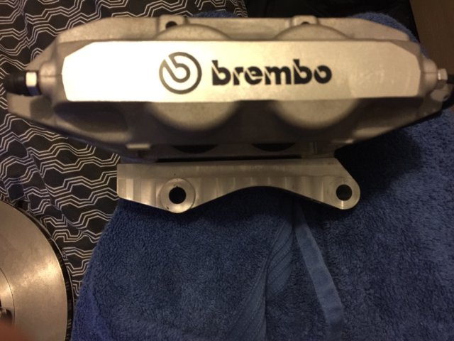

I have also been collecting and making bits for the brembos over that past week when I've had a bit of spare time

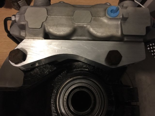

The challenge was to get them under the o.z f1s with minimal machining to the callipers
I have managed to do it with no machining to the calliper but relocated the hole on the hub and made a bracket to suit.

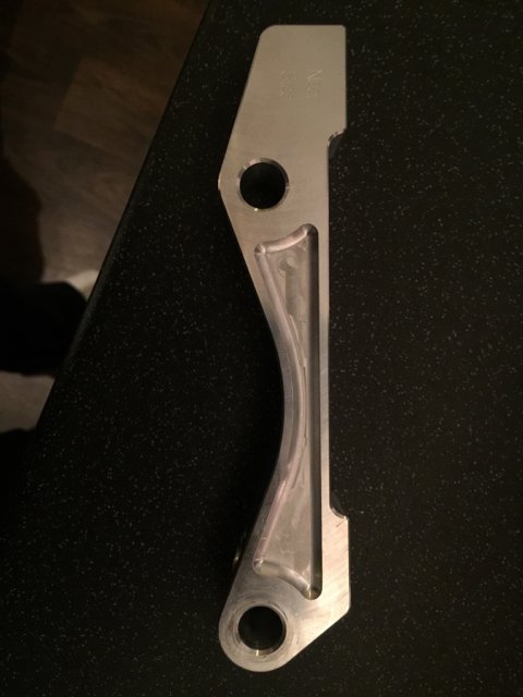

This is my first off which I made to prove and check it fitted in the wheel.
I then made another while updating what I needed to make it fit better and have the calliper in a slightly better position

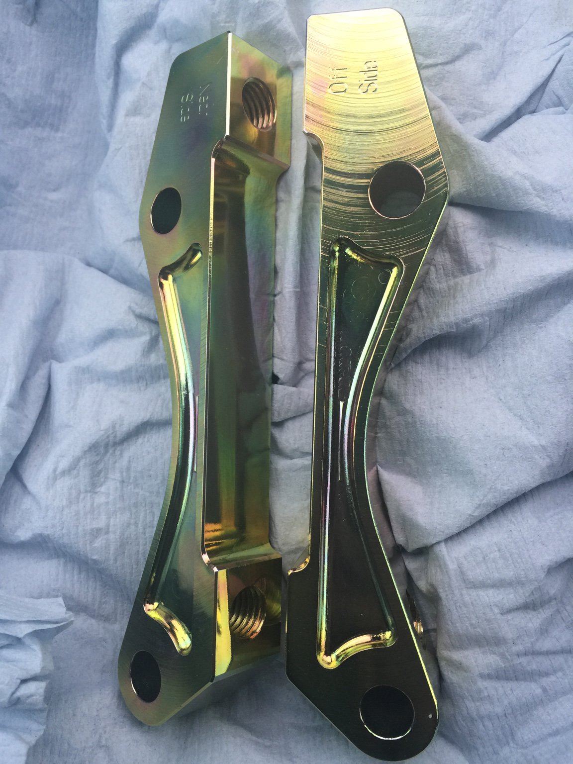

This was the final design in Ali and have made the final ones that will be used out of steel for strength.
The steel ones are now off to be zinc coated to prevent rusting

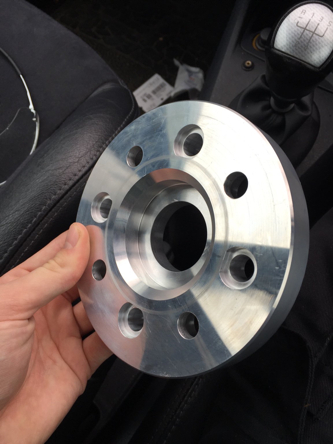

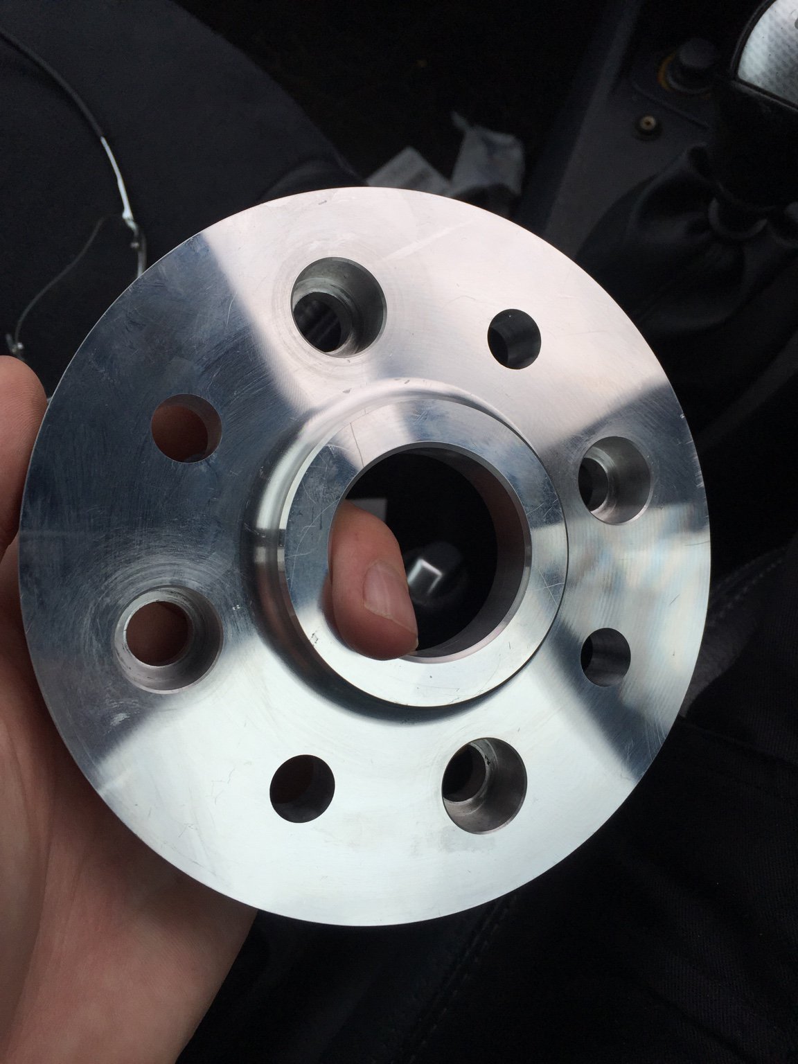

Then I also made 19mm spacers as that's what I needed to space the wheel away enough to give clearance.

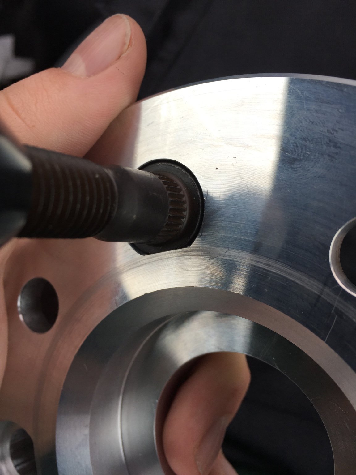

I will be pressing in ford studs in through the back too to make a stud conversion.
Then when it's all fitted this is what it will look like
The calliper has about a 1-1.5mm of clearance from the slope bit inside the wheel.
The final bits I need should be delivered soon which are braided lines and fluid then I Hope to fit all of it over Christmas
Thanks for reading
Robbie

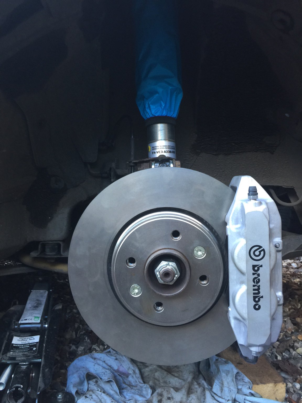

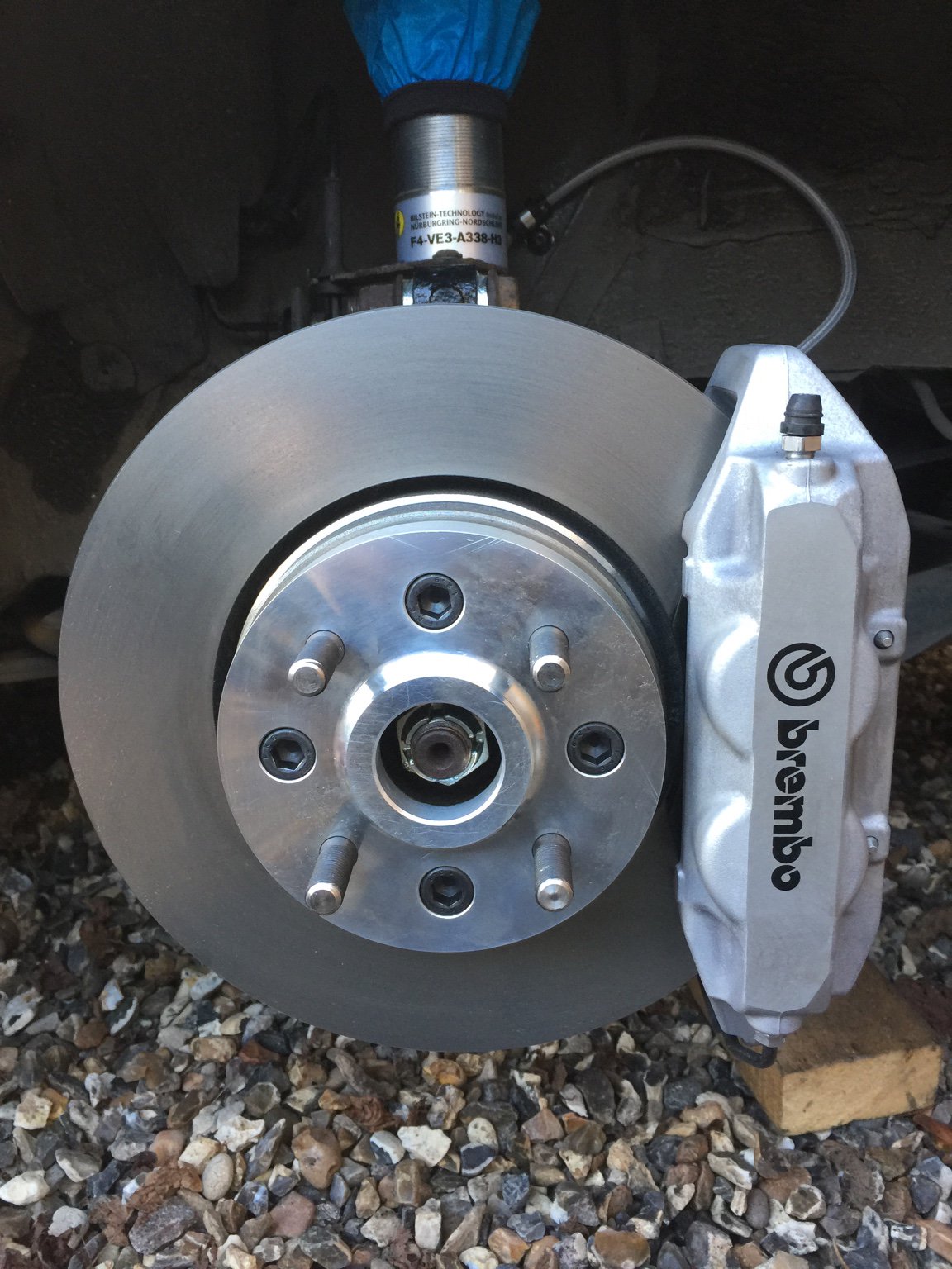

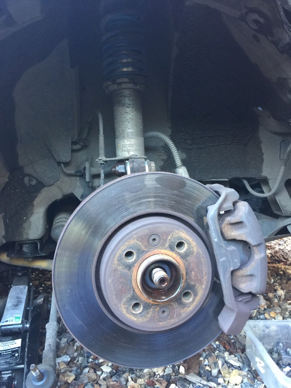

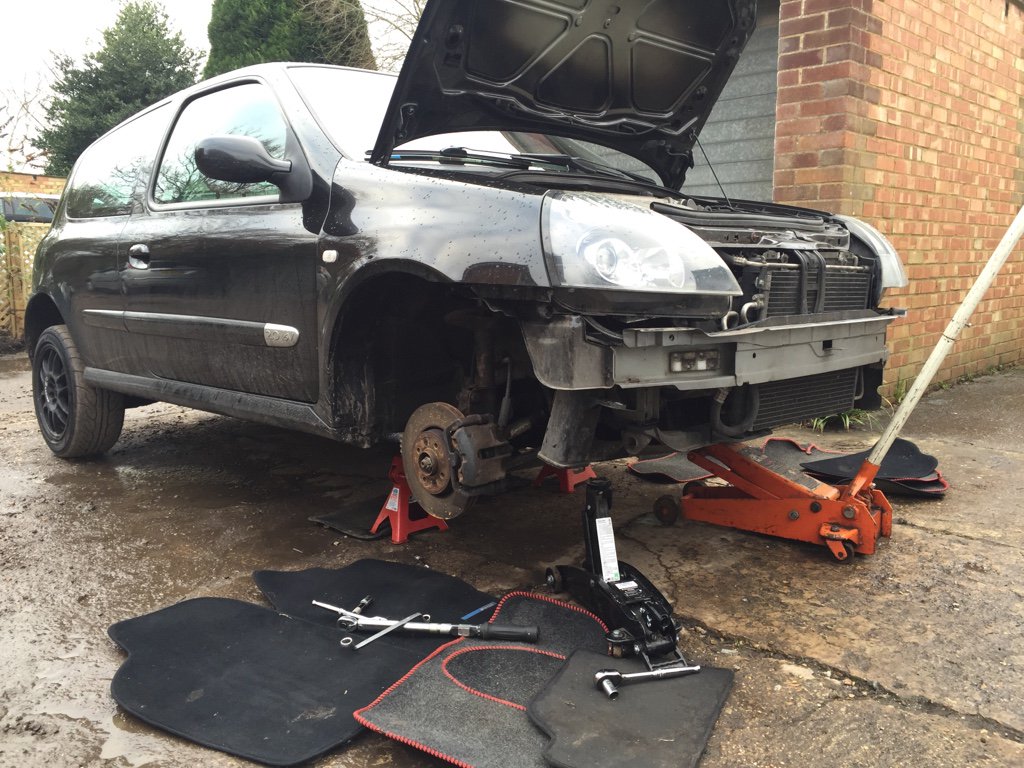

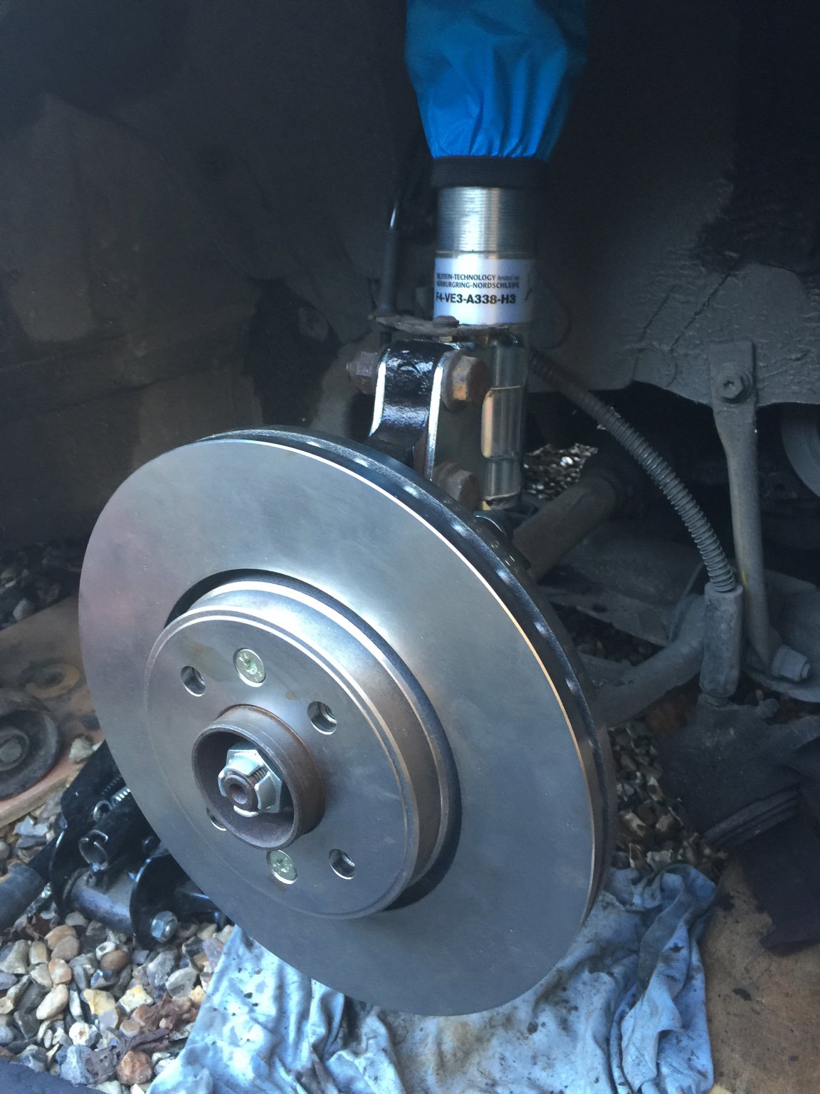

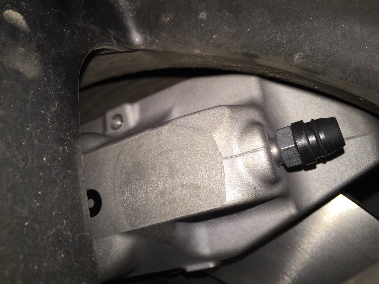

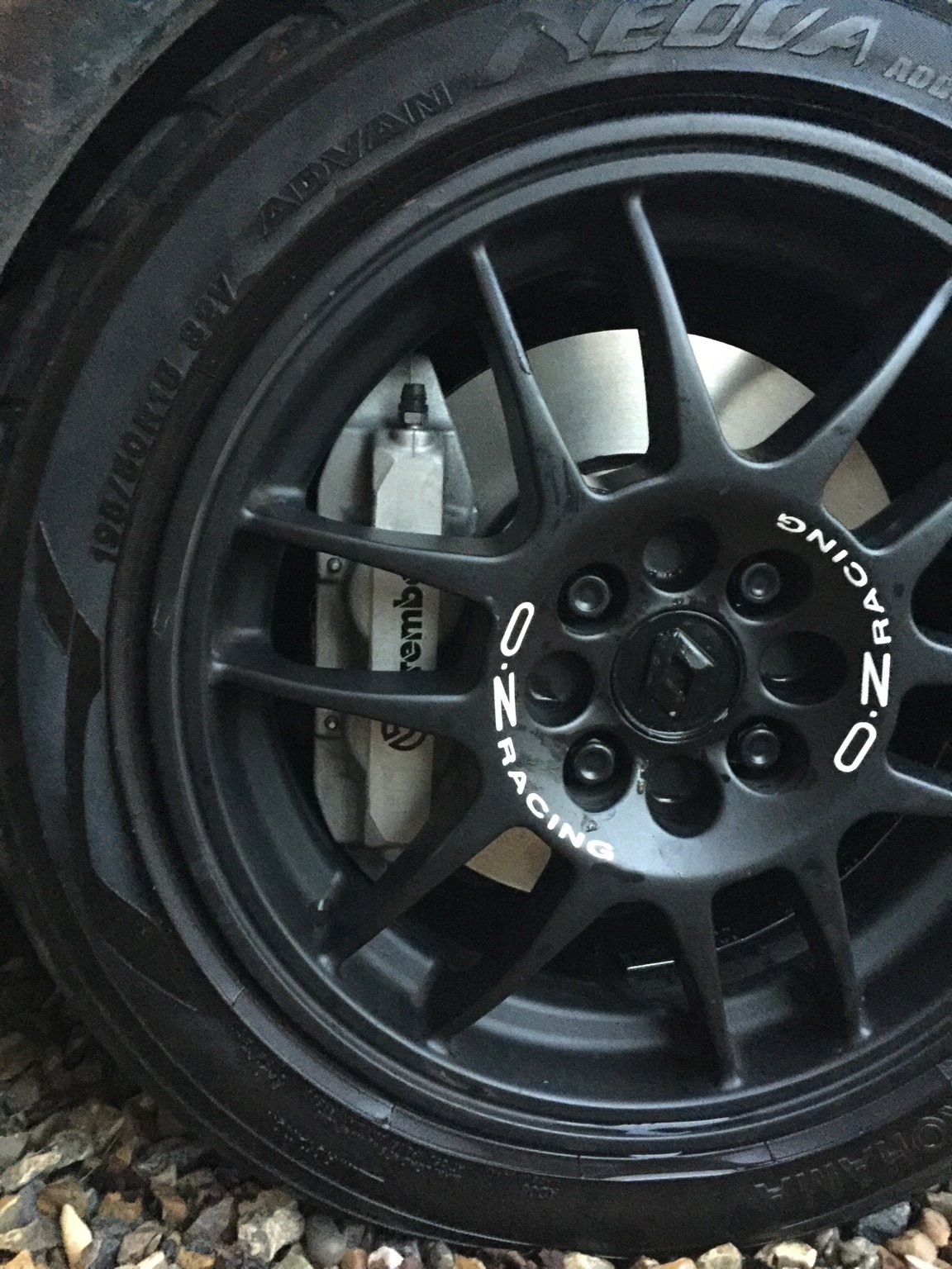

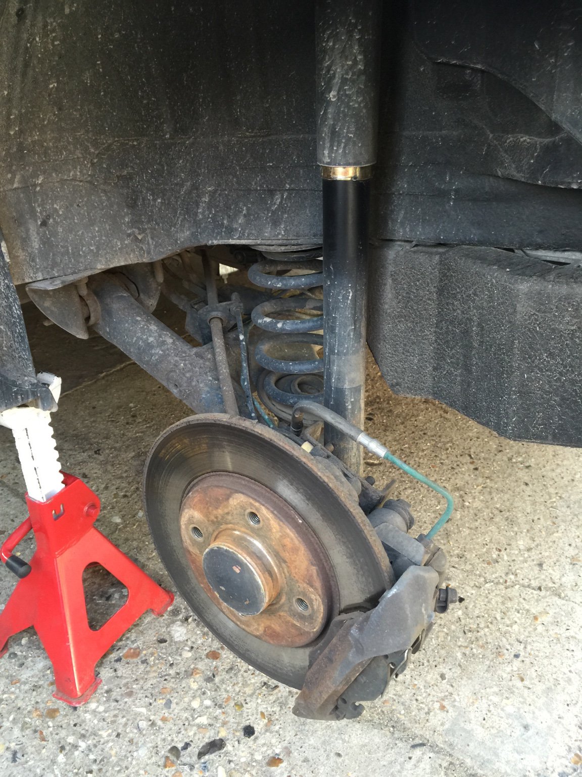

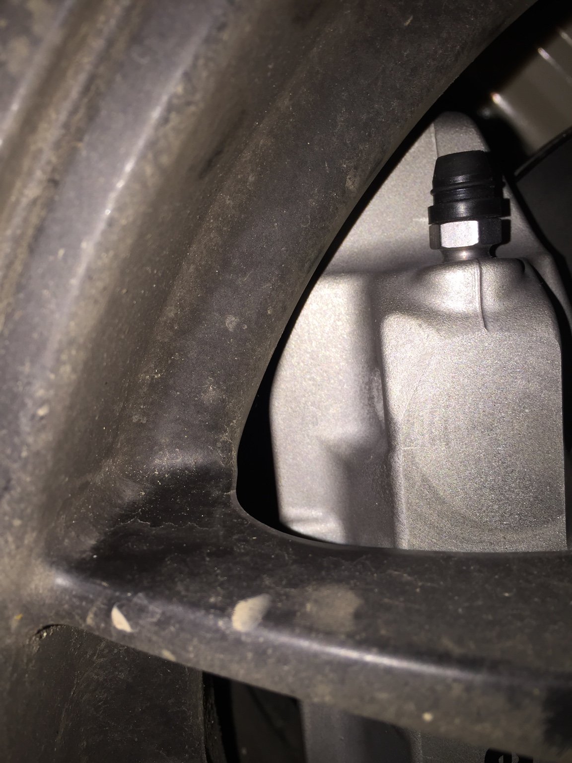

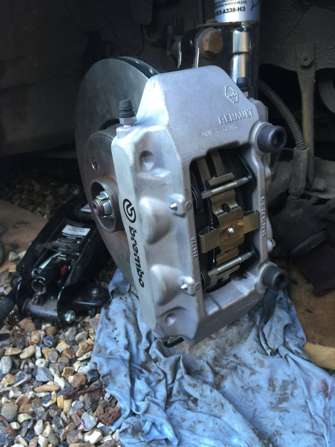

So Over my time off over Christmas I fitted the brembo callipers along with new disc and pads.
I made my brackets at work in my free time and machined the hub and made a bracket to suit this meant I didn't have to machine the calliper at all and also moving the calliper around the centre of the wheel meant I could get a lot more screw thread making them stronger
I also fitted new ball joints and wheel bearings while the hubs were off.
This is before
I removed the coilovers also and gave them a good clean then fitted some covers to protect them in the future.

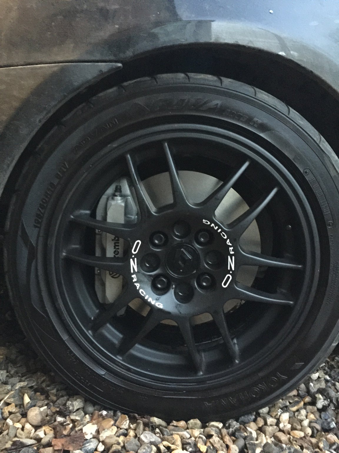

Next was the brackets, disc, calliper and braided lines
Then I fitted the 19mm spacers I made also
And then with the wheel fitted.

Good work with the brackets! I'd love a pair of the brembos on my car, but F1's have always been a downer
What did you have to machine on the hub?
