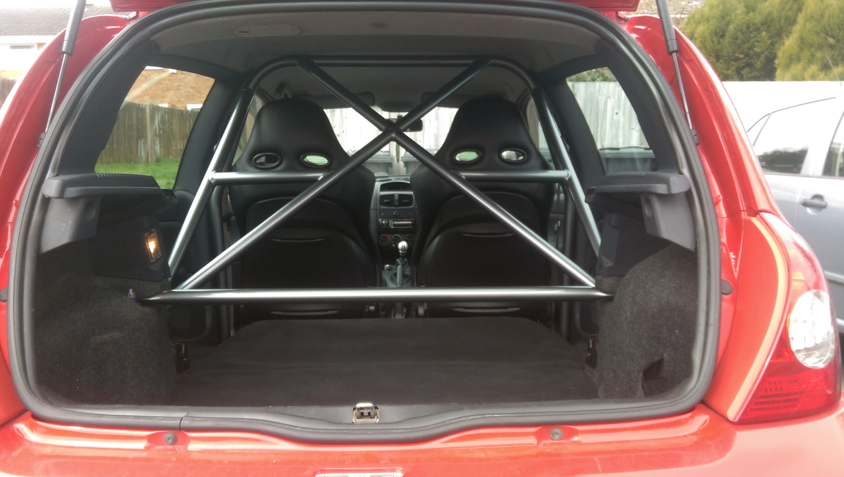

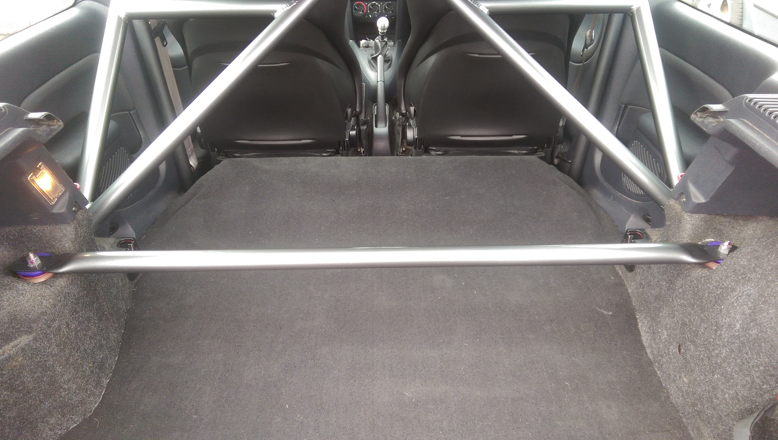

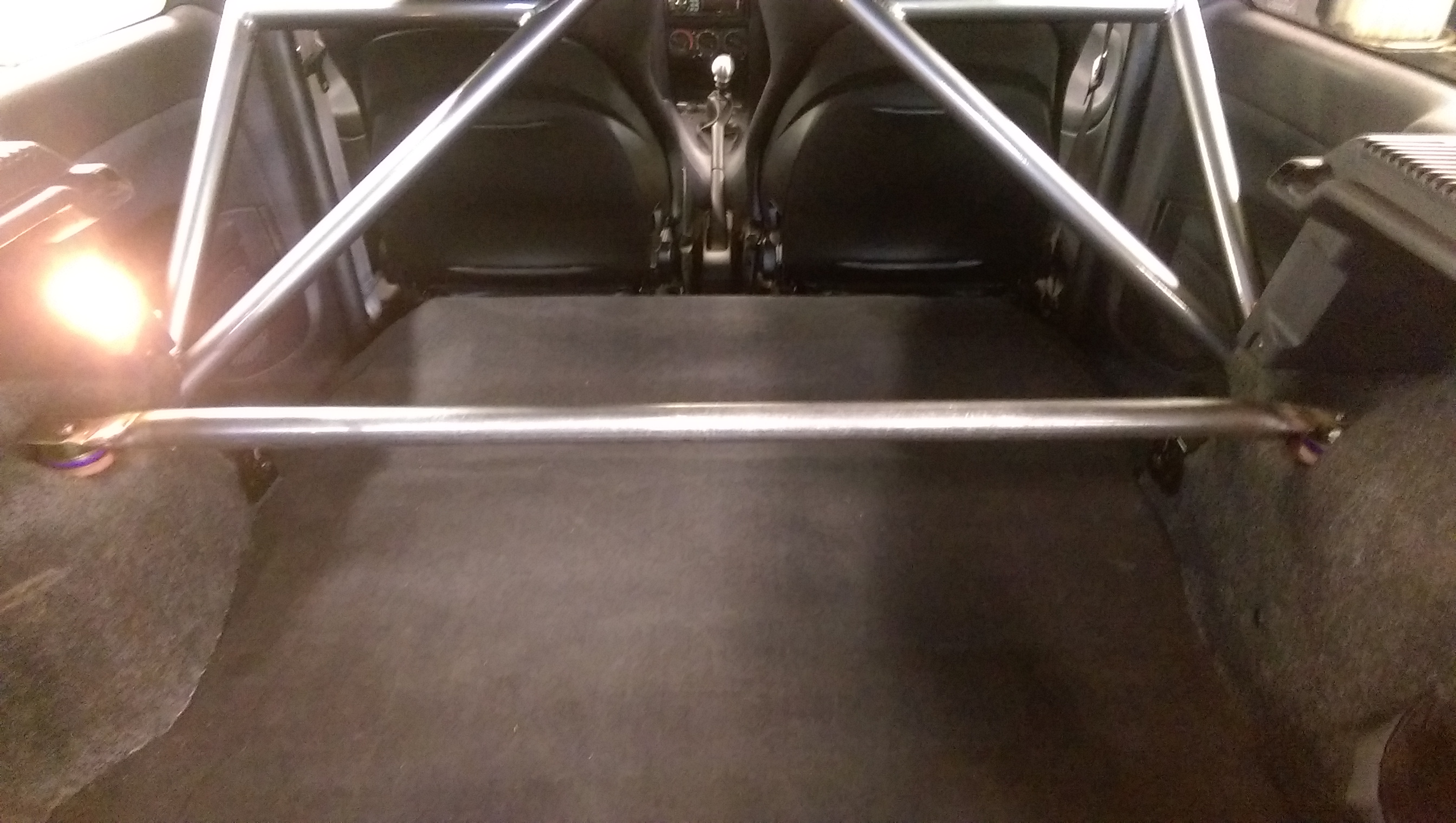

A little bit of fabrication, with this homemade rear strut brace. Just need to get it painted to match the cage!

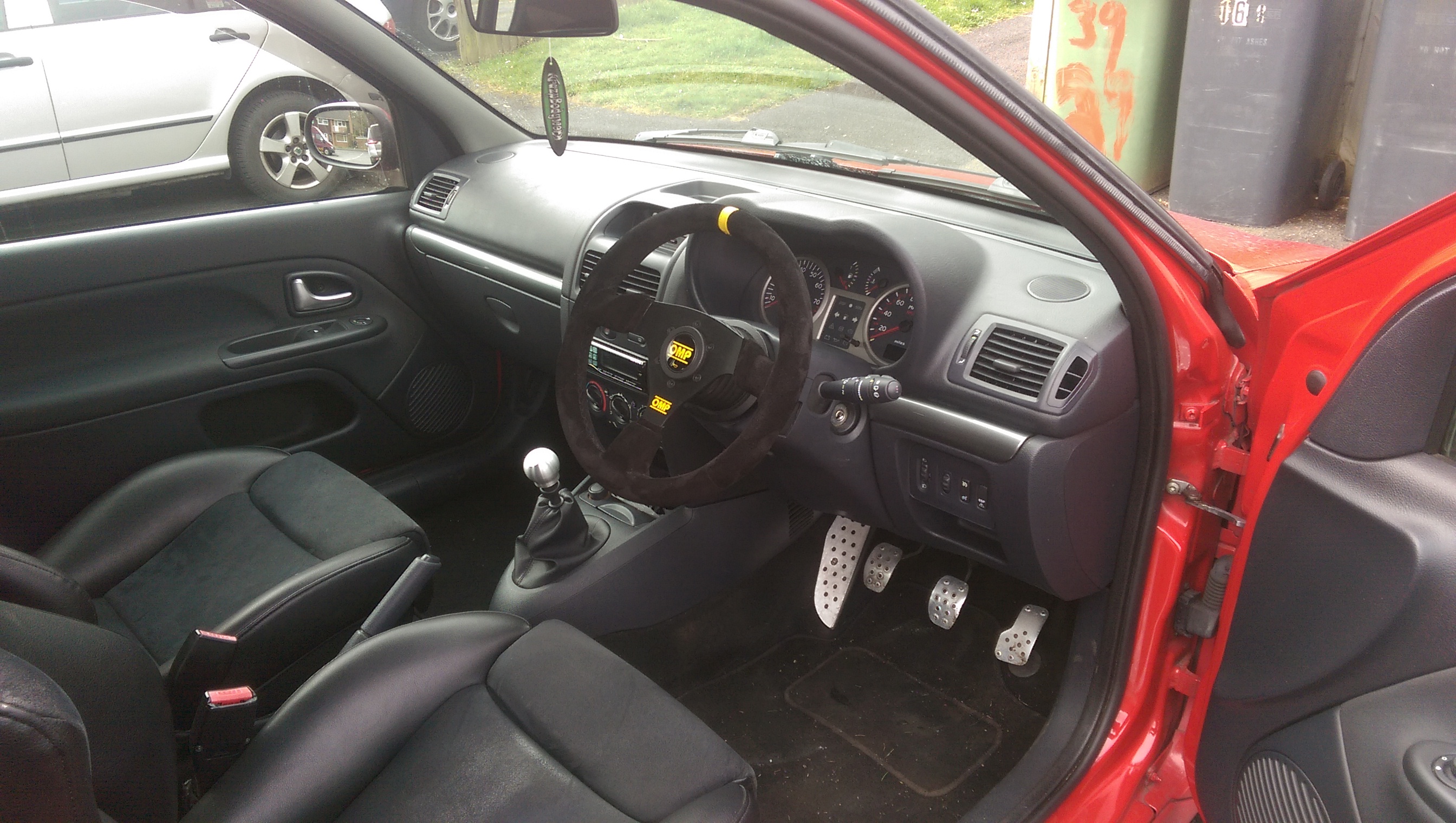

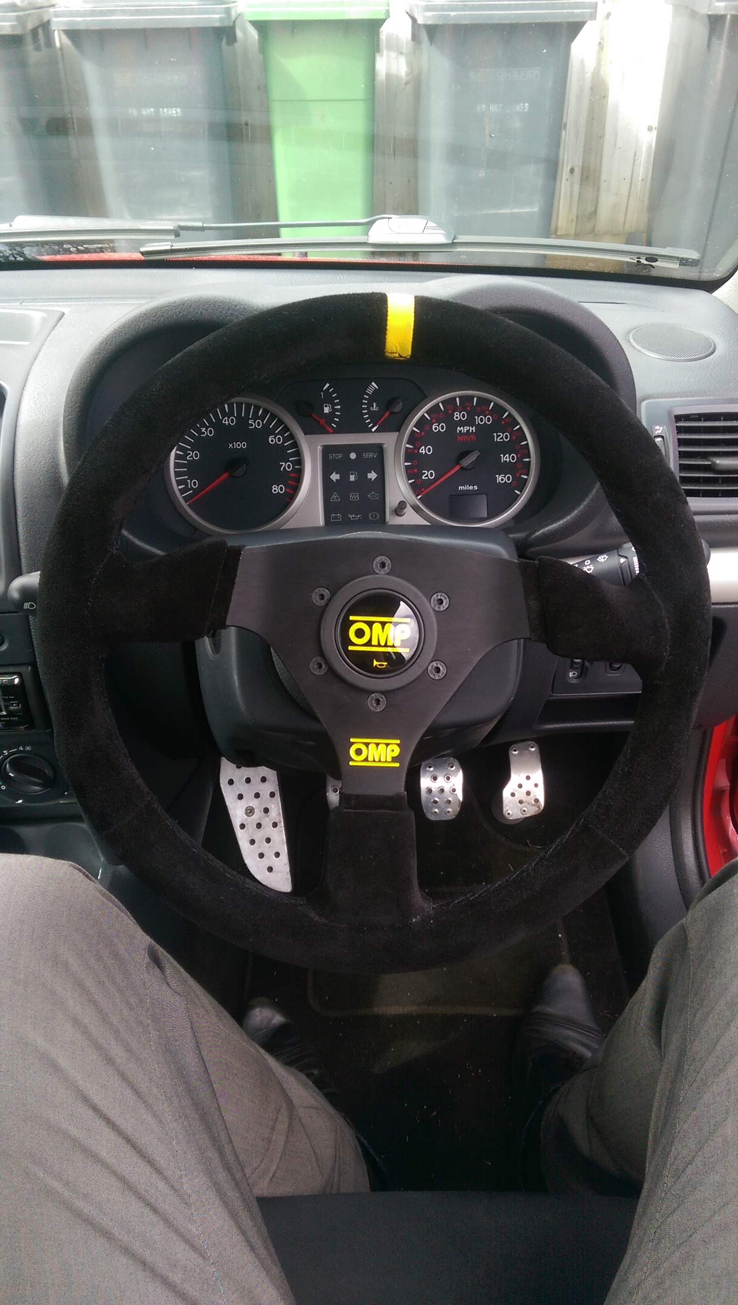

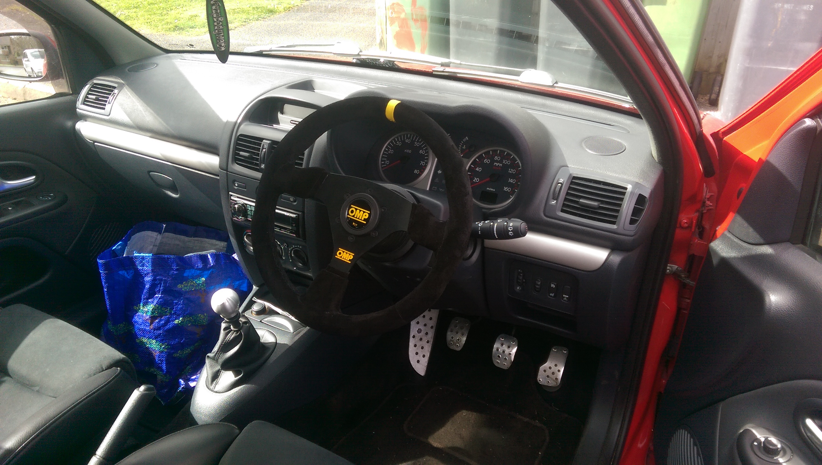

Latest purchase is this OMP Targa wheel! I had one on my 172 and really missed it. IMO the standard wheel is just far too big! Excuse the poor quality of the photos and the random Tesco bag for life....
Any info on how you made the brace please.
I'm about to remove my rear seats but want a bar in place to secure loads to when traveling.
Thankyou
Hi Marc,
It's pretty straight forward if you have access to the tools. Fortunatley I work In a garage! You need to get some straight sections of pipe about a metre in length and some 3mm plate. Using some oxycetolene heat the ends of the pipe and crush them in a vice. Leaving enough gap to push a strip of the 3mm plate Into the slit. Then its a case of zipping it up with a weld, and then marking it for drilling, and then just tidying up the ends. I'm lucky enough to have a mate who owns a body shop so the paint didn't cost me anything. Then the materials on eBay only cost me £14.60 so that's a very cheap rear brace!

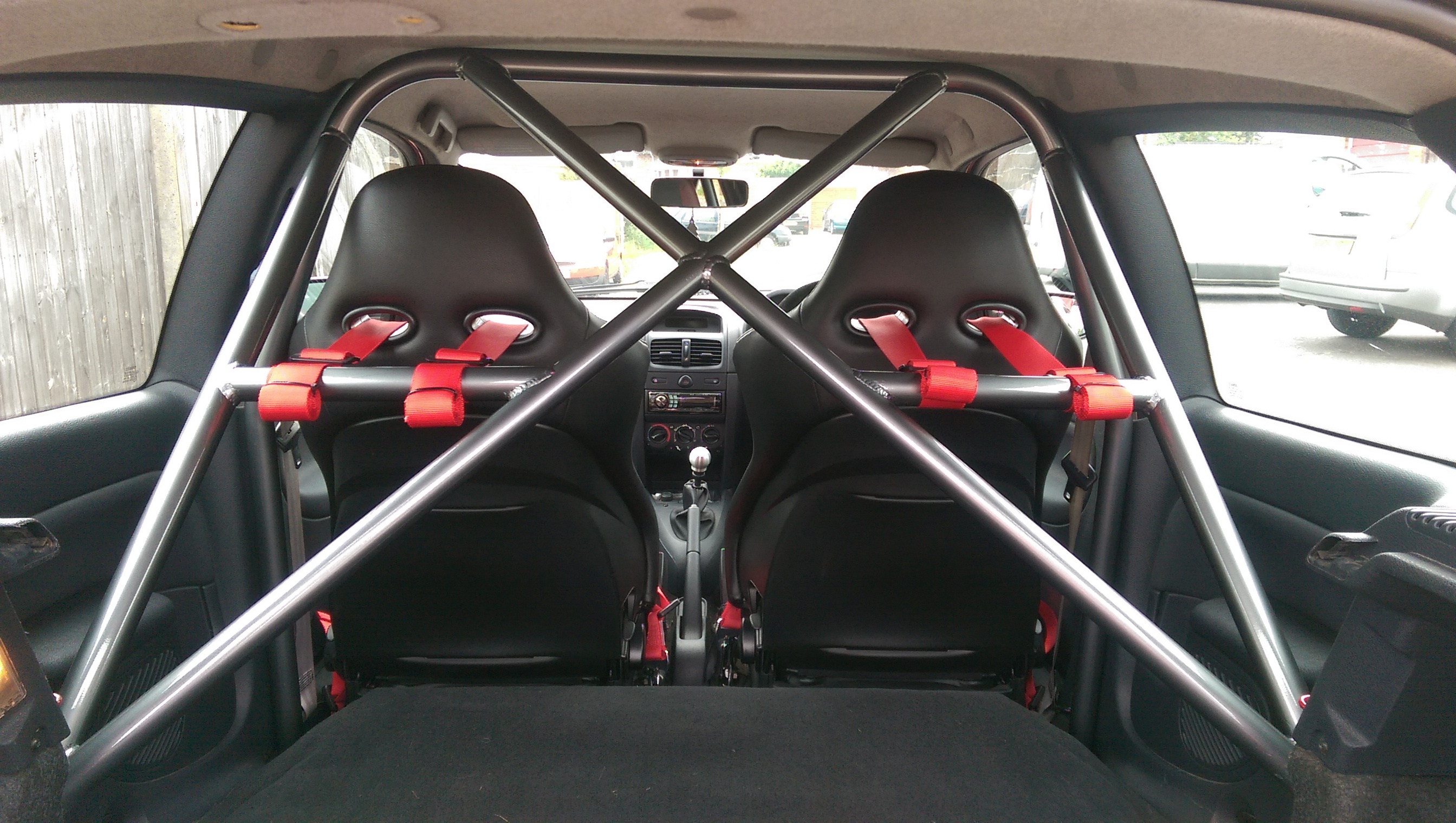

Cage looks epic mate especially with your rear seat delete floor, love the touch of colour too.

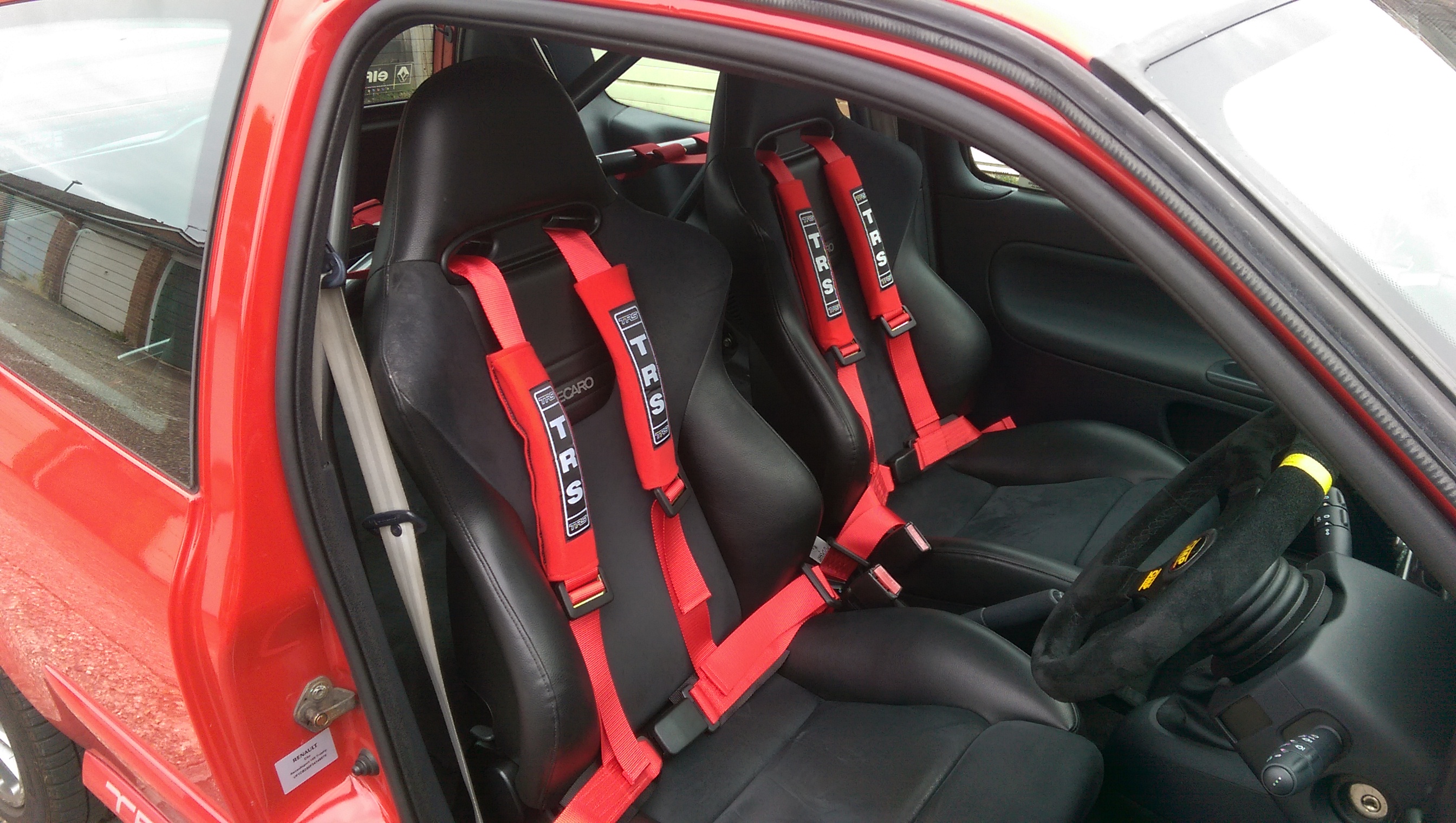

I'm planning on getting my harnesses next month. Initially i was going to get silver but I think it will all look too "samey" instead I've decided on red as it will make a good contrast.

Yes mate thats basically how we fitted them, with a good quality sealant to stop any water ingress between the metal plate sandwich lol! And a good spray of stone chip on the plates on the underside.
And the cage will fit perfectly with the 3mm plate underneath it? Or is that the idea of the bolts. Please excuse my lack of knowledge lol
Also I assume you cut the plates to desired size?
Yeah our plates were a little too large so we cut them down. Especially for the rear mounts. The plates obviously add a little height but it's a perfect fit as the pics show.

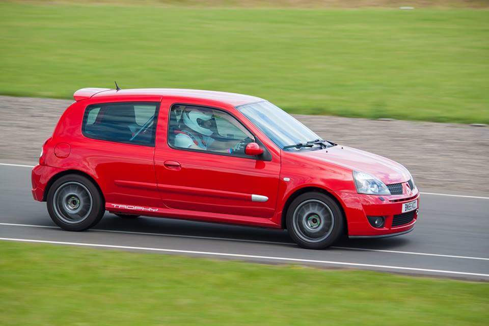

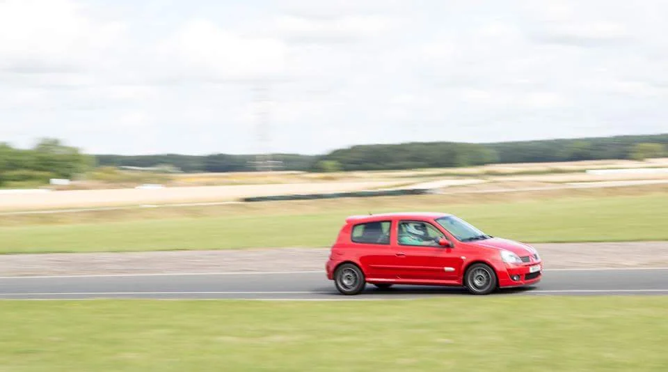

Finally as mentioned CSS15.
What an absaloute awesome weekend! The car performed without issue and I really was wringing its neck! I had a real blast out on track even though it was my first ever time, I've been bitten by the bug and already looking forward to booking my next session.
Here's a few photos unsure of the quality though as being uploaded via my phone.
