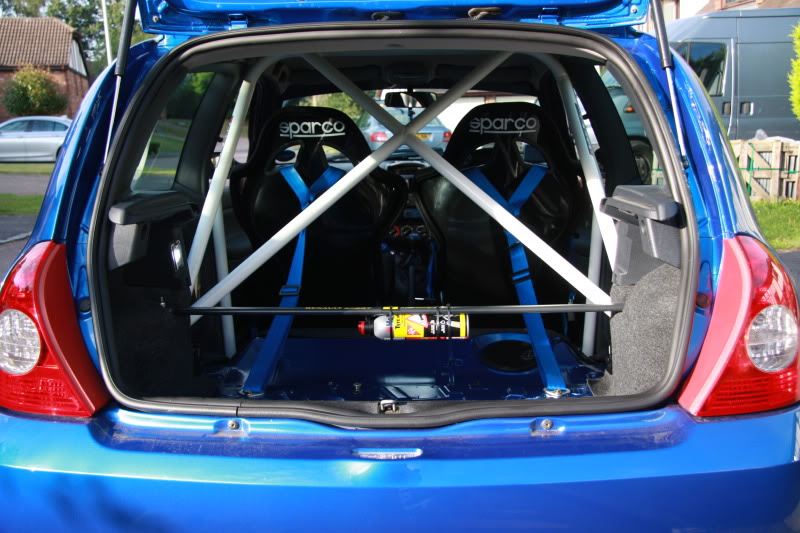

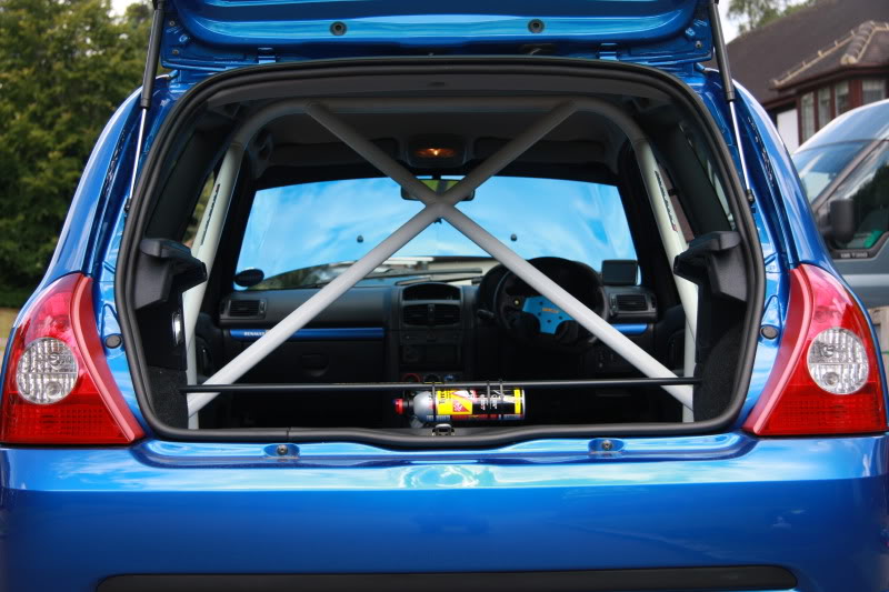

A few of you may have read the thread on the roll cages going for a very good price....

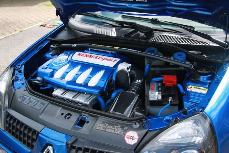

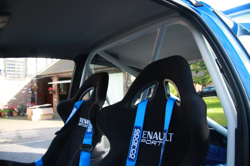

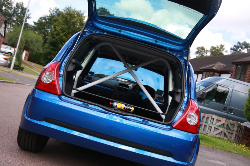

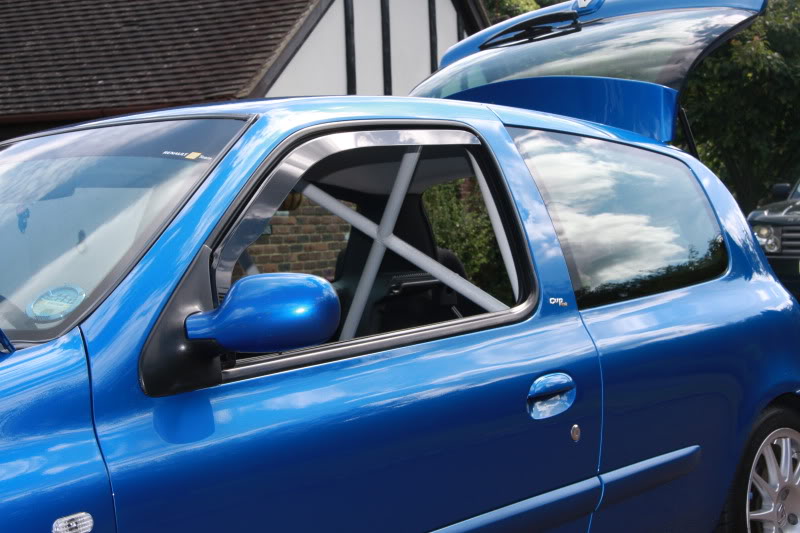

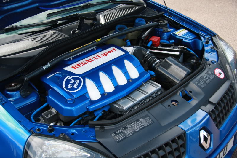

Well I put it into day along with the ITG Induction Kit
It wasn't a hard job, took me about 3-4 hours
ITG FTW

Yeah, just used High Tensile Bolts. Thought about weld but I'll prob take it out "if" I ever sell the car

Looks good, but as Atouba said - hope you never have to test it. I watched the pikes peak video on here, and it was only the quality of the cage that saved them.
I think the Safety Devices stickers are a bit like putting an m-badge on an non m BMW, but each to their own mate. Also, I'm confused why there are Sparco stickers on the back of Bimarco futura seats?
Despite all that, very tidy cup, me likey :)

Looks good, what did you do just drill holes in the floor and the arches to fit the bolts?
IMO hiding the fact it's an non FIA, MSA approved quality cage with a sticker from a respected roll cage company.
"Aaaah so you bought your cage from SD"
"Erm......... Yeah... No...... Looks good dunnit"
Its not a Safety Devices cage so IMO they shouldn't be on there
Yes, it looks good, but looks won't save you in the unfortunate event of an accident :eek: God forbid it should ever happen
Fletcher
I agree. I could tell straight away that it wasn't/ isn't a SD cage.
Oh and why have you got Sparco stickers on the back of your Bimarco seats? :S

But yeah why does it say sparco on the back of futuras

Isn't even a 'scarily thin' tubed roll cage better than none at all?
looks awesome btw.
In a side impact because it has just been bolted to the floor not had a plate welded on first I wouldnt be surprised if the heads just pulled through the metal of the car, but TBH it would still absorb a fair bit of energy first in doing so.
If it rolls over then Im sure it will be better than without it, its triangulated etc so going to be a fair bit stiffer whether its a "proper one" or not.
In a head on, it will obviously do nothing useful at all.
If he bounces his head off the centre bar he risks injury, it should be padded.
I cant see it doing any real harm realistically, and it might do a slight bit of good but TBH these are relatively strong cars in a roll anyway, and TBH its pretty rare they go over in the first place, more likely to bounce off something than roll really.
The fake SD stickers are just horrific, so tacky!
looks awesome btw.
No - not at all
I've seen the cheap, thin cages that people fit for some bizarre "styling" reason actually split in a roll and go into people.
The last thing you really want if you flip your car is metal that's so thin it will split leaving you a nice sharp edge
  182/RS2/ Turbo/Mk1
No - not at all
Providing its CDS, I dont think that will be a significant risk at all, you are probably thinking of ally "show" cages?
