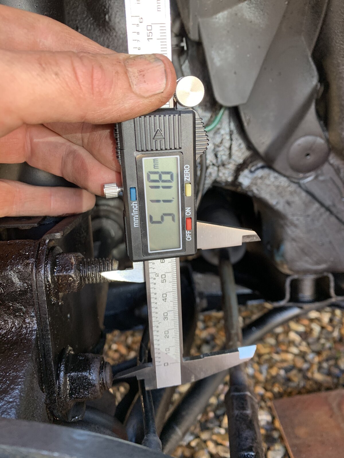

Just struggling to understand the hub I have on here! Considering fitting coil overs so need to know if I have 60mm or 54mm spacing, I can’t seem to find anything measuring either (would the camber bolts effect this? (I.e. need to remove and measure the shock itself)
Then the big question, what coil overs? (thinking budget new would be £1000 max so probably not find a AST set that people seem to think are good!) looked at BC or Gaz Gold so far
Thanks very much

Hey buddy.. Yes camber bolts will have made a difference in your measurements.. you need to measure bolt centre to bolt centre.. Looking at what you have there i say theyre 54mm hubs that you have.. For a grand id say go for the BC racing ones From Kam Racing, as they seem a good buy with them supplied with solid Top mounts included..

Perfect thanks buddy, I was guessing they were 54mm but just wanted an experienced eye!
