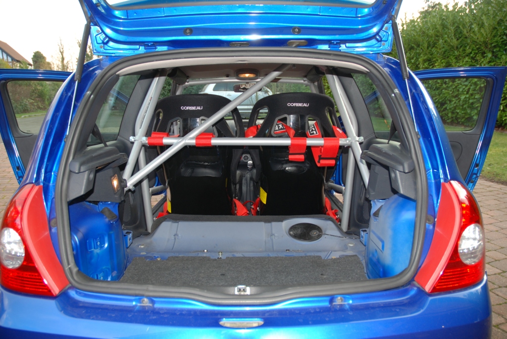

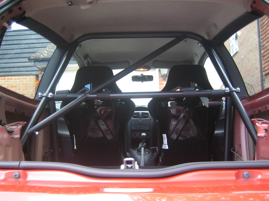

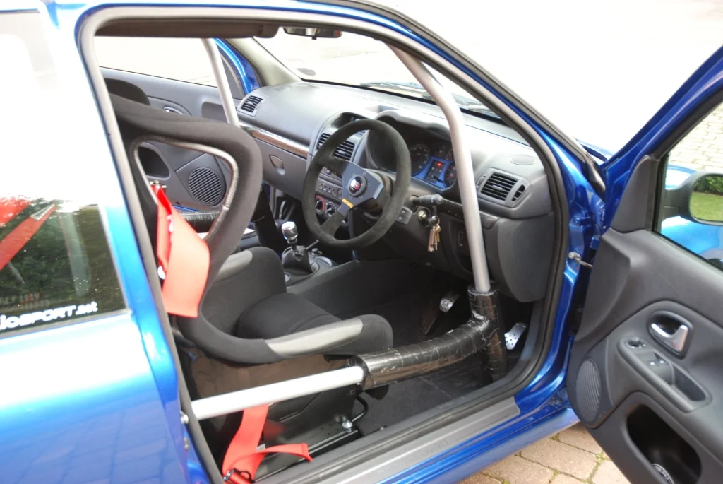

My choice too. Front cage drops before the dash and if you want to be able to use the glove box only a little cutting is required to the door.

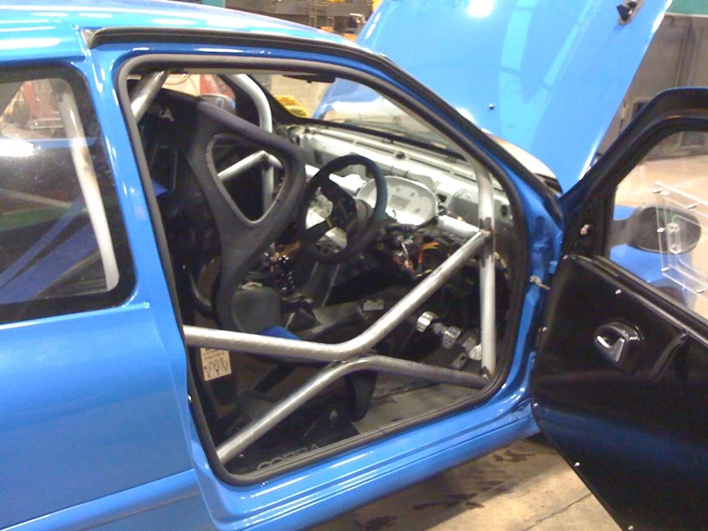

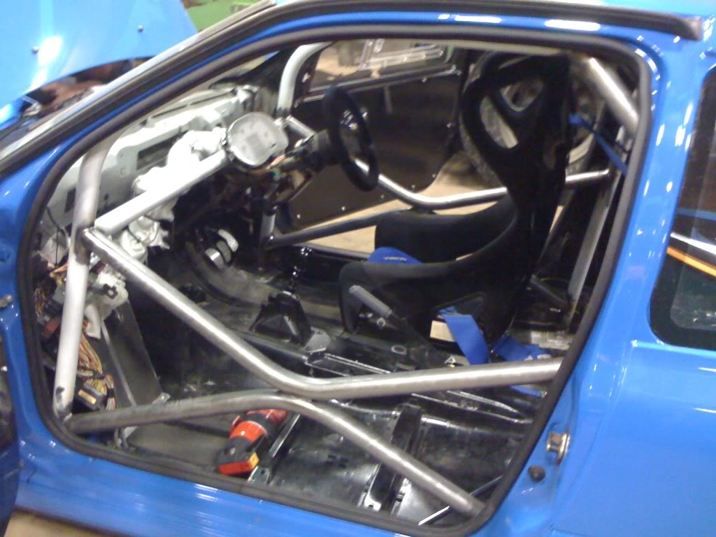

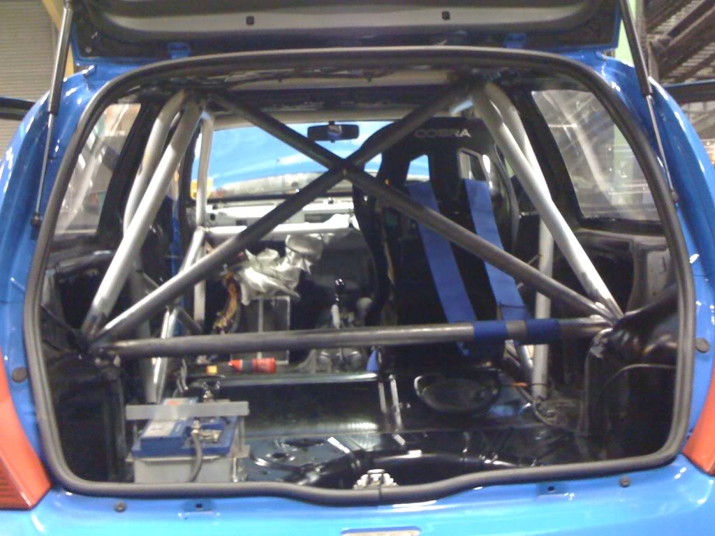

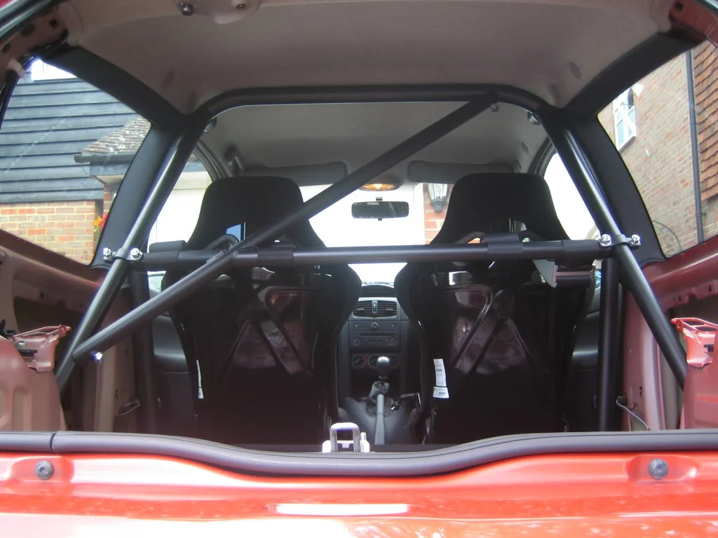

I think you mean 4 point if you dont want doorbars? Dont think the cage really works if the bar just goes round the roof and doesnt have a cross bar.
You can get the door bars which are quite low so its not to bad getting in and out.

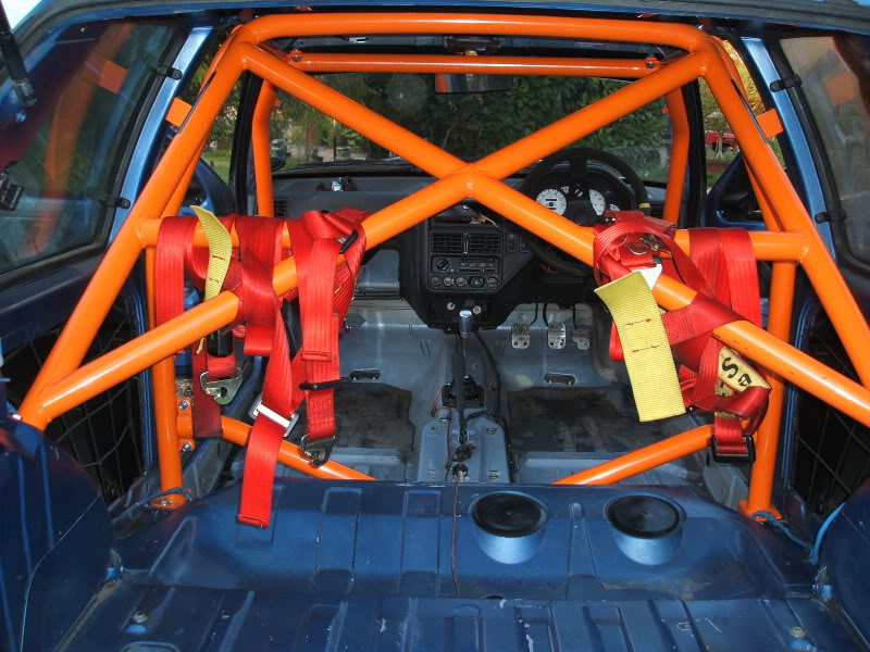

As said before bolt in. Won't require any dash cutting. They usually come with the spreader plates, which need welding in, You might need to box up the centre section ones from the floor. Once the plates are in properly, you can if needs be remove the cage. Ideally you want a bar inplace for the harness mounting, perfect world should be horizontal as you can see from the pics. Good padding aswell if you'll be using on the road, you don't wanna crack skull on it.
I would get some pics of how others have done it for referance with your cage fitter, if you are taking it to someone thats doing a clio for the first time. My old bmw cage was installed by a complete knob, who made a pigs ear of it. This time I paid to have it done properly.
