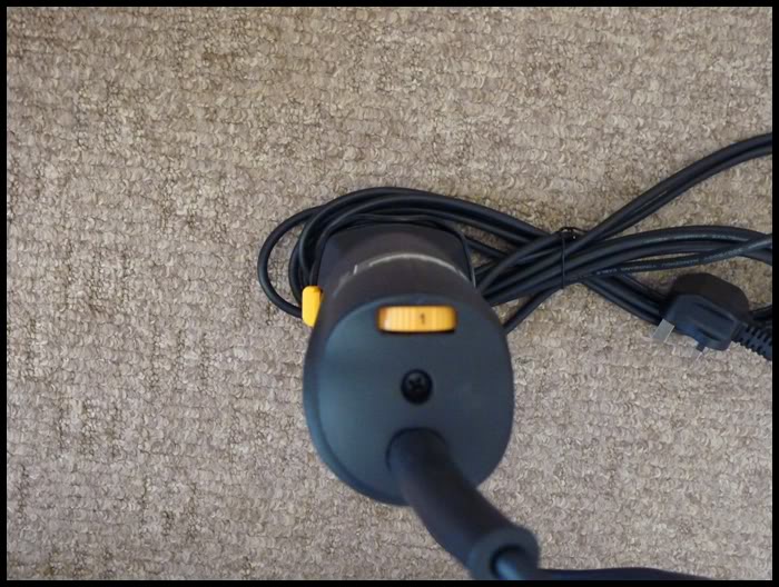

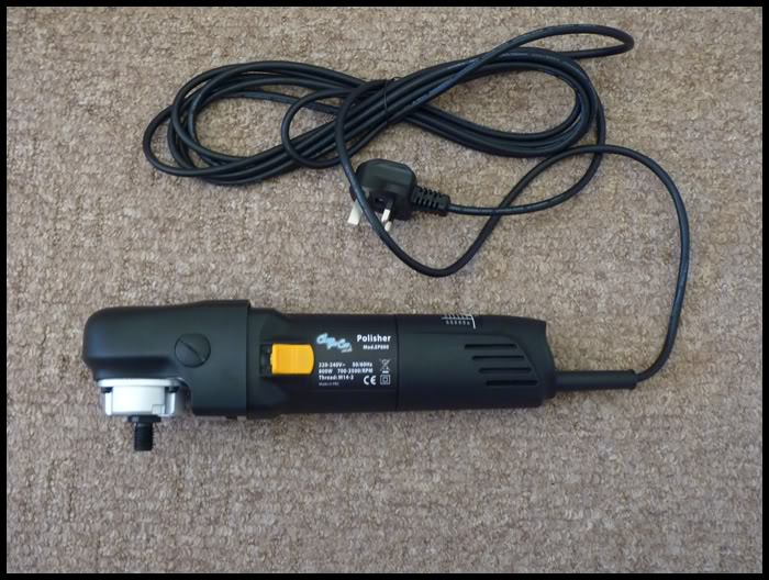

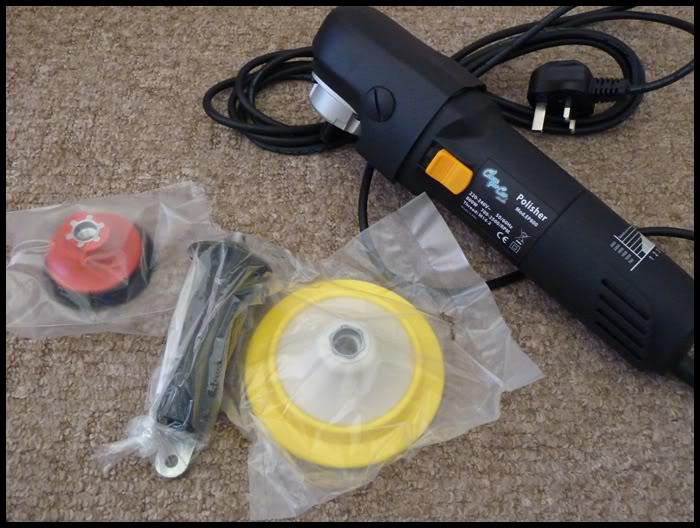

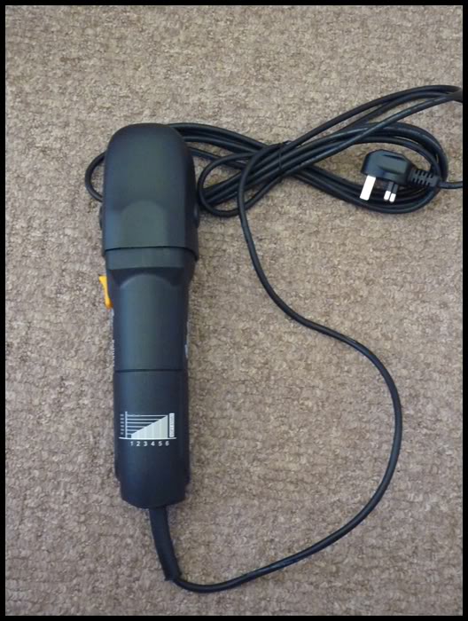

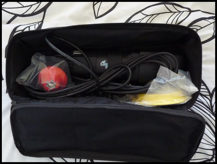

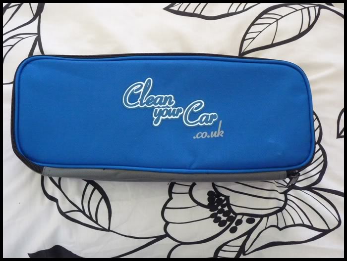

Such a nice change from my Millwaukee. Nice and agile! Love it!

Doesn't mate, I added it in. I've still got my 3M big backing plate although the CYC is good the 3M one has always been my large go to plate. :)
It's a cracking machine, the choice between this and the Millwaukee i'd choose this onlt because I do more enhancement details rather than full correction. Full correction details i'd definitely look.. makita/Milwaukee.

You reckon it would manage a full correction?
Gally
Easily mate, just it's lovely really is. I'm actually being harsh it isn't too light. As you'll have seen on DW Valet Magic's Robbie had been using it on Full corrections.
I just love it's agility.

As long as its lighter than my sim 180 then im not bothered. The speed wheel makes it look like a DA to me, lol
Gally
I was very worried about th speed dial until I held it and thought to be honest it's pretty spot on mate. Tim said he asked for it to be there but who know's.
It's much much lighter than a 180 and lighter than even a CP. I like modern waxes/Rotaries. I feel like they have learned from what has gone before and improved on it.
It's not the prettiest but for the price and performance it's hard to beat.

Thanks for the info mate, might try the hax pads too with the wool included. They look similar to cg hex ones.
Gally
Yeah Tim threw in a few for me to try. I try and stick to 3M they are so durable and the HEX ones are very very good.
