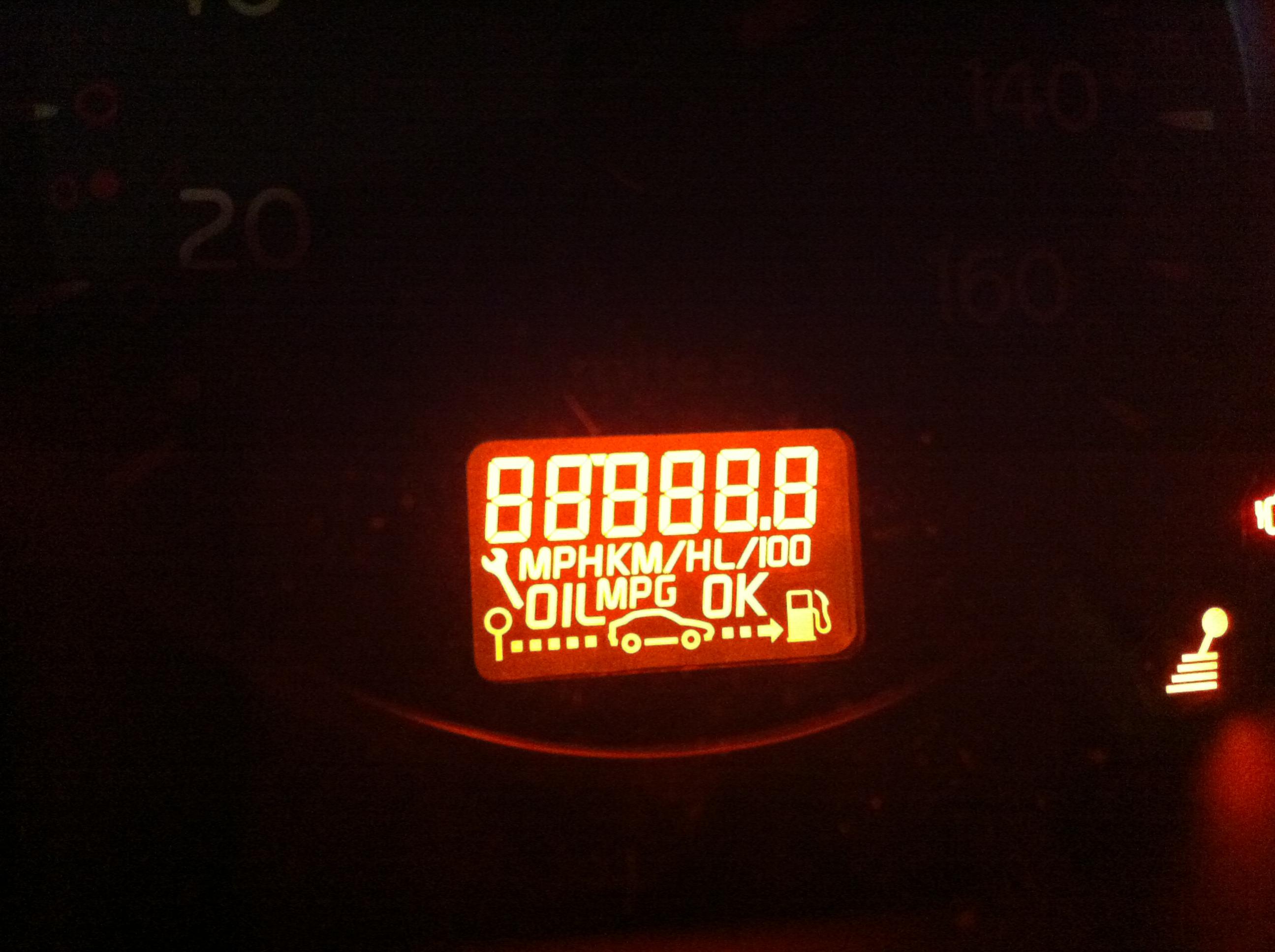

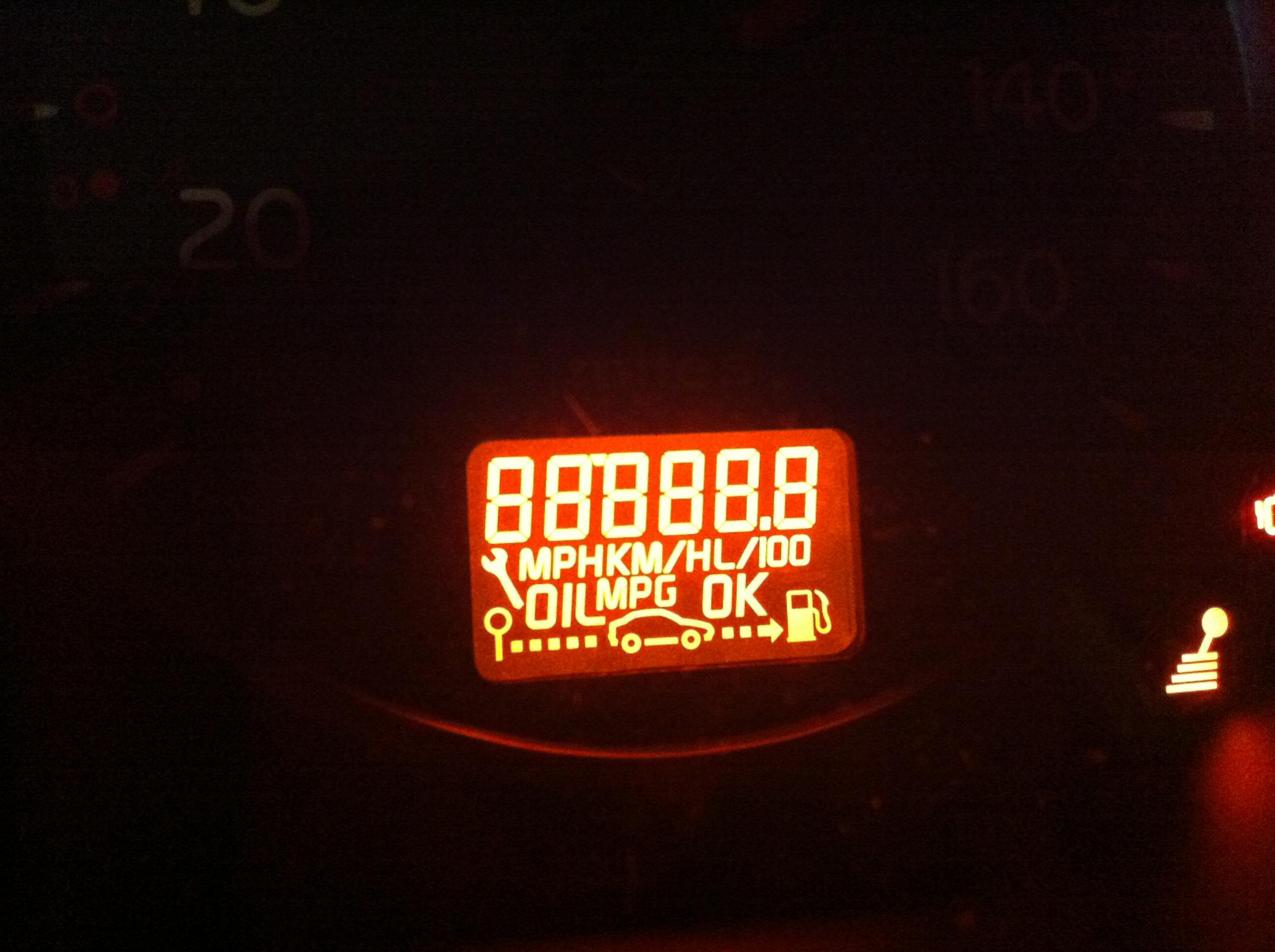

Hi guys , could anyone help identify this error code I'm getting after the old stalk button pressed in before turning the key over.
Have just rebuilt the engine, Parts replaced, Big end bearings, APR's, Rings, Valves, Oil Pump, Water Pump, Cambelt Kit, All Gaskets + Seals, obviously everything else came off and out, getting disturbed.
Suffering with a rough idle, running at say 600/700 sounding slightly lumpy.
Is my error code something to do with anything "idle" related? Cheers Cs x

All the lights lit (shows if you have a failed LED).

Do i have any of these faults? Thanks for that though mate! Seems like you know your stuff :)
Thats just your test screen to make sure all the parts of the lcd display are working
On your previous screen earlier on you have the 't' and 'h' fault codes
Get to that screen again and press the trip reset button on the dashboard in front of the speedo dial
it will clear these faults.
if they come back after a few days driving it may be a fault, bear in mind the poor wiring on these cars though.
i had t and h faults on my old 172 and after clearing them they never came back.
Let us know how you get on.
